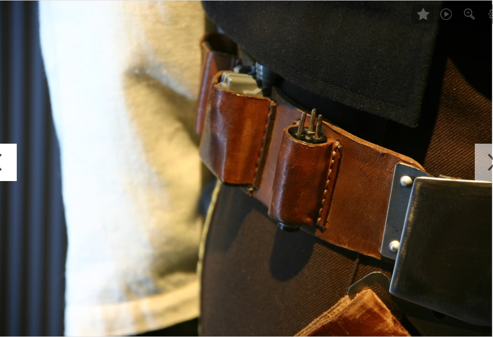

As I prepare the photos for the pouches, I wanted to take small detour back to the hooks.
You know, this project would probably be done already if I didn't have to go back and change a bunch of stuff, every time I come across some new photo. Oh well, that is what screen accuracy means I suppose. :)
After sifting through the photos I took in Seattle, I noticed on only two of them, something that made me realize my previous assumption was wrong.
In my initial design for the Episode V hooks, I knew from the reference photos that the one side was a rectangle shape. However, the reference photos showed that the other side had a top and bottom that curved down. I assumed this was because they were attempting to reduce the height of the hook, so it could more easily work with the "Y" connector.
See here:
attachment.php
See how the top of the hook curves down?
I looked at this, and that little bit of metal to the right, and assumed this was the hook curving back around behind. My original design had the hook curve down, straighten out, then curve back around.
Well...turns out I was quite wrong...
On the right, we can see the hook from a different angle.
That was no reduction in height, nor was the metal curving back. It was actually a notch in the hook. Weird, huh?
This new information prompted me to go back and redesign the hook, which as with most things on this holster has a knock on effect, in that it meant that my loops were wrong, and the "Y" connector had to be tweaked, etc.
The reason I am posting this, is because I would like you guys to look at it with fresh eyes.
Fresh Hook
On the image above, the photo on the left is from Episode VI.
What is strange is that it seems to have the same curve, but in this version, the notch has an outward curve. Compare this to the Episode V version, which appears to have a concave curve. Here are the new shapes:
So, I am hoping you guys can take a look at this and let me know your thoughts on whether I have properly interpreted this new shape.
