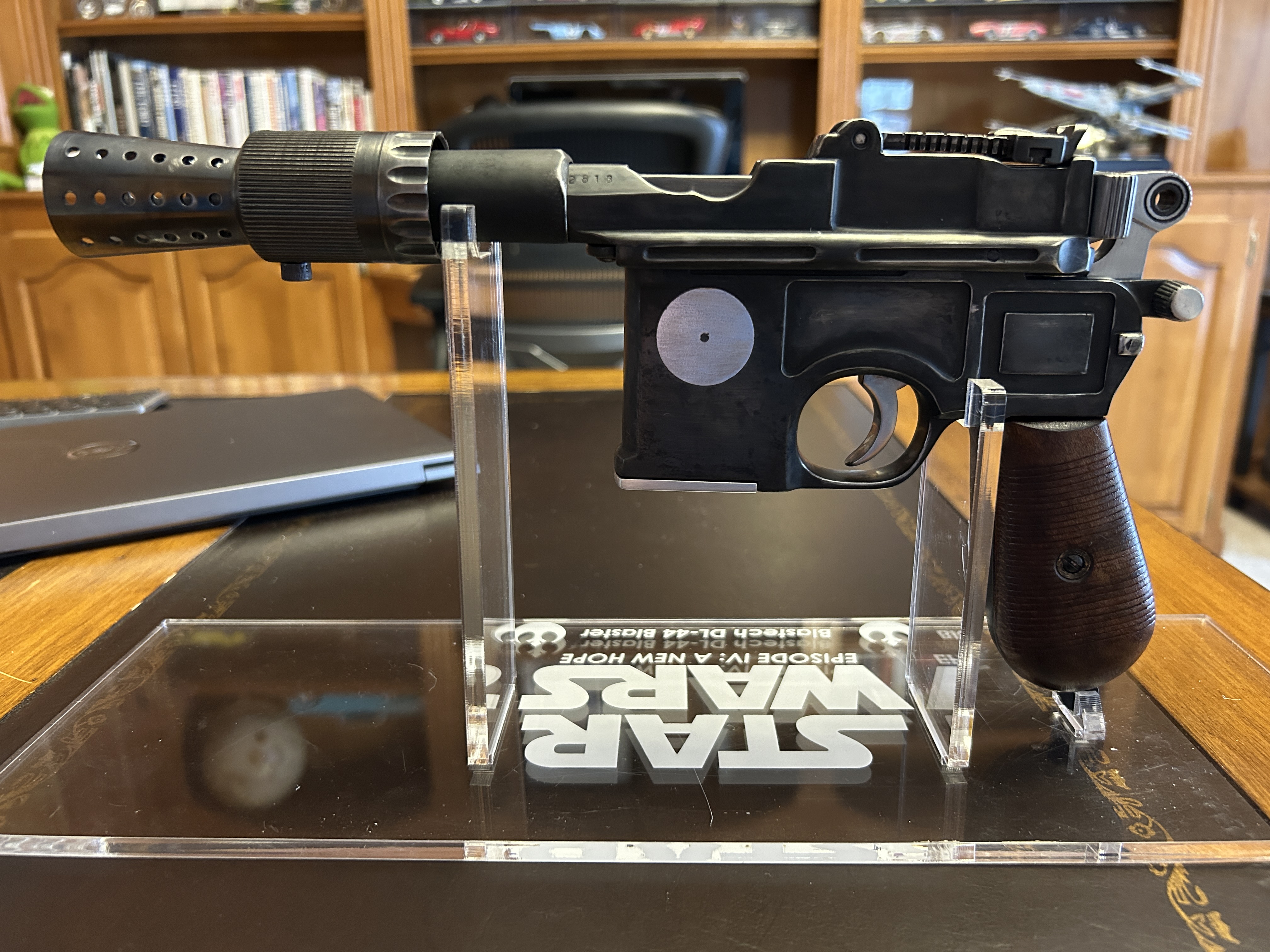

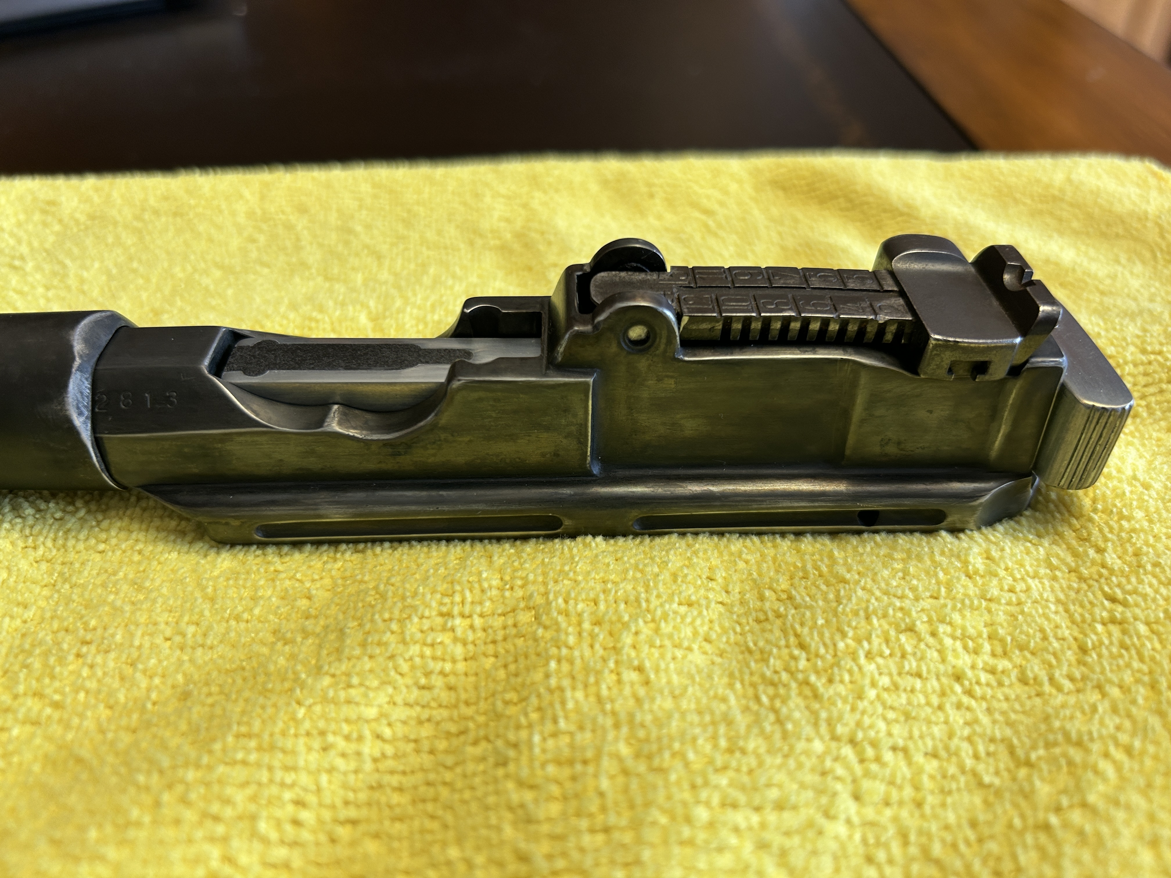

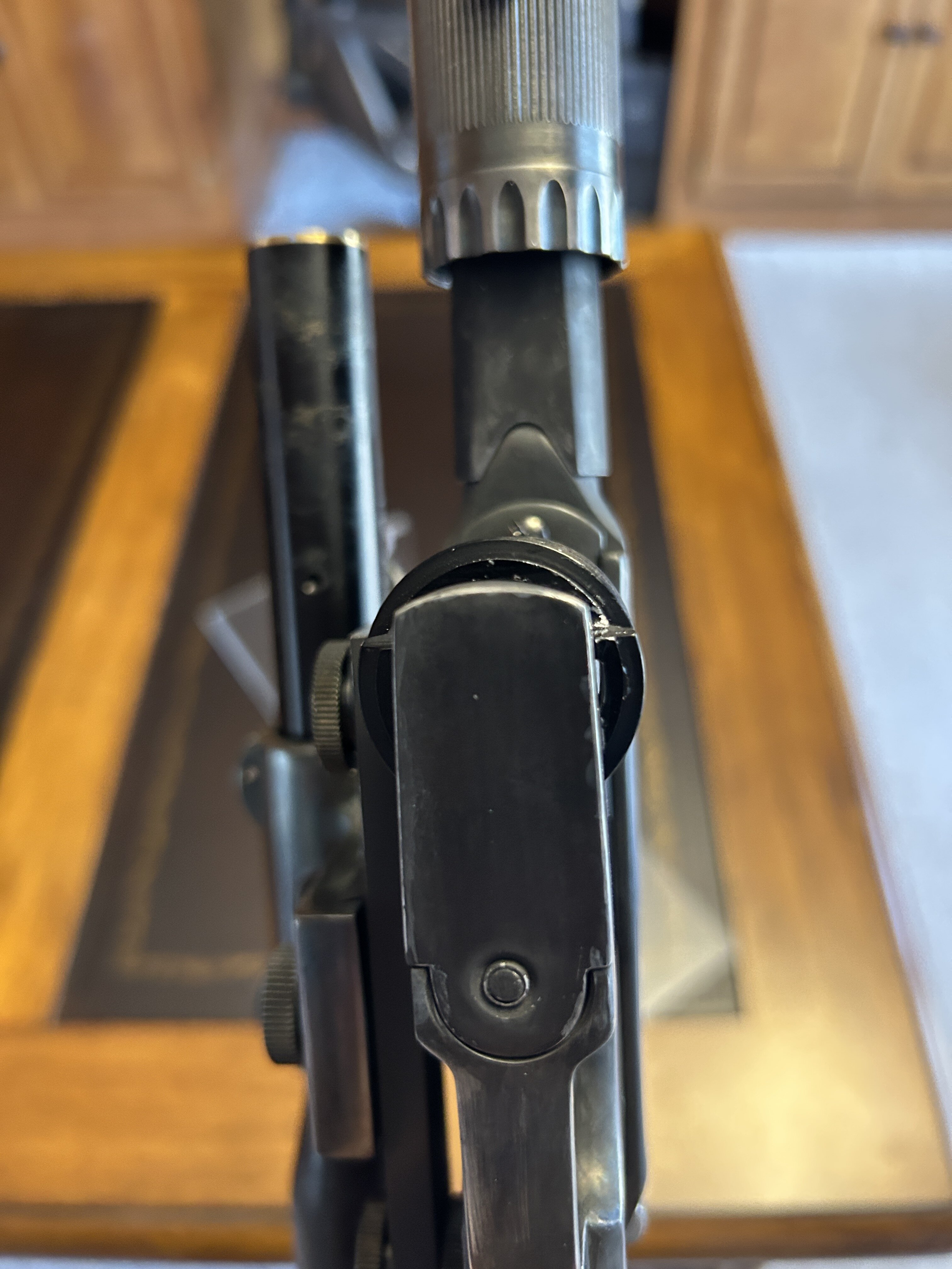

I did another coat of super blue on the denix upper today. I am excited about how well it turned out. It almost looks like an old gun…minus the weathering. I’ll let that cure and hit the edges with sand paper tomorrow. It’s going to match up nicely with the 1909 Mauser sight I’m using.

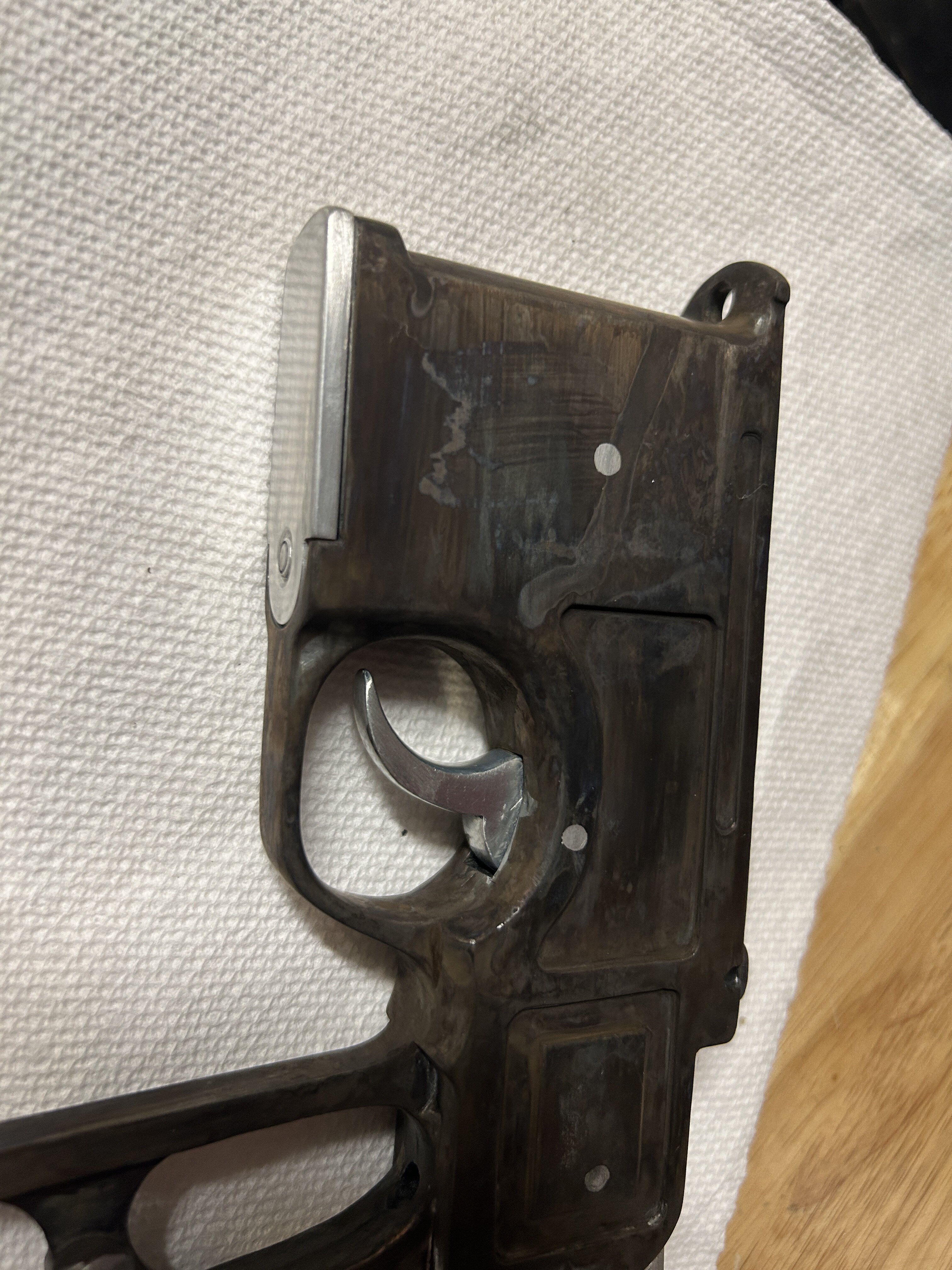

In today’s edition of trial and error, it was mostly error. I applied aluminum black to the denix receiver and it didn’t react with any of the aluminum I added…not the mag plate or the rod I filled the pin holes with. Looks like I’ll be sanding again and painting it. From my reading here, it sounds like paint doesn’t adhere well to the denix. Any recommendations on primer and paint? I’m a model builder and typically use tamiya spray paints.
I used some 0000 steel wool on the aluminum black . I like the look of it. Could use more coats. Maybe I can paint the plate and hole patches and blend them to match.

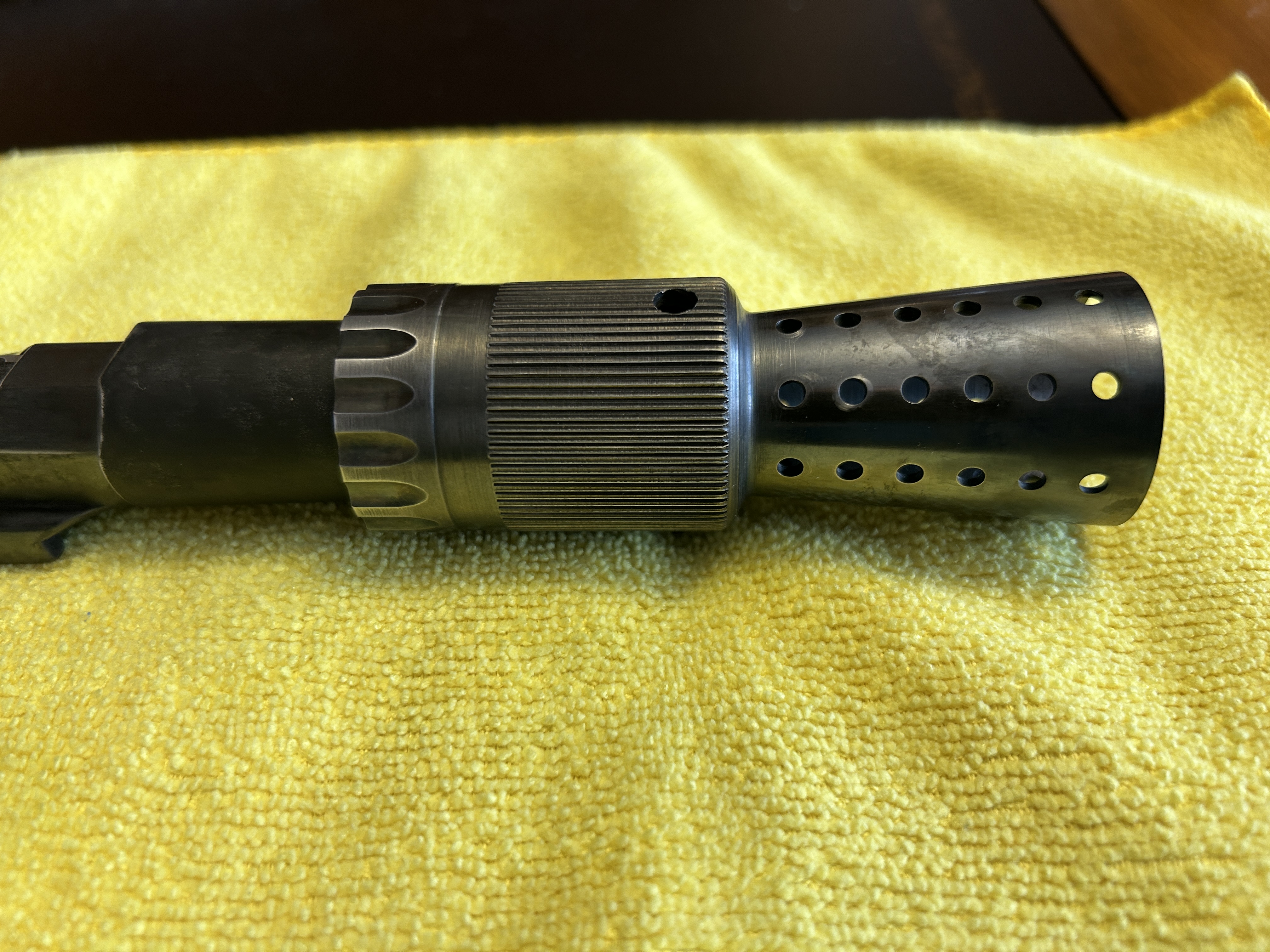

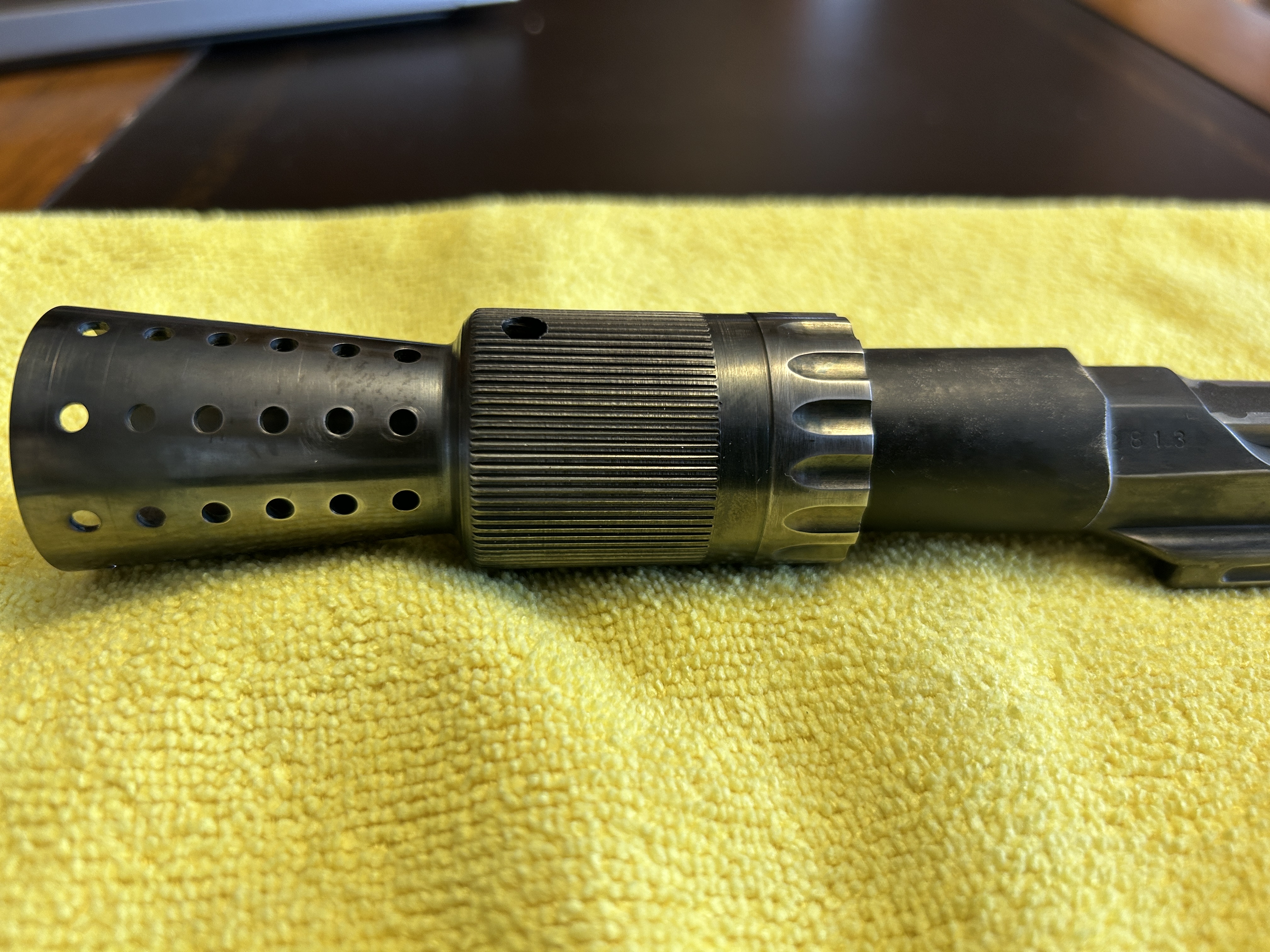

Good for everyone who figured out how to use birchwood casey aluminum black. I am not on that list. I started working on the aluminum bull barrel sleeve. Did one coat by hand with cotton applicator. It was blotchy and less than half covered. The next day, I tried to add a layer. Did not adhere and cover the piece better. So I sanded it all off and immediately went back to applying the AB directly to the surface. It covered better but still blotchy. I used tamiya weathering to salvage it. I’m done with AB.

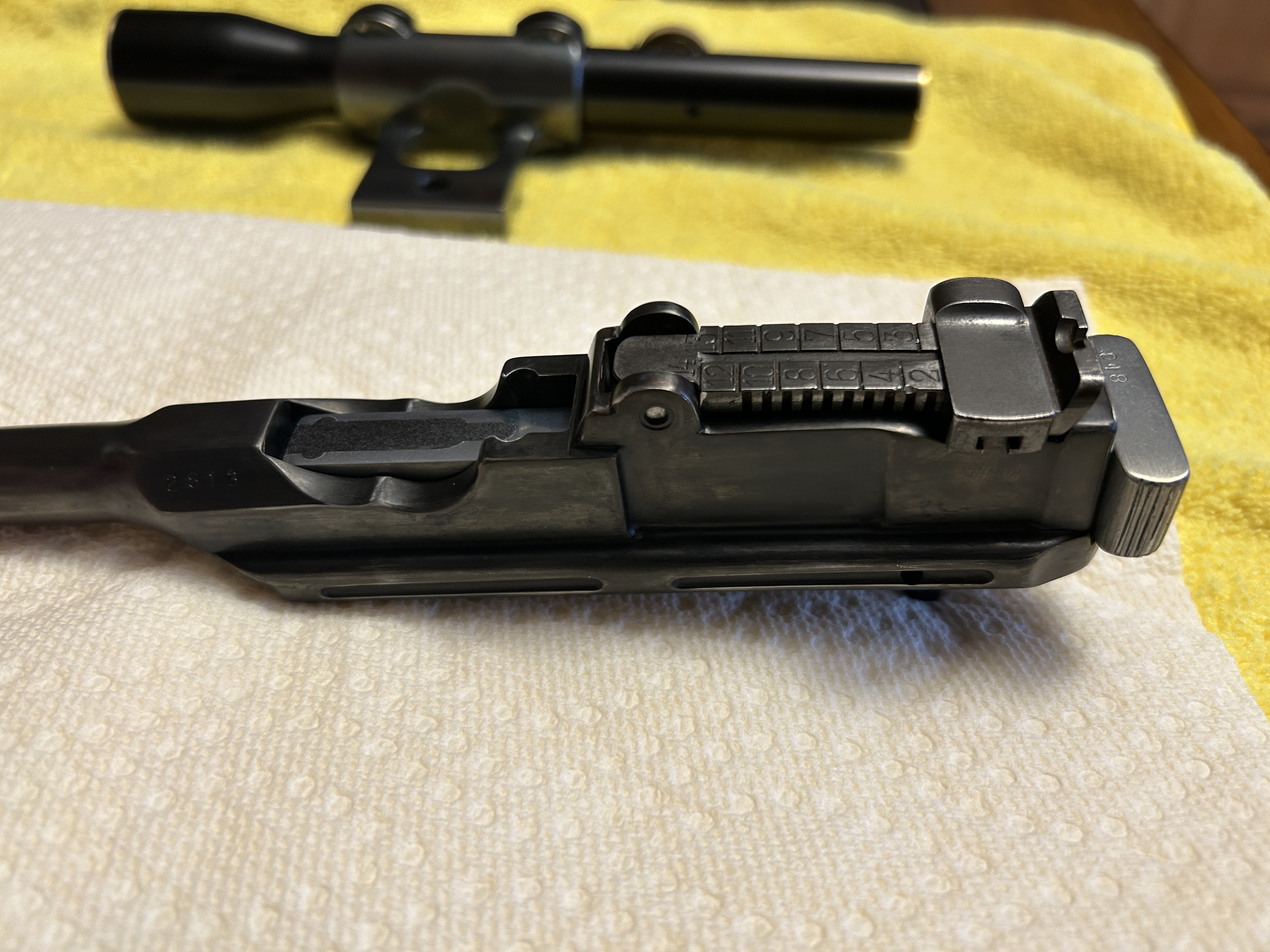

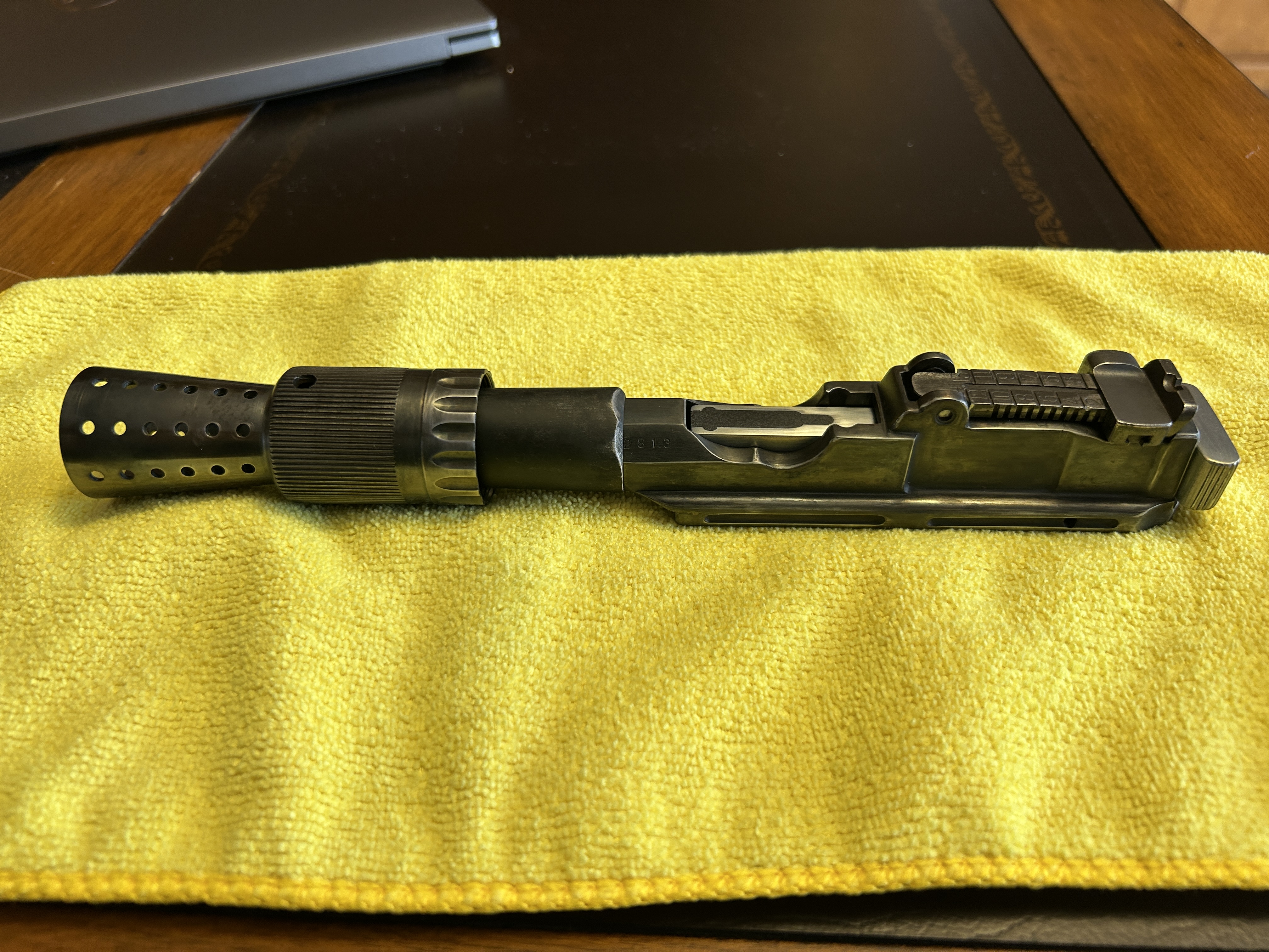

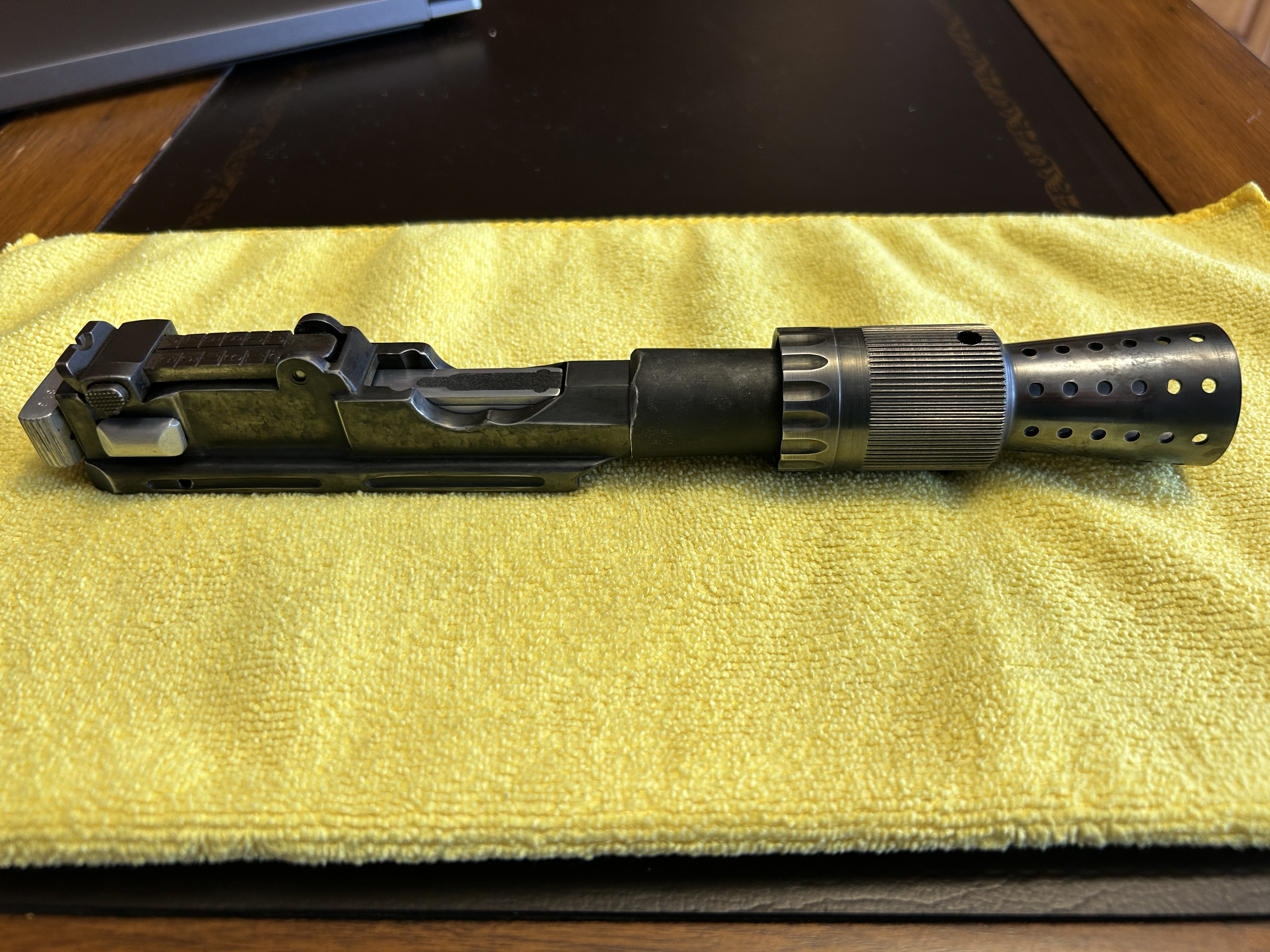

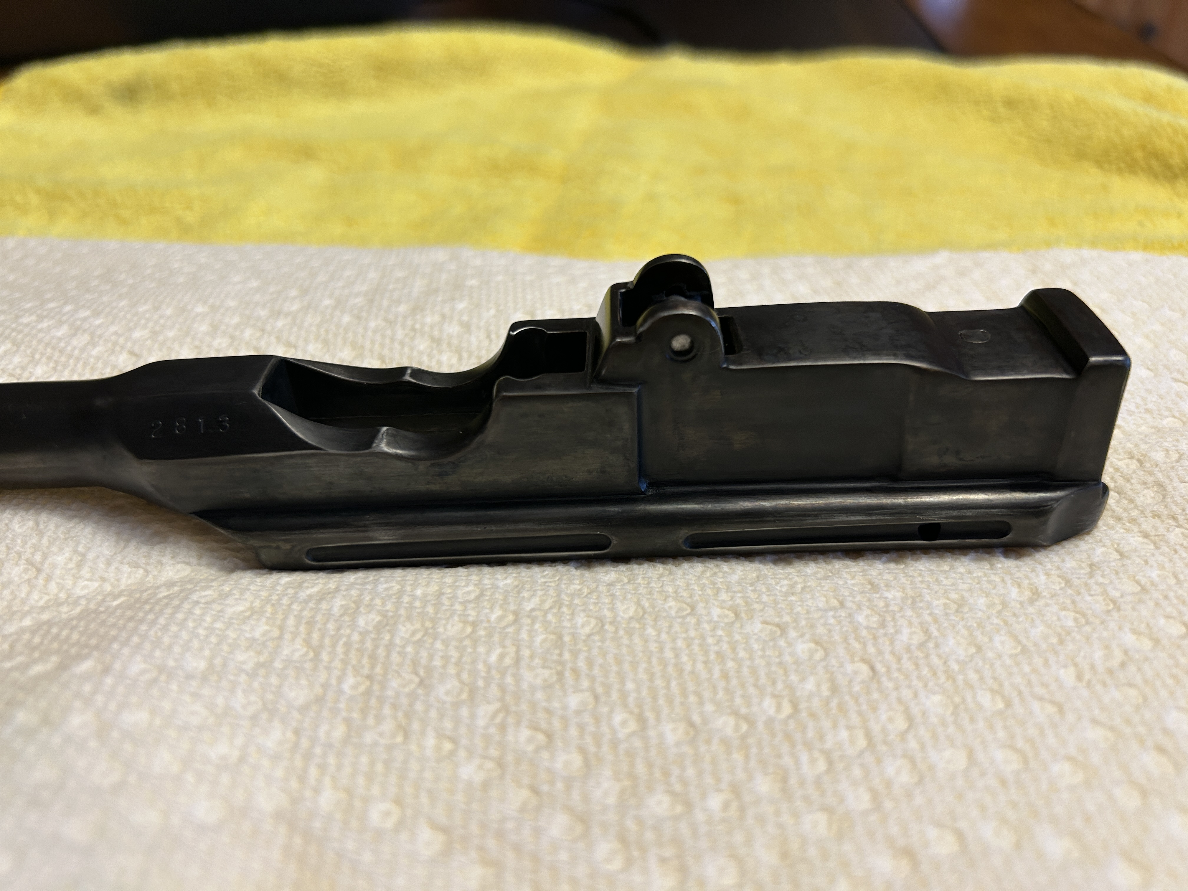

But I can share one milestone. The upper is complete and assembled. Yay! I added a thin strip of rubber between the denix barrel and sleeve. There is no wiggling. It’s solid.

That patina looks awesome, I like it a lot
Thank you. It’s hard to take pictures that show the finish well. It’s reflecting the yellow microfiber cloth. But it is what I wanted. It has variation in color and transparency.

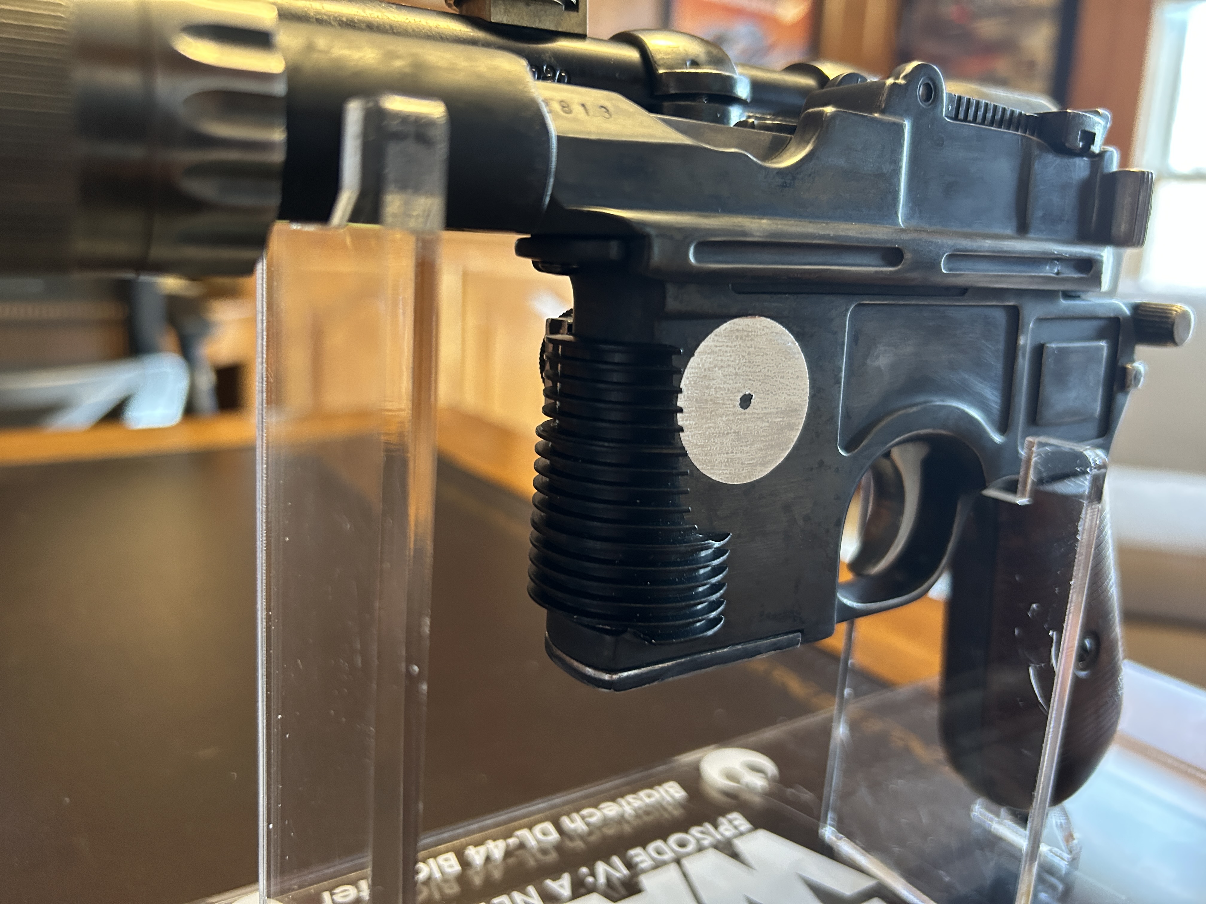

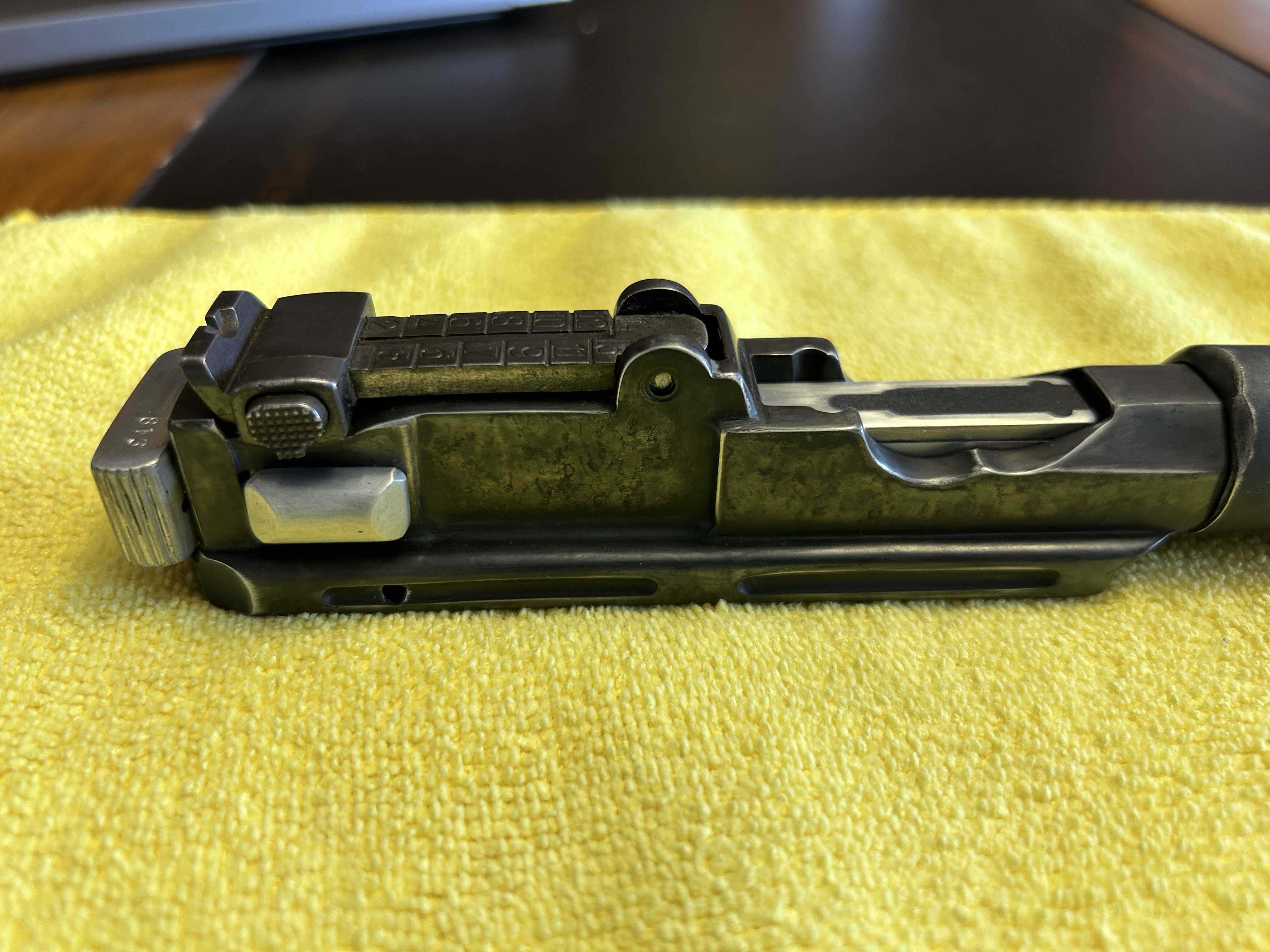

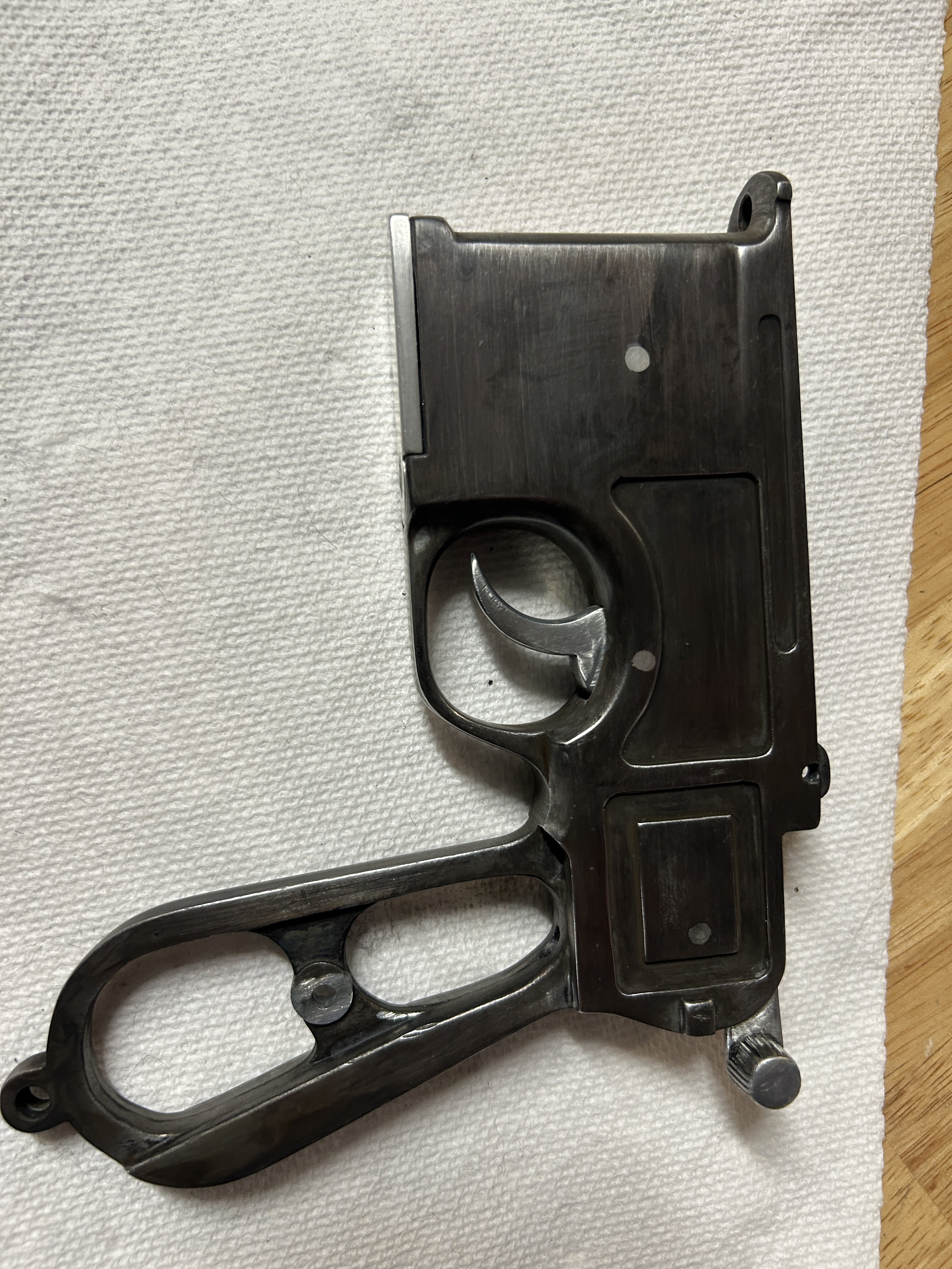

I finished the second coat of super blue on the denix receiver. I’ll let the oil soak in until tomorrow and then start weathering it. And try to paint the aluminum on it that didn’t blue.

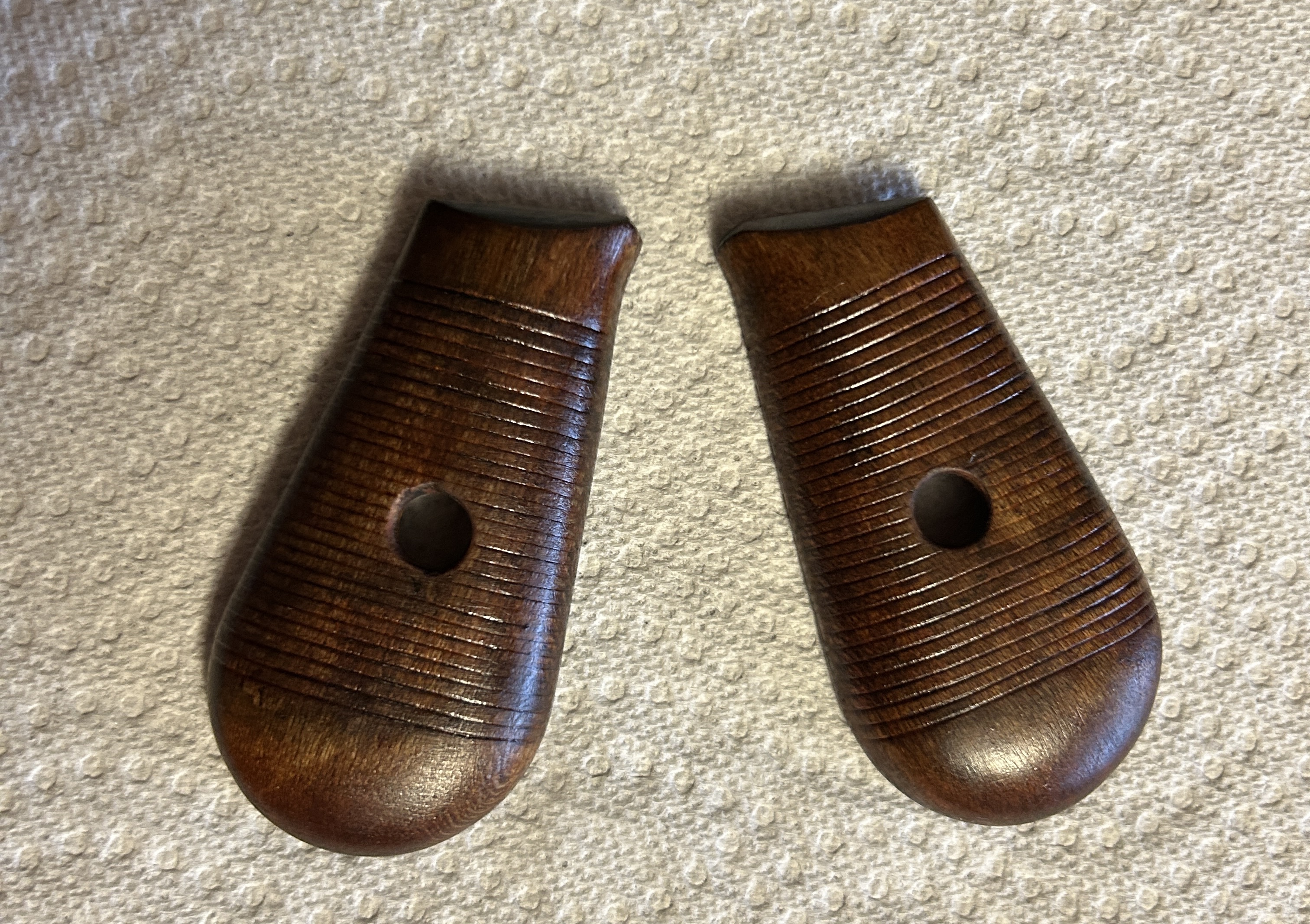

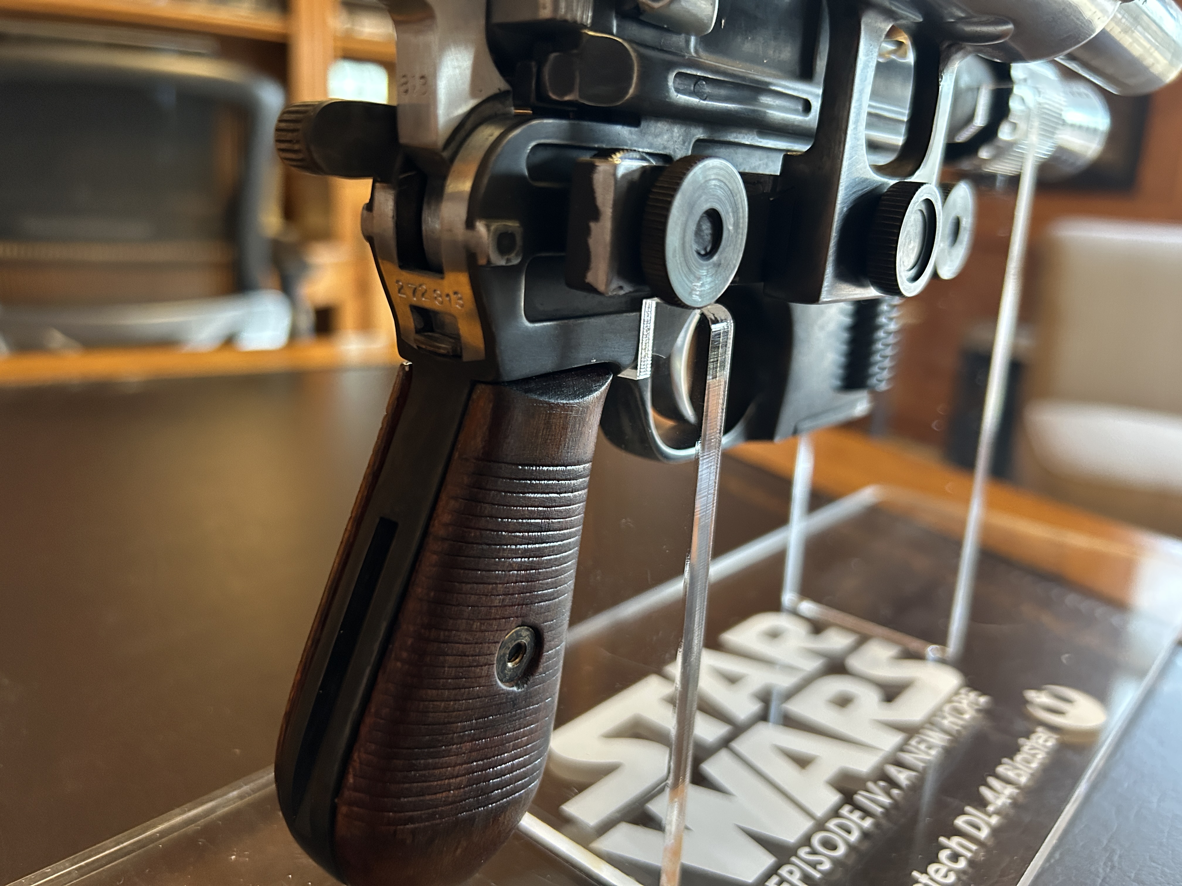

I have been trying different stains with the denix wood grips. Seems like everything (even walnut stain) came out reddish. So I did a wash over the grips and then a semi gloss polyurethane coat. Pretty happy with them now. They look darker in person. Some scraping and sanding and they should look the part.

Everything is starting to come together. The receiver is weathered. The grips have been epoxied on (They moved too much with just the screw holding them). The plugs on the denix pin holes are all painted and close to invisible. The only task left on the main gun is painting the mag plate.

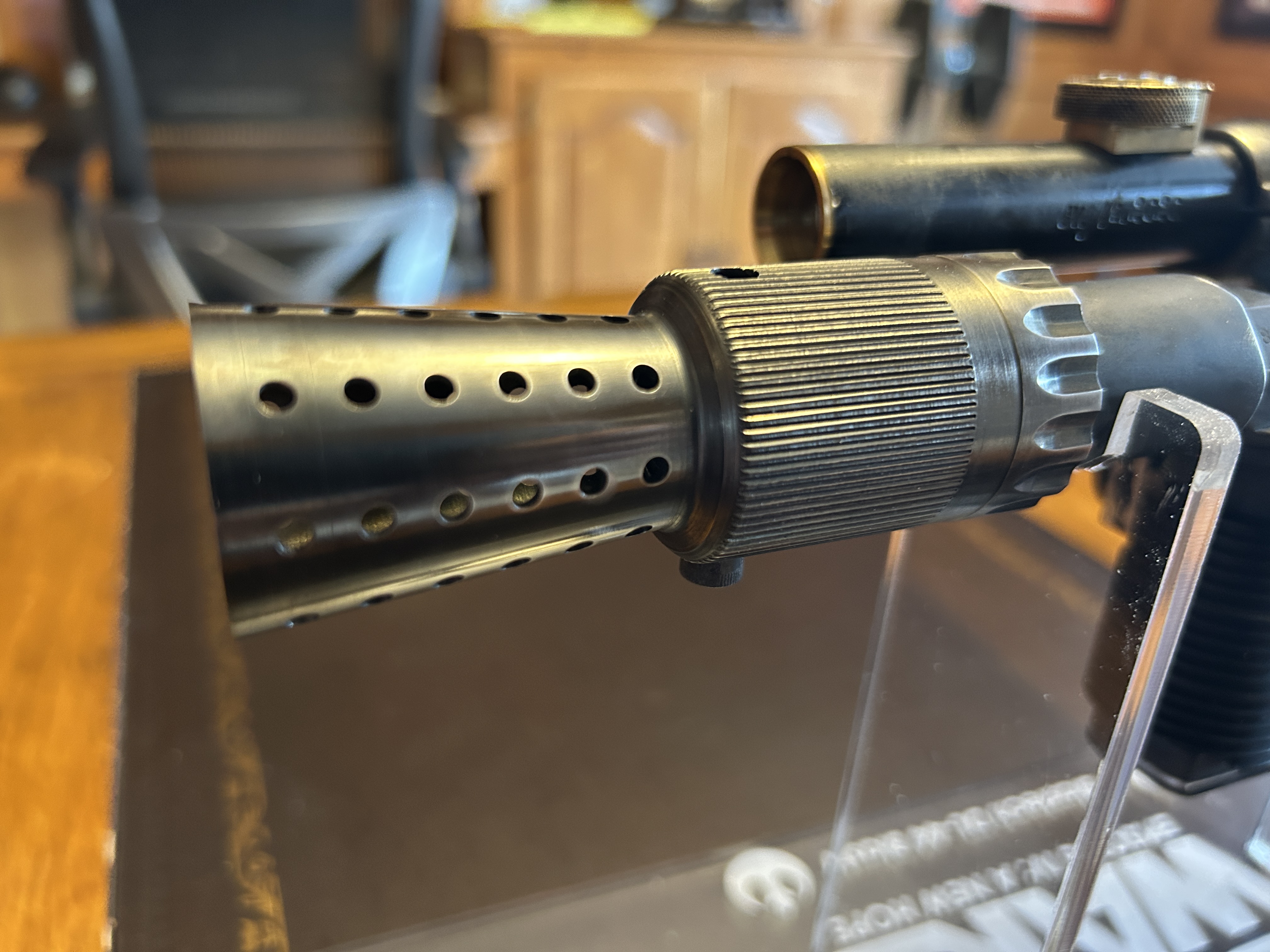

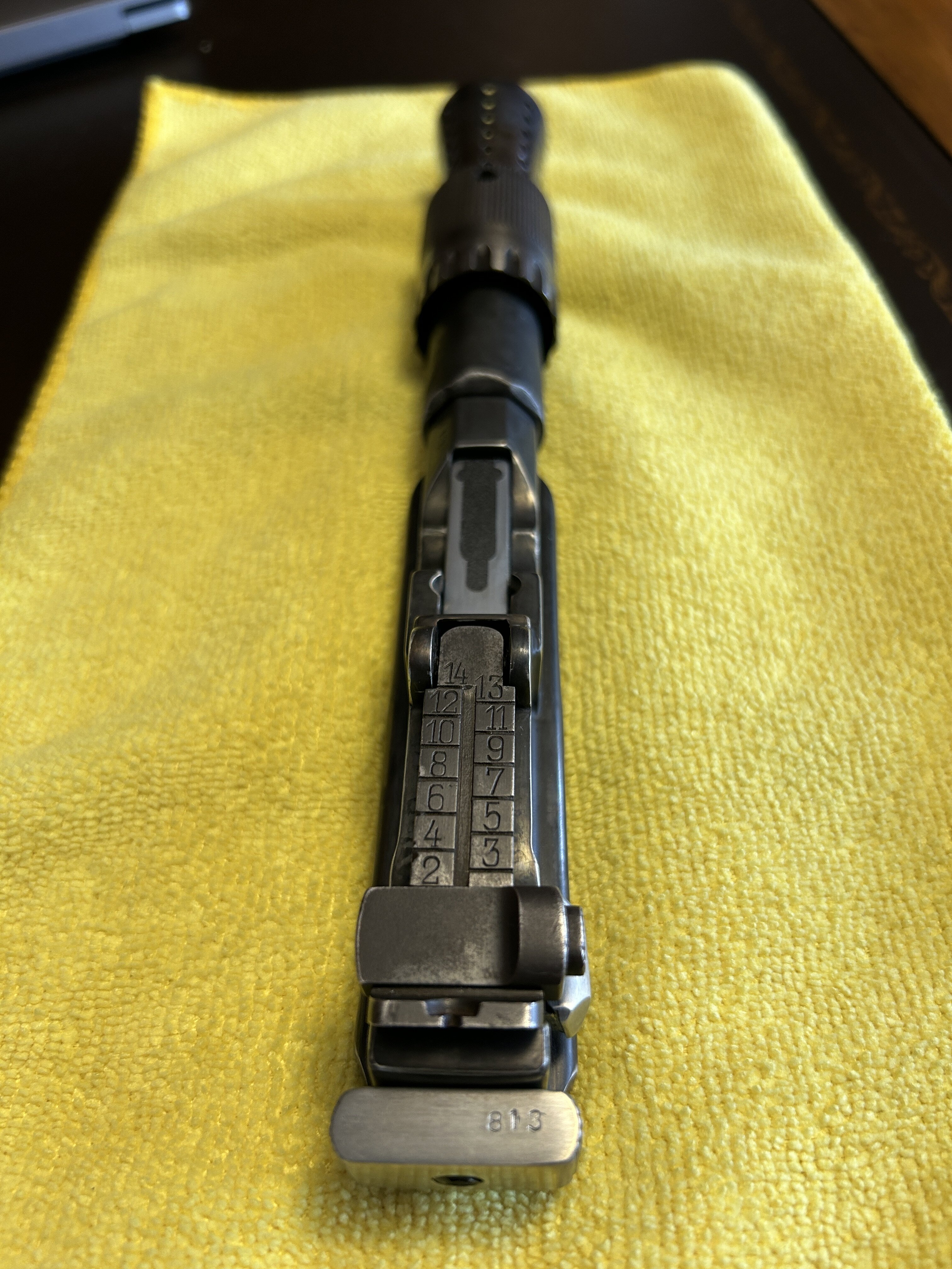

There are still some challenges left with the scope. I need to manually make a paint mask for the aluminum bar. Have to blacken the brass parts. And the biggest challenge: weathering the anodized aluminum scope. I failed with aluminum black. I am hoping to weather it without stripping it.

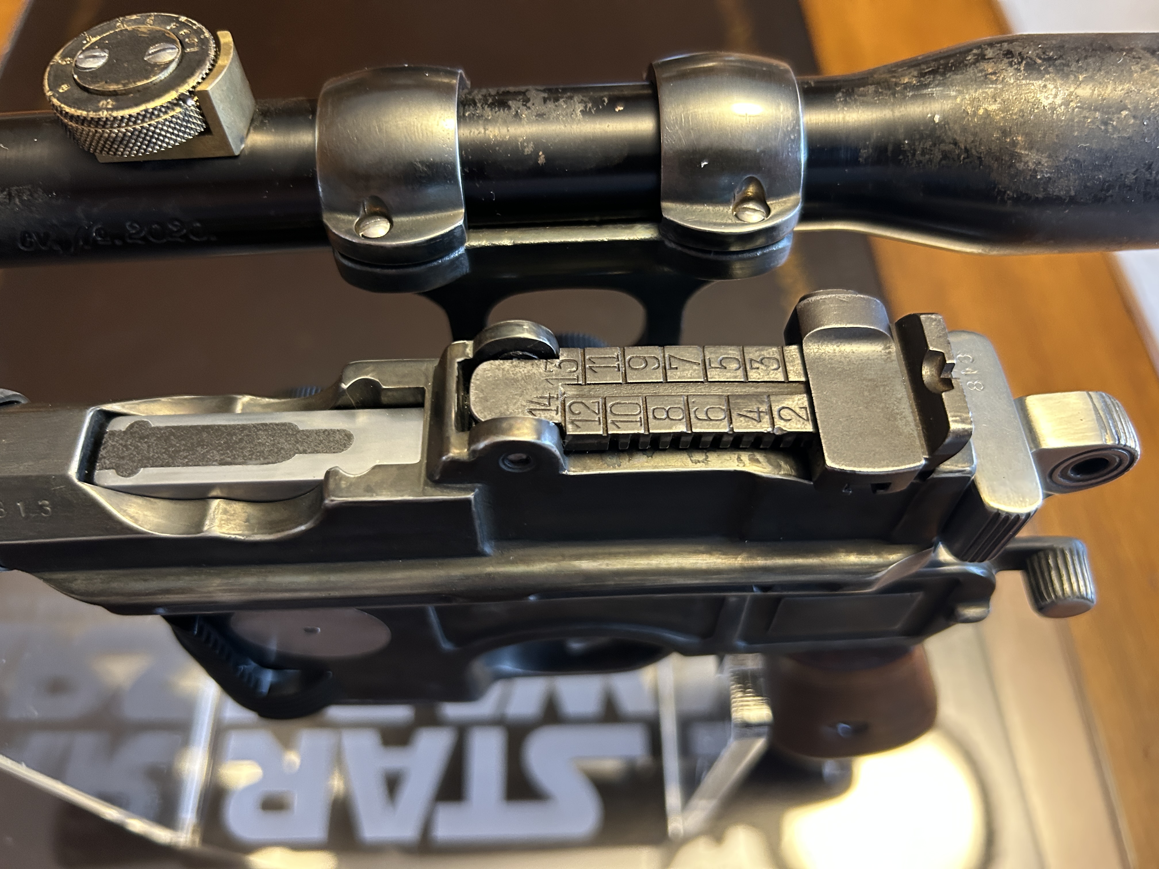

I tore tamiya masking tape for the scope bar using production dl-44 pics as a reference. I painted the bar with Rustoleum high heat enamel. I recommend using this paint. I did some chipping after the paint and it adhered well to the bare aluminum. I used super blue on the scope knurled nuts. Then weathered them with files and sandpaper. Just noticed I need to darken the ends of the scope bolts. The last big task is weathering the brand new looking aluminum scope and brass parts.

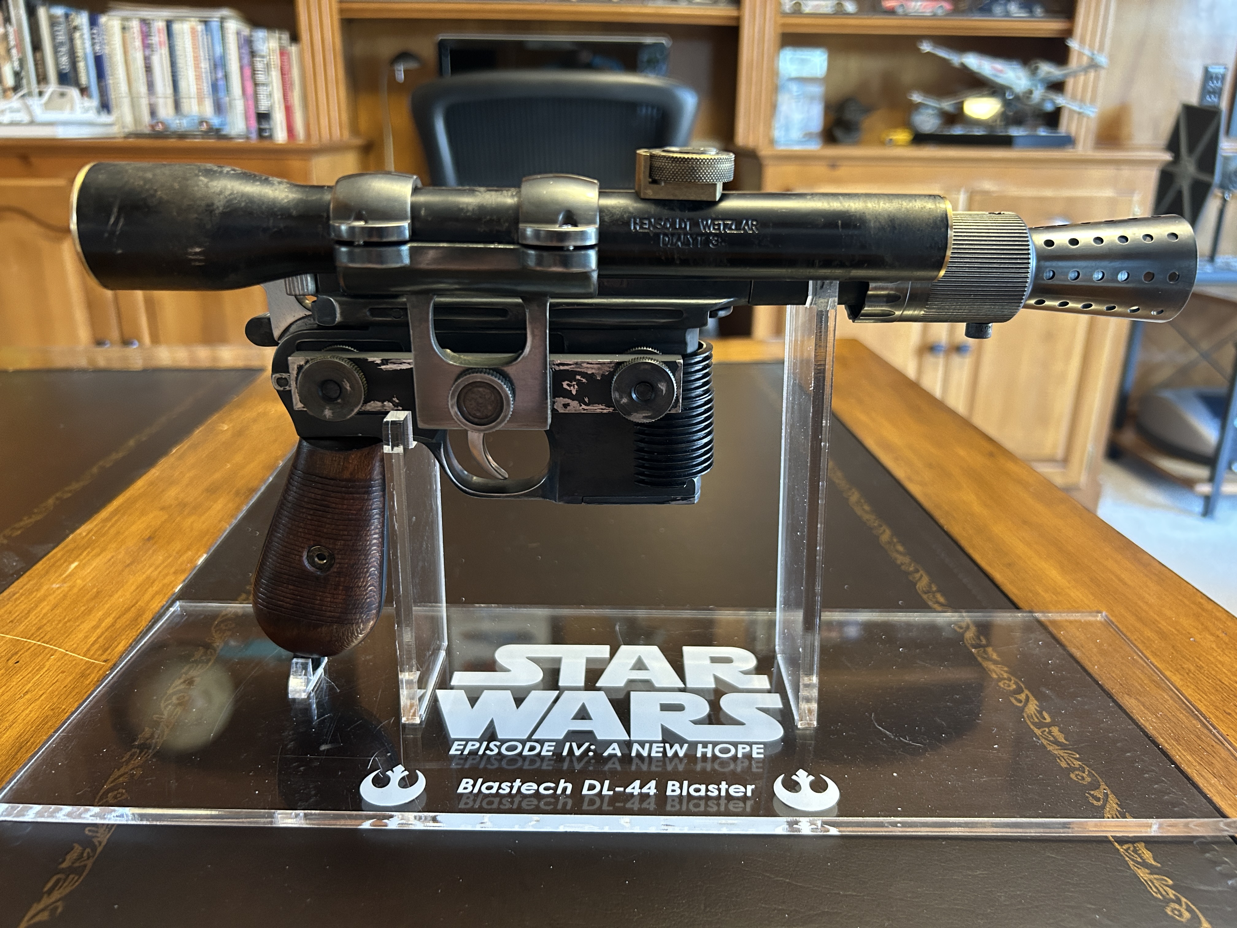

I’m done for tonight. Made the scope crusty and rusty. The last part to work on is the top of the scope dial. Have to decide if I want to spray paint it and chip paint off or just use a black wash on it. The finish line is close

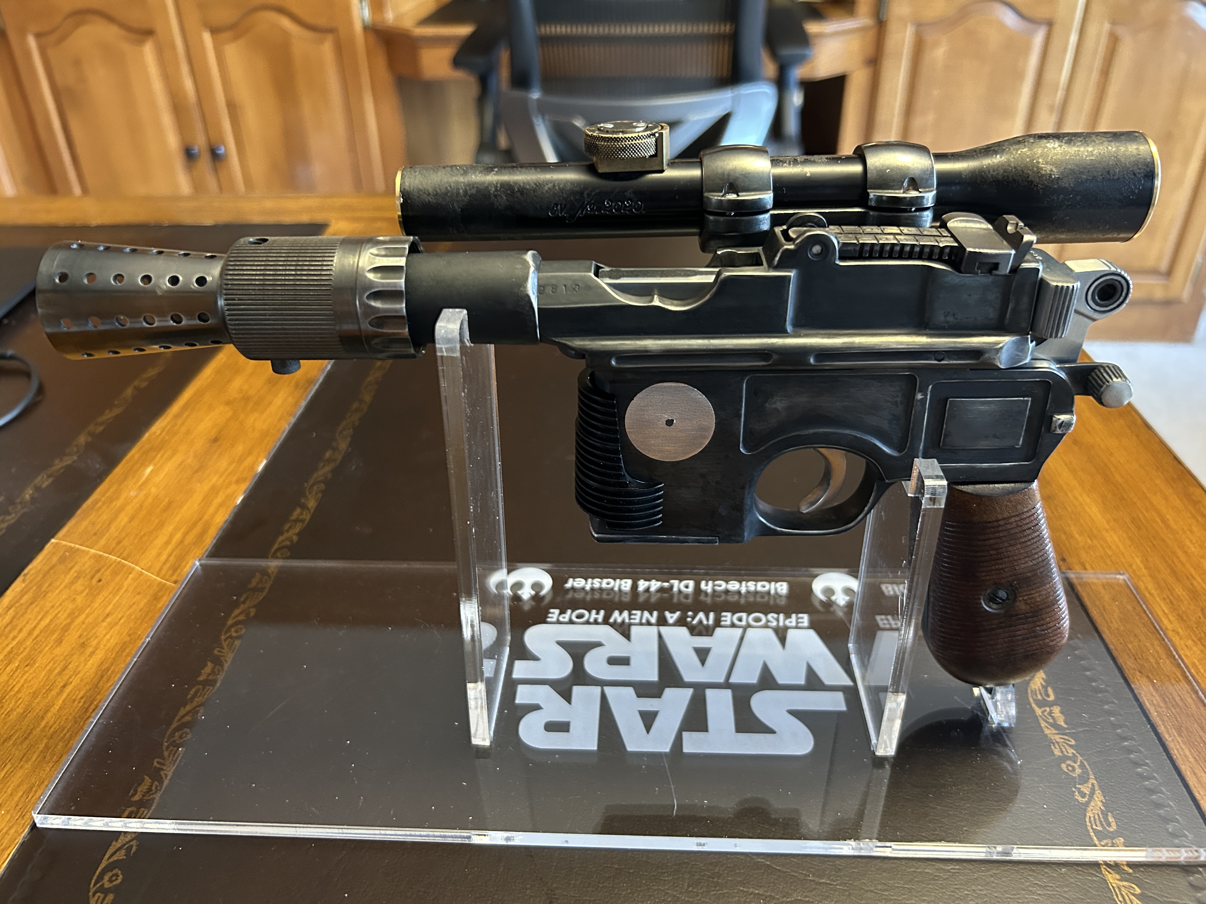

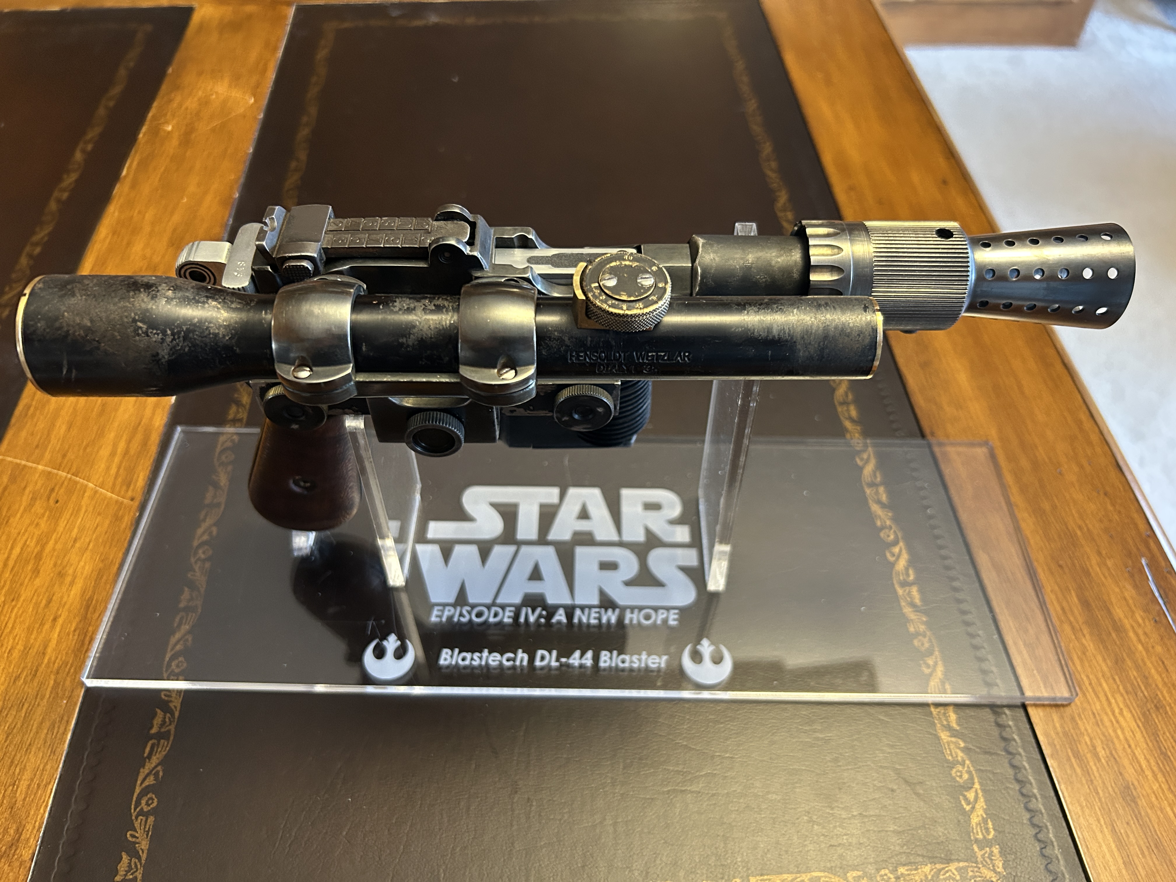

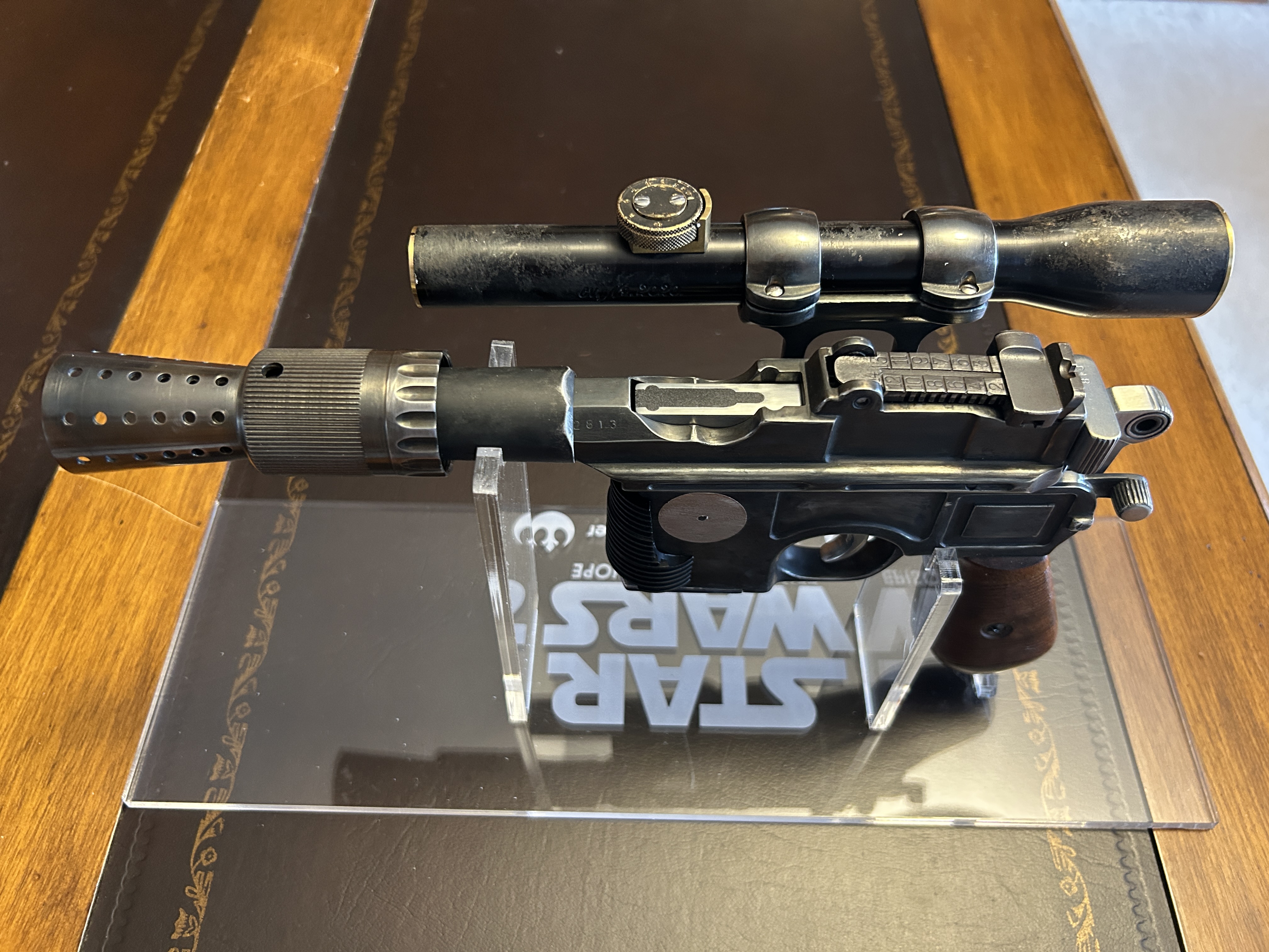

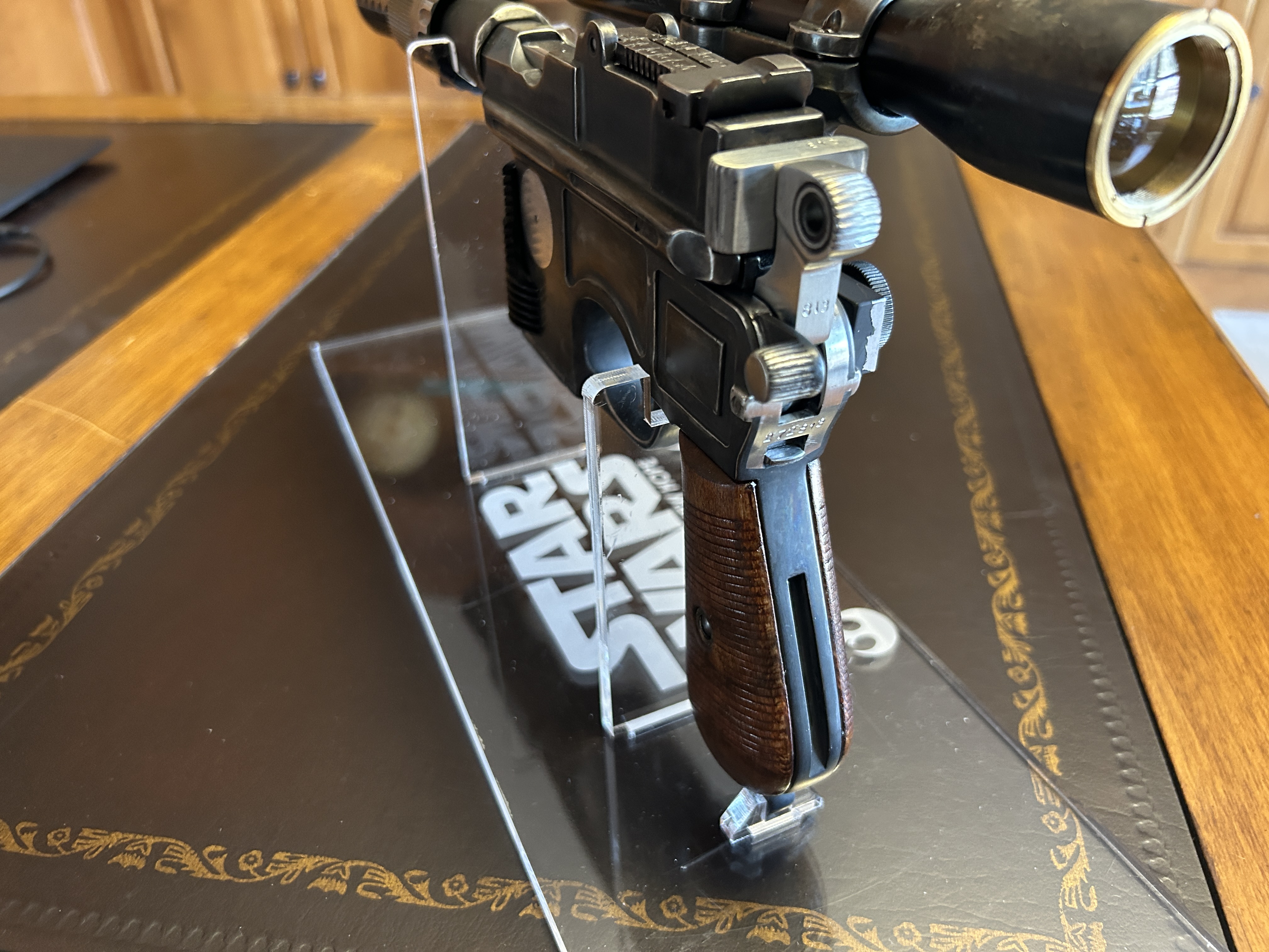

I should have just painted the scope wheel before posting my last message. Two months and two days after receiving the Denix and parts, my Han Solo blaster is complete. Thanks to everyone for the encouragement and all the reference material on the RPF.
I am very pleased with the finished product. If you are thinking about building a Denix based kit, I recommend going for it. The end results are worth it! Tomorrow I’m going to post some pictures of all the tools and supplies I used for any future builders out there.
