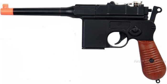

So, this is what i want to get, if i can find one:
and then find a short mag and i'm good to go with a conversion kit?
[h=4]HFC Full Metal WWII Mauser M712 Airsoft Gas Pistol[/h] [h=4]Features:[/h]

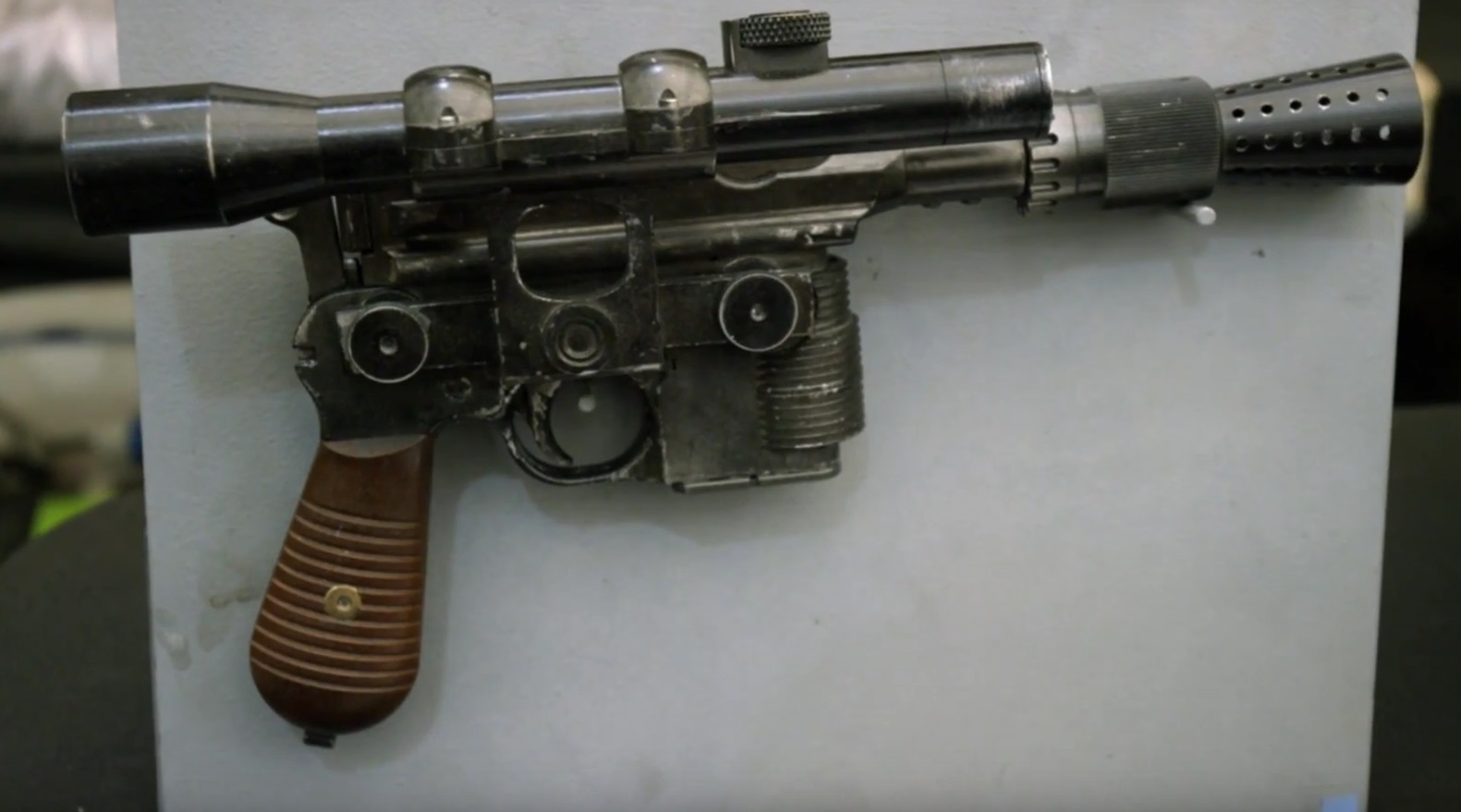

Re: Han Solo Force Awakens Blaster is HFC (and now also a Maurshin) m712 airsoft pist

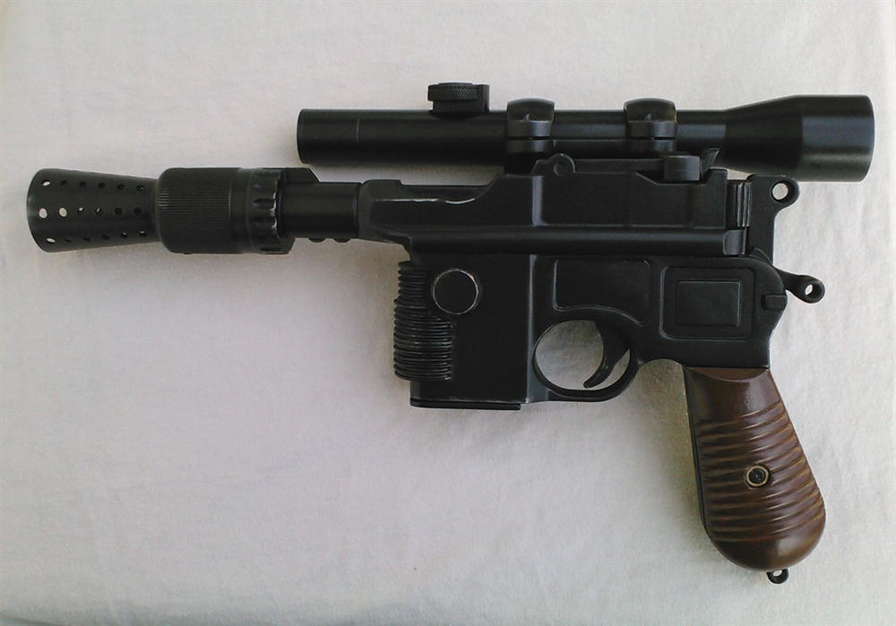

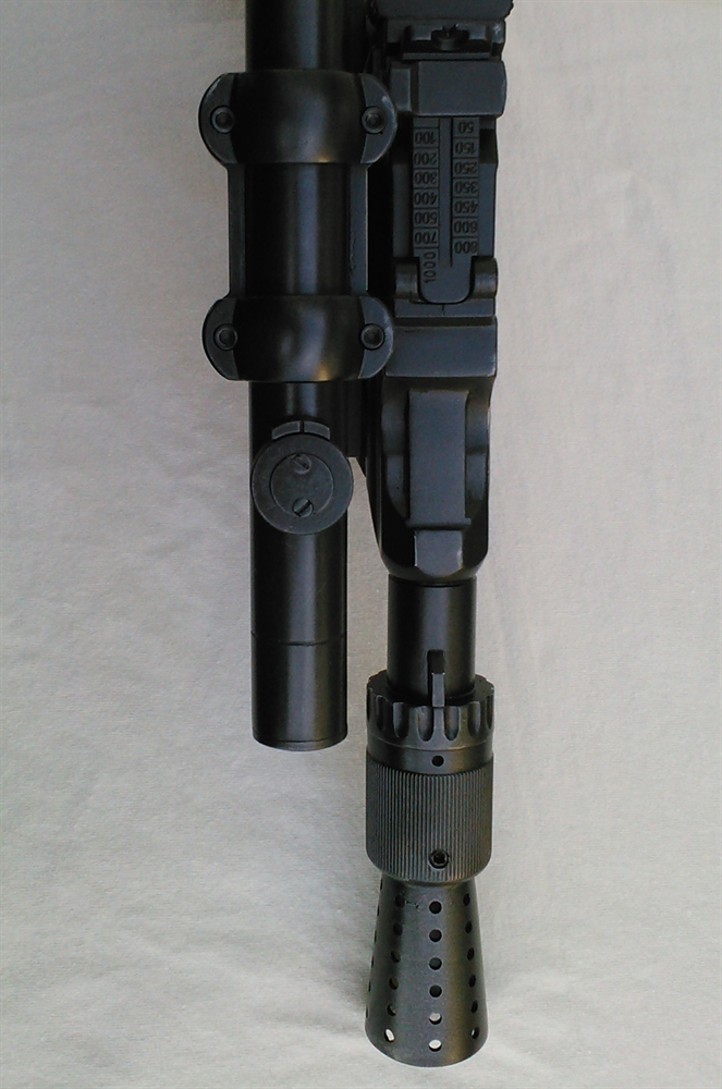

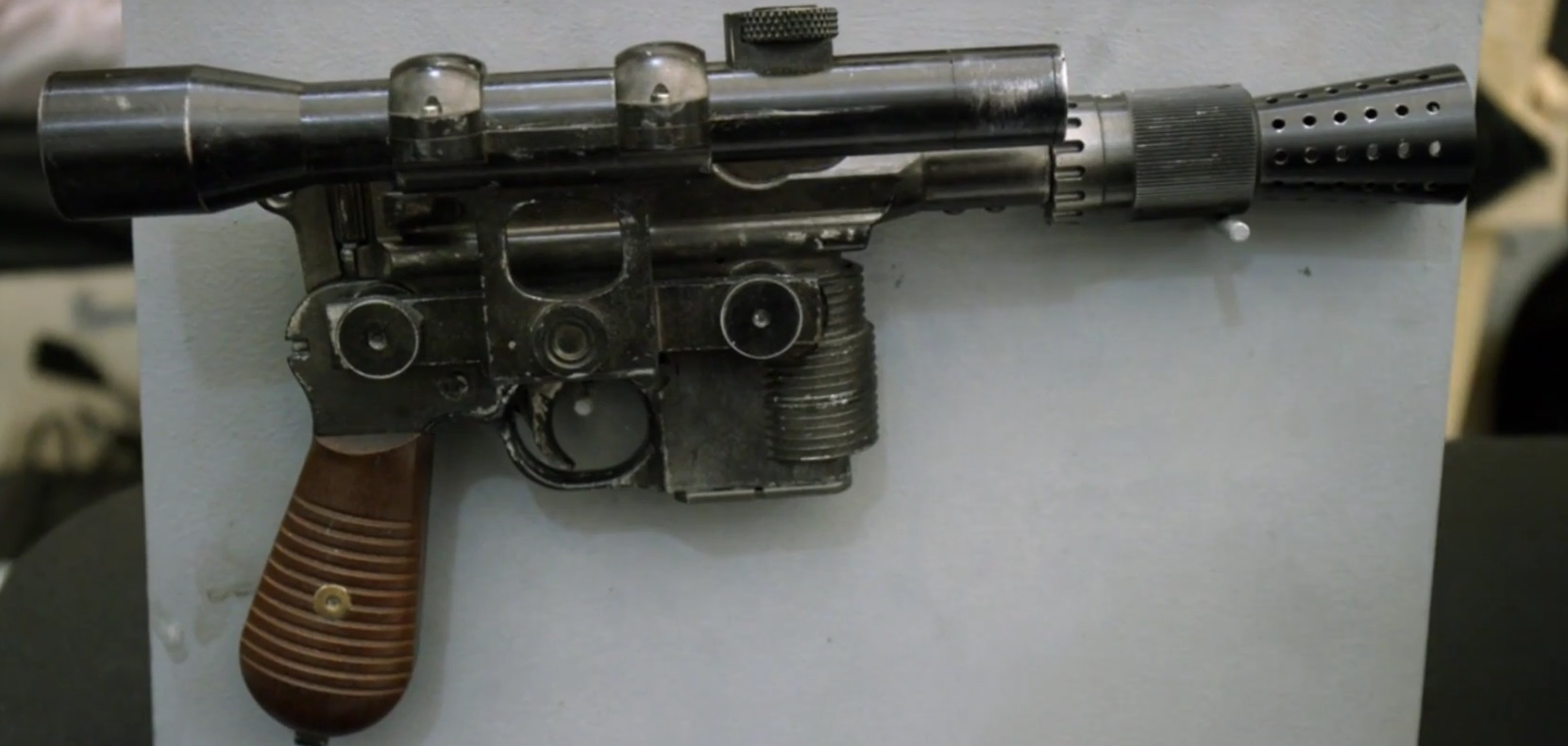

Here's an interesting variant, plus they mirrored the shot.
Weirdo Blaster 2.pngWeirdo Blaster 4.pngWeirdo Blaster 3.pngWeirdo Blaster 1.pngWeirdo Blaster 5.png

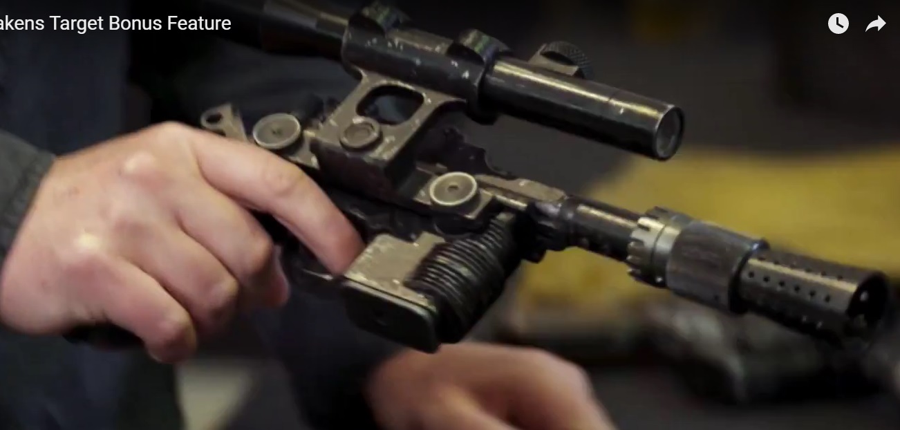

Anyone know what they did for the grips? Looks as if they just airbrushed the ones on there for the stunt but the hero looks like real wood. Any ideas?

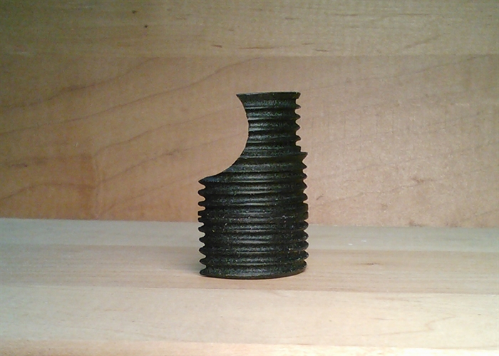

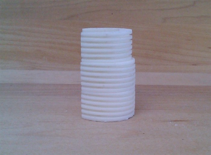

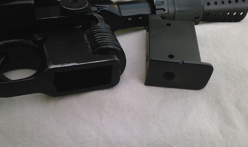

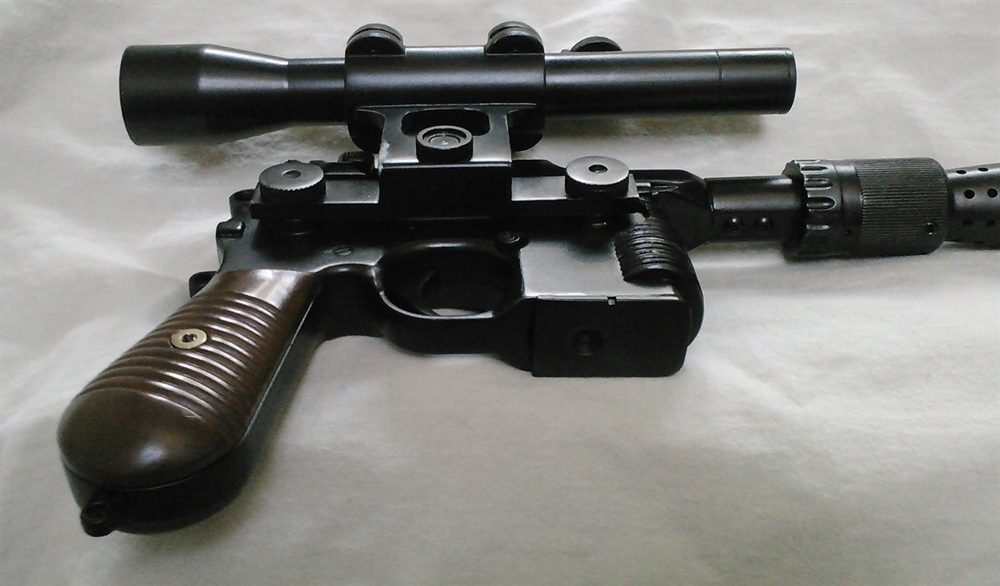

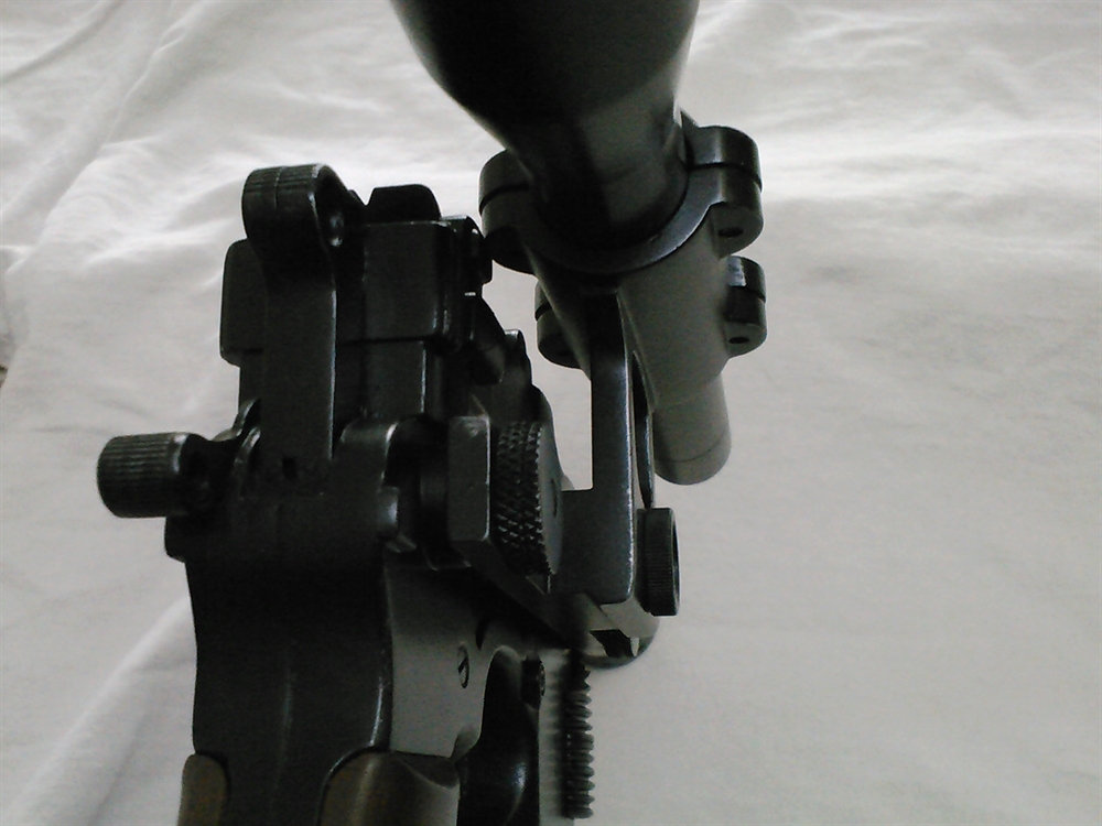

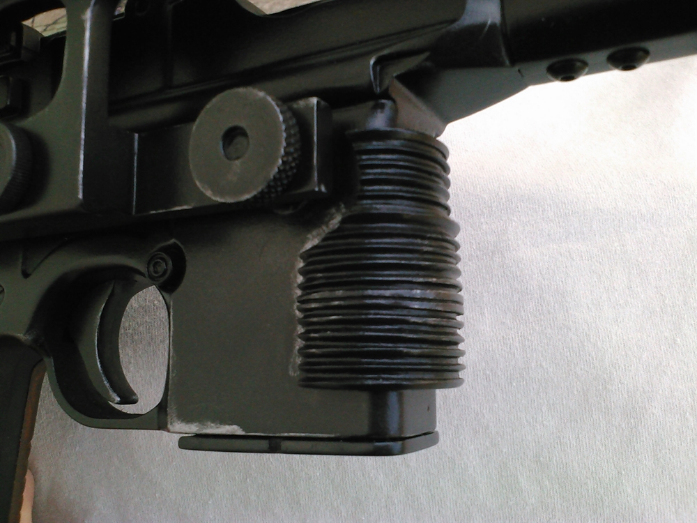

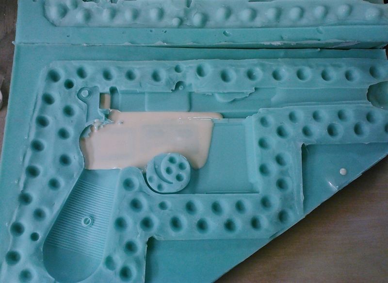

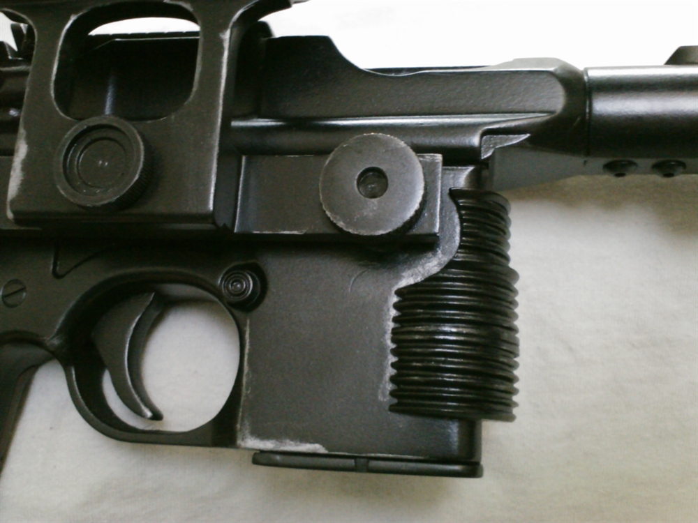

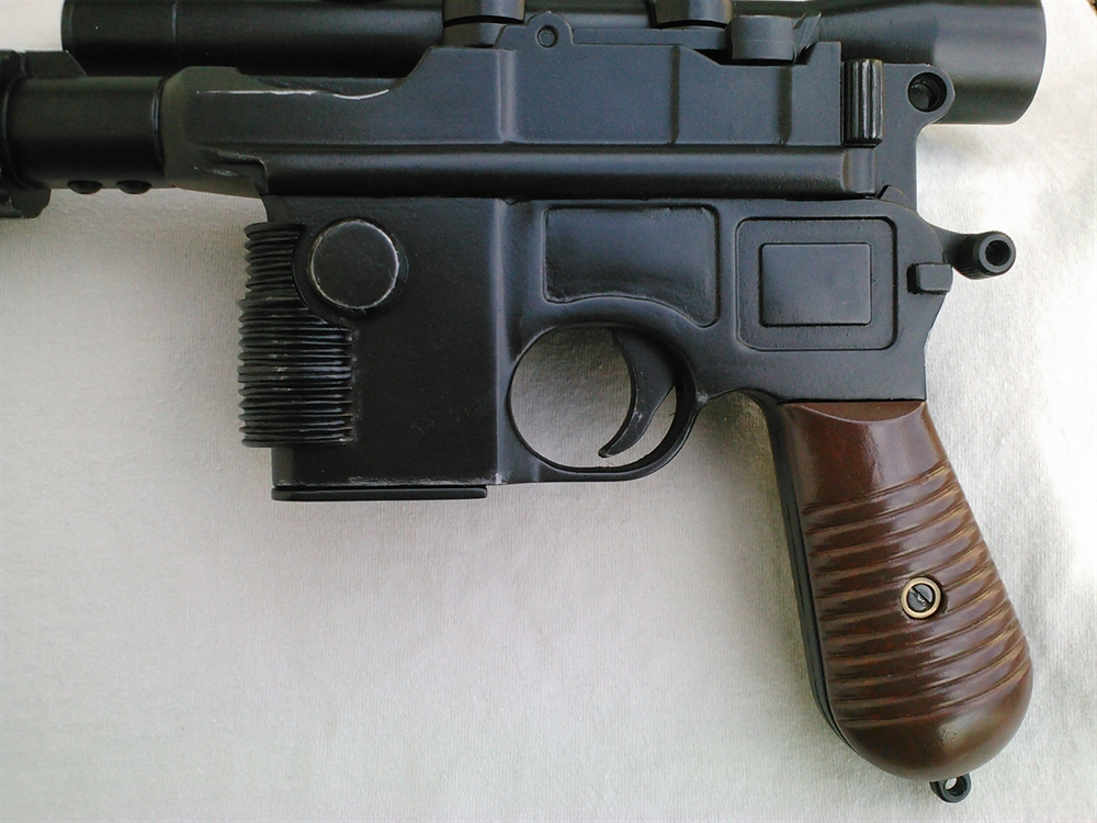

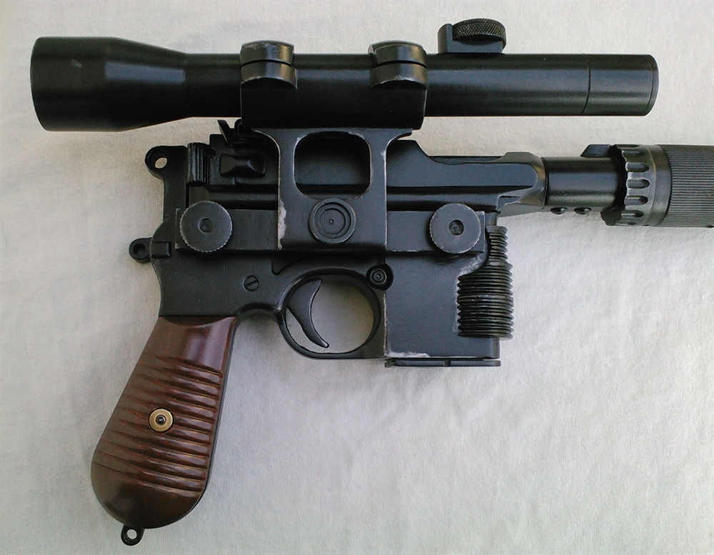

Here's a little something I put together:
attachment.php
Started with one of the cheap 712s off eBay.Some of the proportions are off of course, but it was good practice.
What began as a quick weekend project, ended up taking 3 months of Sundays. :(
I didn't get the pocket above the trigger quite right:
Didn't bother with a working hammer or trigger, but I did manage to keep the mag removable:
Scratch building the grill took a several attempts to get it to look right.

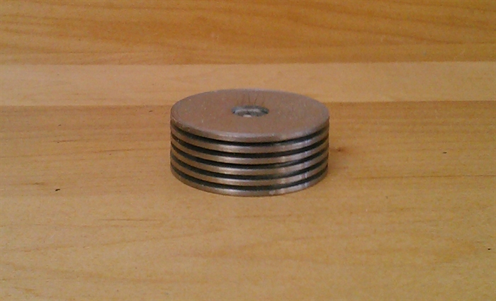

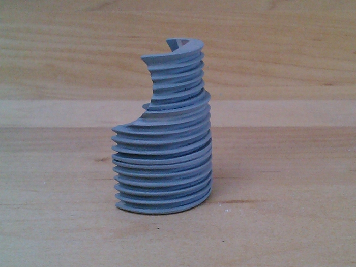

I started by gluing some fender washers, and making a mold and a resin casting of it:
Then cut and shaped the casting to fit the mauser, and made another mold and resin castings:
Stacked/glued 3 castings together:
Then cut it to the final shape:
http://www.therpf.com/attachment.php?attachmentid=607990&d=1459013669
View attachment 608011View attachment 608013View attachment 608012View attachment 608032View attachment 608029View attachment 608030View attachment 608031
View attachment 608025View attachment 608026

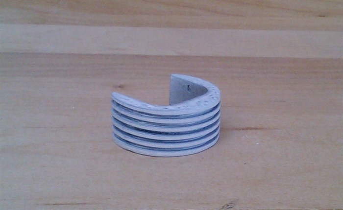

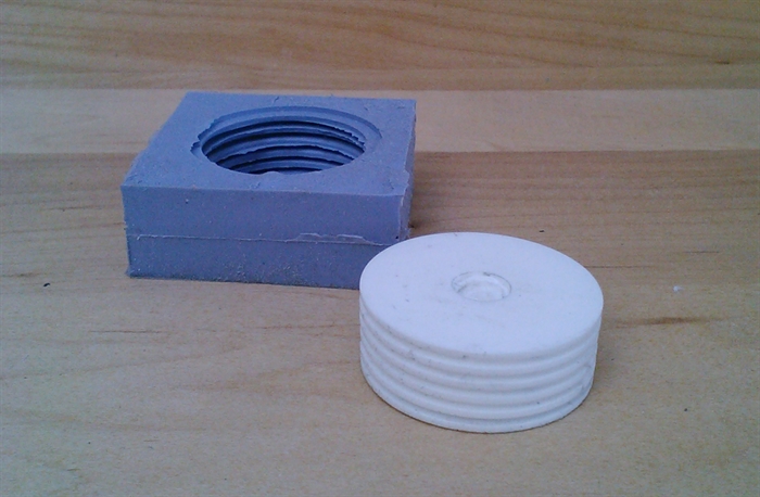

View attachment 608034View attachment 608035

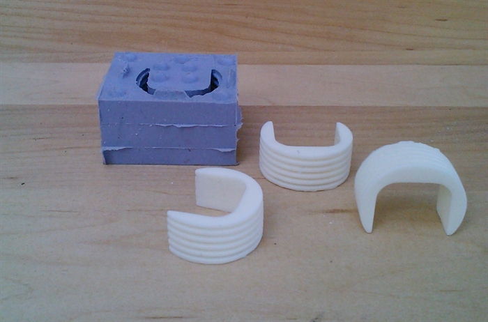

View attachment 608037View attachment 608038

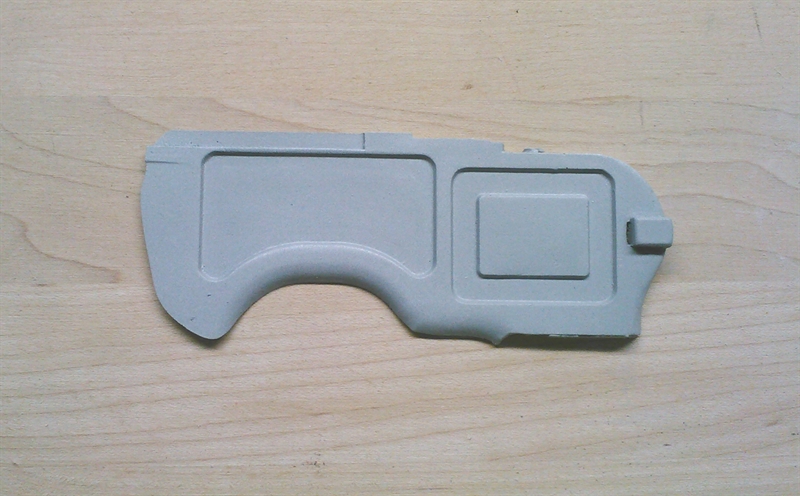

this came out great! how did you fill the selector switch?!
I just grinded down part of the left side and added this section of a resin casting
Huh. Never thought of just covering the side with a casting....

Anybody have any high-res screen-grabs from the digital download? I'm holding out for the blu-ray ...
Yeah the lightsaber thread is full of them but nothing here :(

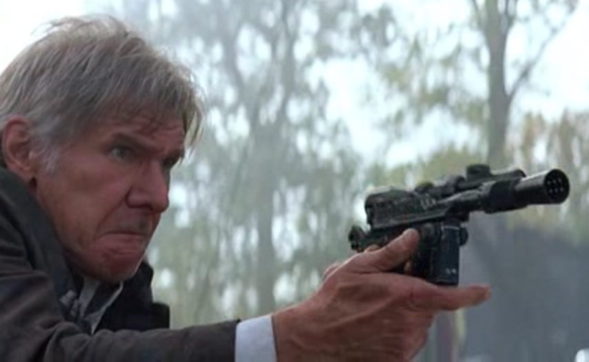

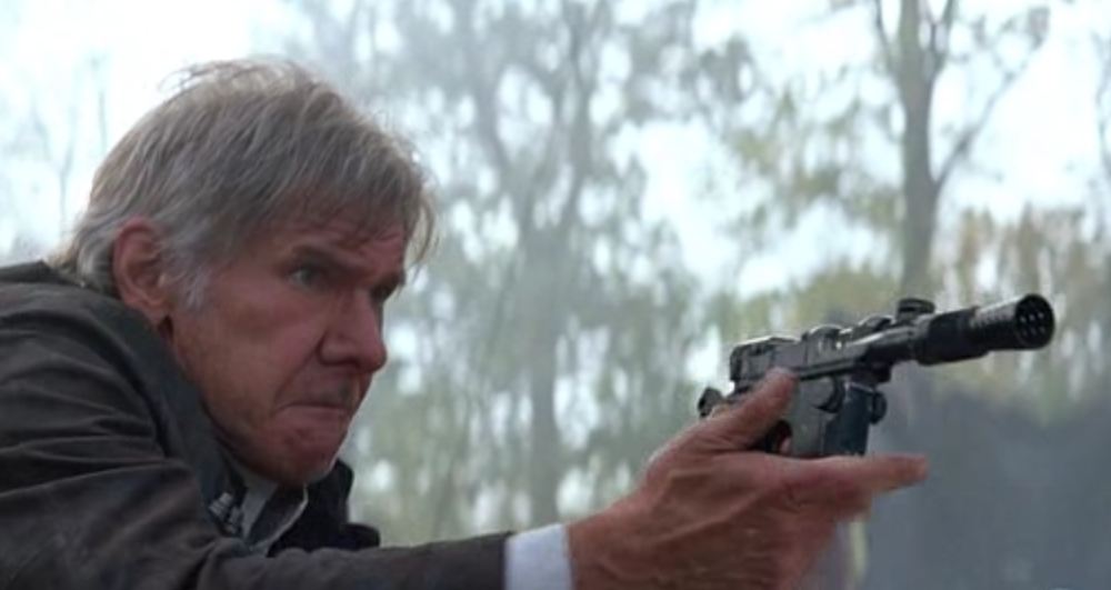

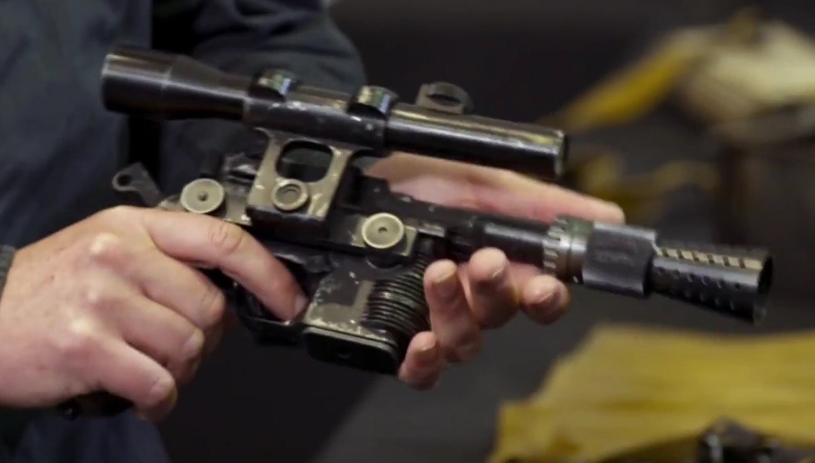

The first one I posted is interesting because it seems to be missing the safety and the small square tabs on the side of the gun. Also, the trigger doesn't look like it's from a HFC, although the mag does.
On the second one. part of me thinks that the hammer doesn't recoil like a functioning gun, but is maybe just stuck into place. The reason I say this is that in a lot of the Starkiller Behind the Scenes shots I saw of Harrison with the gun (where the tip is lighting up red) the hammer is always back as he's firing it. I think they made an electronic version with the hammer always back, and with a light up tip that is activated by pulling the trigger.
