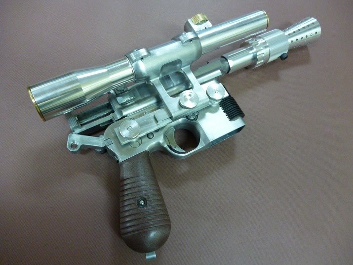

Has anyone tried using a Dark Energy Creations ANH DL-44 kit on an M712 Mauser? I didn't realize I have an M712 Mauser when I bought the ANH kit; am considering selling the kit and buying a TFA kit from DEC since Dave's making those now but if I can make this ANH kit work without a lot of heavy modding I'll probably keep it.
Thoughts?
Re: Han Solo Force Awakens Blaster is HFC (and now also a Maurshin) m712 airsoft pist
Although very similar, there are a few differences in the ANH and TFA blasters. (I assume the makers wanted to have a close resemblance for all but us eagle eyed RPF members.)
Aside from the actual base gun differences including the detachable mag, full auto selector switch and slab side engraved rectangles, there is not much difference.
If if you simply want a nice looking ANH/TFA blaster hybrid, you could fit the ANH parts to the Airsoft.
The bull barrel could be attached with paste epoxy which would help fill the voids and space between the Airsoft and bull barrel.
the Flash Hider attaches to the bull barrel with a thumbscrew.
The scope and mount can attach with 2 part epoxy.
The most work would be with the grill. You would need to file or sand the inside to widen it enough to fit the wider mag well. A dremel would make quick work of it. The latest kits have cast metal grills that file easy.
I think ink there are members here that have used Airsoft base guns and could add build details. Maybe a search would find some links too.
hope this helps.

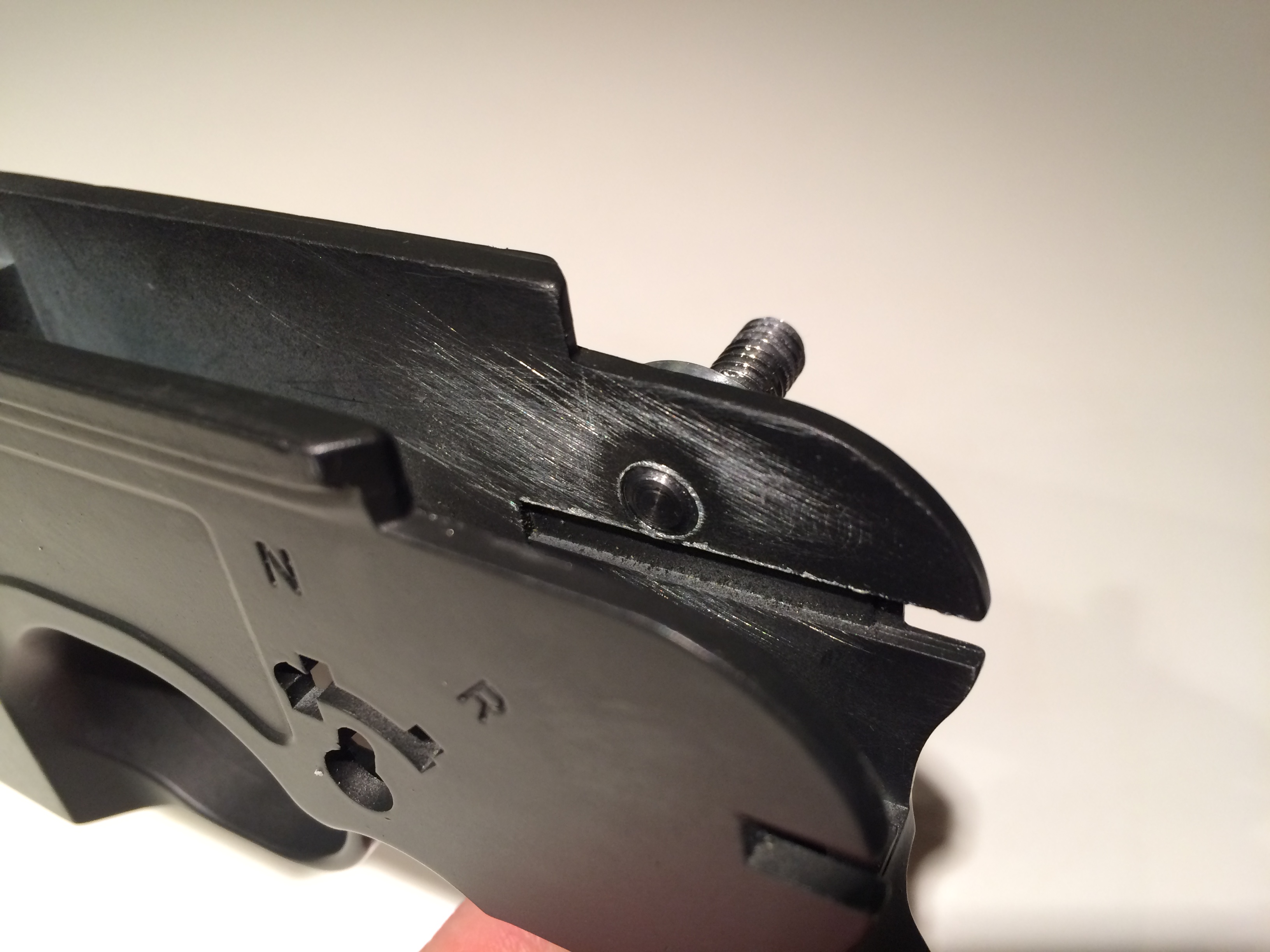

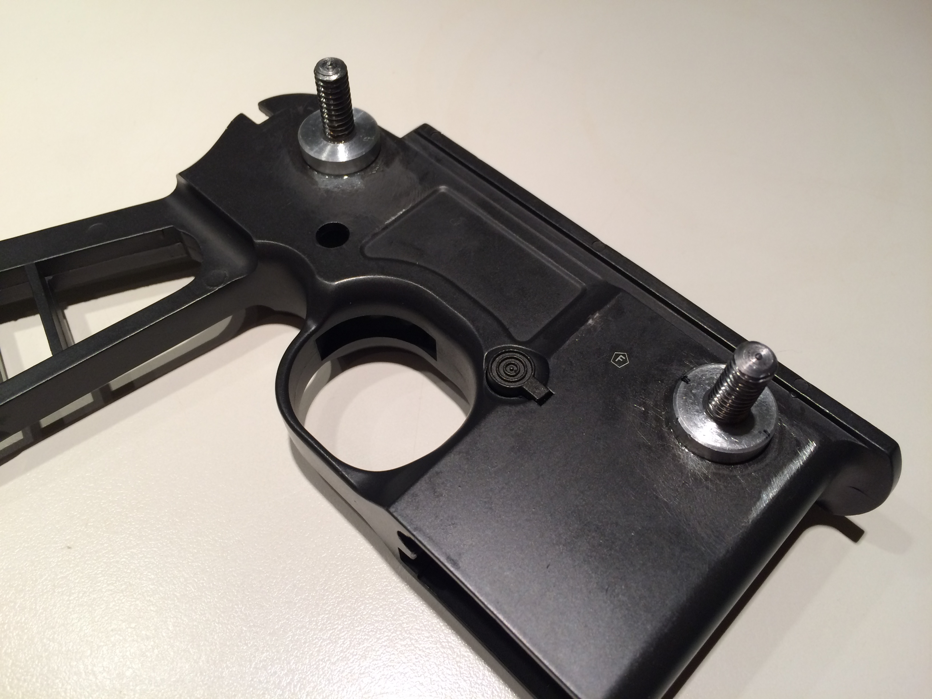

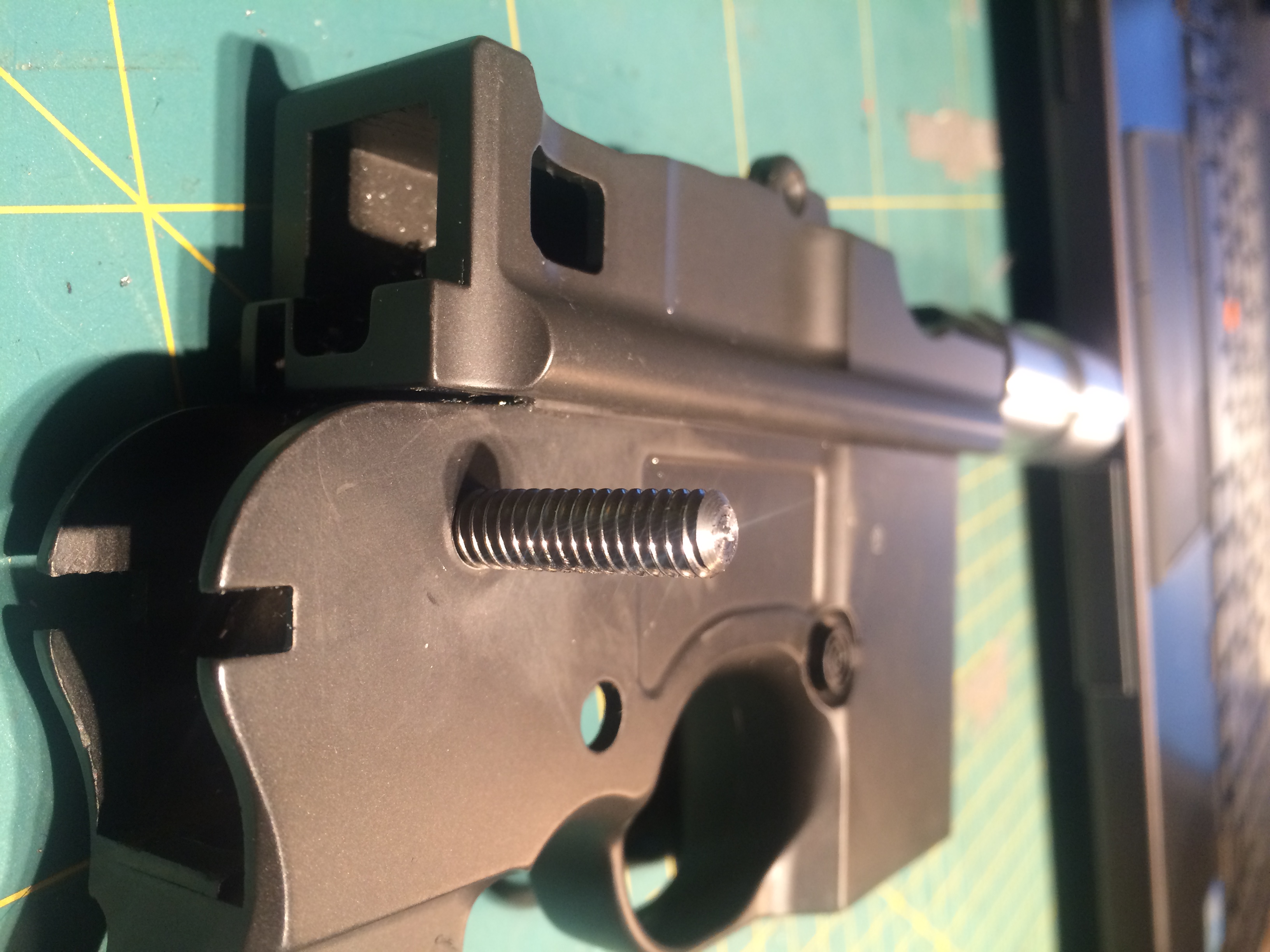

I got the ANH DL44 set from Dark Energy before seeing the TFA prop. So I will just try to make the best of this set and my HFC mauser. Sorry if i'm hijacking this thread - perhaps it's more of an exploring the TFA blaster, than working with the HFC gun thread. I would just like to share how I attached the scope, without killing the inner gun mechanism.
1. Dismaltle the gun totally and remove all of the inner stuff
2. Drill the two holes for the scope bar
3. Use a thread cutter in the holes. The metal is 2mm thick, so there is enough to turn the screws about 3 times.
4. In the hole in the back of the gun you can turn the screw 1/2 mm into the gun, but not anymore. The magazine well has no room at all, so do not turn the screw into the inner.
5. Put epoxy on the screws and turn them into place. Put epoxy on the back of the two caps and the lower part of the screws. This glues the caps to the gun and the screws for extra strenght.
If you use the ANH kit from Dark Energy, the front cap needs to be filed, so the scope bar can run paralell to the gun. This is because the mag well on this gun is wider and has an angle compared to the denix. I just used a file and some patience.
It has cured for 30 hours now, and it seems to be very, very strong, and it does not disturb the inner gun mechanism at all. So I think this might Work. It was strong even without the epoxy. I wanted to avoid silver welding, because my chance of getting it right would be 0%. I have no experience working with epoxy or metal - so any comments would be nice. If it breaks off i'll let you know:) Im considering if i should insert another screw in the middle, just for extra support - there are three caps on the scope bar, so this should be doable.
Edit: I should mention that I wasnt able to get a hold of the 1/4-20 thread cutter that the assembly guidelines from Dark Energy Creations advised, so I used an "M6" cutter. This does not have a perfect fit for the supplied screws, helping them to Lock into the hole - but making alignment a bit tricky.

This helps a lot. Thank you for sharing. If you're going for a 100% TFA blaster I'm pretty sure socket cap screws on the scope mount. It's good to know that the base is drill-able. I've toyed with the idea of drilling into the mag to secure it a bit better. I am not worried about the BB shooting, but I do want the hammer and trigger to work. Again, I appreciate the pics. This puts my mind at ease a bit. I was very skeptical about just epoxying the threaded mounts to the outside of the pistol.
You're welcome. I have testet it a bit, and it is very strong. I will not go for a third bolt - this will do. The HFC has e nice hard shot and a great sound. And this way it will not be a problem to preserve the shooting ability. Just be carefulll when removing the inner barrel and cutting it.

very nice tutorial ! Glad you posted. The TFA kit will assemble the same way.
Glad you find the mount very strong and sturdy. As long as the metal parts are clean and de-greased, the epoxy is better than trying to soldier zinc to steel. zinc melts at a much lower temp.

I will post in the TFA interest thread also. I agree - you should be very carefull cleaning and de-greasing before epoxying. I dont know about the denix gun, but airtsoft guns are usually a bit oily. I cleaned the gun and sanded it where i used epoxy. I also sanded the two "spacers" on the back side, where they glued to the gun.

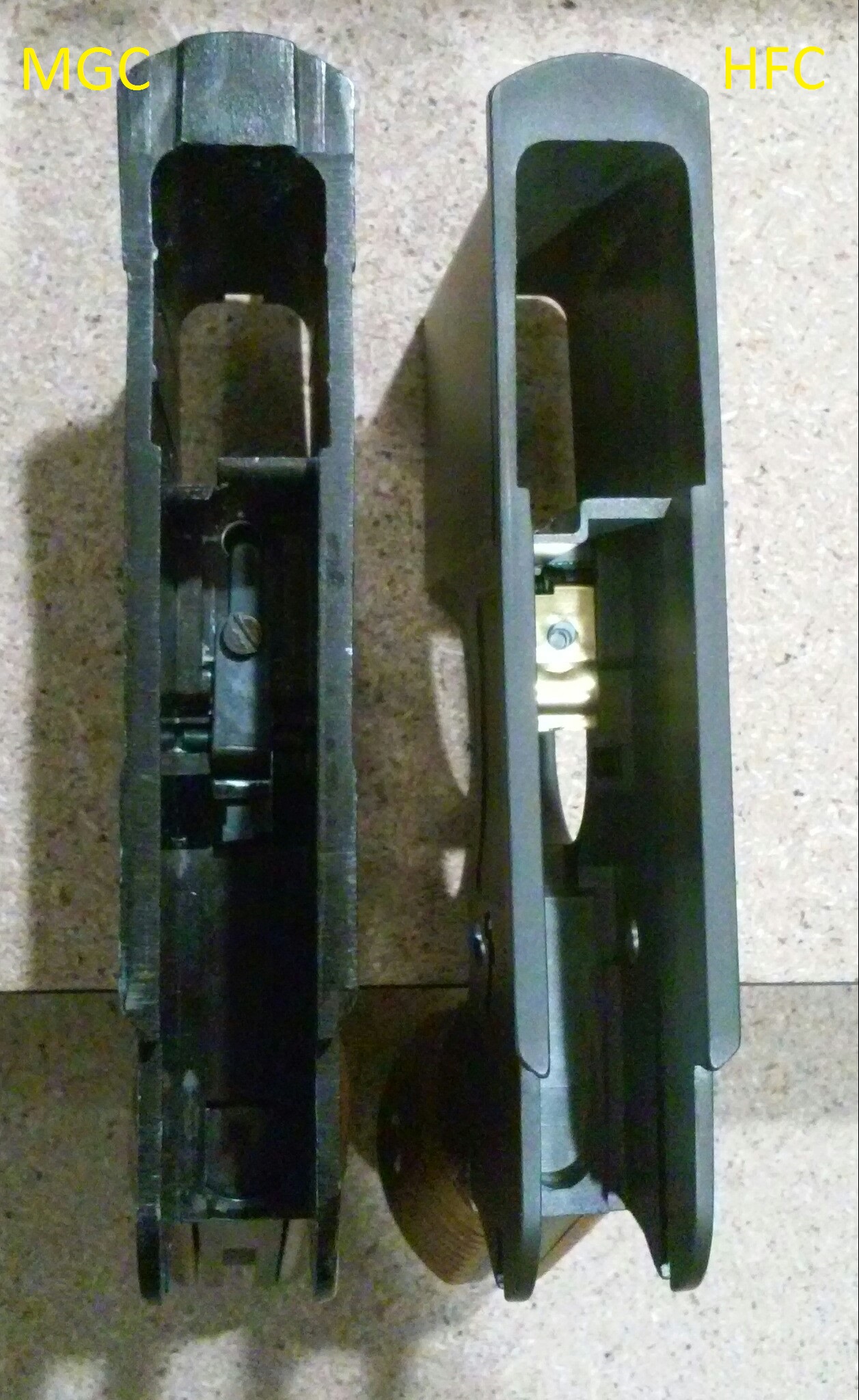

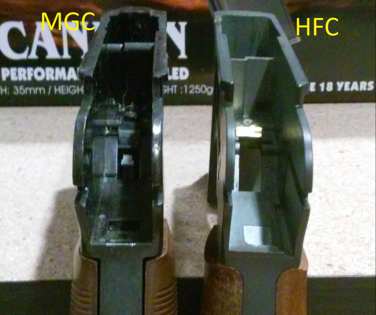

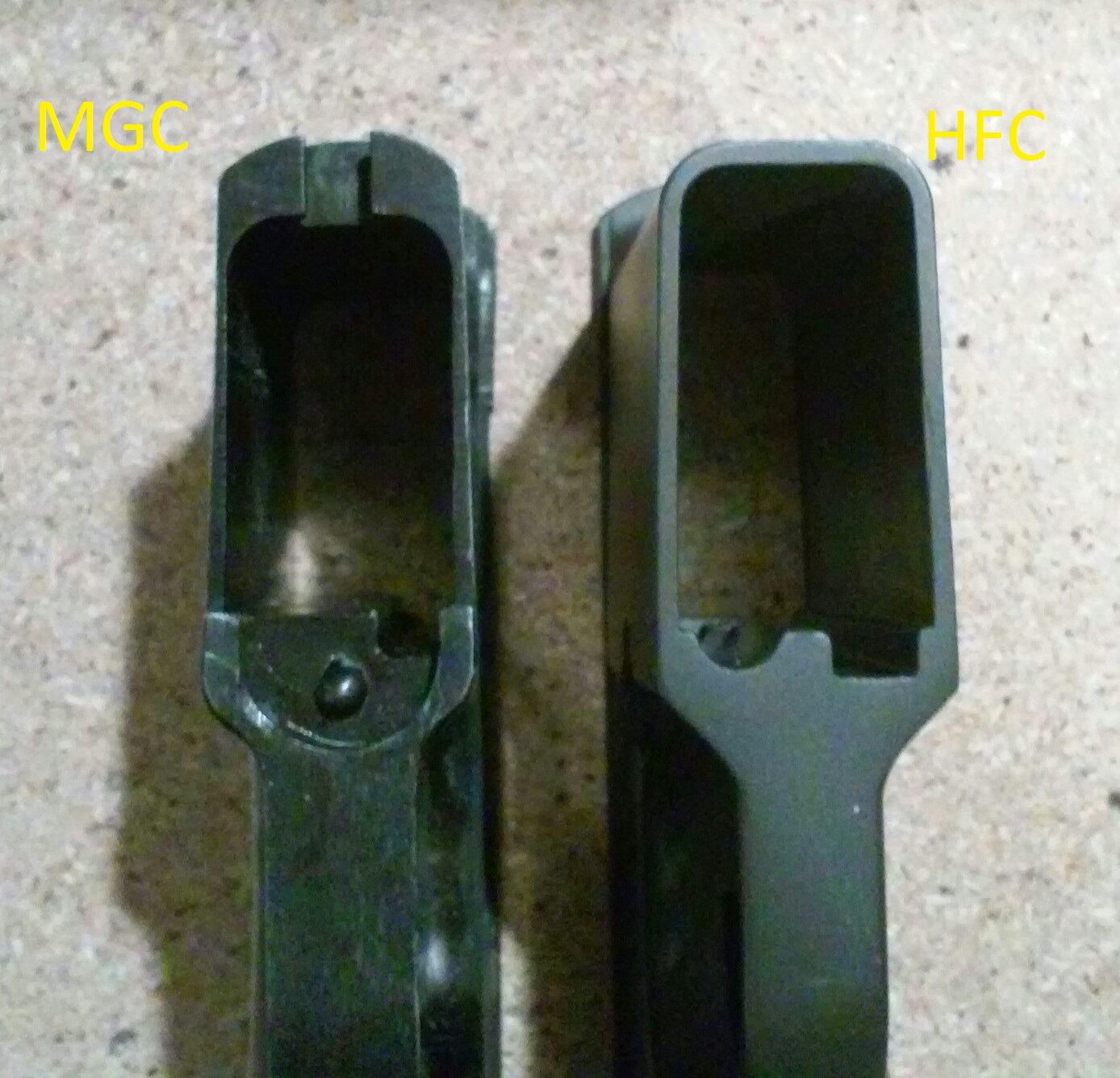

Here's some comparison pics of an MGC and the HFC of the wall thickness.
I think there's enough metal there to tap a few threads, plus having the spacers threaded AND using epoxy, it should be sturdy enough.

Very oily. Seems like they used Vaseline.
View attachment 585154View attachment 585153View attachment 585152
Good info! Looks like there will be plenty of room to tap the HFC and retain functionality. Nice!
