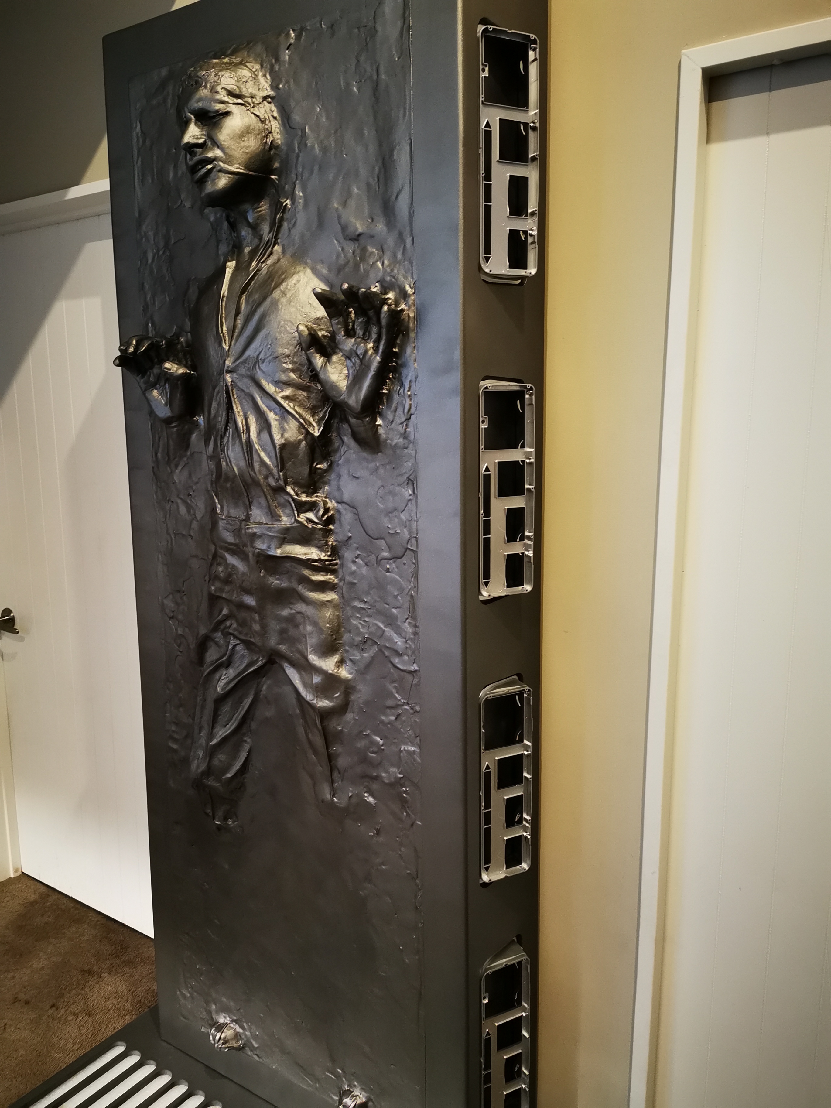

Volvo Panels painted and they are looking sweet. I plan on mounting them with Neodynium magnets so they are easy to remove for storage/moving.
Panels are reproduction in ABS from Todd Blatt
Paint is Rust-Oleum Metallic Aluminium 2X Ultra Cover
That does mean I will try and shoehorn all of the electronics for the hero panels into one panel, more to come on that.

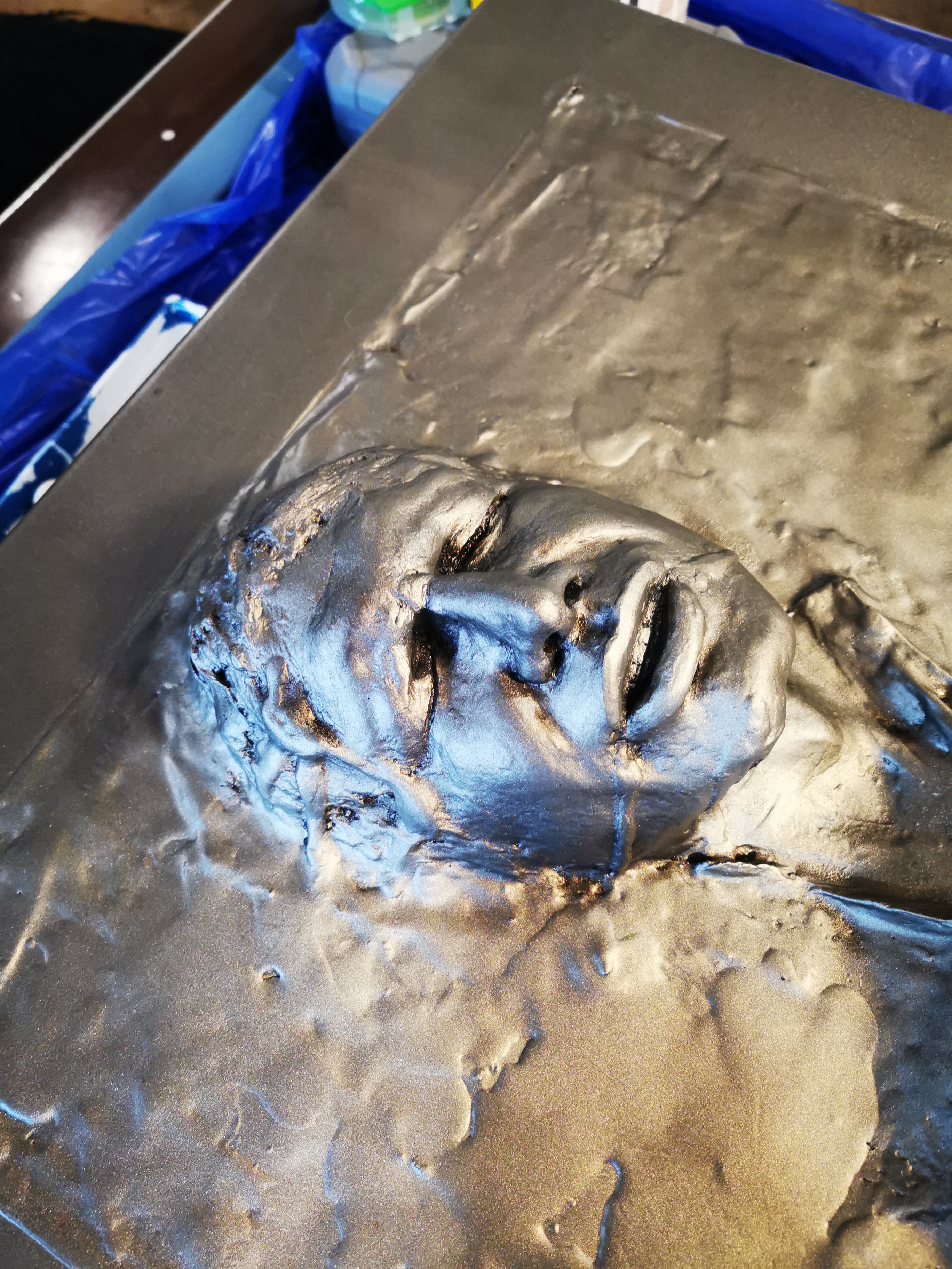

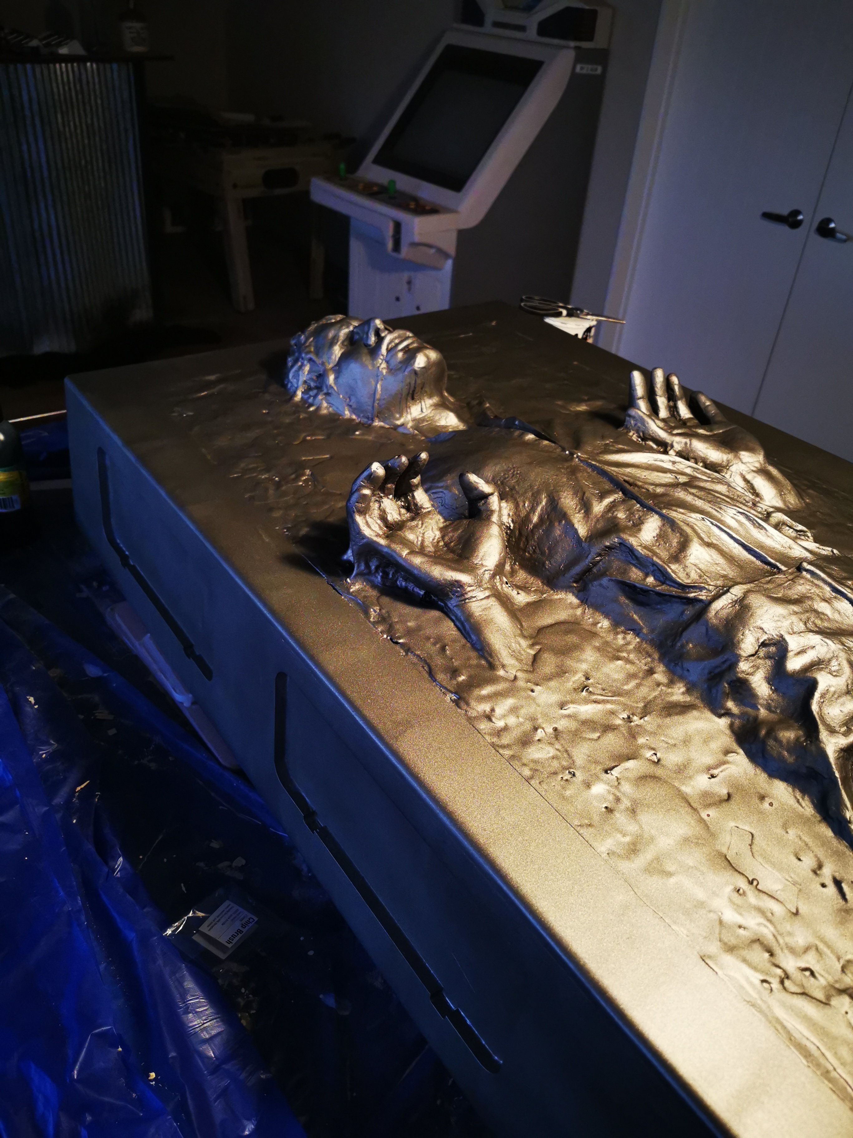

Finally had good enough weather to lay down my first coat of paint - I know its been debated, but I decided to go for a solid color block, so the whole thing is Rust-oleum Flat Antique Nickel. Its how I remember it from the movies, so I'm happy with the choice.
A little patchy in places, but i'll see how it dries and then add another coat, and possibly a third if Im not happy with that as well.

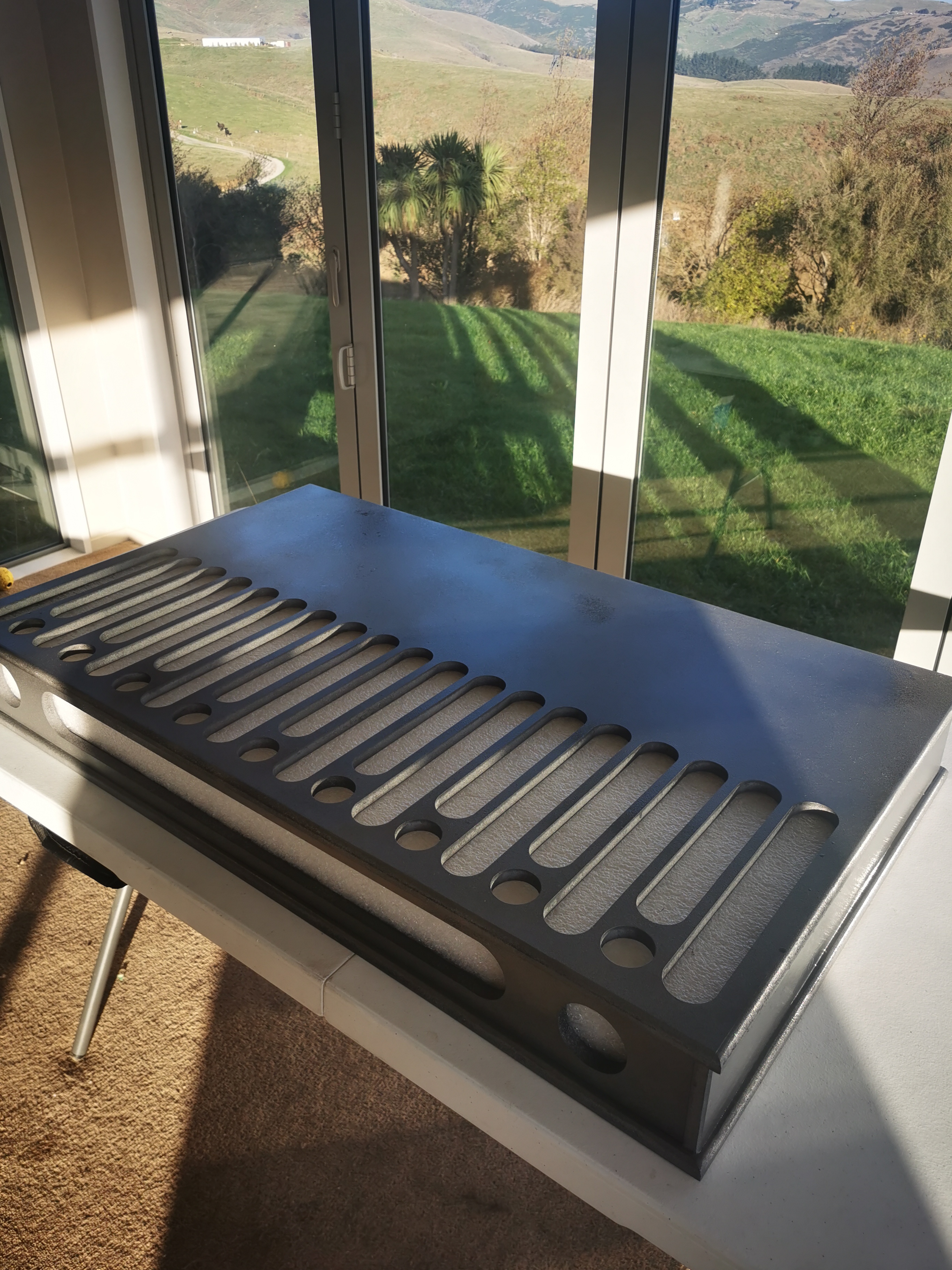

Busy Weekend - managed to paint the base as well, and insert/glue the diffuser plastic.
Now just waiting on an 5m RGB LED Strip, that I can program with an Arduino to simulate the hot lava underfloor, and the base will be complete.
Will upload scripts and instructions here as well as a video once its completed.

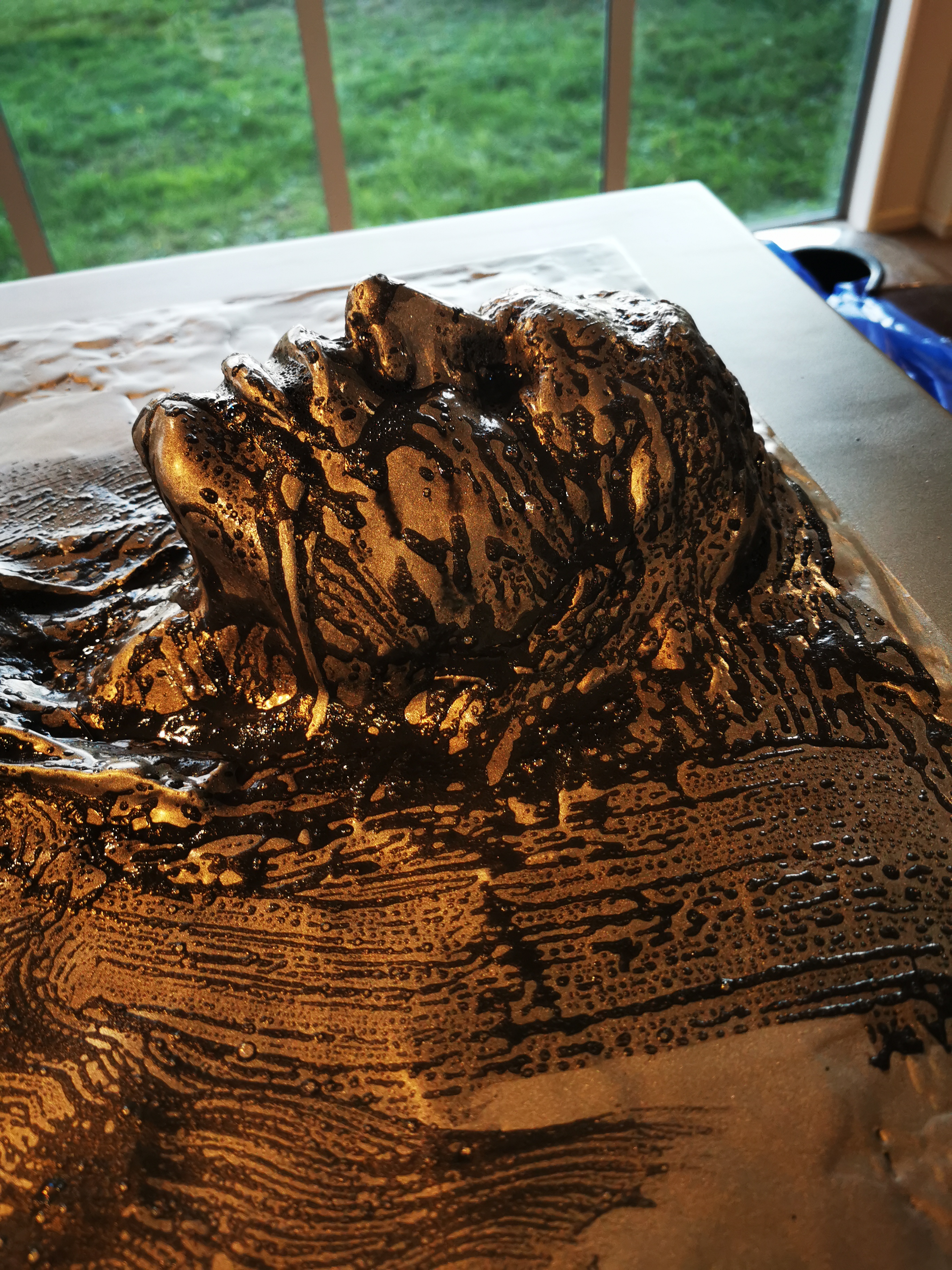

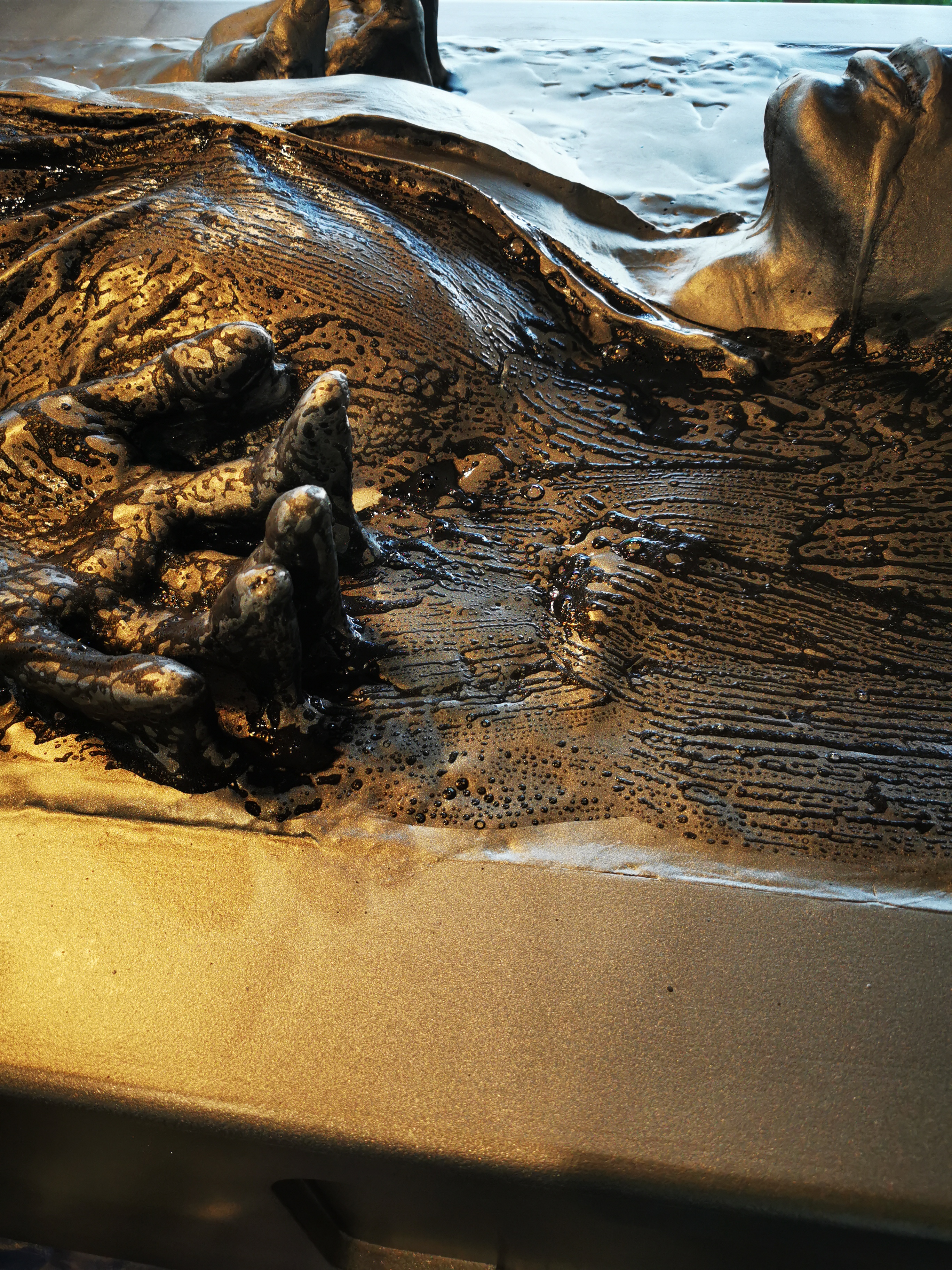

Ok Time for a bit of dirt - was pretty hard starting this considering i thought it already looked pretty good.
Dark Wash 1 part acrylic 5 parts water with a small squirt of Dishwash liquid.
Painted on quite heavily - let it dry for about 5 mins and then wiped off loosely with a damp rag, went over some areas a bit more to clean up, as was really wanting it quite subtle.
Will possibly add another wash as is pretty faint.

To make the panels easy to clip on and off, I ended up using Neodymium Rare earth magnets.
These are about 4.5mm Diameter, 3mm Deep
I then placed the panels in position and marked where the holes are onto the box - then drilled with a 4.5mm drill bit
then a bit of epoxy and slid each magnet into the holes - make sure you keep the polarity the same for each one makes things easier long term.
I then inserted the magnets - once again the correct polarity, into each of the panels - its a tight fit so no glue is needed

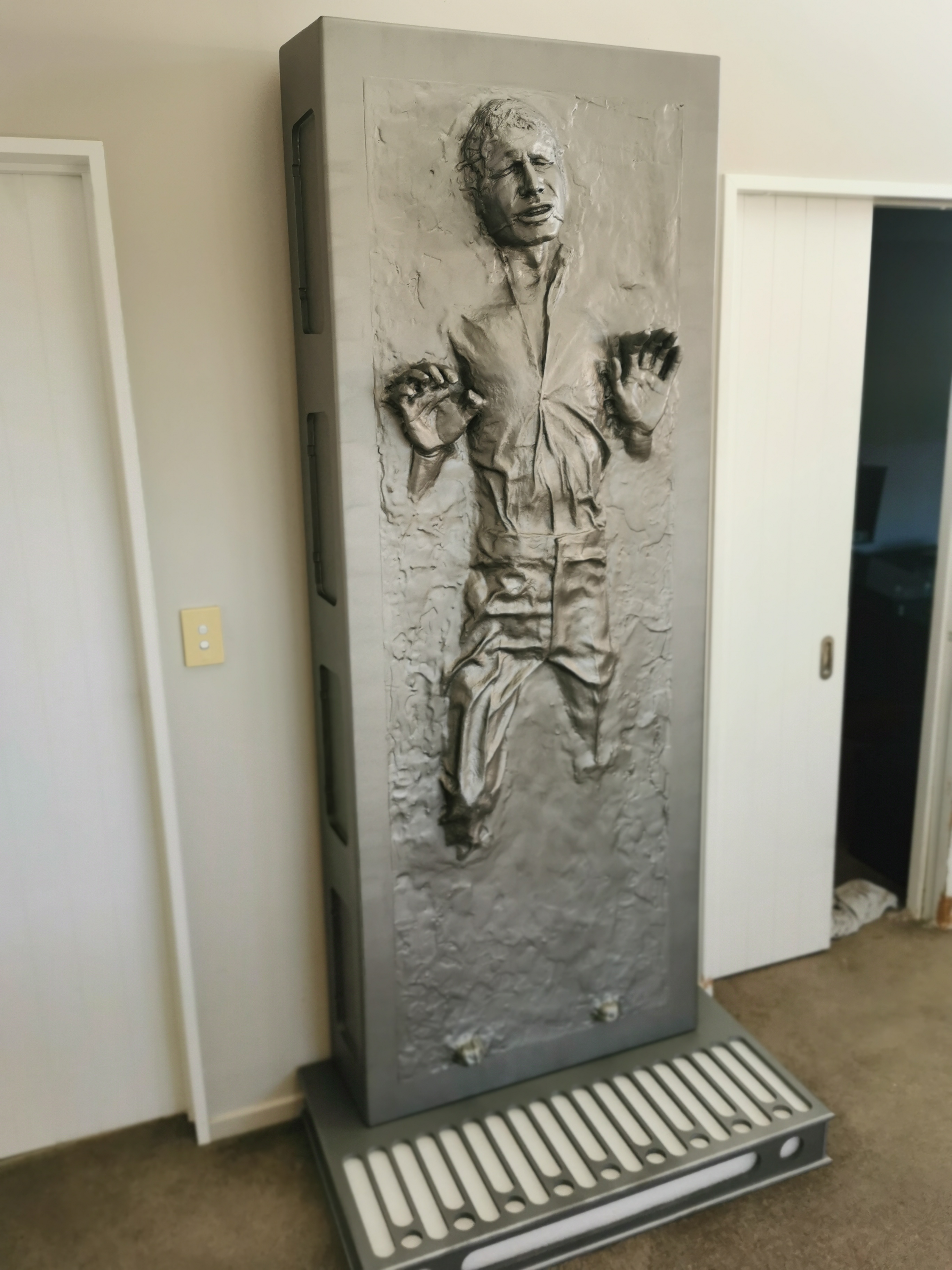

And now we have easily removeable click on panels
