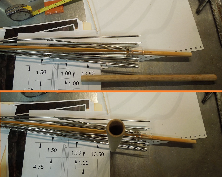

After scaling images of the umbrella, I purchased a parasol kit from Vena Cava Designs which has spars exactly the size I needed, though the handle(s) and end cap are not right for the prop.
First thing I made was a longer shaft out of a 5/8 inch oak dowel. I drilled a 29/64 hole in the end of it to match the diameter of the kit.

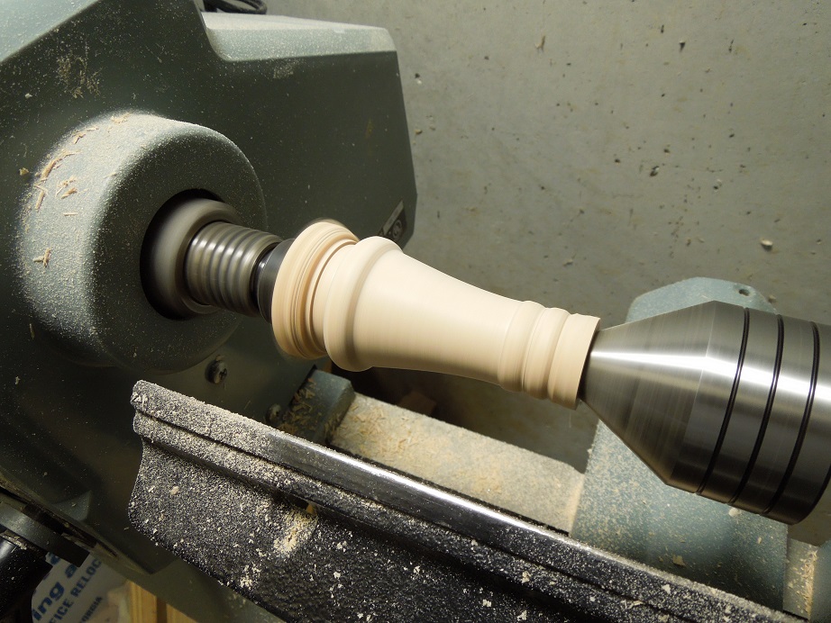

I then turned a handle using a wood lathe.

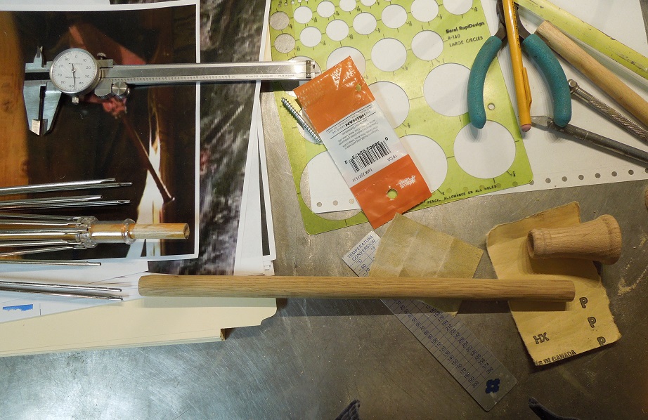

I shorten the shaft of the kit and drilled pilot holes so I could use a steel dowel screw (and lots of wood glue) to hold the two shafts together. The handle was then glued on.
I then made a new tip using a brass cane part from Rockler. This cap is glued in place after the pink fabric panels are put on .
Next I need to stain and finish the oak parts.
