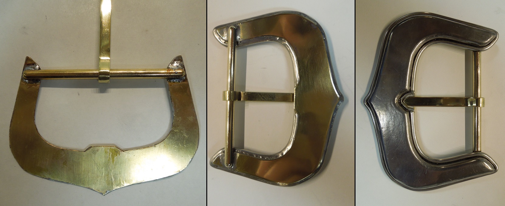

I don't have a picture, but I attached the one wing I made back in the first post of this thread. Unfortunately, the weight of the pewter causes it to sag in a most unattractive way. I plan now to try etching some brass wings per The DarkPope's instructions. I did some practice etching on a .032" brass backing plate for a Hagrid belt buckle using contact "paper" instead of photo-resist. It worked OK.
If you're doing a simple design, there's no need for photoresist. As you found out, contact paper works, so does strong Scotch tape, or packing tape - if you're able to cut the designs into it. There's a device - who's name eludes me right now - that can cut stickers that retails for $200 ish - if you know a friend that has one - stickers work as resist as well. They just have to be able to not pull up from the metal during the etch. It also helps if they can be removed after the etch :)

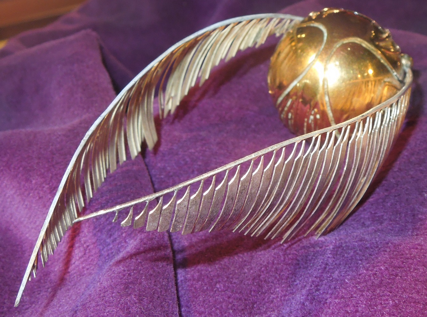

On to the bane of my existance for the last month or 2. I'll start by saying that I have finally completed my Wing Bender (tm) (patent pending)(no stealing). I couldn't be happier. After several different attempts, I finally just routed a channel into a piece of aluminum and pressure fit the wing into it. Now the secret's out. I won't bore anyone with the different attempts I made, It's picture time...

A few things you likely have noticed about the pictures. The first is that they are the old and incorrect design - that will be fixed in upcoming wings. I etched a few of this type and kept them around to test out the different benders I had made. The second is that they're a bit tarnished, that's because I was only going to be using them as experiments, so I didn't do any additional coats on it to prevent said tarnish. The ribs have no squeeze marks. The pressure fit did exactly as I had hoped, and they really do look great.

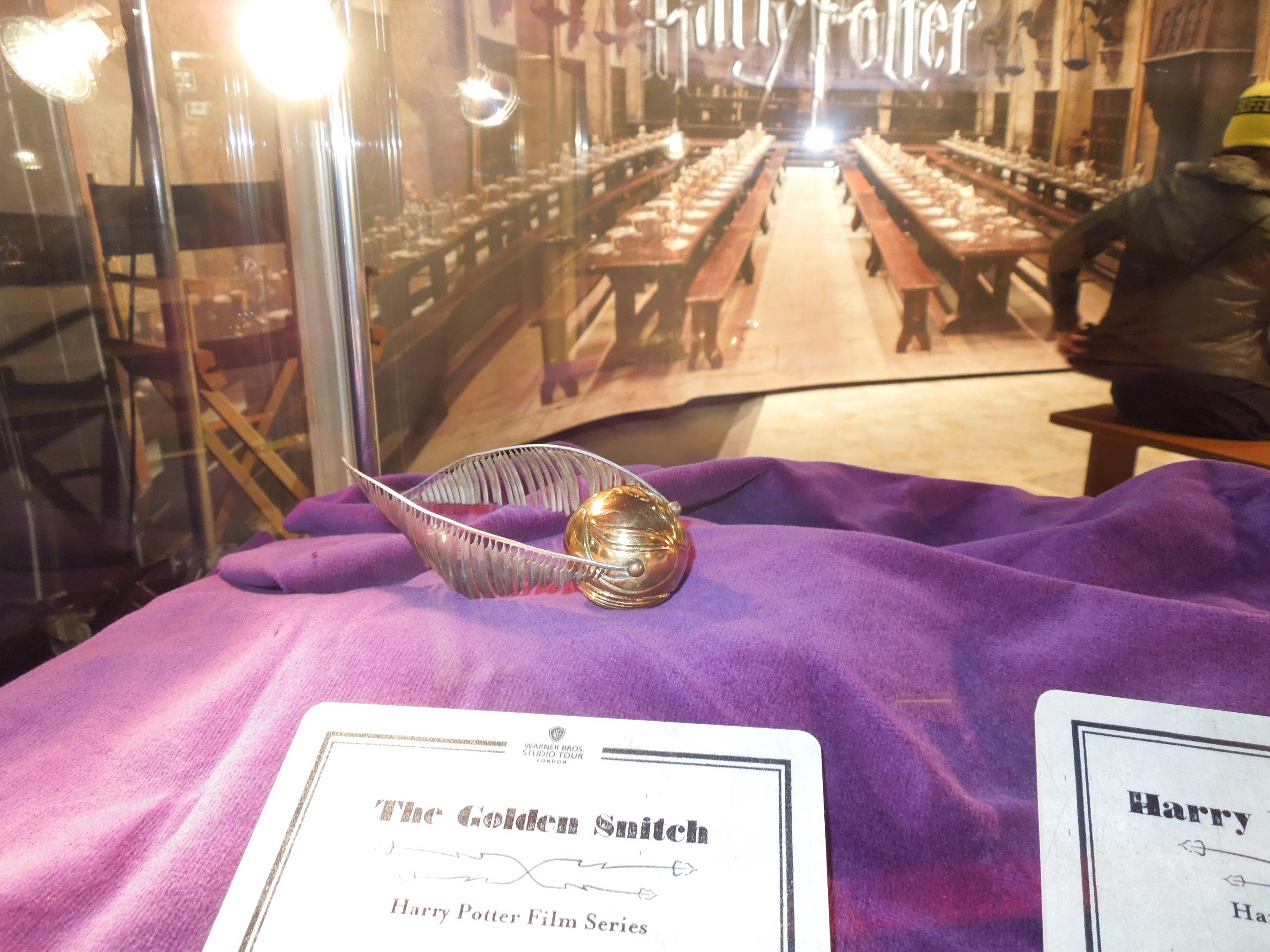

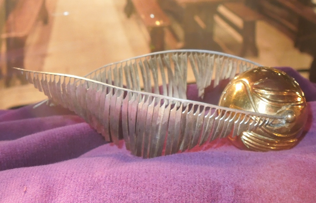

I was fortunate enough to be able to attend the HP Celebration 2015 at Universal Orlando, and guess what they had on display?
Thinking that since the original prop was made by a silversmith, I asked the attendant if the wings were made of sterling silver. She said she was told that they're made out of aluminum! She also said they were cut out by hand. (I believe etching is much easier)

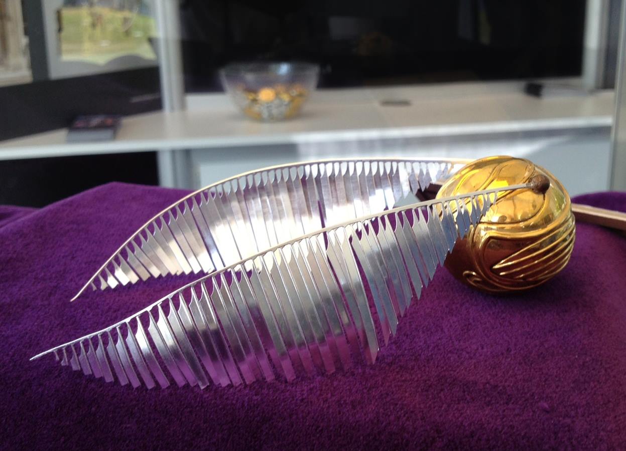

If you were given correct info - then I could see why aluminum was used. It doesn't tarnish ever - as all brass does. I don't buy that the originals were hand cut - a photoetching house can make wings by the Snitchload before the first wing was cut. Speaking of Snitches - do you have any more pictures?

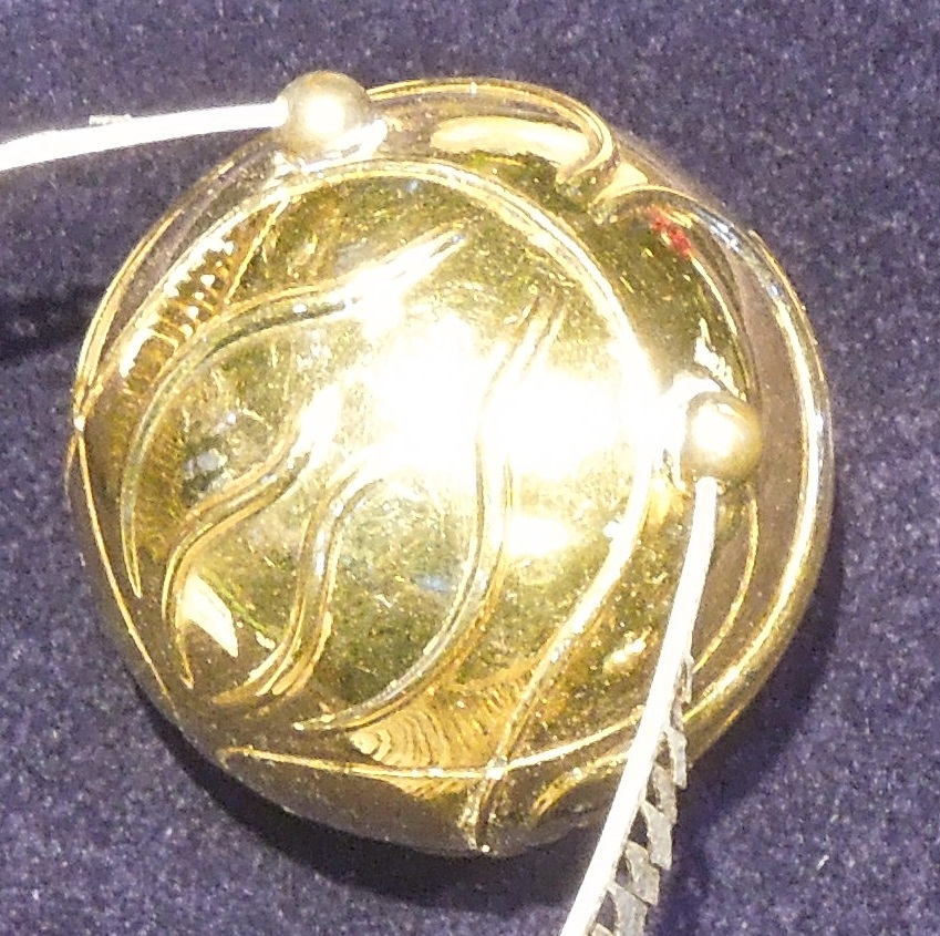

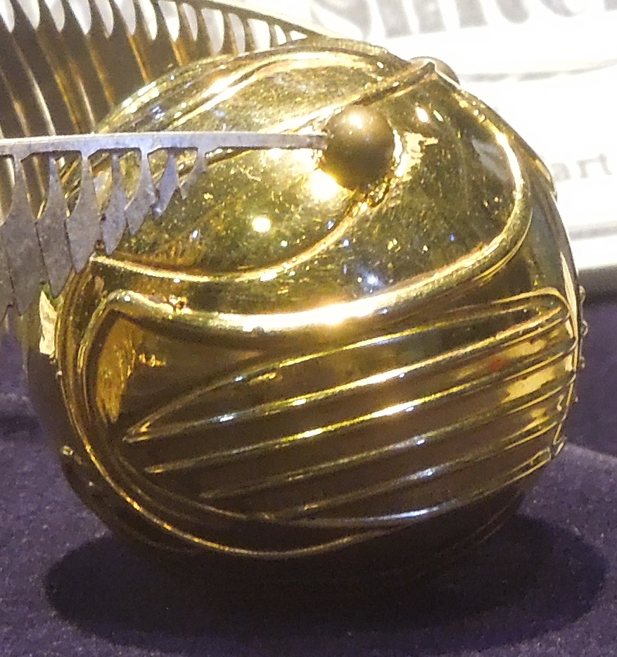

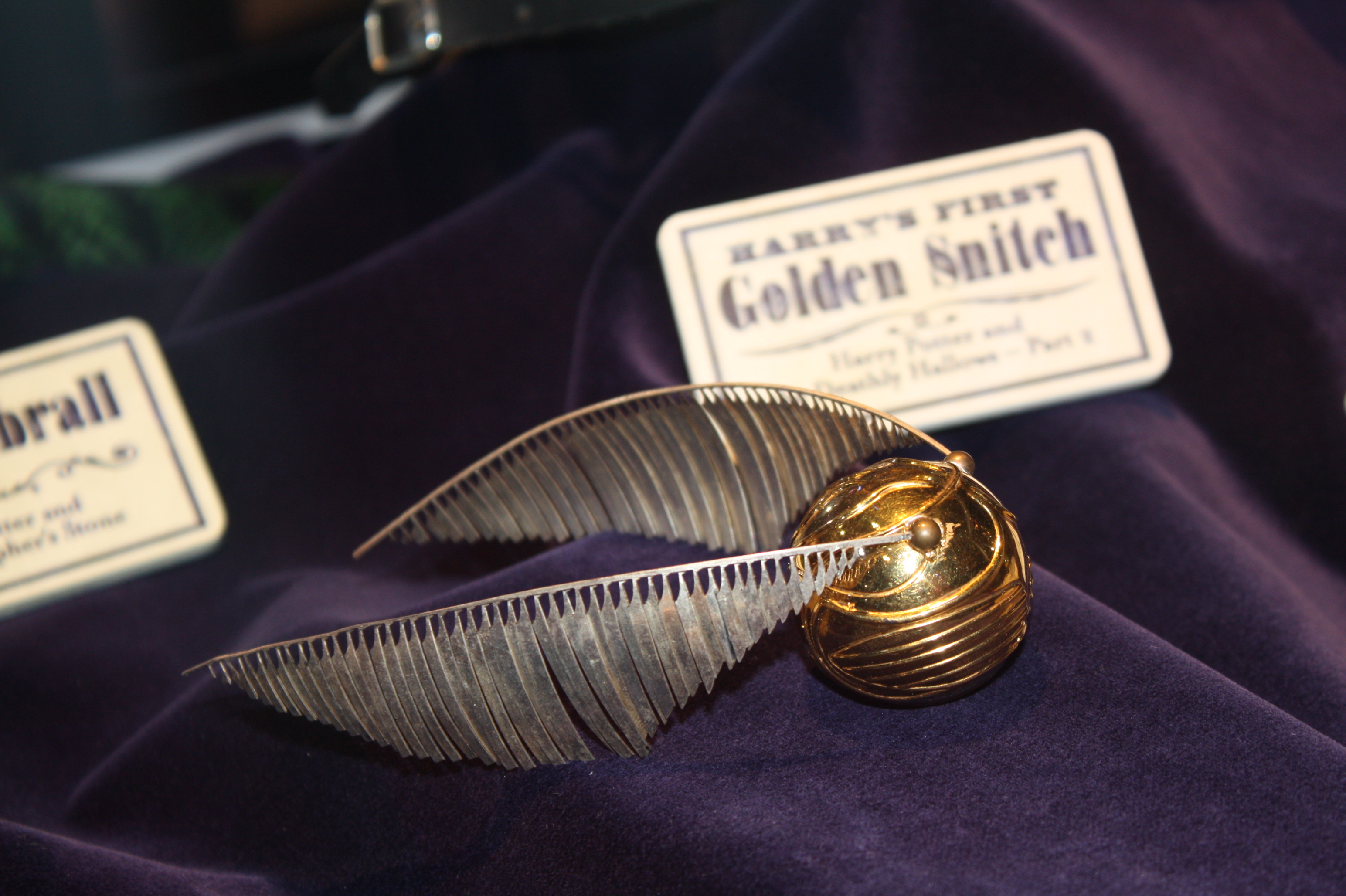

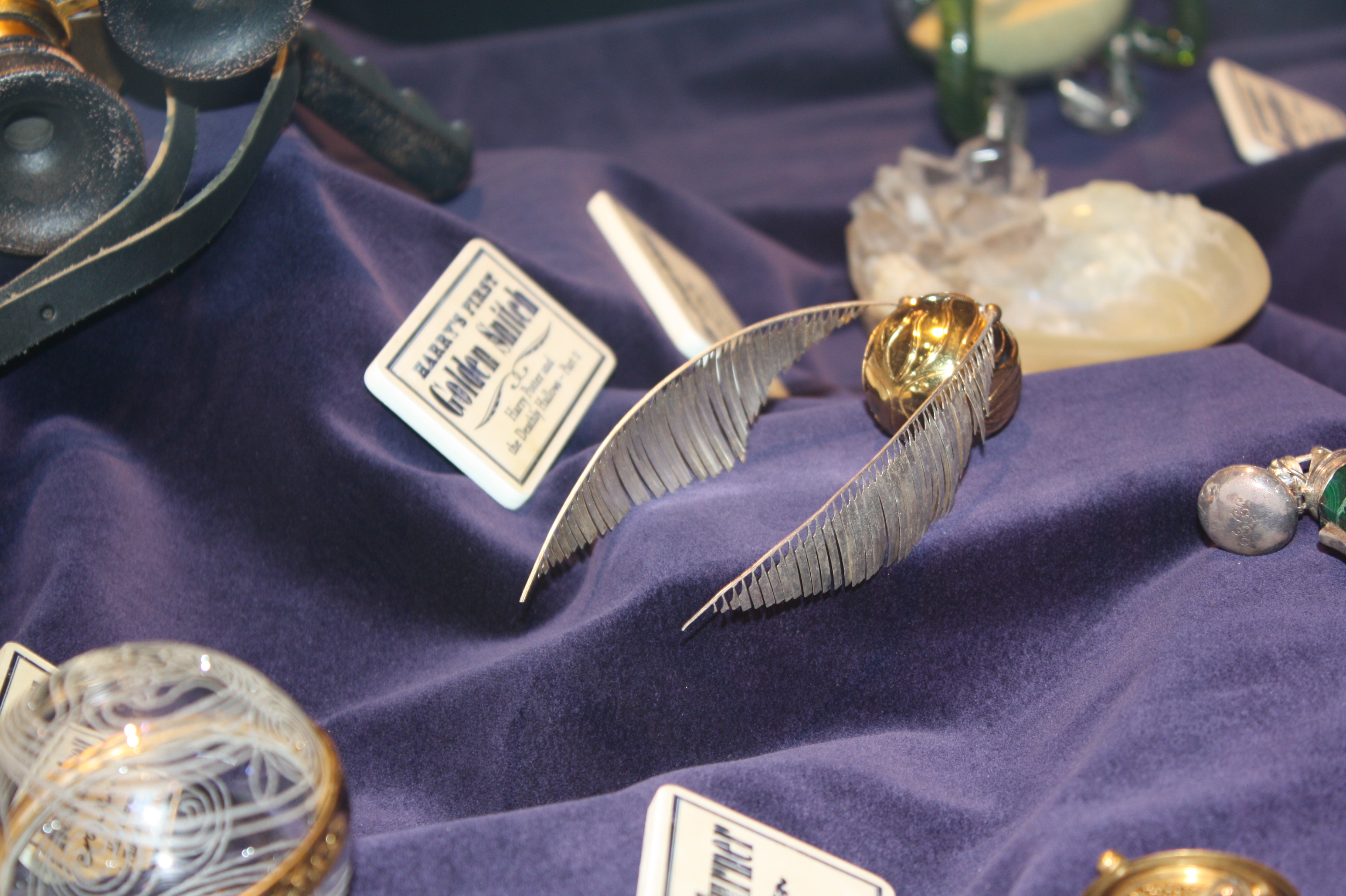

These are the images I have. I thought I had one that showed more of the bottom, but can't find it at the moment.
attachment.php
attachment.php
attachment.php
attachment.php
attachment.php

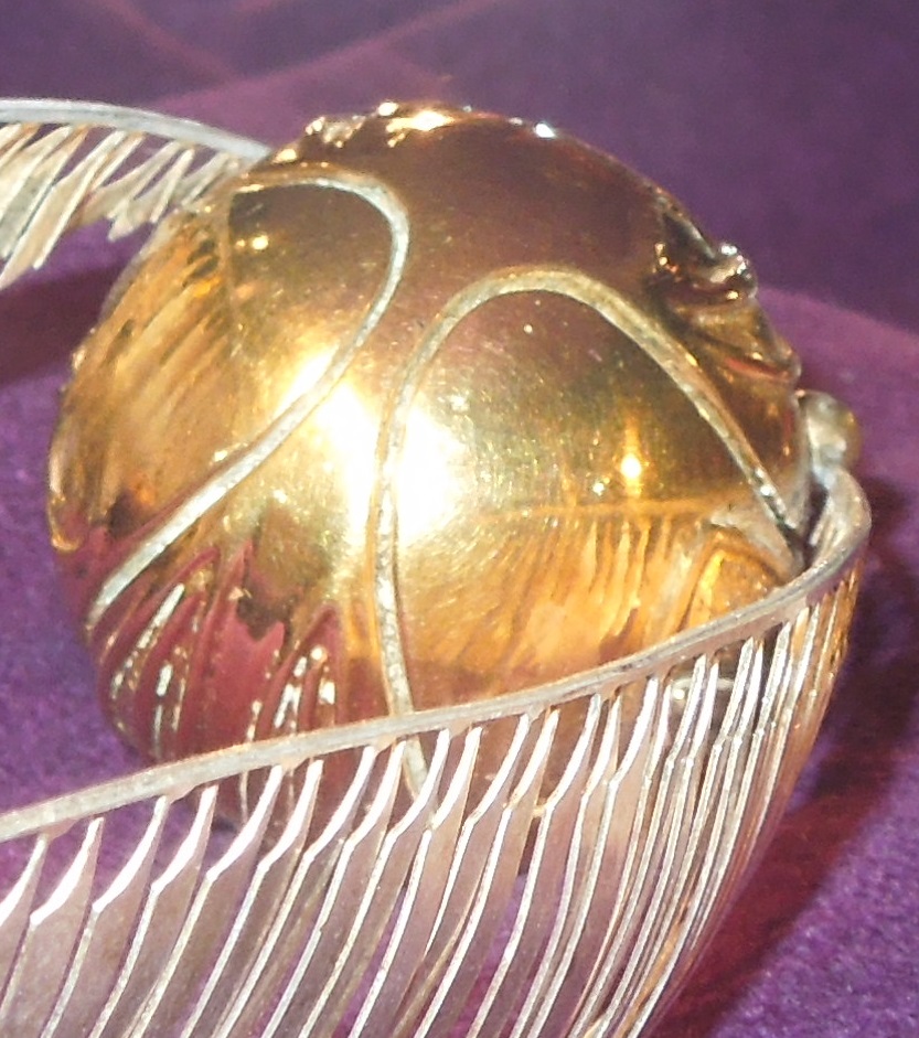

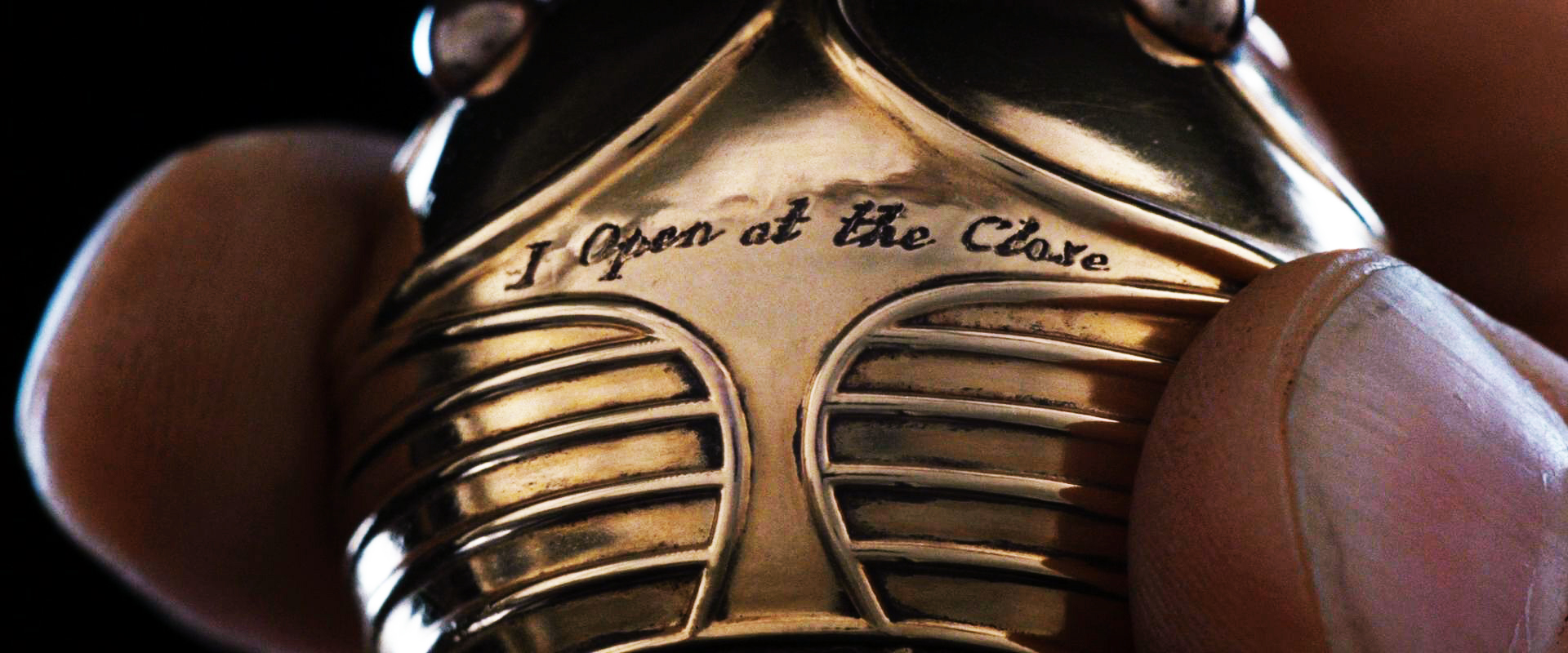

Most of the details are raised rounded ridges, but the one coming off the bottom of the "eyes" are valleys.

Not only are they valleys, they appear in the last photo to be colored in with silver too.
I saw that too. I was thinking it might be solder?? I didn't include the picture below because it didn't show any new detail, but it looks to me like the "eye" for some reason had to be re-soldered back on. Sort of a "I can fix this".
attachment.php
Also, I forgot to mention, the prop just looks bigger than the 35mm "printed" version I got from Shapeways. Perhaps 38mm or 1.5". They wouldn't let me measure it :unsure, at that time, and it was in a glass case with no good points of reference, but it just looked bigger. My wife thought so too.

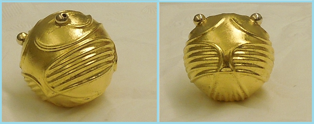

I saw the Shapeways description, and that's where I got the 35mm idea. I was looking into different size balls to make it from - Ping Pong, Foosball, Beer Pong and everything I was finding was 38 or 40mm. I bought the ball bearing out of the assumption that 35mm was correct. Logic would dictate that whoever made the Snitch would make it from readily available sized things - aka Ping Pong ball, and not from an oddly numbered thing like 33.78mm that was specially machined so no one would ever get the correct size. Maybe there are Google-able pictures from other people that went to the same exhibit and there was something of standard size that could be measured behind it as Scotophor suggested to use some trigonometry for sizes.

I mentioned size to the modeller of the Shapeways Snitch (I feel like saying Martin, but I can't remember his name for certain) – that I thought it was a bit too small to be "screen accurate" – Holding it in my hand, I feel it just doesn't have that bulk that the Deathly Hallows snitch possessed such as when he kisses it and all of that stuff. I wouldn't be surprised if there were a few different sizes along the way though.
It is comparable in size to the Hallmark snitch that was released a couple of years ago, but it's definitely smaller than I think the screen used prop was, and from observations here, it looks like the snitch that is on tour is closer to that size.
I feel as though a ping pong ball is closer to screen accurate size. I've no solid measurements though. Just feels from my ping pong ball based snitches.
From what I've come across and some memory, 35mm would be closer to book-accurate sizing. That's about the size of a walnut, isn't it?

I went to the Warner Brothers Studios in the UK this week and compared the original snitch on display with my Shapeways version and a ping pong ball. The original snitch is much closer to the ping pong ball in size, i.e., larger than the Shapeways. Since the snitch is in the middle of the case, you can't really put a tape measurer against it to get a completely accurate measurement.
