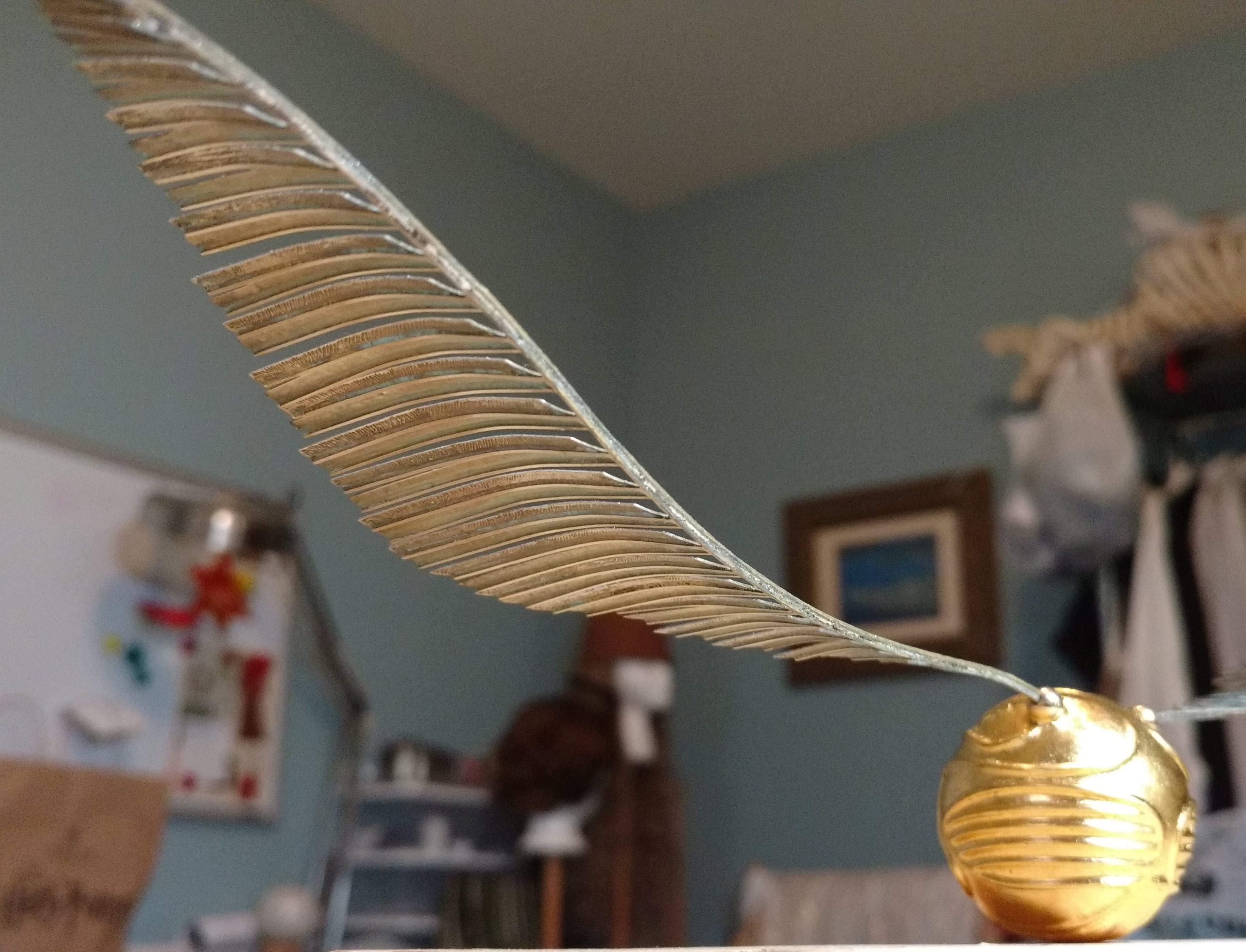

Oh god, this is gorgeous! How did you manage this kind of detail on the wings if you don't mind?

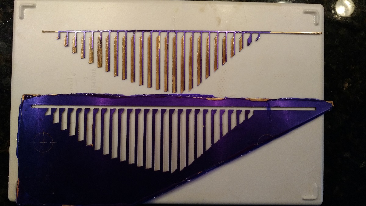

Somewhere in this thread is a link to a very well done brass etching tutorial by TheDarkPope . Follow that religiously.
Each wing is a pair of interleaved brass etchings, silver plated (I used Plug-N-Plate by Caswell), clamped together, and soldered using silver filled paste. I used transparencies printed on an ink jet printer, LED "black lights" from Home Depot, resist, a laminator, and mg scale from Amazon and had better results with muriatic acid/hydrogen peroxide than with ferric chloride.
