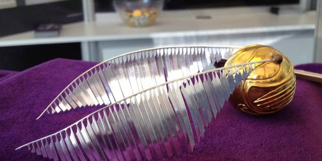

I know a lot of the CGI representations of the Snitch wings are gold in color, of which polished brass makes an excellent replica. However, I believe that JK's vision was that the wings are silver in color. Just curious, do you have means to plate the brass - either chrome, nickel, silver, tin or pewter?
ATL
I found this picture and others that seem to suggest that the prop we're all referring to has the wings in silver. Is it possible that the golden color seen in the other images may be due to the illumination of the prop?
I found this picture and others that seem to confirm that the prop we're all referring to has the wings in silver. Is it possible that the golden color seen in the other images may be due to the illumination of the prop?
It appears that this was made by a silversmith, and it may have been done just for the Warner Brothers display in London...
http://www.mugglenet.com/2013/07/beautiful-golden-snitch-on-display-at-buckingham-palace/
The Warner Bros. Studio Tour London: The Making of Harry Potter Facebook page released this beautiful new image today of a gorgeous Golden Snitch. It is being featured alongside a selection of props being displayed at the Coronation Festival at Buckingham Palace from July 12 to July 14. According to the caption included with the picture, “the Silversmith who holds the Royal Warrant of Appointment to HM The Queen, worked with Pierre Bohanna” to create this spectacular Snitch. Head over to the Studio Tour’s Facebook page for a closer look!
TDP - I knew I'd seen it mentioned that the static display was made by a silversmith. Thanks for posting the link.

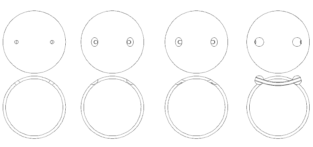

Here's my thought on how I intend to mount the wings to the body keeping in mind that I plan to have the wings come out the sides as if hovering, rather than folded back as with the display.
The top row in the diagram is looking at the two holes in the body shown rotated so that they're facing up. The second row is the respective cross section (sans cross hatching).

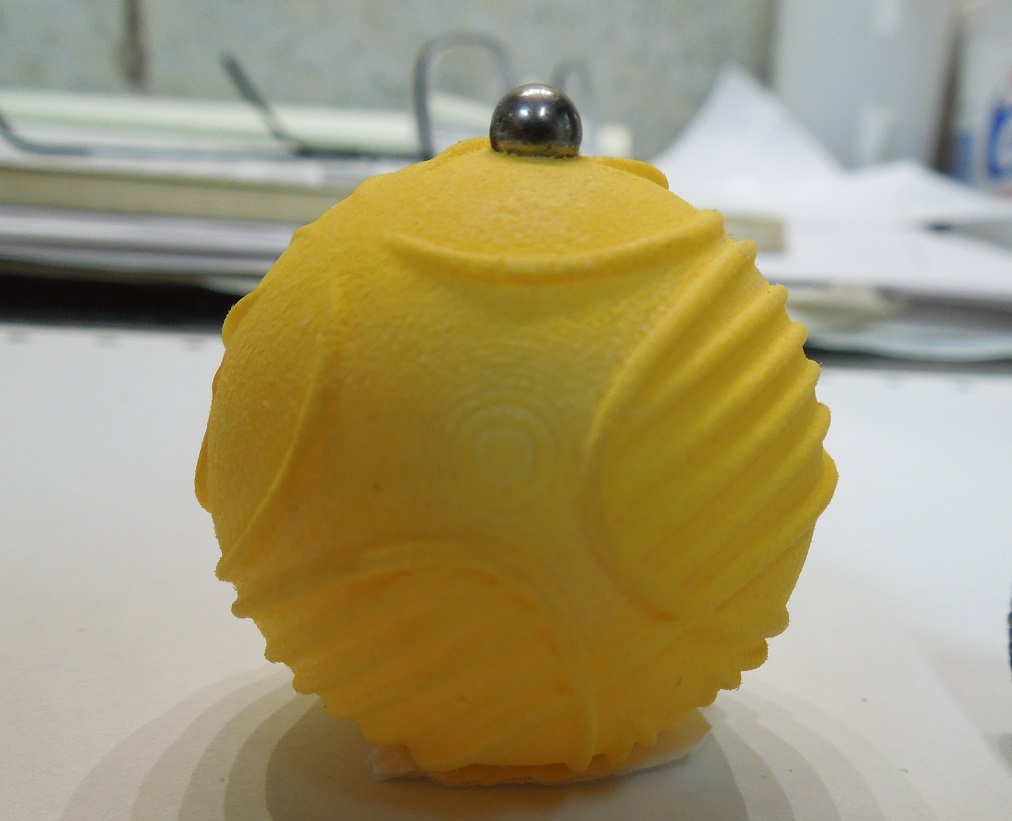

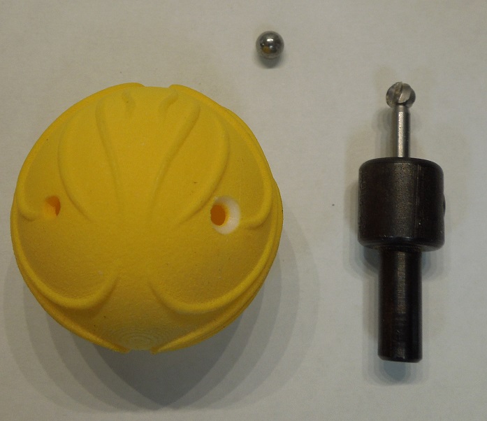

Using a Dremel 3/16 diameter cutter BY HAND I created a shallow dished indentation to fit a 5mm gold plated bead (in the mail). The bead has a 2mm thru hole.
Here's a stand-in 3/16 diameter ball bearing.
The next step will be to file the inside of the dished hole using another Dremel bit to allow a 2mm OD thin wall brass tube (no postage if you cand find them at an ACE hardware) to pass between the 2 holes. The brass tube will need to be bent around a 1-3/4 inch diameter tube. Once the 2mm tube is in place, a bead will be epoxied to each end, and the tube trimmed as required. The elongated rib from the 2 wings will then be slid into this brass tube.

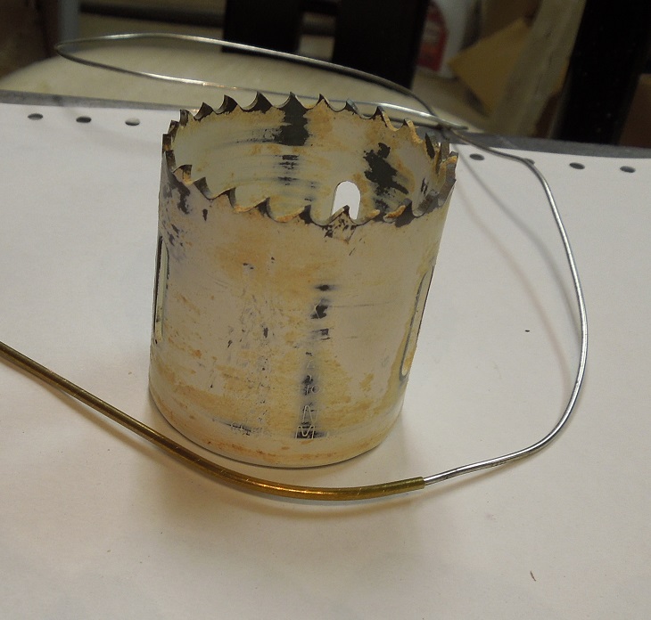

I bent the end of the 2mm brass tube around a 1-3/4 inch hole saw. I put a piece of 16AWG copper wire inside the tube to keep it from collapsing.

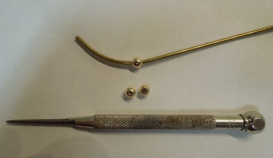

Turns out the 5mm gold plated beads I ordered only have 1.5mm holes. I was able to use a scribe to enlarge the holes. Attempts at drilling didn't work.

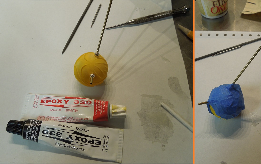

I epoxied the beads to the 2mm tube and the body, and used some painters tape to hold it all in place till the glue can set.

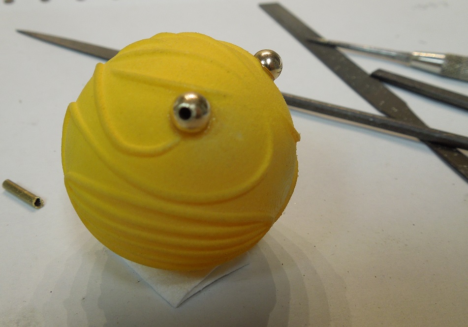

I trimmed the end of the 2mm brass tube and filed it flush with the bead.

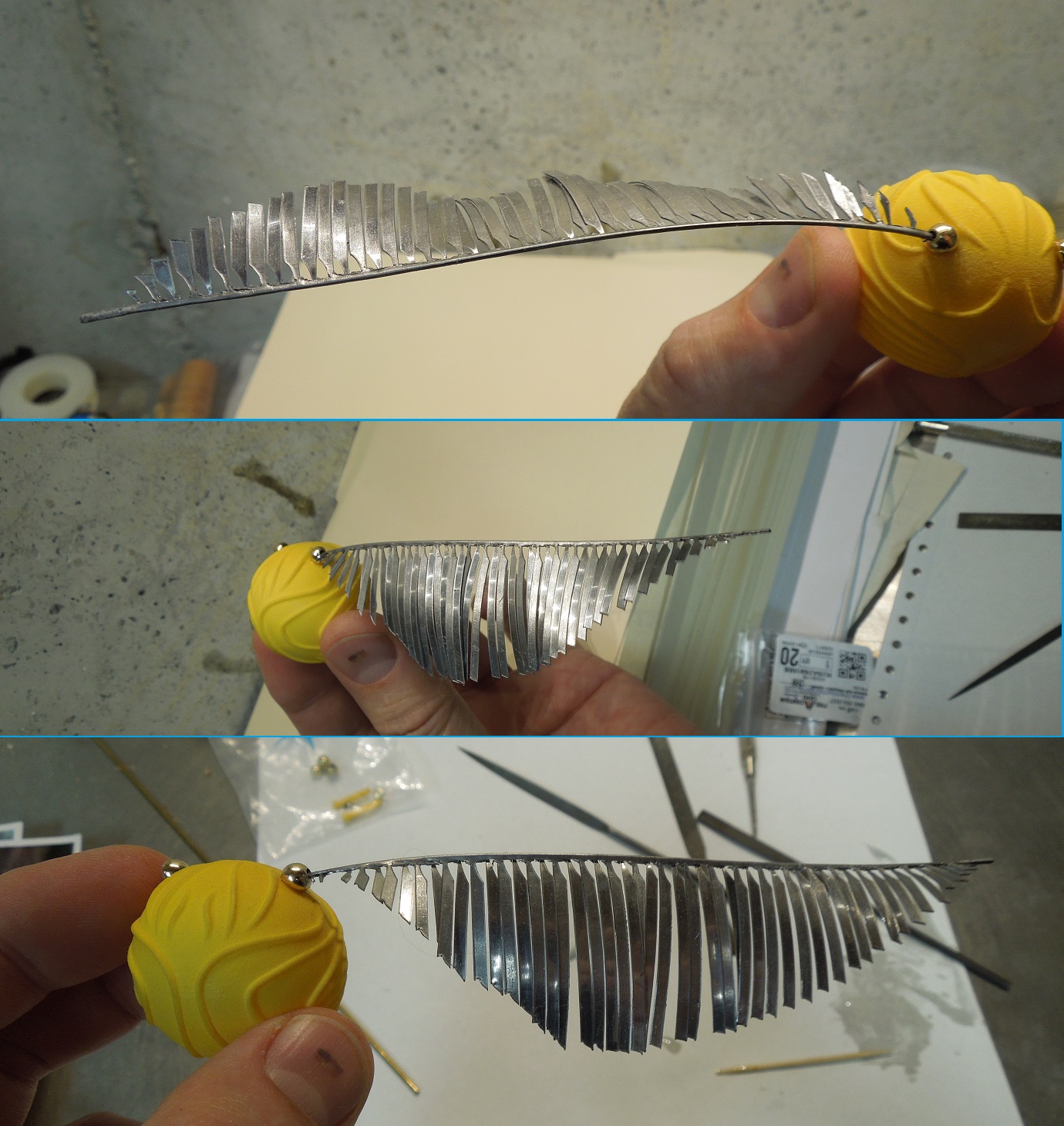

For grins, I attached the one pewter wing I made.
There actually is a 0.015 inch diameter steel wire embedded in the "rib" to give the wing some structure and help hold it's shape. The lead based pewter I've use is relatively heavy and it doesn't want to cooperate when I try to shape it.

ATL, your wing came out nicely. In the video I was using .010 brass and it took 43 minutes to etch. The process took a bit longer than it normally would because I was filming, and therefore using a different technique to etch. The way i normally etch, it would take 20-25 minutes for .010 brass, but that way doesn't allow for proper filming. How long did it take to etch your wings, and how heavy are they?

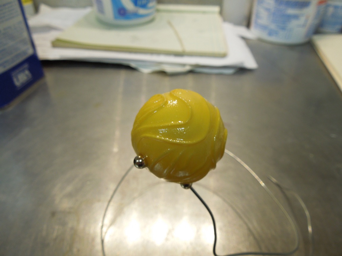

As was expected, applying the Smooth-on product would be similar to brushing on cold molasses (treacle :) ). With this in mind, I tried to apply as thin a coat as possible, but it still filled in many areas between some of the ridges and it's going to take a lot of work to fix this.
Small update, but rather depressing. My wing bender didn't quite work as planned. I'm on the right track, but I need diffferent materials, and possibly different tooling to make it work correctly. It's easy enough to bend the rib of the wing without fancy gadgets, however it leaves the edges rather messy, but that's not going to work for a pretty Snitch. I have another idea I'm going to try. It'll be a few more days to get the necessary parts.
Small update, but rather depressing. My wing bender didn't quite work as planned. I'm on the right track, but I need different materials...
