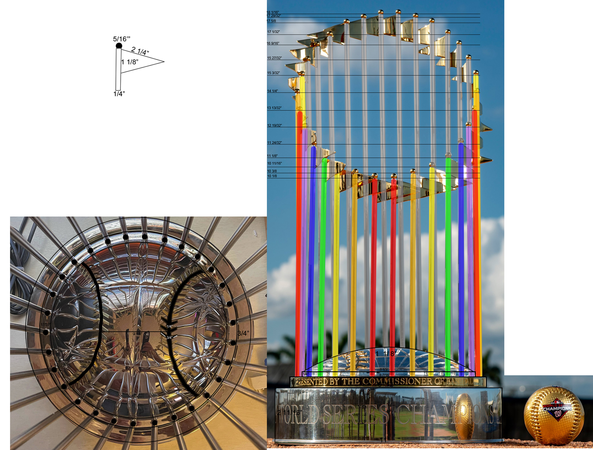

While researching the World Series trophy, I struggled to find consistent dimensions. Wikipedia lists the diameter of the base as 11 inches, and the poles are 24 inches tall. A company selling replica trophies states the base is 14 inches, and a fellow builder from the Replica Prop Forum (RPF) mentioned the Chicago Tribune describing the base as 11 inches. To resolve this, I used a reference photo from the Washington Nationals, which showed the trophy with a baseball at its base. This allowed me to scale the photo in Photoshop, using the size of the baseball as a reference, and take measurements from there. I did take some liberties with the measurements since sourcing parts in those exact sizes wasn't feasible.

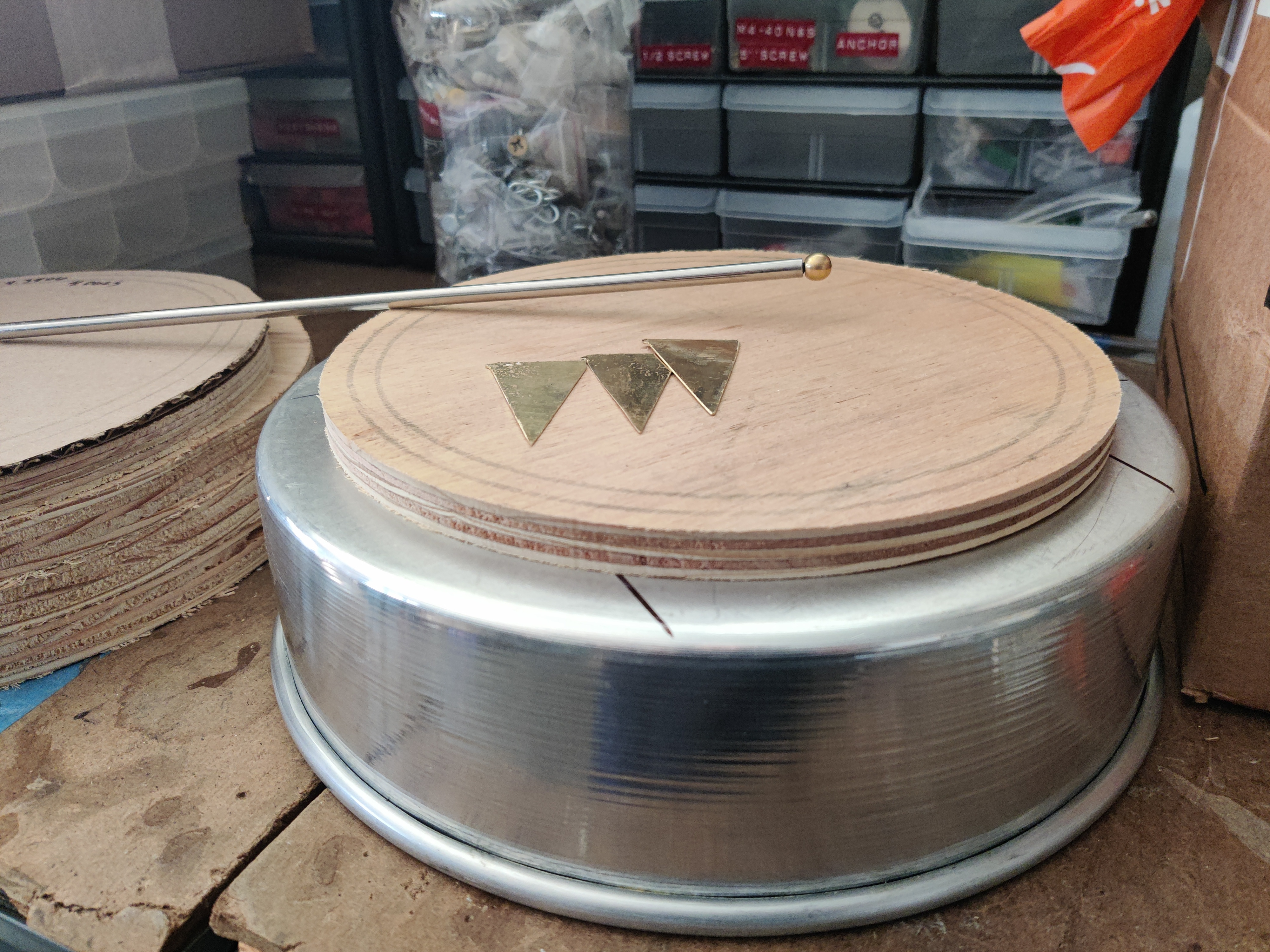

The flagpole tubes were determined by the size of the ball at the top. I found a lamp supply store that had a ball of the right diameter, already threaded with an 8/32 size. The stainless steel tube and brass flags were sourced from McMaster-Carr. The flags themselves were made from thin brass sheets, cut by hand based on designs I came up with on SketchUp. The inner structure of the trophy is made from three 3/4" plywood sheets and one 1/2" plywood sheet. A 1/2" plywood ring holds the poles and keeps the hubcap secured to the cake pan.

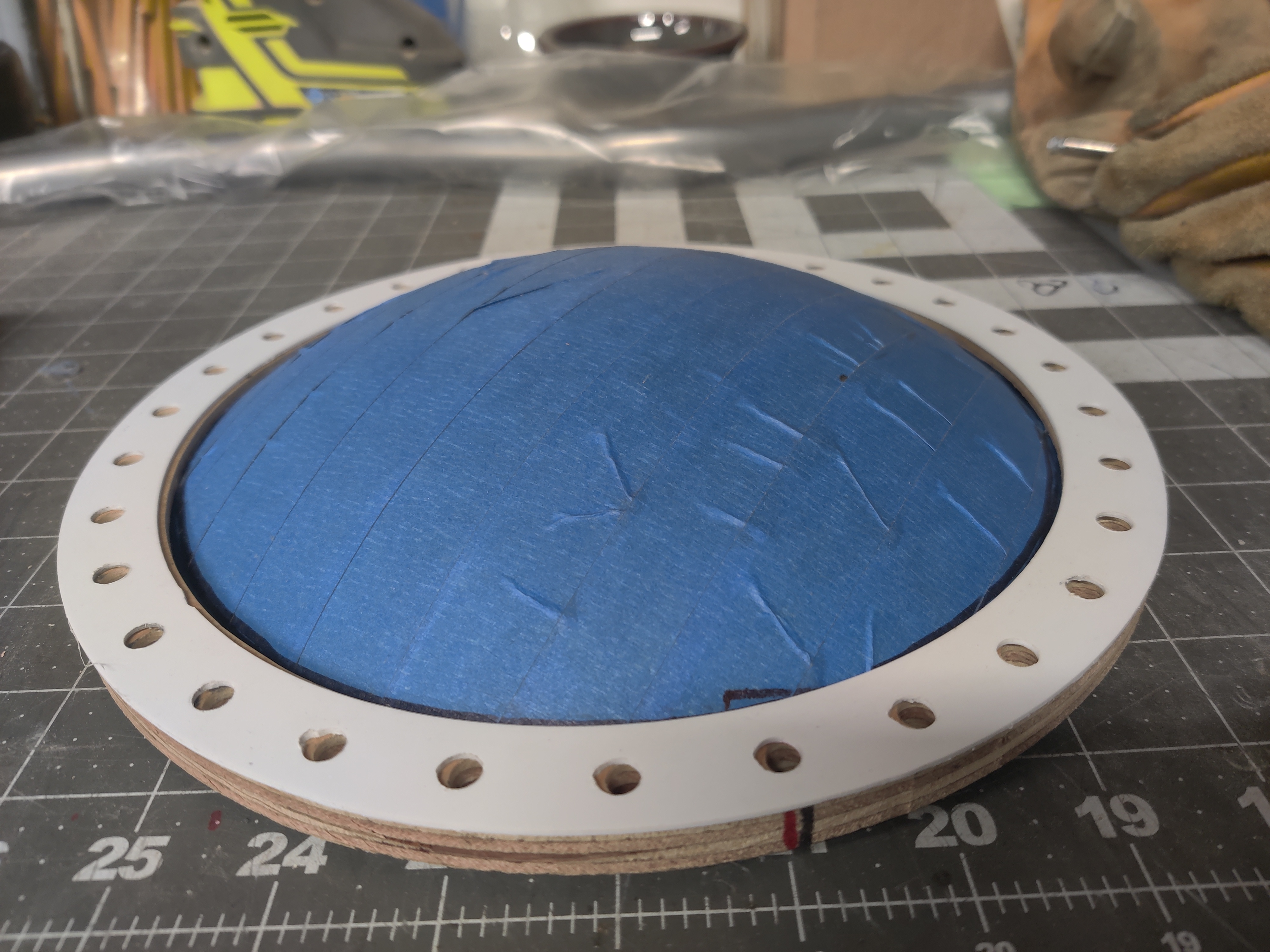

I began by cutting the circles using a circle cutting jig and a battery-powered trim router for the cuts. I ensured all circles had a centered reference point for alignment during gluing and cutting. The first three circles in the 3/4" ply were cut to ~11" in diameter, and the two 1/2” ply were cut to ~9 1/2” in diameter.

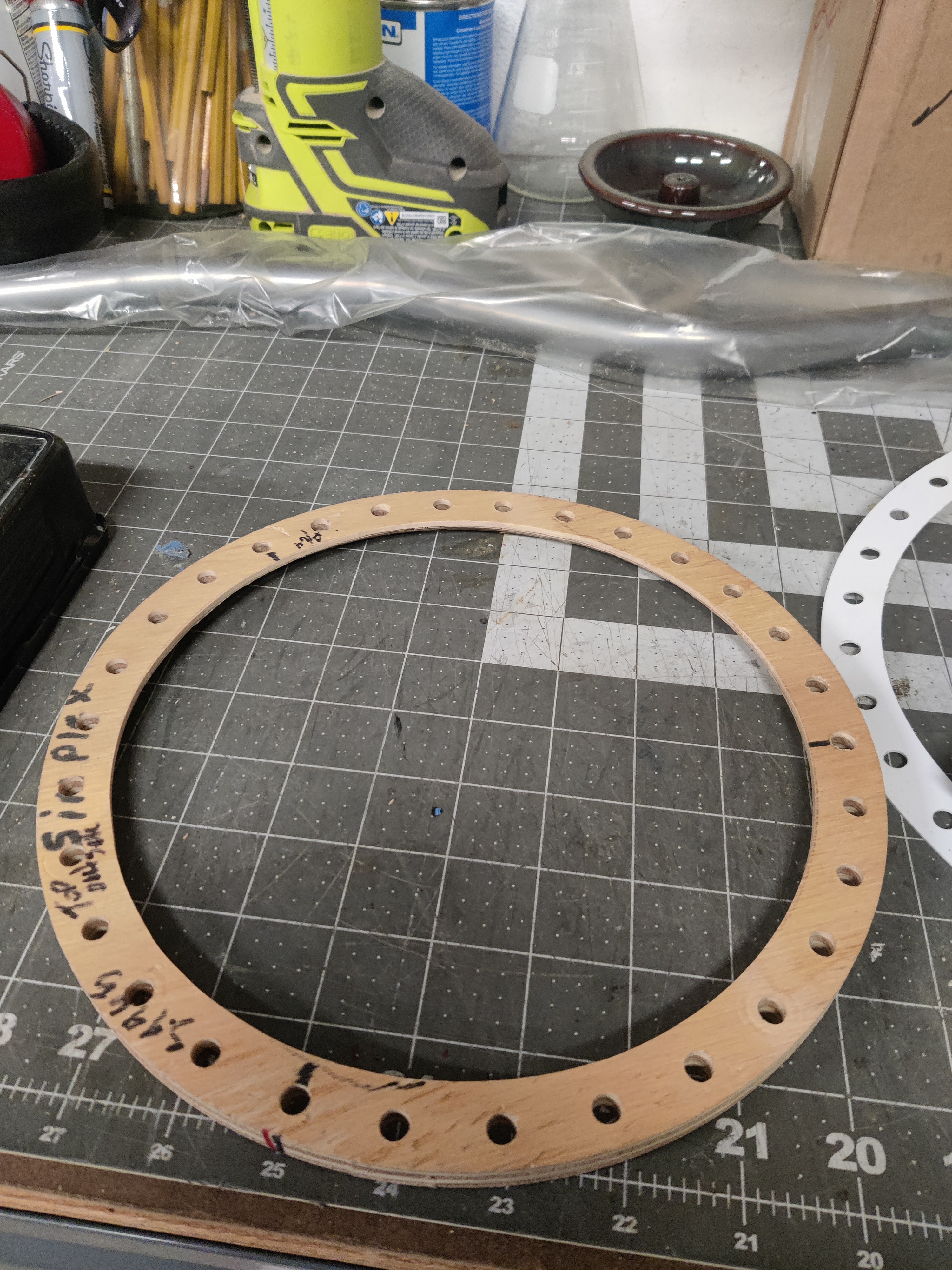

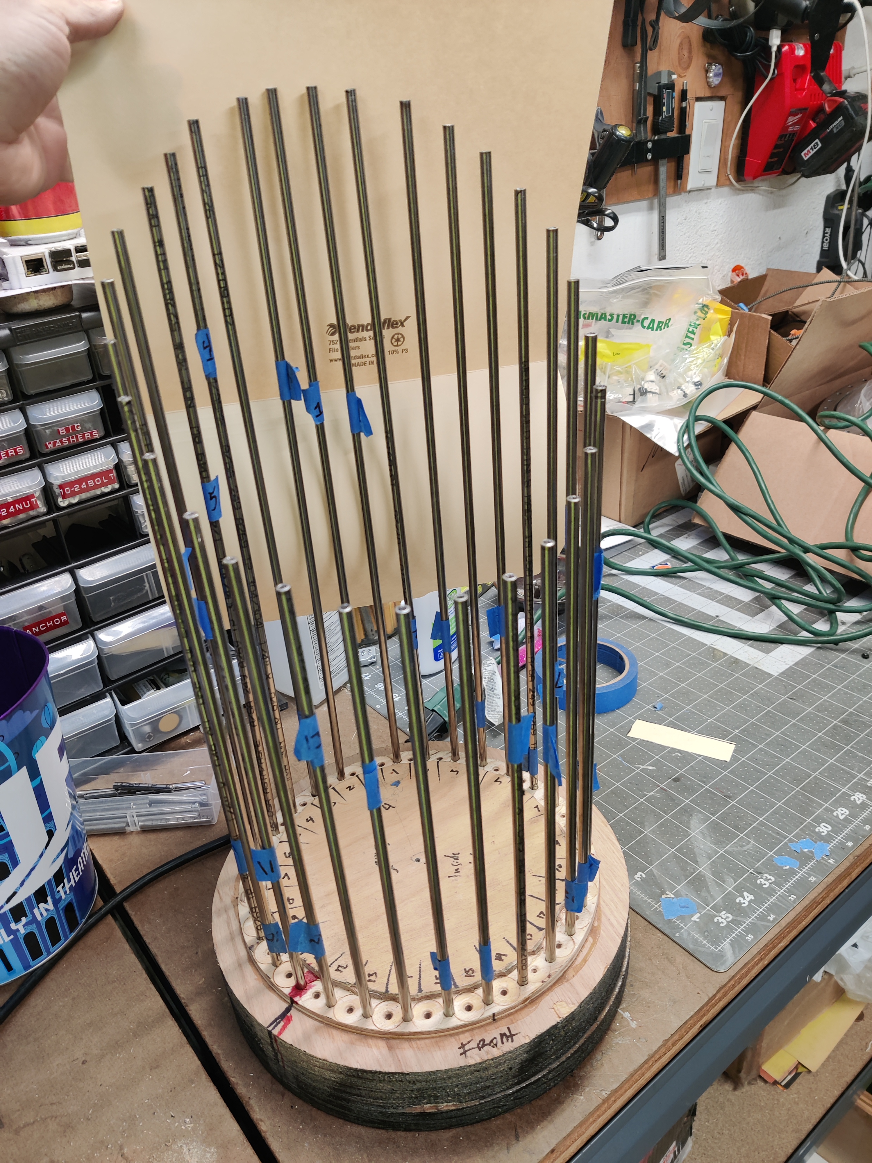

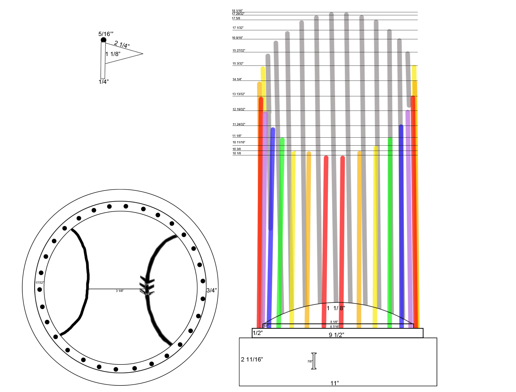

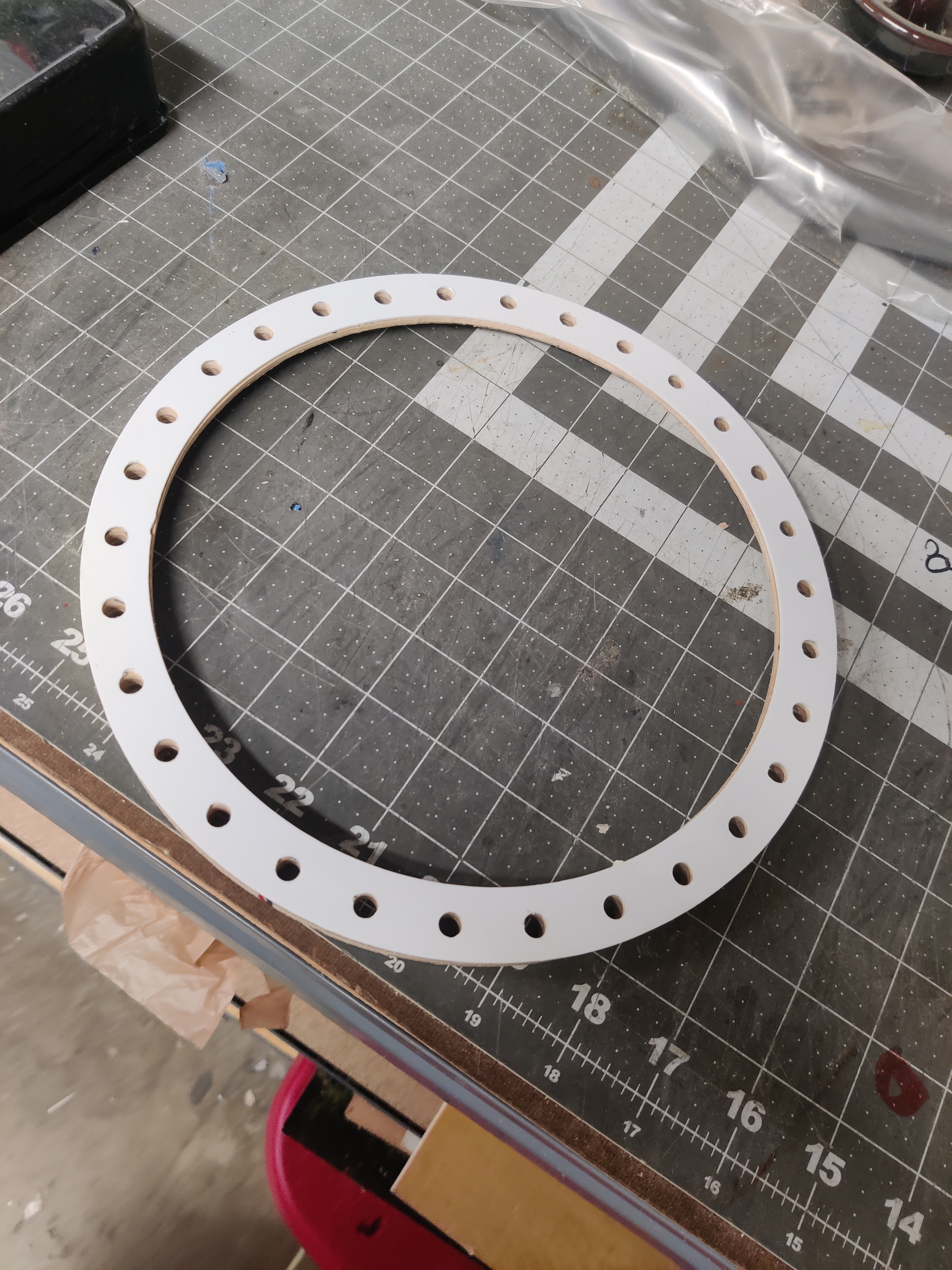

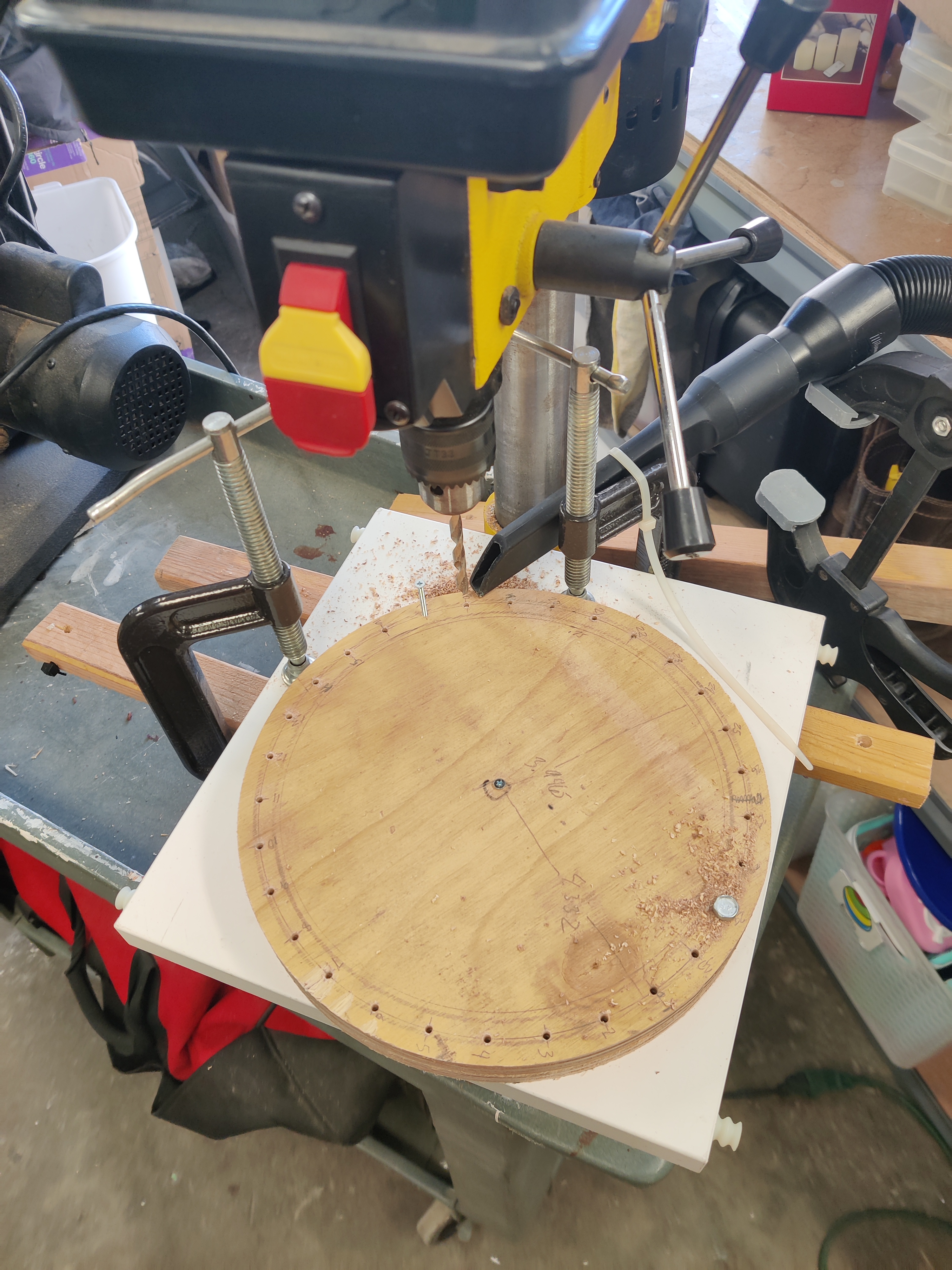

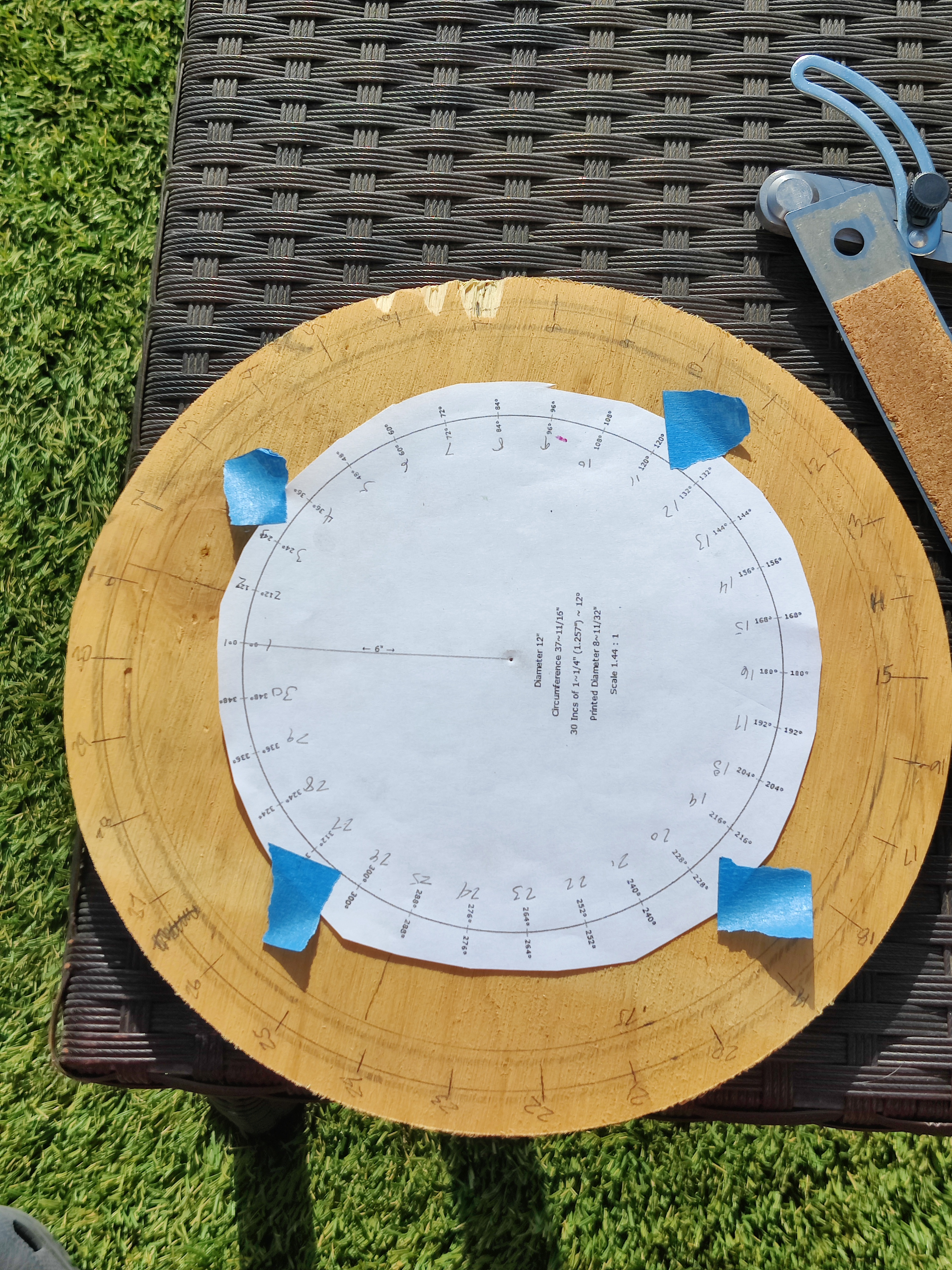

Next, I used an online calculator to divide a circle into 30 equal parts and marked those locations on a 1/2" plywood sheet. I drilled pilot holes at each of these marks using a drill press. The tricky part was drilling the correct hole size for the stainless steel tubes. After several trials, I found that a specific drill bit (size F) was the perfect fit. I drilled the top half-inch of the plywood for all 30 flagpoles and used that as a template for the rest of the pieces. Since my drill bit wasn’t long enough to go through all the plywood at once, I glued the pieces in two parts and then drilled through the entire stack.

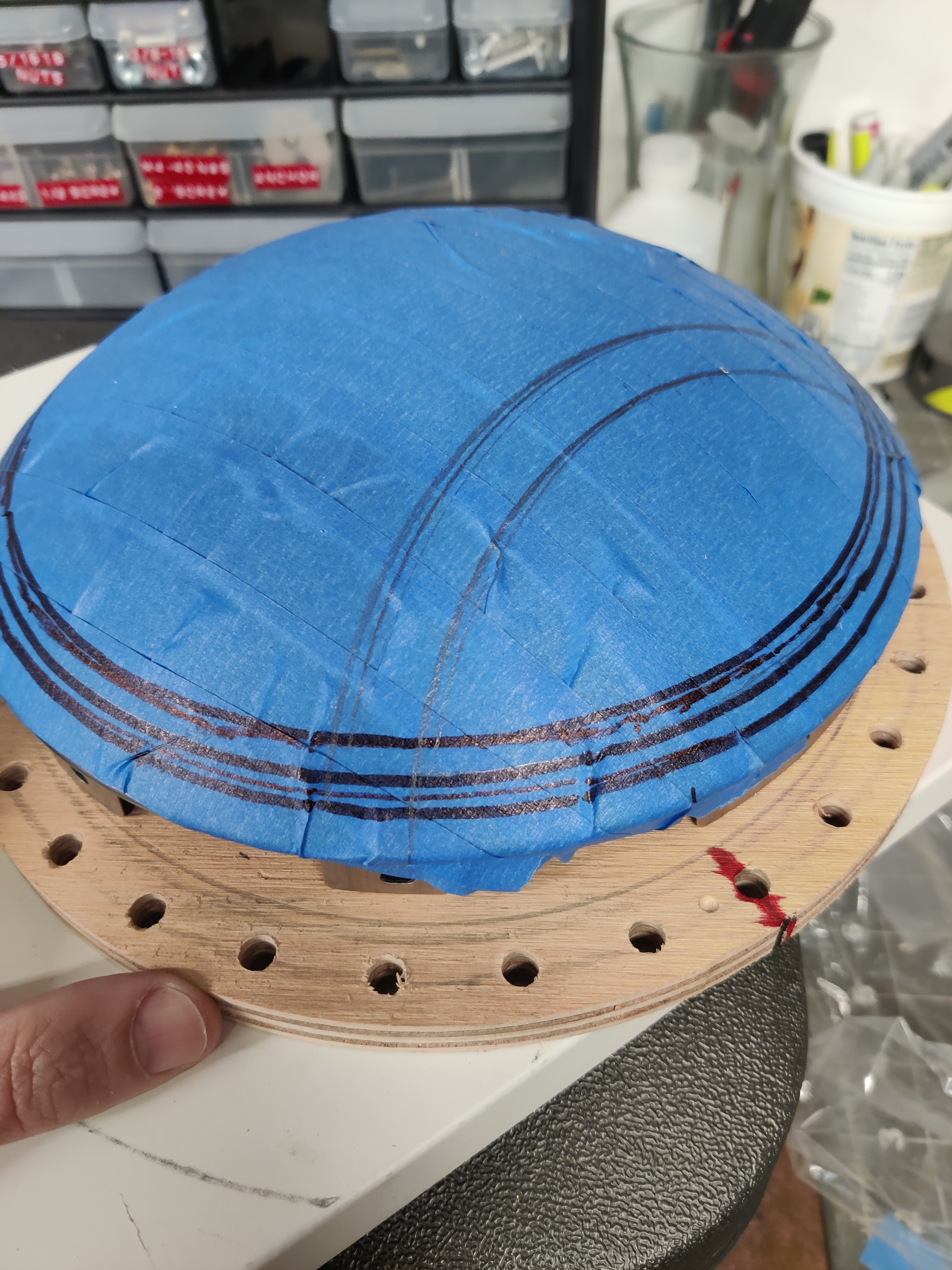

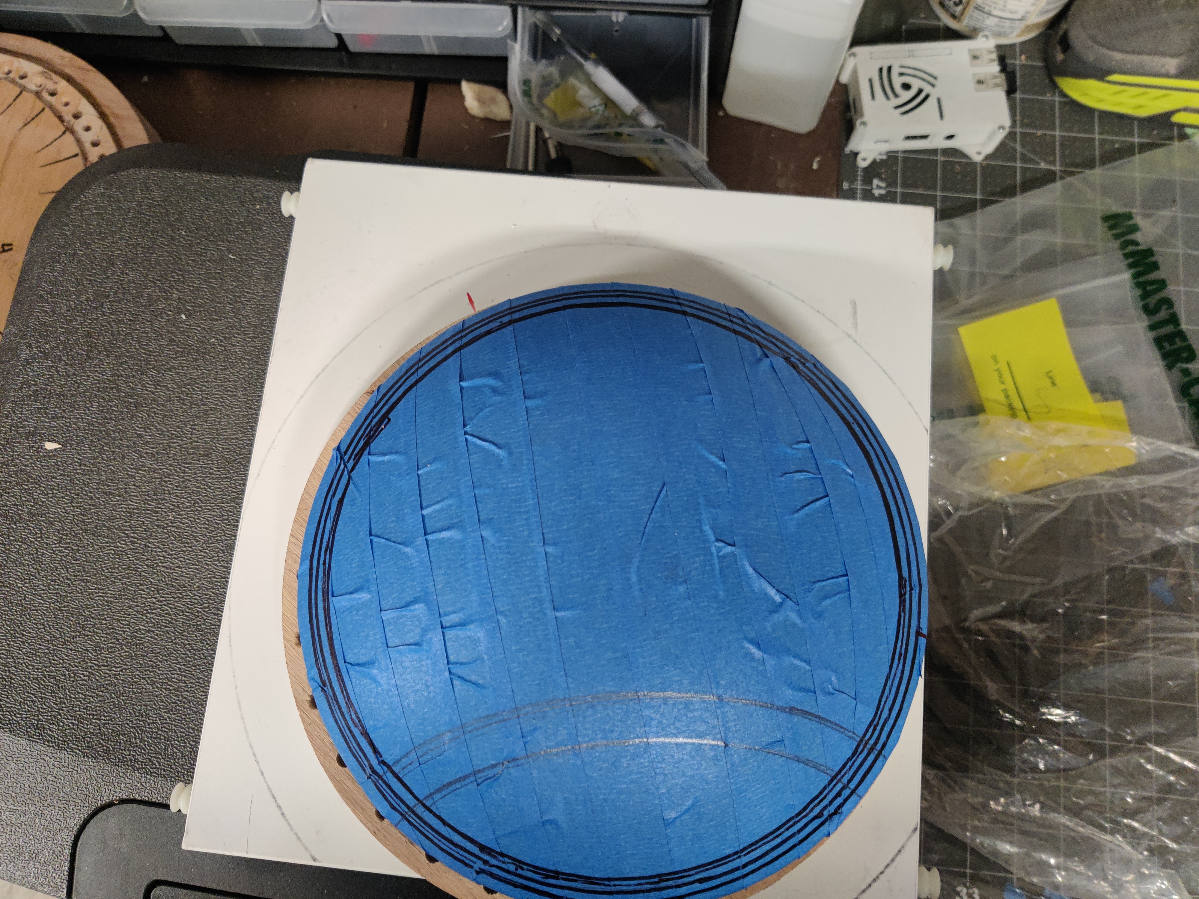

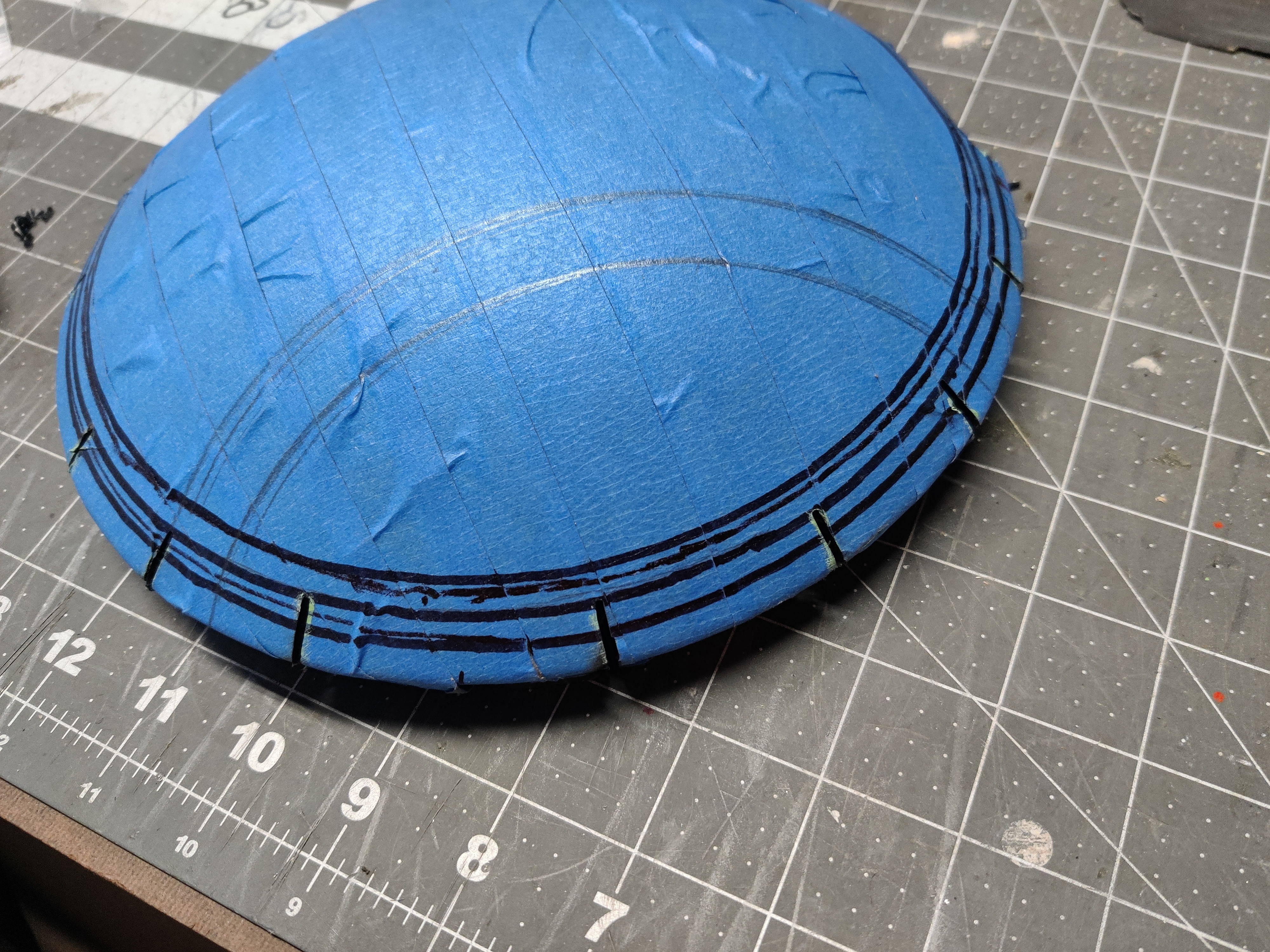

I then worked on the hubcap (the baseball). After wrapping it in tape, I estimated the location for the threads and cut a ring from the 1/2" plywood to determine where the hubcap would fit. I would then use an angle grinder to trim the ball down to the desired height.

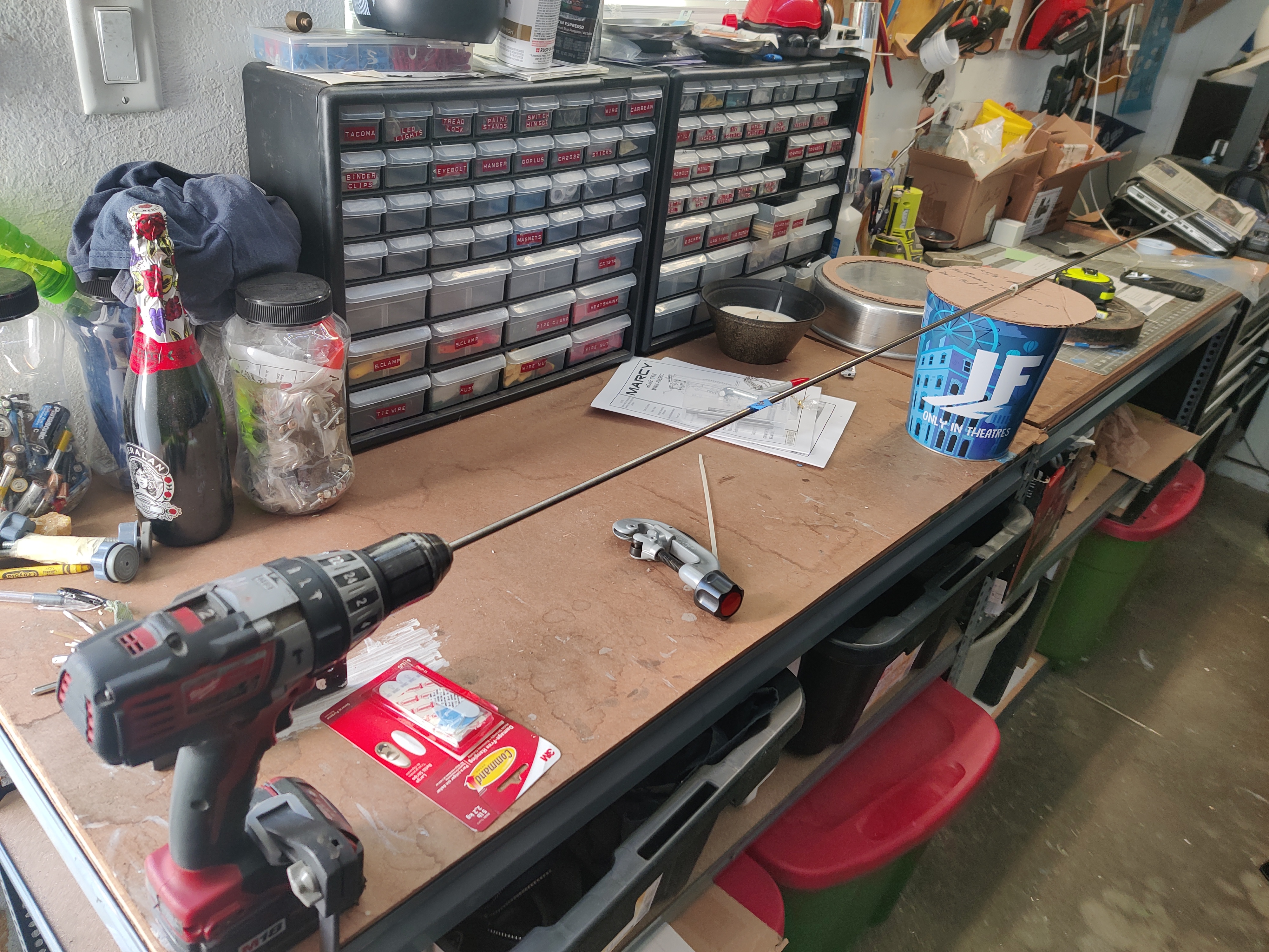

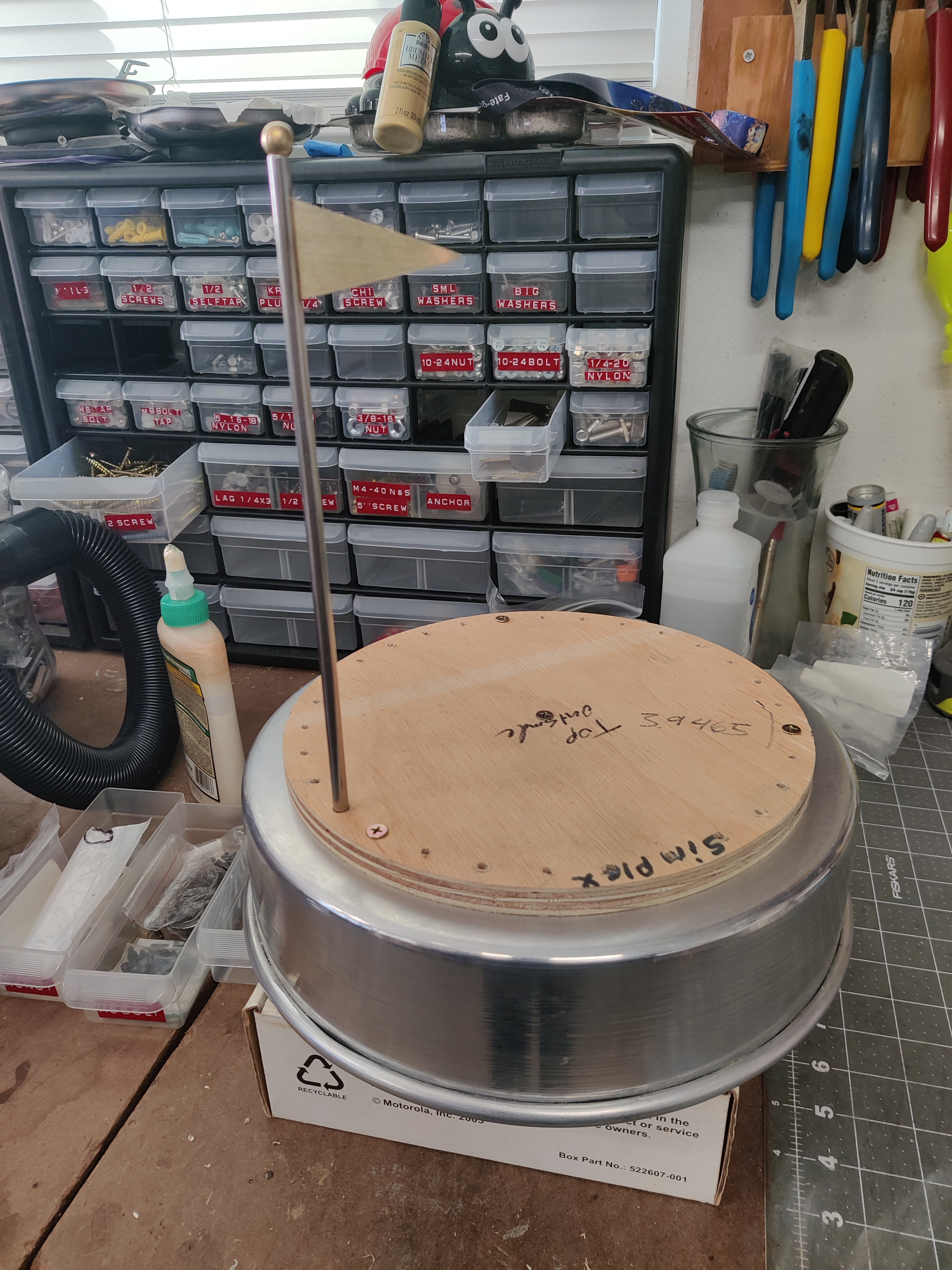

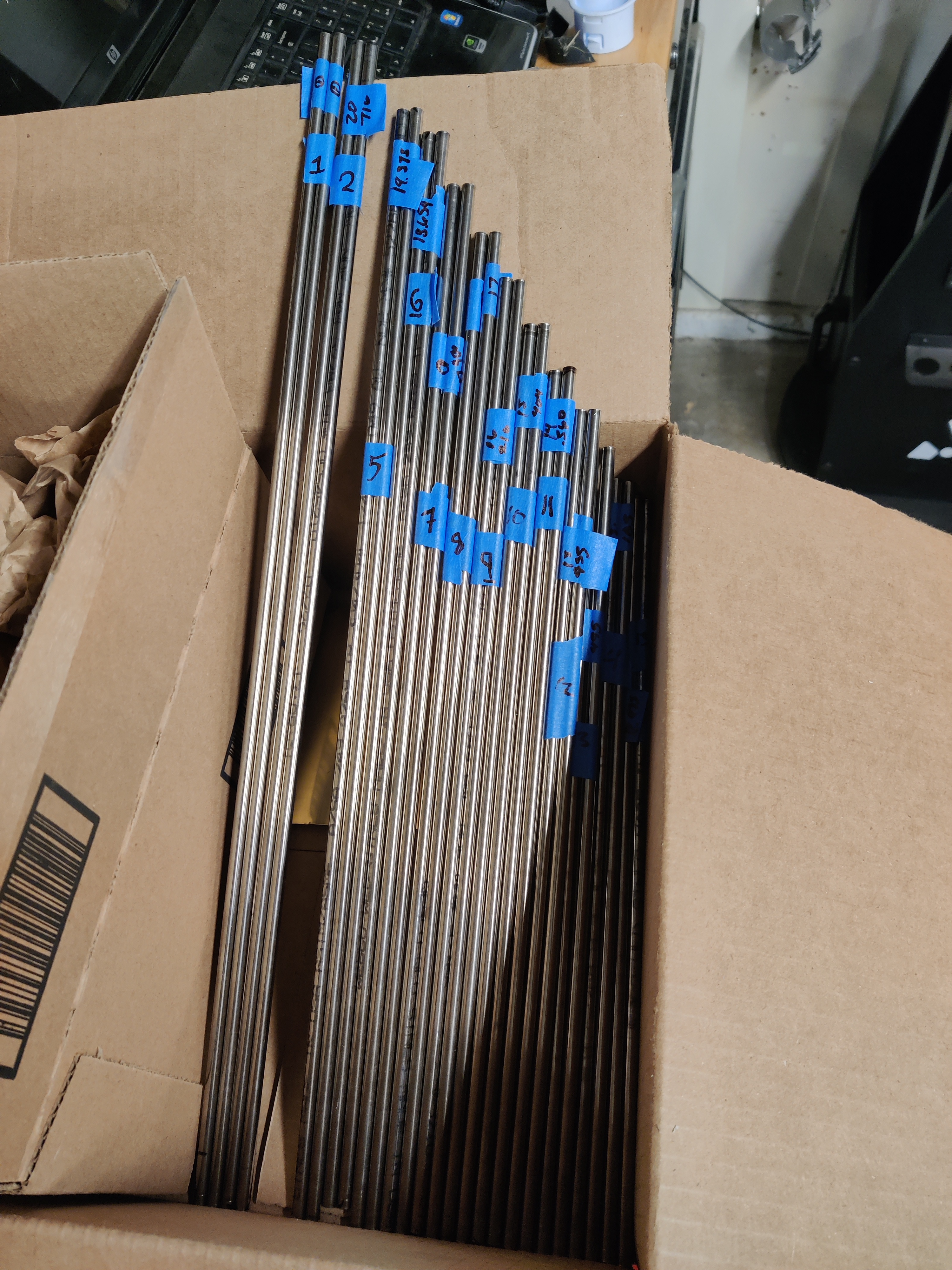

I then moved on to cutting the stainless-steel tubes, which were measured from the top of the base to the tip of the flagpole. I added 2 inches to each flagpole to account for the structural part inside the base. Using a drill and tube cutter to make the cuts, and I tapped both ends to fit 8/32 bolts.

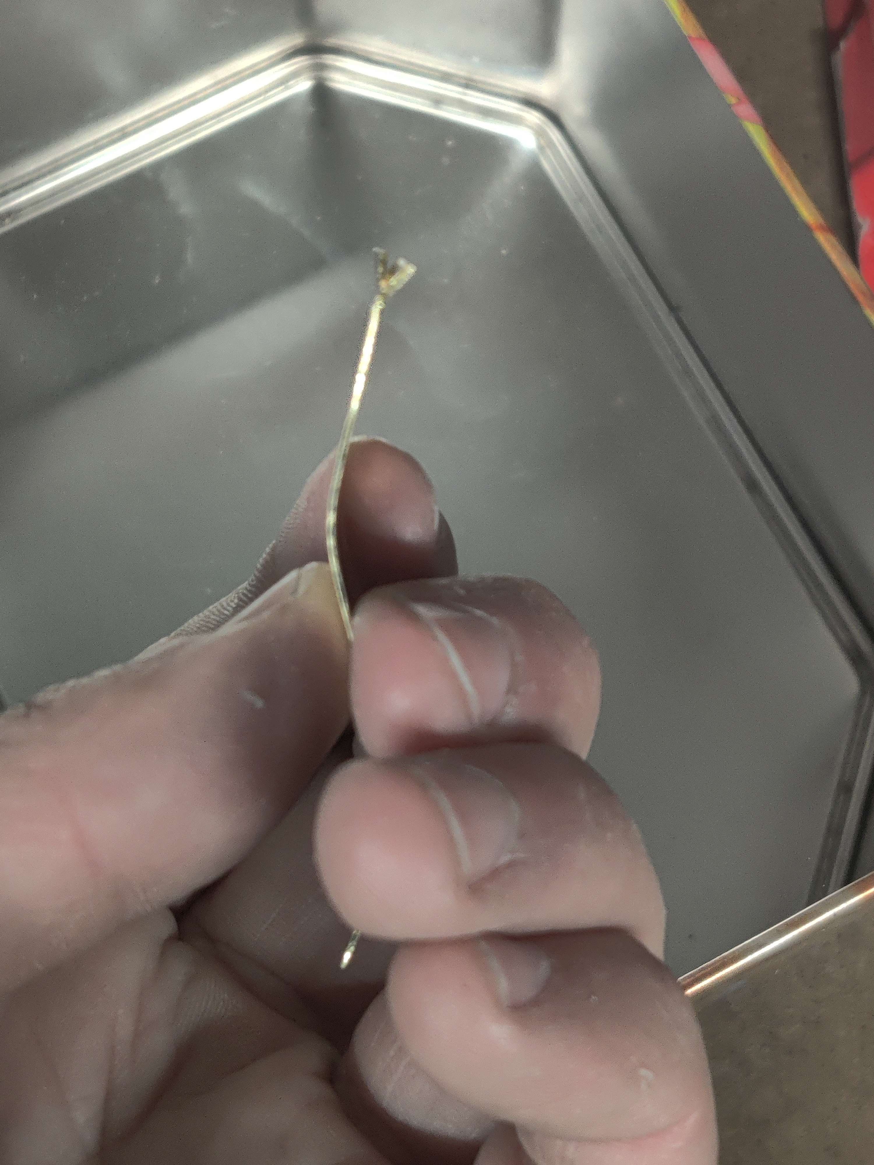

I spent about two hours cutting the slots for the flagpoles. This was achieved by attaching a Dremel cutting disc to my drill press. The tubes were held with a jig to keep them from moving. I figured out a way to attach the brass flags, after some trial and error, by cutting a notch on the top of each flag. I also added a notch to the bottom to prevent the flags from slipping off. I also cut a slot on the back of the flag to further prevent the flag from slipping out.

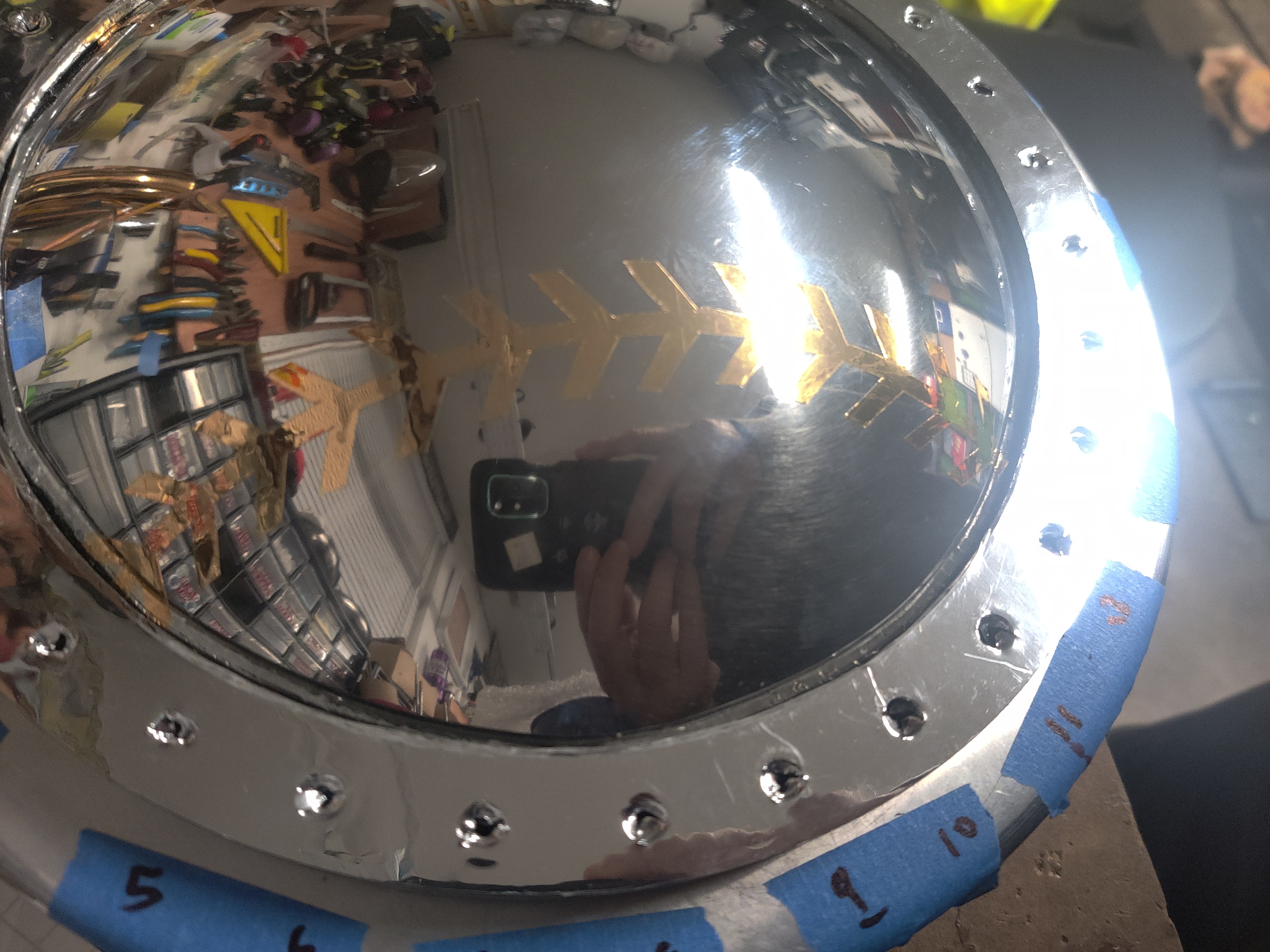

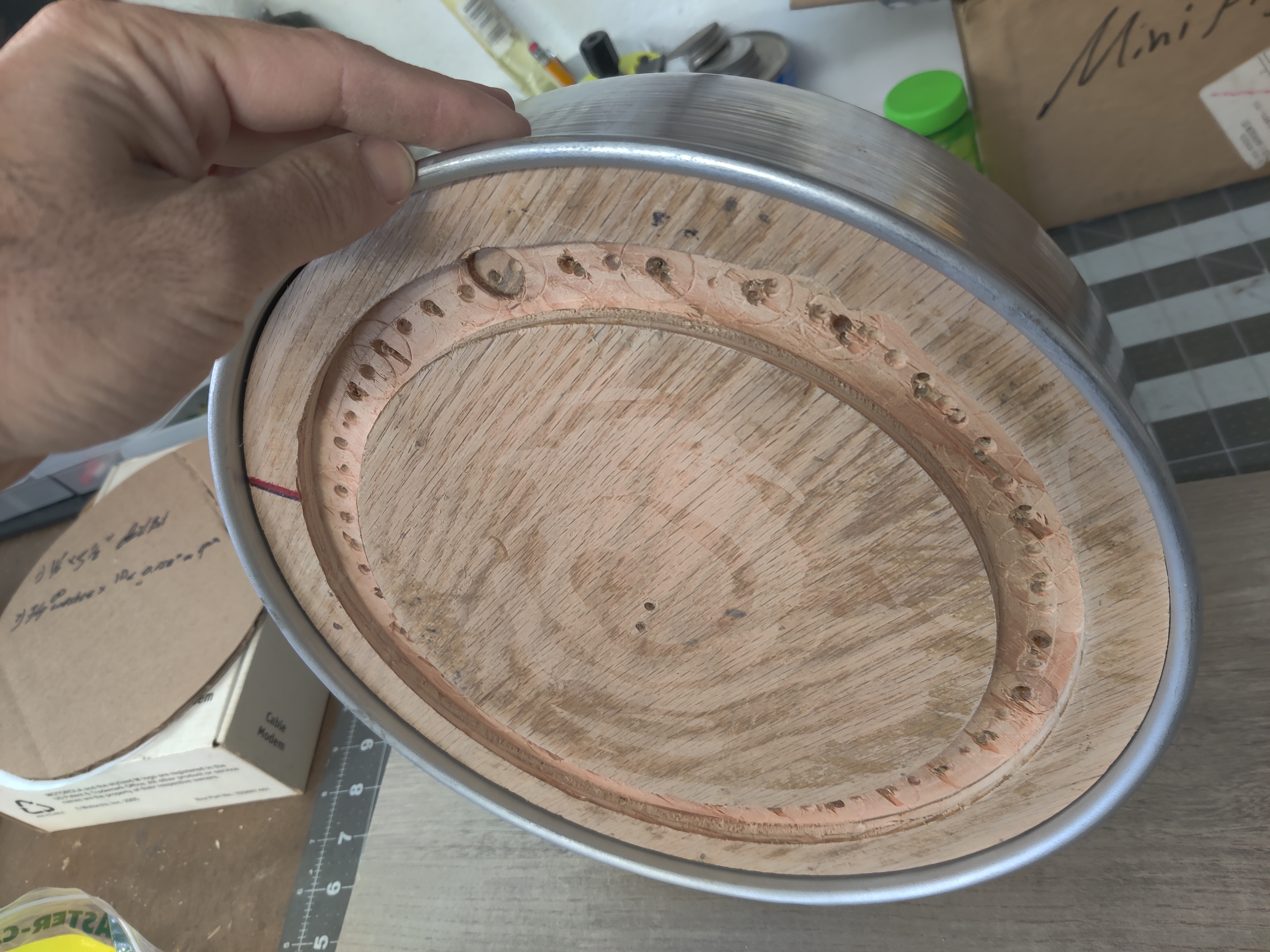

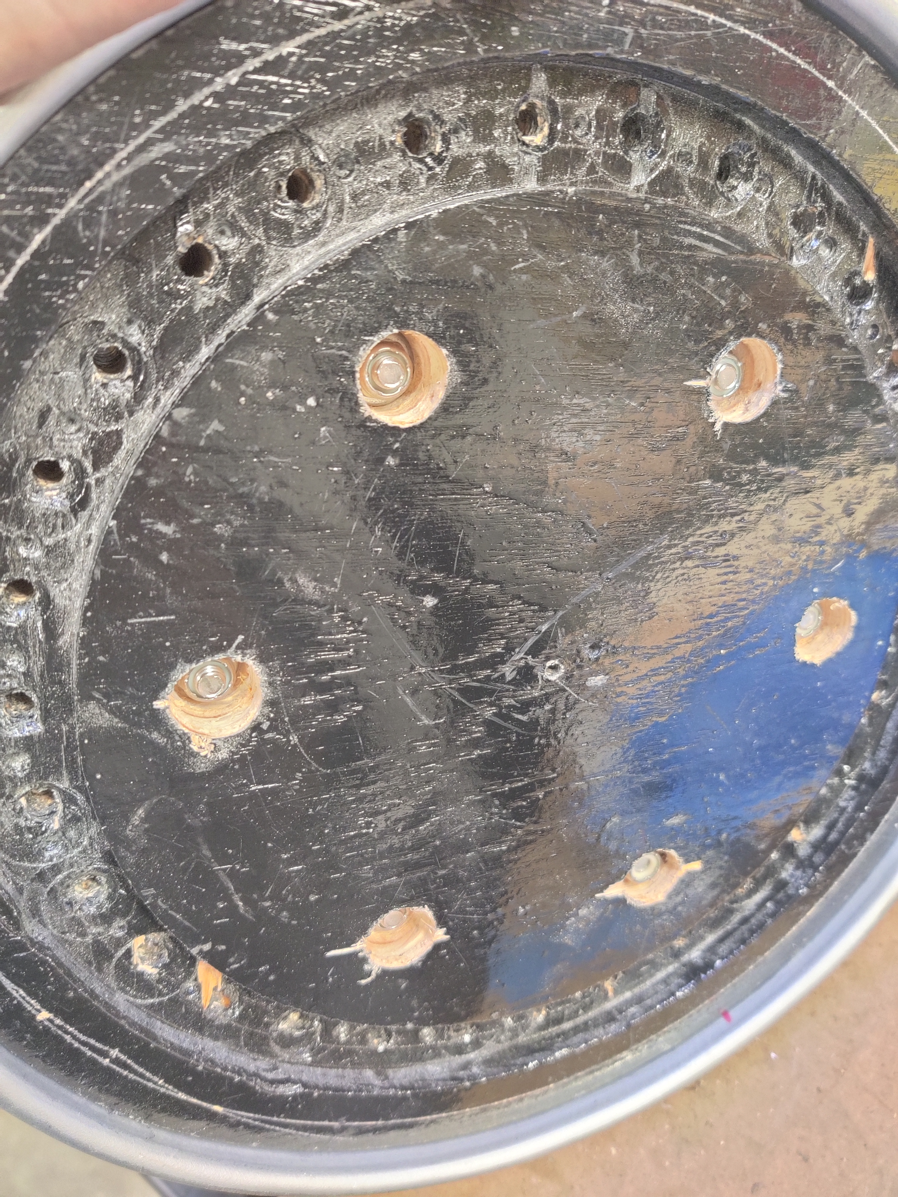

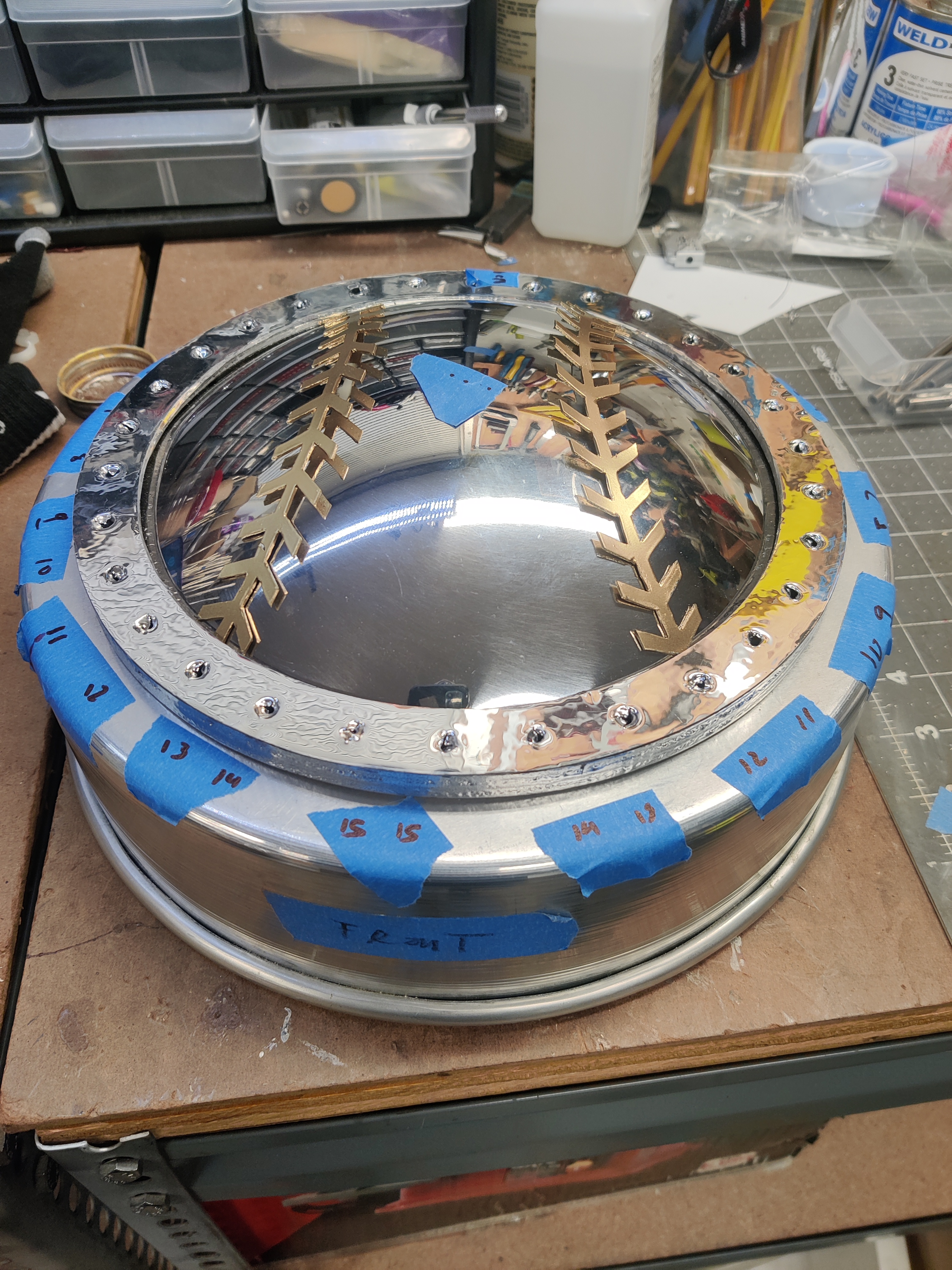

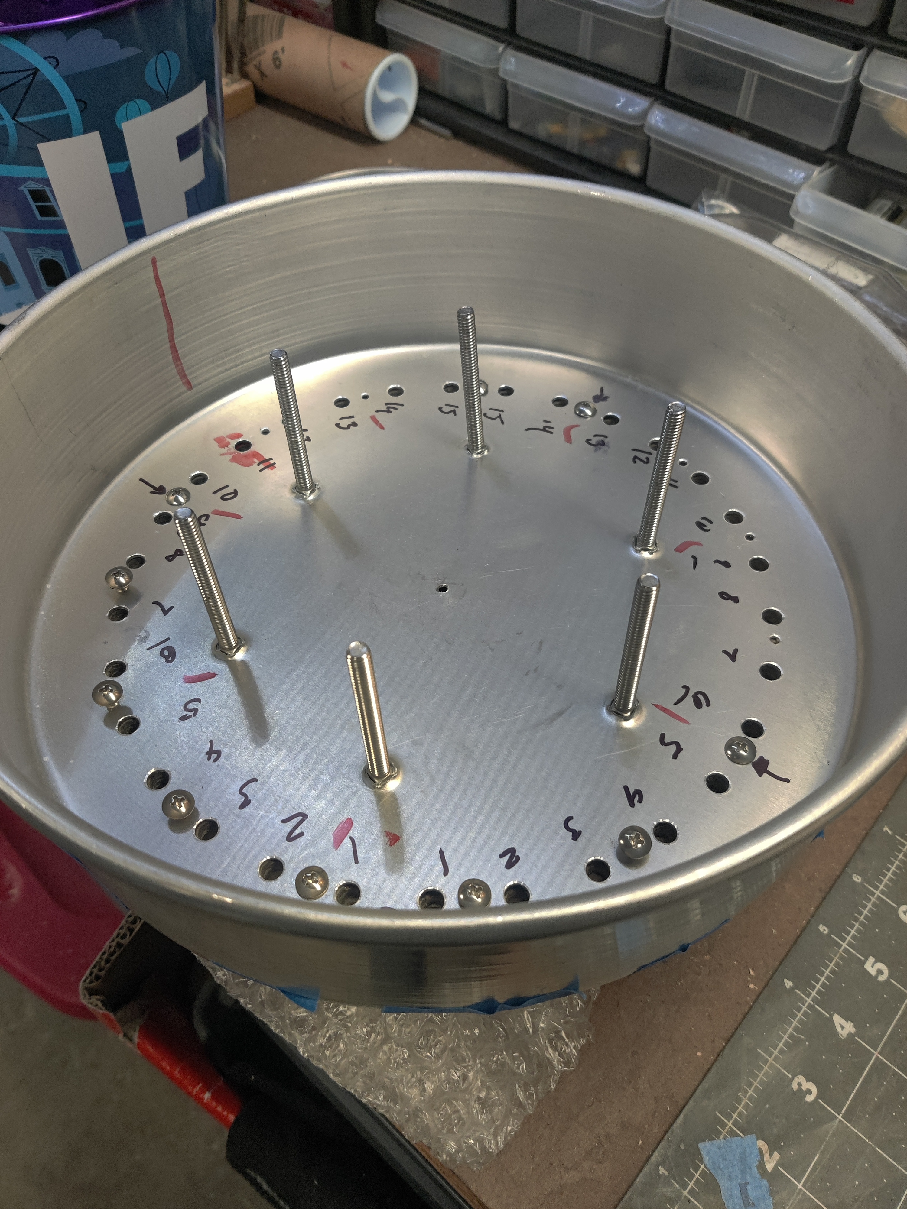

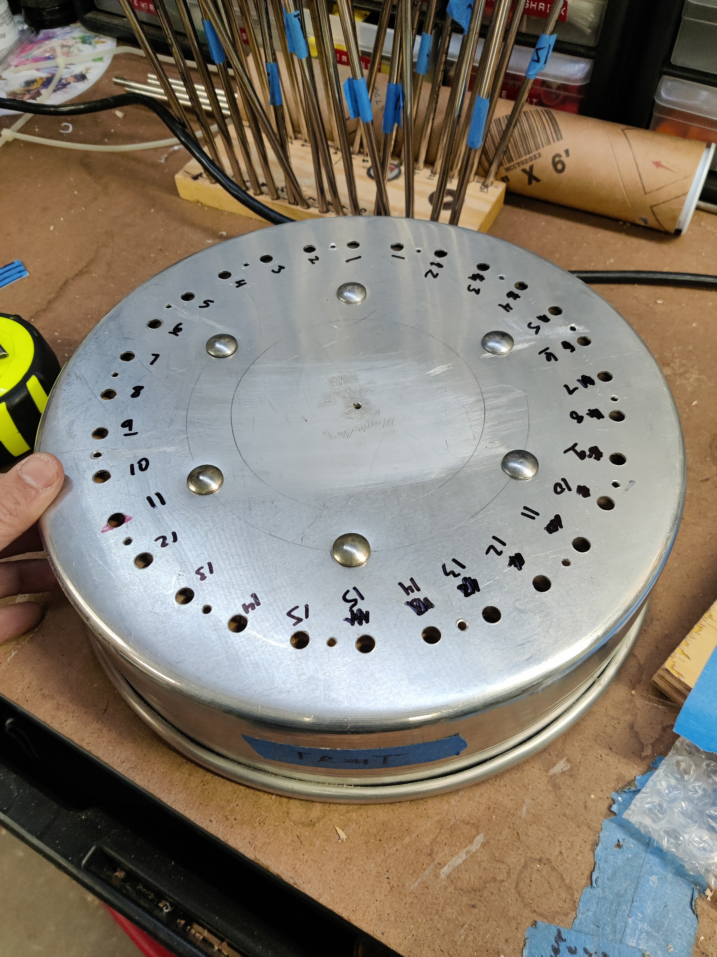

With all the flagpole slots cut, I moved on to attaching the components together. First, I drilled six holes in the center of the cake pan to secure the wood to the cake pan using carriage bolts. I fixed the plywood ring and hubcap to the base with about 18 screws from the inside of the cake pan. This process was tricky, as I had to evenly press down the ring around the ball. I had several failed attempts before finding a better solution by resting the ring on two hard surfaces and letting the ball float.
I experimented with three different methods for the baseball laces. First, I tried using brass but snipping it didn’t give the clean look I wanted. Next, I tried styrene plastic, but it didn’t look right after painting. Ultimately, I opted for chrome gold vinyl, which blended nicely into the surface. I will eventually replace the vinyl with brass when I find the right tool for the job.
I moved on to inserting the flag poles into the base by bolting an 8/32 with a washer and a wood screw to prevent the pole from coming out.

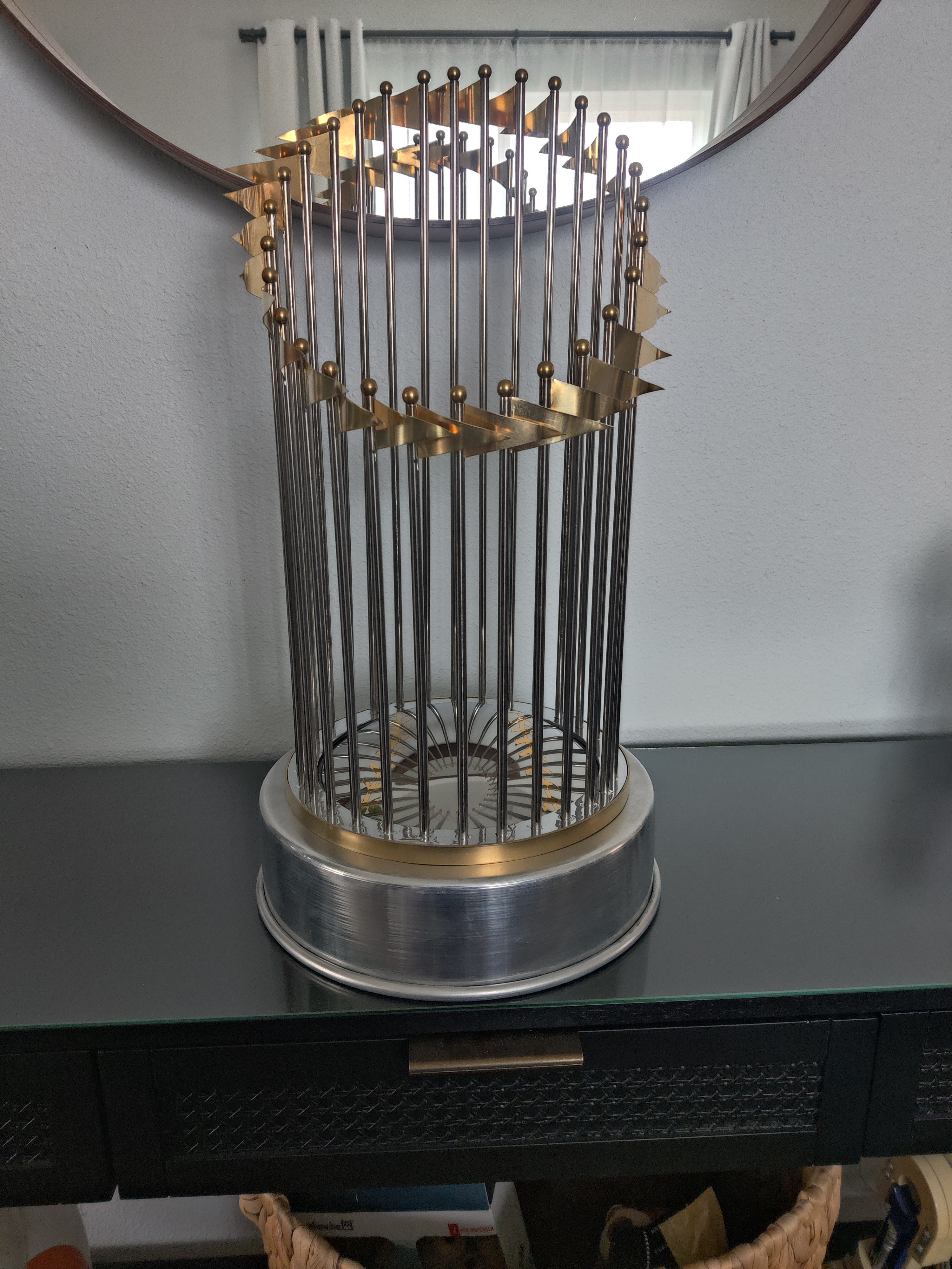

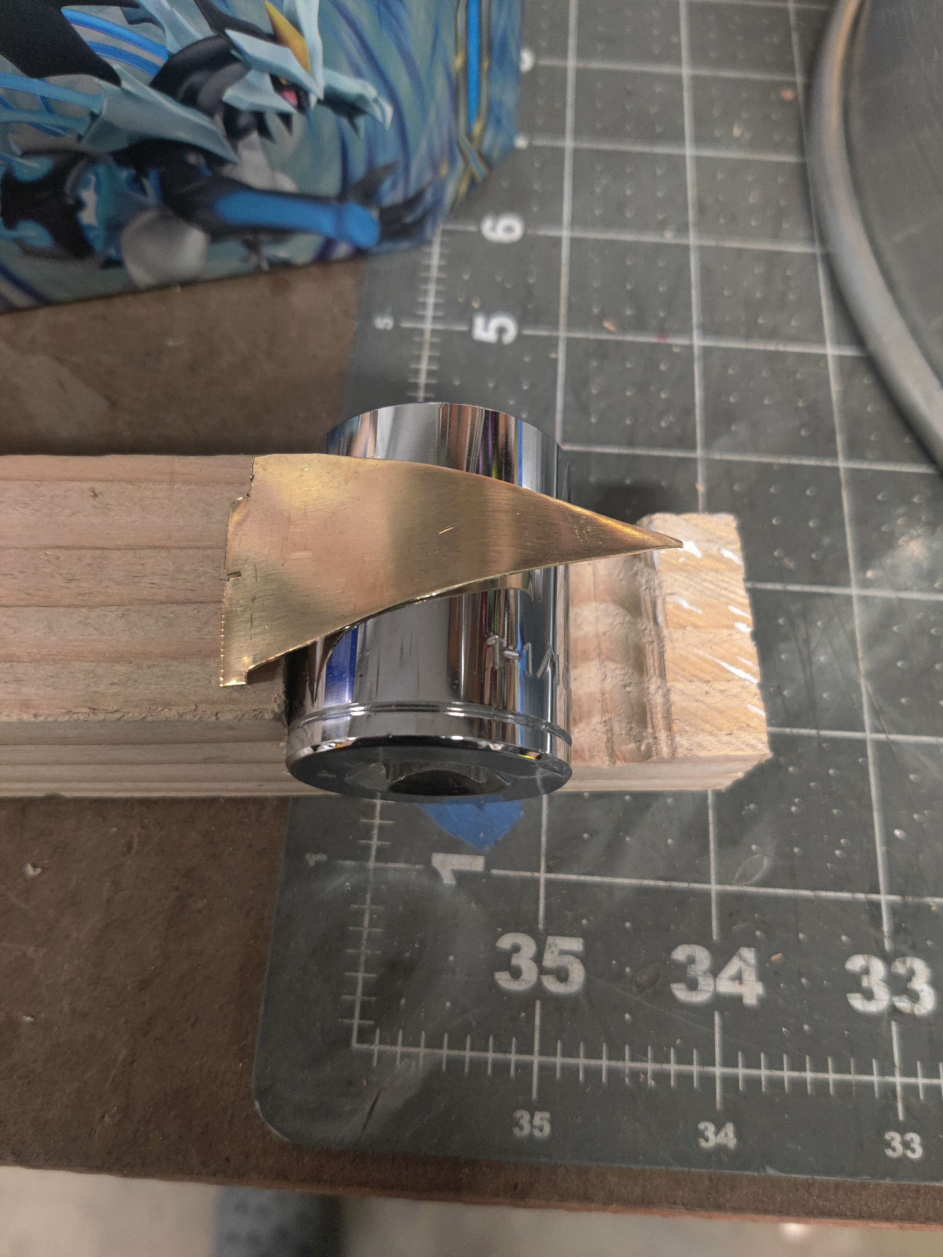

With the flag poles added to the base, I moved on to installing the flags. I started by bending the flags using a 1 1/4" socket and inserted them into the flagpole and threaded on the brass ball.
Finally, the World Series trophy was assembled!
If there are any questions or suggestions to make this trophy more accurate, I’d greatly appreciate it!
