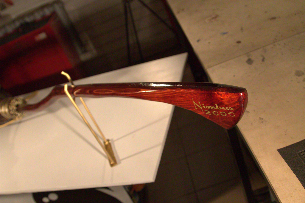

For me, the stem of this broom is the most important part. Somehow it’s a part that is mostly discriminated by other replicas. It’s actually shaped very beautifully and elegantly and even has important aerodynamically elements. It starts narrow, then goes slim, then flares out to an ellipse and afterwards goes in to the round shape again. The second part of the stem starts with an edge on top and roundness bellow and then goes to a settle sloping down. Also the tip of the broom forms kind a V shape with almost flat planes on both sides and clear edge connecting them with the top. I don’t know if I made it clear, but there is some serious broom awesomeness going on there.
Jigsaw, sander and jack-plane came in to help and after some time, the broom started to take shape. Pine being very soft, it wasn’t hard to shape, but every wrong movement left some kind of dent or other artifact. With my lower than average woodworking skills it took a long time to shape it in to the exact shape I was aiming for. After a while those planes, ellipses, and lips come in to being and it started to feel like an actual racing broom. It just felt right in the hand.
The color was a real pain. It changes constantly during screenshots. Personally I loved the color and texture on close up shots. That grain texture of mahogany was really appealing. Sadly after a lot of experimenting I wasn’t able to get it. I’ll not get too much in to it, but I tried various stains, sealers in mahogany and rowan colors, also different varnishes. Nothing was really looking right for my personal taste, although some variations looked close enough to some screenshots. I really have no idea how to figure out the actually right color, because it depends so much on color correction, lighting and other factors and I couldn’t find any quality pictures of screen used props. For example, it seemed that Alfonso Cuaron and Michael Seresin had very little red color in their palette and there is no trace of mahogany tone there.

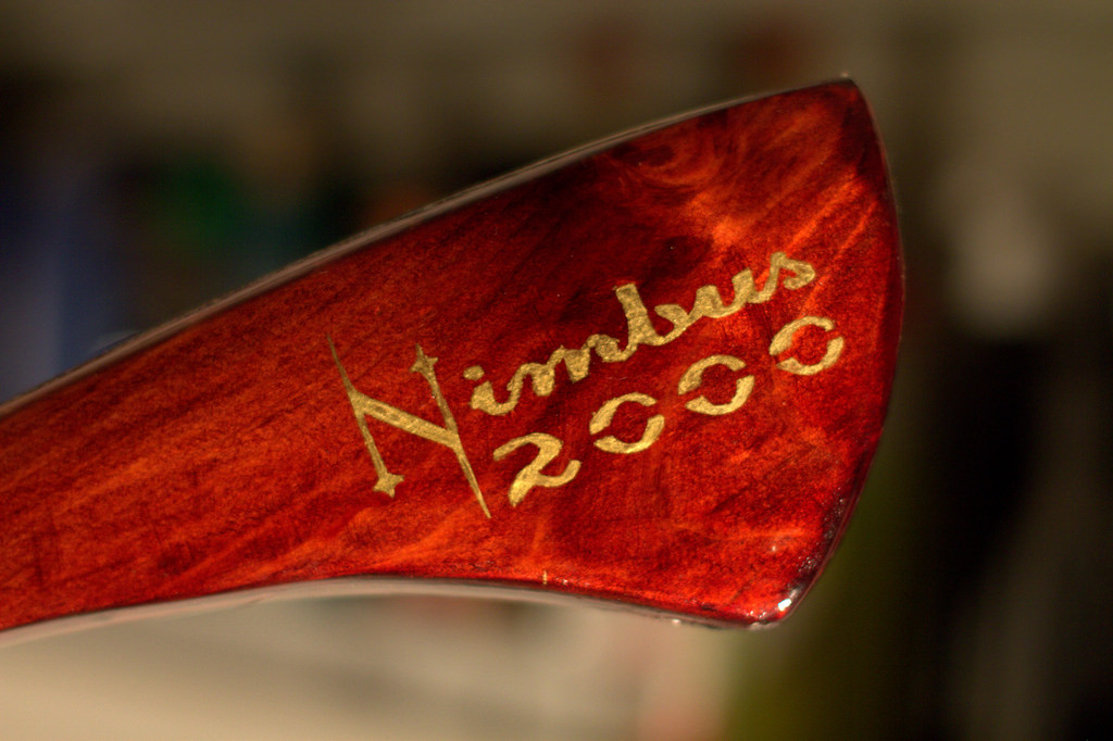

So after some stain, some varnish, it was time for the logo. X-acto knife comes in to action. I used simple label paper for the stencil. It definitely wasn’t right for this kind a job, but it’s the only one I had. To apply gold a brush was used. It would be easier to just use spray paint, but I don’t think that “Nimbus Broom Company” use spraying cans. Sadly, paint was too watery and my label paper wasn’t sealing well, so result was adequate. Better decal film, better paint or better coating was needed. I decided to cheat and use a gold lack marker. Mostly because it’s cheaper and it still gives some brush marks. The paint still is watery, but I can control it better.

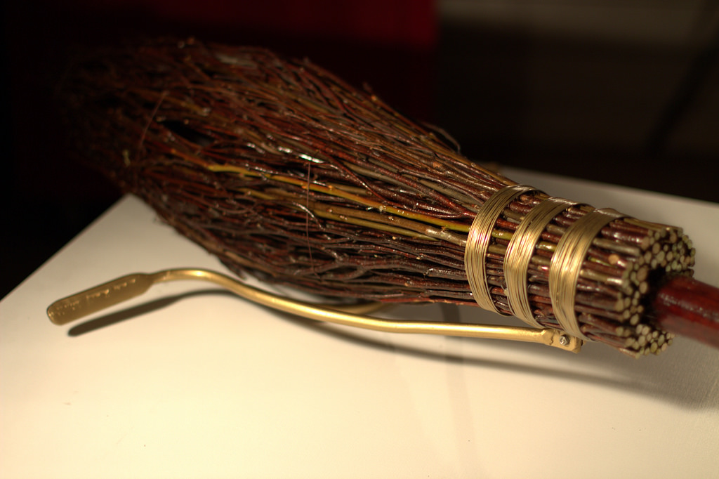

Finally we come to the branches. First – what type to use? I chose birch for couple of reasons. The broom end coloration in movies looked reddish/brownish and birch branches turns a little red while drying up. Most importantly birch branches are traditionally used to make brooms in Europe, so story wise, it seemed like the right thing to do. Willow could be a choice too – it has nice coloration, long straight branches, which are bendy and just thick enough. Using willow may have been more screen accurate and for anyone trying to get that exact look, it’s the way to go. It’s just that nobody makes real brooms from willows and while cleaning brooms and flying brooms are kind of different, they are both made for sweeping. One is for sweeping dirt, the other is for sweeping out the completion! Also, if we would take the only shot where the anatomy of broom end appears (in Alfonso Cuaron’s HP3) the branches closely resemble branches in actual brooms.
I bought couple of brooms made from birch, but was not happy with them, so went for a collecting mission to find nearby birches. After some time, I managed to distinguish four groups of different types of birch branches. Those types were – young, dried up, grown and broom. Young branches bend beautifully, but were too short. Dried up branches break while bending, but have the right color. Branches from grown trees are good in length, but color is not right. And in the end it turned out that I wouldn’t be collect enough of any of those… (Insert grunting noise here). This meant a lot of sorting and trimming…
Willow branches:
Different types of birch branches:
After the right amount of branches it was time to begin shaping them. Over-sized clamps came in to help here.

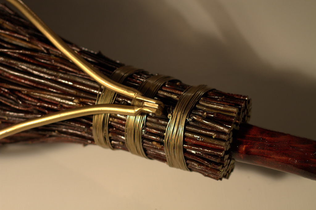

Real brooms do not use glue to hold them together, so I wanted windings to do the actual job here and not just be an accessory. First I tried a 3mm hard wire, but it was way too hard to wind up in an elegant way. Something a little softer was needed here. Then I tried plastic covered wire which actually looked quite good, but it felt wrong to use something with plastic. Finally I had to settle on thin stainless steel wire because it’s soft enough to be wound up quite elegantly, although it’s definitely not thick enough. I should have used aluminum wire, but it just was too expensive.

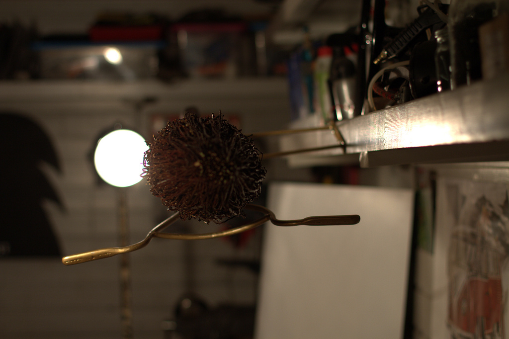

To keep windings in place I looped the start and the end on the nail, which then went in to the stem. It may not look very good, but it looks archaic technology, which was ok story wise. To keep the shape of the broom I colored some white string with mahogany stain. It’s thin enough not draw attention and hides itself pretty well among all the branches.
To avoid using spray paint (although I already did when painting leg retainer…), I again used a brush to color the windings. This was not the cleanest way and I should have done better more diligently with winding and painting.
Broom end was varnished a bit, to give it some gloss, like in the movies.

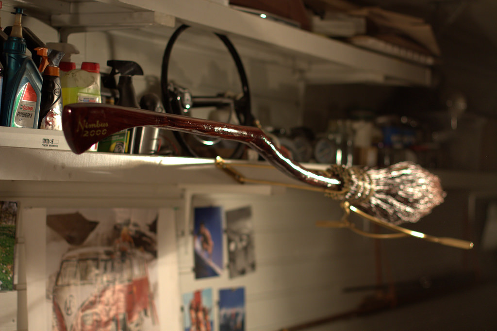

To finish it off a broom hanger was needed. I know that one must hang his/hers broom with branches facing downwards, but I really wanted it to be in flight-like position. At first, hook like design came in to mind, but with my primitive metal bending skills I wasn’t able to make it hold the broom stable. Then I just reused some scrap metal and made an easy two point holder.

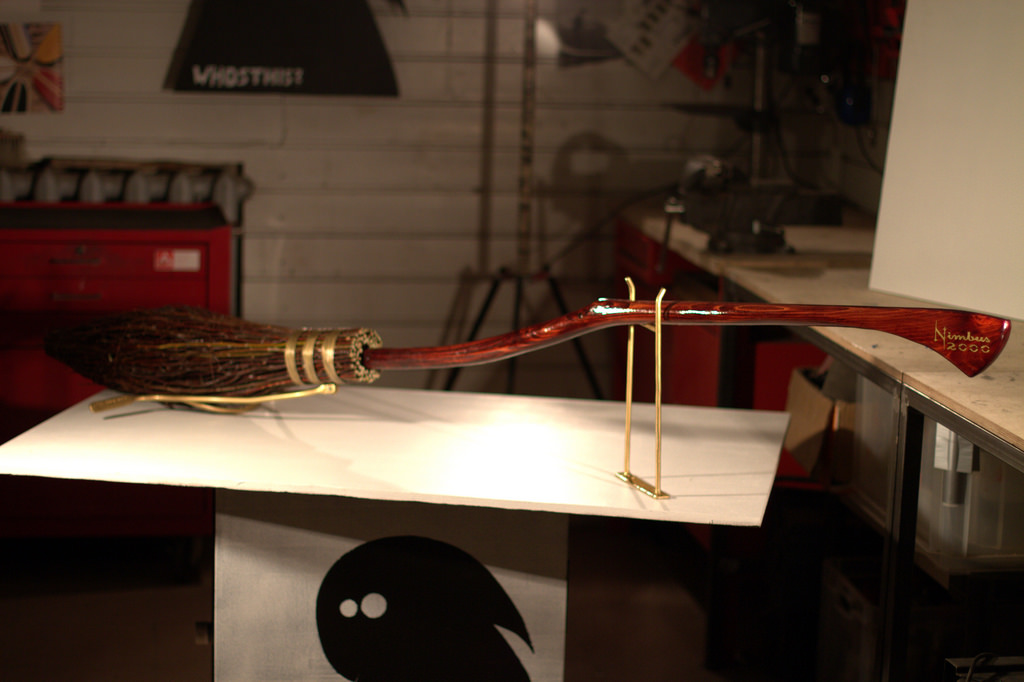

Results:
In the end I made more exceptions than I wanted in building process it doesn’t look exactly like the real one. Someday, I hope I’ll get to make one from real mahogany and not cheap out on all the other details, but for now this is it.
In the end, the most important thing about the broom is not how it looks, but how it works. UP!
