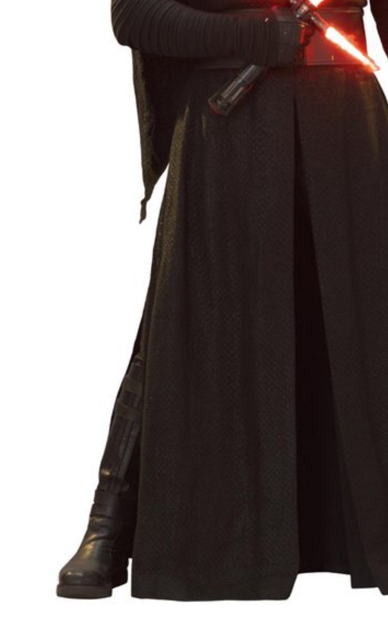

Looks like the same boots looks like as Kylo, minus the strapsView attachment 570688
They do look similar, but when you look a bit closer at the details around the ankle, you can see that Kylo's boots have a lot more detail than the new FO Officer boots (more than just the piping and straps up the front I mean)
You can see there's a seam right at the ankle running down to, I think, the sole which isn't present on the FO Officer boots, unfortunately

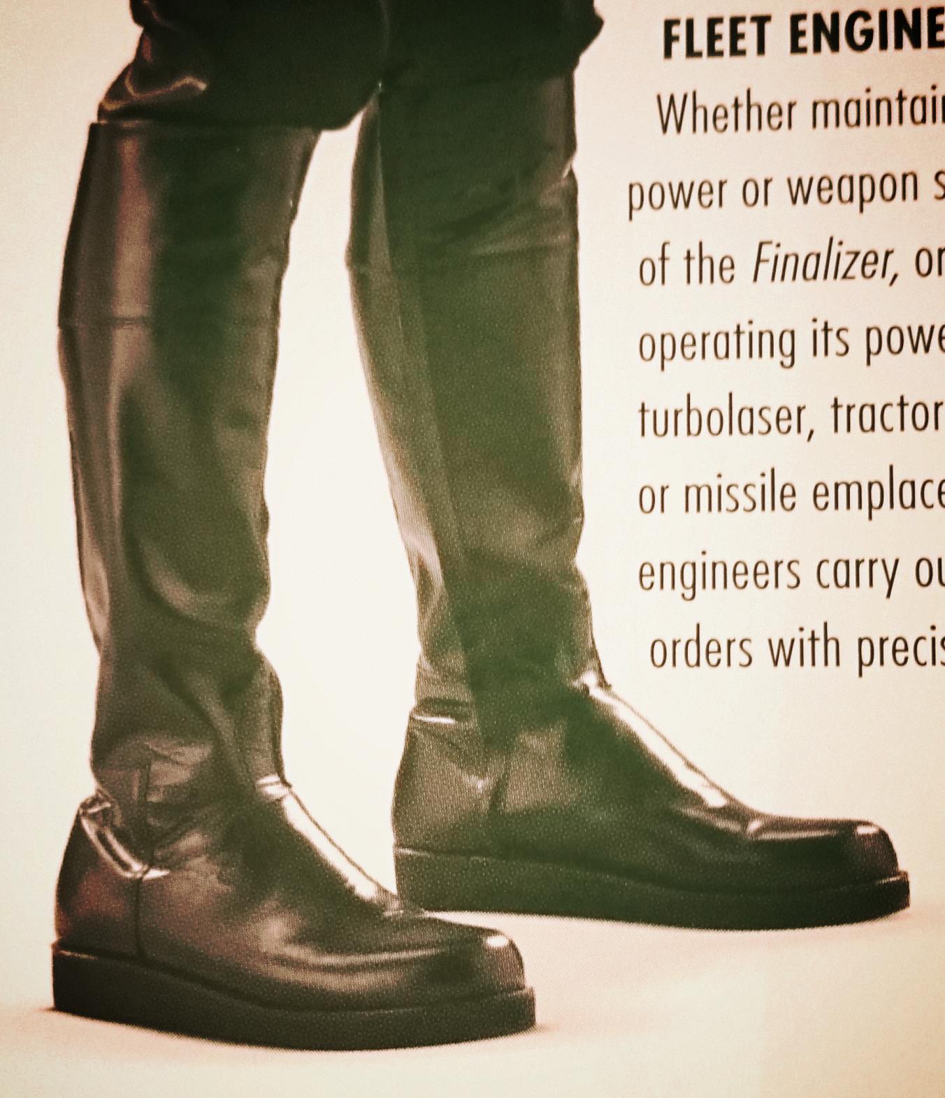

So, the Boots, I think are something that really wants a lot of research, as there is a very real chance they're off the rack, what with Rey's and Poe's boots being from PoZu, as well as the snowtrooper and X-Wing pilot boots being off the rack too.
What we know about the boots:
•Single piece sole, thickening towards the back, like a tradition heel lifts on riding boots
•Large trim detail on top of boots (I estimate this to be about 4" tall, but it's only an estimation)
•Zip on the inside of the leg, hidden by a leather flap
•Completely plain Vamp, with rectangular tongue with rounded corners
•Square/Rectangular Hell Counter, flat top creating a seam into the boot shaft, and straight edge on the side of the feet ending at the zip area on the inside, and showing as a seam onto the vamp on the outside.
•All seams are sewn with a double row of stitching
There also seems to be a stiffer leather, or perhaps some form of interfacing (not sure of the correct term for footwear) which causes a much stiffer shape around the foot, almost as if the boots are built over a pair of shoes, as can be see in this photo:
So, with this information, I think it may be a good base to begin looking for a pre-existing boot, now just to figure out where to even begin looking, or how!

Riding boots tend to have a separate heel - to keep your foot in the stirrup. Hux's boots have a one piece sole.

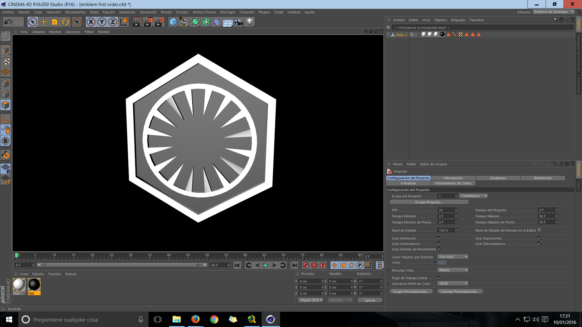

I made this First Order insignia to use in the hat. I hope to be helpful.
Looks great!
