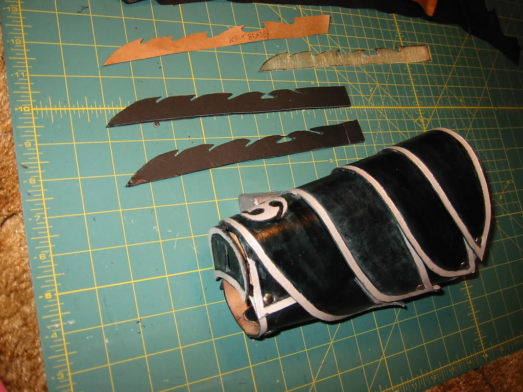

What I did for mine was make it out of leather, three layers.
First layer is the standard bracer like for renaissance faire, that has velcro along the closure and snaps for added security.
The second layer is rivetted to the first, and forms the gauntlet outer layer.
It can be an arched shape for a blade gauntlet, or rectangular for a bomb gauntlet.
The last layer is the decor if desired; this also is rivetted to the first layer.
Here's a picture of my wristblade gauntlet, you can see the first and second layers near the front, with the 4 decor layers over all.... there's a piece to hide the blade mechanism but it kept coming off so I painted the end of the mechanism black:
My bomb gauntlet is similar; if there wasn't decor on it, I would have cut a flap in the top for the lid.
Leather can be wet and shaped to what you want, and it can be dyed various colors to match the rest of the armor :D
(Tandy Leather Factory is a good source :) )
