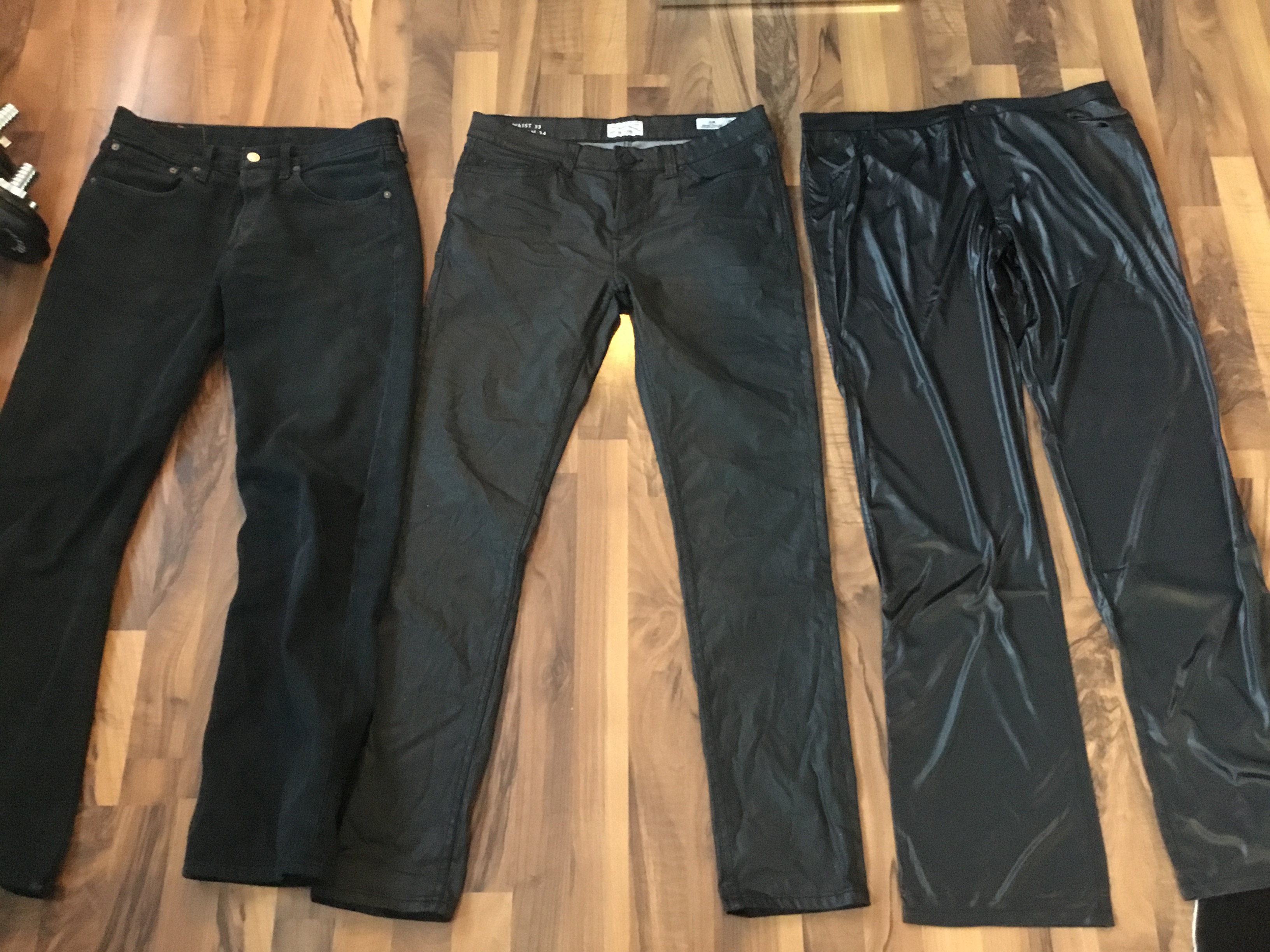

A little update on the pants.
I got my hands on two different pants. One is a wax coated jeans, and the other one is a full polyurethane one. I'd like to hear some of your opinions which one is better.
so from left to right: normal black jeans for comparison, waxed jeans, PU jeans.
I thought about doing PU for mine, don't know which is more accurate, but I want to do the waxed.

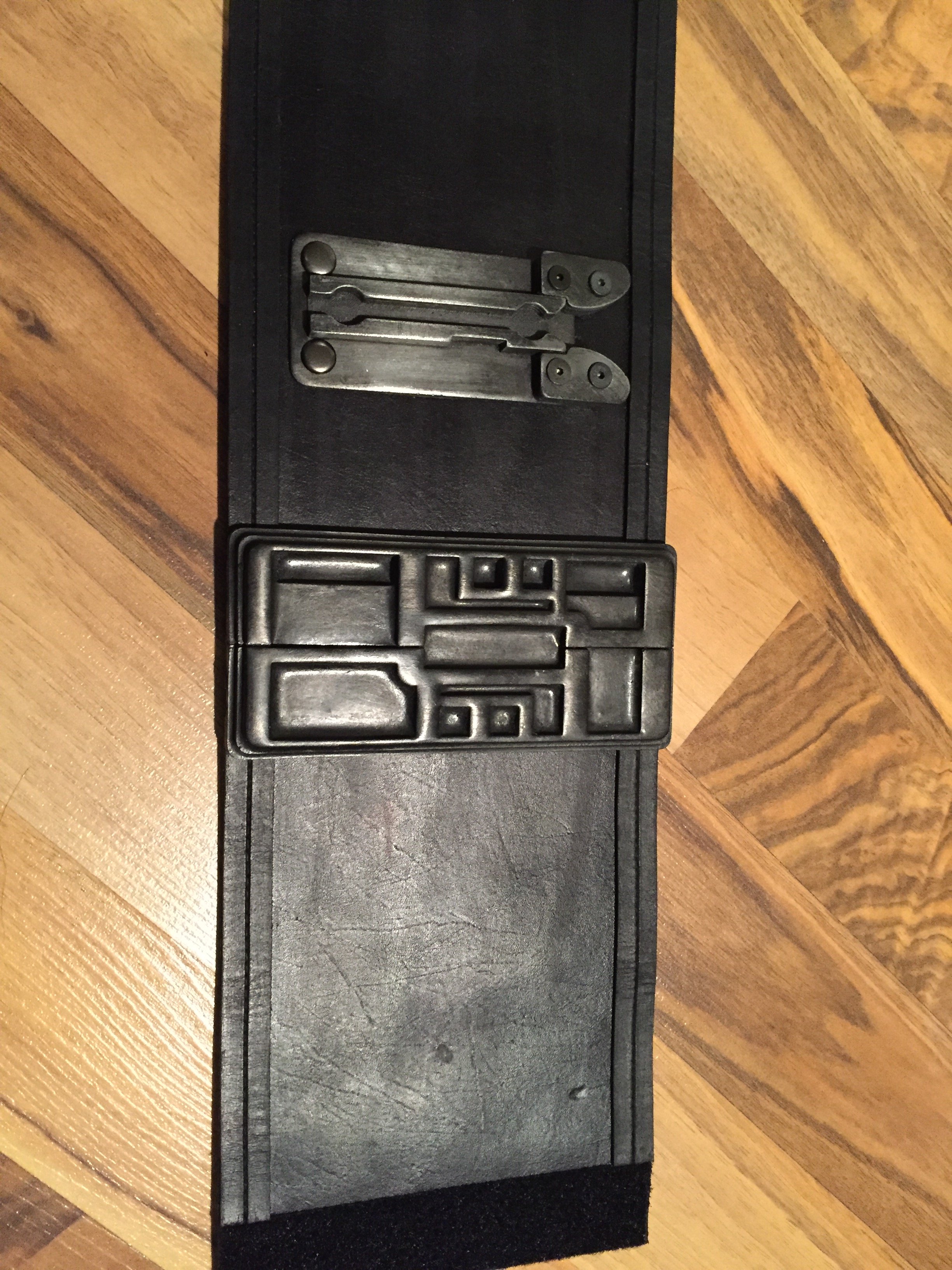

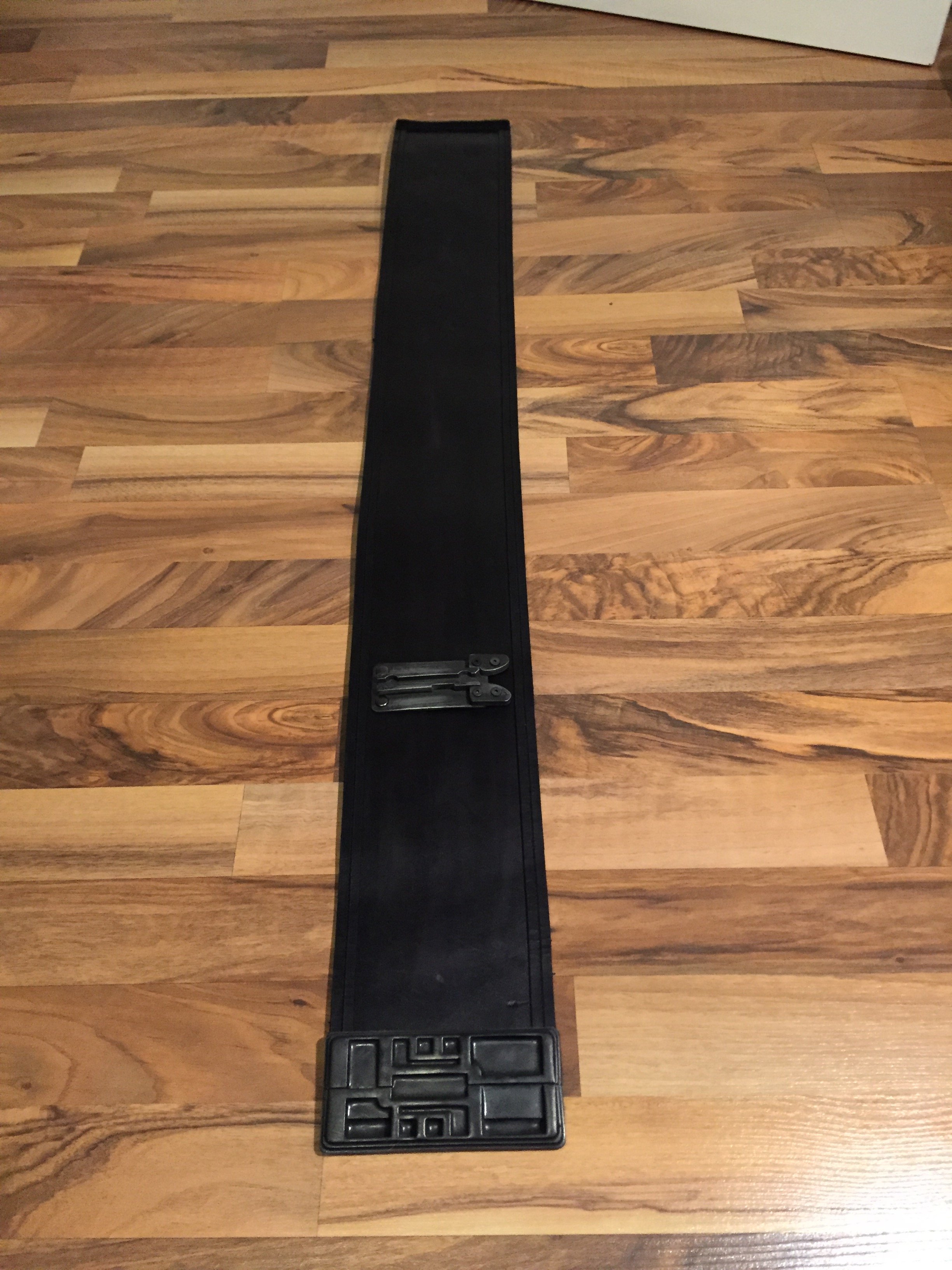

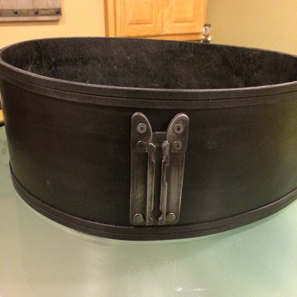

So, what I got was my awesome new belt from PHProps.
First something about the whole ordering process.
Paul frequently sent me updates, and asked how I want my stuff.
He also instantly answered all my questions.
So the customer service was excellent!

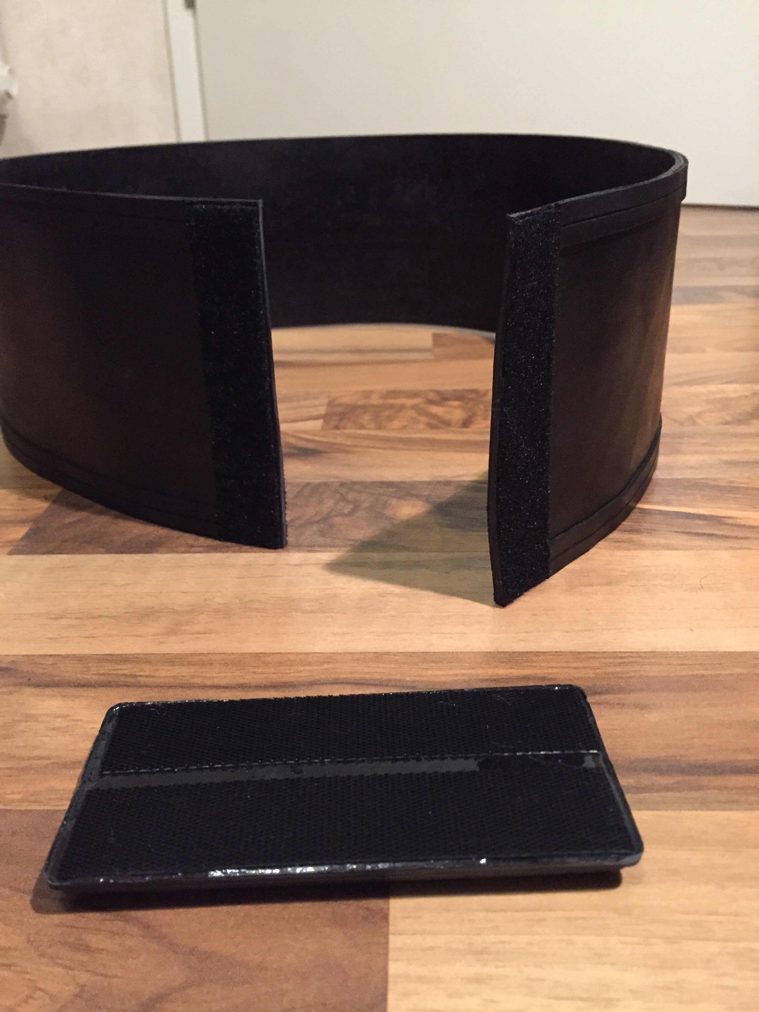

There's not a lot to say about the belt. It looks awesome, it feels awesome, it smells awesome.
Real leather, resin cast buckle and saber clip. The leather has a very light used look to it.
The buckle is holding the two ends of the belt together with Velcro.
The saber clip is bolt onto the leather with metal screws and rivets.
Overall I'm very satisfied, and would definitely buy from PHProps again!
I'm sorry, my crappy camera doesn't do this piece of art justice.

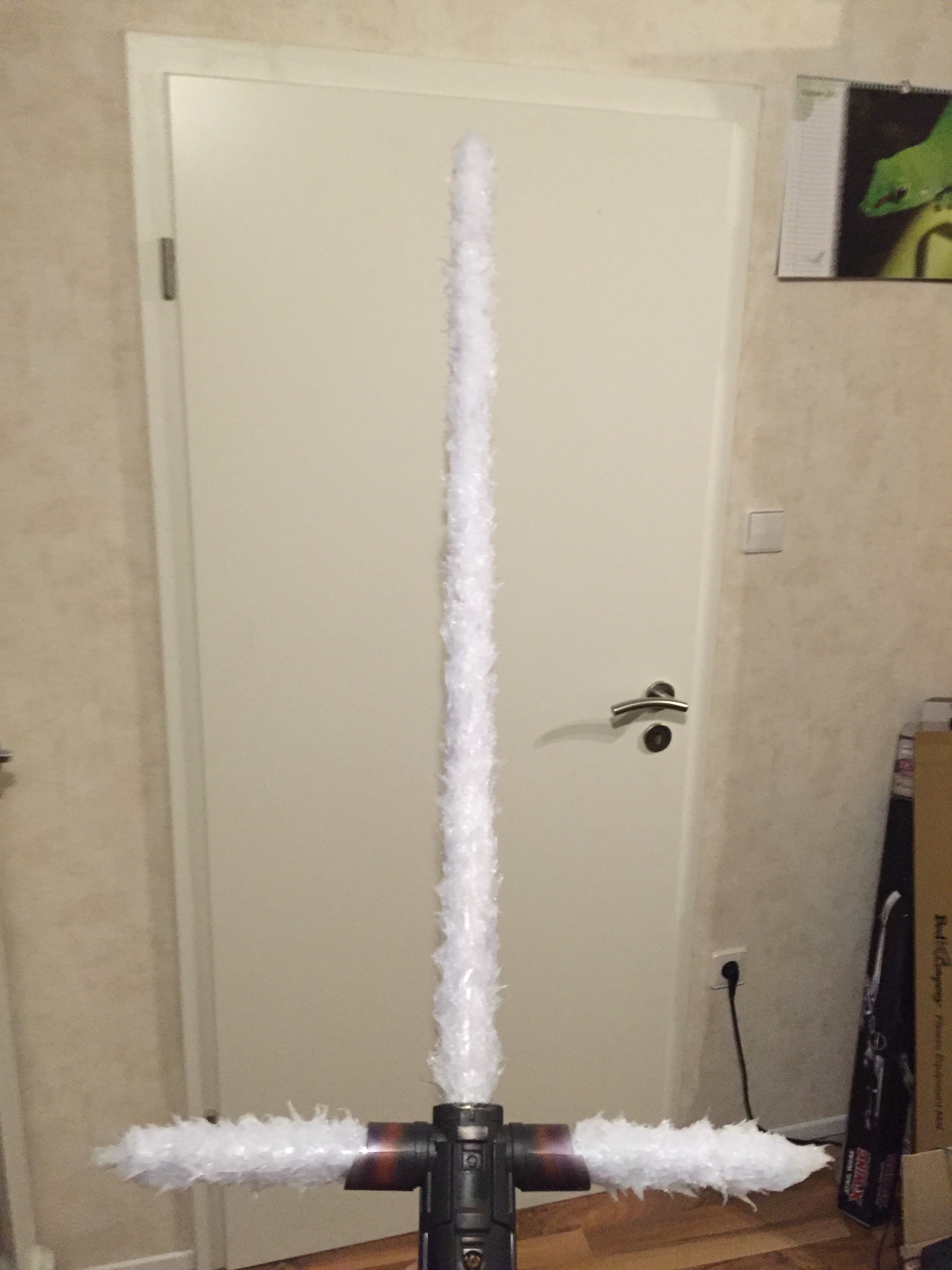

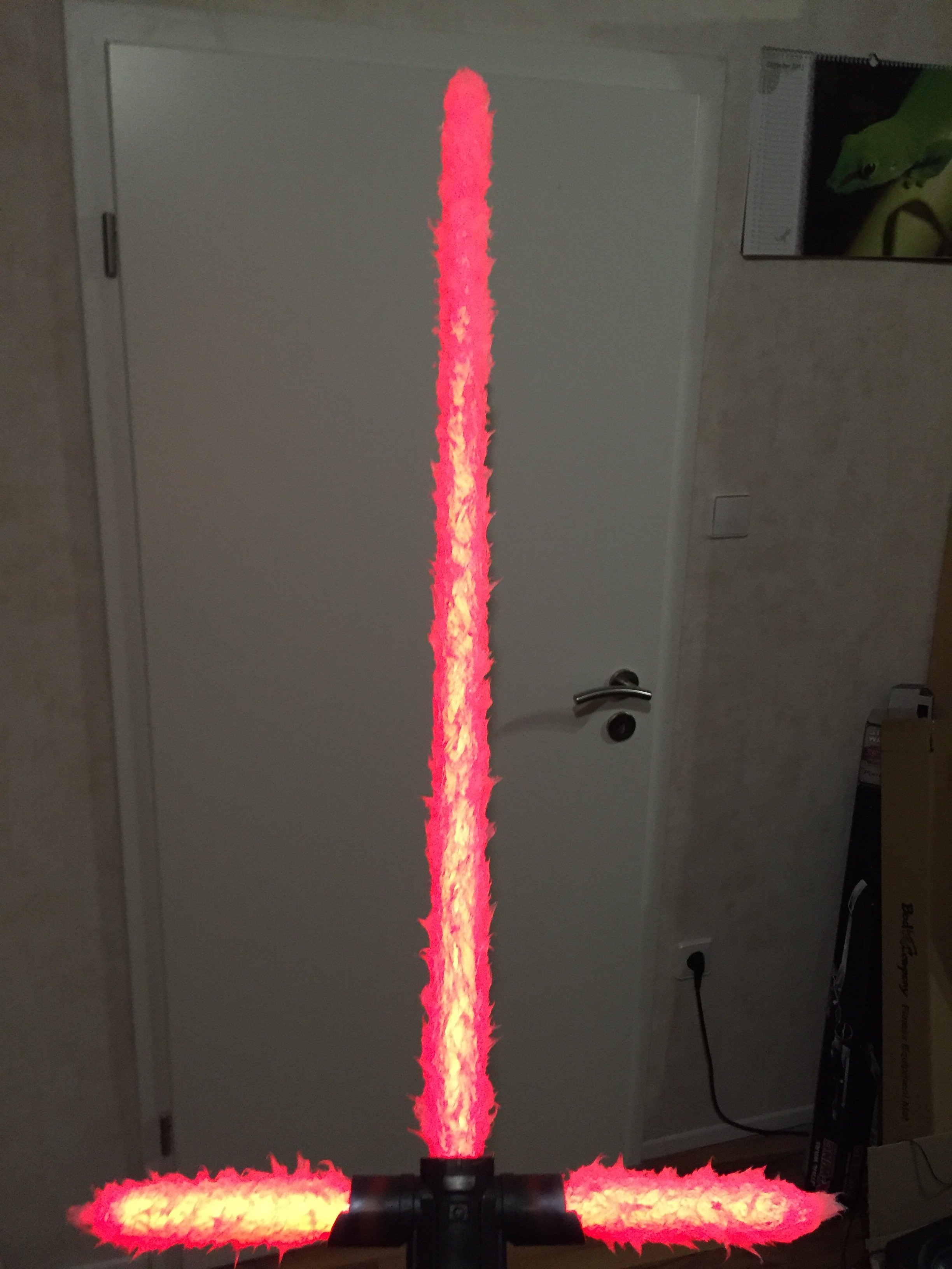

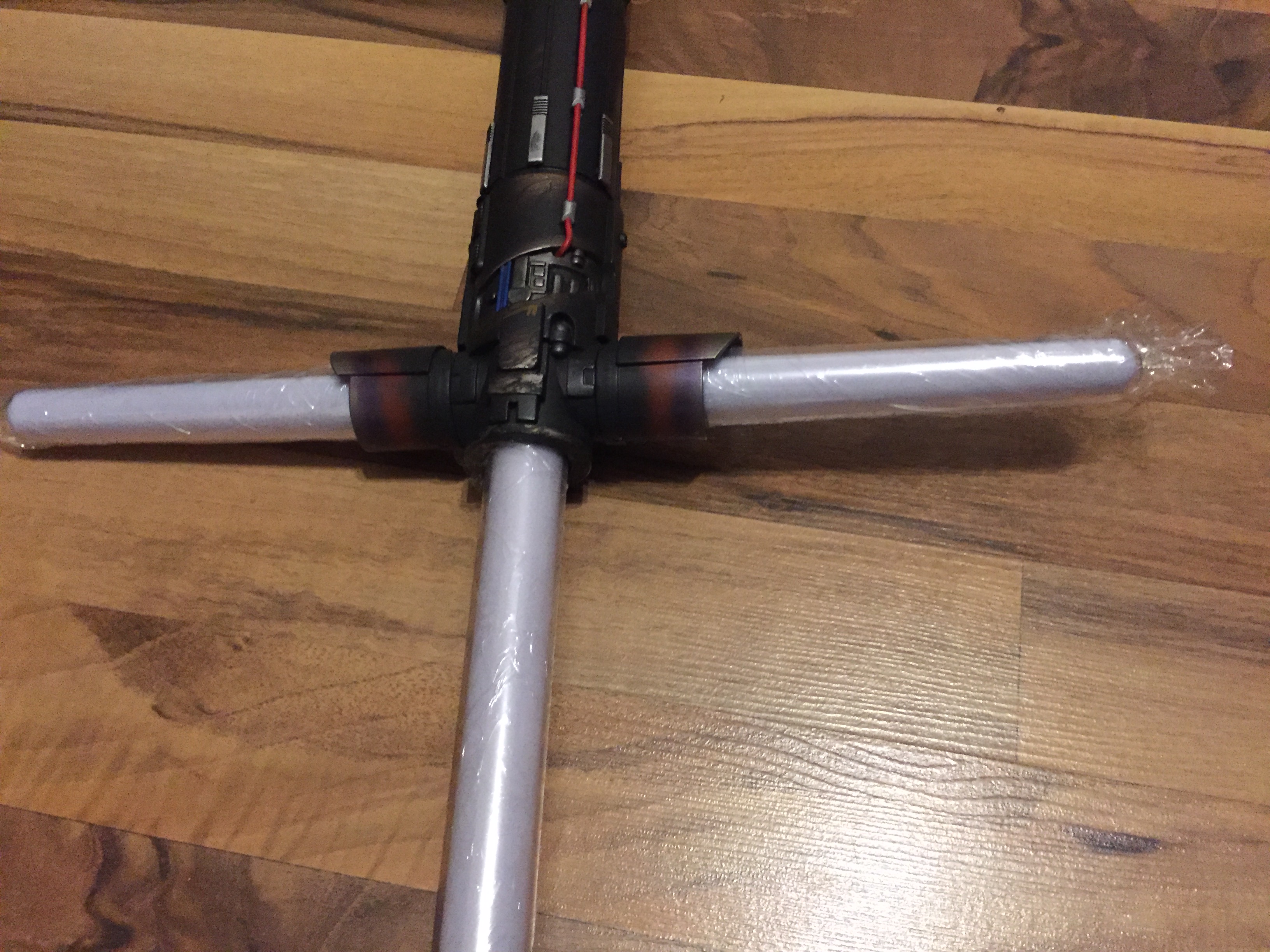

I finally decided to mod the blades of my force FX saber with the unstable look.
I didn't want to ruin my saber, so I wanted to do something, that is reversible.
I looked everywhere for the fluorescent tube covers, but couldn't find them.
But then today I saw my wife in the kitchen, using some plastic wrap. (The stuff you use for sandwiches, and so on)
That was the solution to my problem.
I wrapped the blades in the plastic wrap.
Next I put some clear silicon on it.
If you want to do this, work in small segments, and do the main blade in one run.
I started by covering a area of about 10 - 15cm with silicon, and then used a jagged piece of wood (a plastic fork works well too) to get the flame effect.
First I pulled it upwards, to get an even distribution, then I worked it crosswise, to make it look more natural.
Finally I "pulled" the silicon away from the blade, to get some spikes.
The advantage over hot glue is, that you have a fairly long time to form it, until it hardens, so you can try different patterns, and correct some spots you don't like.
Just try not to touch it with your arms, or hit something with it. it's one hell of a mess...
That way I worked my way along all the blades.
On the ends of the blades, I twisted the plastic wrap with my fingers. I put some silicon on it, and then pinched it from the side with the fork. Then I twisted it again. Together with the silicon, it will give a nice ending.

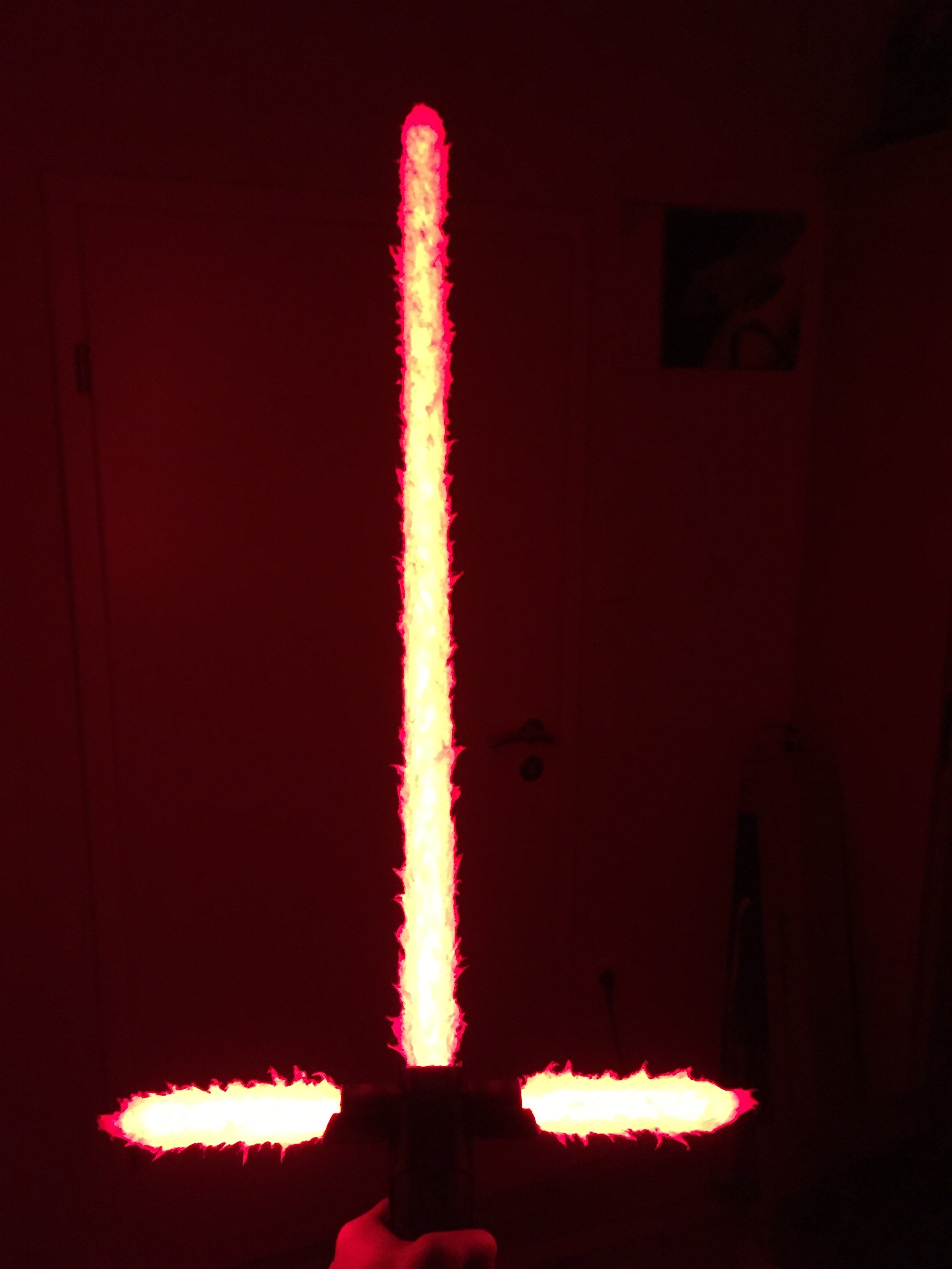

Thats how it turned out. (The blade looks shorter the pictures because I took the pictures at an angle. Otherwise I wouldn't have been able to get the whole saber on screen.)
And with the power on:
And with the lights out:
Now I think about maybe covering it with a clear red color for a better daylight look, if I find a suitable one.

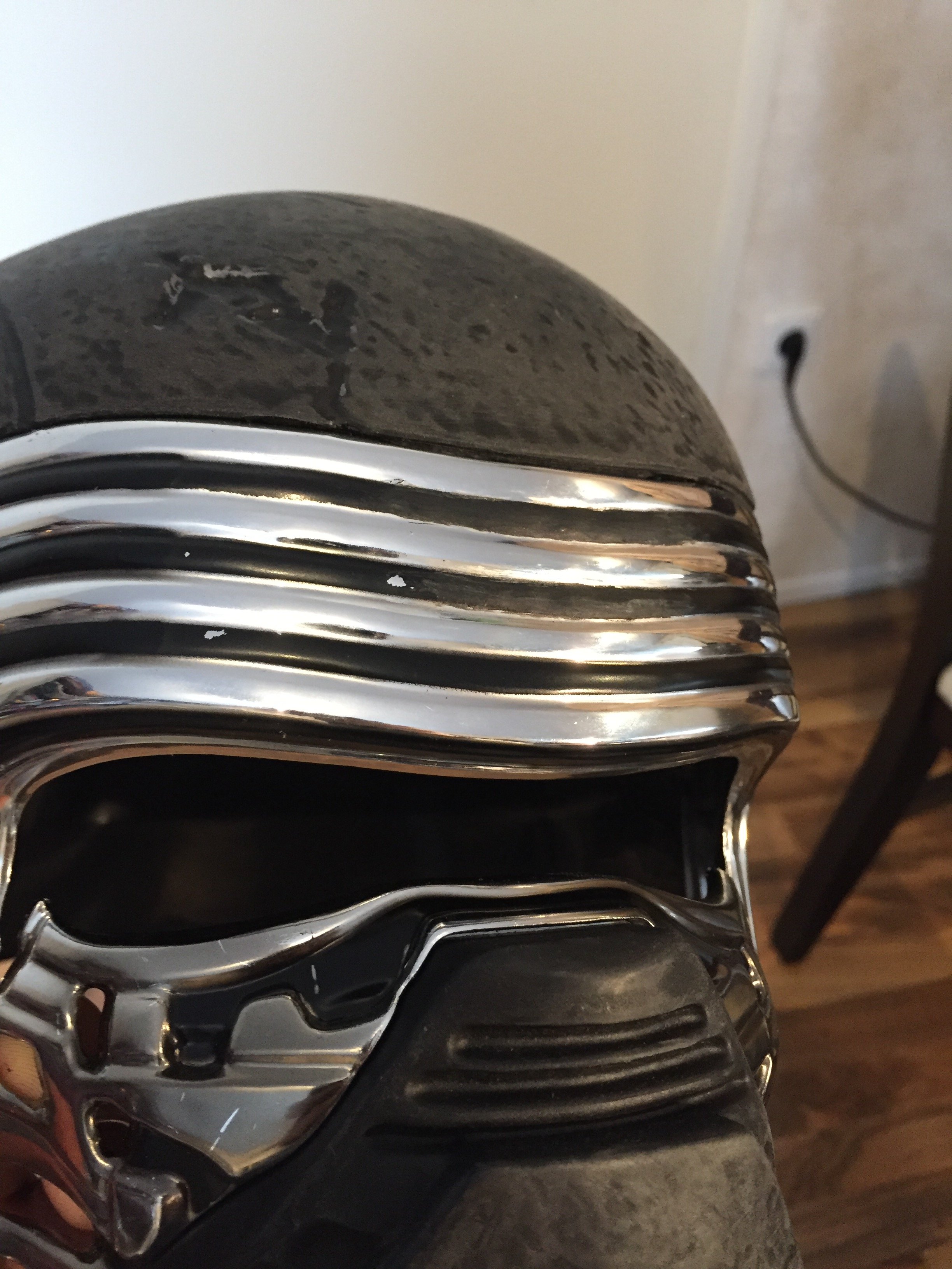

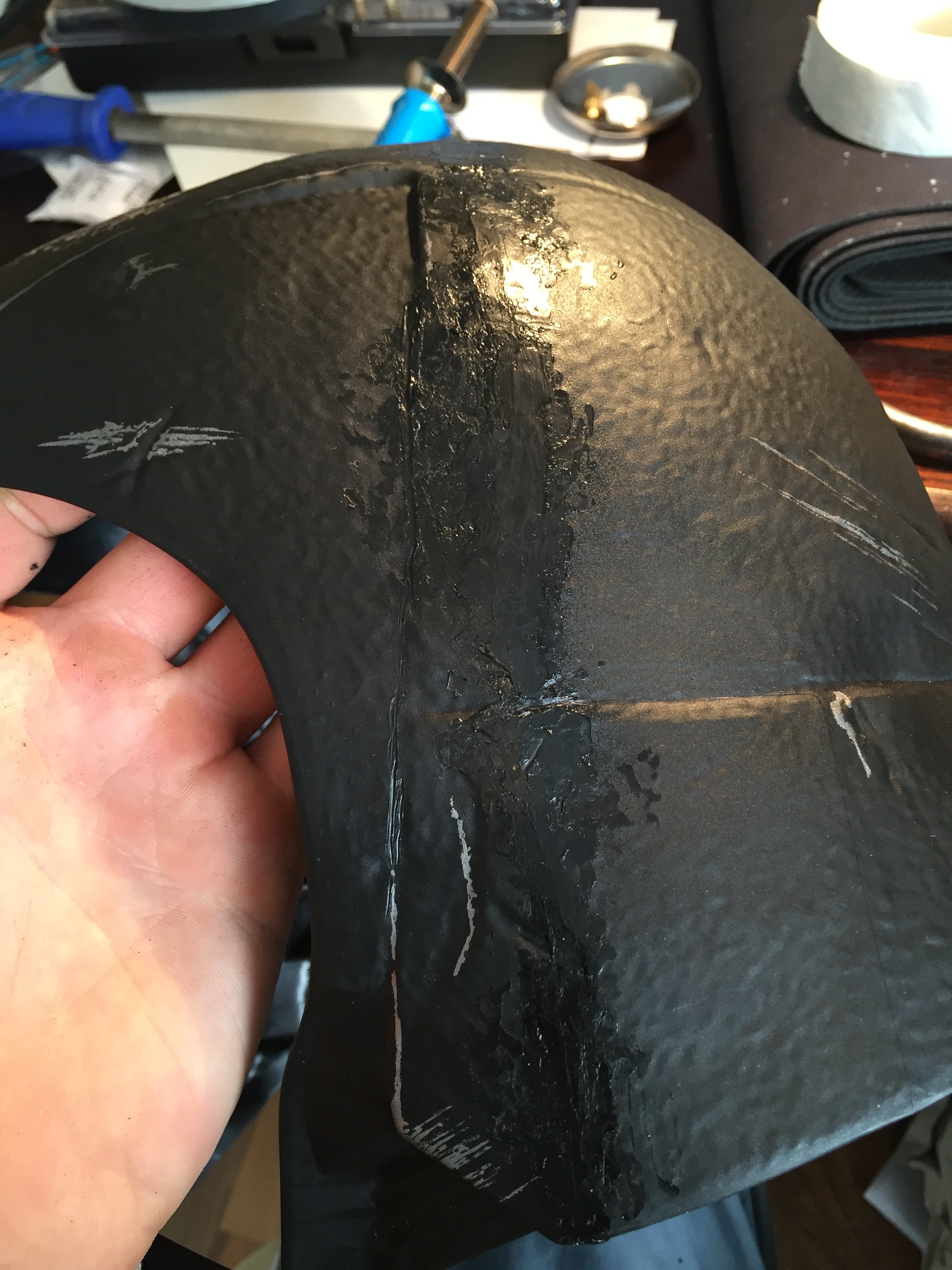

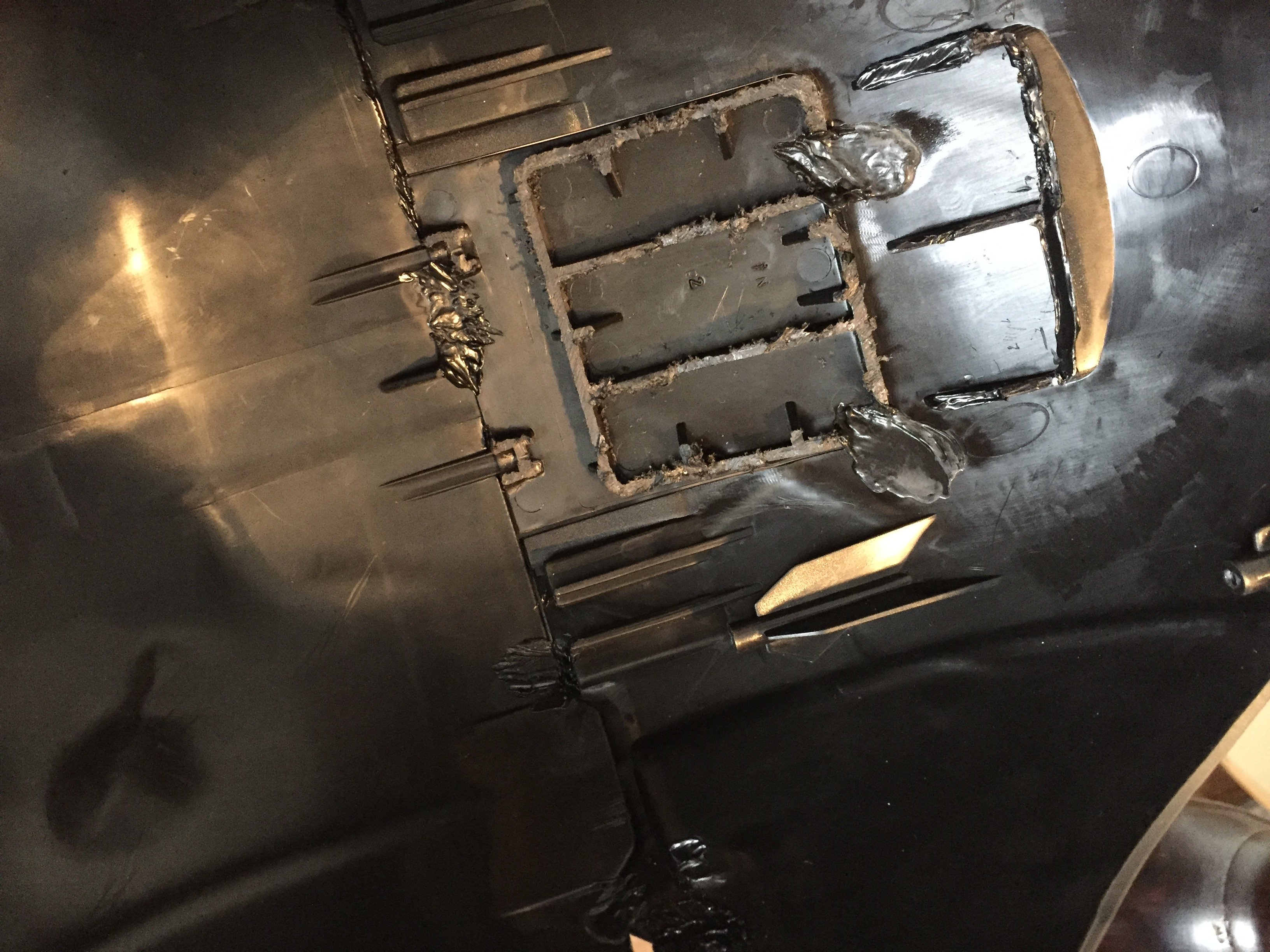

I finally got my black series helmet, and started modding it today.
This is one days work.

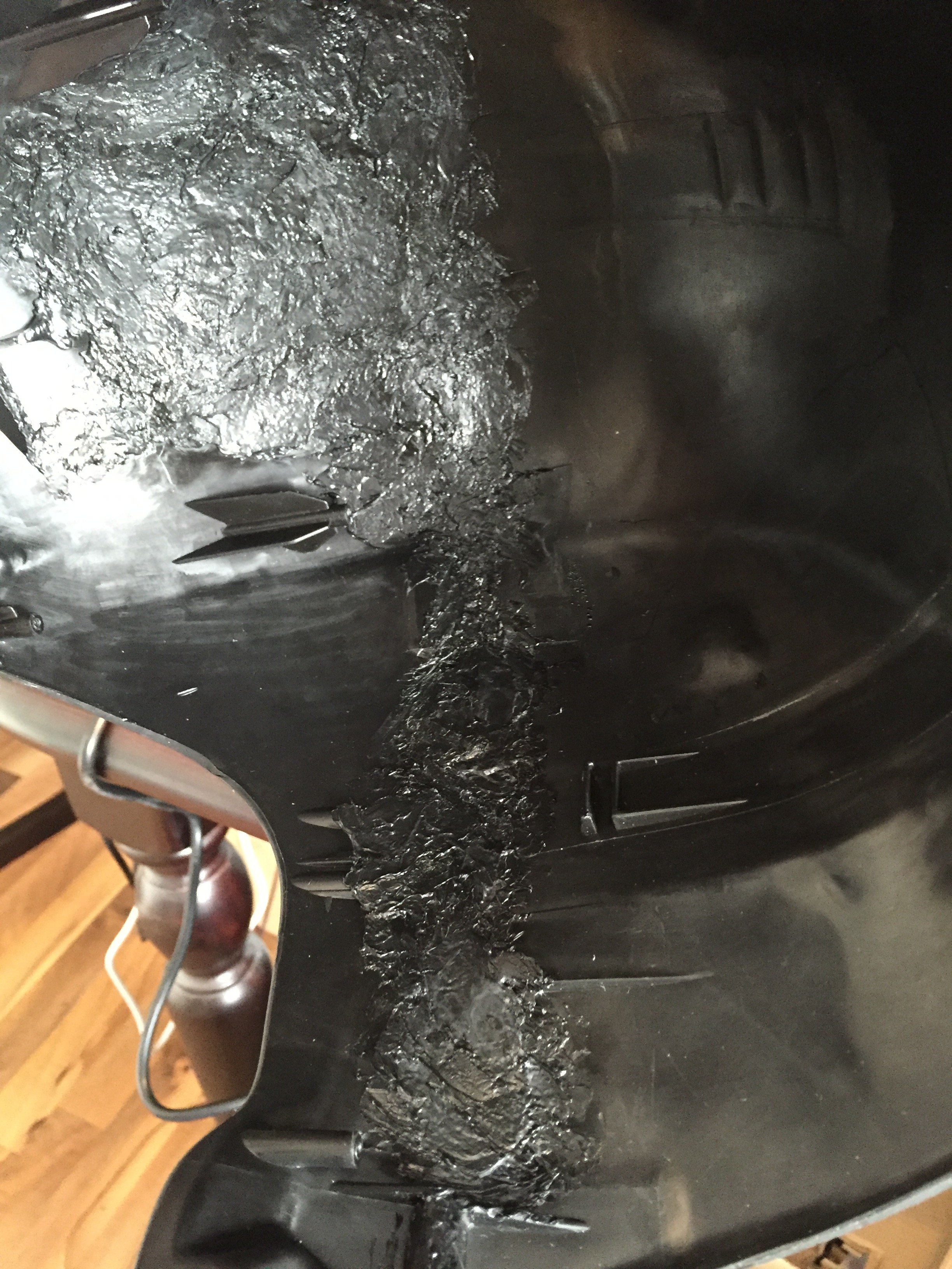

Here I fixed the too halves and the battery cover into place.
Then I soldered the whole thing. (WIP)
I sanded the bucket

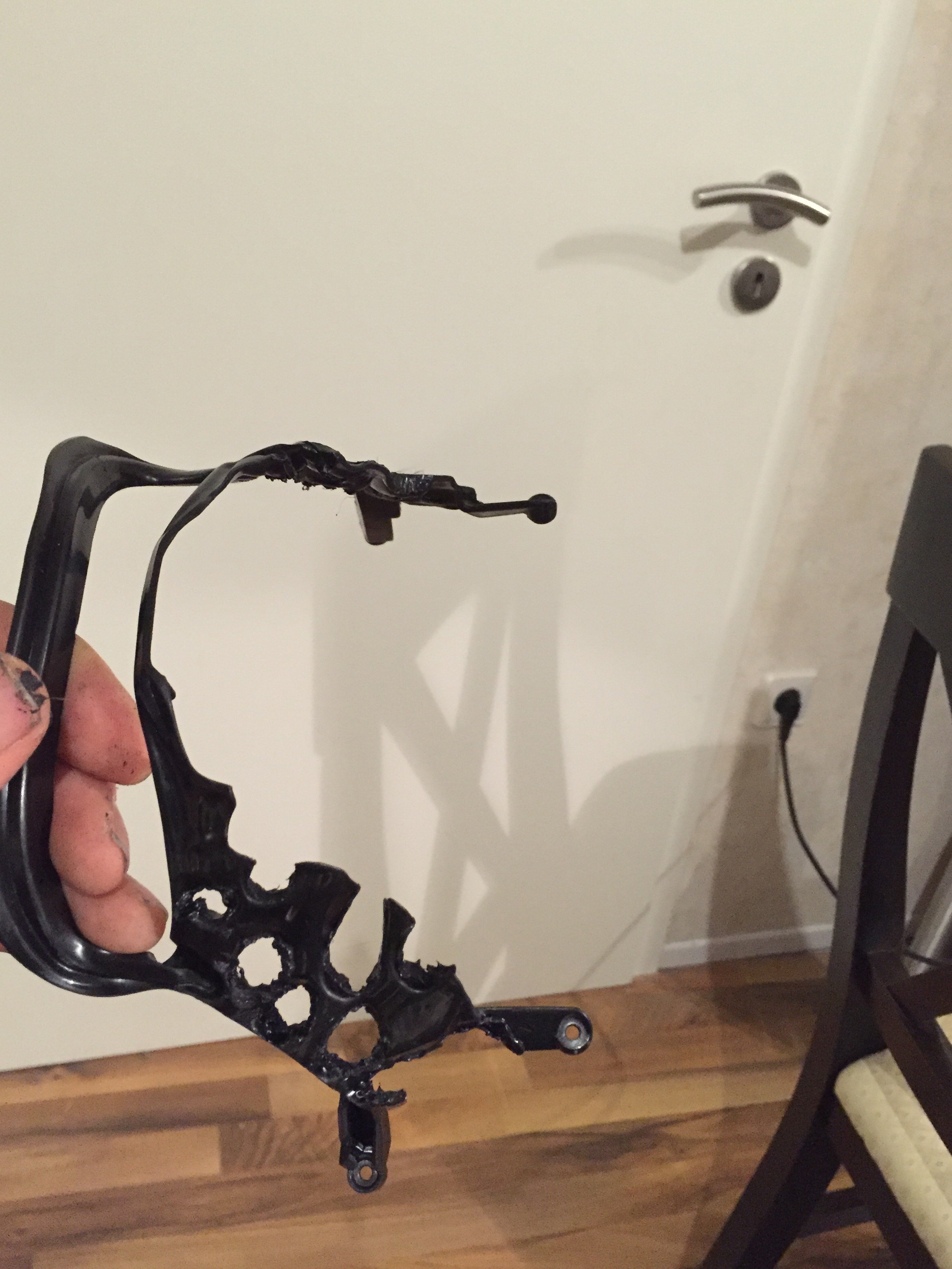

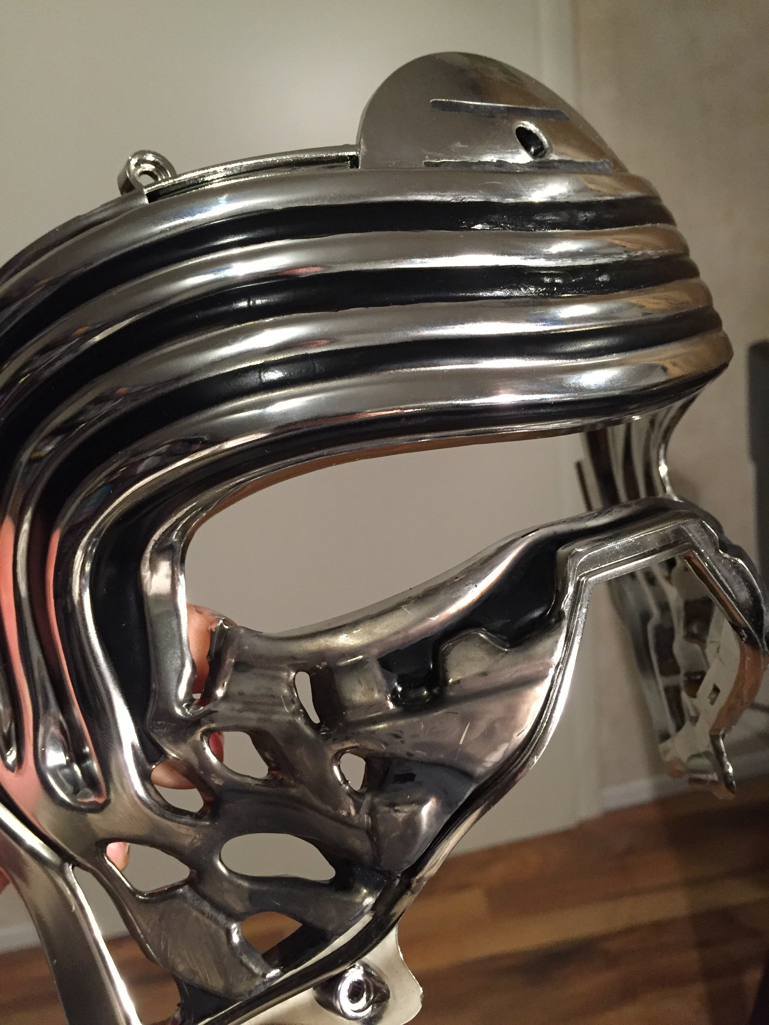

And I cut out the back part of the chrome piece
More to come. :)

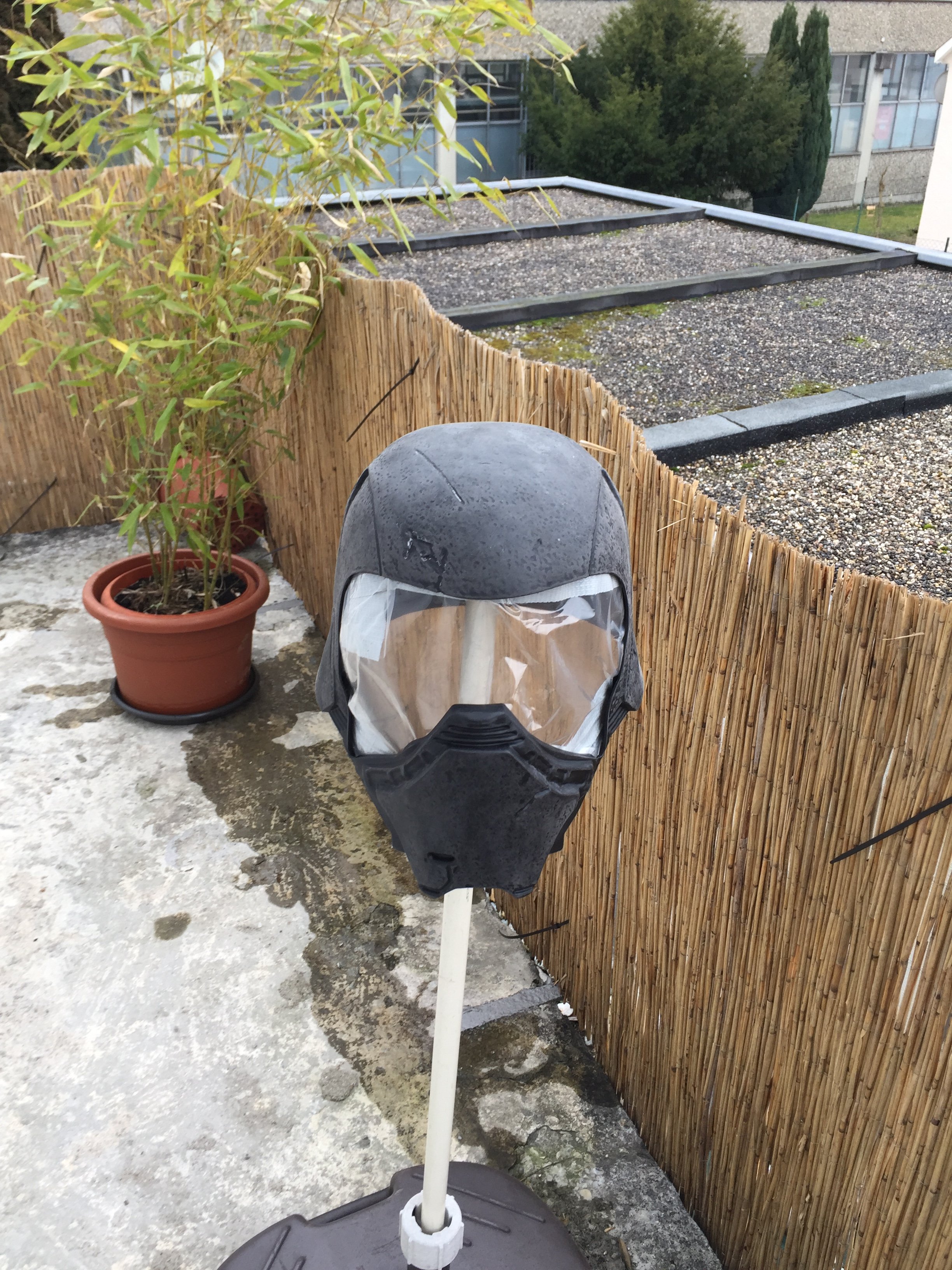

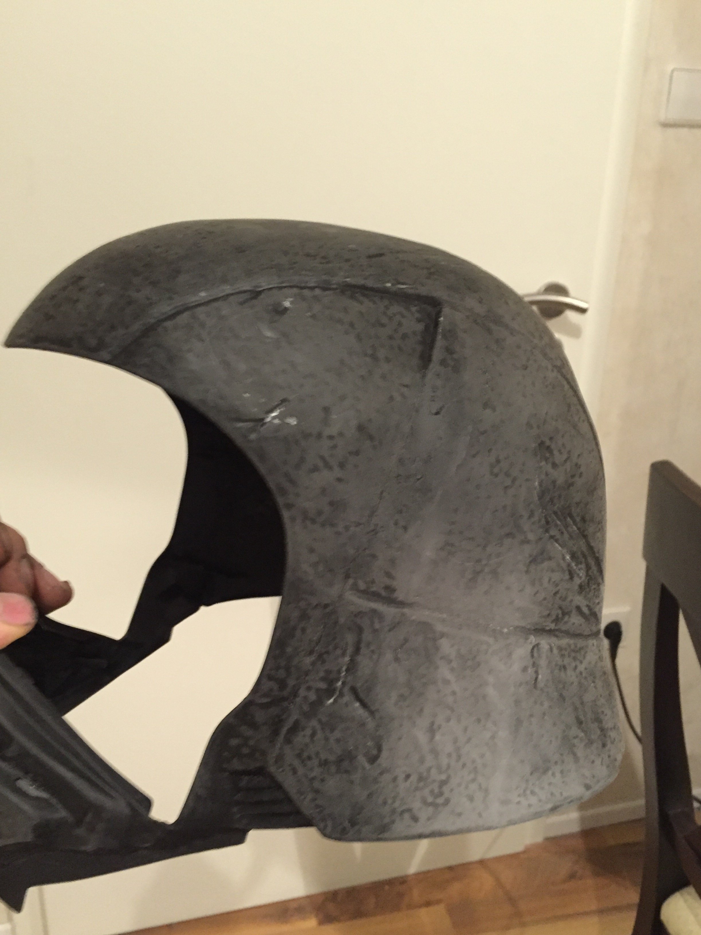

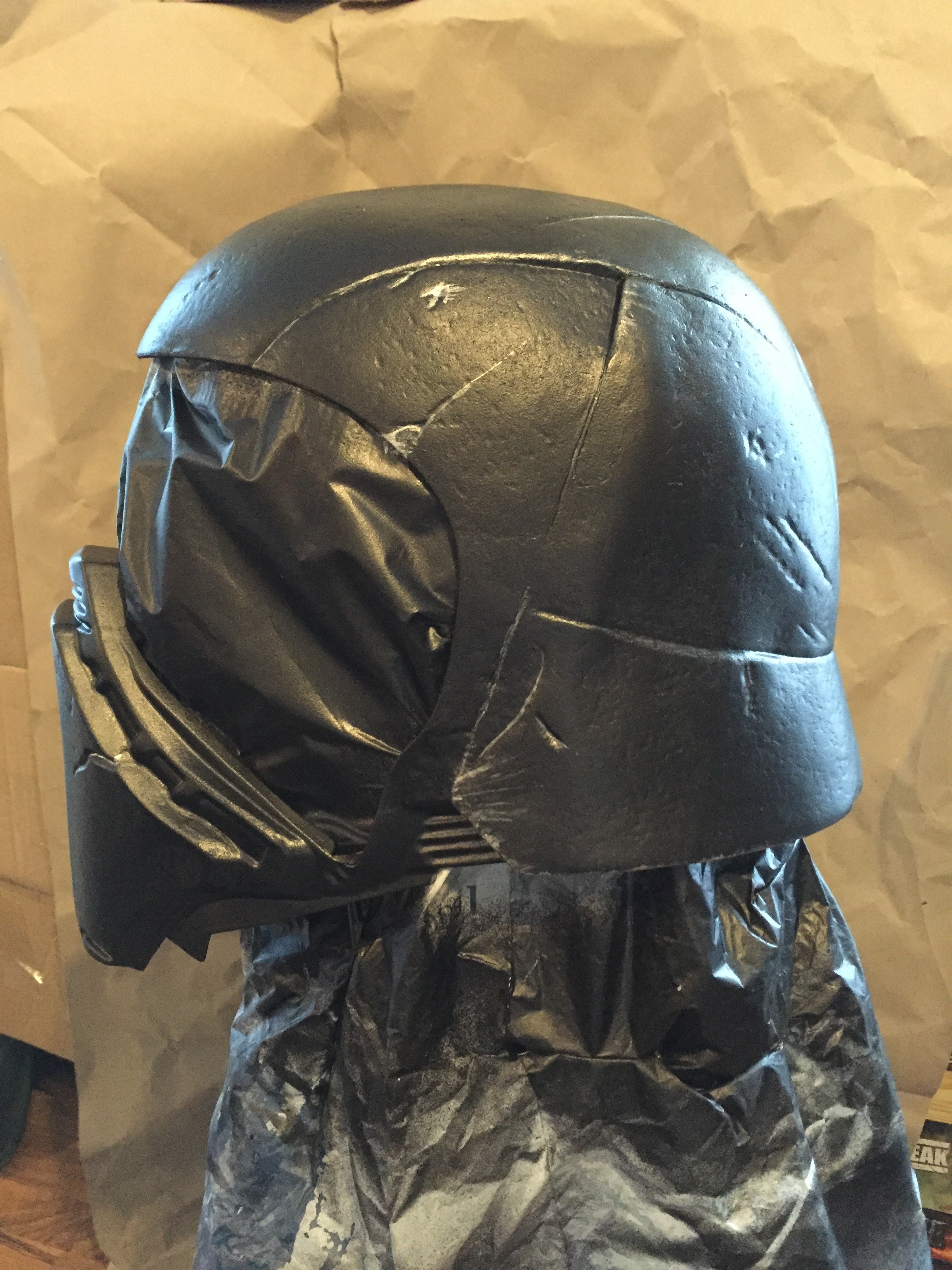

After another day in the imperial workshop, the helmet is almost done.

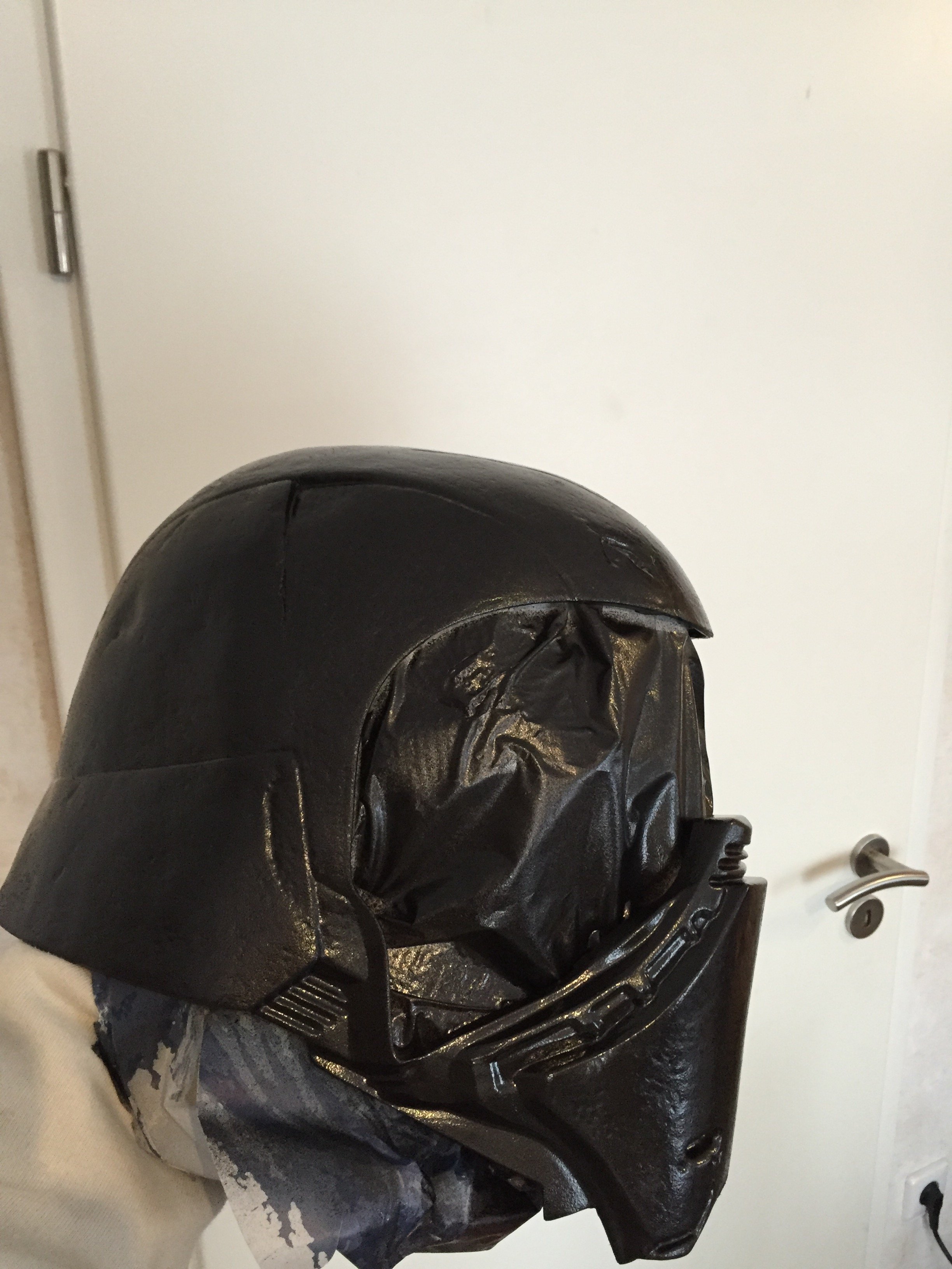

Breathing holes and speaker holes filled with black miliput.
Ready for painting
4 coats of hammered black

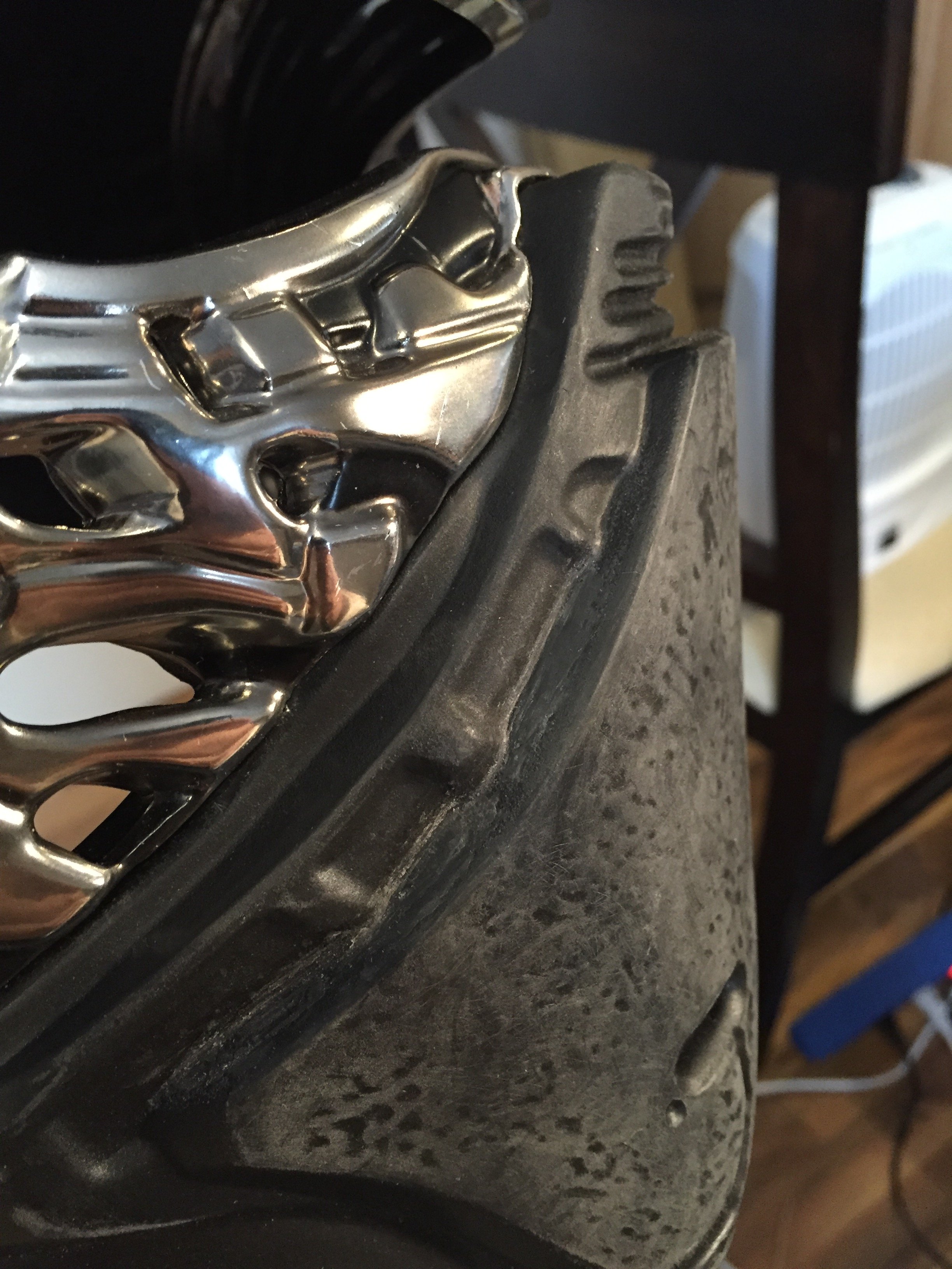

Painted some weathering details with silver, and sprayed two coats of satin matte clear sealing spray
Once its dry, I can work on the final details of the bucket, assemble it, and do the interior.

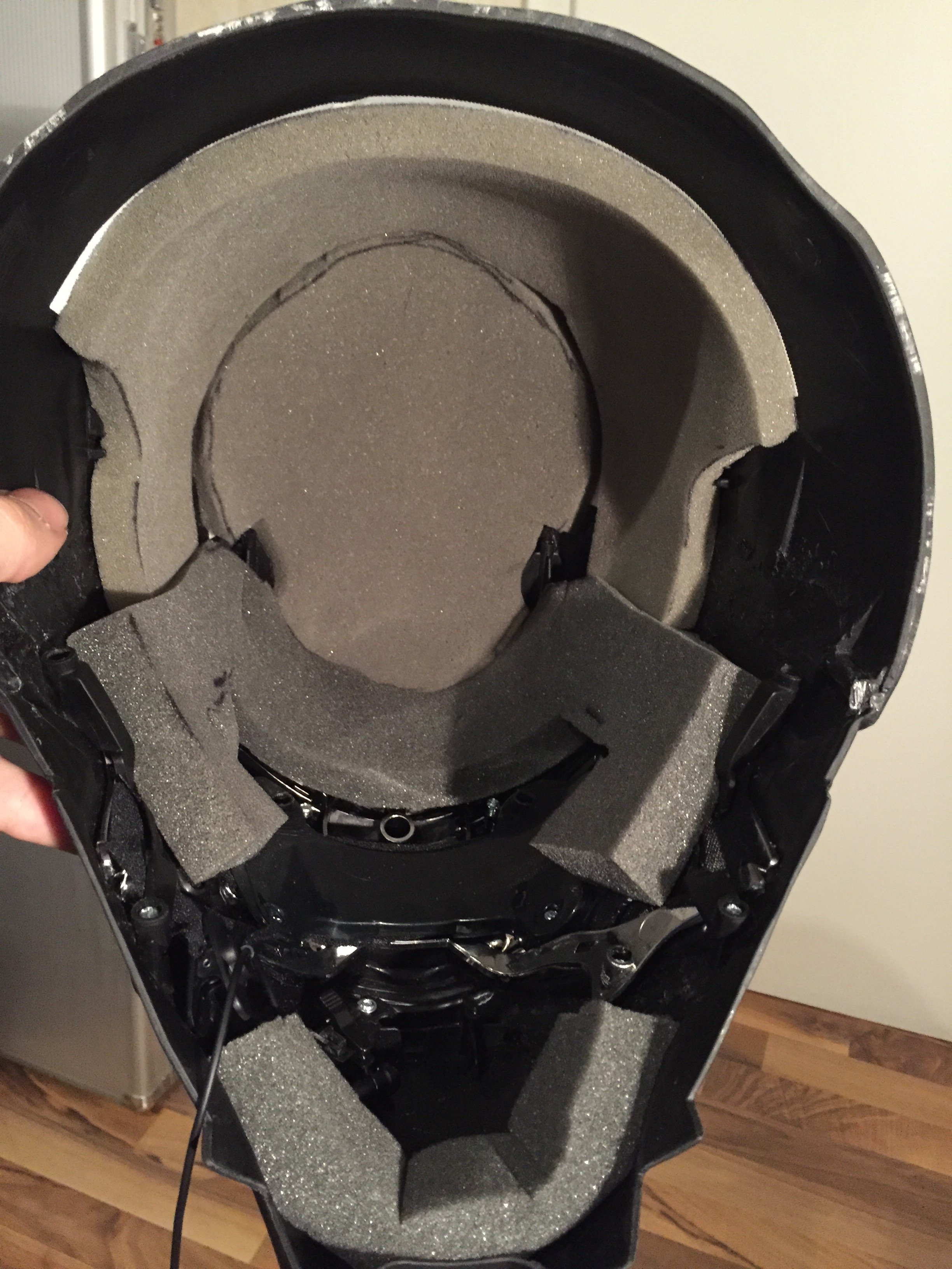

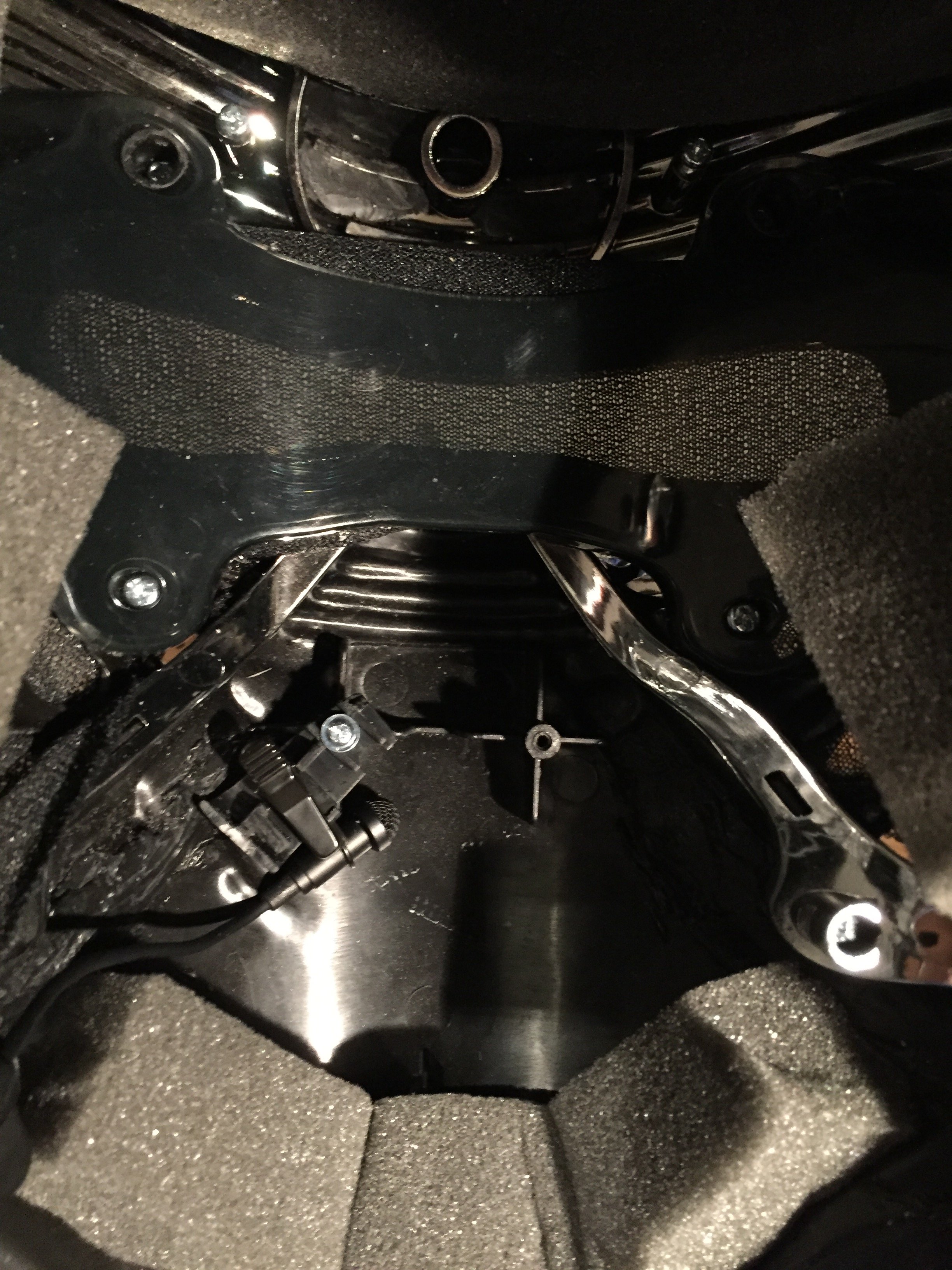

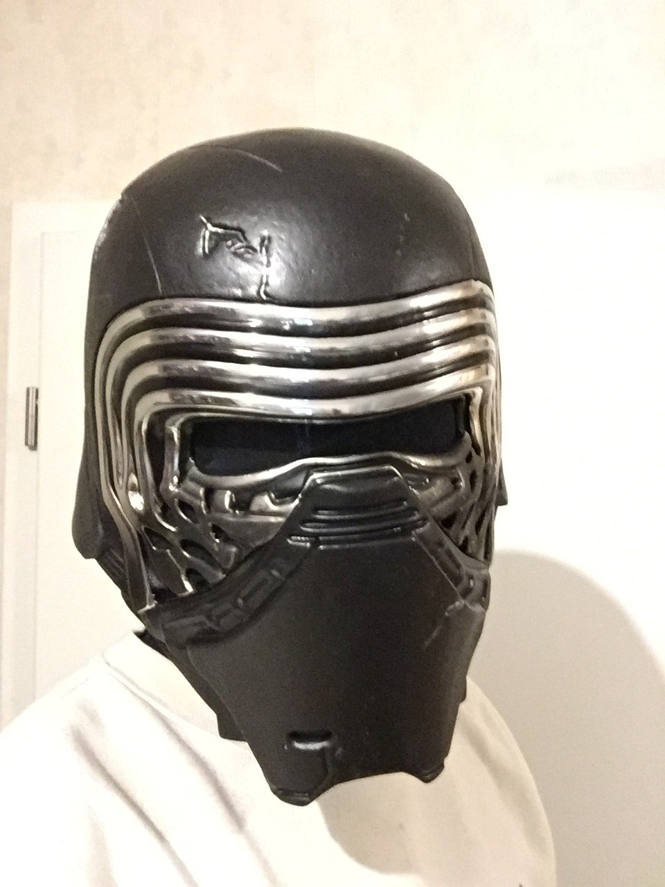

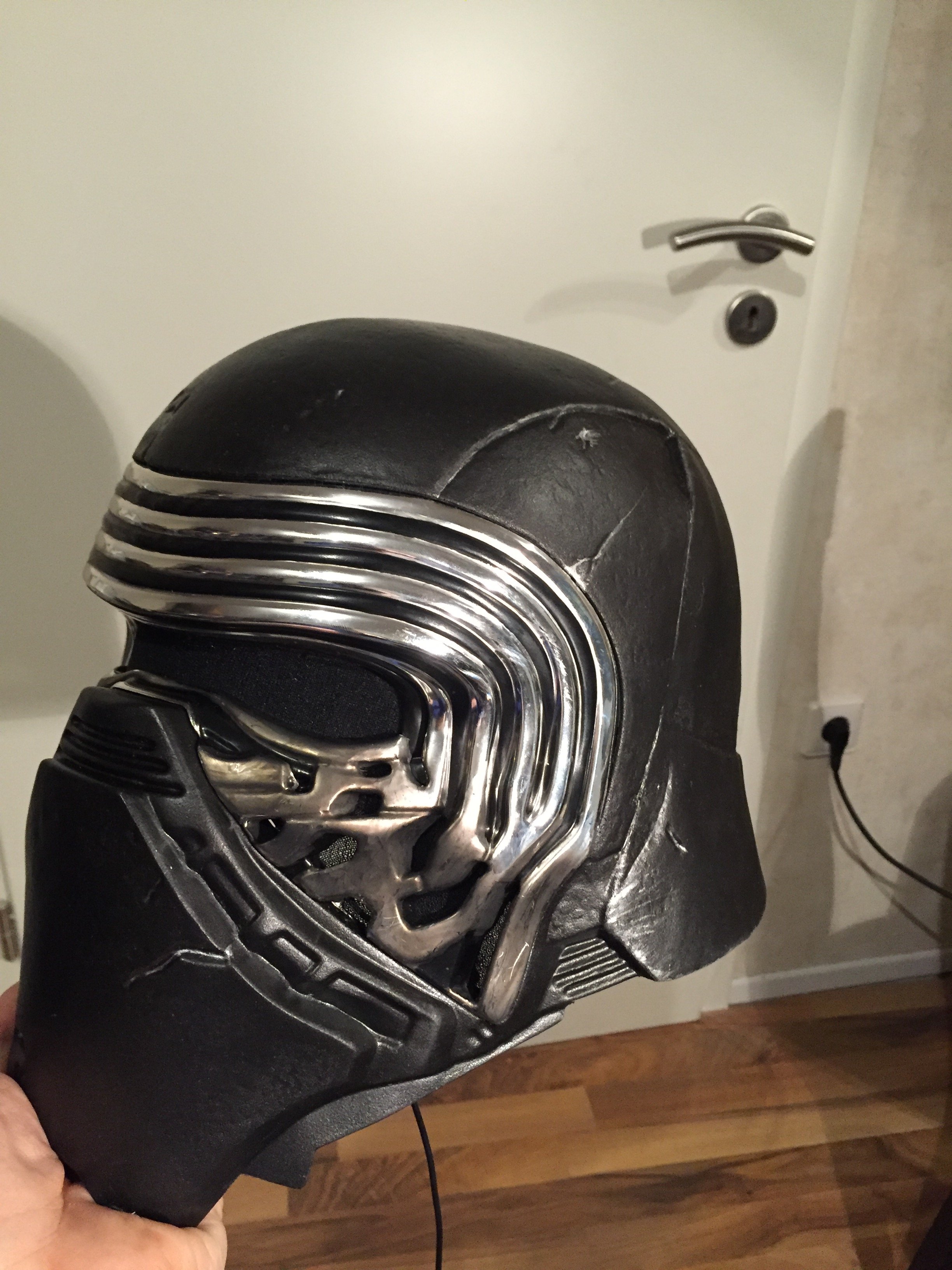

Finished the helmet today.
Took me one weekend, and one evening.
Re-painted all black areas on the chrome piece, and weathered the cheek section, to be darker, and less shiny.
Put the cloth that covered a speaker over the visor and cheek holes. I tried nylon pantyhose too, and the speaker cover gives a much better vision through the visor.
Assembled everything back together.
I cut some foam pieces, and glued them with double sided tape to the inside of the helmet.
I left some space for the nose and ears. It sits very comfortable and snug on my head.
Also I used some of the spare parts to build a mount for my microphone. It sits directly in dront of my mouth.
I just need to figure out how to hide the cable, that goes to the speaker on my belt. Any tips?
I'm happy with how it came out. This is the first time I did something like this, and I couldn't have done it, with the help from you guys! Thanks a lot!
Run the wire from the speaker under your costume, up through your neck seal then over your ear. You shouldn't be able to see it at all. What speaker are you using and does it change your voice?

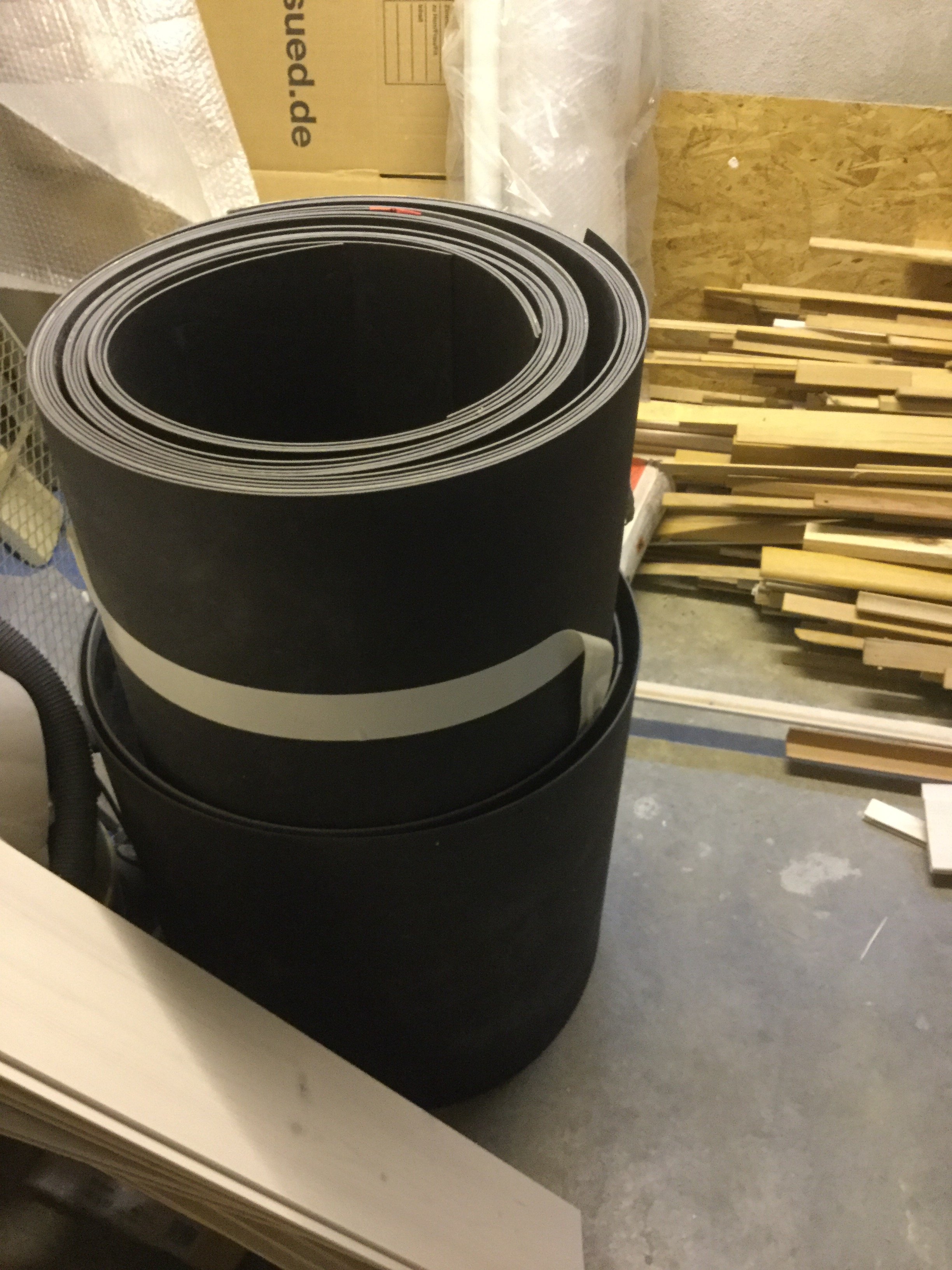

Today I started working on a the belt.

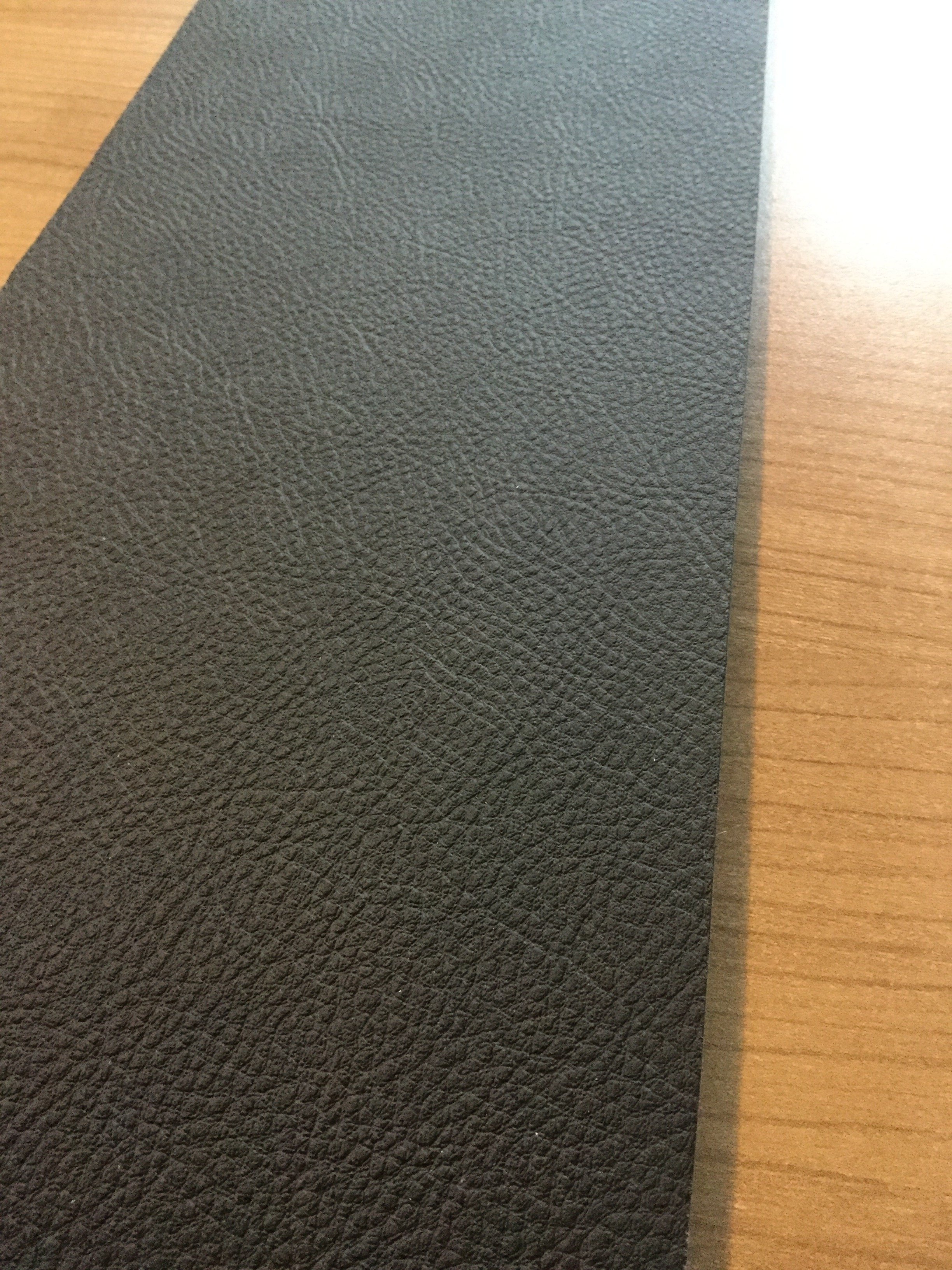

Found this nice stuff in my basement:
This is a roll of floor dampening. It's a very dense black foam with a rubbery plastic coating, that looks like leather.

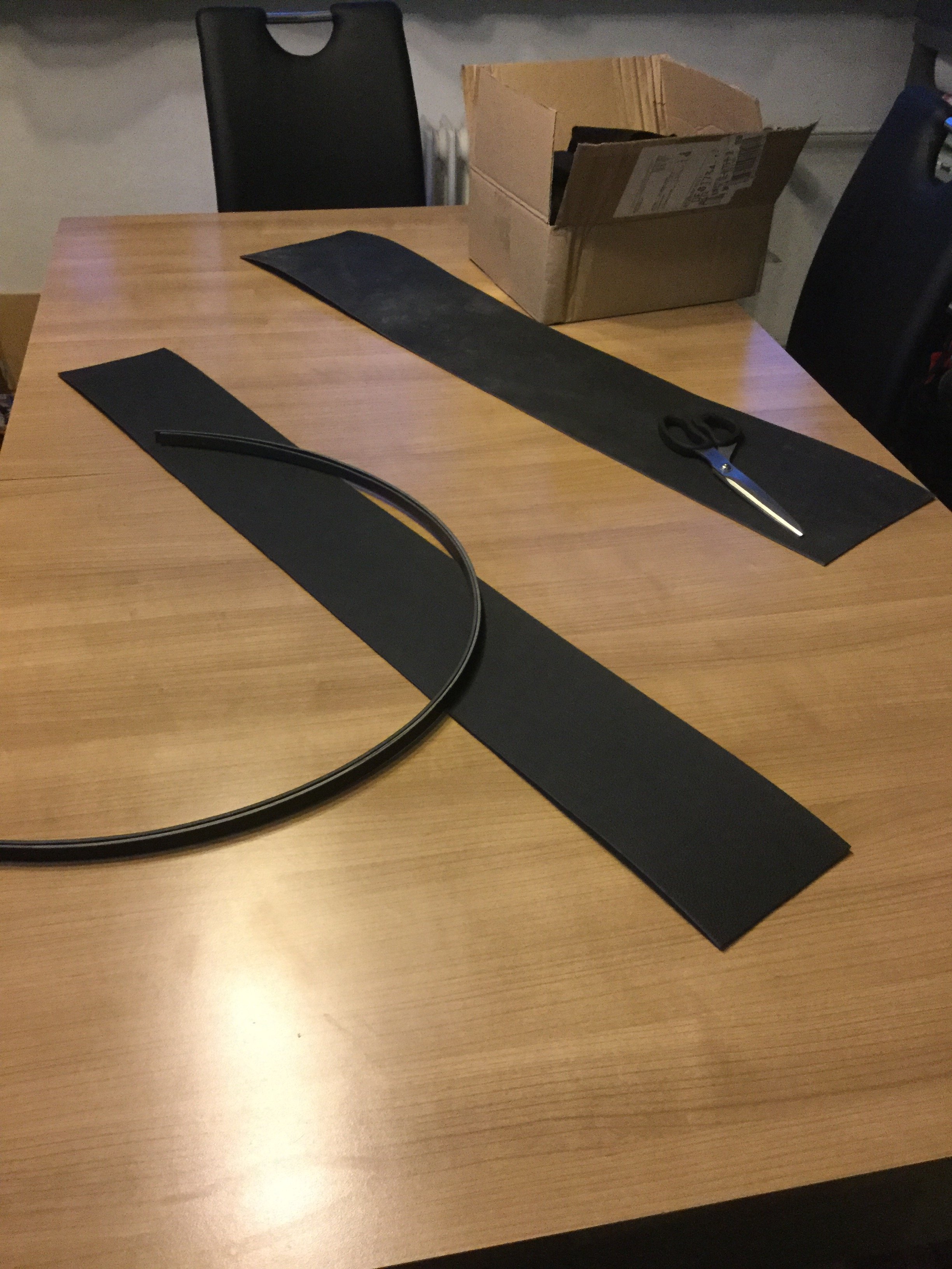

I've got tons of this stuff, so I started building a prototype belt.
I cut a 5 inch and two 12mm stripes from it.
View attachment 573223View attachment 573222
Now I have to wait for the resin belt buckle to arrive, before I can but the exact length, and sew it together.

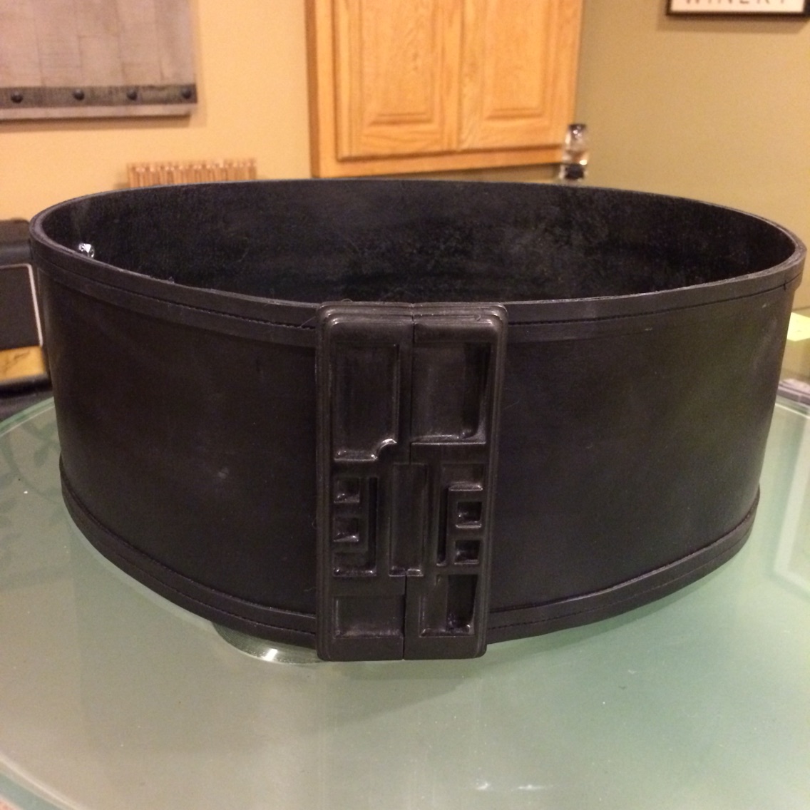

Wait... I thought you'd said that you bought your belt from PH props? Paul's belts are fantastic (My hubby has one) and are real leather. Why make a foam one?
When I started the cosplay, I did most of the stuff myself. It wasn't perfect, but I had something, and I didn't plan to go 501st back then.
It helped me to experiment and try everything. But I also came to the point where I realized, that my sewing skills won't get me to where I wanted to.
So I let the pros do some of the work.
Im changing all the bad parts for better ones step by step. And it takes some time. I still have to wait for my boots and soft parts for at least a month.
But I did have a complete costume from the beginning, though it wasn't the best.
I hope I was able to explain it . :)
And yes, Paul's belt is the best you can get imo.
