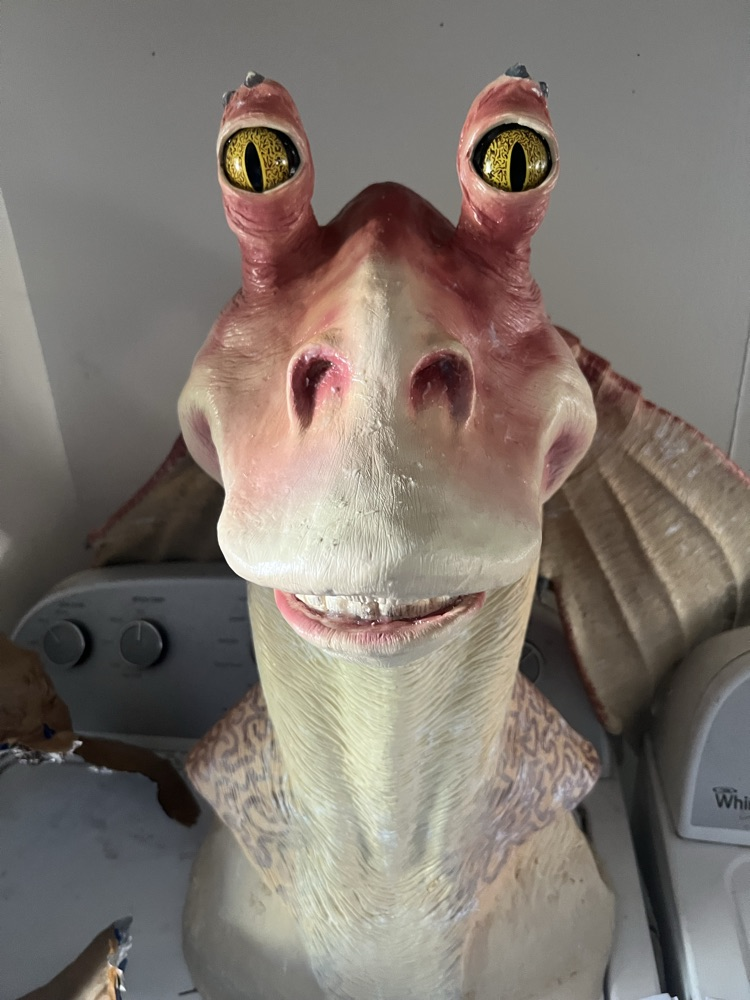

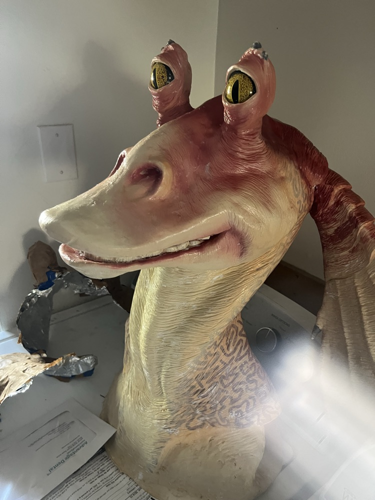

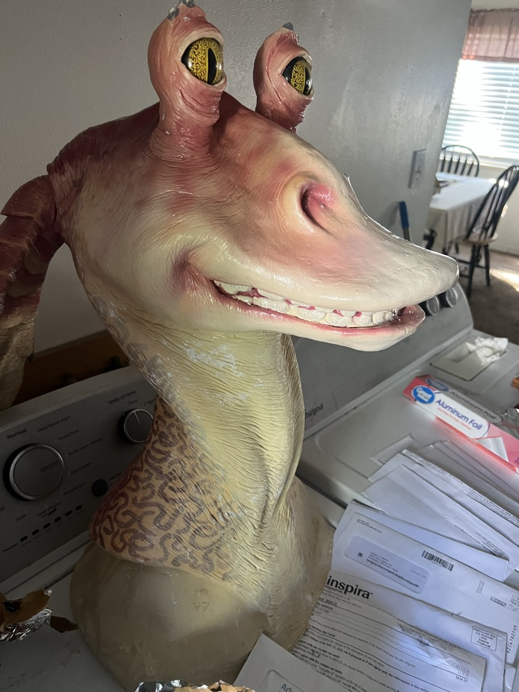

I'm a long-time admirer of the amazing work on this forum, and I'm hoping to tap into the community's collective wisdom for a project that I'm incredibly passionate about, but have hit a major roadblock on. My goal is to create a high-quality, wearable silicone mask of Jar Jar Binks with a functional, moving jaw. My starting point and primary reference is this beautiful, life-sized bust that I've acquired.
My Journey So Far:I've spent a significant amount of time and resources trying to tackle this on my own. I've learned a lot from my "failures," including that simpler methods like plaster bandage molds or single-piece paper mâché shells are not suitable for a complex shape with so many undercuts (especially the eyestalks). I'm now committed to doing this the "right way" to honor the project and get a result I can be proud of.
Where I'm Stuck:I've done enough research to know that the next logical step is to create a multi-part, brush-on silicone mold with a rigid mother mold (like Plasti-Paste). Frankly, as a solo operator in a rural area (Pendleton, Oregon), the scale and technical precision of this step are intimidating, and it's the critical point where this project will either succeed or fail.
