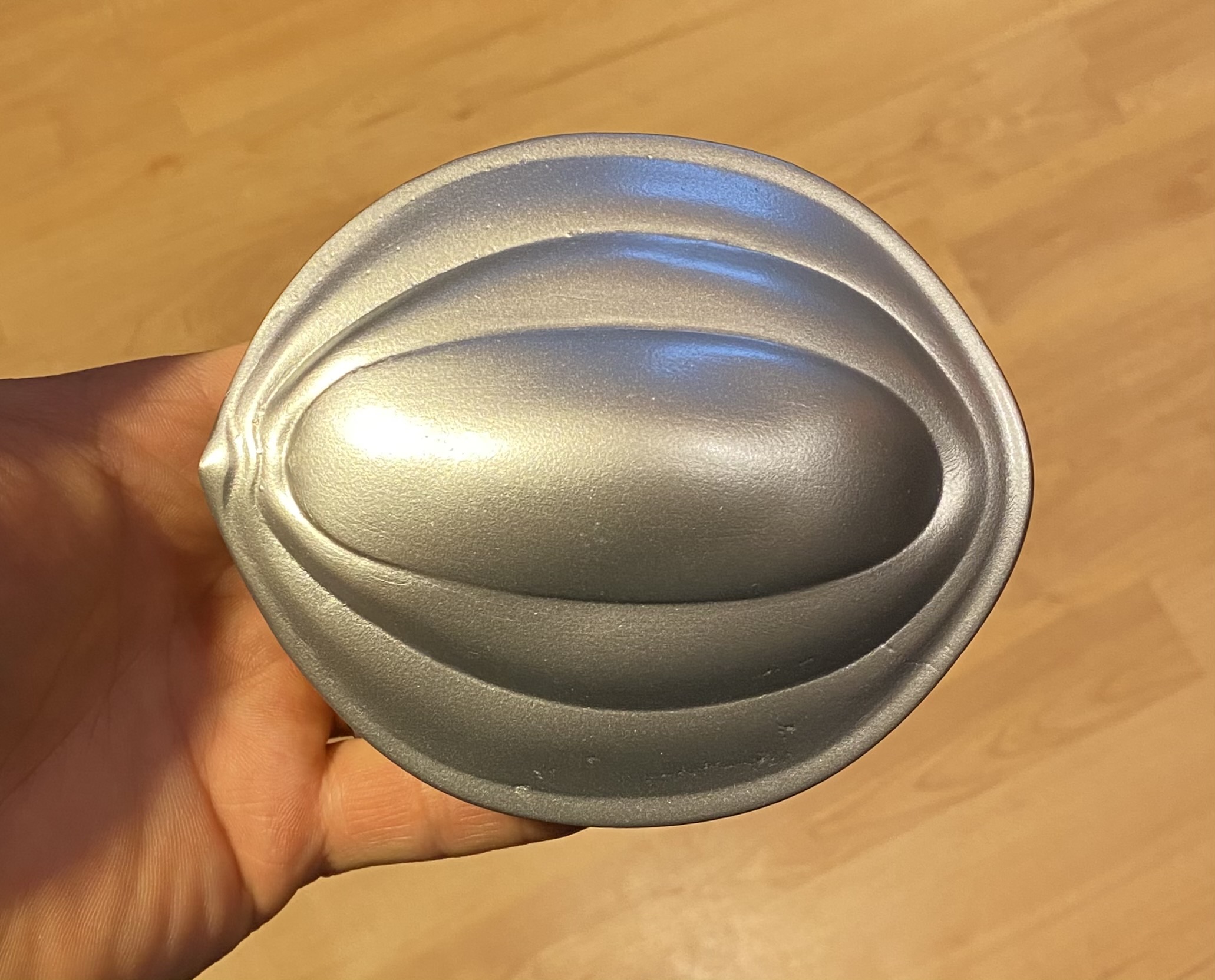

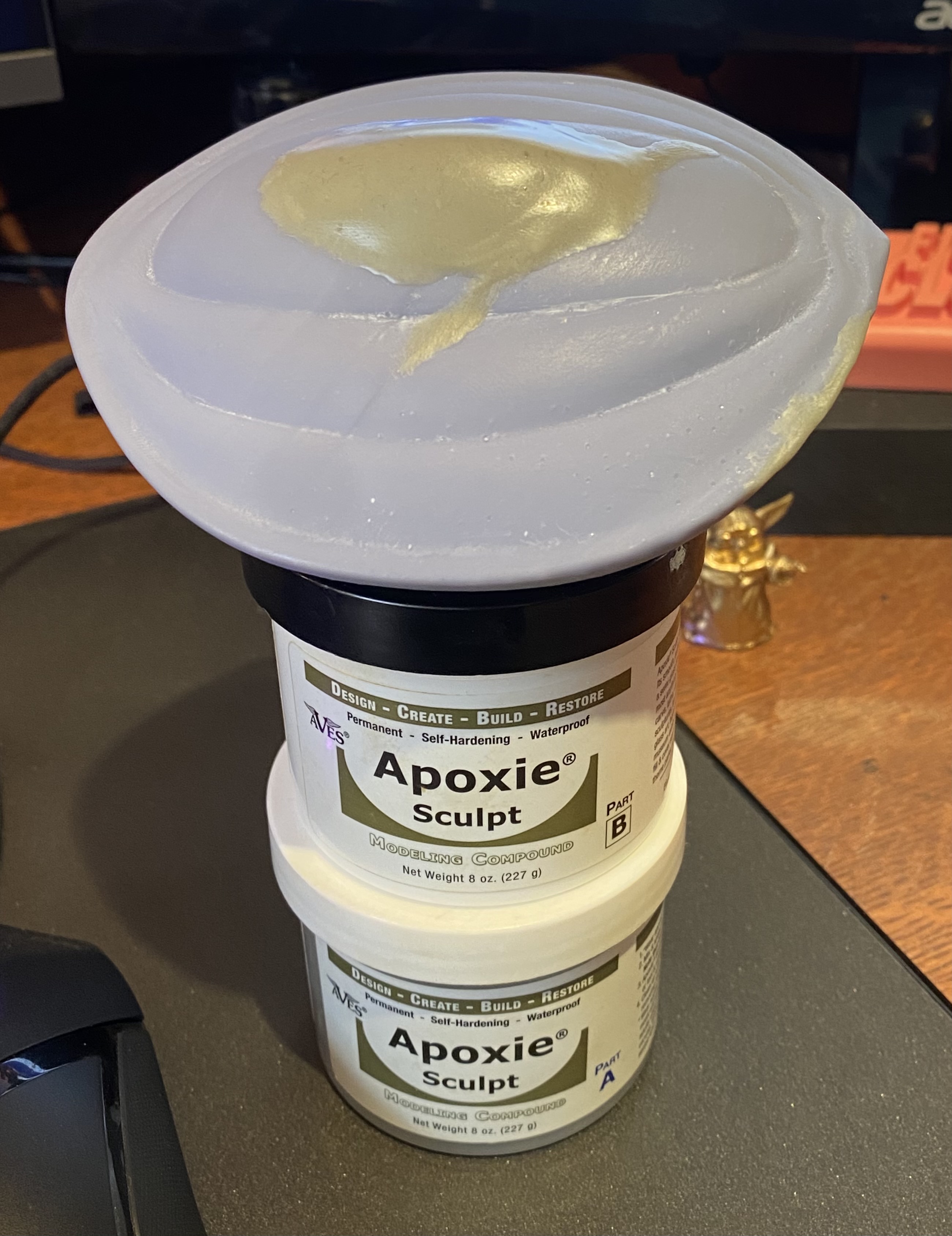

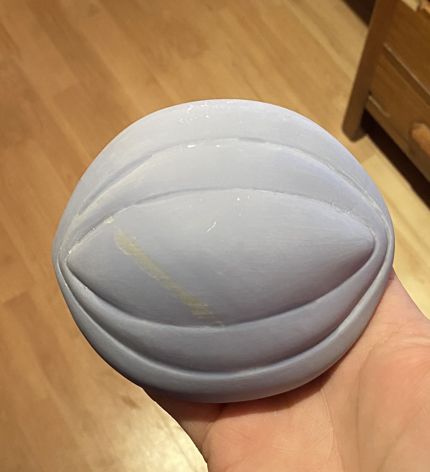

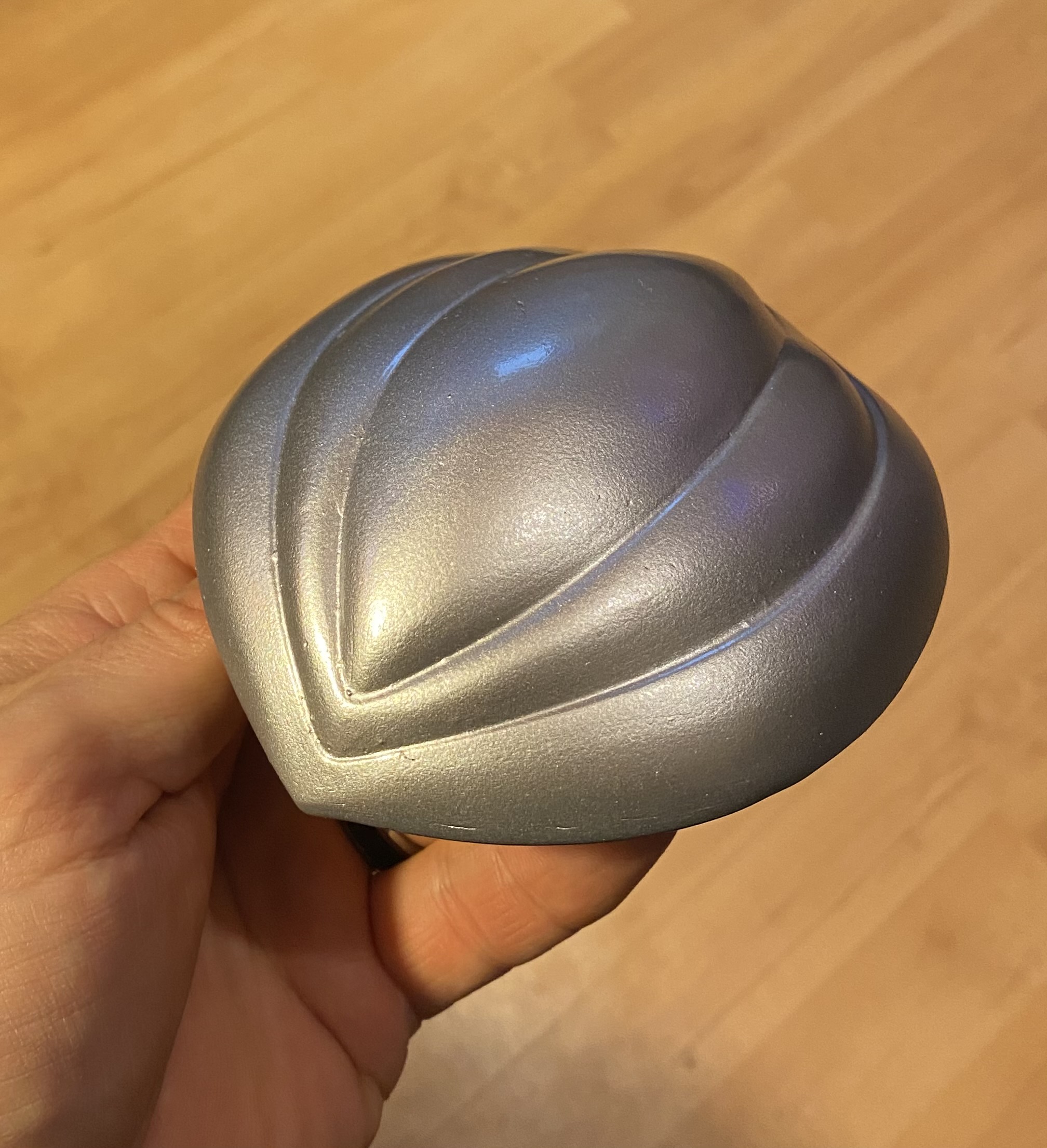

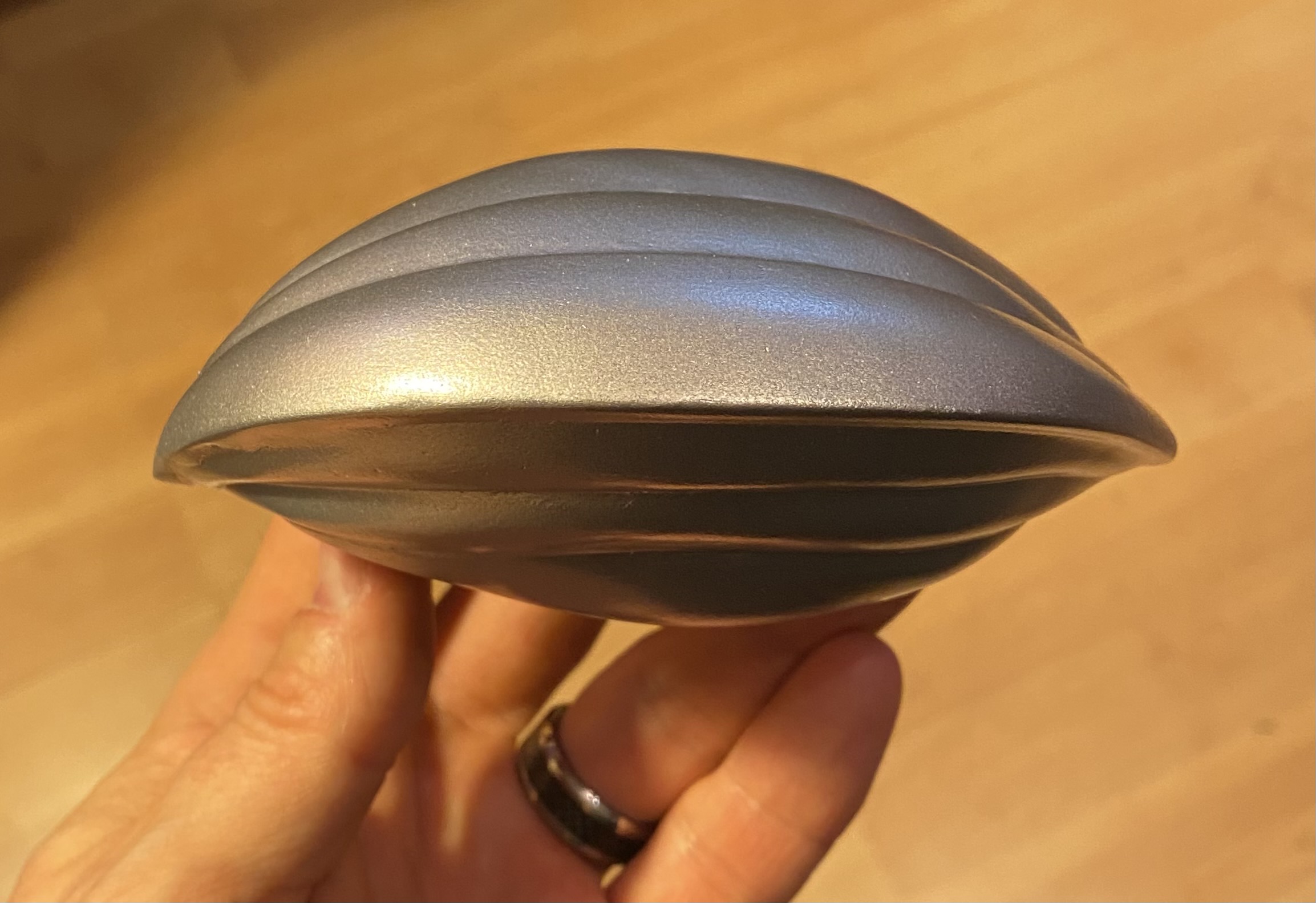

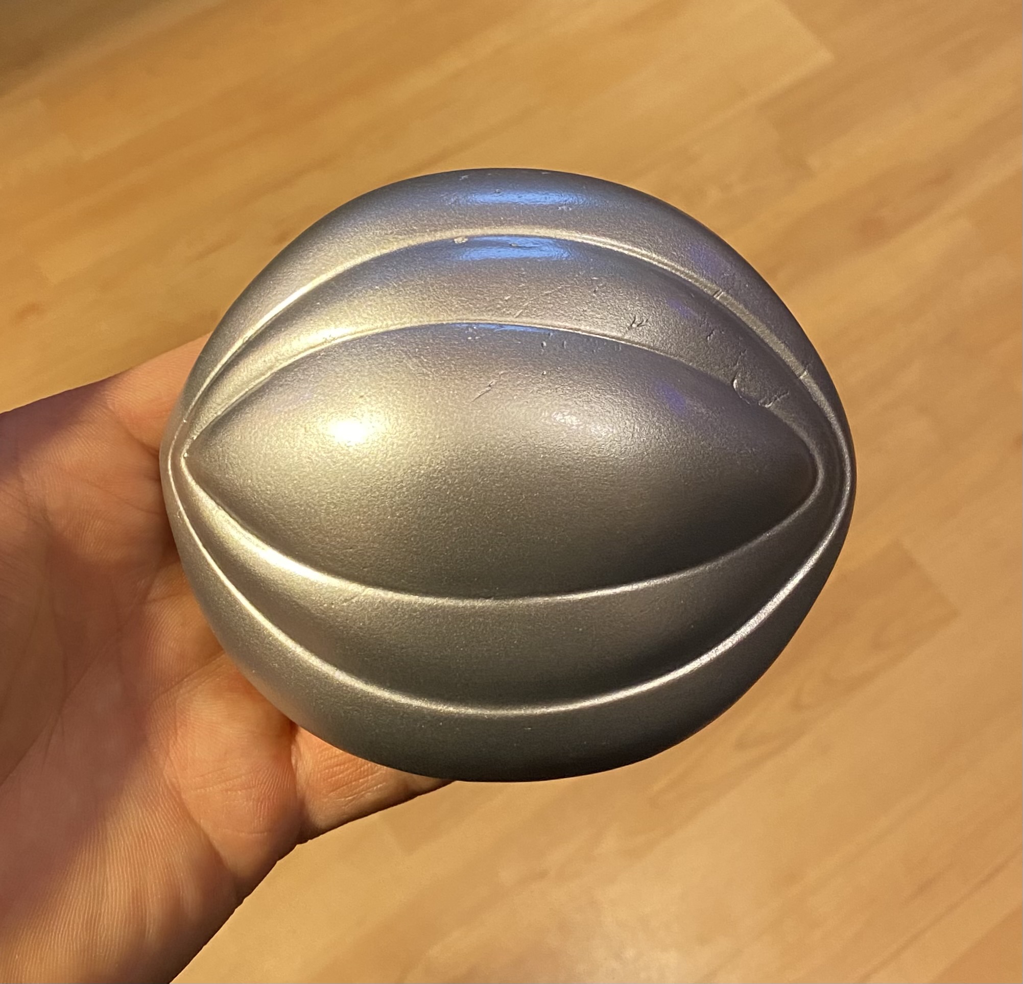

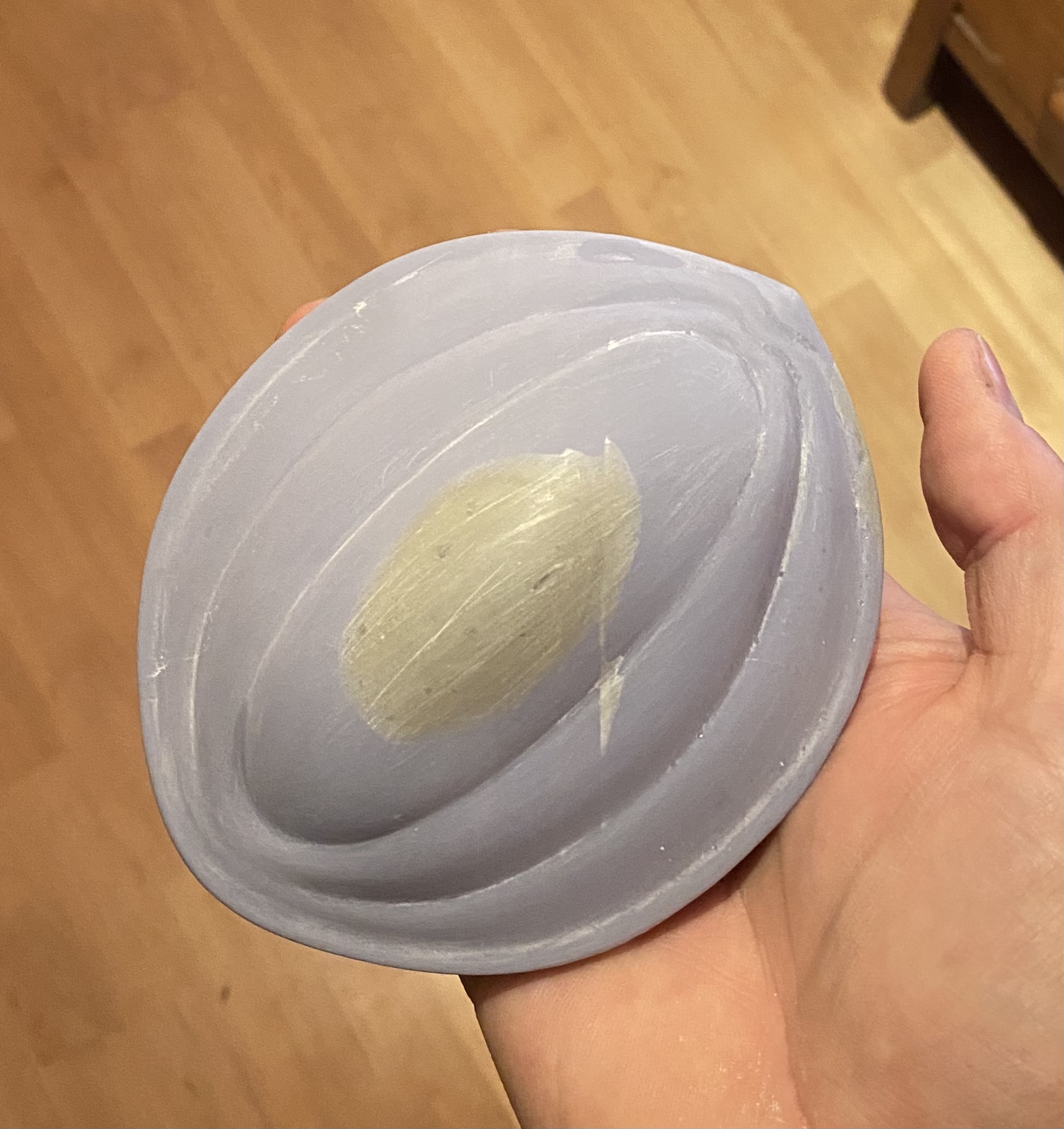

The 3D print that I got had a circular hole in the bottom, so I ended up using Apoxie sculpt to fill it, as well as some deeper shift lines. After all the sanding, I primed, painted and then put gloss clear coat on. In total I probably spent over three hours on it, but it turned out ok. I'm still in awe being able to hold this in my hands when all I could do as a kid was rewind the movie over and over again. My only complaint is that I wish it was bigger, but this will do.

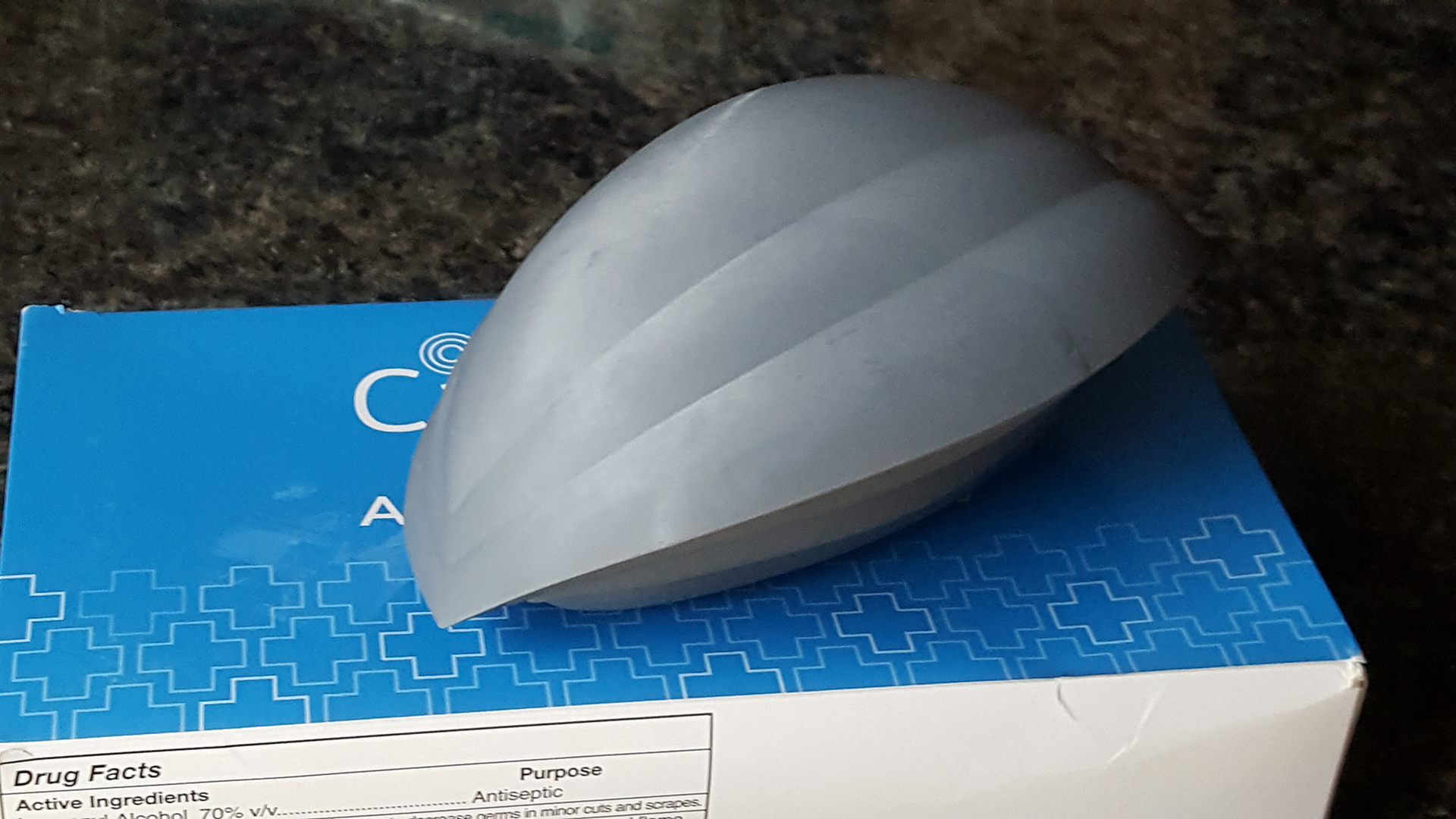

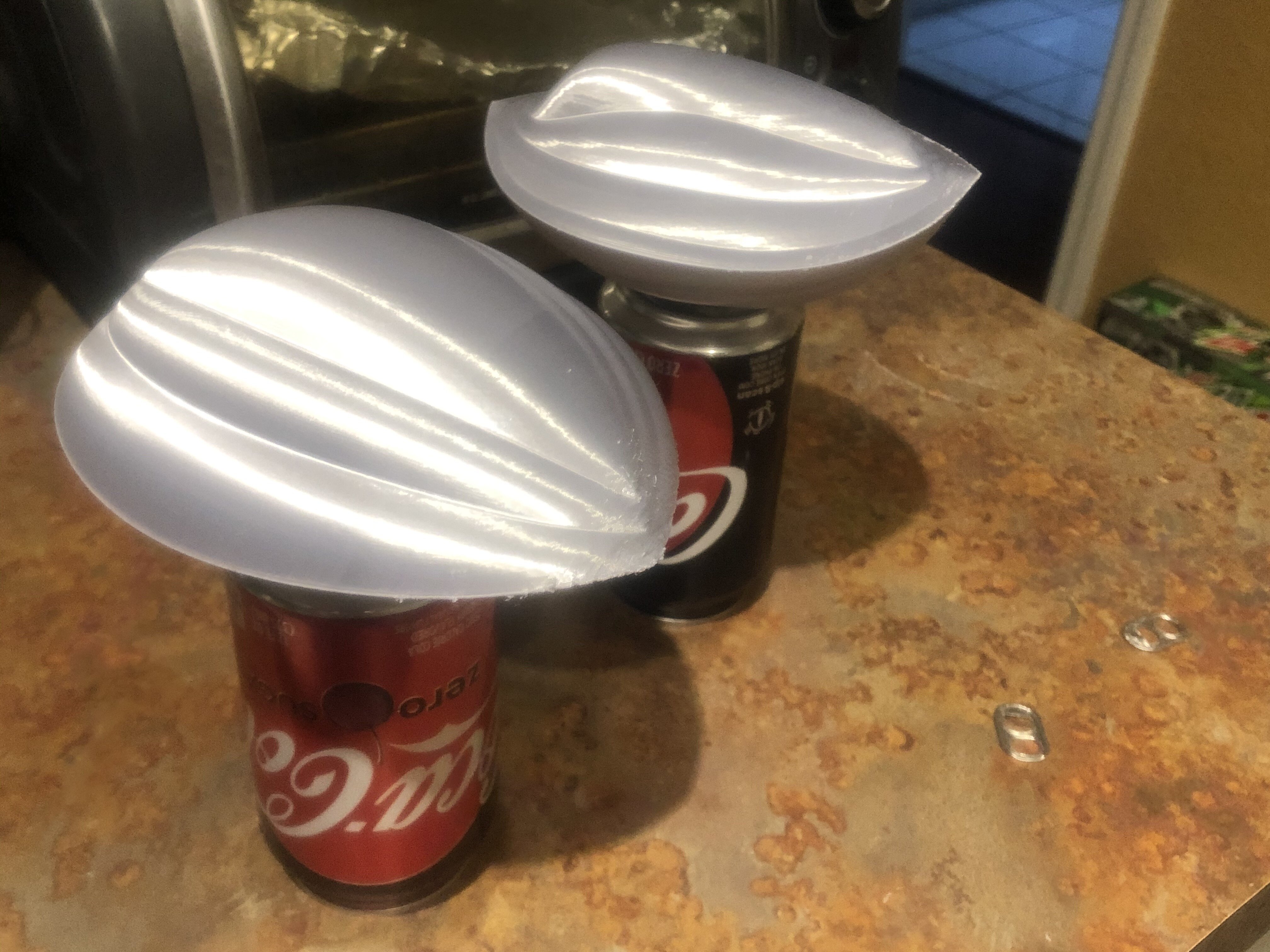

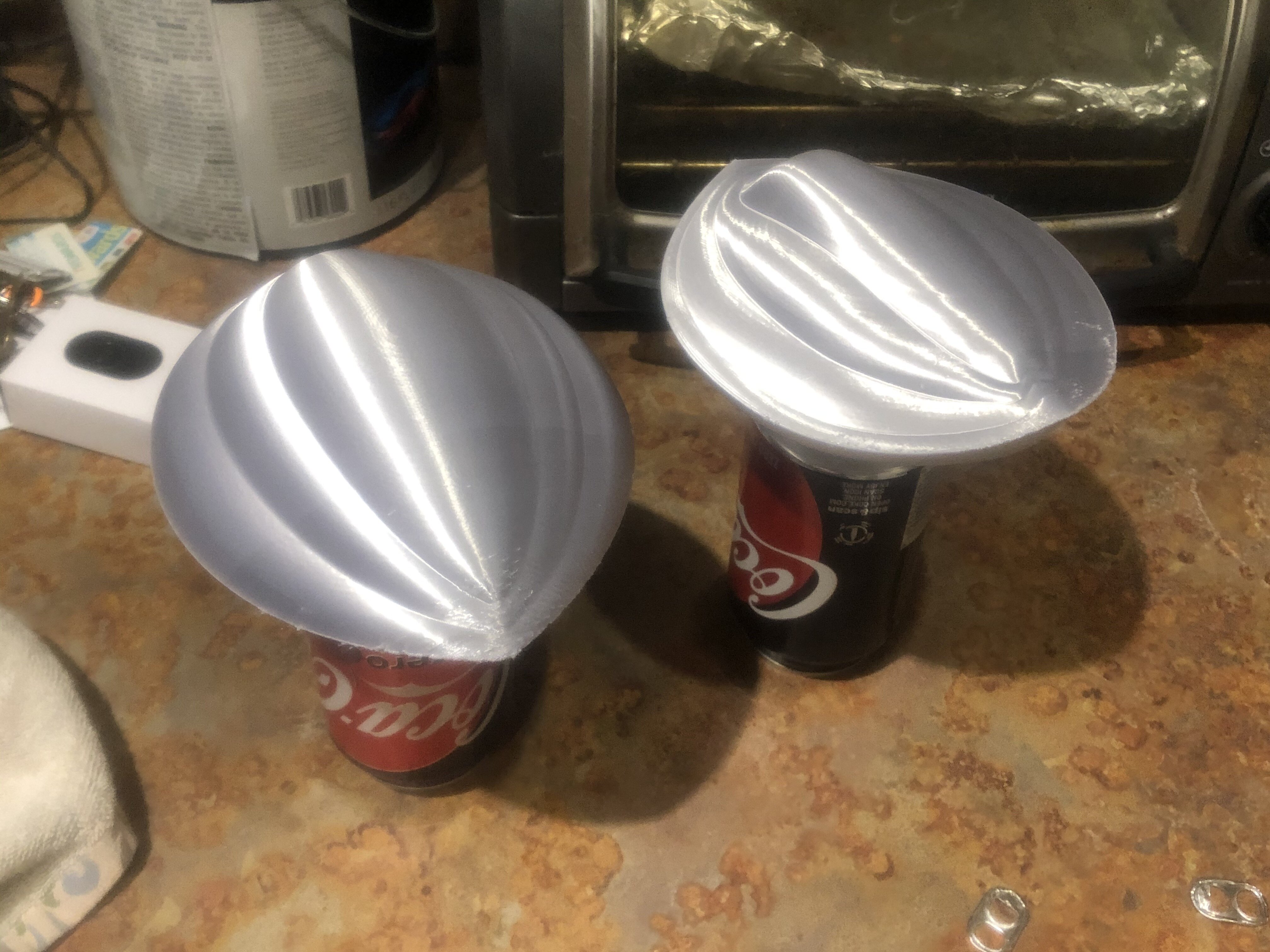

Made a couple a little smaller than the first try & these both came out pretty good - Planning to sand, prime & use Molotow chrome on these. Don't know if I'll try again at max size or not - Could go up to about 23CM tall on the Ender 3 Pro, Or I could just print the back end to match the half I already made.

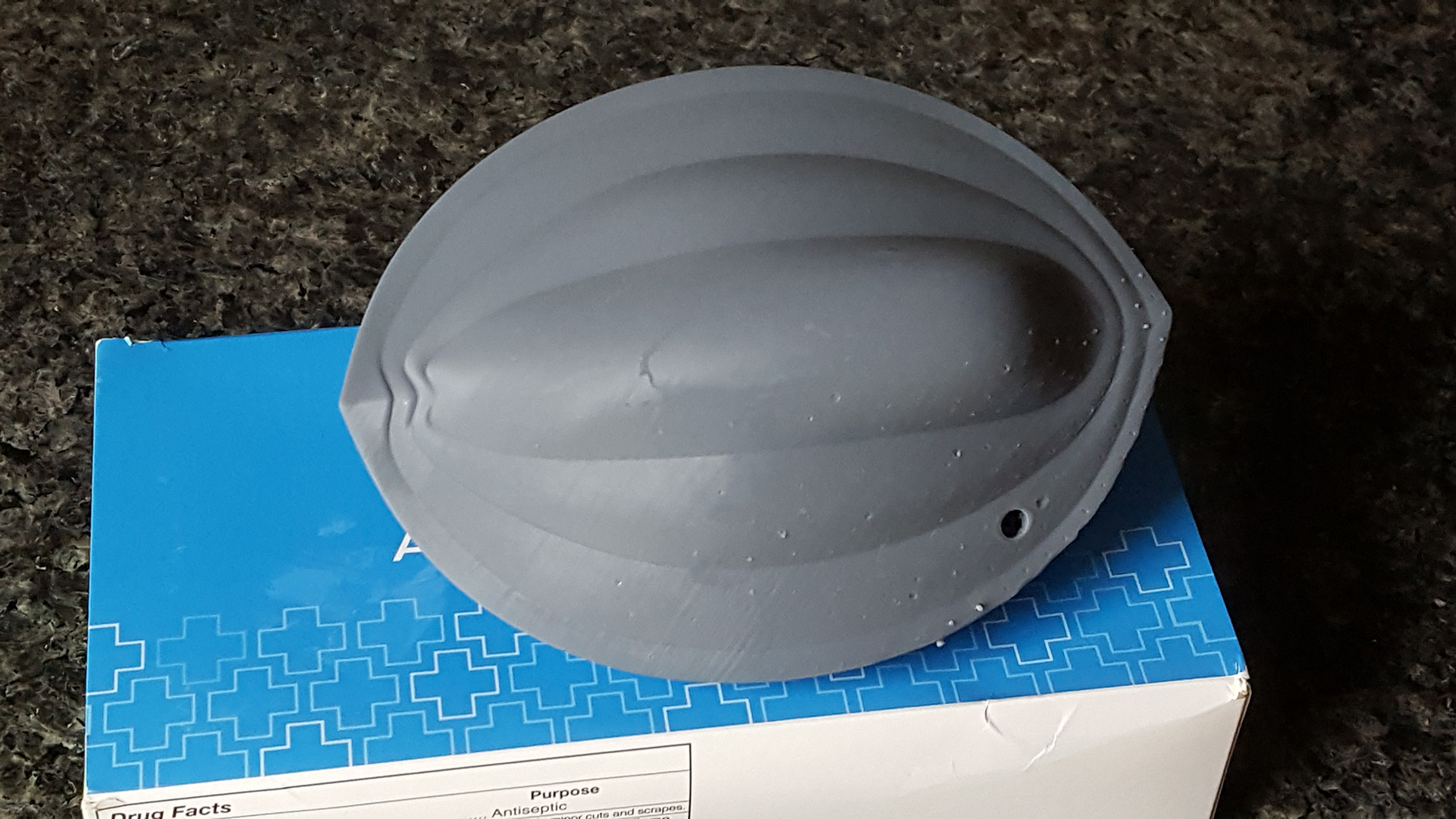

I got my Phrozen Sonic 4k mini a little while ago and after 4 attempts finally managed to get this to print. It's as big as the mini can do with this model, about 5.75" long. I probably over did it on the supports but after 4 failures I wanted to be sure. The dimples will easily smooth over with some filler though. :)
