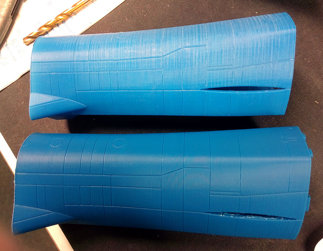

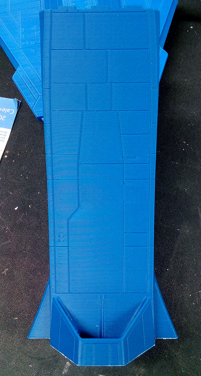

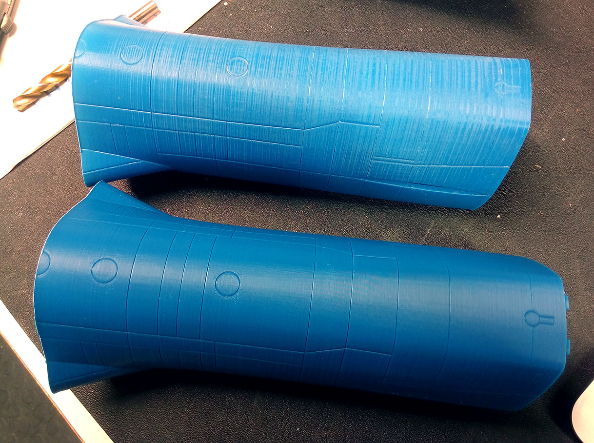

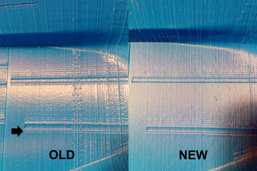

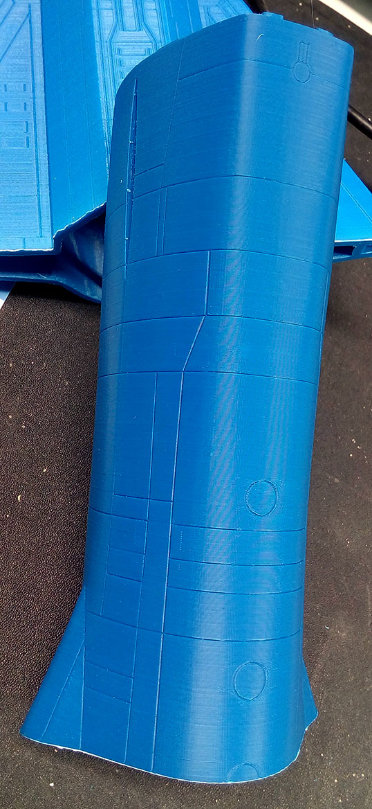

Did an upgrade on my print head and power supply on my printer which has improved the print quality considerably for the large ABS parts. They were not bad but it's reduced an artefact that caused low spots on one side of the panel lines that would require some fiddly filling.
Old vs new, the top part is a worse early print, but you can see the now parts look really clean and crisp in comparison
New on it's own

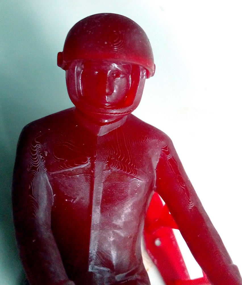

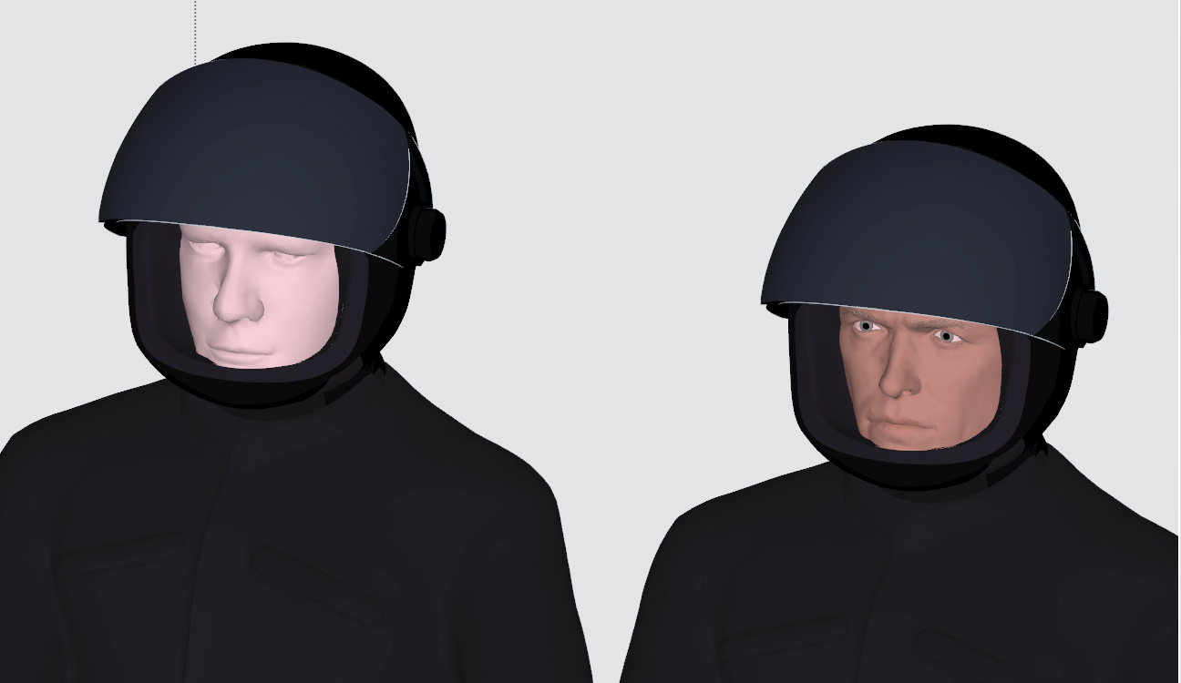

Sent out a pair of 1/18th's and did a Voskov pilot, found a game character face that was a reasonable match with a small amount of tweaking
Still finishing the 1/12th, re-printing some of the parts at my cost as I would rather the guy have better looking parts with less clean-up time.

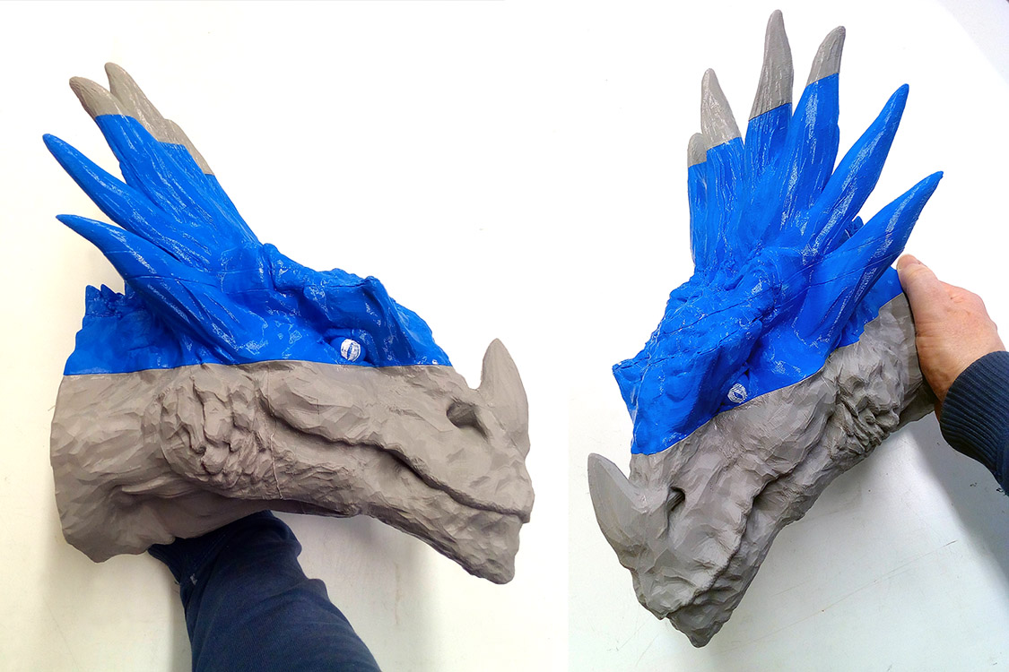

Totally unrelated, but did some printing with some spare PLA filament as a test, couple of hiccups hence the multi-colour, and will be using it to try out my airbrushing skills with my newly acquired airbrush set.

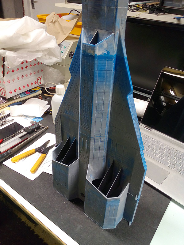

Finally getting some work done on my 1/18th.

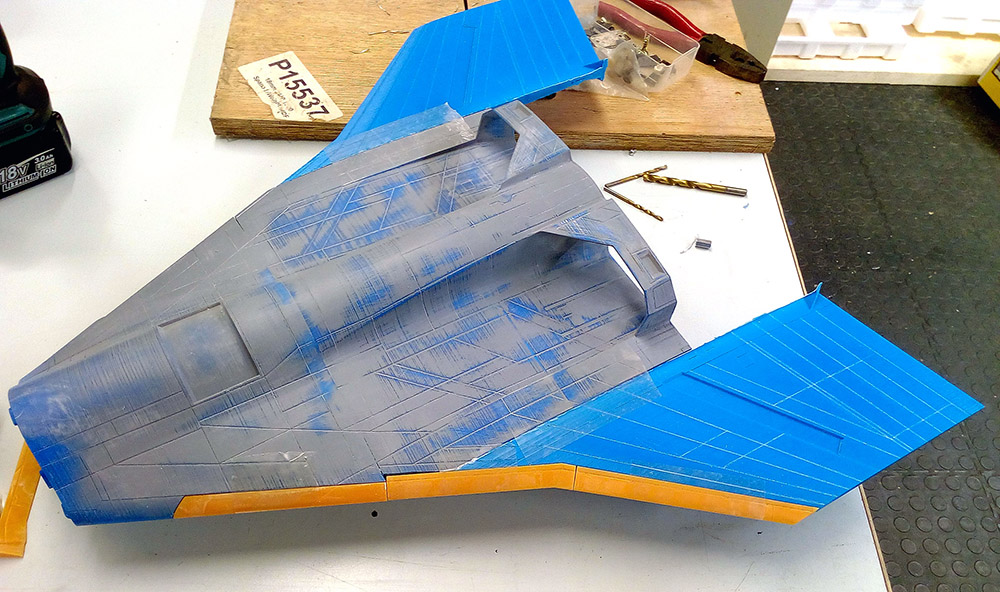

Test fitting leading edge pieces. I have changed the model since this, hence the slightly over-enthusiastic trimming of the blue ABS!
The front leading edge piece will be a bit bigger so the panel line is in the resin part and the joint will be easier to hide.

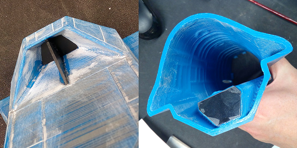

Adding the strakes and closing off the vents with 1.5mm ABS sheet
Discovered through a youtube video that Methyl Ether Ketone (MEK) is the stuff to bond ABS with, paint on the surfaces push together and in half an hour or less you are good to go.

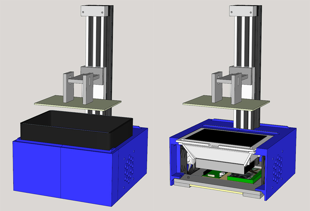

I'm not ready to make the 1/48th kits yet, I have to get together my custom printer which is big enough to do a kit at a time at high enough resolution
I have all the parts, just have to print the blue enclosure, build the light box etc.

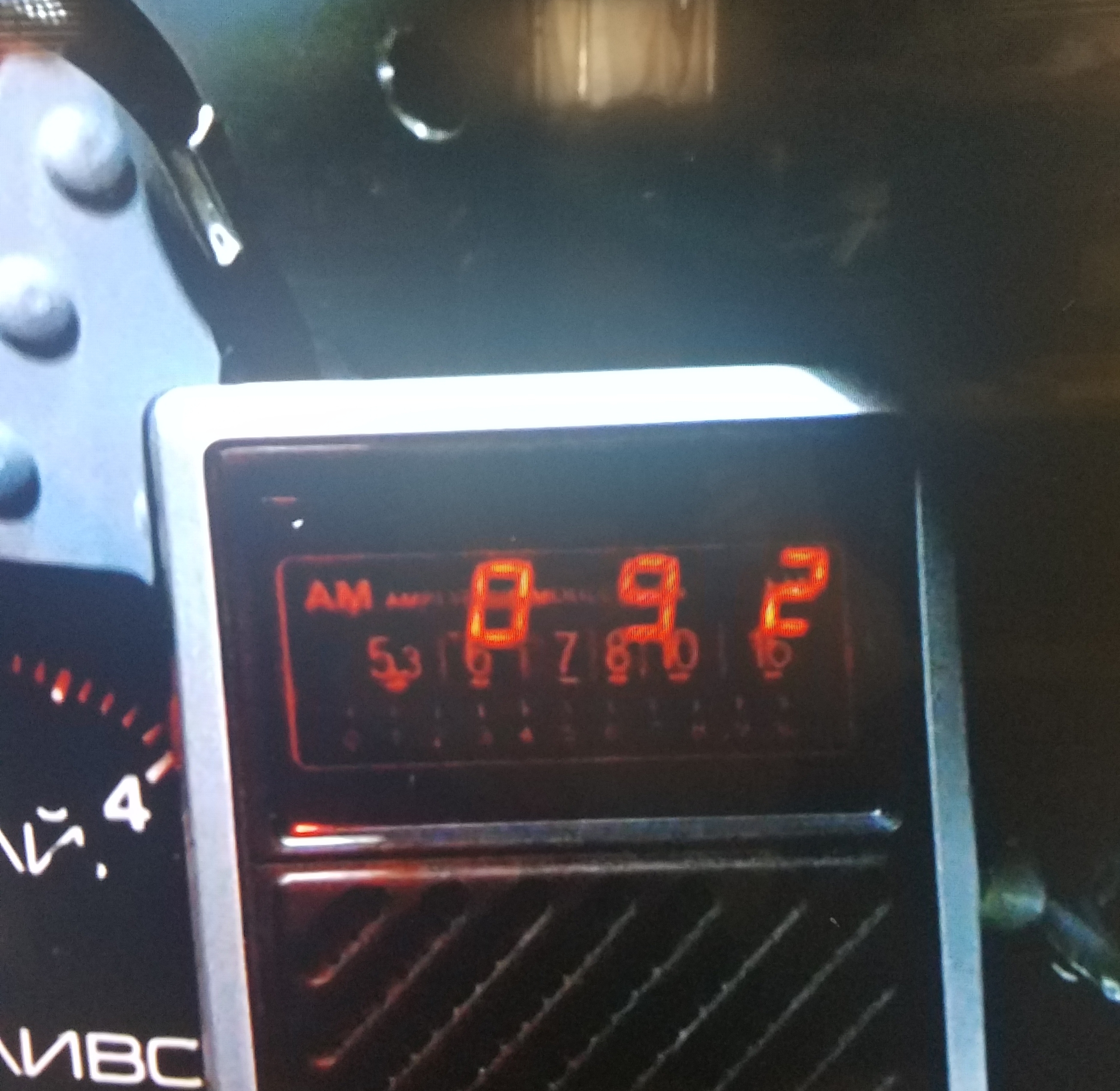

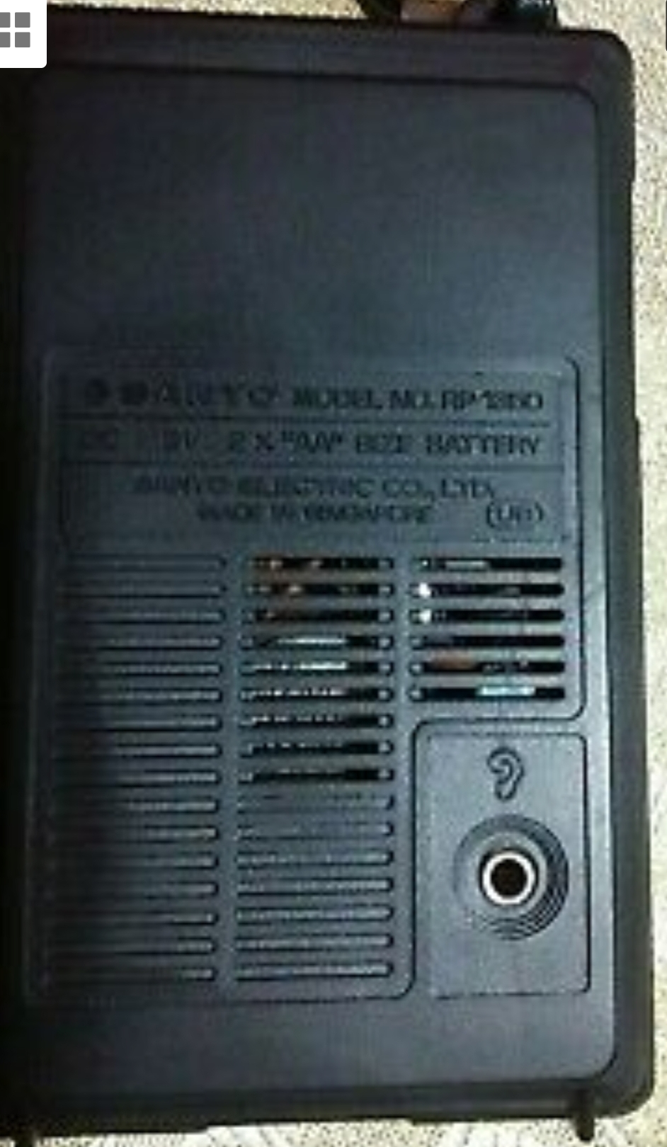

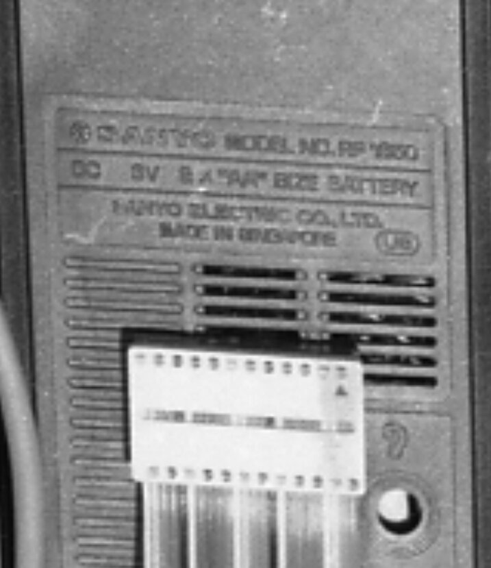

I was curious about the black rectangle above the right rudder pedal. Zoomed in to it. Noticed what appears to be non-Russian words. Could see that it is English text. Couldn't read it until I did a screen cap, then flipped it 180°. Realized that the text describes the make and model of a compact radio, usually found on the back. Turns out it is the one that the production used to represent Gant's radio/homing beacon. You can see it is a SANYO radio, model RP 1350. So just bought one from eBay. Here's a couple pics of it from the eBay listing. Also a screen grab of the radio from the movie. Looks like they used gaffer's tape to cover the logo. There are a couple of these radios still available on eBay. Haven't gotten my radio as yet.

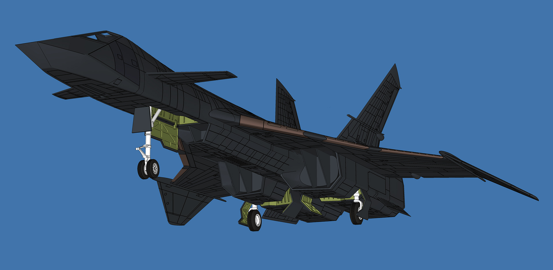

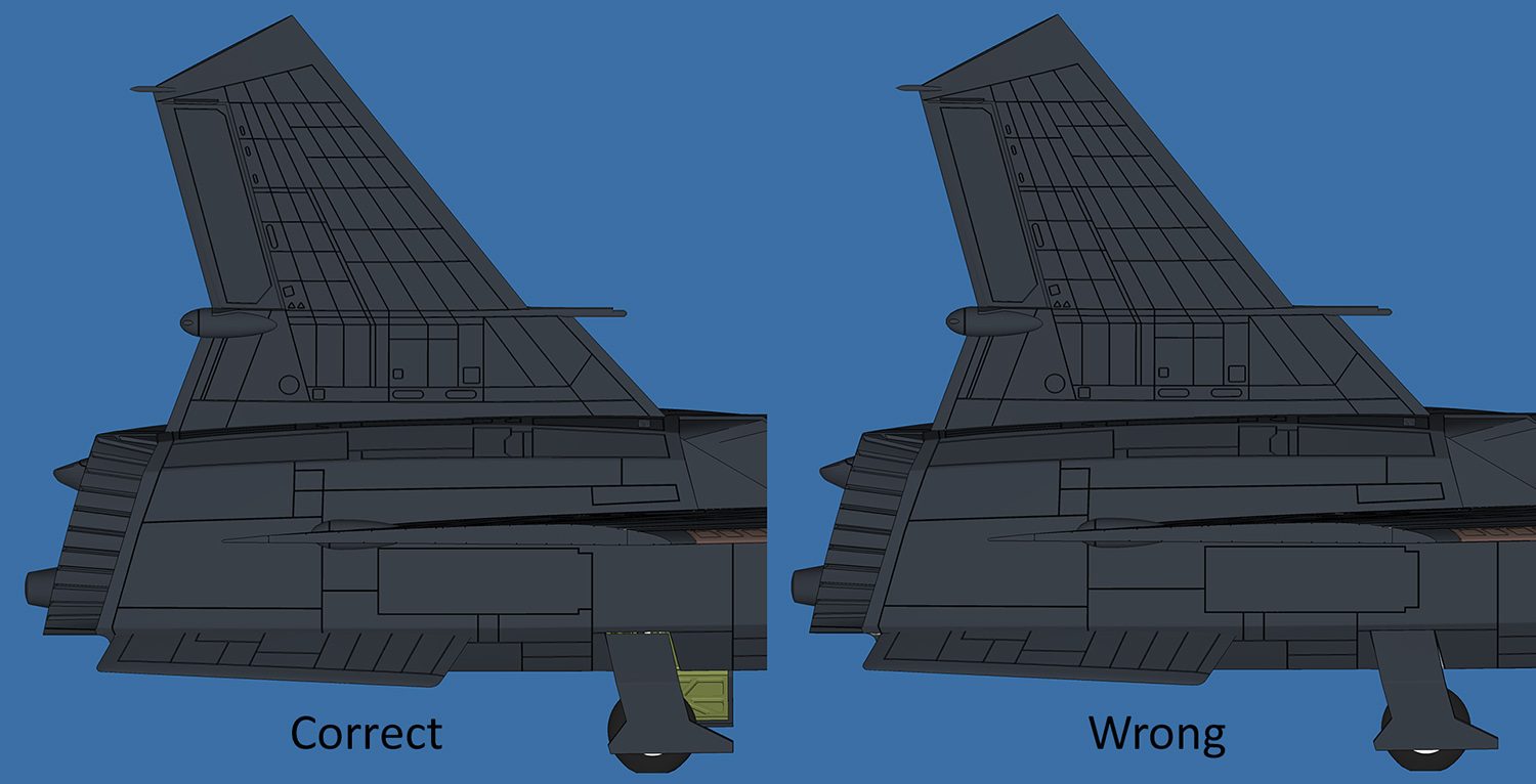

Yes, worked on display landing gear for someone who asked for it.

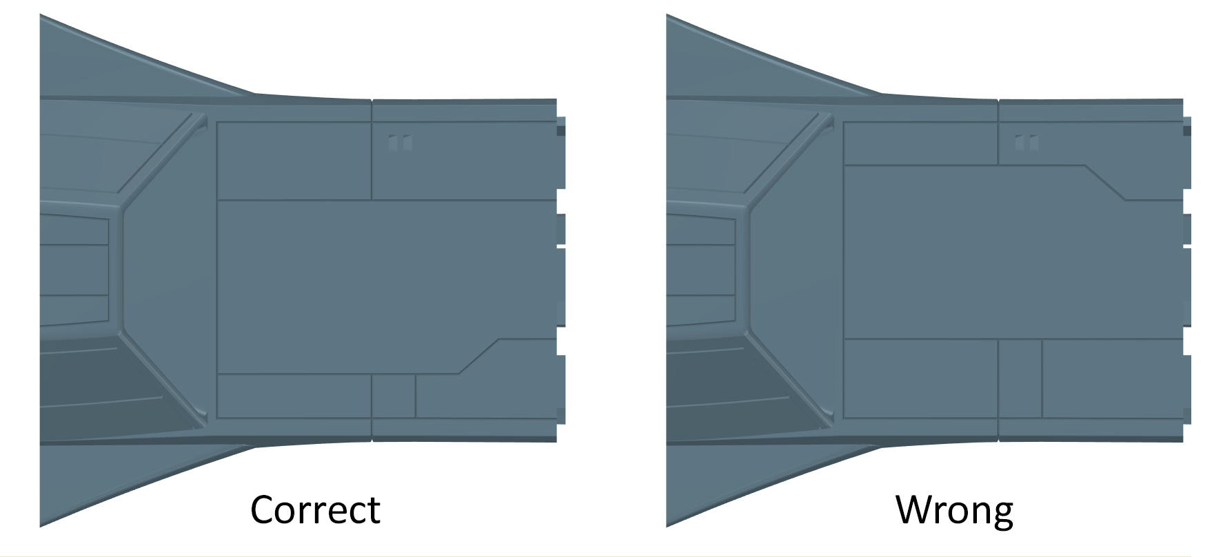

- and in doing so discovered two mistakes.
Had the missile bay too far forward, got it wrong as the two 1/12th scale studio modes are different to each other, so not necessarily wrong, but the missile bays and landing gear bays can't coexist otherwise.
Also had the front landing gear bay door reversed

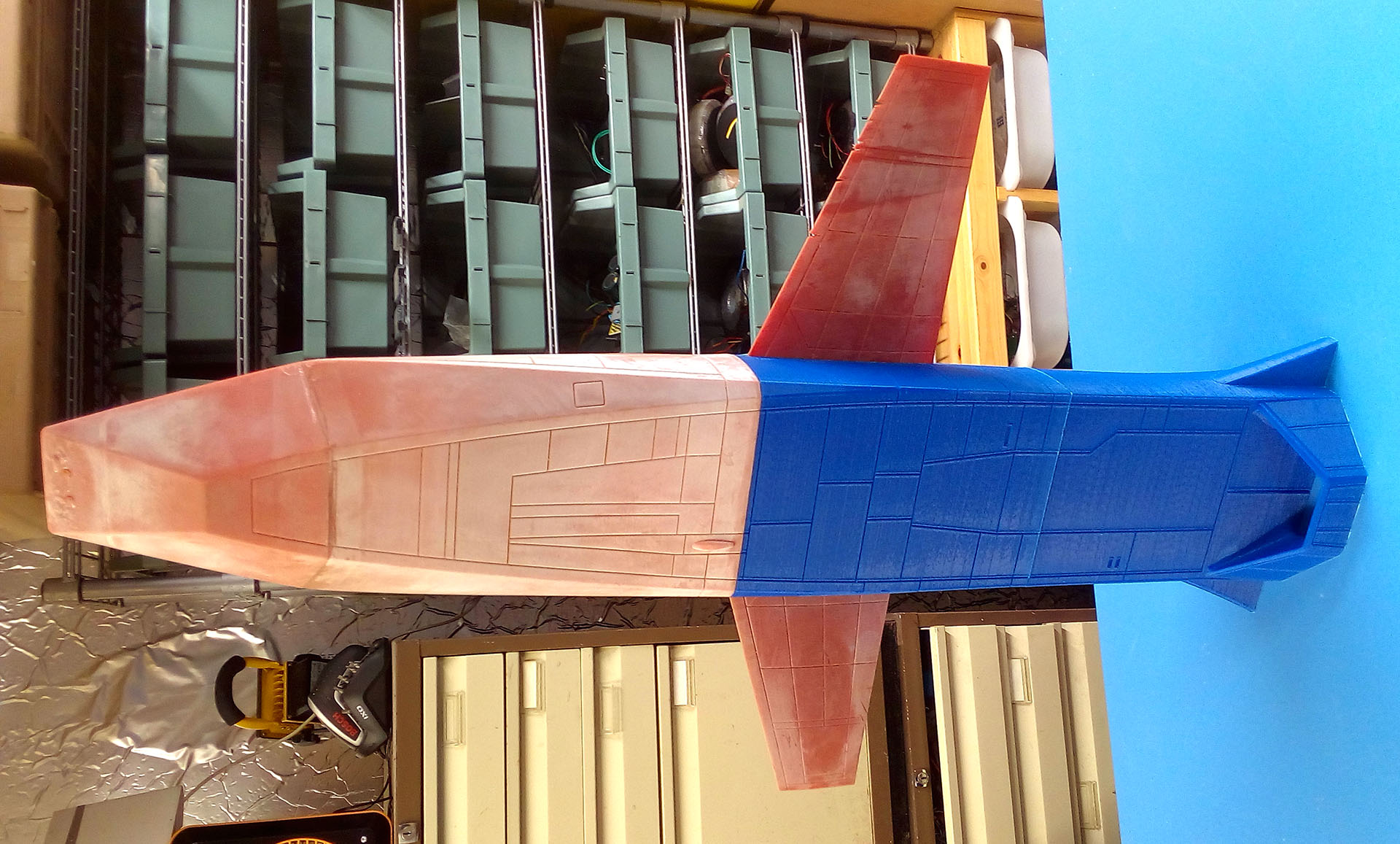

Aside from dealing with the craziness of the world have delivered the first pair of 1/18th scale kits and am reprinting most of the ABS body parts for the 1/12th as the print quality is so much better with a improved print head.

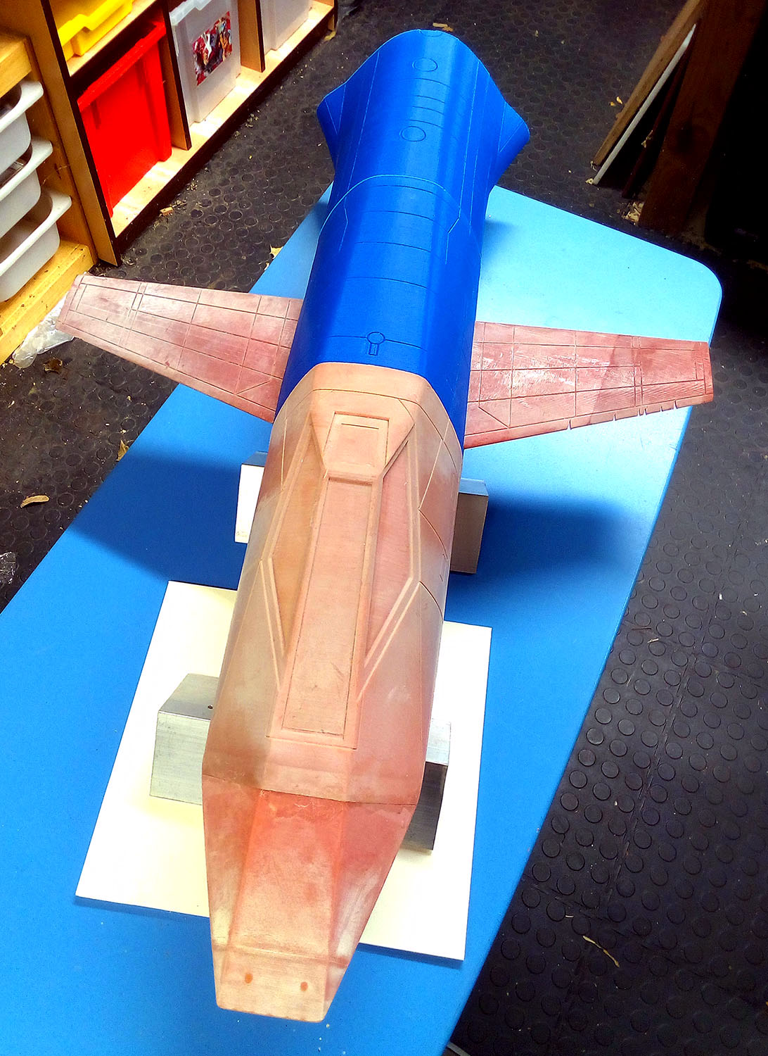

Just printed a 1/12th nose which is enormous, will post picks when it's cured and cleaned up.

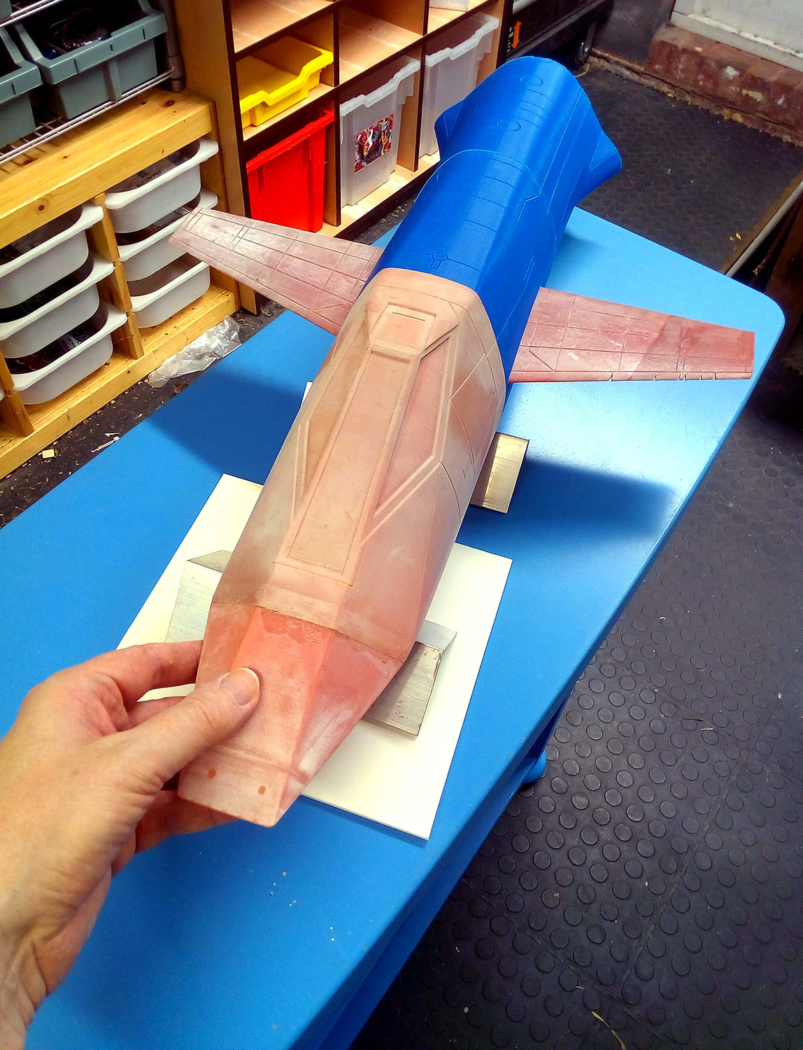

Bit messy as I had just glued the nose part on with epoxy, and the resin custom mix looks like flesh in the pics, but here is a studio scale 1/12th nose section
Have to fix the one canard leading edge, updated the slicing software and didn't realise it had overridden my slower lift speed, so got some layer separations.
