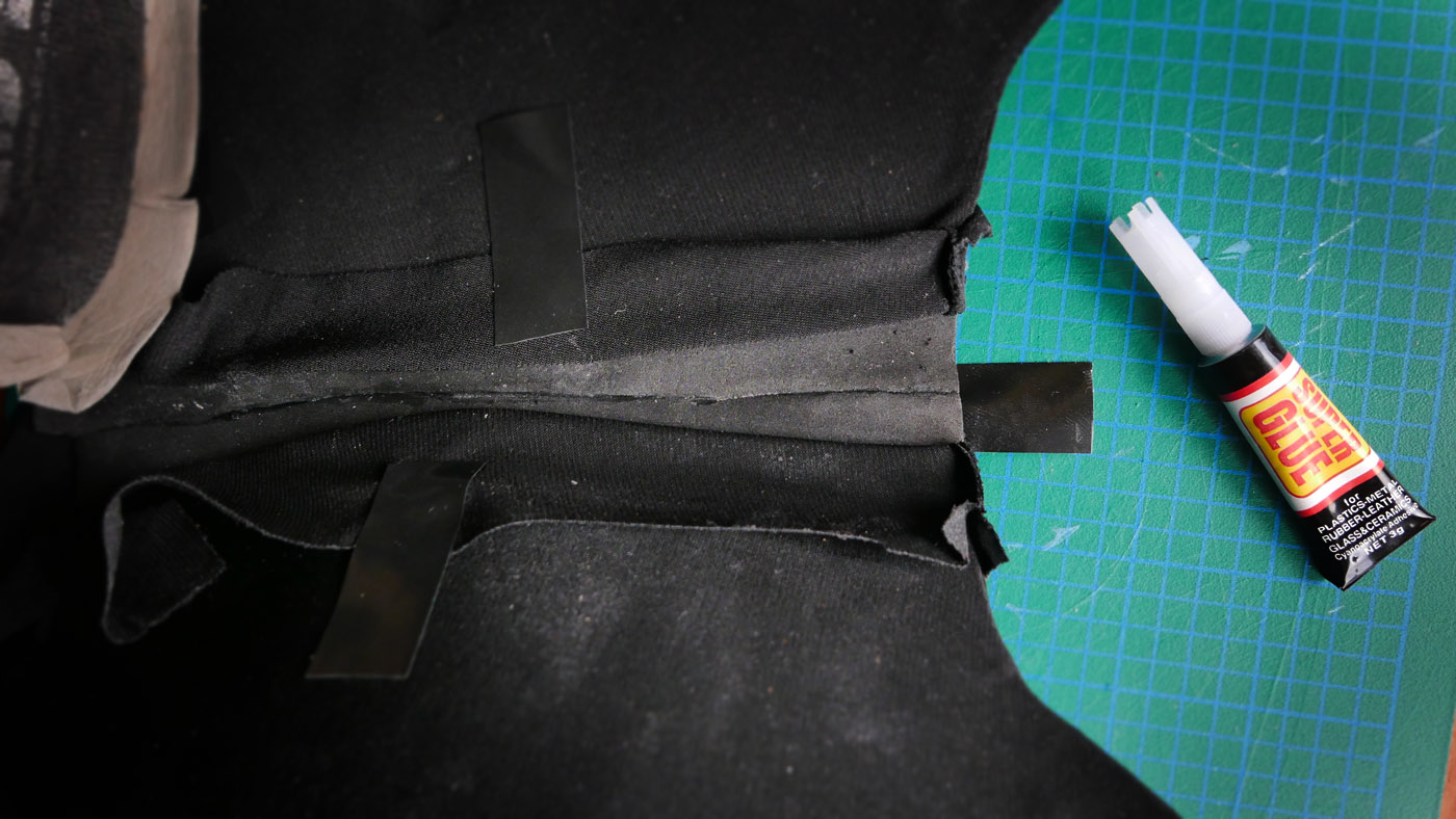

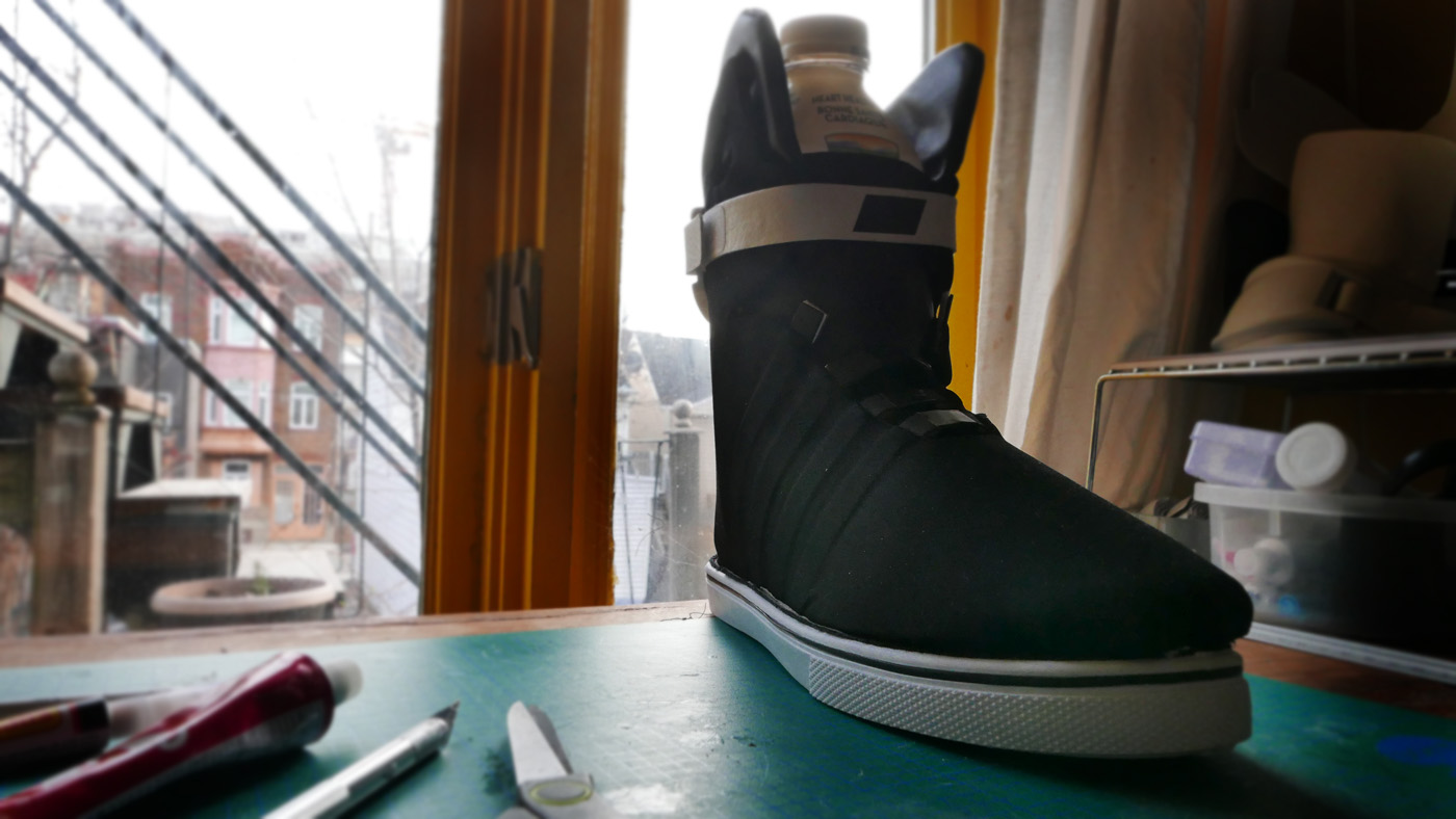

New update : Join the back (but I have to sew this part to secure it) :

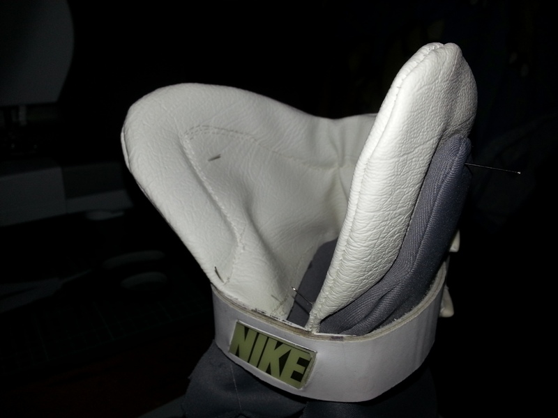

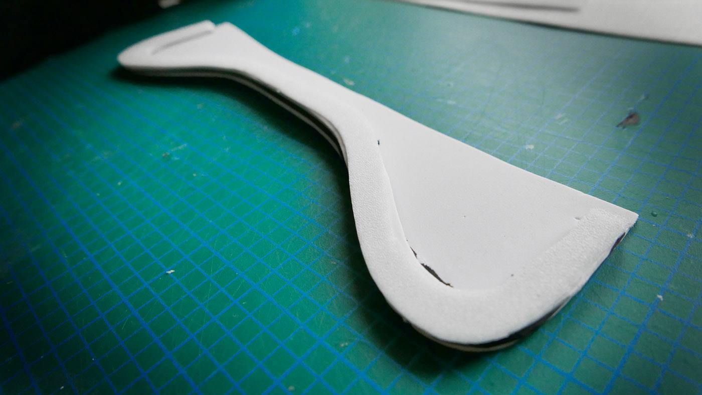

Making the ears (foam + fake leather) :

Is that seam external or internal? Yes you have to sew those.
cavx : Its is an iside view. I've glue the 2 foam parts together and I'm going to secure it from the outside by sewing it. I don't know yet how but I have to find out a way to make it :/
It is really challenging for me to find a solution on everything as it is my first try ^^ and hand sewing is sooooo long so I have to do things right or I'll have to re-do everything -_-
Like the ears, I had to make it 2 times before making them the right way (and I also need to find out how to attach them :/)
Yes, these shoes can look simple but if you want them done right, it is really hard to make them all by hand !

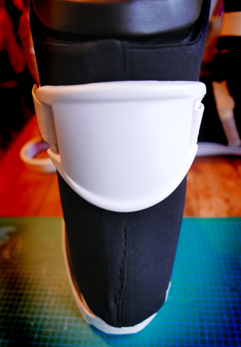

I'm thinking about making a visible seam on this part as the're black, the thread isn't really noticeable... Yeah, "the lazy way" is getting me :D
It is not perfect but with the Heel Cup and the Ankle Bucke, you won't see so much of this seam :
NEXT : Finding how to attach the ears :/ - Any advices are welcome folks ;)

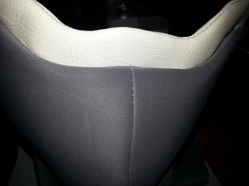

You are supposed to sew that first, then turn the upper inside out.
I needed to use closer spaces stitching, but you get the idea.
attachment.php
The cuff gets sewn to the liner and why that seam is not visible from the outside of the shoe.

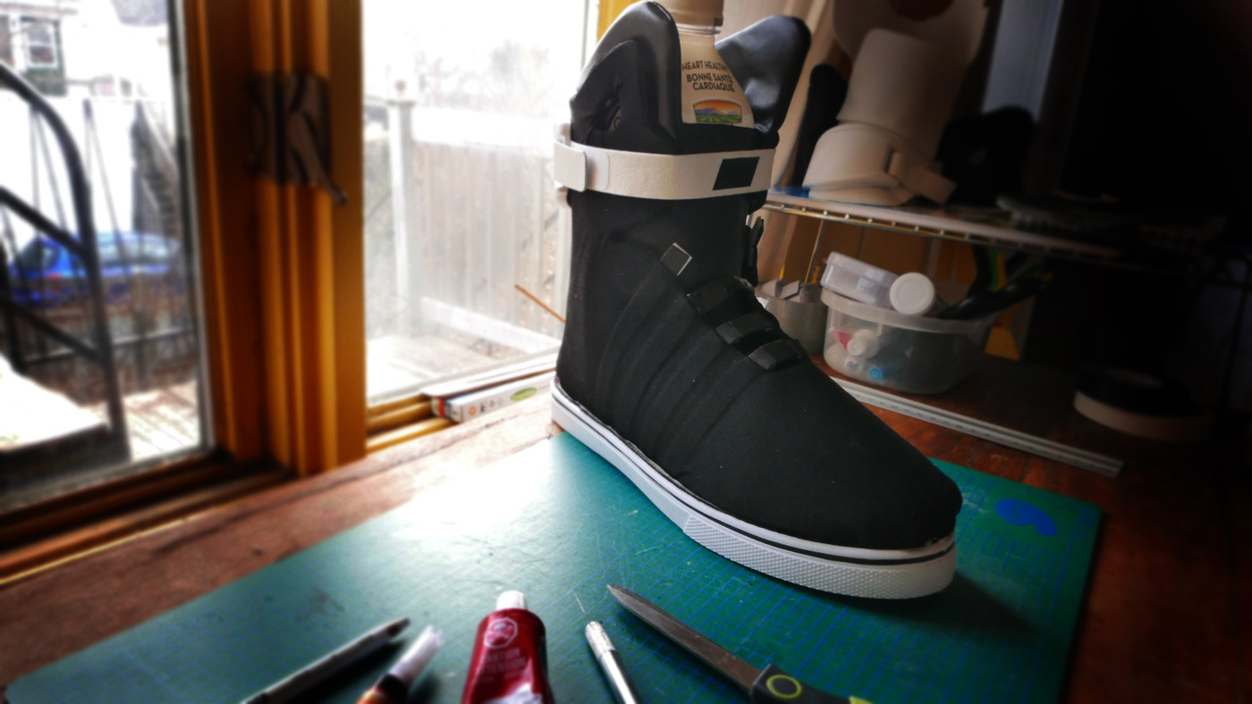

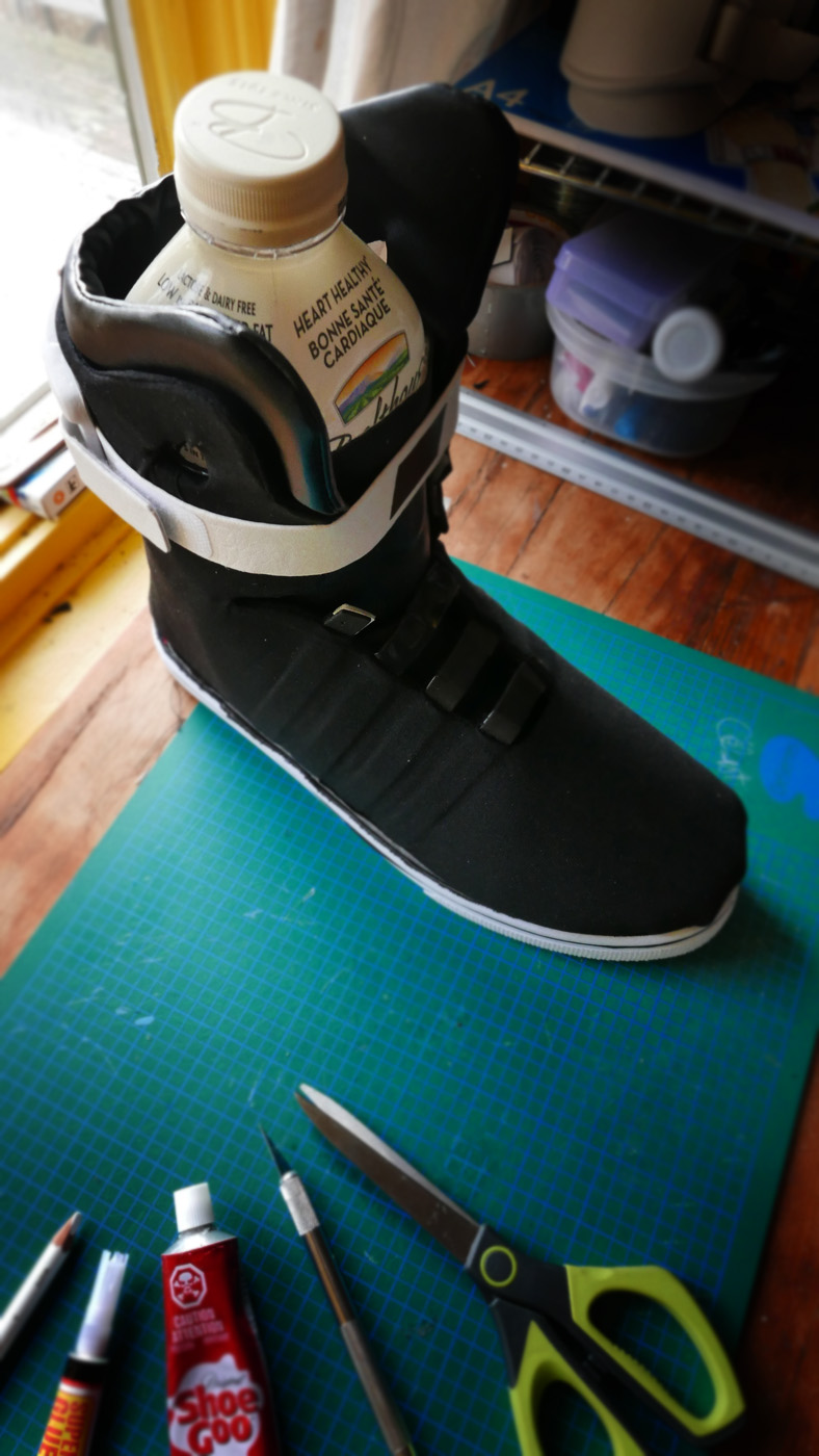

New improvement on the back :ninja
Sewed this :
For this to be possible :devil :
EDIT for @cavx : I get it, but I made my foam attachement too soon so I couldn't make this kind of seam
as I've glued the fabric too soon on my structure -_-
It is trial and errors so It can't be that messy the next time.
About the cuff :
I didn't know that there was a liner in the MAGs...
Is it a removeable one or is if fixed (I guess it is fixed) ?
I guess it is a thin liner. (or it is simply the inner fabric maybe... So I sould have attach the cuffs before sewing the inner to the outter fabric)
If you look at those patterns, you will see the liner. The cuff attaches to that and there is a small collar parts that joins the cuff to the collar.

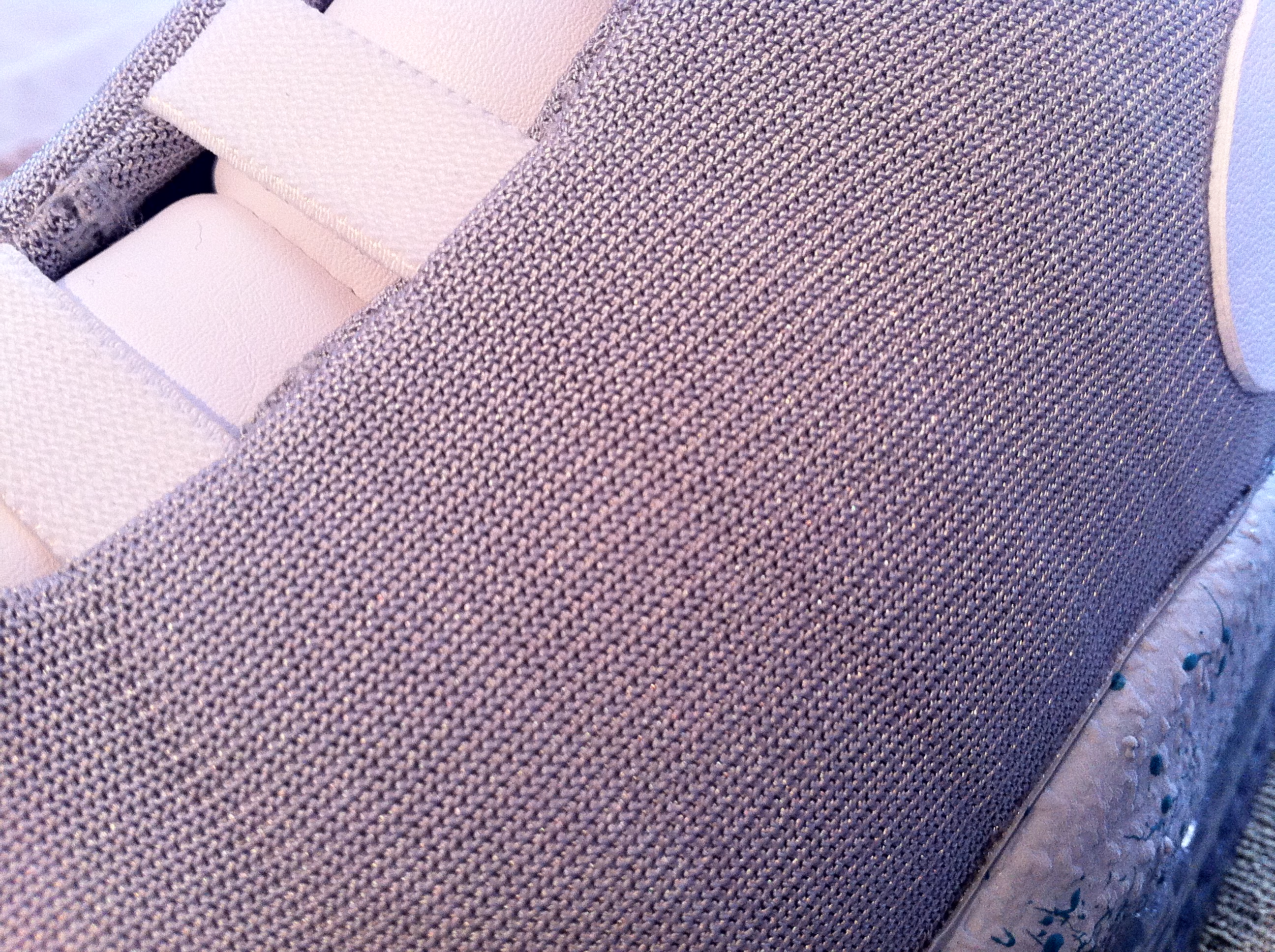

Ok, I'll check if they have something grey at my local fabric store.
By the way, I've used spandex for the black ones but I don't remember other colors on the shelves :-/
@Jedifyfe : Did you have my Message about the your yellow Mags ?

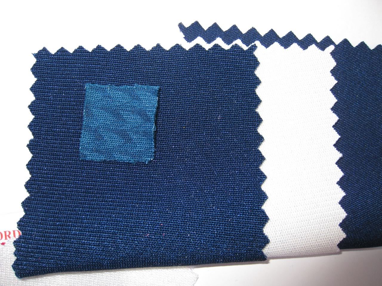

From memory, Nike stated had they had the fabric custom made after they could not find a match from fabric supplies.
I am nearly 100% sure that the fabric is a Jumbo Weave Spandex. When I say Spandex, I don't mean the shiny slick material. Jumbo Weave Spandex has a chainlink type weave. See the comparison here:
Shoe Fabric:
Jumbo Weave Spandex:
I'll ask if they have this "spandex" but I'm pretty sure they won't :(
Thanks for this precious info.
I think I've read something from him about this and that's why I was thinking about the accoustic fabric :rolleyes
