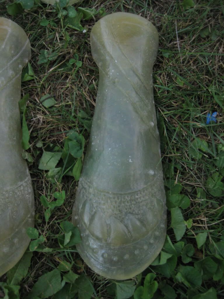

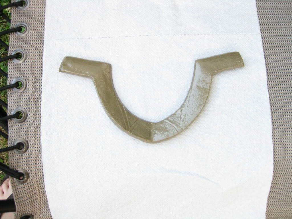

Three days before the con I begin the casting of my pieces. The necklace and bracers turn out pretty good as they are much simpler pieces than the horned helm. There is minimal air bubbles and a pretty even thickness so they require much less effort, phew. Good way to start out anyways!
Necklace and bracers cast in fiberglass resin with edges sanded down
Primed
