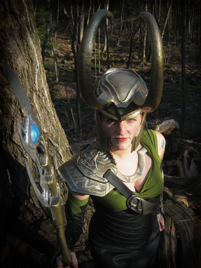

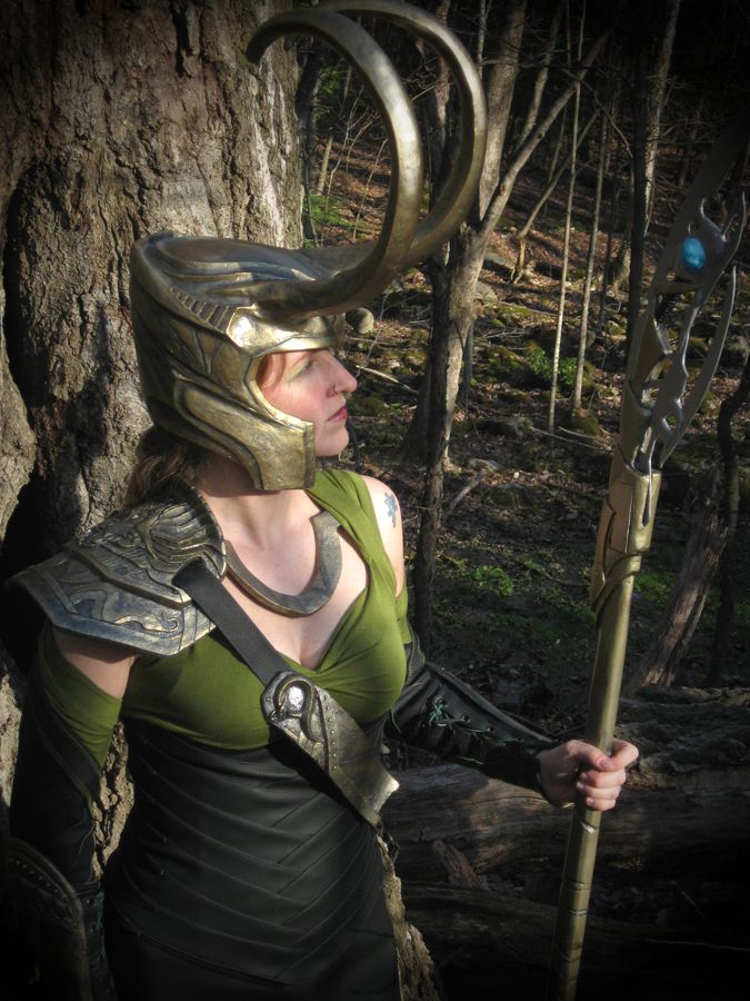

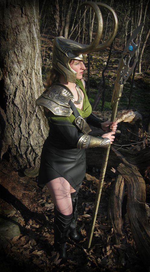

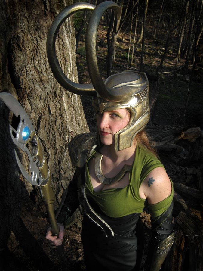

Finally got some pics taken of the costume in its current, more complete state! I still want to make the jacket, and maybe cape, but it's looking a lot more whole and satisfying right now. Yay! So, here is a bunch of pics because I'm bad at narrowing them down. Also I suck at posing, and my friend who is not a photographer took the pics in my backyard so... not perfect, but we enjoy them :p Hope you do too!
There are a few more pics up on my FB page (click on link in signature below) so feel free to check those out and like my page too :] Thanks for looking!
I love it! That last picture is epic, lol. I'm really liking the shirt - is this the new one that you made?
Thank you! Yeah I like the last one just wish there weren't so many branches in the background. And yep that's the new shirt I made :D
Spectacular! I also like the "epic" last one :)
Great choice with the decorative stitching on the gauntlet/sleeve guards.. it really ties the arms to the top.
I started watching this thread when you were mostly working on the soft parts. I totally forgot you sculpted and cast the armor completely from scratch too! The entire look has come together so well. That shoulder piece is a thing of beauty.. love it.
Thank you very much! :D I did end up being glad i did the upper arm pieces, the top looked bare and too separate without them! Thanks about the armour also, my shoulder piece is definitely "my precious" out of all the costume elements :p
Thanks verrrrrry much! :] As to the last pic yes I agree need to see the staff better. I think I'm going to redo the paint job on it and take more pics next month :D
Really awesome! Looking forward to seeing more of your stuff! I'm gonna be making a Loki myself here shortly, so yours is a great inspiration. :)
