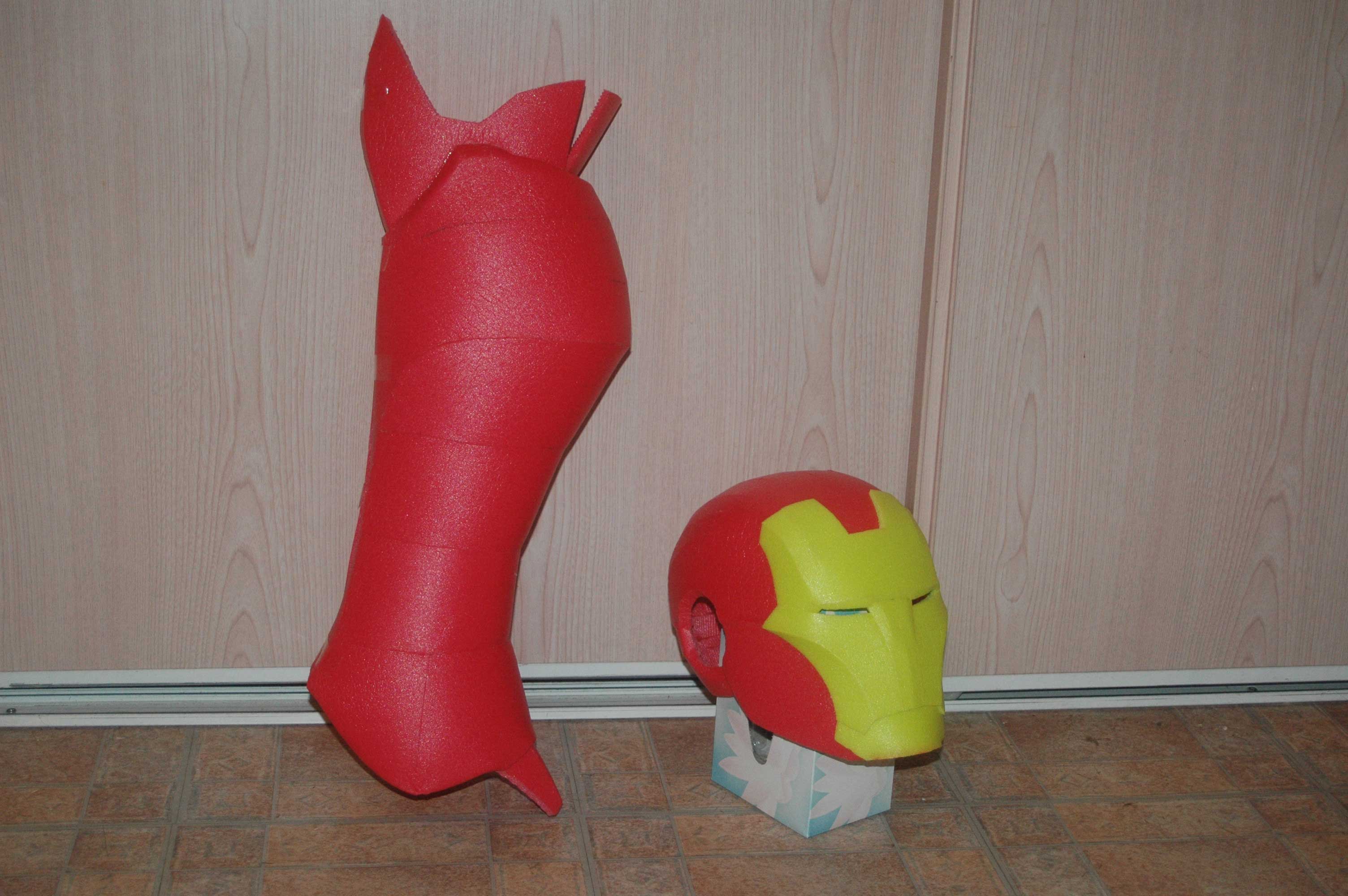

Be carefull with the legs. Thighs and shins are modeled to fit a videogame character -not an human being- and are about 10 or 15% too long. If you rescale them by decreasing the ratio, they won't be wide enough anymore to be weared. Or if so, you might look like a wading bird. For my own I had to extract back the obj files and edit them under Blender (or anything else) in order to restore some human proportions. These moded legs are not included in my package, I'll upload them and post a link if you wish.
For the same reasons of its game's character's origin, the helmet HAVE to be scaled. Don't built it on the heels with the same scale factor than the rest of the parts. It actualy has the size of a head itself, not the size of a helmet.
Pieces destined to the trash...

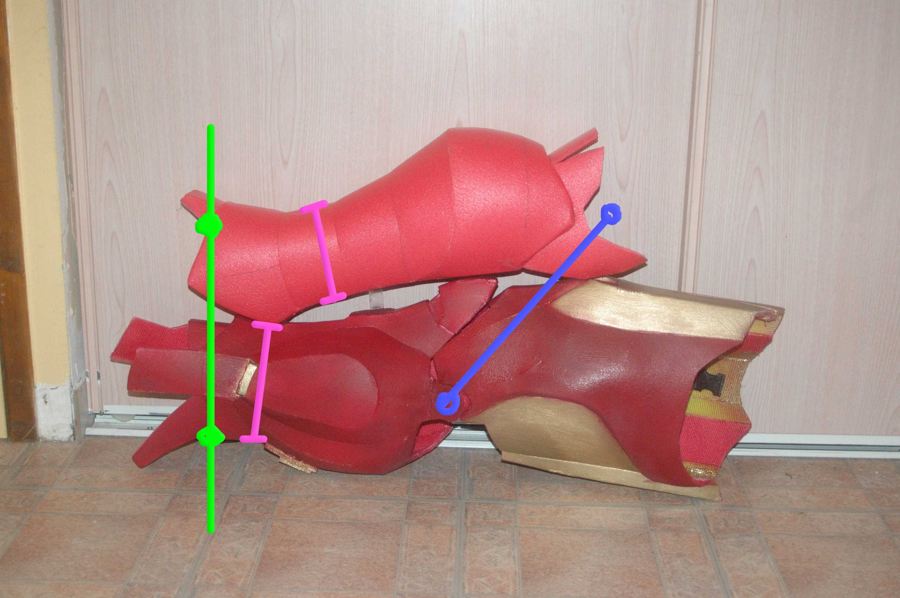

-EDIT-
a quick comparison with a well proportioned mark4 leg
for quite the same ankle circumference, we have the Extremis knee's articulation at the half level of the mk4 thigh. Rescaling the shin piece to shorten it will also tighten the ankle too much to wear it, moreover with thick foam.
--reEDIT--
-EDIT-
--reEDIT--

dude you are a hero!! i noticed that they were waaaaay to thin or way to long so was gonna jus add foam to the back to extend their length but this looks way easier! cheers!!
