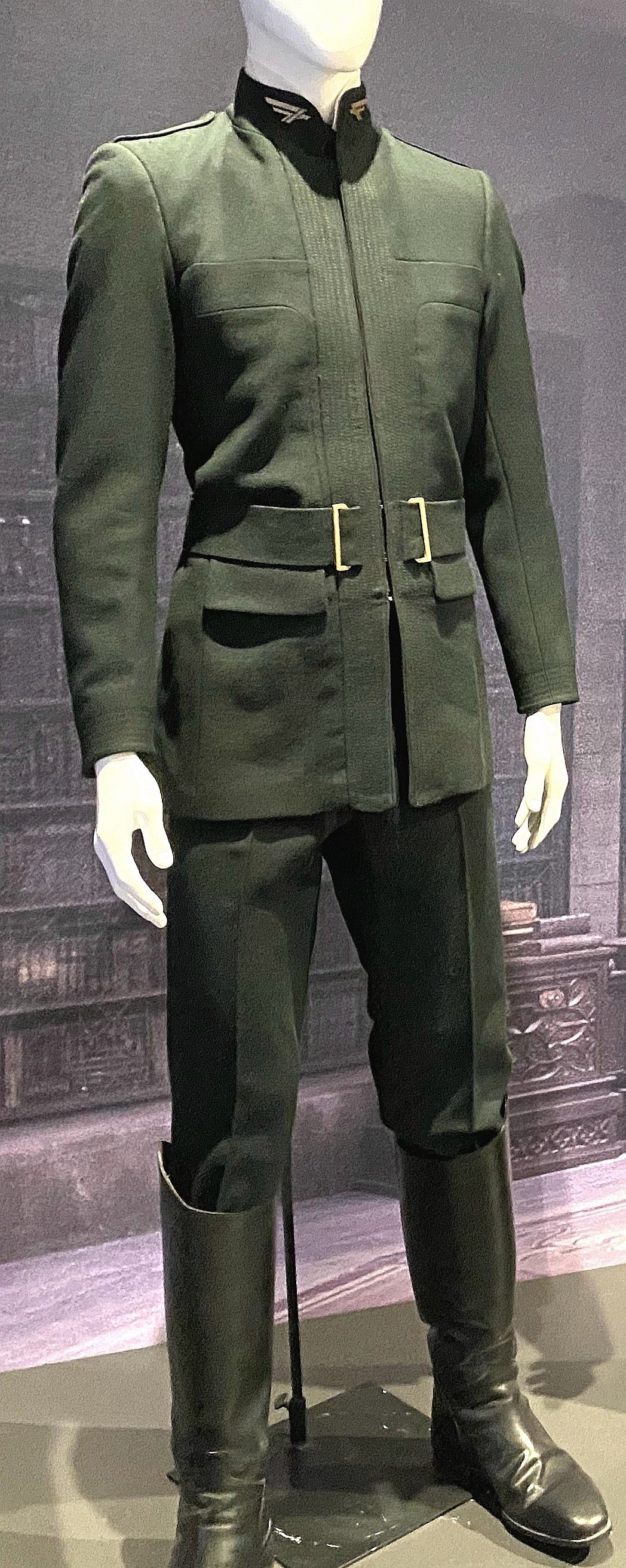

Leto's uniform is largely identical to those worn by everyone else aside from the added accessories, but it also features gold piping on the cuffs and collar:
The above pictures seem to show visible hook-and-eye closures underneath the jacket, but in this BTS picture it looks like Paul's has a zipper, so it's possible that different versions of the jacket were made (or I could just be misinterpreting this photo). I'll probably use hook-and-eyes on mine since that feels more 'proper' for a military dress uniform:
The piped seams on the cuffs aren't present at all on other versions of the uniform, but I'll assume that the breast 'pockets' are:

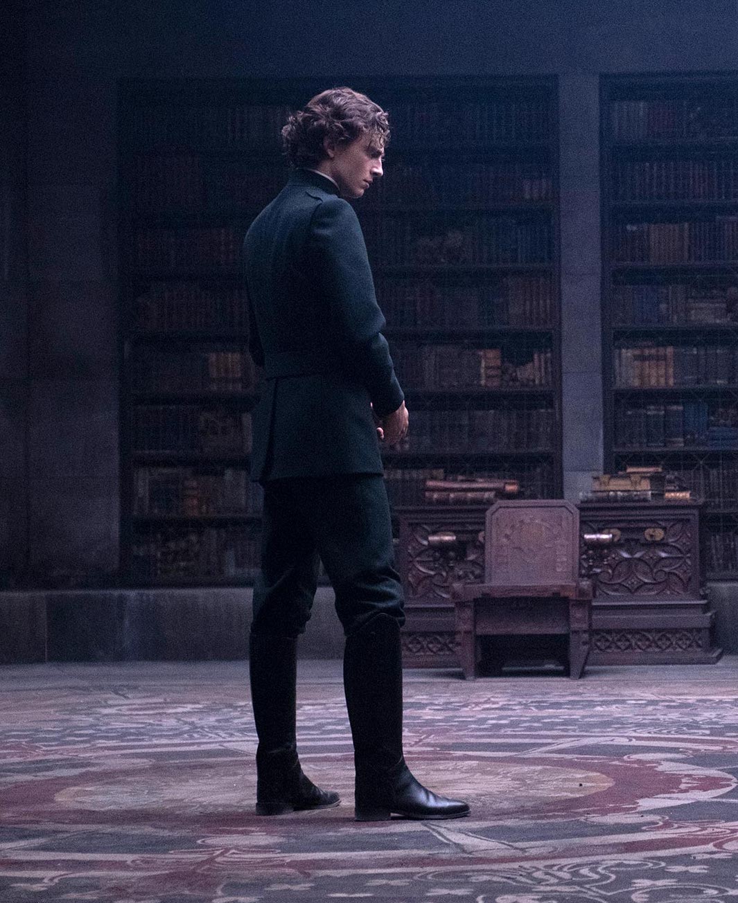

The back seems to be very plain, with the belt (as you can see in one of the above photos, the buckles don't do anything; someone on Facebook suggested they might be slots to hold a weapon belt in place rather than intended to be buckles themselves) continuing all the way around with no belt loops and with just a single vertical seam (probably continuing up the collar, but can't tell for sure) with a single vent:

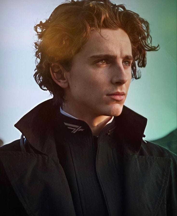

But there clearly isn't in this image of Leto's uniform (aside from the gold that's on the collar):
And Paul's uniform looks a little off in the above image anyway (the collar badges look black, like they are on the working uniform, and while it could just be the lighting, with how direct it is on his face I'd expect the brass color to show up a lot more than that), so I'm wondering if that could be a different variant of the uniform? I'm probably not going to include piping on mine unless we can find definitive evidence that the uniform he wears in the rest of the movie has it.

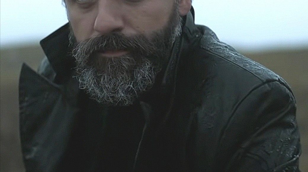

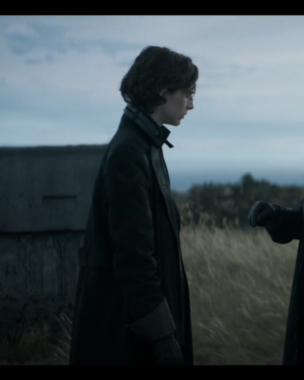

The trickiest part is the trench coat, not because of the design (it appears to be extremely simple, as far as coats like this go) but because there are very few decent images of it, and none at all from the back. Some of these images are photos I took of the movie on my laptop (damn you AppleTV and your stupid anti-piracy screenshot blocker!) so I apologize in advance for the horrible quality.
It seems to be made of some kind of shiny, waterproof material, probably waxed or laminated cotton. It's very long, almost ankle length, and it has peak lapels and a big collar. There are no fasteners except for a belt to tie around the waist and two smaller belts around the collar. It's got an Atreides hawk sigil on each sleeve at the shoulder.

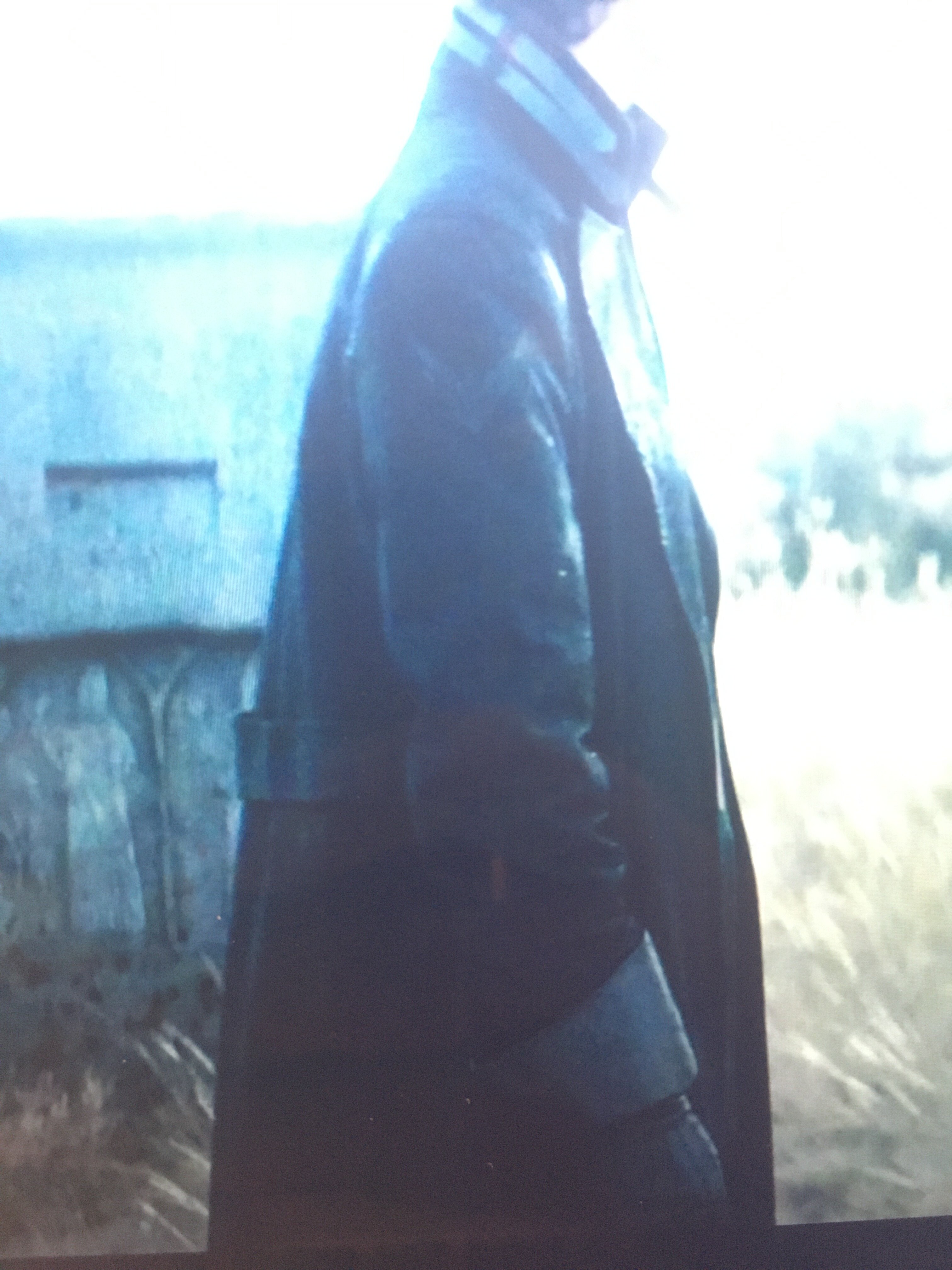

The cuffs (rarely seen, since Paul and Leto are wearing the leather gauntlets in most shots where the coat appears) seem to be completely plain:
The collar straps are secured with individual belt loops, one set on each side. The ends of the straps on the right (from the POV of one wearing it) are pointed and the ends of the left are flat. I don't know what to make of the straps, since there don't seem to be buckles or buttons or any other visible fastener on them. It doesn't make sense for them to be purely ornamental, though. I'm not sure what I'll do about them.

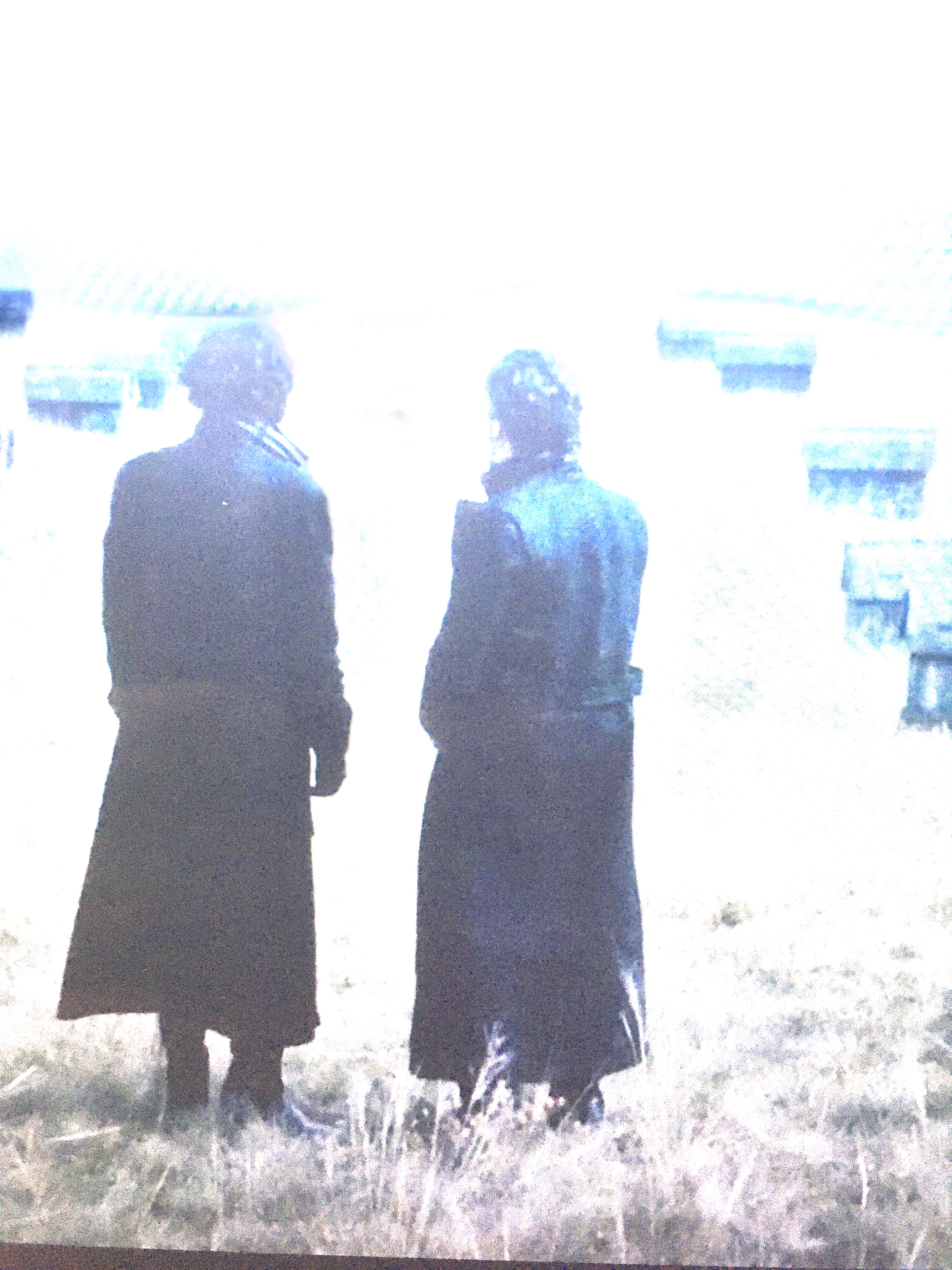

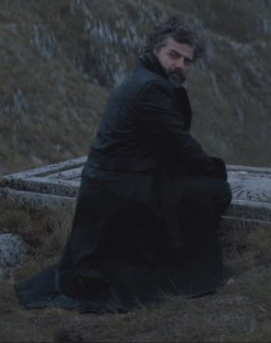

The hardest part is the back. We can't really tell anything about it at all without adjusting the exposure to see a little more detail since the images where the coat appears are all very starkly lit, but it looks like the back is very plain, with no seams or vent. (The coat on the figure does have a vent, but it really looks like there isn't one on the actual prop, so unless someone can find a screenshot proving it's there I'll assume that's an inaccuracy on the part of the figure.) The collar seems to have a separate piece around the bottom edge, like many collars of this style tend to have (sorry, don't know the technical term).
However, complicating the coat is this shot, where it almost appears to have a horizontal seam across the shoulders. It's clearly not there in the earlier images of Paul and Leto standing in the graveyard, and it definitely could just be a crease in the material, but it really looks like a seam to me. I'm not sure what to make of it but I'll probably err on the side of not including it, again unless someone has another image proving it's definitely there:

It is very common to add a hook and eye fastener at the top of a zippered closure. The top of a zipper tends to be broader and sometimes forces the two edges apart. The hook and eye brings the edges back together and helps “hide” the zipper pull. Also in women's garments where the zipper was in the back and difficult to manipulate, the hook-eye provided additional strength so that the zipper did not unzip if the fabric came under stress or strain.
A collar of this type are two pieces - a collar and an undercollar. Sometimes the undercollar is cut on the bias. Even with the same fabric, the bias can can appear different as it reflects the light differently. Also to hold the edges of the two collar components in place after they are sewn together, the undercollar is understitched. This makes the edge of the undercollar stay inside the collar and less visible. These two factors may be producing a “piping” artifact.

The large coat collar is also a cold/wet weather feature. The storm collar is stood upright to keep the rain and wind out. The straps hold the collar snug around the neck. From your Paul coat 1.jpg and img-0539.jpg it looks like there is a small flat (rectangular?) slide or buckle on left side end of the collar straps. The right ends of the straps might just slip through the opening in the slide. The action figure images looks like they might use a velcro omnitape which can hook and loop to itself to attach the ends together.

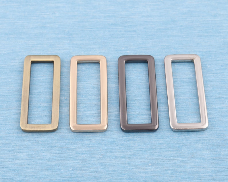

Slide buckles on the collar straps make sense, I thought it looked like there could've been some at first but I wasn't sure. Now to somehow find some that at least look close in a small enough width...

The Uniform Collar can be made from a single piece of fabric without a seam. The only thing is it requires a lot more fabric and the grain of the fabric cannot be aligned with the jacket front in any reasonable way. The collar piece before attachment would look something like a cotter pin with the legs spread apart. This is because of the slope of the shoulders. I have also considered putting the seam at some point or points around the collar other than the center back. The seam(s) might be hidden to a degree by the six lines of the collar's top-stitching. A stair-step type seam (or two) might be less obvious than one which goes all the way across at a single point. I may try to mock up a sample with my fabric to see if a seam is noticeable or not with the top-stitching.

The Trench coat collar buckles might be something like this slide below with a much narrower opening. I am also looking to see if there is a type of clamping buckle which might sit on the end of the strap.

And also related to vents, I'm still trying to figure out whether the trench coat has one. The coat on the figure certainly does, and the way the bottom of Paul's coat is blowing in this shot kind of makes me think the prop coats might have a vent too, and we just can't see it on Leto's coat because that portion is still too darkly lit. The left side of his coat seems to be getting blown out by the wind, and if there wasn't a vent I'd expect the entire bottom of the coat to be blown that way, but it only seems to be affecting the left part (but again, it's very hard to tell for sure).
If there is one, I'm thinking it wouldn't be a traditional vent like on a suit jacket or overcoat, but a V-shaped one more like on a fishtail parka (or Officer K's coat, I think? Unless I'm remembering it wrong), since there definitely doesn't look to be a vertical back seam.
The height of the back vent on the dress uniform is my best evidence of the jacket having a peplum where that seam is covered or hidden by the belt. I believe the vent separation goes all the way up to the seam under the belt.
As far as I understand, Paul's uniform jacket has plated/peplum back ( plated slit) that goes till the waist line.
And Lego's uniform jacket has open slit on back.
Though both jackets are belong to one uniform but there are few differences.
I haven't check their trench coats yet.

Please avoid my above post regarding the back slit.
There is open slit in Paul's jacket too, in this image center vertical line on back clearly shown so IMO, there won't be horizontal waistline.
I did initially wonder if there could've been a center back pleat on the uniform jacket, but I think it's just a regular seam. That image of Paul walking is great, probably the clearest look we've gotten of the back of the uniform. Agreed about the trench coat, that image with Leto walking pretty much seals the deal I think. Still bothers me about whether Paul's coat has a seam across the back shoulder... the image you posted of him from behind comes from the same scene as the ones I posted where it looks like there's a seam, and here it looks like there isn't, so maybe it was just a crease in the fabric resulting from it being pulled tight across his back because of how he was posed?
I think we have agreement there is NO back vent for the trench coat. I finally got to look at the 4K Blu ray and the pictures shared from them walking in the graveyard at about 14:25 show a great deal of back and forth sway of the coat without any split or background.
