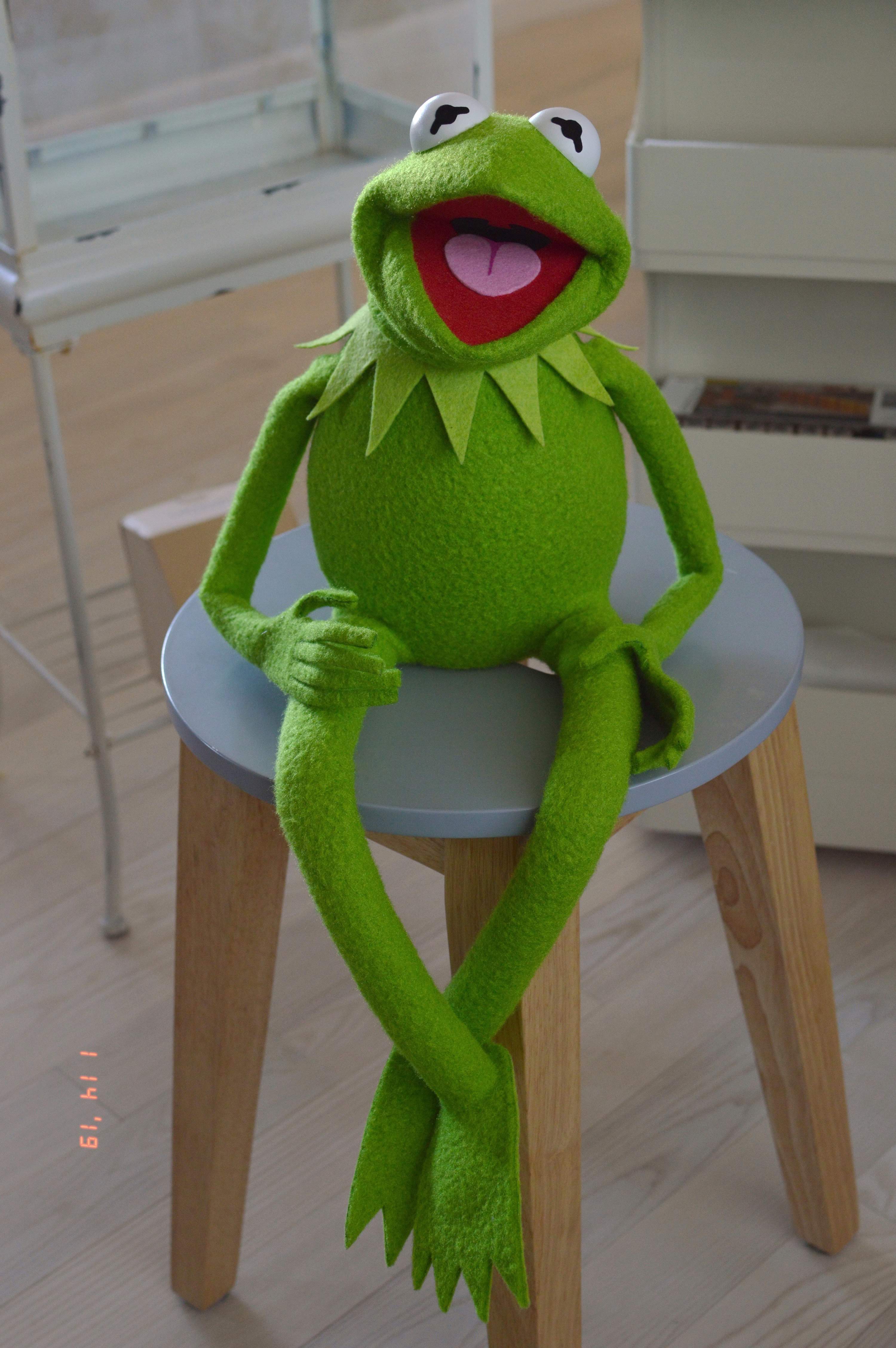

ecl's Kermit the Frog Puppet Replica (later builds, using my newest patterns)
Owh wow. Ecl these are amazing! You can see the love and dedication im making these! Love love love all of these!

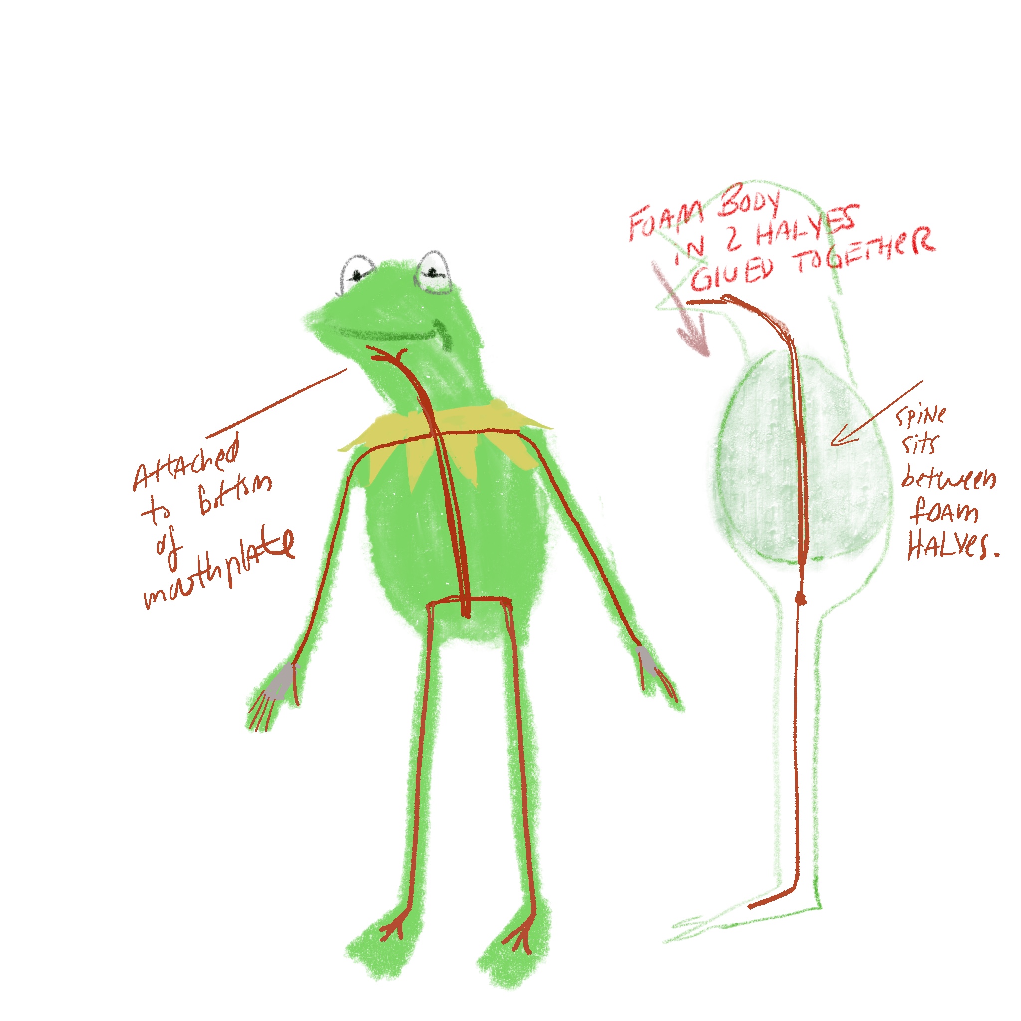

I'm wondering to make my second kermit. But I have few questions. For my first kermit. I only put wires in his arms. this time I want to make a body spine to connect his arms, legs, mouthplate. Did you take a photo of your poser kermit's spine? What it is look like? and I saw there is a hole under kermit's body of your photo, for a poser kermit, is it have a hole under his body too?

The way I made my ‘photo puppet’ version was actually super simple. I drew a quick and messy sketch below that kind of shows what I did. Basically, like a human body, the spine acts a support and the arms and legs on Kermit are just connected to the spine. I made the spine out of about three bendable wires which I used some duct tape to keep together (holds surprisingly well and flexible also). The wires are attached to the bottom of the mouthplate. Unfortunately I didn’t really take photos of the process when I made him; I only made one photo puppet version as I prefer to make the functional performance puppet versions.
You really only have to make the arms and legs bendable, as his body doesn’t bend, being so round and large. So the spine in this case only acts a place for the arms, legs, and mouthplate to connect to. The mouthplate also has additional wires on the back edge so that it can also be posed opened and closed.

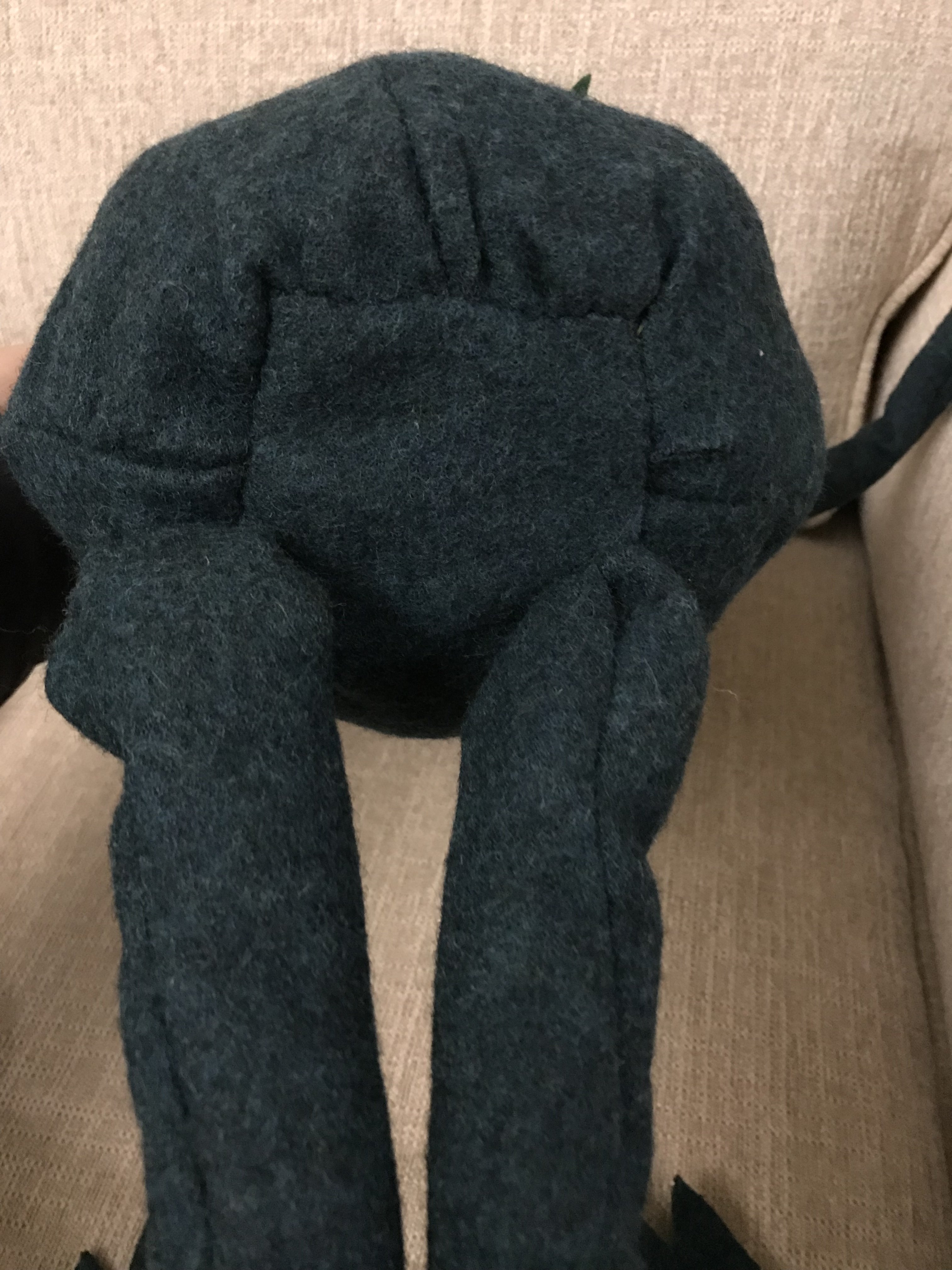

I found the seam of the bottom of my photo puppet's body is quite wired. What it is look like of your photo puppet?

As for the seam on the body, that’s difficult, but I just sort of wrap the fabric around the foam and trim. My seam basically looks like this:
