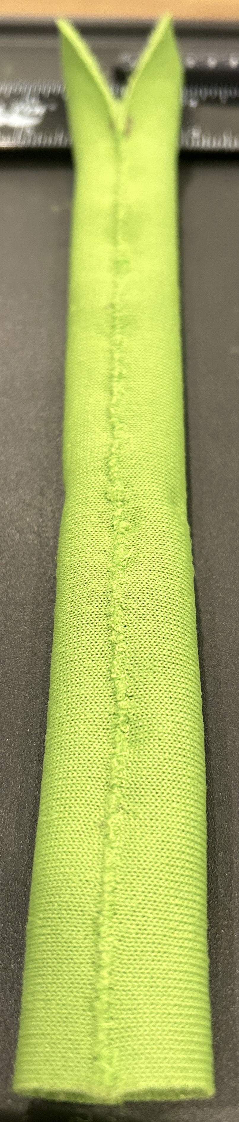

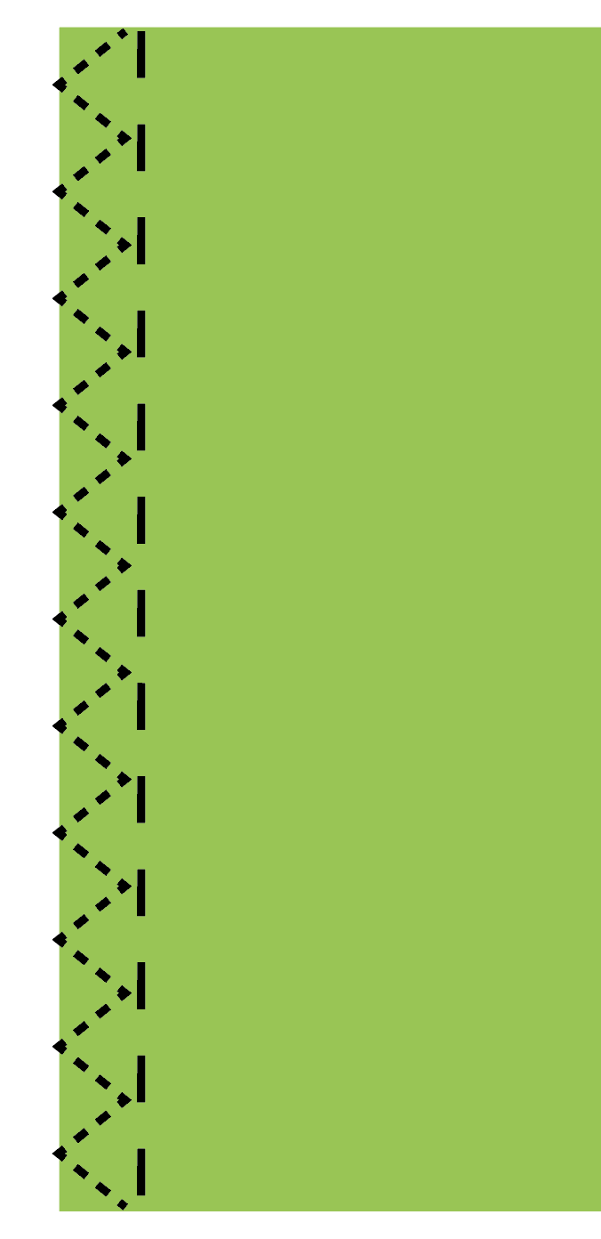

The other thing that I did while making this head is stitching tests. I tried a more exact whip stitch, a ladder stitch, and a stitch that I saw on a Swazzle video. Anti-pill fleece does not hide seams well at all, which is apparently why it isn't usually used in Muppet style puppet building. Because of this, I figured that if something worked well on the anti-pill it would work all the better on the better fleece. Hopefully. The Swazzle stitch won by a landslide. The seam was barely visible. I used it for half of the top of the head. The video for this is titled "Sewing puppet fleece with an invisible seam, Live Puppet Building Tutorial". It's basically a whip stitch but you only sew in and out of the middle and very bottom of the substrate of the fleece, kinda weaving the 2 pieces together. I also think doing it side by side means little to no bunching effect.
Now, I do want to mention that puppet fleece hides seams REALLY well, so sewing like the demonstration shows is not required. I'll do more tests of various stitches and how they affect basic fleece and various puppet fleece seams.
Since this stitch was supposed to be sewn with the 2 pieces of fabric side by side rather than on top of one another, I put little lines to make sure alignment was correct as I went along. I think this is something I will carry through future builds regardless of sewing method.
View attachment 1833281View attachment 1833282
Normal stitch
Swazzle style stitch (top half of seam)

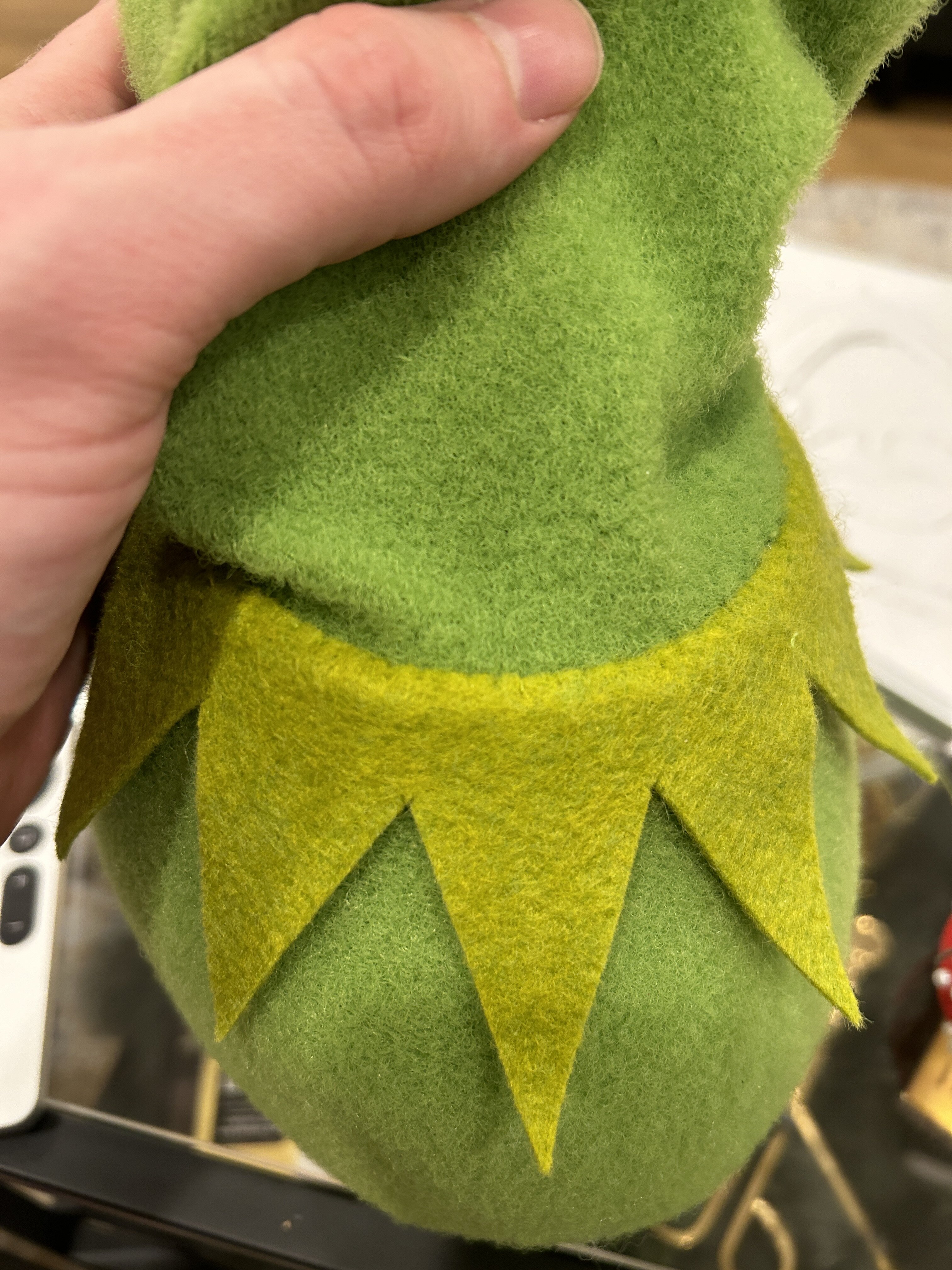

I also decided to knock out the collar. I have spent WAY too much money buying tons of felts in various shades of yellow-green and none have matched the color I'm looking for. I went with one for now but have resigned myself to the fact that I'll probably have to custom dye in order to get the color I want. I am waiting on one more that is being shipped from the UK but if anybody has found a felt that is ready to go as-is, please drop a link! I'm trying to go for a nice heavy 100% wool felt so that is limiting choices a fair bit.
To make the collar pattern, I used cues from ECL to use a semi-circle based pattern. First step was measuring the circumference of the neck and this was a bit of a challenge. I stuffed the neck to make sure it was at its maximum diameter but just raising or lowering the measuring tape by a mere millimeter or two yielded vastly different results. I went through a few paper test collars until I got it right.
Once I had the circumference, I doubled it and used the new 2x size as my basis for the interior cut that attaches to his neck. Remember, I'm doing a semi circle pattern, so the circles have to be twice the diameters of my actual measurements. I then had to figure out the proportions of the triangles. I took some measurements of a scaled photo and played around with things until I got it to line up. I can't remember if these screenshots are from the final pattern or not, as I made many tiny adjustments. The funny thing was that after all that work, it ended up lining up with ECL's almost perfectly. But I'm annoyingly stubborn and wanted to do it myself from scratch, haha.

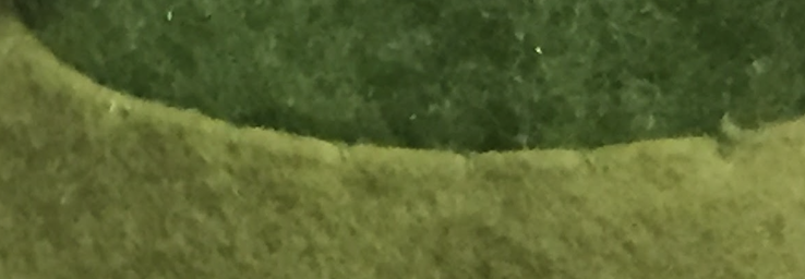

One thing that I noticed when looking at some high-res photos of the real Kermit, is that the collar isn't ladder stitched on. At first, I thought that it was maybe a modified blanket stitch but realized that wouldn't be feasible. I then realized that it was most likely a simple whip stitch, like most of what the muppets are built using. I can't remember if I posted this tid-bit before but I listen to Matt Vogel's amazing podcast "Below the Frame" where he spends 90-120 minutes talking with his fellow puppeteers, puppet wranglers, builders, miscellaneous Sesame Street/Muppet personnel. One episode was with Rollie Krewson, who has been a muppet builder since The Muppet Show and she said definitively that what we call the "Henson Stitch" was always taught internally as a basic, very fine, whip stitch. She said that people can use the ladder stitch or baseball stitch as needed but that going back to her training from Don Sahlin, it was a whip stitch whenever possible. Anyway, back to the matter at hand. Here are some images from 2 different Kermits showing that the collar attachment it is more of a spaced out whip stitch.
The color felt that I ended up using is pretty cheap wool acrylic blend and not tightly woven. Because of this, I wasn't able to really sew as close to the edge as I wanted, otherwise the thread would just rip the felt. I wasn't thrilled with this because the stitches are too visible. That's part of the reason that I'm still on the hunt for a good quality collar felt. I also realized that I should have spaced my stitches out a but more but it was a bit late to turn back since I didn't think the felt would hold up to removing the stitches and starting over- so I just continued on trying to keep the spacing that I started with.

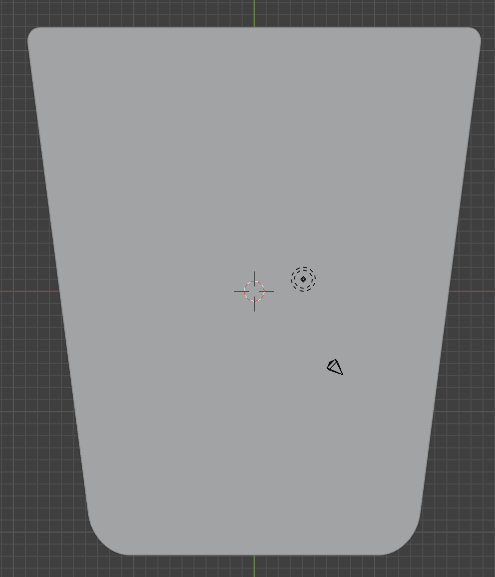

Basically, Kermit's fingers are fleece wrapped around a bendable wire. That wire is attached to a trapezoid plastic plate in his palm, which is also what the arm rod attaches to. I first made a template of the hand shape in Illustrator after taking some measurements from various photos.
I then took the trapezoid shape, imported it into Blender and made a 3d object. I also beveled the corners while I was at it.
Still being a total amateur in 3d modeling, boolean modifiers are my go to for adjusting a shape. I basically created other shapes and subtracted them from the trapezoid. I'll spare you the various iterations and just go straight to the one I based on the Rick Lyon arm rod. I created a square hole that will receive the arm rod, 5 holes for the finger wires, and I also tapered it a bit so that it got thinner the closer it got to the fingers.

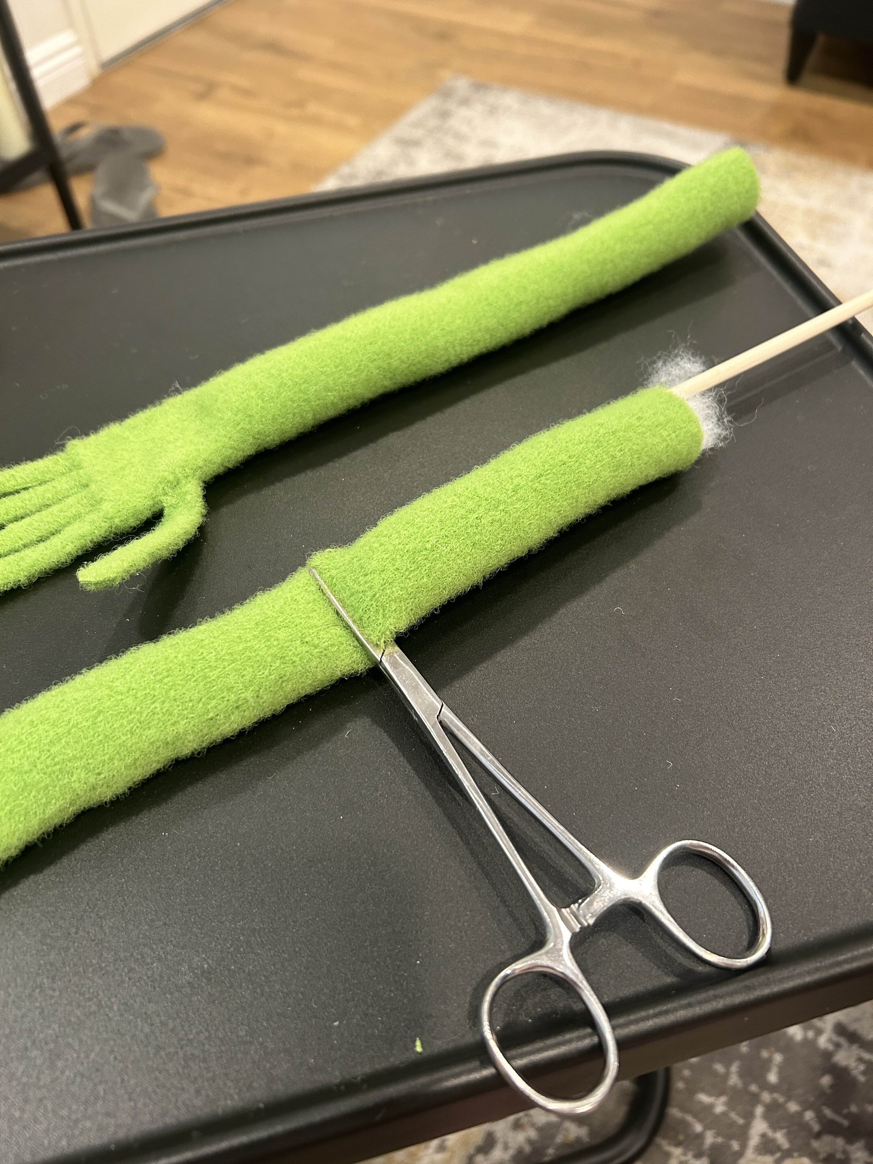

Then, I stuffed the arms with poly-fil, making sure to clamp the arm halfway through to prevent poly-fil from bulking out the elbow. FYI, I think I'll be using 1/4 inch foam for the arms in my next attempt.

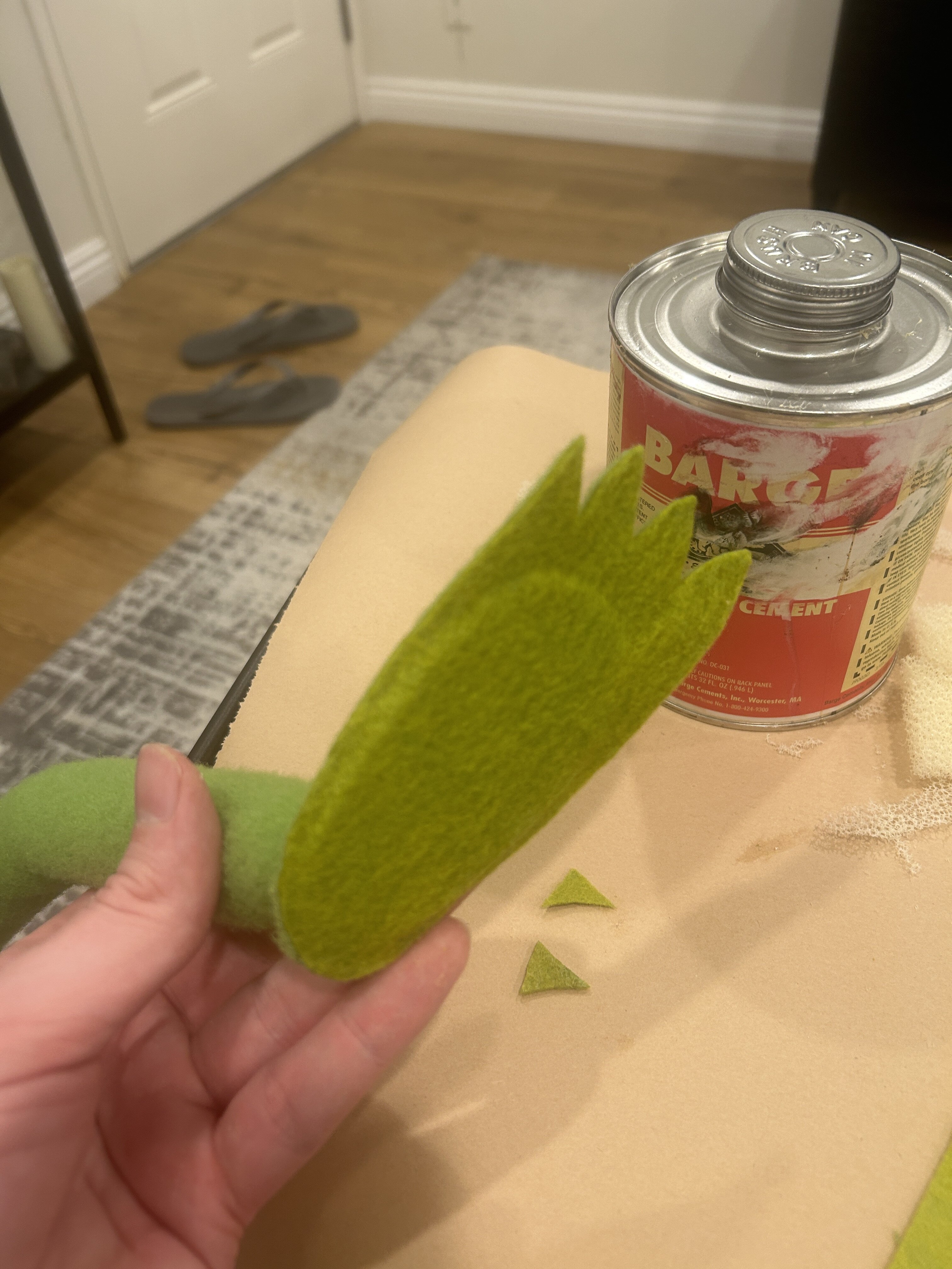

Next step was to attach the fleece part of the foot to the leg. I did it at this step as it's easier for me to stitch 2 pieces of fabric without anything impeding my ability to sew. I'm going back and forth if I want to use a hole in the foot of my next pattern to do a whip stitch rather than a ladder stitch (like it is in the MR pattern). I don't know though...
Time to finish up the foot. The foot, top to bottom, has layers of fleece, a stuffing, a plastic egg shaped plate (which I 3d printed), and then the bottom layer of felt. I used contact cement between each layer. The felt should be the same that is used on the collar. I tried stuffing it with fiber fill but that was a hot mess. I had fibers going everywhere, couldn't keep them contained, they were gluing and getting stuck to areas I didn't want them- it was horrible. I tried removing the fiber as best I could and switched to some of the 1/2" foam that I used for the body. I cut out a piece of that, glued it to the plastic plate and trimmed it to the proportions I was looking for. I then slapped some glue on the felt and attached everything together before cutting off the excess felt. My foot pattern should have been a bit wider to account for the volume of the fleece/polyfil. It was a bit of a struggle getting them to attach to the felt. I should have taken this into account when tracing reference images, but lesson learned!

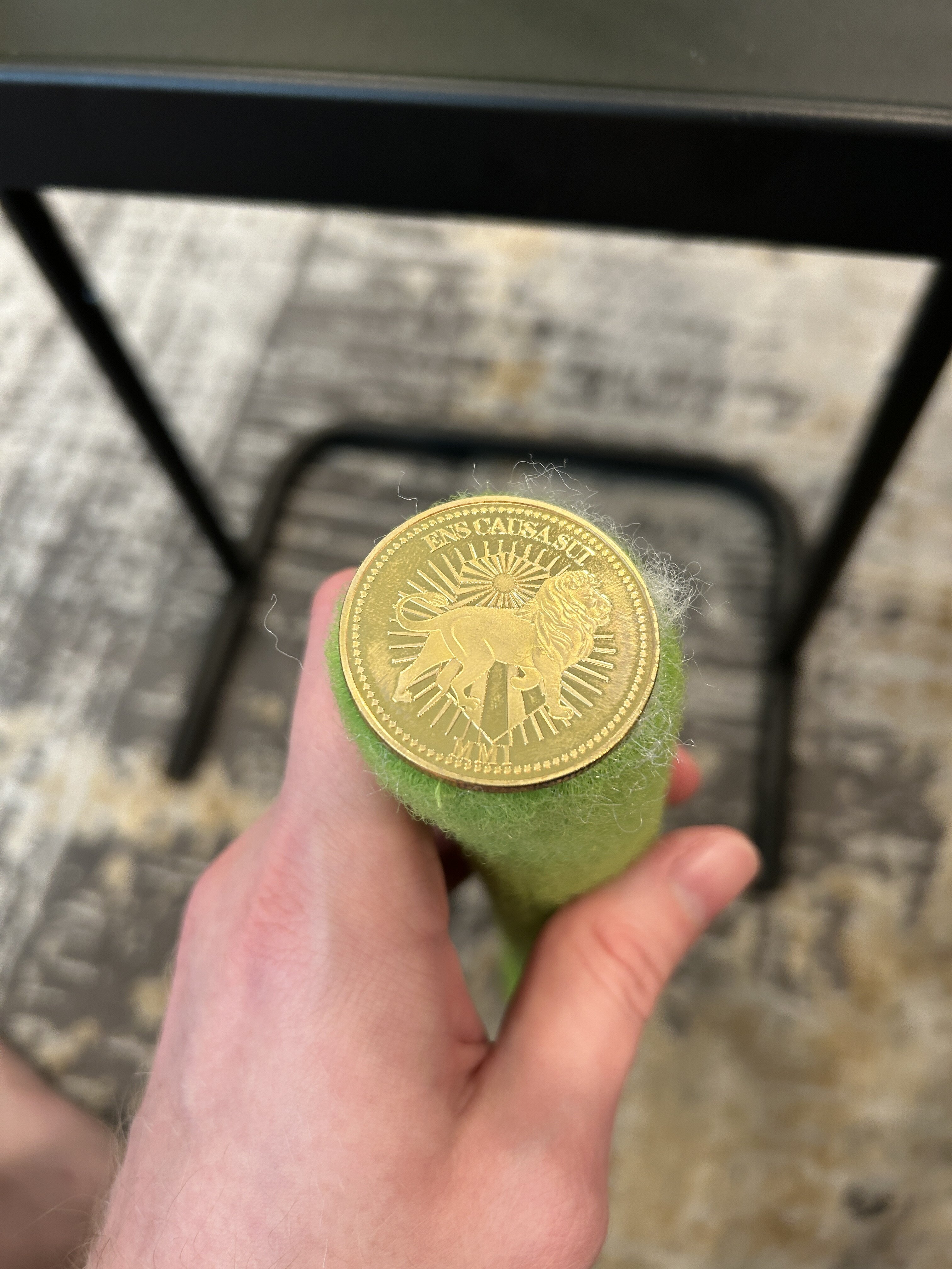

To attach them to the body, I laid out where the should actually go and traced John Wick coin (gotta use what you have!) onto the body to help keep track when stitching. I used a ladder stitch for this.
Not much else to do. Tomorrow I'll add on the arm sleeve and finish him up by finally giving him eyes.

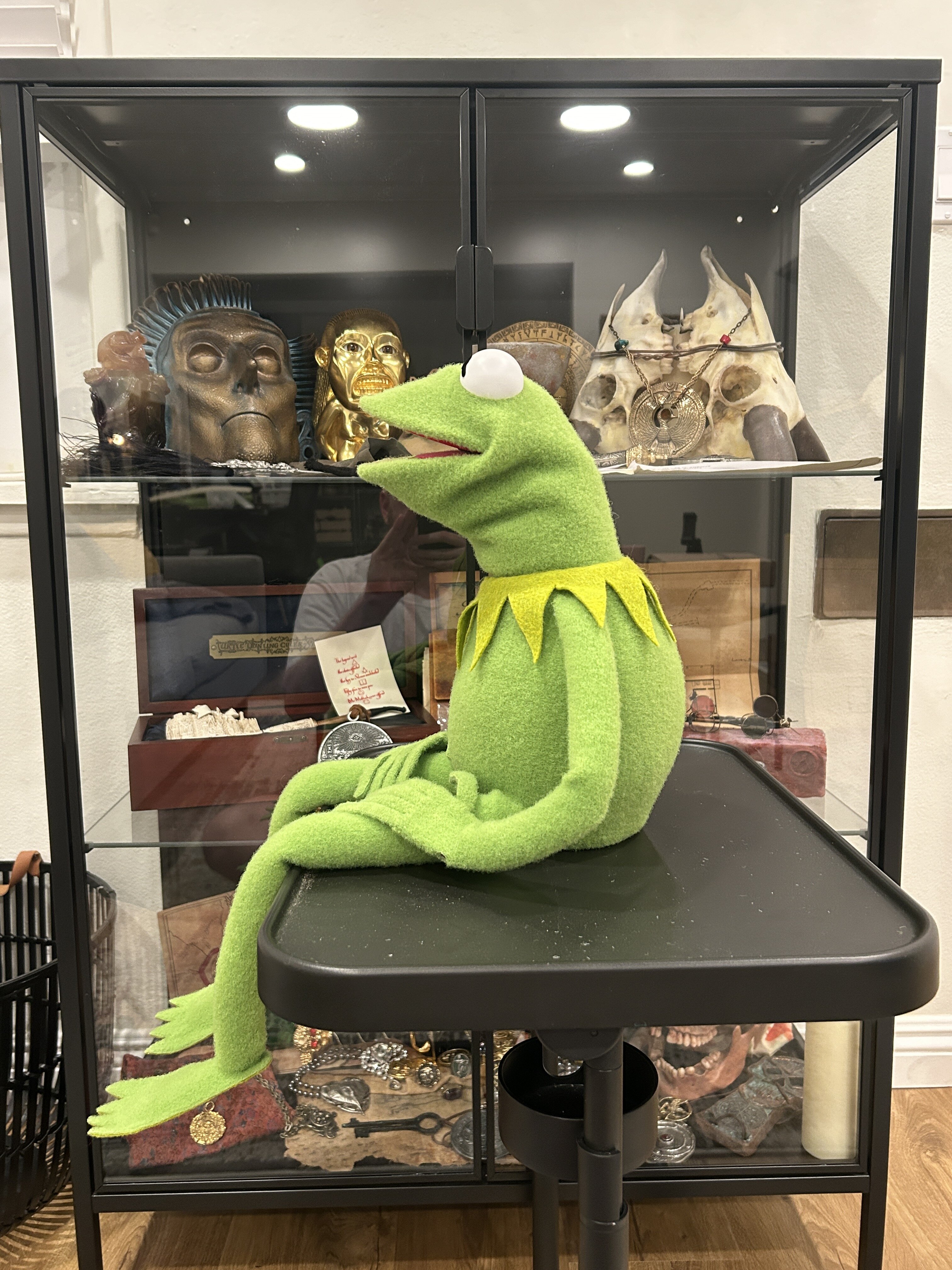

And we're at the finish line. All that was left on Kermit was to add the eyes, sew the inner liner to the bottom, and make and add the arm sleeve.
I did all of this at once, and the order was eyes, liner attachment, arm sleeve attachment. I'm going to save instructions/pics of the eye step for last on this post so that we can have a big reveal, because that's when a lump of green fleece became Kermit.

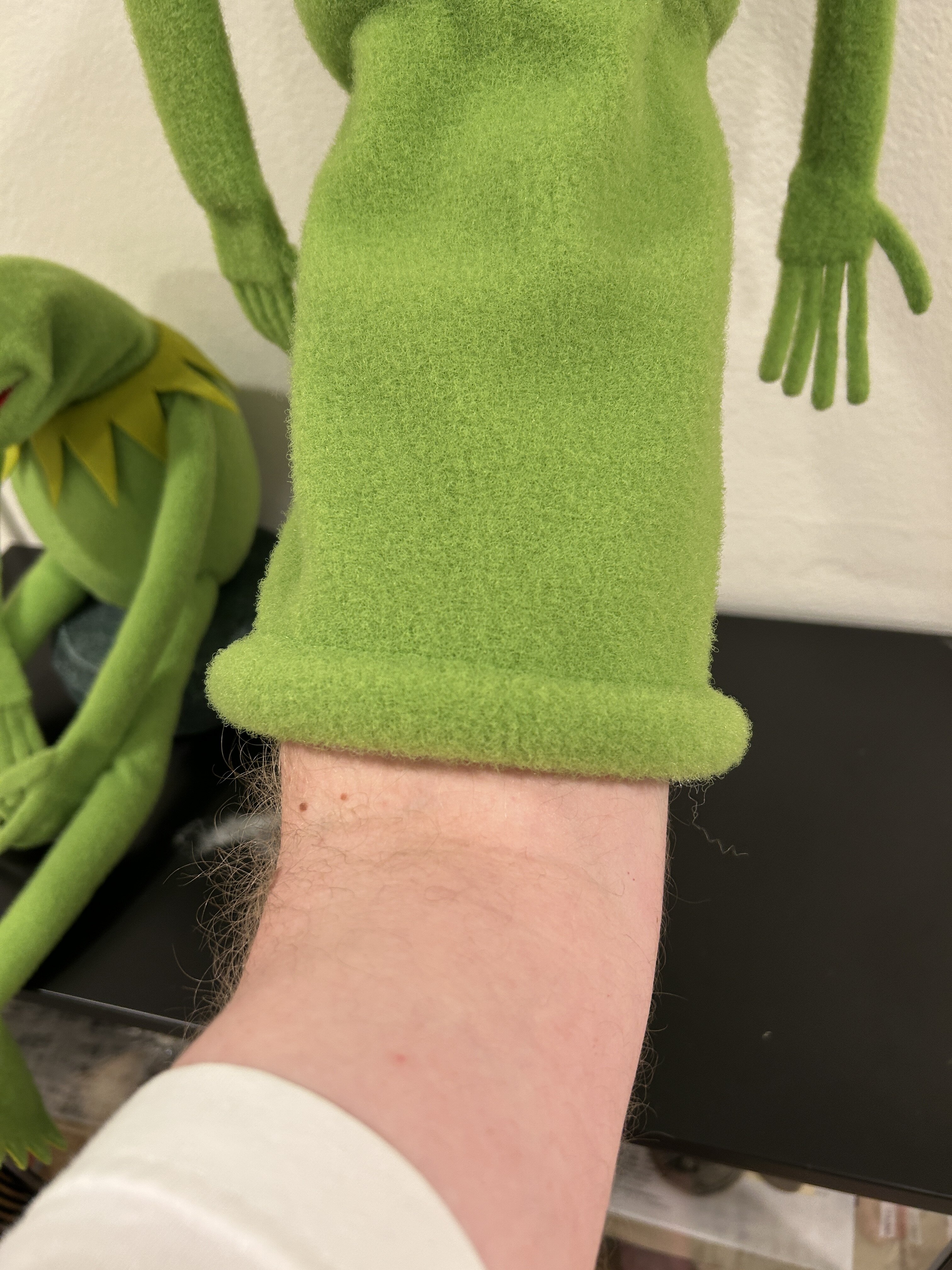

Now I made the arm sleeve that helps hide the puppeteers arm if it accidentally gets in the shot. This was super simple (once I figured out how to sew through up to 4 layers of fleece on my sewing machine). First step was cutting out a rectangle of fleece that was 9x12 inches. I made a hem along one of the 12" sides. I didn't want to include boning in the hem this time around, but that is definitely an option. I just didn't have a good foot for getting super close to the boning. I really didn't want a 3/4-1 inch hem. Once I had the hem sewn in, I put the two 9" sides facing each other and sewed about 3/8" seam. going over the part that had the hem already sewn was a challenge but I was eventually able to make it work by turning the sewing foot pressure down to 0 right at the hemline. I was already using a roller foot attachment so that helped it feed through the machine as well. No pics of the progress but here's one after it's sewn up, and after it was ladder stitched into place.

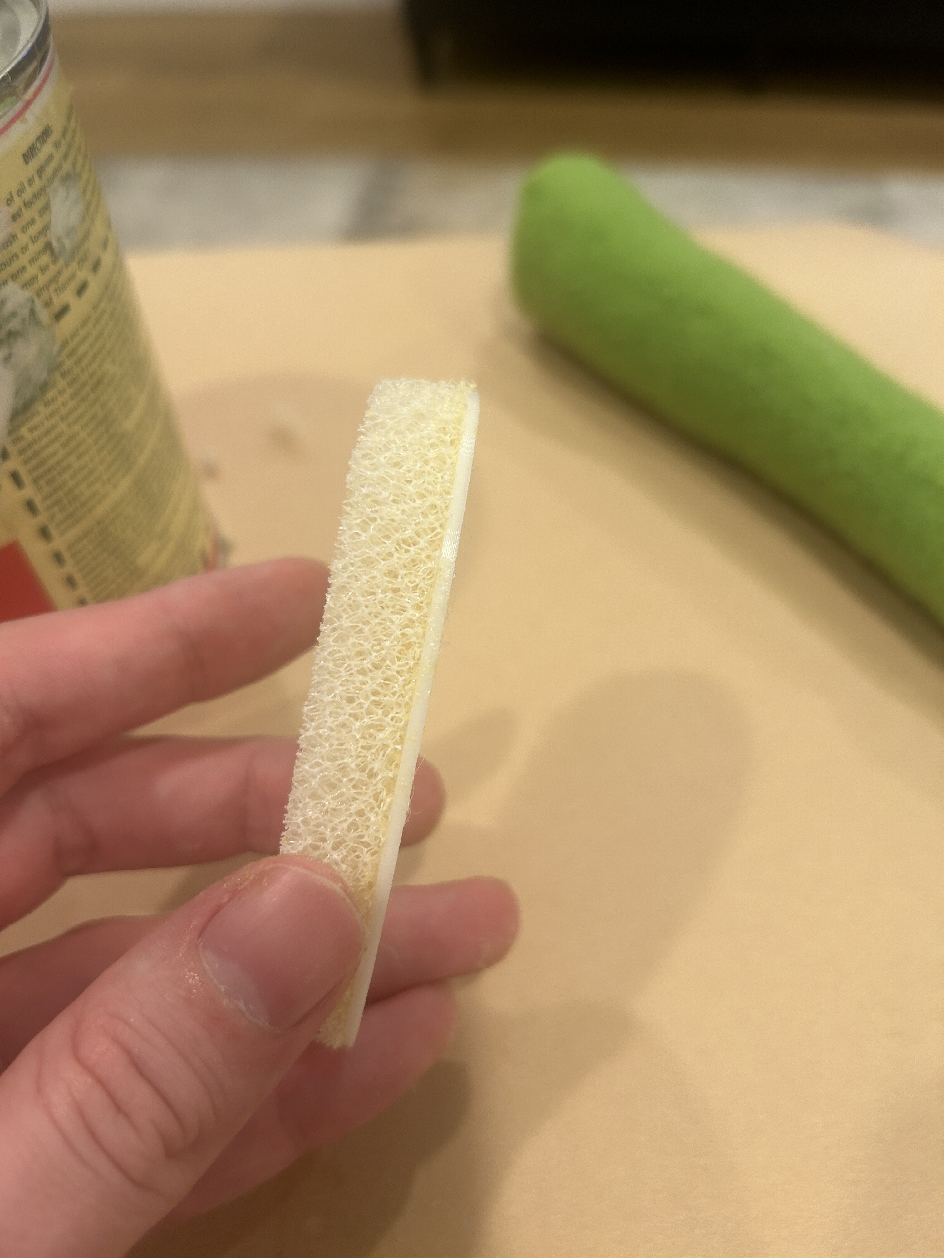

I also went with poly foam everywhere rather than reticulated. I actually like it more, and the fact that it's not nearly as expensive is a huge upside. I also went with a much better felt for the collar. It's "prickly pear" from feltbetter (feltmuchbetter on Etsy UK). They don't normally ship to the US but the owner was happy to when I messaged them off to the side. The color is a much better match and the quality is a million times better than the previous one. I also decided to use a 10oz chartreuse duck canvas from Big Duck Canvas as a liner, rather than the felt. I also glued the liner to the mouth plate as before but I also used my sewing machine to stitch it on and make it even more secure. I also changed up the type of boning that I used.

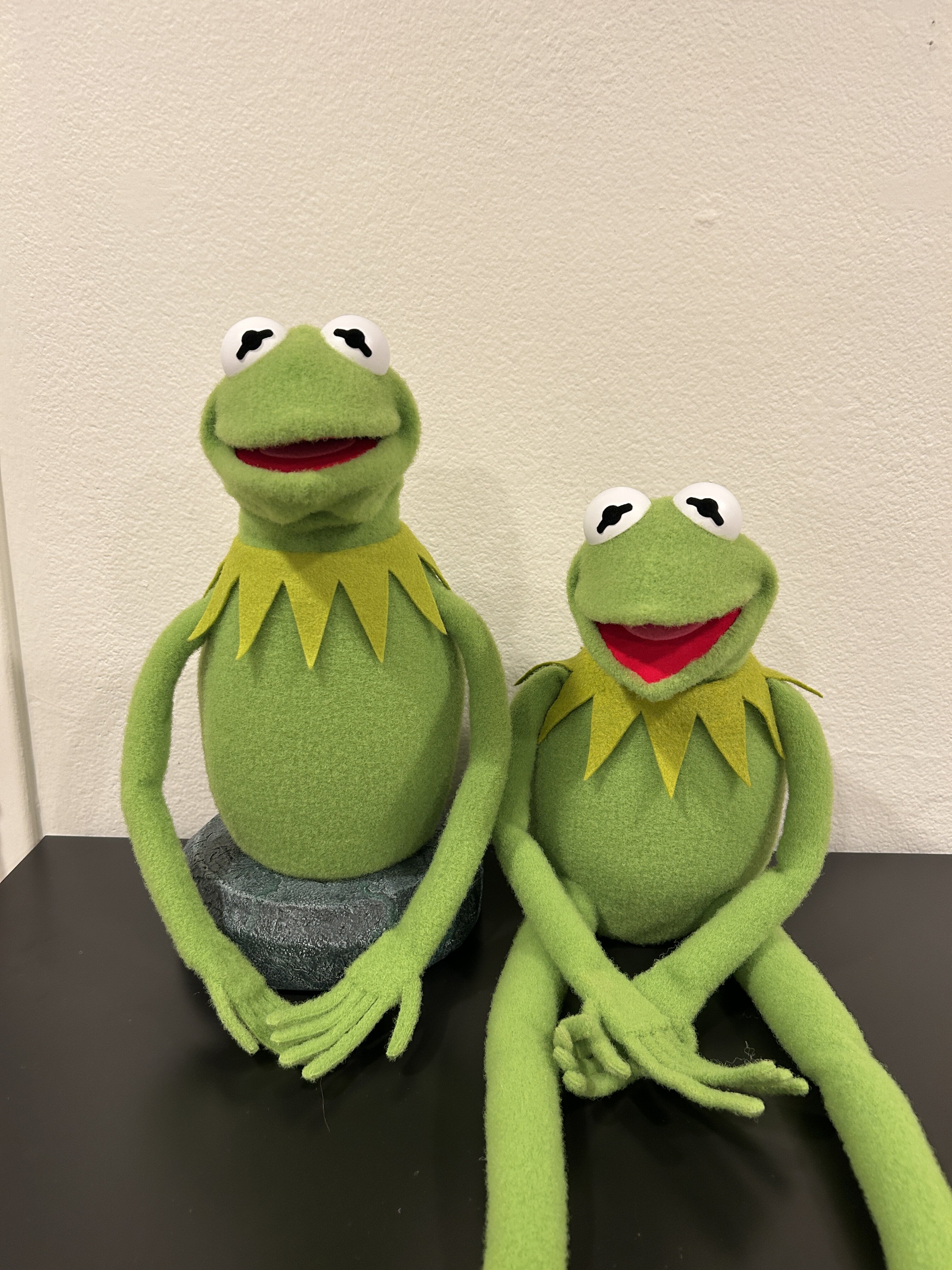

Finished up Kermit 2 tonight! It's nice to see him all put together. I am happy I tried out the new techniques and pattern modifications. There are definitely some things I'll carry over to the next build and some that I probably won't. The head is relatively the same size, but I scaled down the eyes to 38 mm with 7/8" pupils. I think they are a better fit than the earlier version. I think I'll keep the new mouth plate, new eye size. I'll probably combine the 2 body patterns to find a happy medium, same with the head, and the hands.
I definitely like the new way of making the entire body/head skin and slipping it over the foam. I might actually try to machine stitch the head/body/arm sleeve together because there's no real reason to hand stitch those pieces. In fact, I might try to machine stitch the whole thing just out of curiosity to see the difference after picking seams.
I also used a flexible tubing for the bottom of the arm sleeve and I really like that too. I made it removable so that the arm sleeve can tuck in the body when not in use.
I can post these patterns if there is interest but I think that my v1 patterns are still a little better overall so I'm probably going to hold off unless I get asked. Especially since I think v3 will be started/finished within the next month or two.

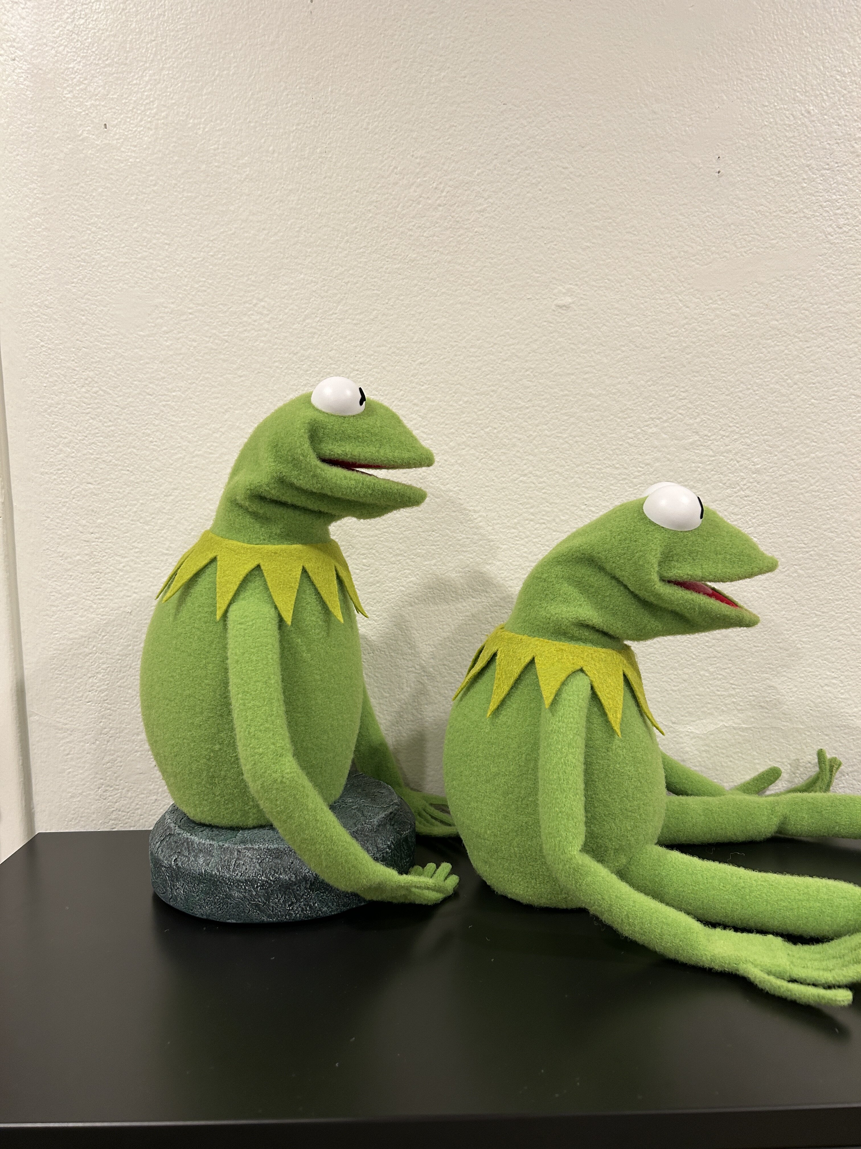

Arm sleeve:
V1 has legs, v2 does not:
Arm sleeve:
View attachment 1868155View attachment 1868156View attachment 1868157View attachment 1868158
View attachment 1868152View attachment 1868151View attachment 1868153View attachment 1868154
