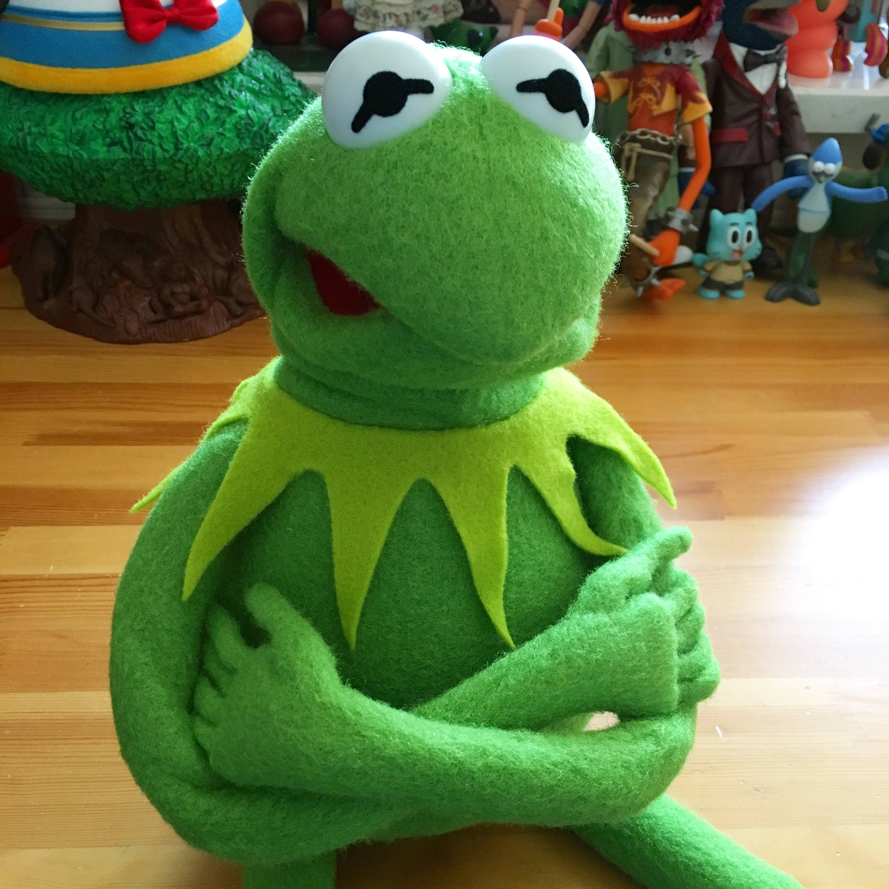

Here's the "photo puppet" version I made. I actually removed the wires in the arms and legs, so he's now more of a hybrid of a traditional posable photo puppet and the puppet kermit. I didn't want to worry about the wires eventually breaking from repeated use, so I just left the wires in the neck and mouth in place.

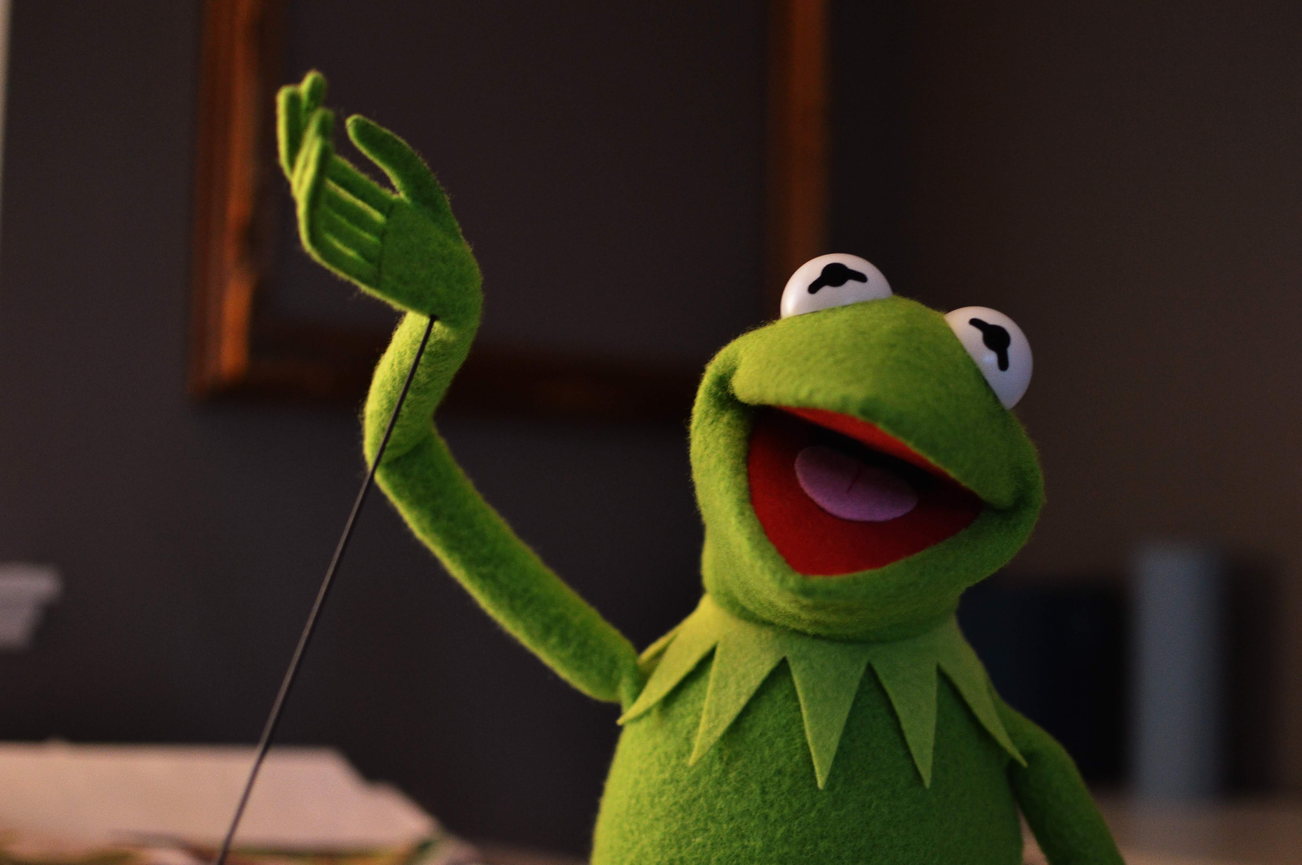

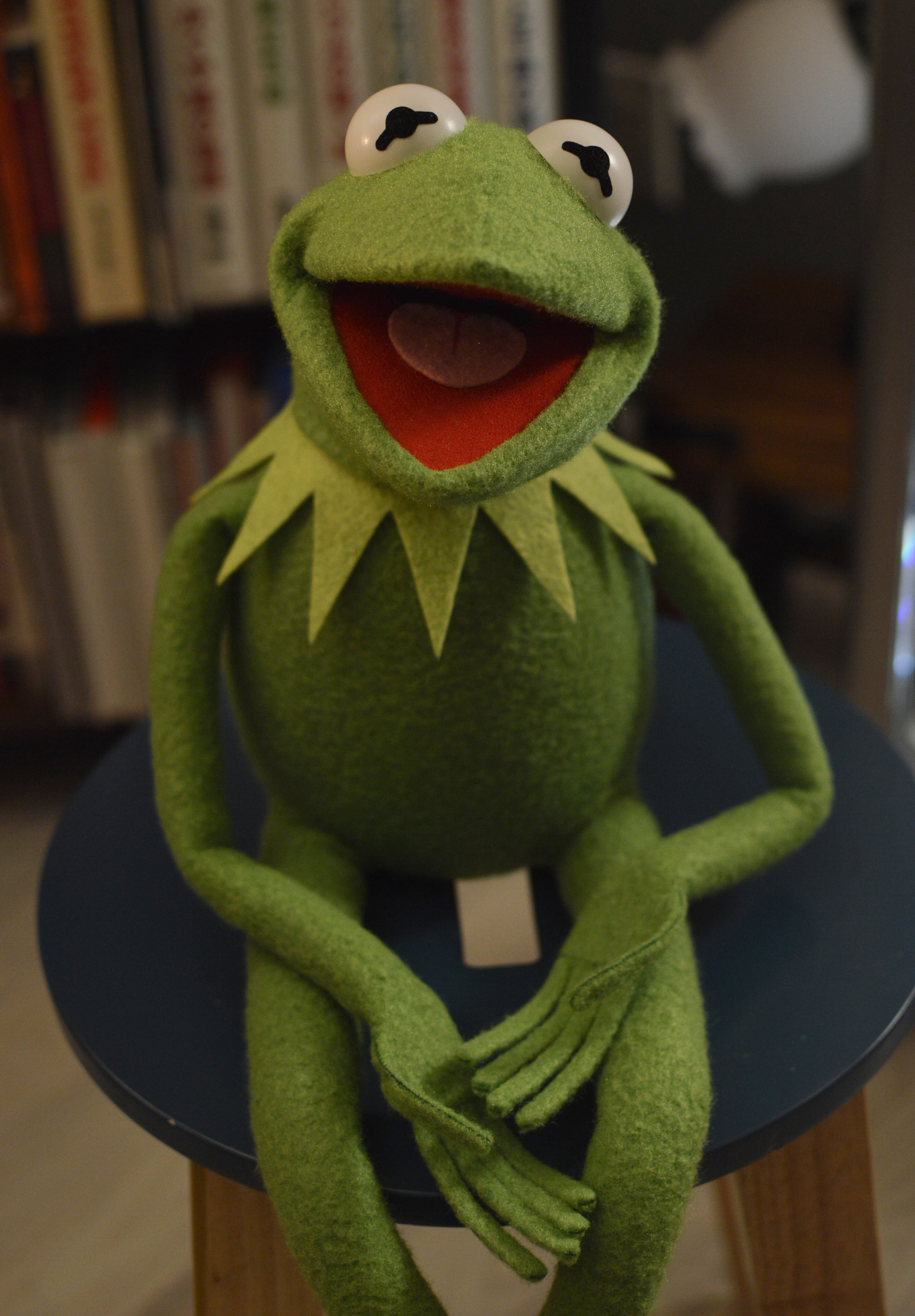

I just finished up my 4th Kermit Puppet build. It never seems to end, as I'm always seeing things that need to be improved. This time, it was the shape and material of the mouth-plate that motivated me to make this one, along with a scale modification after I spent some time studying an original Kermit up close in an exhibition here early this year. Kermit looked surprisingly small in person--not much bigger than the MR replicas Kermit. I redid most of my patterns, especially the head, as this time I used rubber as the mouth-plate material, giving him a wider range of emotions. Overall, this Kermit is also slightly smaller than my earlier builds--even closer to the original I observed. Even then, he is still just over two feet in height. Materials used, except for the rubber mouth-plate, are the same as previous builds: antron fleece from "Puppet Pelts" (a great shop), black adhesive velvet, ultrasuede (red), jewelry wire (fingers), felt, 35mm domes (Puppet Pelts).
I'll start with the pics of the final result:

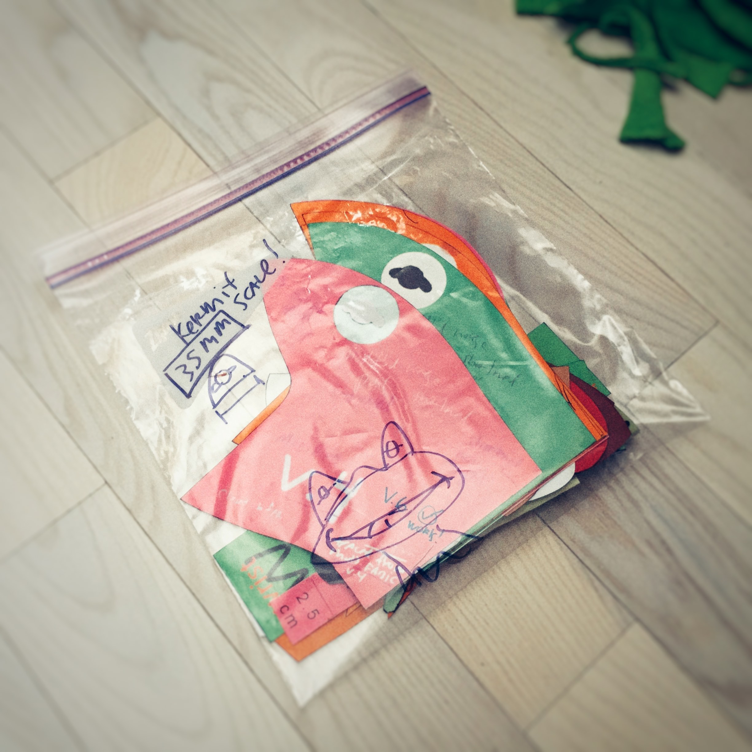

Pattern Bag: It took me 6 different designs to arrive at the head that you see on this build. Most of the changes were small, but made big differences!

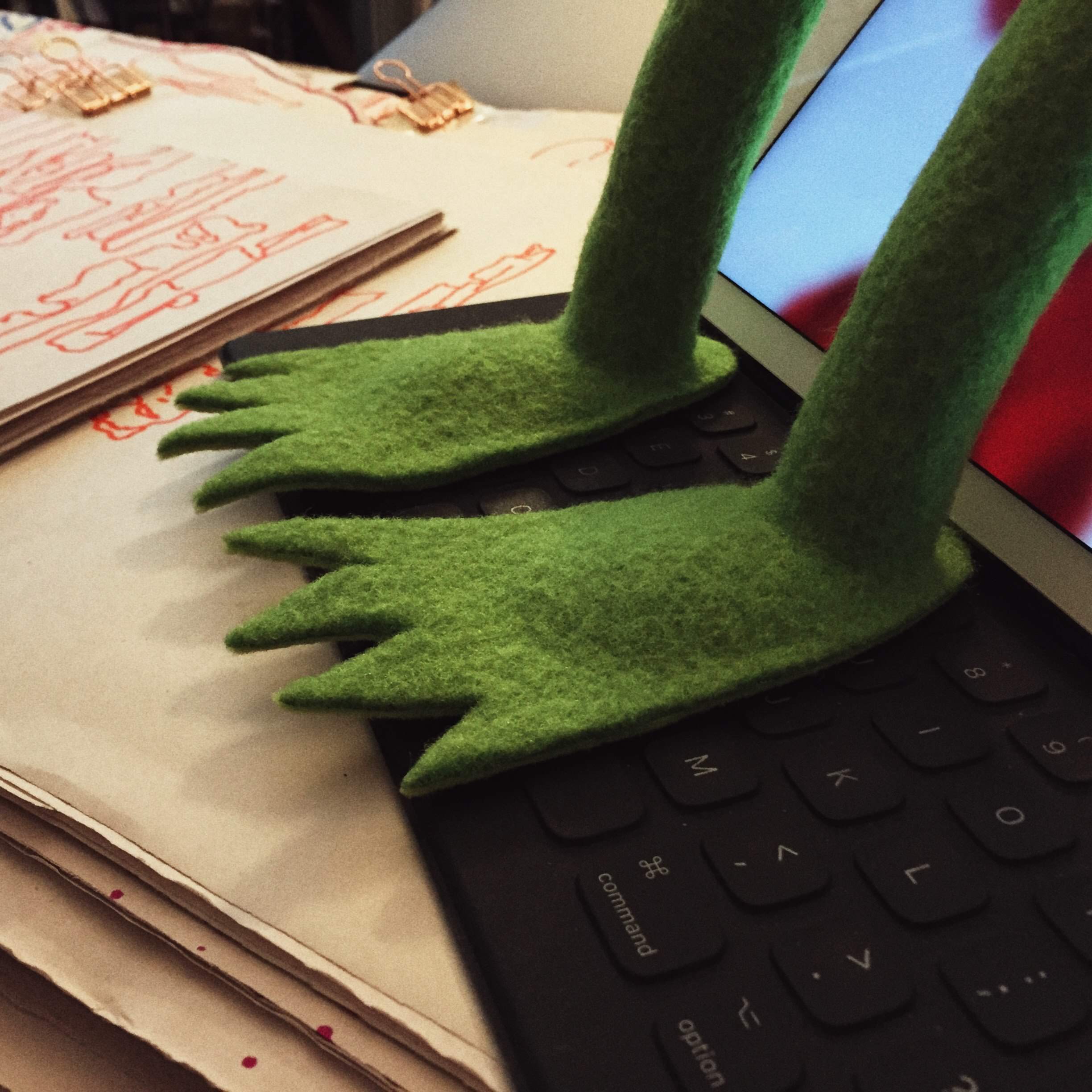

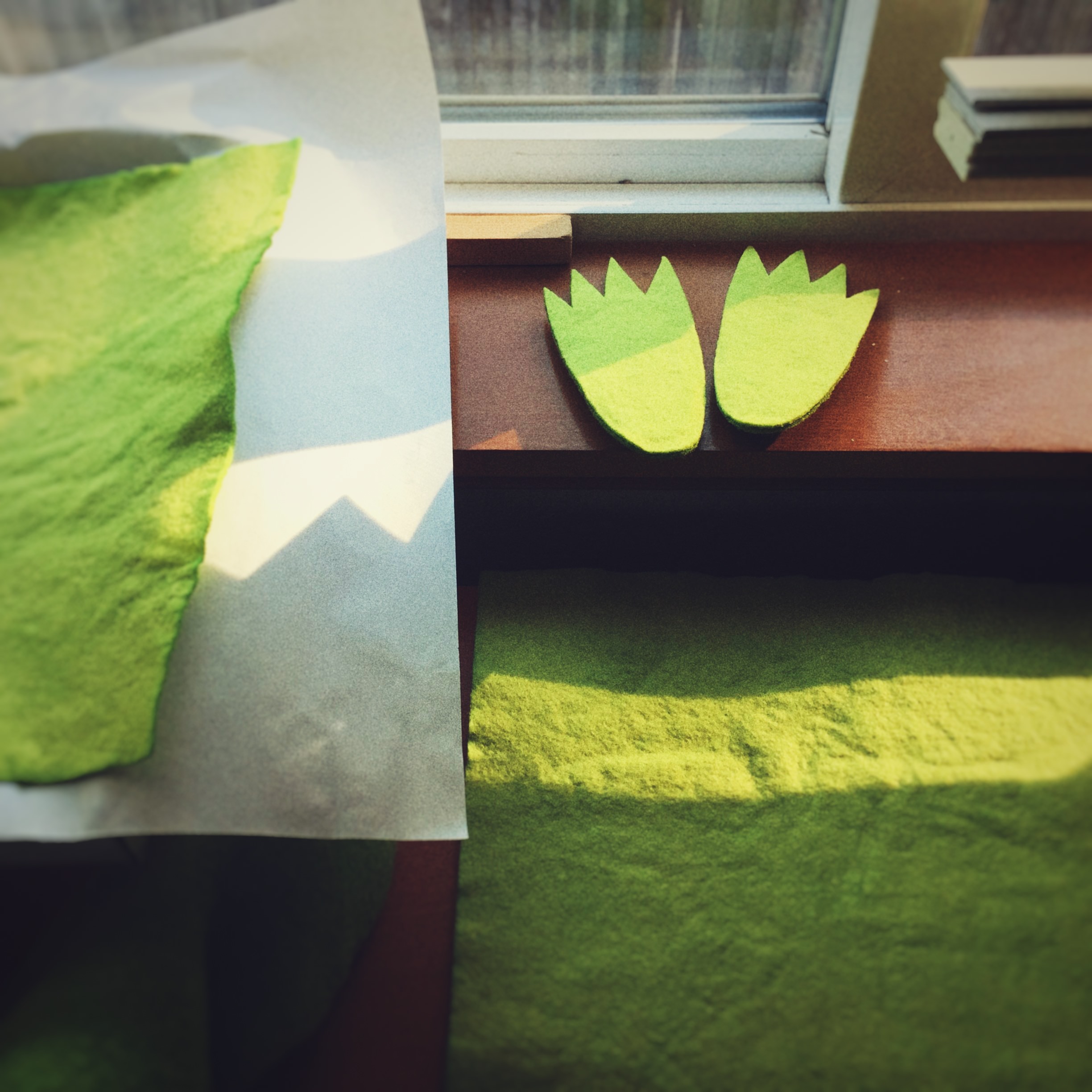

The feet are based more on the iconic Kermit feet than the earlier flat looking style that I used on my previous build.

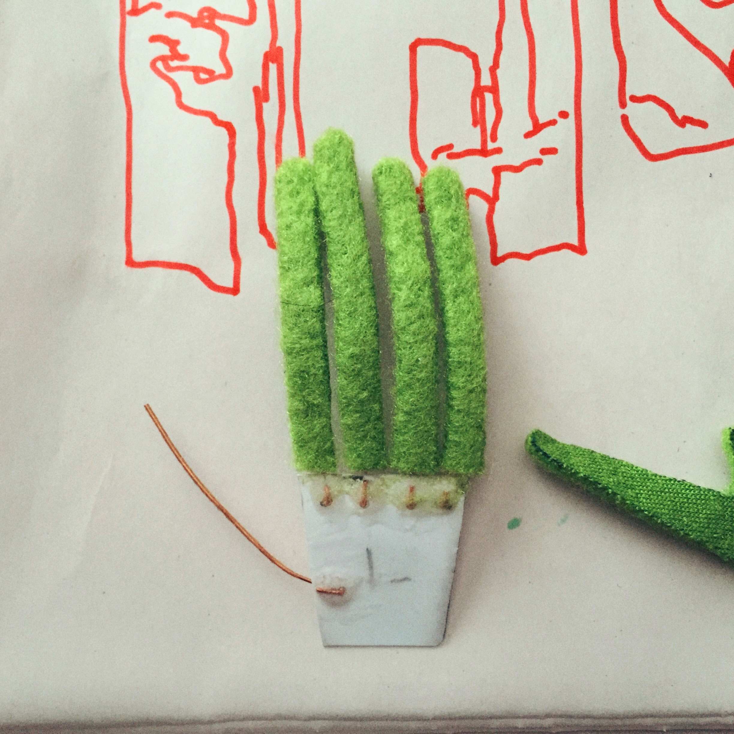

Arm/hands patterns were upgraded by combining the palm with the arm (like the MR pattern). A bit more streamlined than my earlier pattern.
Styrene "palm" insert. The finger wires were hooked and then epoxied into the plate for more security.

Giving the felt a slightly yellow tint. I wanted the felt to have a slightly more lime appearance with a hint of yellow, to make it look more like some of the earlier Kermits. The exhibition one I saw had a collar similar to this color:

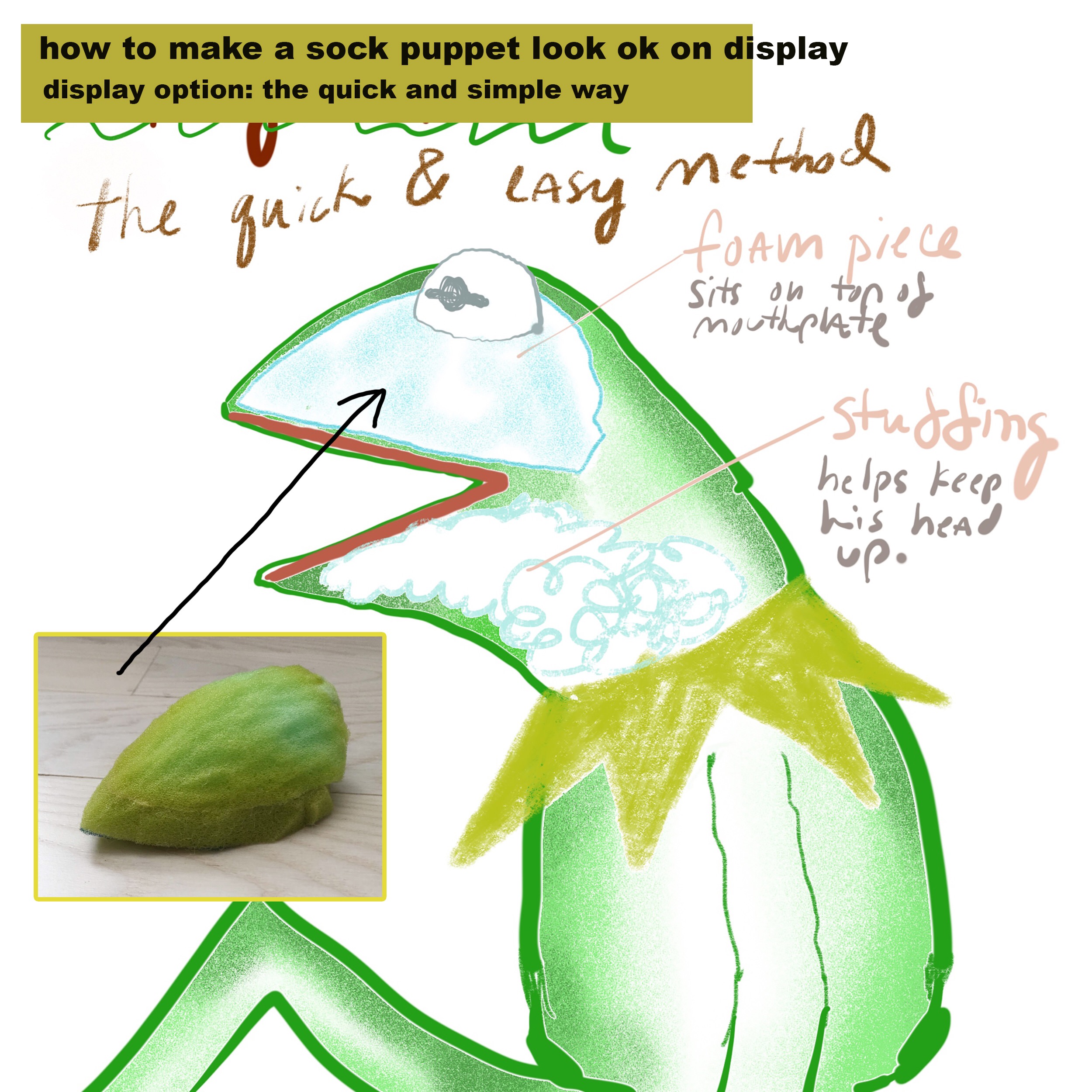

Hello! I no longer use styrene for my mouth-plates on my new builds. I recommend something like a gasket rubber; that’s basically a thin rubber sheet. It’s much more flexible. I’m not sure where you’d find it where you are, but I get mine in small pieces at the hardware store near the plumbing section.
As for your questions:
1) I do put stuffing in the neck area of my builds, and a shaped piece of foam for the top of his head, but this is only to give his head shape while on display. When you use it as a puppet, there should be no stuffing in the head (kermit’s Head shape is basically the person’s hand). It really depends on if you want to build a puppet Kermit, or a “poser” puppet, like in the photos you showed above. That one basically does have wires, foam, and stuffing inside to give him shape and a posable mouth.
For display, I do this with my puppet builds:
2) If you want his mouth to be posable (non-puppet version) then yes, I add wires to the back side of the mouthplate to allow it to open and close. I’ve made one version with the wires in his body for my ‘poser’ kermit, and I also add a thicker wire from the bottom of the mouthplate that does through his body—basically like a spine, where the arms and leg wires also connect!
But my puppet versions just have the removable stuffing and foam you see above. I dont put wires in those, so his mouth just kind of stays kind of open naturally when sitting there :)

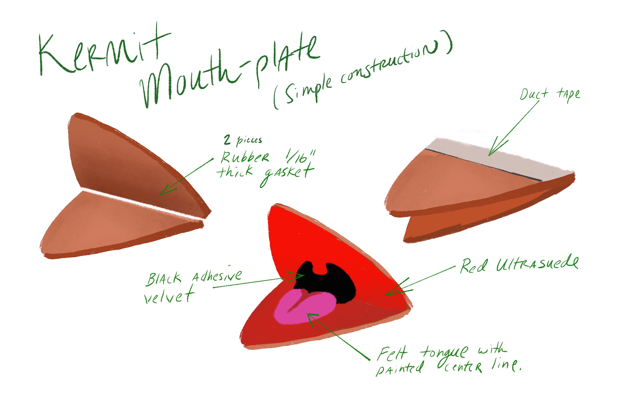

Here is a simple way to construct a mouthplate. There are other ways you could do it; but the more layers you add to it, the more stiff it becomes. If you want more expressions and flexibility, try to keep the plate simple. As mentioned, there are two separate pieces of the rubber—top and bottom.
