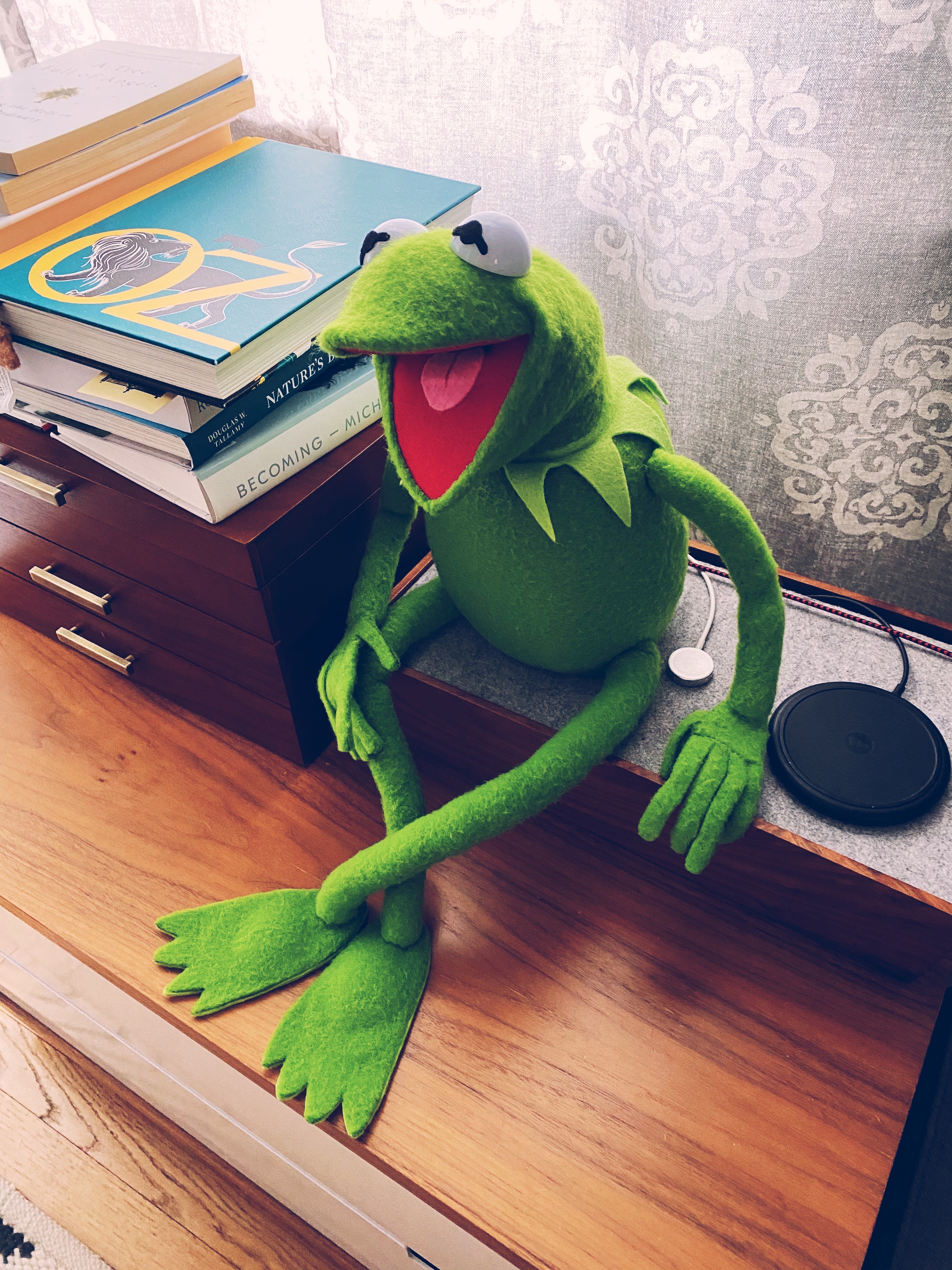

This doesn’t happen everyday around here, so I took some pics:
Their necks are stuffed to keep the heads up, so it looks thicker around there than it really is; I still need to figure out some kind of stand/structure that will work better for display.

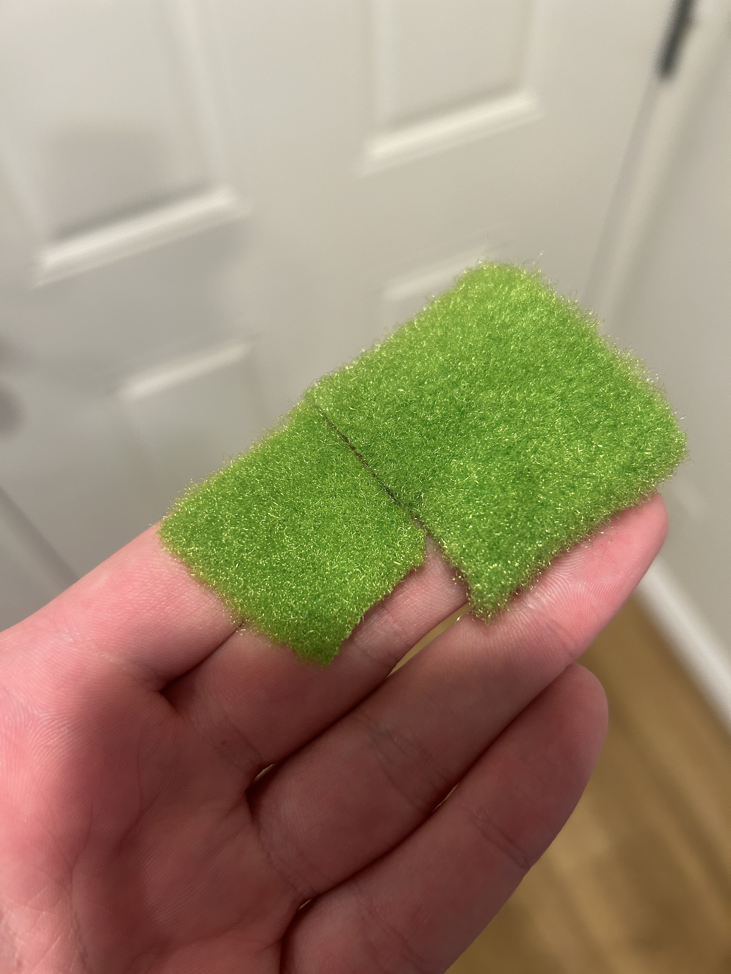

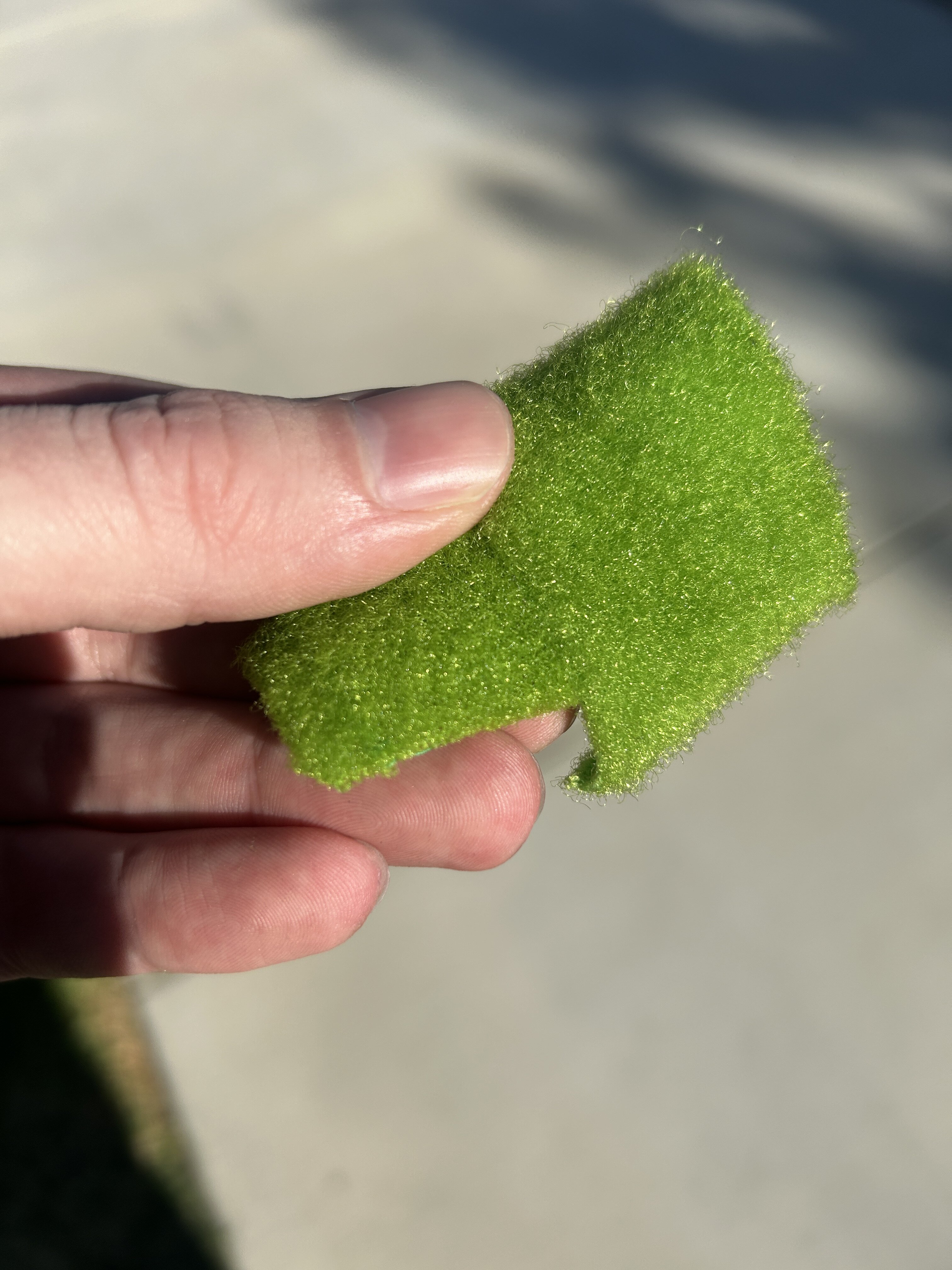

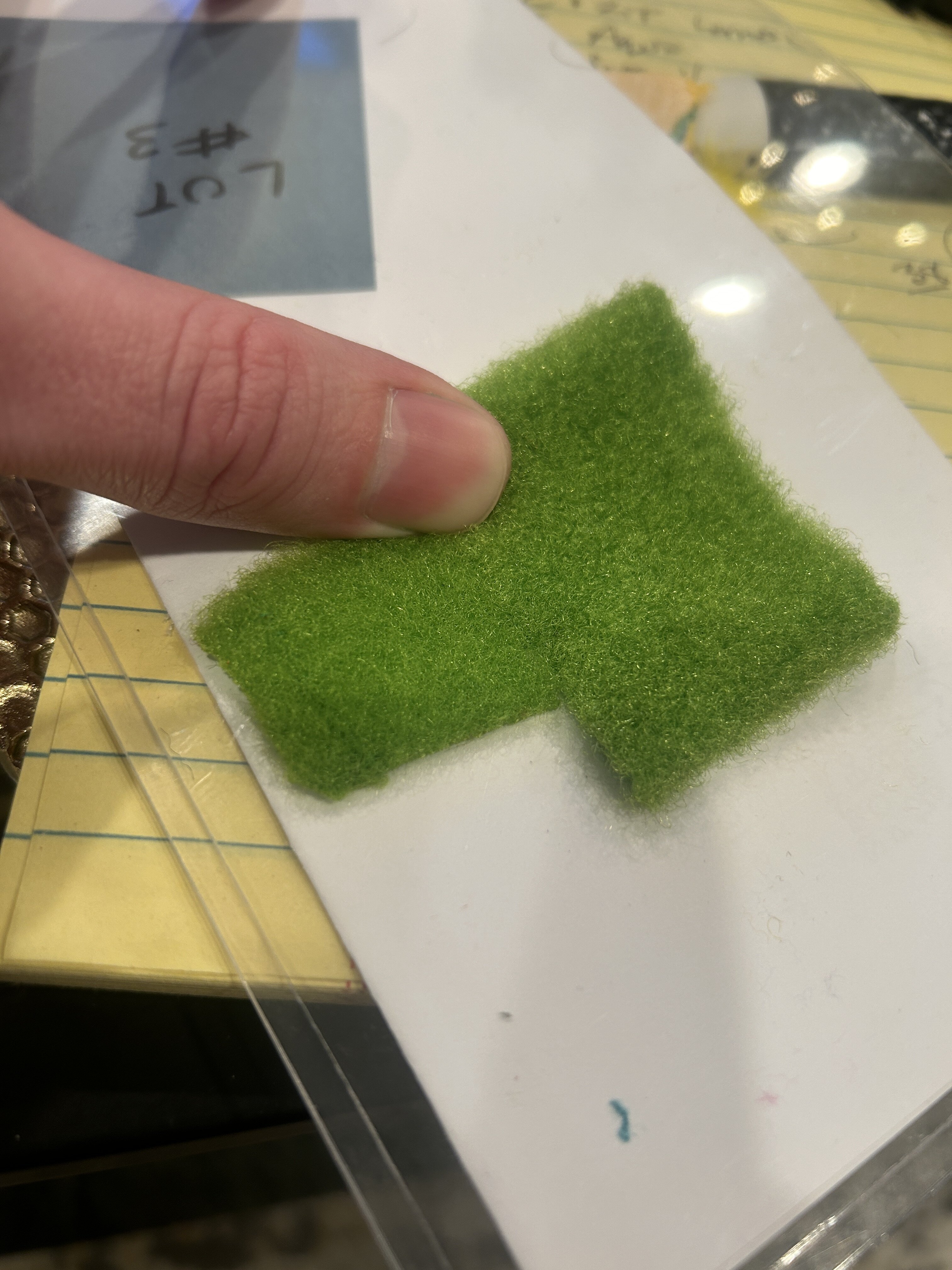

KOMakesThings danieljferguson Just to jump in regarding the F3 fleece, I love it!! It's my favorite of the 3 and very similar to the Malden Mills fleece used on Kermit from the late 70s until the supply ran out (though Kermit's current makers, Puppet Heap might have stock that they are still able to use). It's slightly shinier than the Malden Mills fleece, but much better than the very matte/dull Fuzzelle. It also has a tighter knit on the back of it than the Fuzzelle, making it much easier to sew with as you can get much closer to the edge than you can with Fuzzelle. It can be purchased by the yard from Dharma Trading, but it does only come in white and needs to be dyed yourself. That being said, the owner recently suggested that he's looking for additional distribution partners and hopes to eventually offer some additional colors. I was using Fuzzelle originally but after using F3, I'm never going back. And it's MUCH more affordable!!
Here's a post in my thread comparing a piece of an actual 80s/90s Kermit, with the Fisher Price Kermit hand puppet from the late 70s that used the same Malden Mills fleece, and factory dyed Fuzzelle: MM vs FP vs Fuz.
I just found out that I never posted about this in my build thread (I could have swore I did), but I also tried dying F3 and comparing it to the piece of Kermit that I have and here is what they look like in 3 lighting conditions. The F3 is the larger piece.
I hope this helps!!
