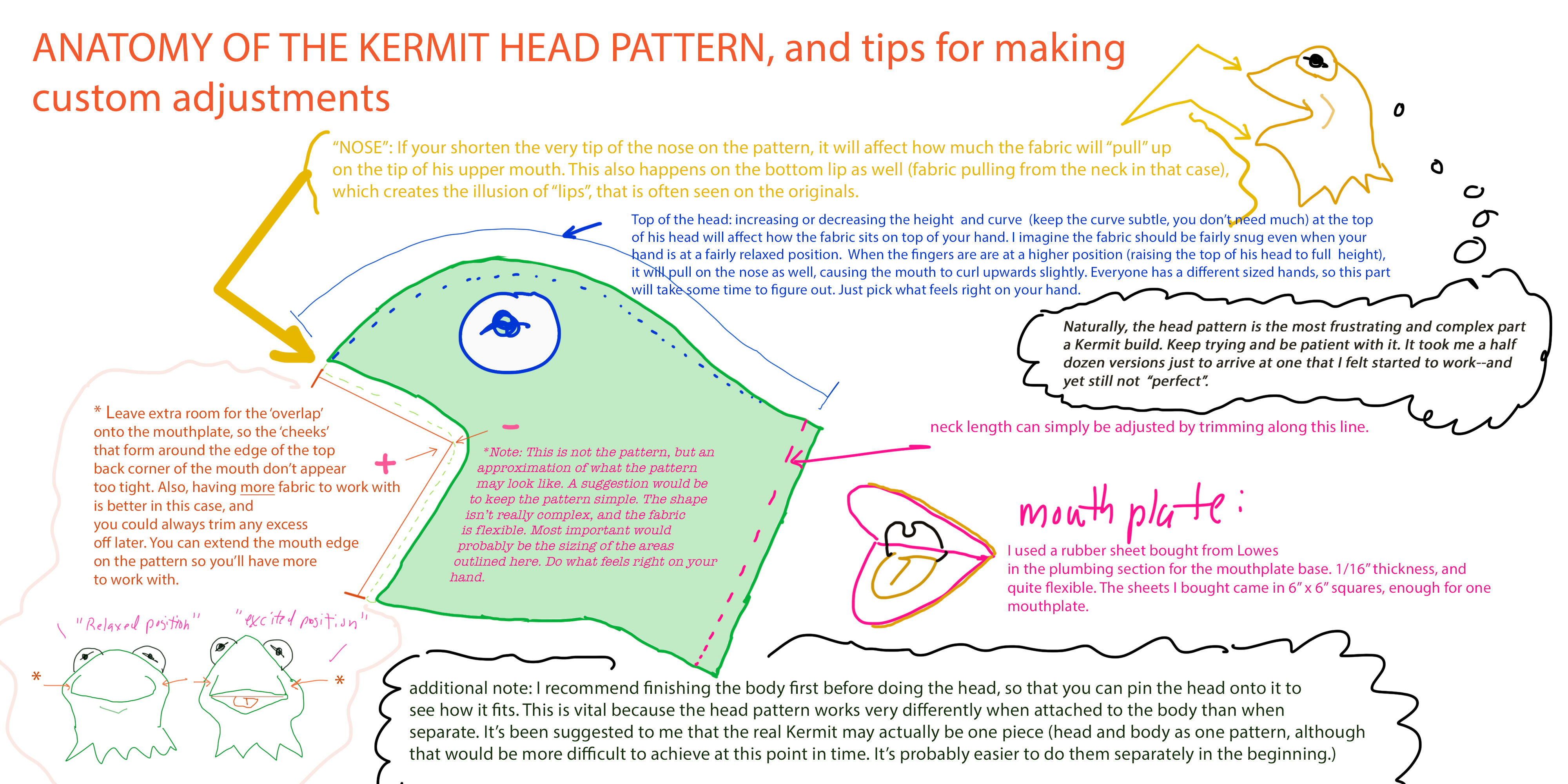

Thanks! Here's something I wrote up that might help de-mystify a few things about the head pattern. It's still a tough process though, but it might clear up a few questions as to "how do I make it do this?".
