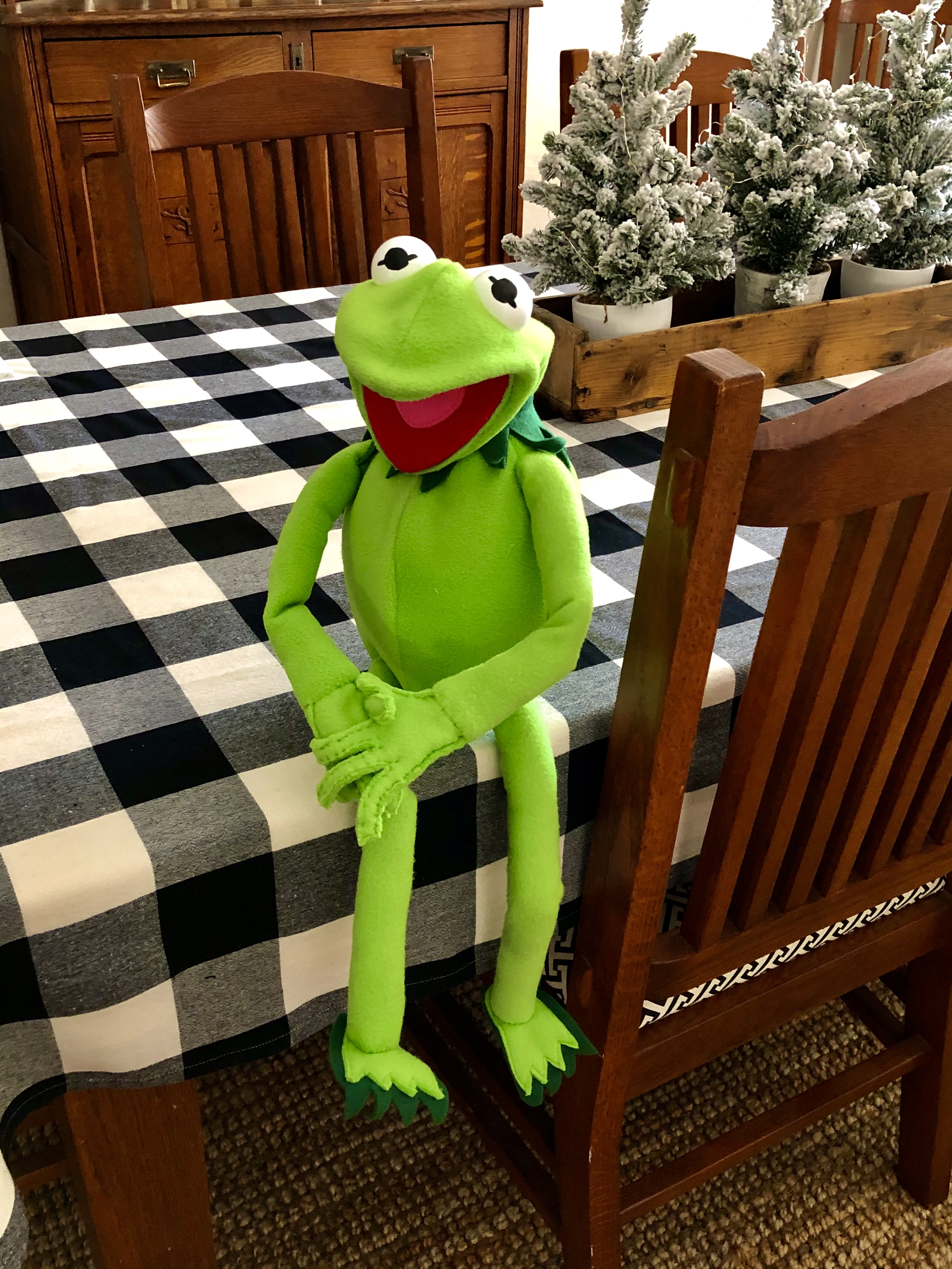

Thanks so much for all your information. It helped a great deal. Here’s the one I made for my grandson. He loved it!

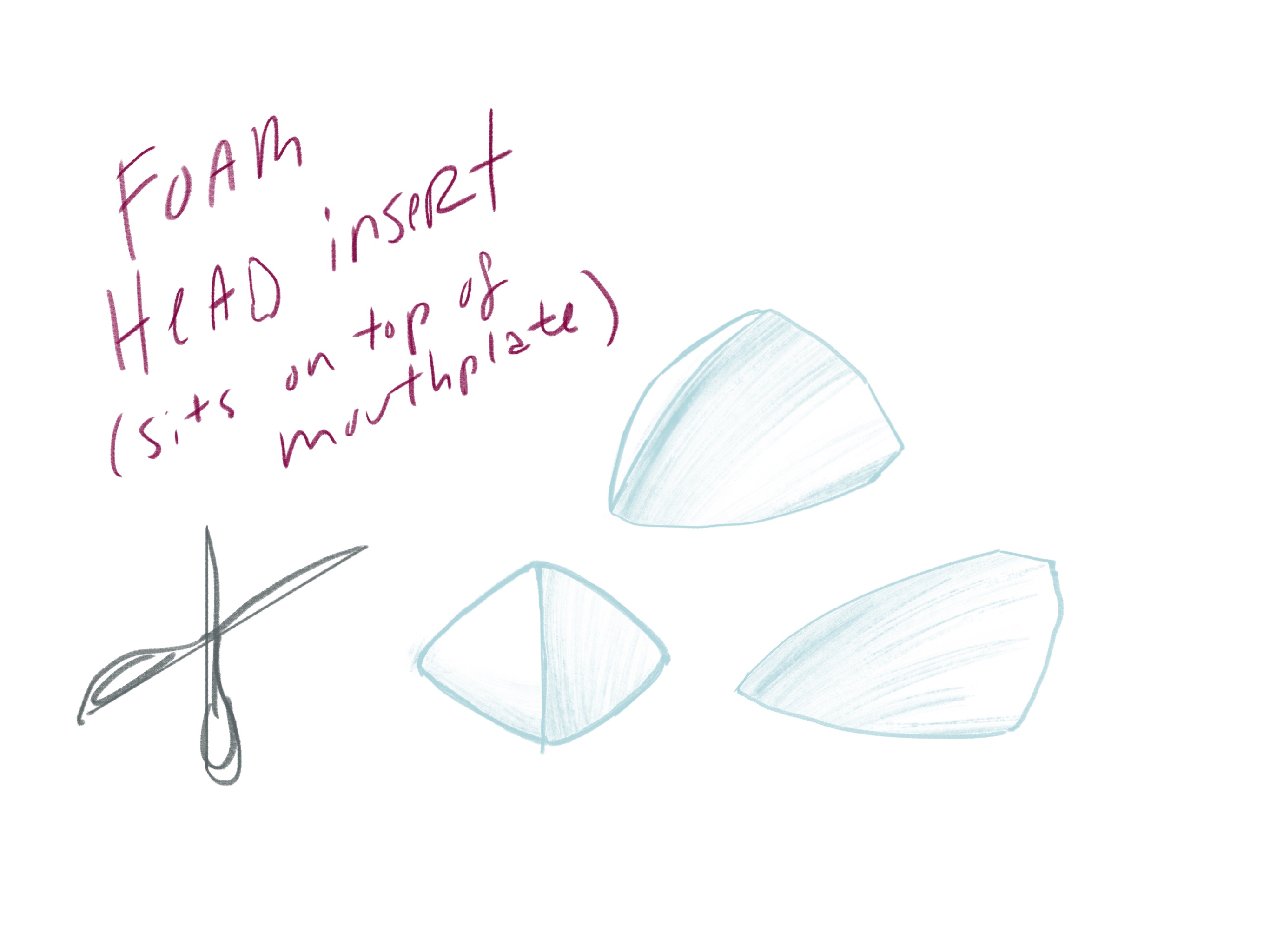

For display, how do you stuff the heads? Your builds look great!
That’s great—What a great gift for your grandson! I’m glad the info was of help. I still think the process of making one of these puppets is fascinating. I’ve learned a few things here and there from other builders as well!
Thanks! I just cut two pieces out from foam. The head part is sort of a triangular shape, and a simple cylinder shape to keep the head up. Nothing fancy, but I’ve found it to be a simple way to get the puppet display ready.
All the photos I’ve taken of my builds on display basically have these two pieces inside (easily Removable, of course!):

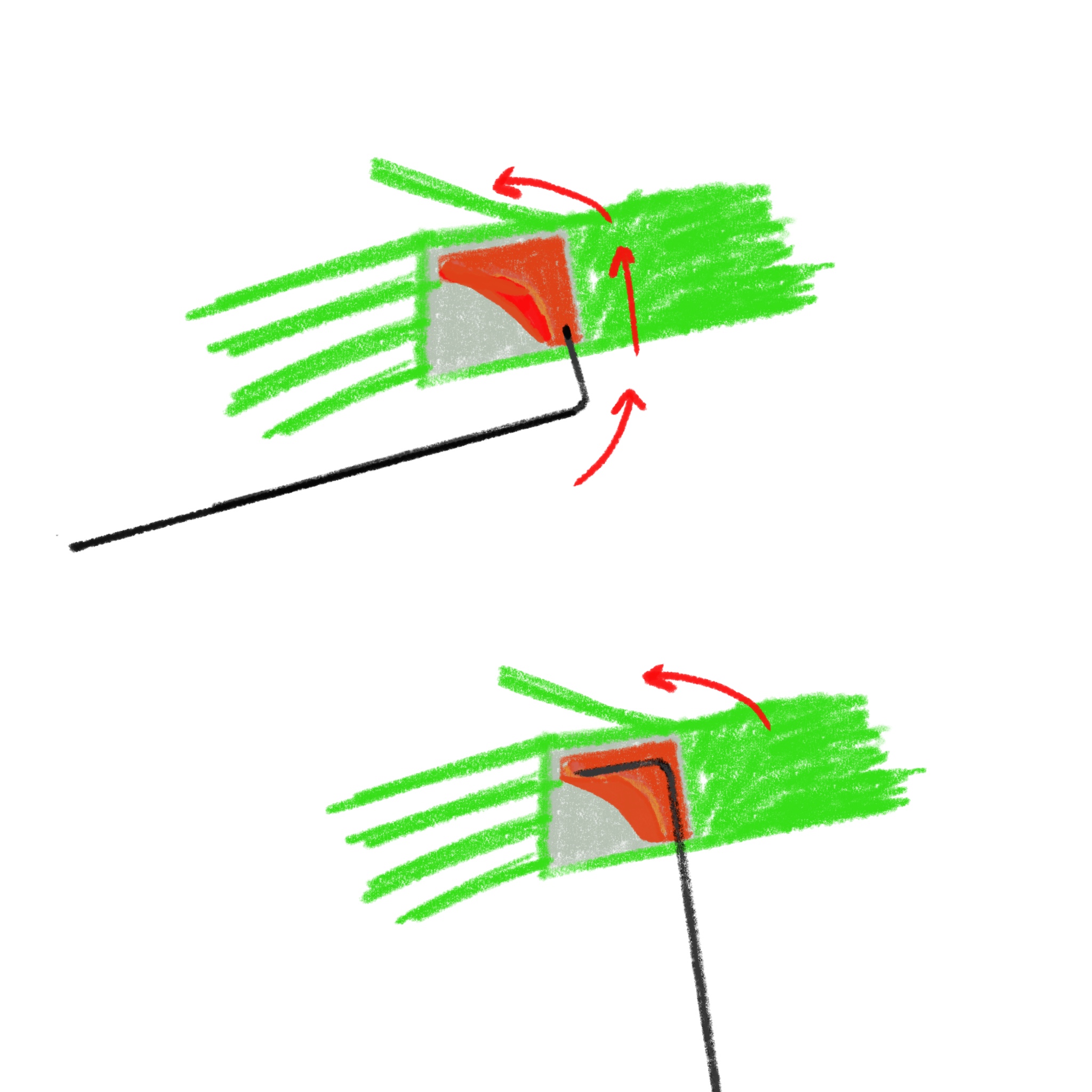

Hey ecl! I’m planning to make another Kermit, but with improvements. Do you have any puppet patterns to make Kermit the Frog With puppet rods? And do you have a list of materials to make Kermit for 2021?
It’s actually fairly simple to make the hands ready for arm rods! There are a bunch of ways to do it, but I‘ve been adding small pockets glued to the styrene hand plate on the palm side. Some people use rubber tubing for the pocket, but I‘ve been using some ultra-suede. Basically whatever you think would be durable enough for the end of the arm rod to slide into. I do that before finishing up the hand, and then simply cut a small hole at the base of his hand toward the back in the fabric, and then add a bit of glue around the hole to clean up the area where it attaches to the base of the inner pocket/palm. This allows for removable arm rods, which I have looking like a handle bar shape, allowing the hand to move inward and outward at the wrist.
An ‘x-ray’ view of how things fit in the hand:

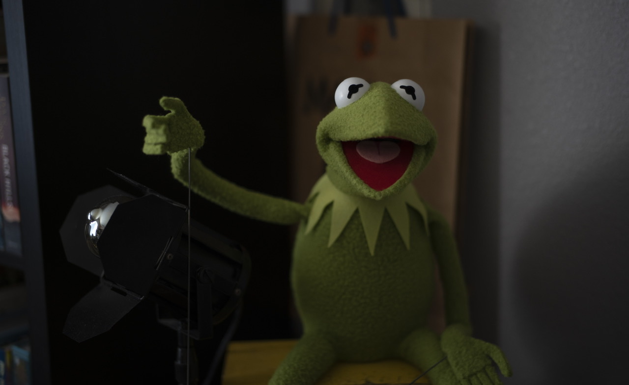

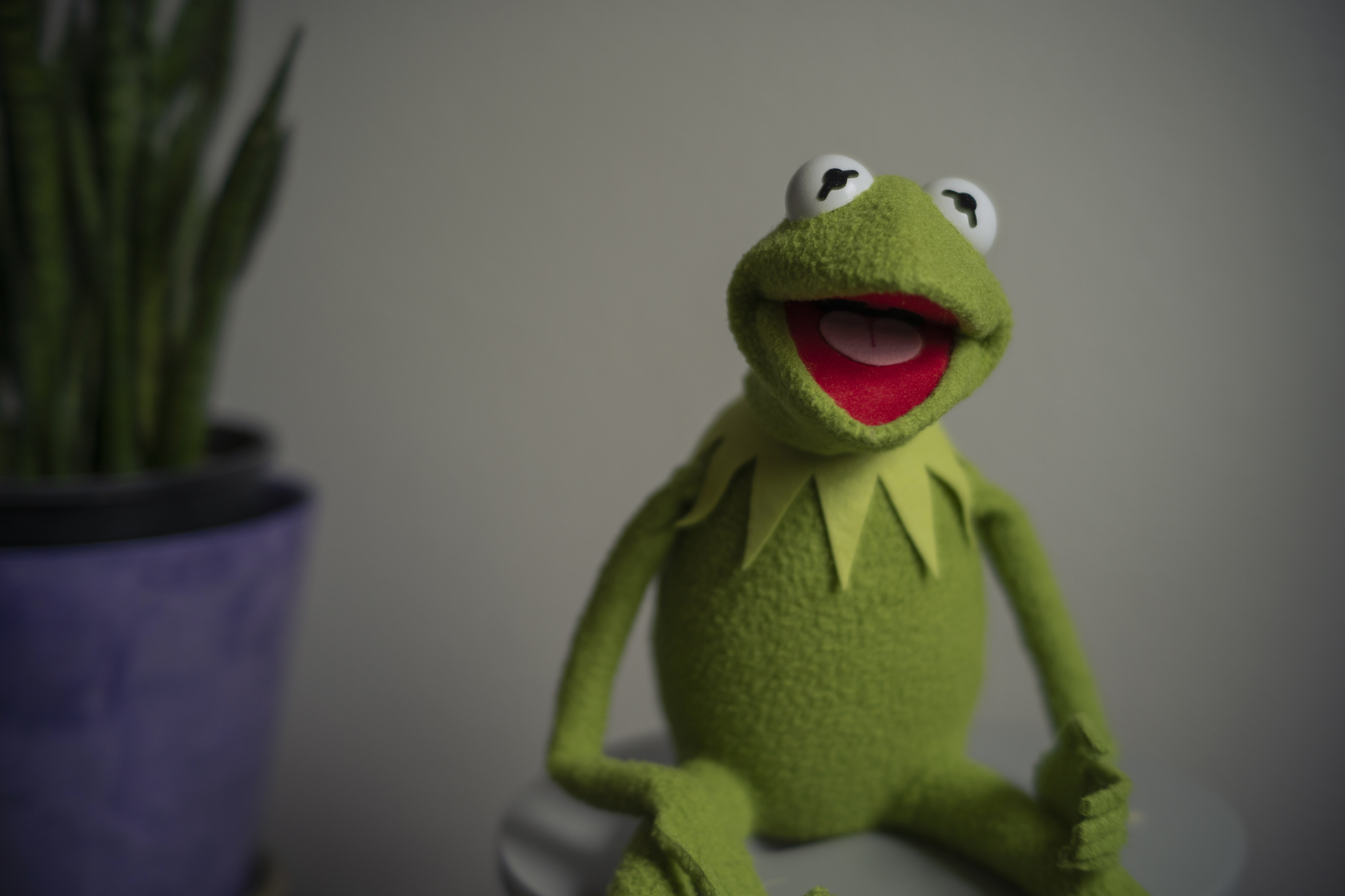

Had some fun over the holiday taking a few new pics of my build from earlier this year :)
