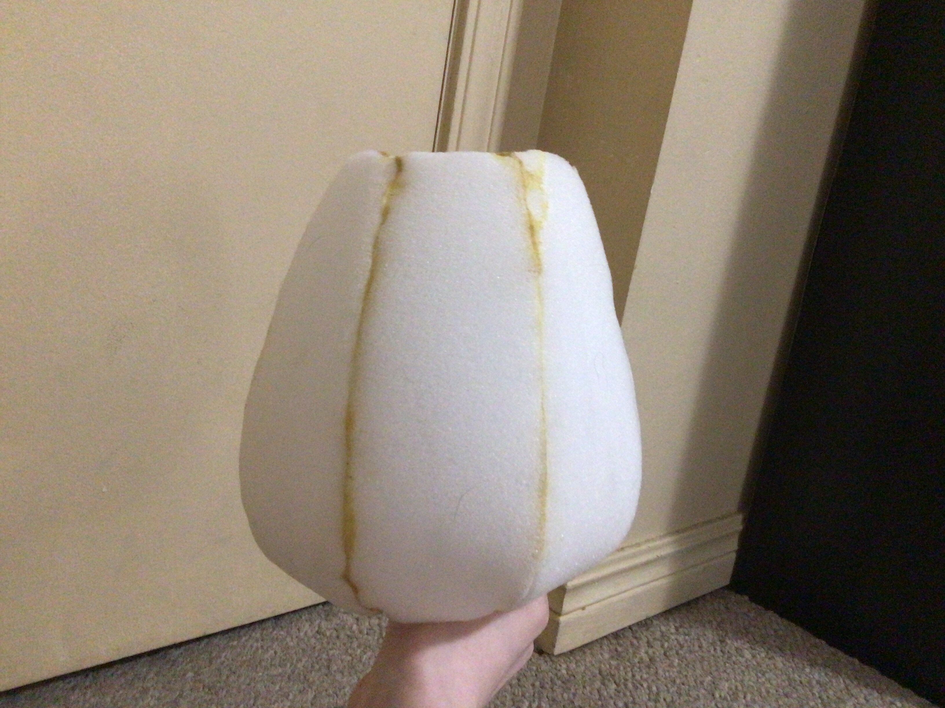

How many pieces do you use for kermits body? I’m using your old patterns
Generally, I end up using 7 pieces, although that sometimes depends on how the foam pieces end up getting cut (they can vary often times).
Something like this (below). From what I’ve seen in several references is that Kermit’s back has a pointed look to it, and his chest tends to be flatter. One my current builds, I will often trim the pieces to slightly different shapes and widths to get that look (Two back pieces a little wider, etc.):
