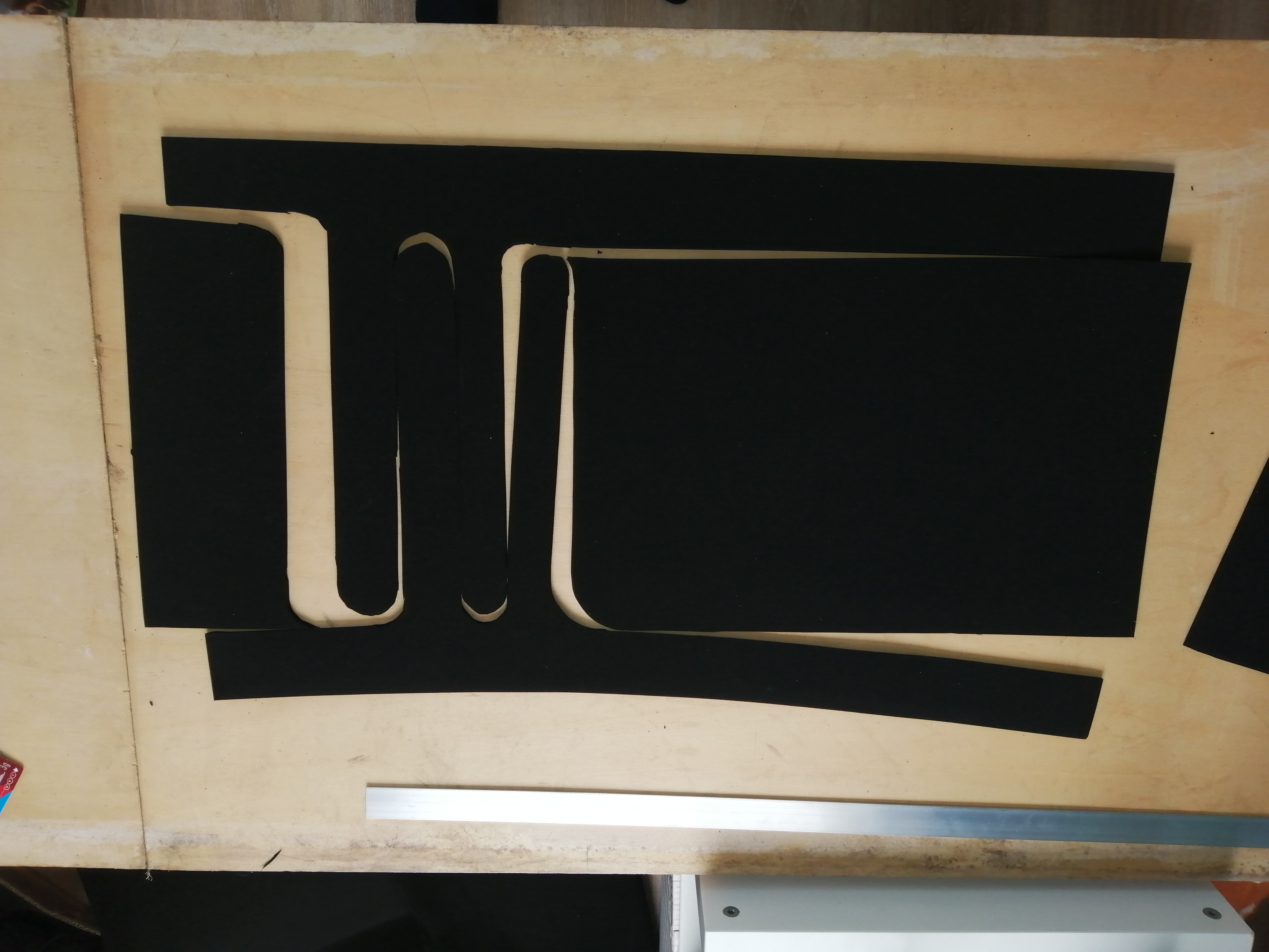

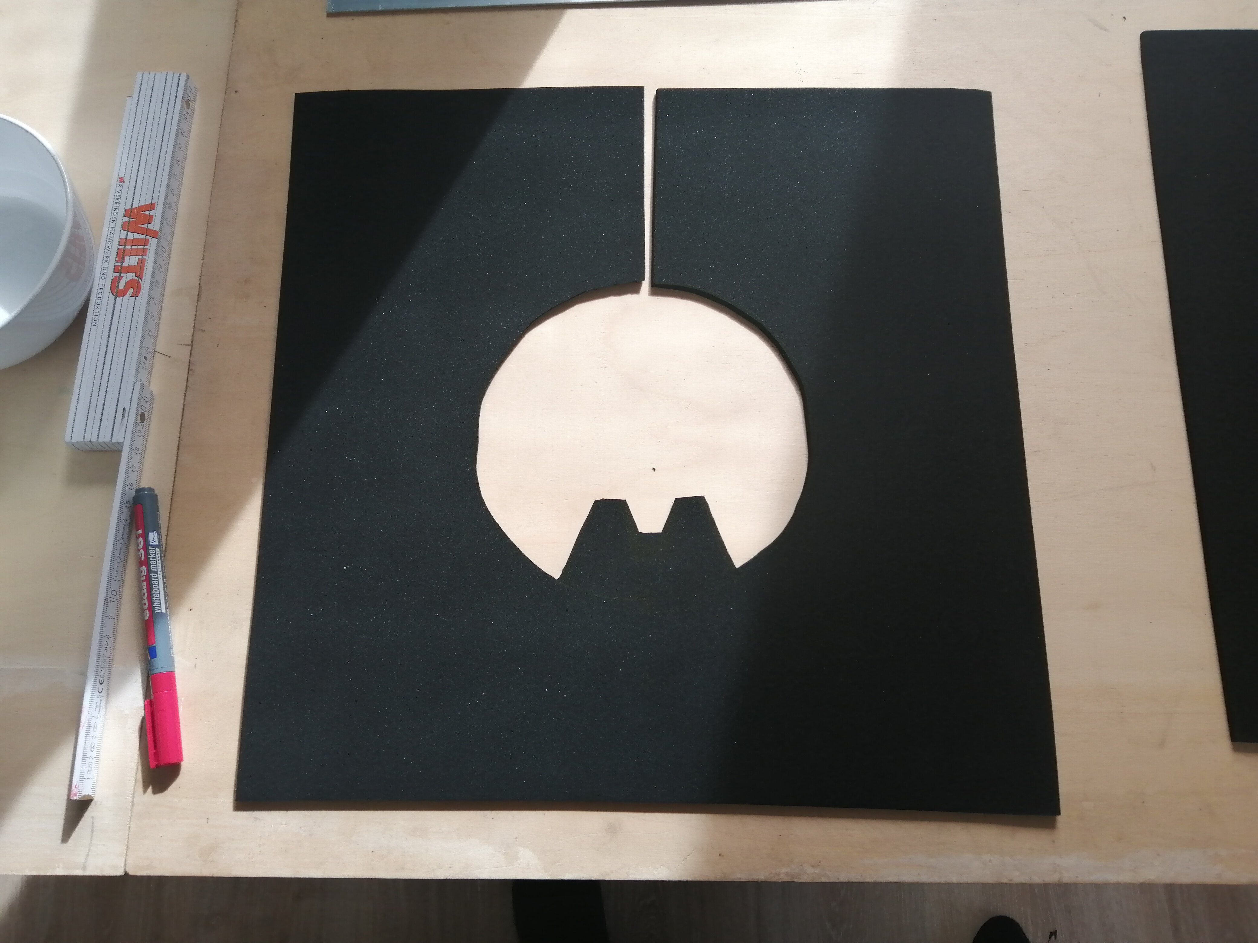

I started off with the torso-part and used 4mm EVA-foam. Basically tried to brake some ground and understand how the different parts might work together.

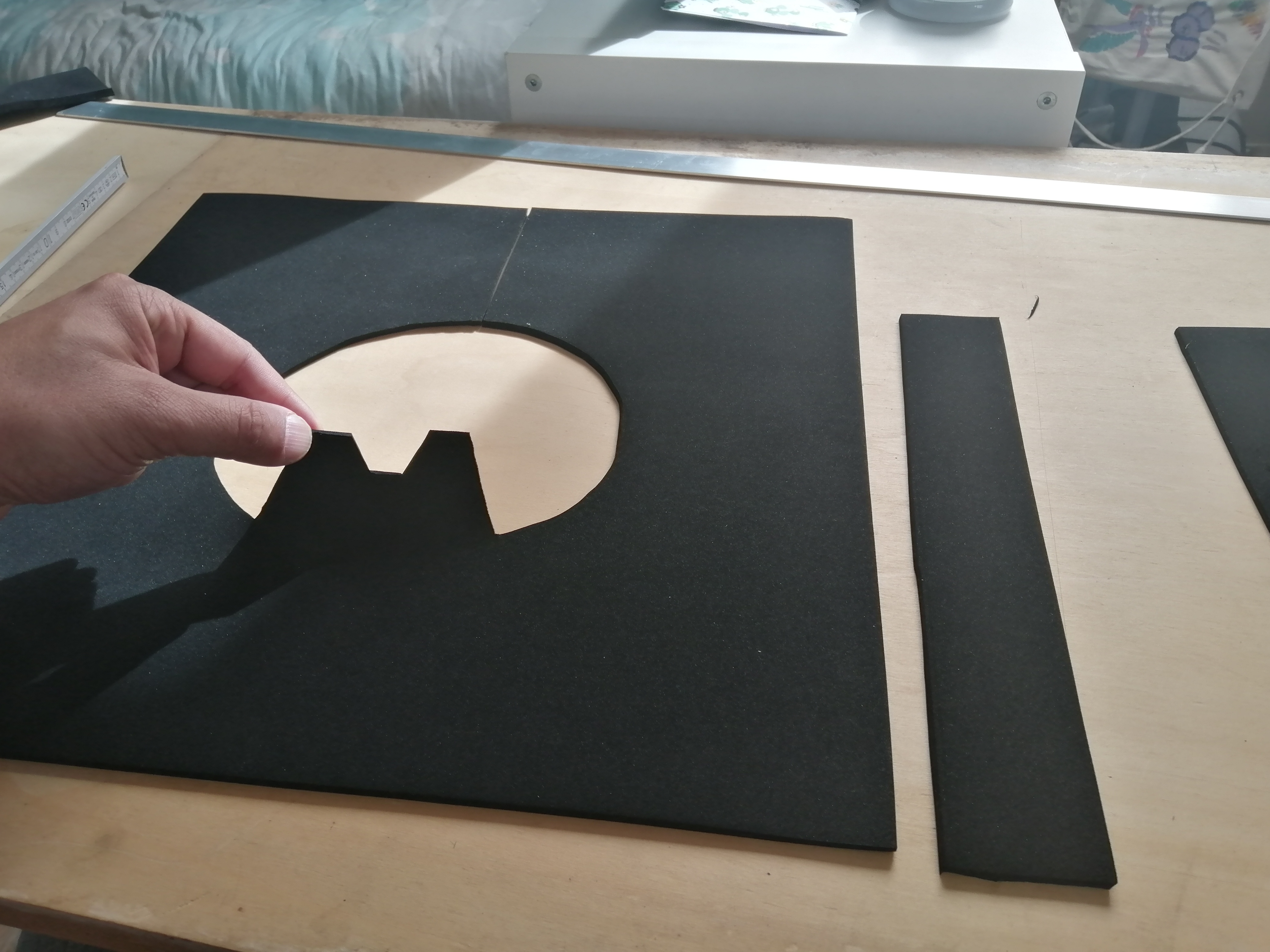

From pix like this I figured there's a rectangular neck and shoulder piece:

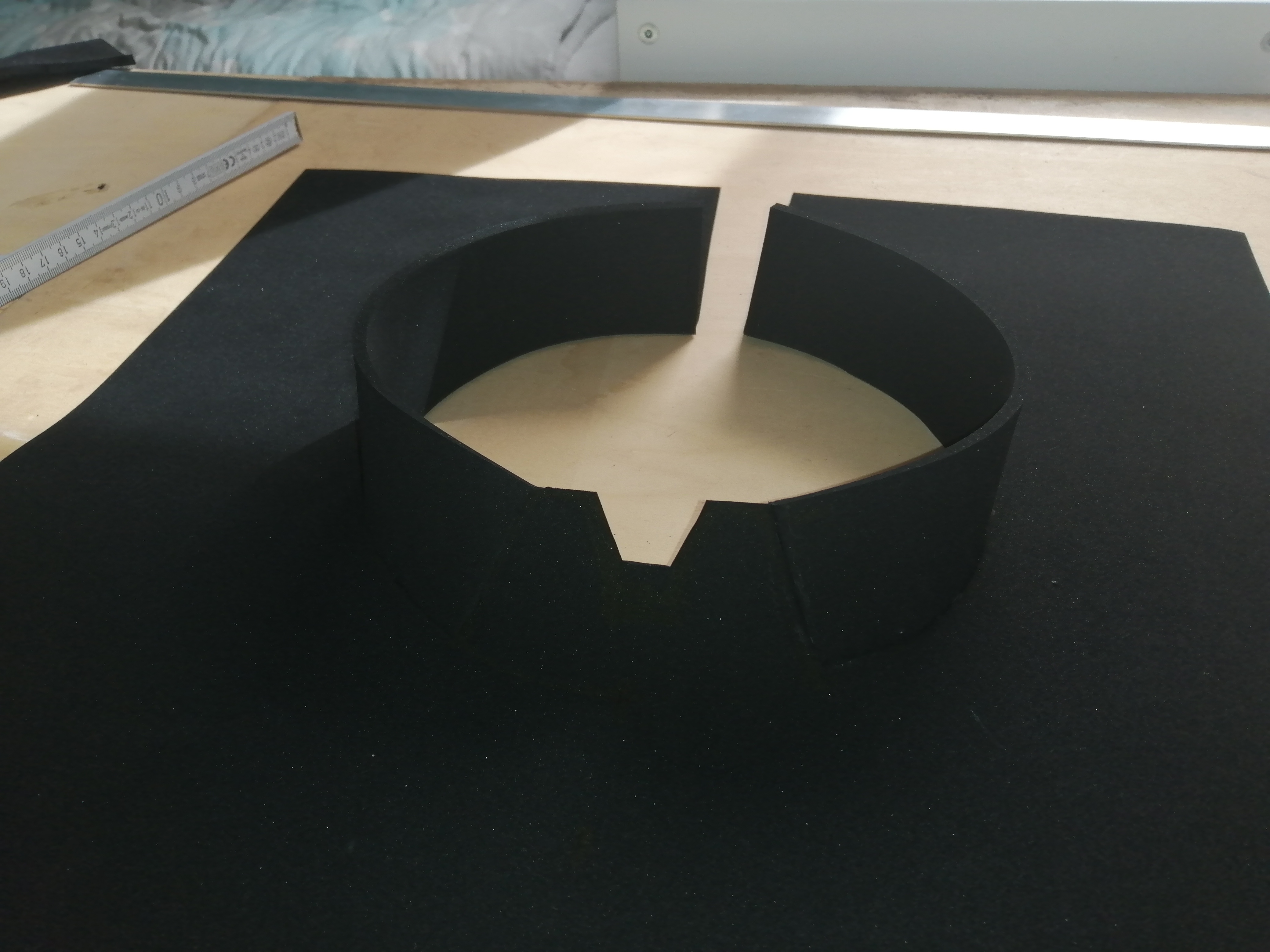

As there's no seam in the middle of the collar I cut out the opening like this:
Then put in a stripe of foam to complete the collar:

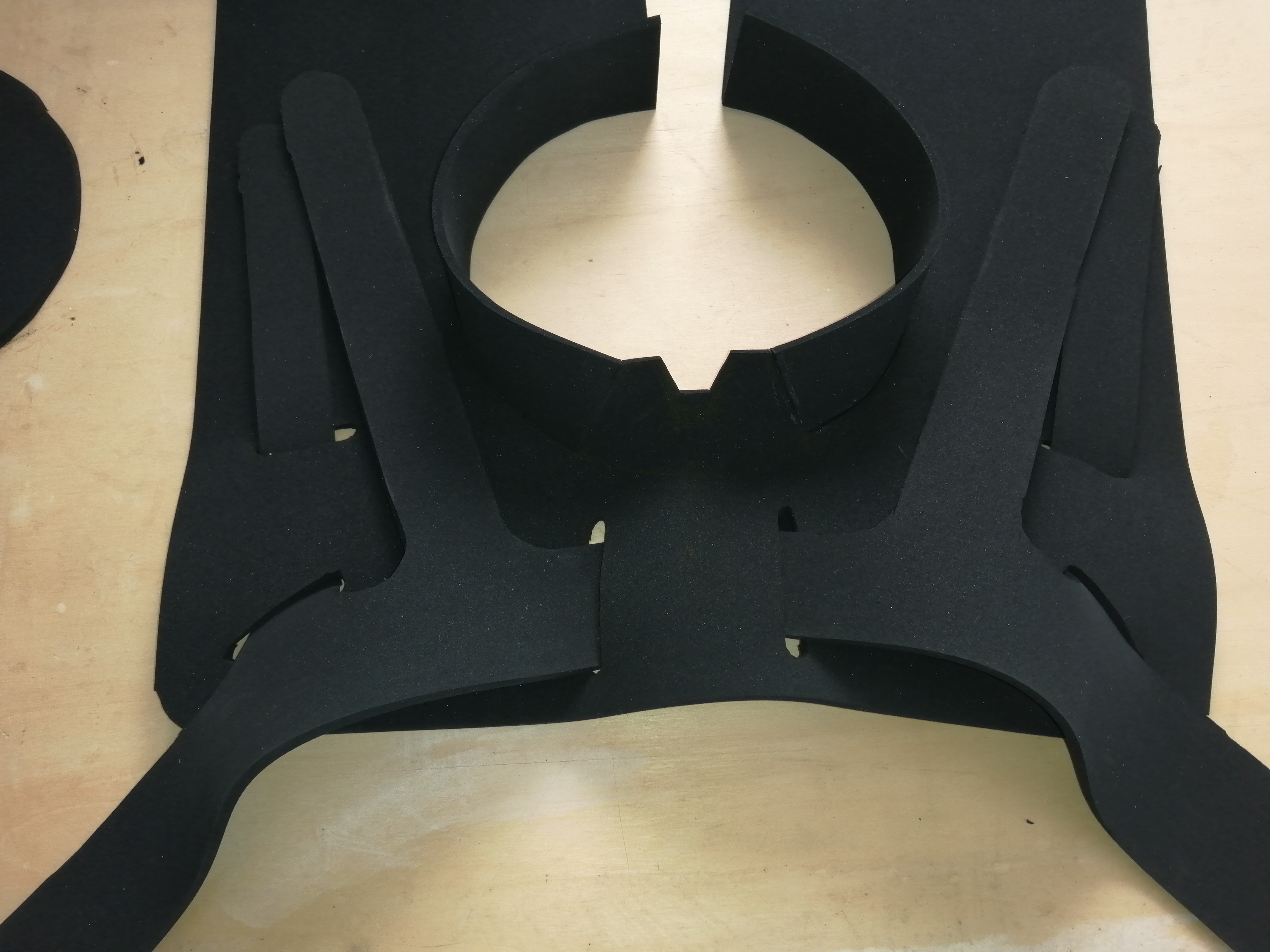

The second part for the shoulder piece is more of a wild guess, but after playing around with different shapes I ended up with this:
(You can cut them out kind of "interlocking" to safe a bit on the material...)
Then I made some cut-outs and put the pieces together like this:

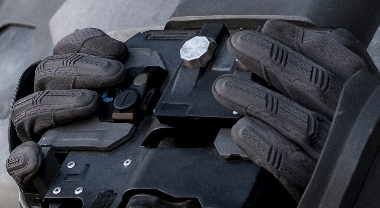

I've been searching for these gloves Duke Leto wears.

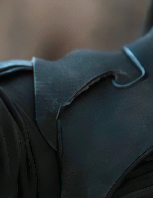

What do you think the original costumes are made of?
I'd say it's some sort of fiber-rubber-compound. I don't know the official technical term for that. The type of material they use for floor-mats and flip-flops and the like.
At first I thought they used Neopren, but those threads on the cutouts you see here point to some sort of fiber-inlay:
Epic! I love build like this templating as you go. Really really cool ,gonna watch this one.
Will your final build be the foam? or will you go with the mat material or something similar ?
Muddler You could be right; looks like they used a slightly ribbed material and a smooth version.

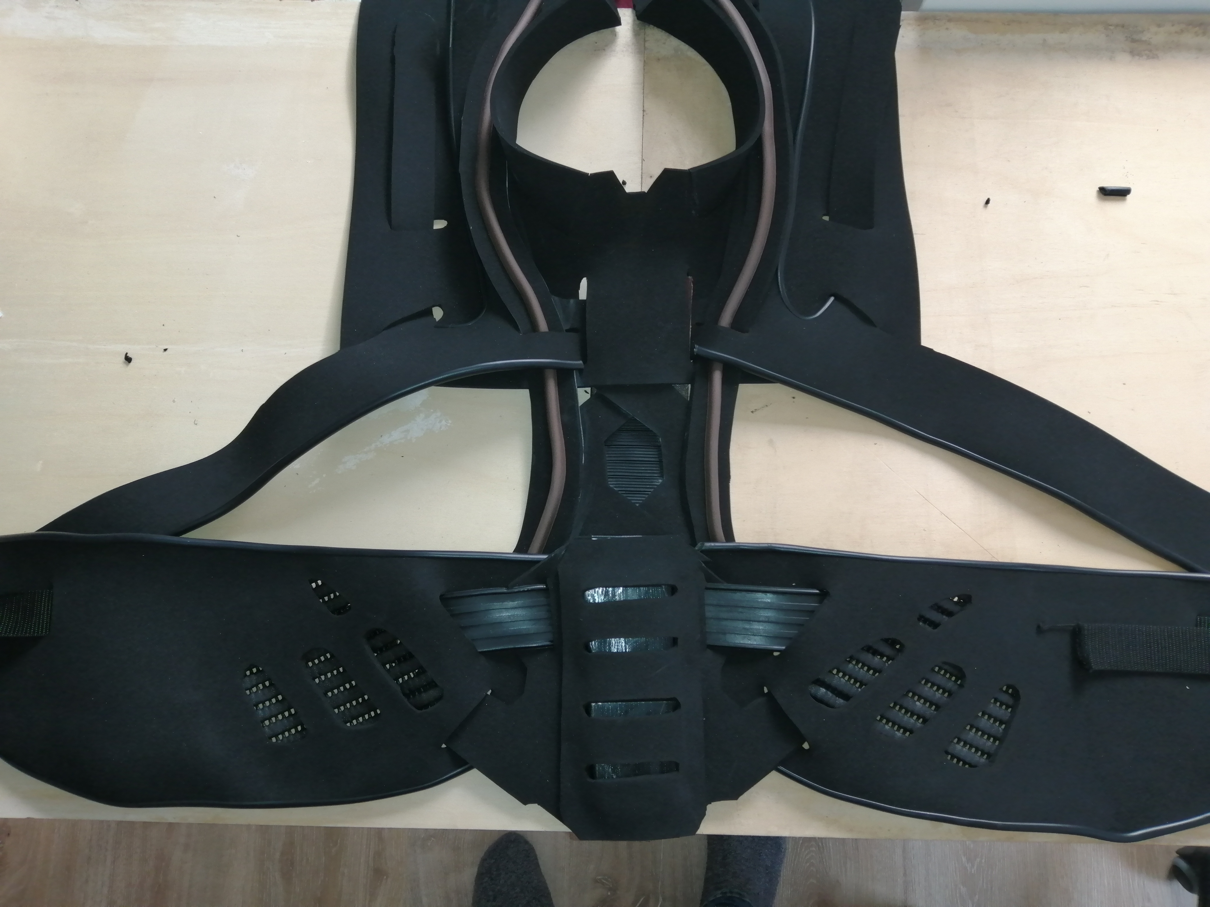

Some progress on the torso piece:
Adding the tubing and corner-protection already makes for a more legit overall feel. :cool:

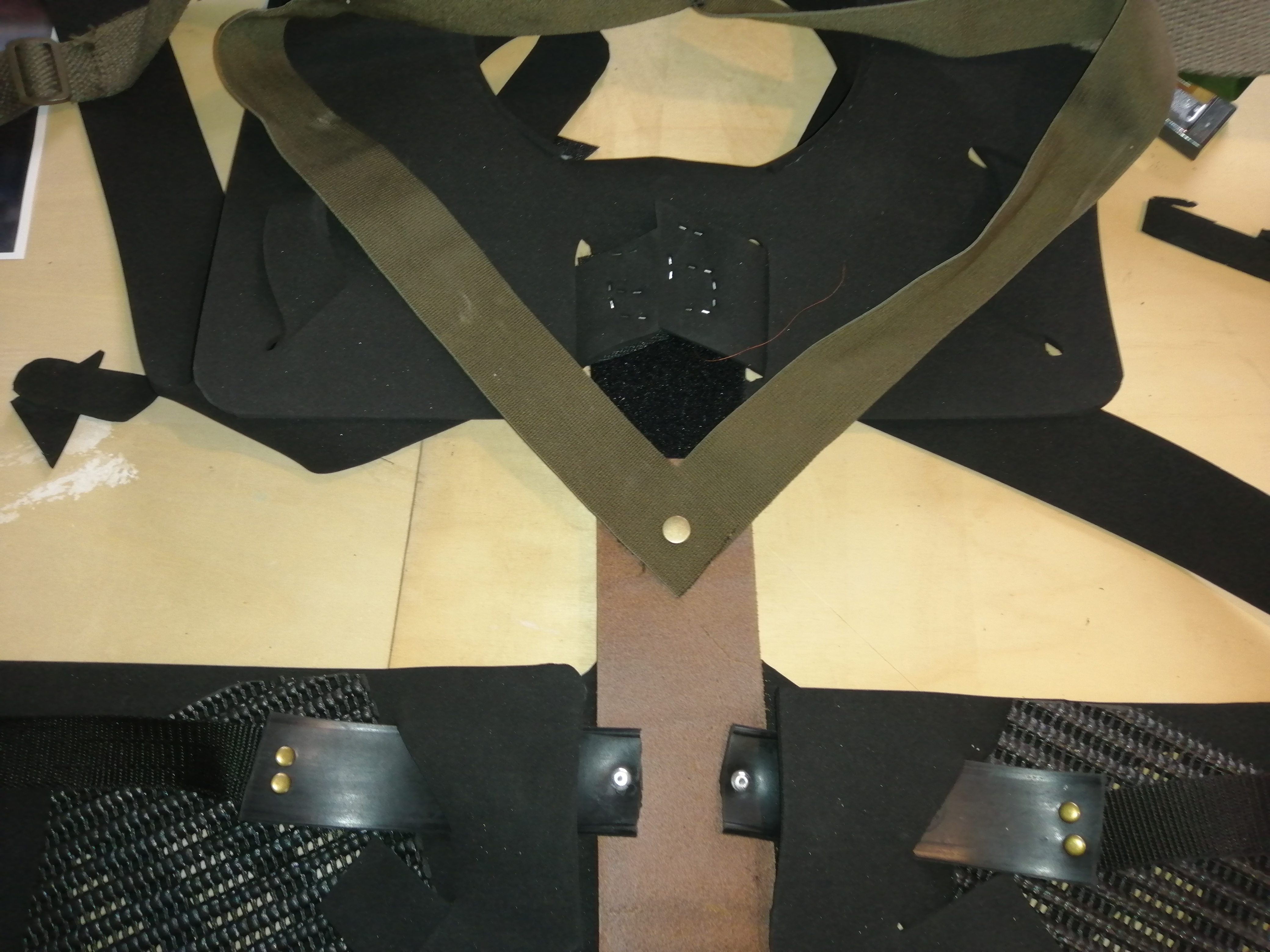

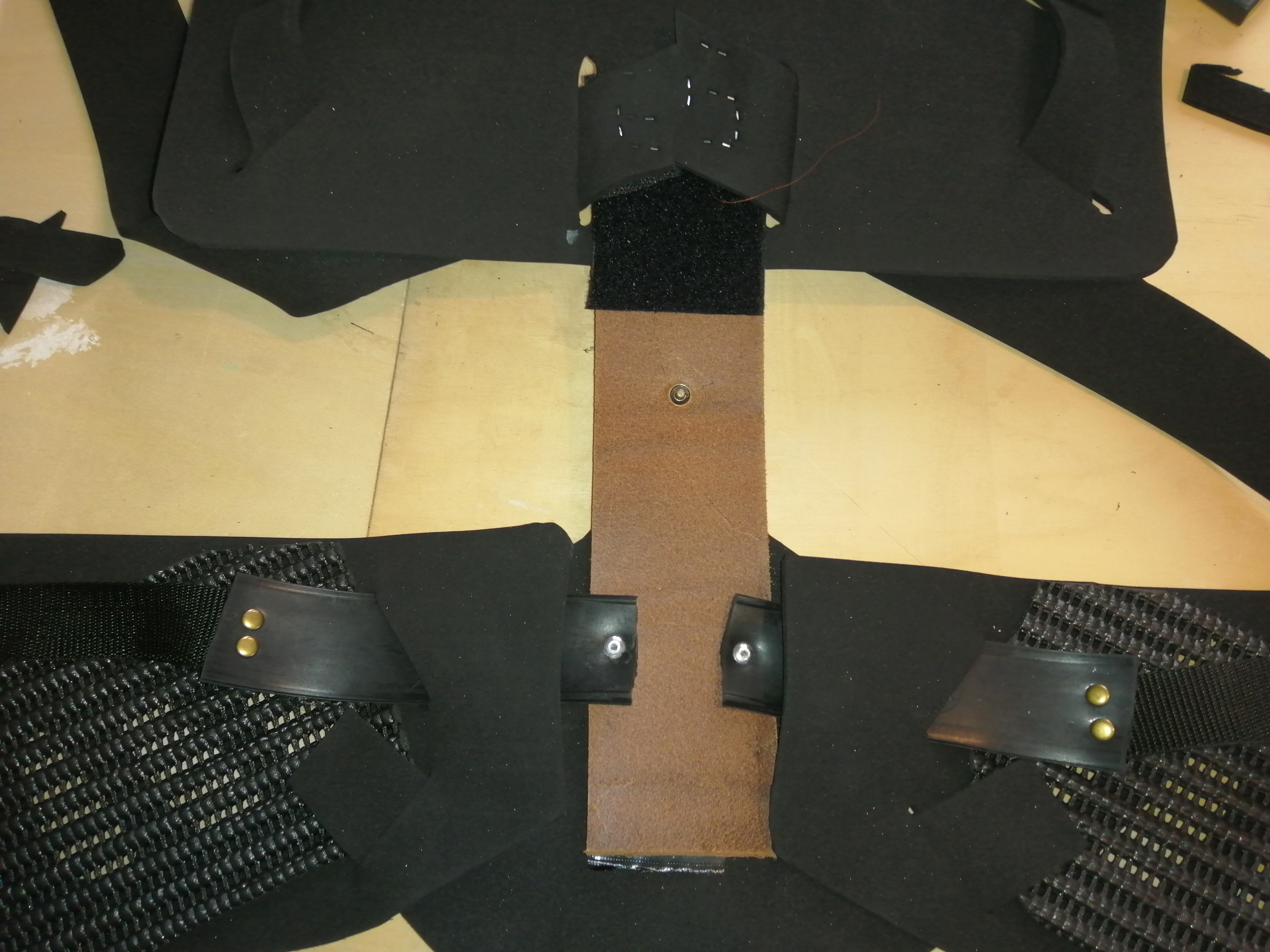

With more progress I'm also more concerned with stability and practicability (meaning I'll have to be able to put it on and off by myself...)
So I added a piece of sturdy leather as a basis to hold the parts together:
Also added some straps of an old military carrying harness to fasten the whole construction around my body:
Still a lot more way to go, but slowly getting there...

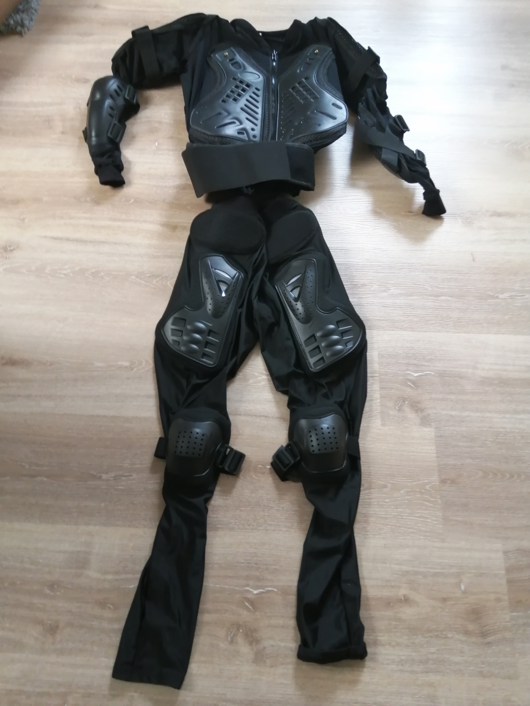

So now it's goin' to get dirty and I'll have to cheat a lot. There'll definetely be no time to sew a proper undersuit, so I got some cheap motorcross protective-gear to have something to work on:

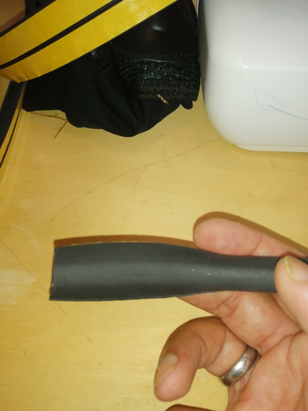

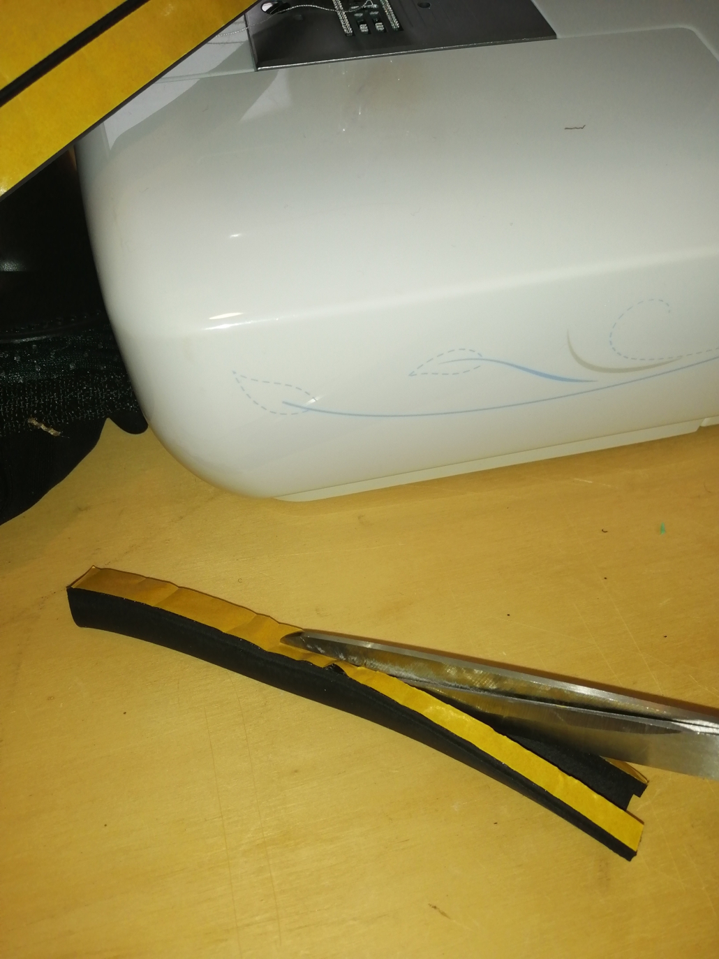

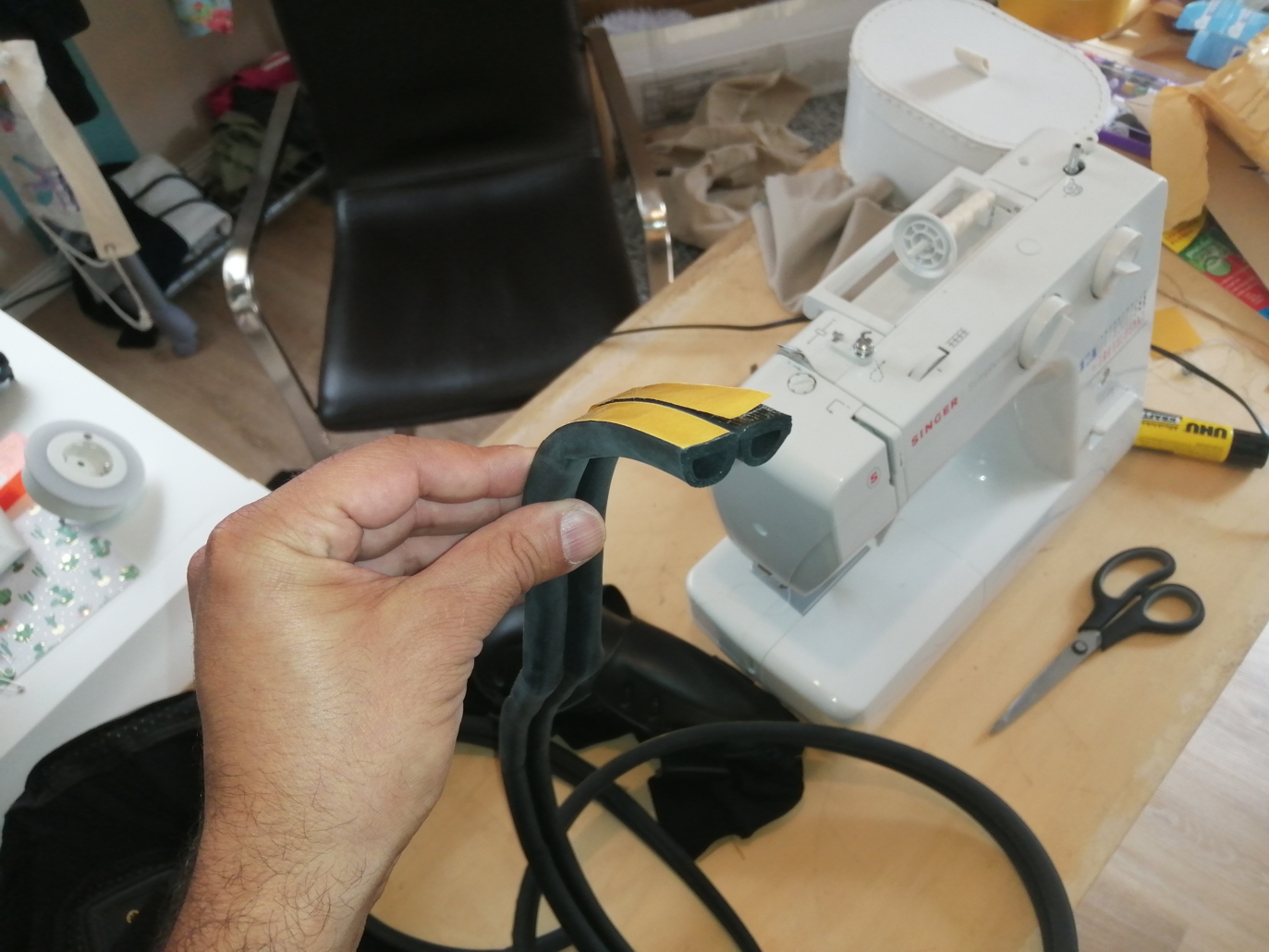

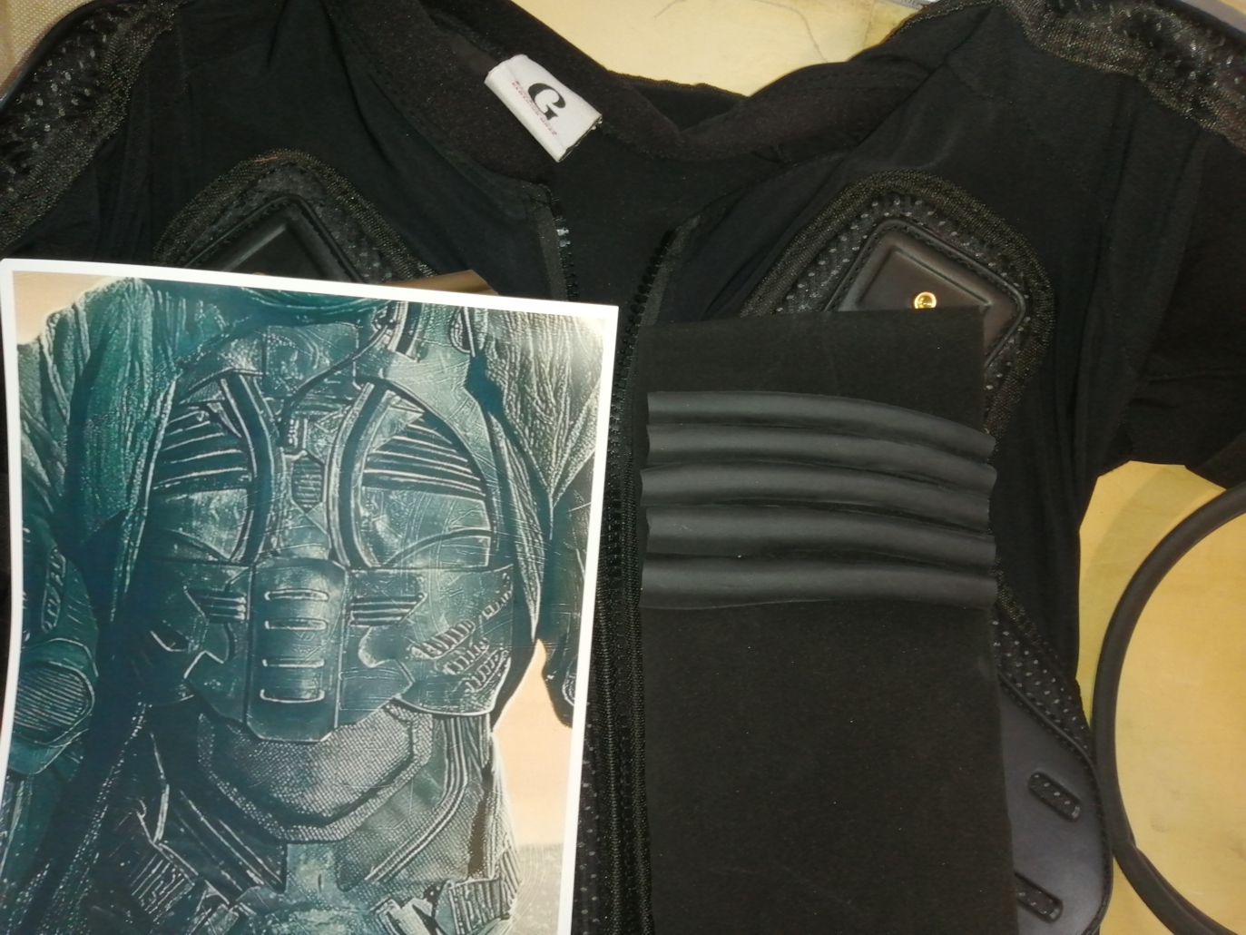

For the underlying ribbed "tube-whatever"-breast part I used some foamrubber door-seal in different diameters:
Cutting them from the bottom-side allows for a little shaping to better match the references
And a first test-fitting shows we're slowly getting there:

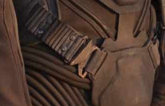

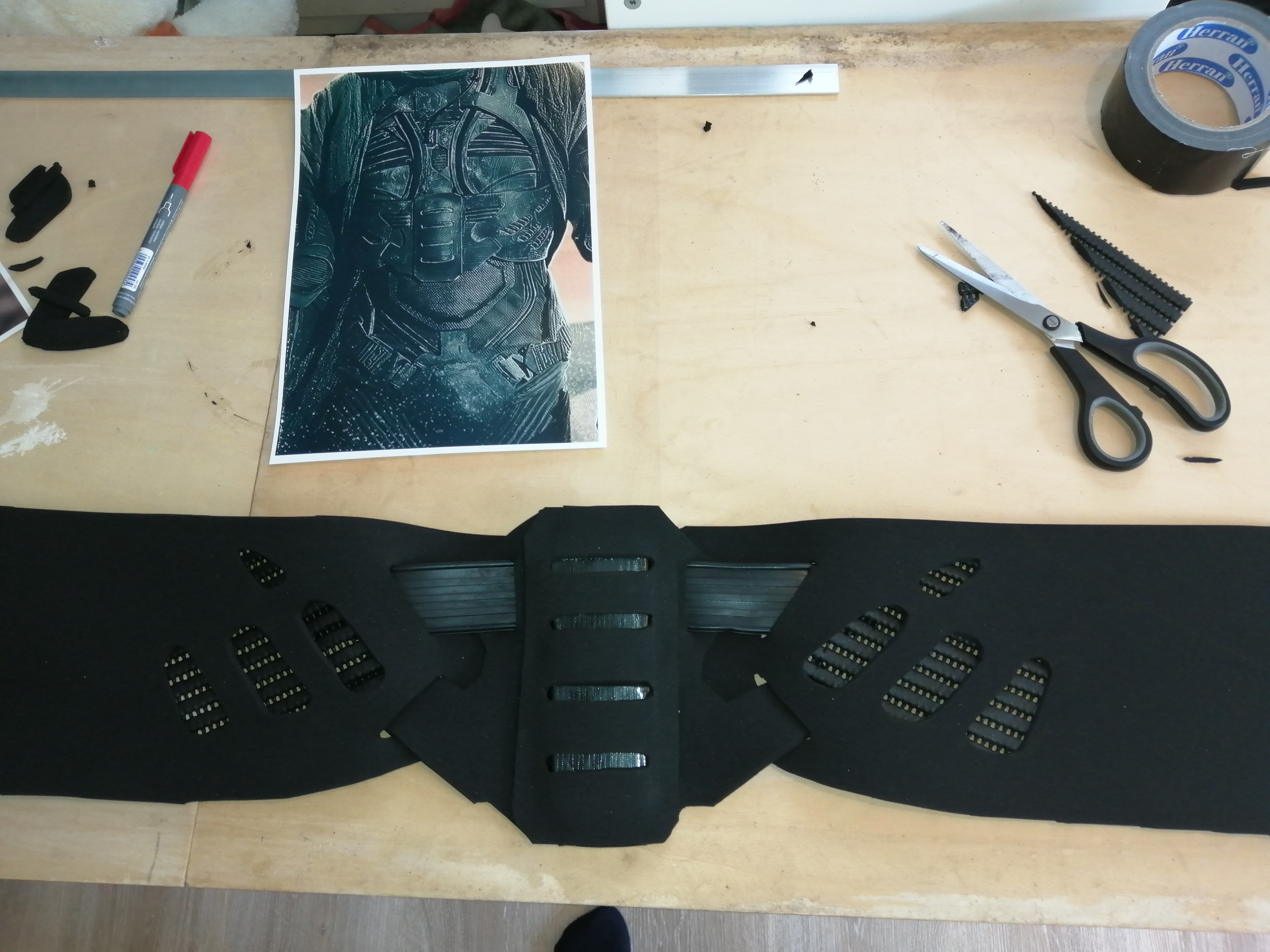

Worked on the groin protection and wanted to share one idea on possible "found items":

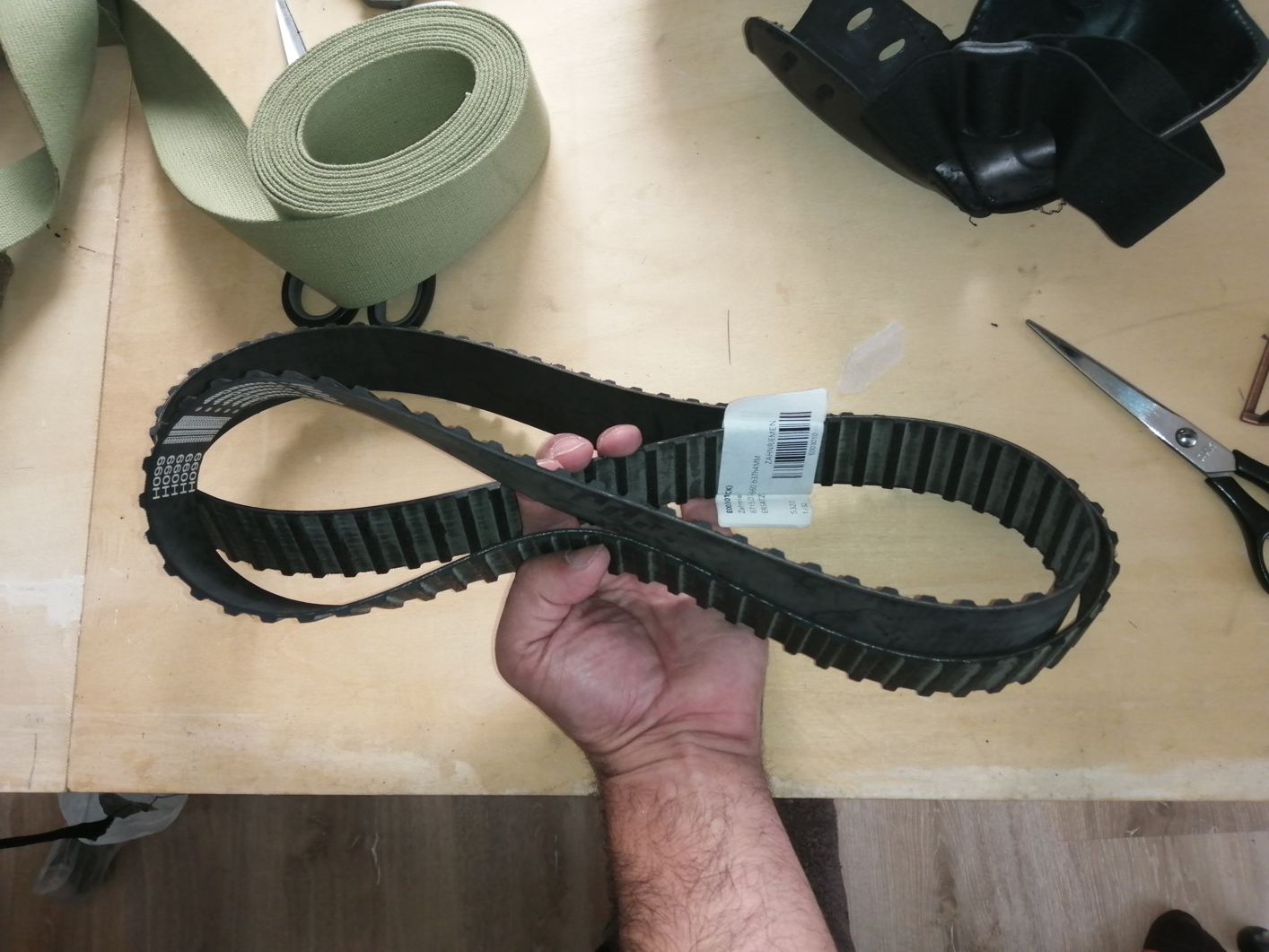

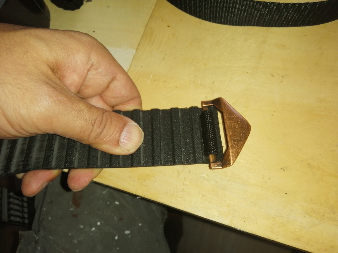

I guess what they might have used are industrial timing-belts:
The toothing on mine is not a 100% match, but it's the closest I was able to find at the moment. There are actually several other parts of the Still Suit that might be based on different timing-belts, but maybe I'll post on that later.

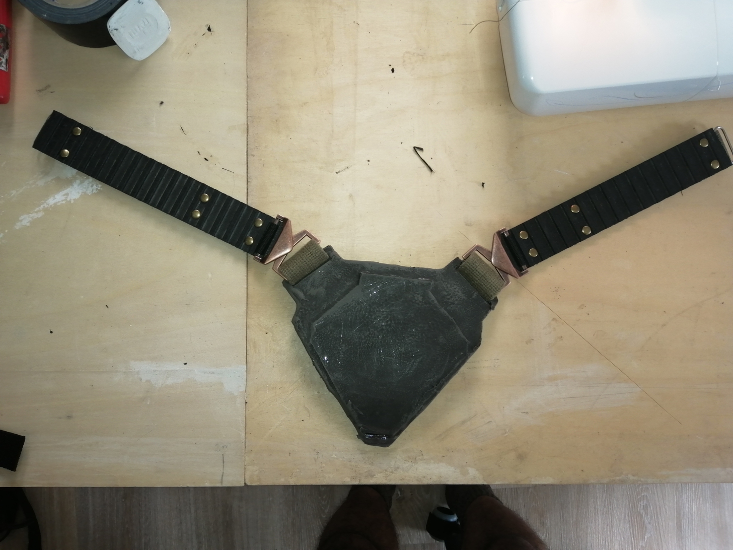

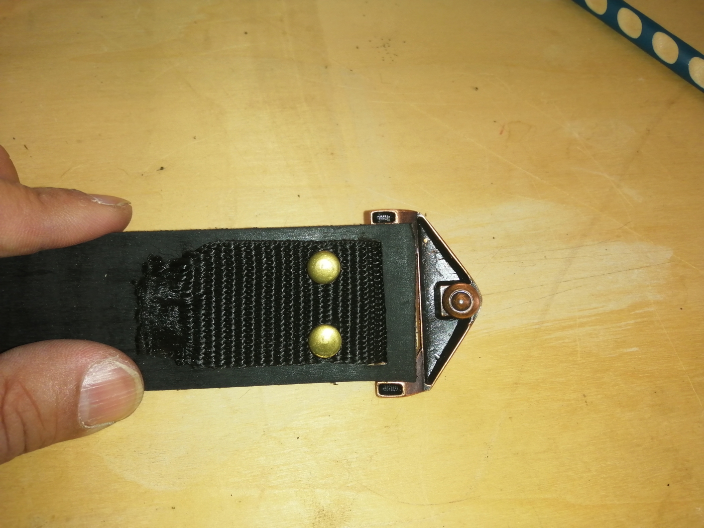

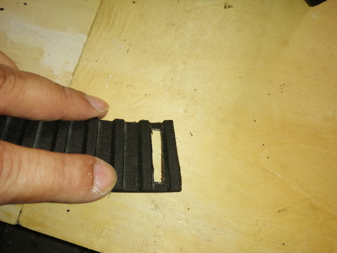

As the belt is very rigid, I wasn't able to fold it over to fix the buckle, so I made a cutout:
Used a piece of strap which I let through the opening and fastenend with rivets:
Interestingly this might be a technical explanation for the rivets we see on the screen-used costumes (though I got the feeling that they did something different there).
Maybe they made molds from timing-belts and cast them in a more flexible rubber-like material. (On some pictures you see the belts bulge and wobble quite a bit, which actual timing-belts usually won't do...)
And here are the belt pieces attached to the quickly improvised groin-plate (just some layers of foam covered with epoxy).
Stay tuned! Will surely show pictures of the complete costume tomorrow!
View attachment 1494681 View attachment 1494682

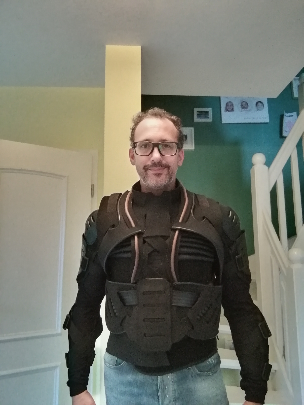

Phew...
Still a bit exhausted from the whole experience, so just a few quick pix.
The current version of the suit with a bit of painting and weathering added. There are so many little things I would like to have added...
But still happy I got that far for the premiere.
Here with an added "jubba-cloak" and nosetube in front of the cinema:
(I really needed the cloak, because the backside of the suit is a bit ugly with lots of straps and buckles...:p)
The movie was pretty impressive, still gotta let it sink in...
