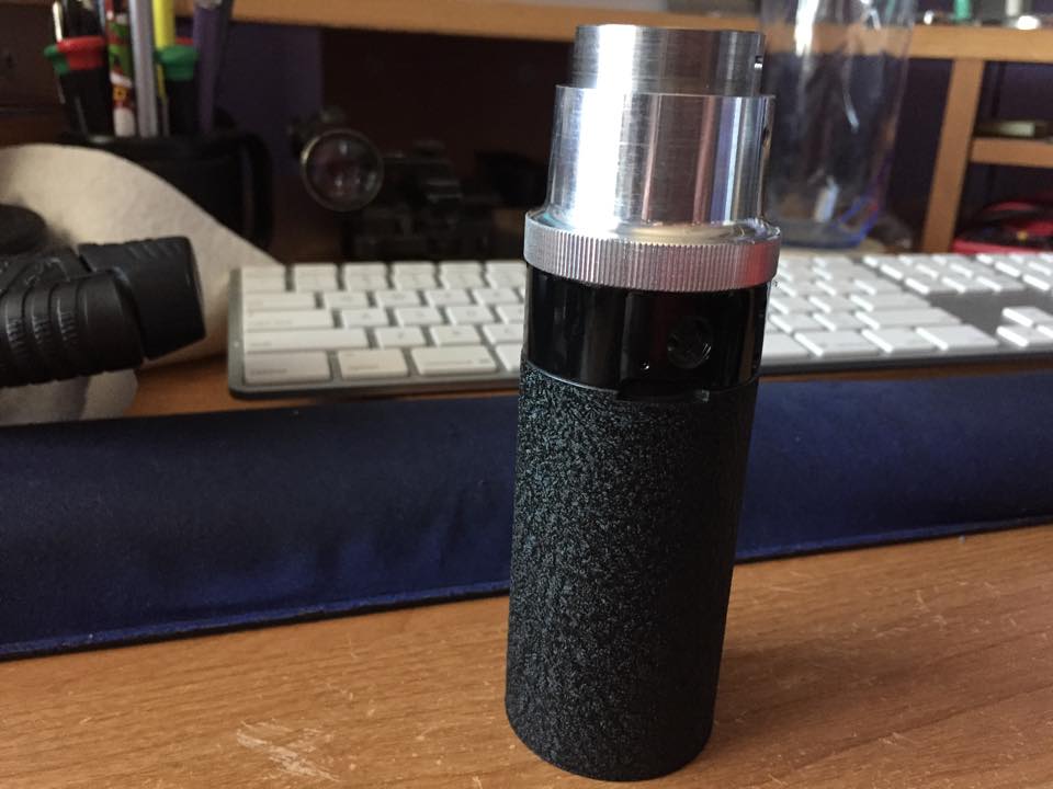

Thanks! applying the red dot now... well paint applied, now it's baking.
I'm not sure how pretty I can make the logo though... dang...
How about a local engraving company? An easy job to do a CNC cylindrical engraving with a vector file of the logo. That's how I plan to do it: first paint, then engrave. Just like the real Kobold.
And I'm also curious about that wrinkle paint!

Sorry guys, busy evening.
This is the wrinkle paint I used.
http://www.oreillyauto.com/site/c/d...rch_wrinkle+paint_-1_-1&keyword=wrinkle+paint
Worked super well, and was very easy to do. Just follow the instructions pretty much. I always bake my paints, as I suck at having real patience. It actually says you can bake it to cure it too on the can, so I did my normal procedure and voila. Turned out fantastic.
I have a superb resin casting of an accurate Kobold and the wrinkle finish matches perfectly.
Now about that engraving....
Dave... care to offer a service??????????
