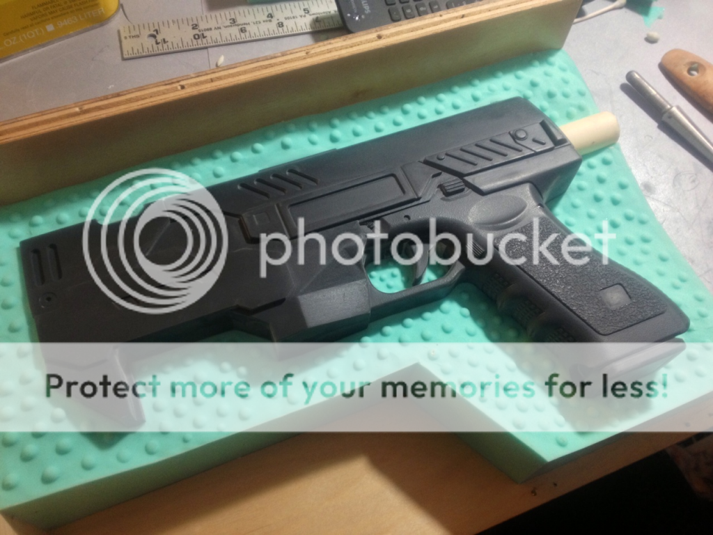

Here's a few more photos.
This is the interior of the "flash hider". I've built a recessed barrel at the bottom, and filled in the lower void. This way if you don't want to add the supressor you don't have to.
Here's the interior of the lower mag. I added some styrene shims to the interior to beef up the side walls a bit and remove the undercuts to make molding and casting easier...I would later drop an additional plate down at the bottom to bring up a bit more to make ammo castings sit level and plum...
In the mold and being clayed up. Notice the thin tan areas around some of the Glock mechanisms? That's clay that's been pushed into seams to keep silicone from seeping in.
Print coat of silicone in progress. This side has since been filled up and sealed. The mag has also been molded. I hope to pour the other half tomorrow and pull a few castings from the magazine mold. Pics to follow!
Shawn

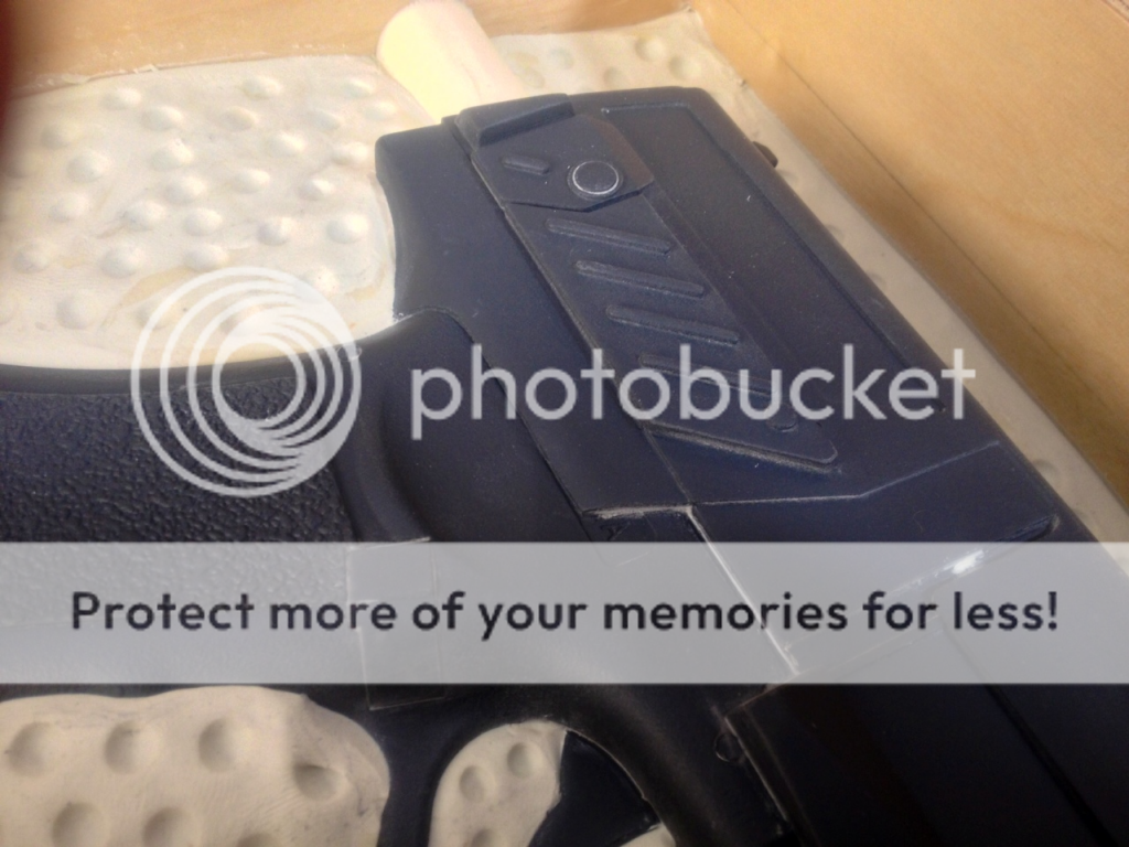

Here's the other side about to get silicone (I did wind up adding one tiny detail that only seemed appropriate-not seen here). With luck I should have a casting to either late tomorrow or Wednesday. I also ordered some inert 9mm rounds that I'll configure in a group and mold for the forward mag once they arrive. Thanks for everyone's patience!
