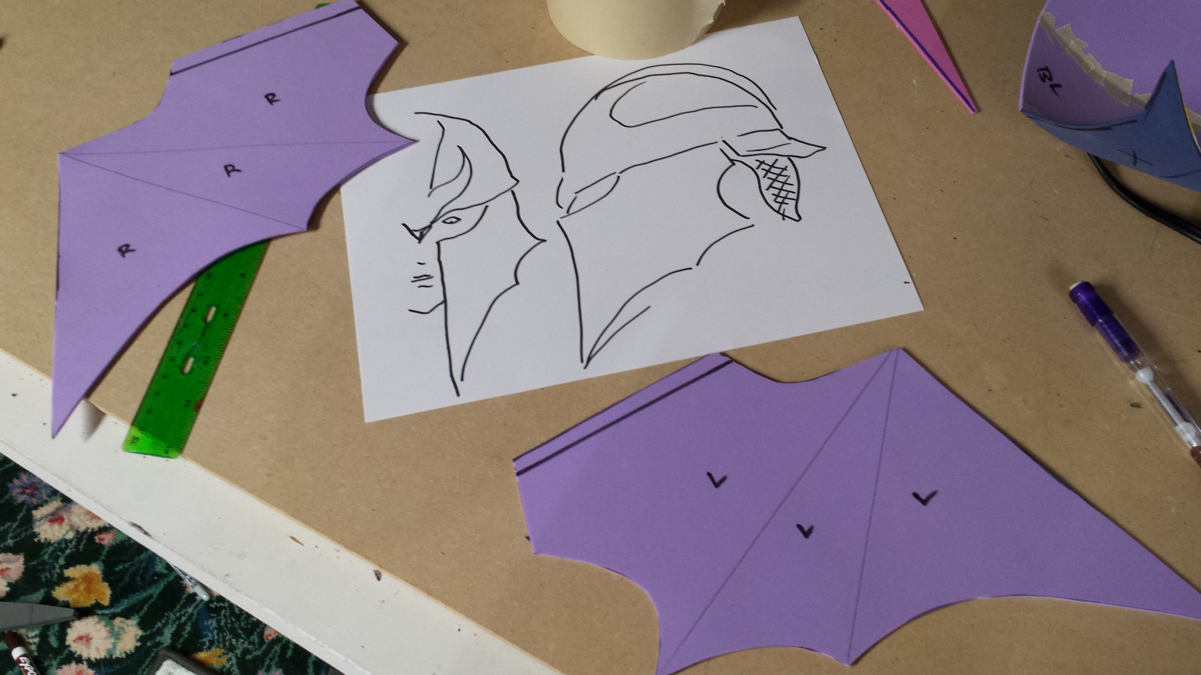

I started with mapping out the template. Cover your helmet in tape and draw out all the sections you want to make out of worbla of other materials, peel them off and put them out. I usually laid these patterns out on craft foam because I could them easily cut them out to sandwich between worbla layers.

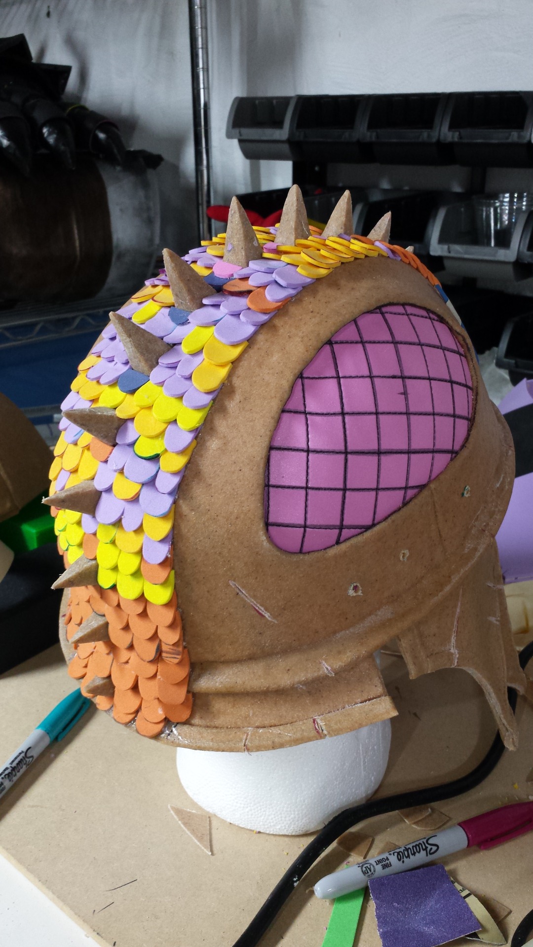

The stitched scale on the side came first. I took a piece of craft foam and did some wide stitching on my sewing machine in a crisscross pattern and glued it to the side of my helmet. I had patterned out the window for that scale pattern on my tape, so I then sandwiched these pieces between worbla, heat them up, and molded them around the helmet.
The wings were second. I sketched out the wing shape against the helmet and then divided it into 3 pieces, sandwiching each between worbla. I then stuck them all together at angles to get that ridged look and added a slim rope of worbla across each seam for added height. These both were glued to the inside of the helmet.
The spikes were made with worbla scraps that were heated, shaped, and dremeled into points. I kept the bottoms of each as flat squares so they could be easily glued onto the helmet.I added a lip to the back of the helmet to mimic the shape extending over the chainmail in reference images.

The surrounding scales were craft foam that I cut out from scraps and attached with this beads of hot glue.

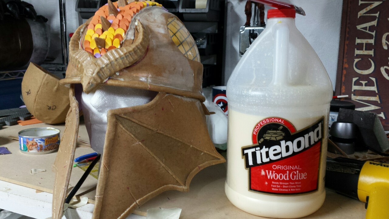

The dragon head was templated with craft foam - but like the spikes, was molded out of scrap worbla and shaped using exacto blades and the sanding bits of my dremel.

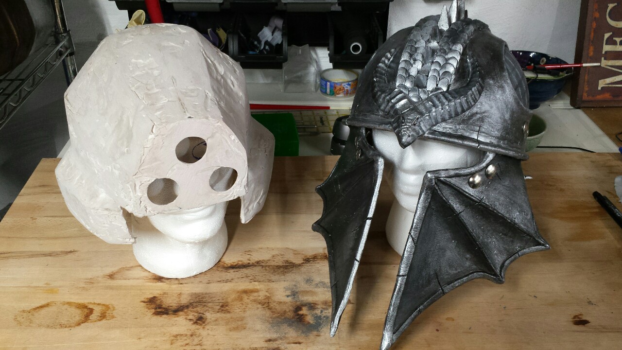

When the base was complete I painted it all in layers of wood glue that had been diluted with some water. You can also use plastidip as long as you’re meticulous about getting the underside of the scales.

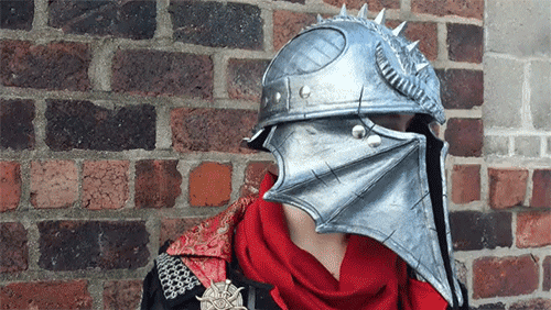

Rub n’ buff gave me the metallic look I wanted, but you can also use spray paint or aidbrushing to color it. Dry brushing black in grooves and corners gives is a weathered look. Some metal rivets go on the wigs and you’re done!
