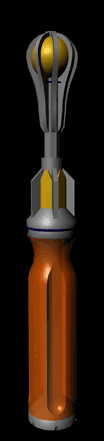

I've been lurking the RPF for awhile now; this contest got me to finally become a member. Design contests are always so cool!
Anyway, like a few of the others, I took inspiration from a good ol' trusty normal screwdriver with my design. That coupled with a mechanism idea I had.
• The diameter of the grip is 25 mm
• The diameter of the brass sphere is 20 mm
• The diameter of the cylinder that the fins and sliders are around is 11 mm
• The main octagonal shaft is 7.5 mm thick (side to side, not point to point).
A lot of why I like this design is because of its opening and closing movement, so I threw together a really rough animation so that you can get a sense of how the thing moves. The looping gif is in the spoiler tag below.
While the movement looks like it would call for intricate mechanics, it doesn't. The arms are simply hinged at the top, and there is a blue elastic band that pulls them all toward the center. When you extend the tip, the arms are pulled up and follow the curve of the sphere, which splays them out.
As far as materials go, I'm looking at an anodized aluminum look to the silver metal, brushed brass for the yellow metal, and an amber transparent resin/plastic for the grip. The other blue bit on there would just be 2 or 3 more elastic bands wrapped around that part.

Exactly the type of member we're looking for! Welcome to the forum! I love the open/close mechanic.
