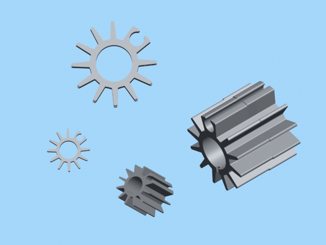

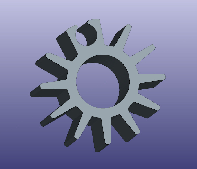

If you could use double sized Heat Sinks for the engines Let me know. I have highly accurate 1/12 scale 3D file made for 3D printing
A grew a pair for Stu, a few years back for his 1/12 Y-wing.
I originally made them back in 2008 for my 1/12 X-wing project.
This was before so much was made available from the publicly shared Y-Stuff
Thank you, Michael! That's a very nice offer, however I plan to make my own heat sinks without the 'circular anomaly' at the edge and make them symmetrical-bladed fans.

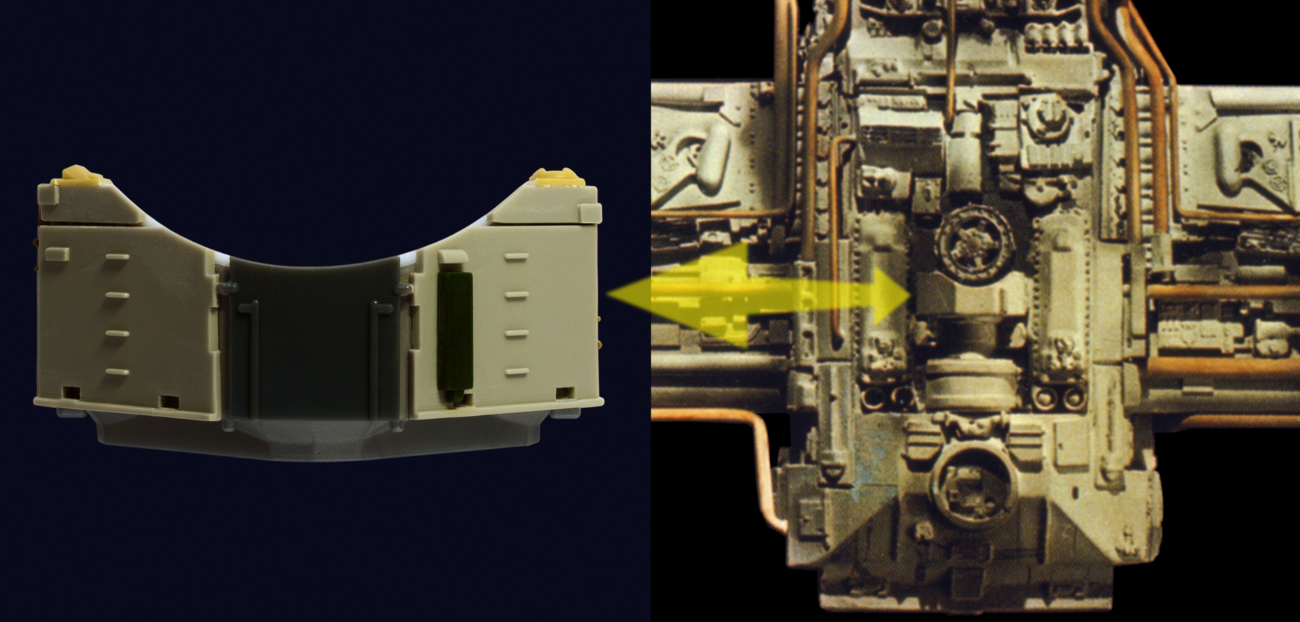

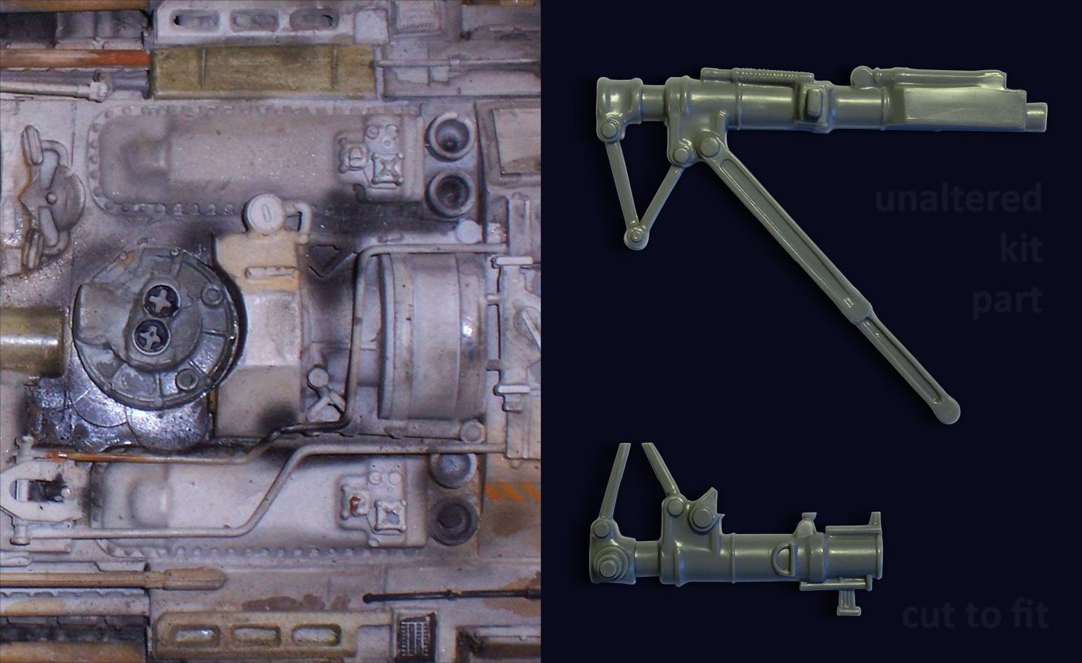

Finished the Lunar Excursion Module descent stage with some added extra detailing:

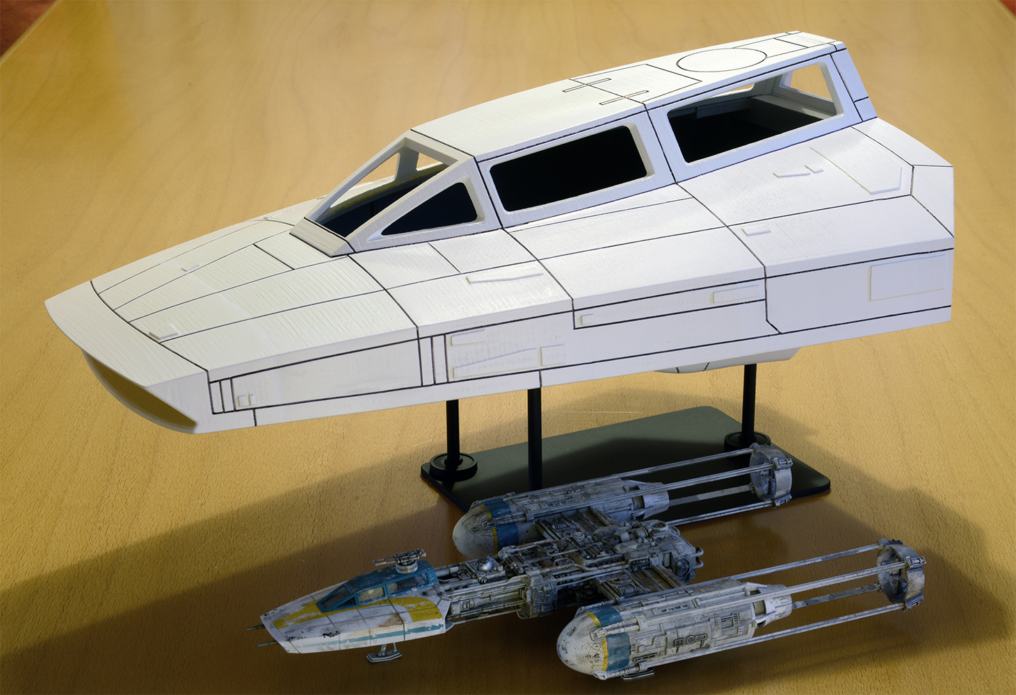

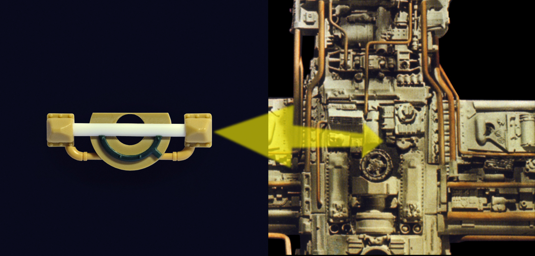

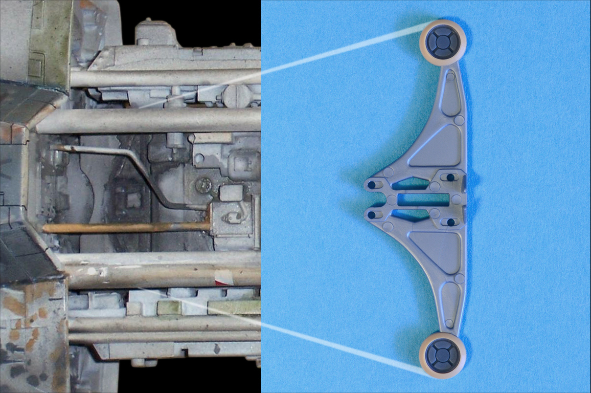

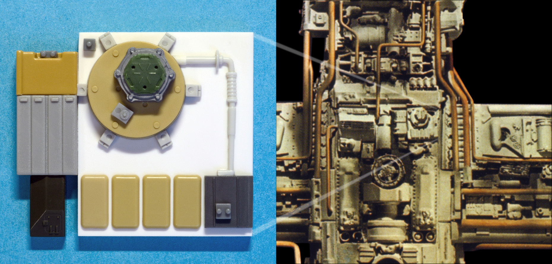

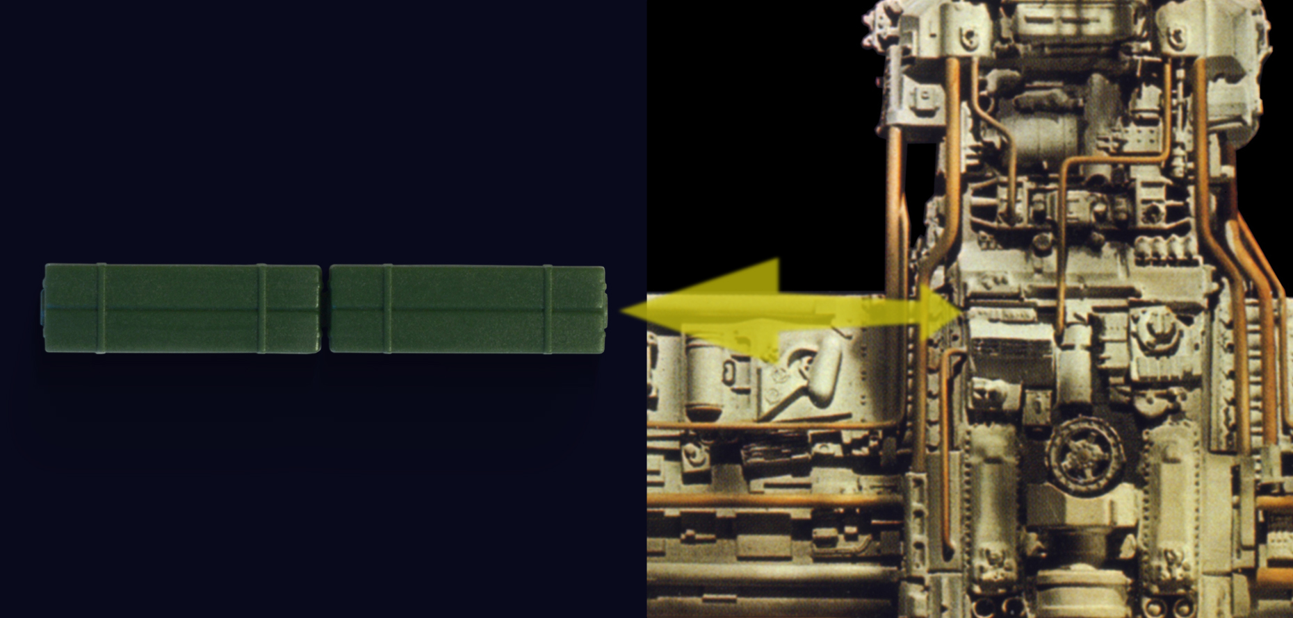

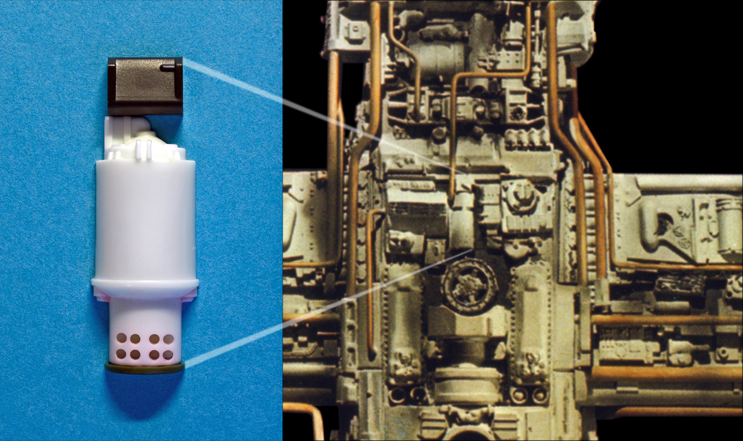

Over the past year have gotten some interesting comments, and I think what is a little bewildering to a few modelers out there is why I started this way. Never had any doubt of being able to build the frame, hull or forward fuselage. I sat on the plexiglas egg shapes for a long time, thinking 'this could either become a large Y-Wing or could use them for engine bells someday".
What I wasn't sure of was whether there were enough good parts in the stash in the right size and scale to do the detailing on a large Y-Wing. That is why I started with the details first, wanted to find out if the project was doable.
Most studio scale builds of Y-Wings tend to start with the interior frame and hull first. Once the hull is complete (or nearly complete) modelers tend to start working on the detail parts, some still missing some donor kits or parts and gradually getting there as the parts come in.
So maybe it seems this build started backwards, but wanted to tackle the uncertain things first. If it had turned out that detailing was a problem, I would have aborted and done something else. Fortunately, enough good detail was there. :)
Update: the details surrounding the Tiger wheel/top model mount are done, and decided to ditch Gold 2's ship gun turrets for Gold leader's landing gear parts. Like those better.
_DSC1800 comparison.jpg _DSC1801 comparison.jpg _DSC1806 comparison.jpg _DSC1805 comparison.jpg
Is that an AT-AT neck I see there? Always love seeing the details you make. Now hurry up!
Thanks Fett_Ish! Yes, you're the first to recognize it. Will be tipping my hat to several Star Wars vehicles hidden in the detailing, so there's more of that to come in the future.

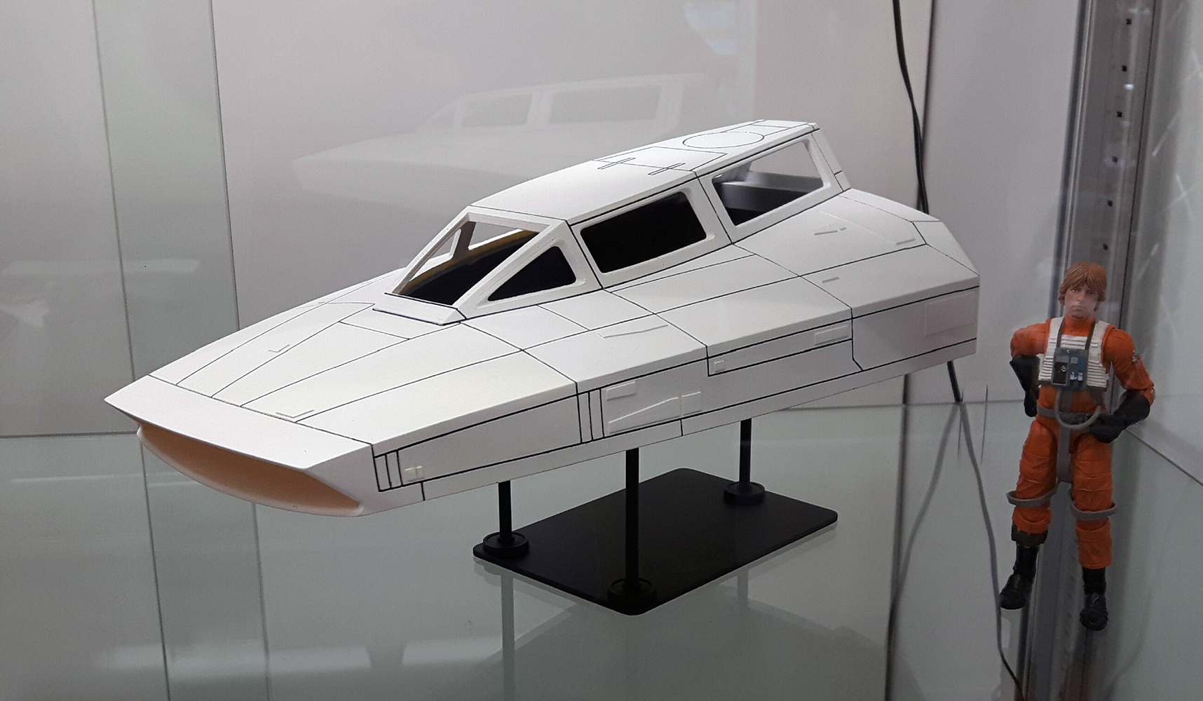

Looking very good. Love that cockpit, and seeing it, did you think about a pilot yet?

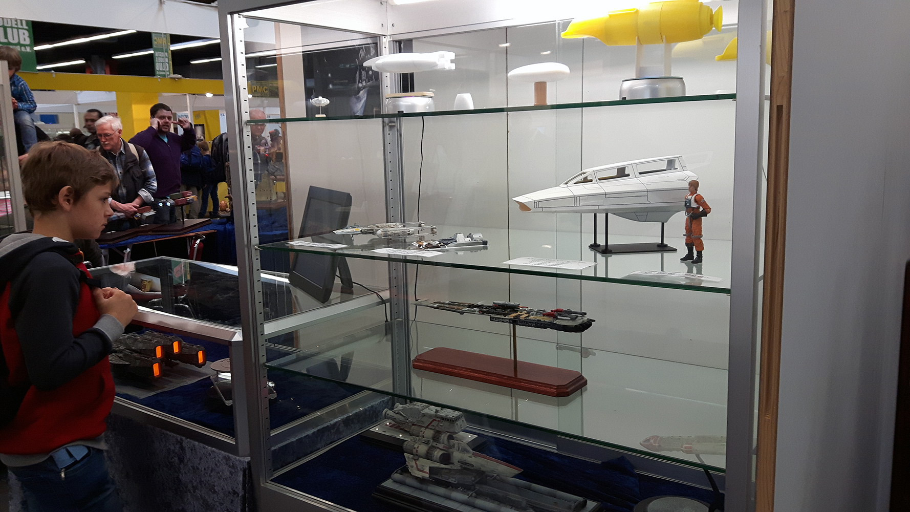

Thank you, Joberg! Will try my hand at modeling my own rebel pilot, of great help to do that is a black series Luke Skywalker in rebel pilot outfit. Here are two pictures from two weeks ago with the figure standing beside the forward fuselage, when the study model was first unveiled at the Intermodellbau 2017 in Dortmund, Germany. The Intermodellbau is the World's largest model fair and the Y-Wing print-out received a lot of attention. I think the figure really helped to give visitor's an idea of the scale.
Glues Brothers stand side Intermodellbau 2017.jpg Glues Brothers stand Intermodellbau 2017 close-up.jpg
It's almost big enough that you could fit inside.
I wonder if there will be printers someday that can print these at 1 to 1 scale, wouldn't that be neat? But where I would put it? I think the aircraft industries have big ones, parts of large airliners are printed these days.
Oh well, we can always dream. :)
