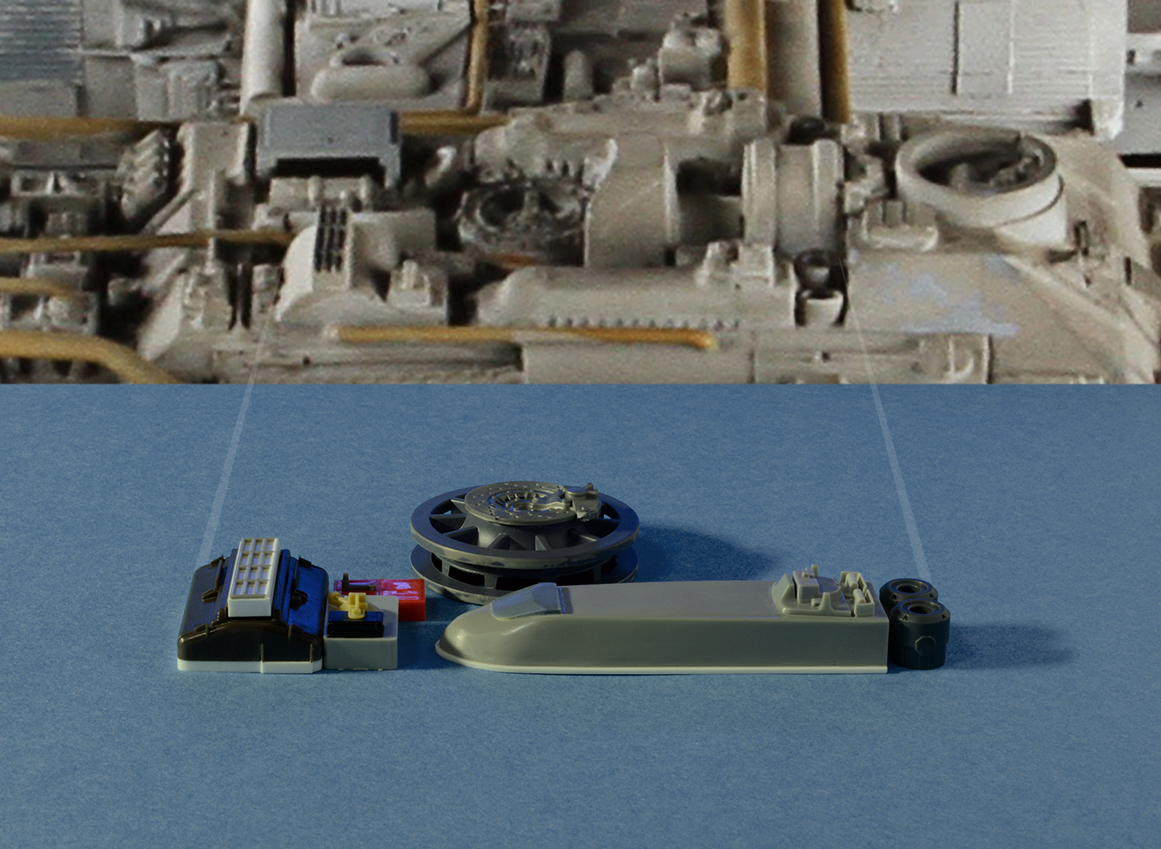

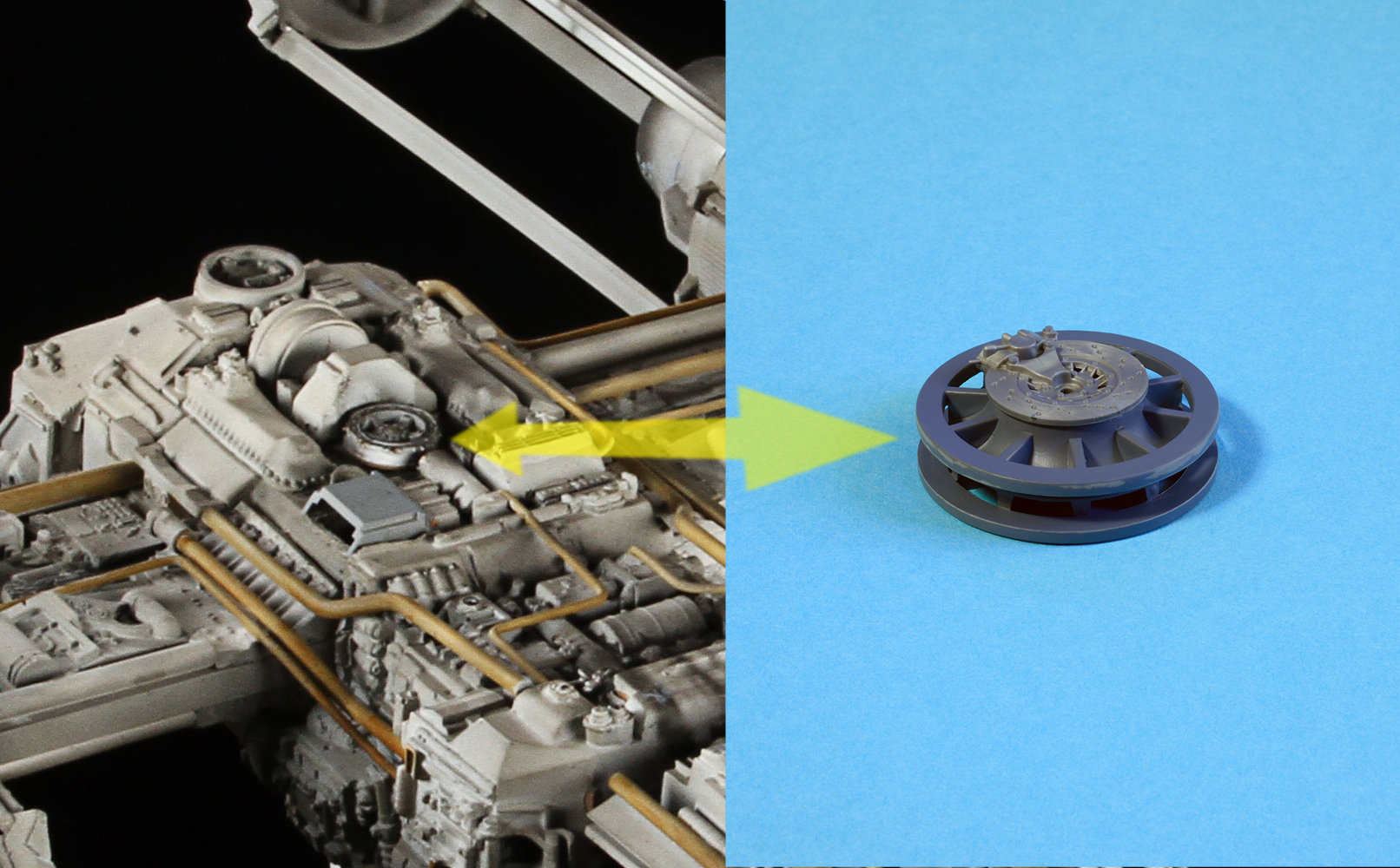

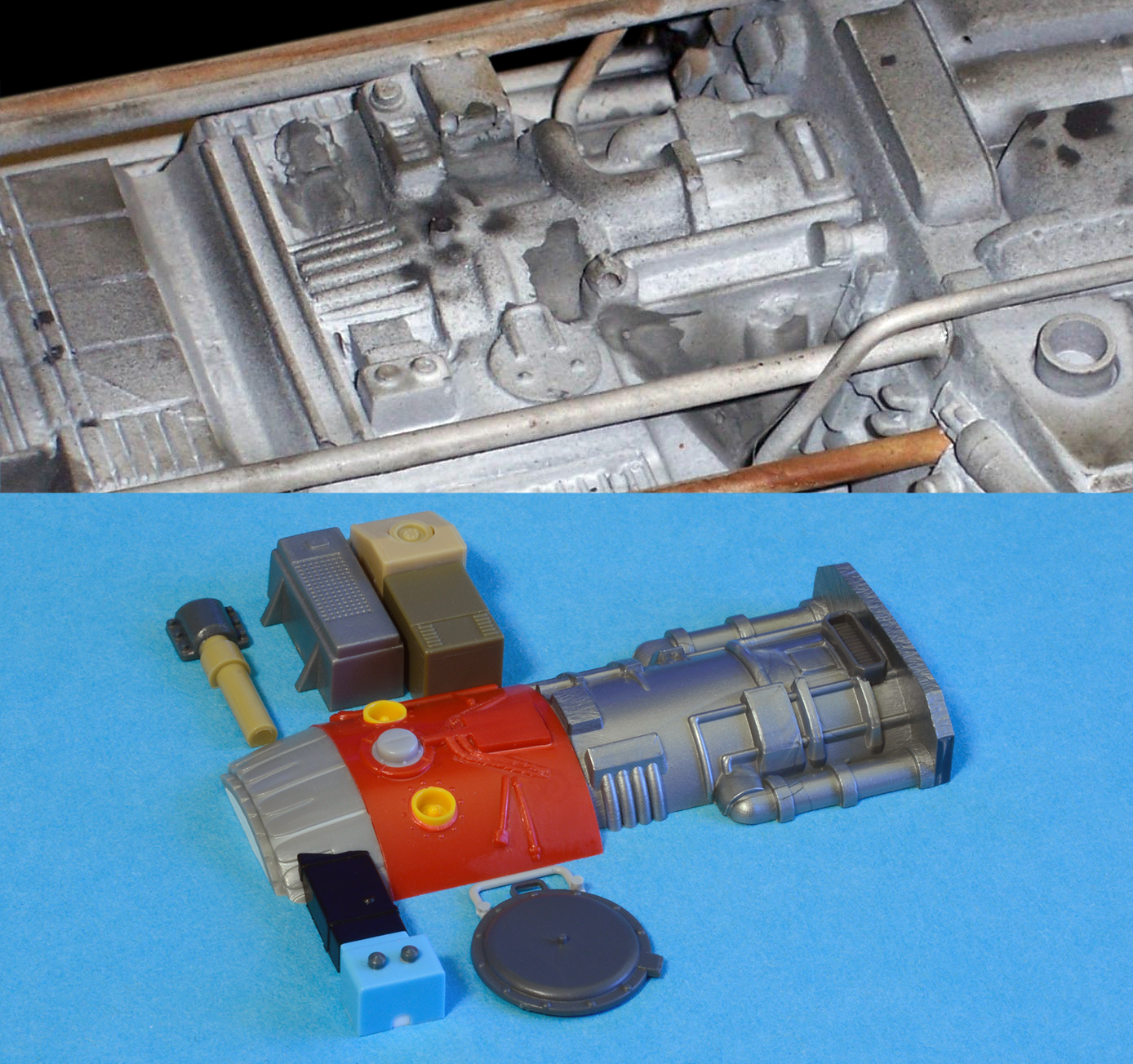

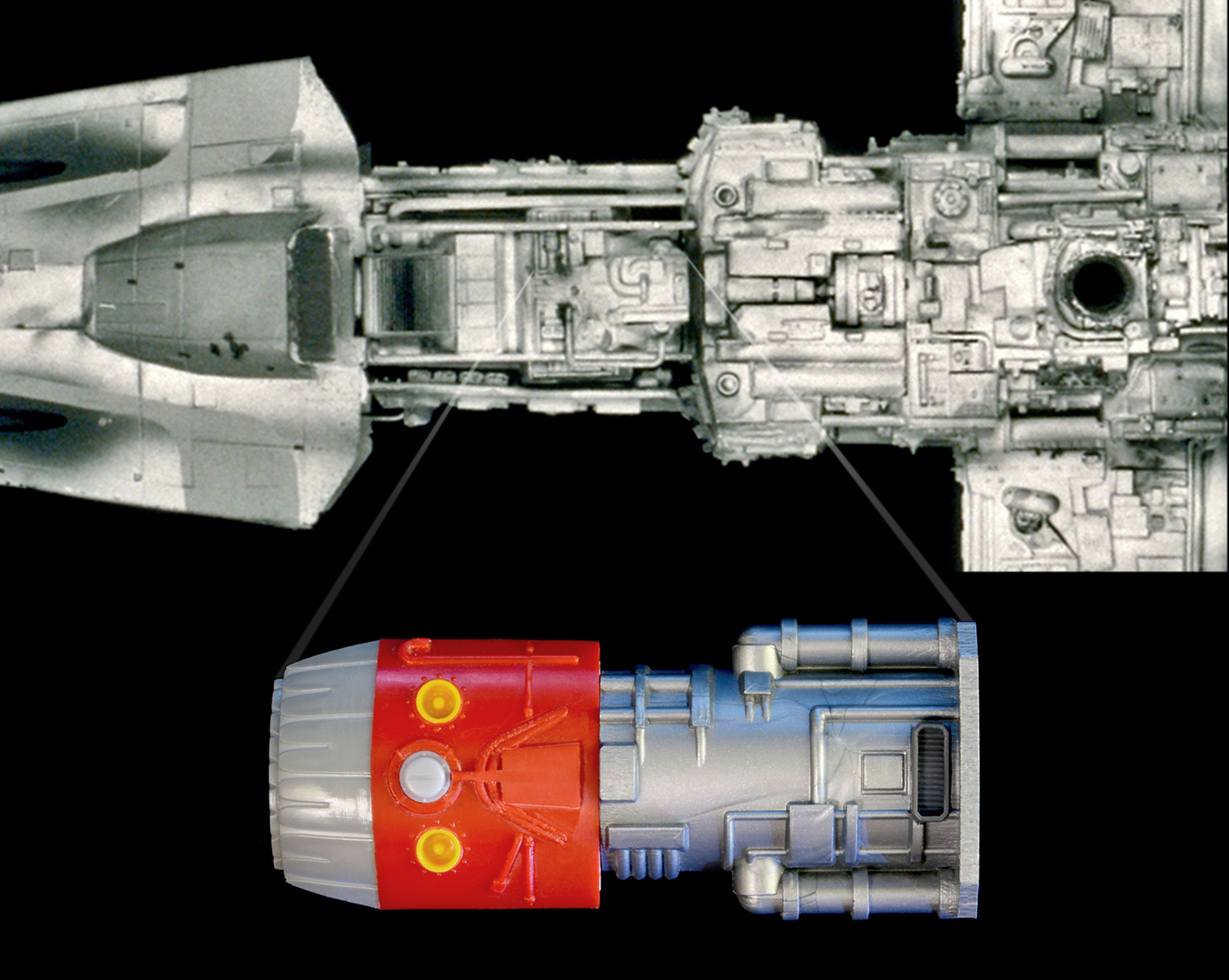

Thought I'd create something that looked just a little less like a tiger sprocket tank wheel and went with a mix of Gold 2's and Gold Leader's top mount cover:

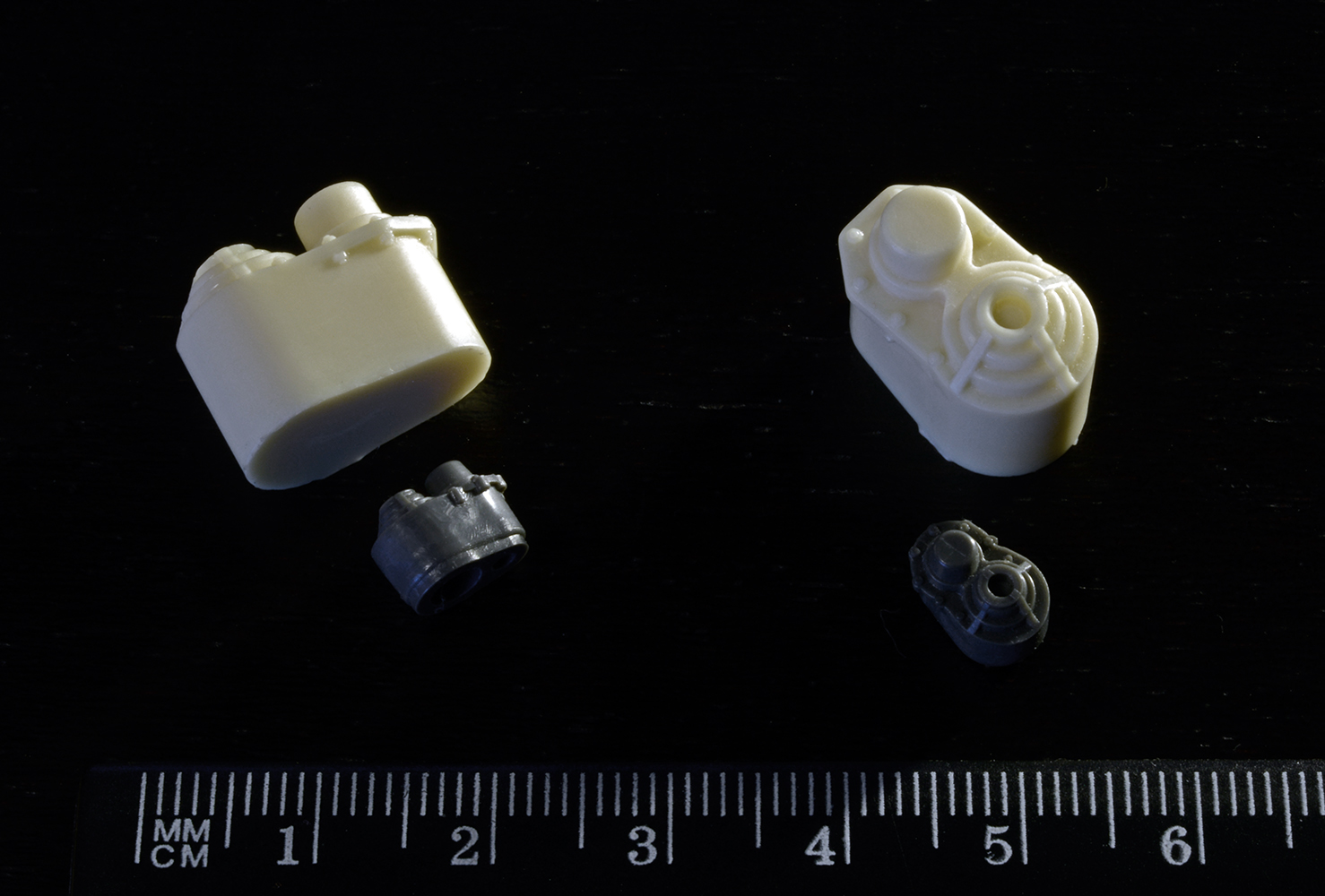

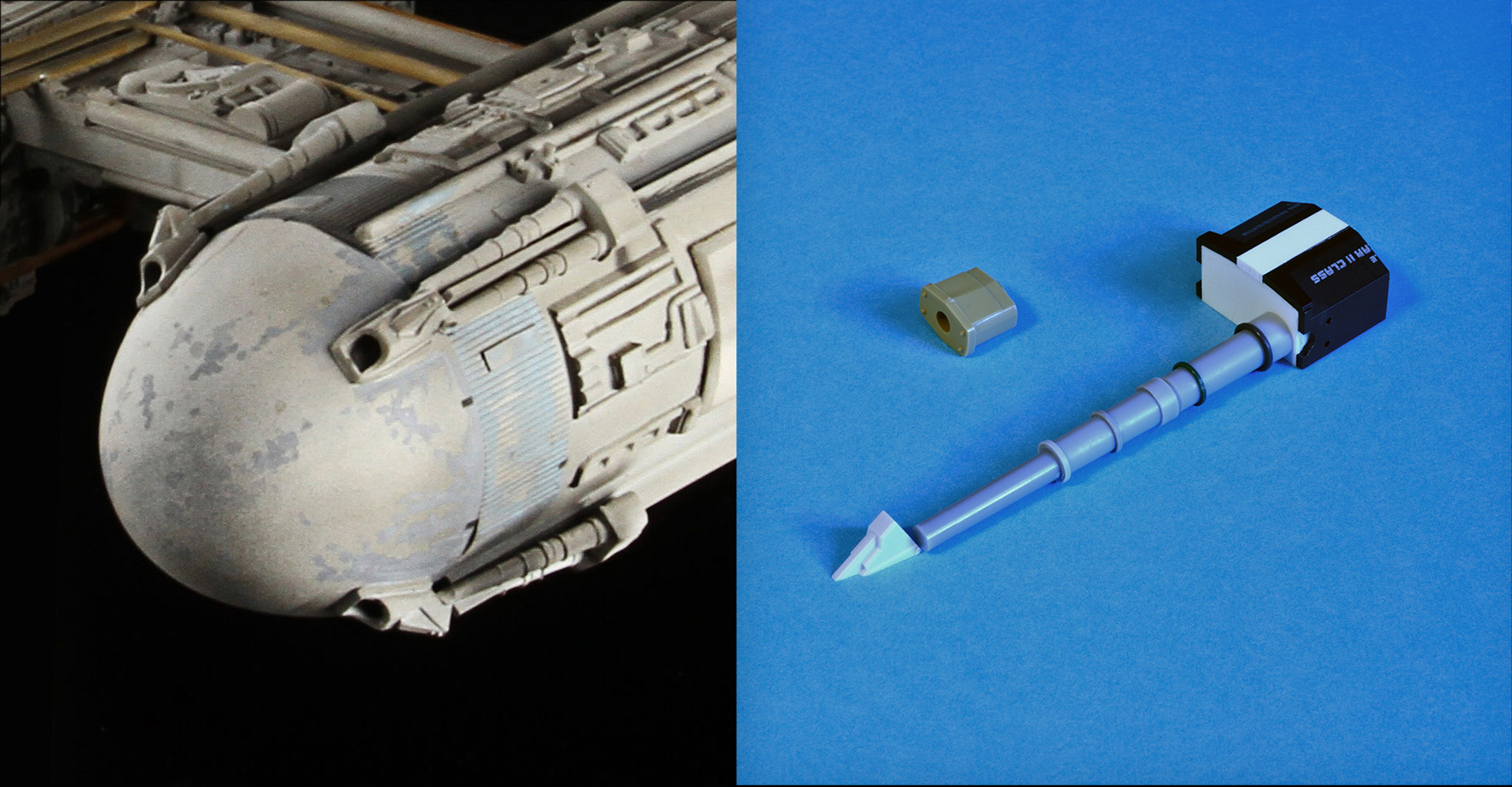

Some progress:

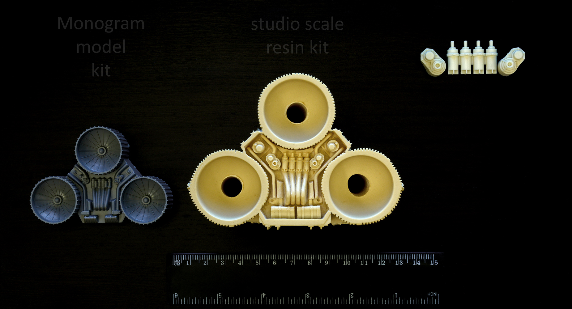

And another studio scale parts to scratchbuild/resin parts comparison:

Would definitely recommend buying large-scale kits and stocking up for such a project, have found that detailing in this scale isn't easy. The parts are larger than usual and fewer to choose from when compared to 1/24th scale, for example. I have a lot of parts in my stash and am still having trouble finding some details.

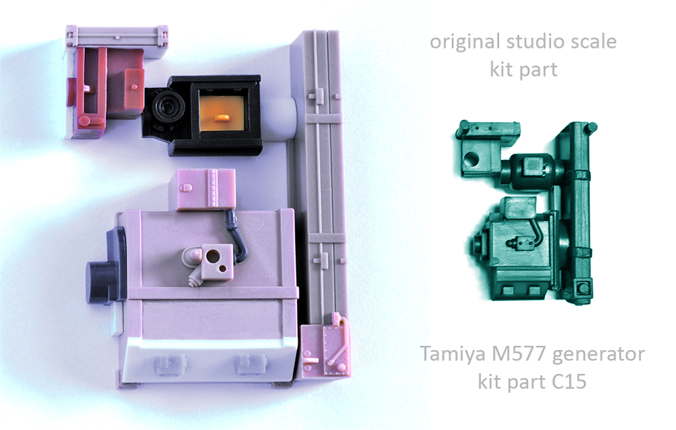

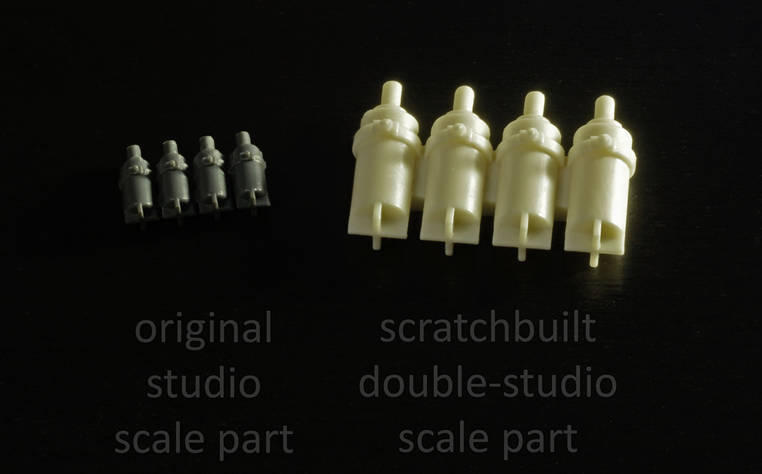

Update: created four parts which imitate the M577 generator:
