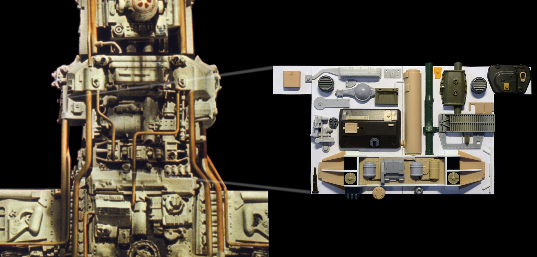

Update: didn't want to recreate the 25-pounder field gun front shield, have used that one too often on kitbashes in the past and find the part too recognizable for my taste. Decided to free-style it.
(To be fair, the original details on the right side are missing three small parts, but the comparison gives a general idea.)
Thank you, joberg! :)

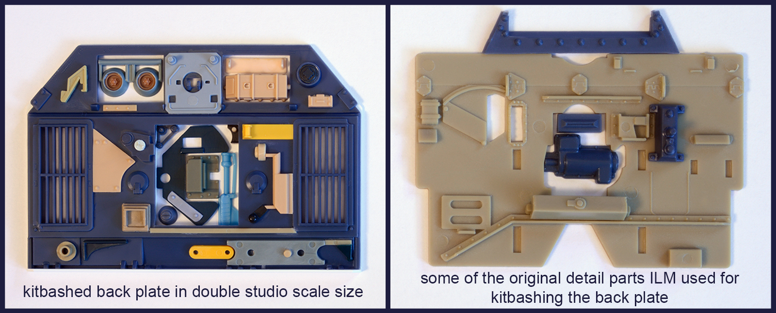

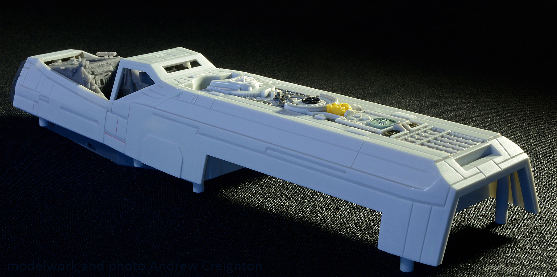

Still studying the original Y-Wings and looking at the forward fuselage's back plate - the detailing beneath the rear window area.
In the top right corner you can see the electrical socket near the top model mount, it's interesting to note that Gold Leader and Gold 2 have lost their access covers for plugging up the hole.

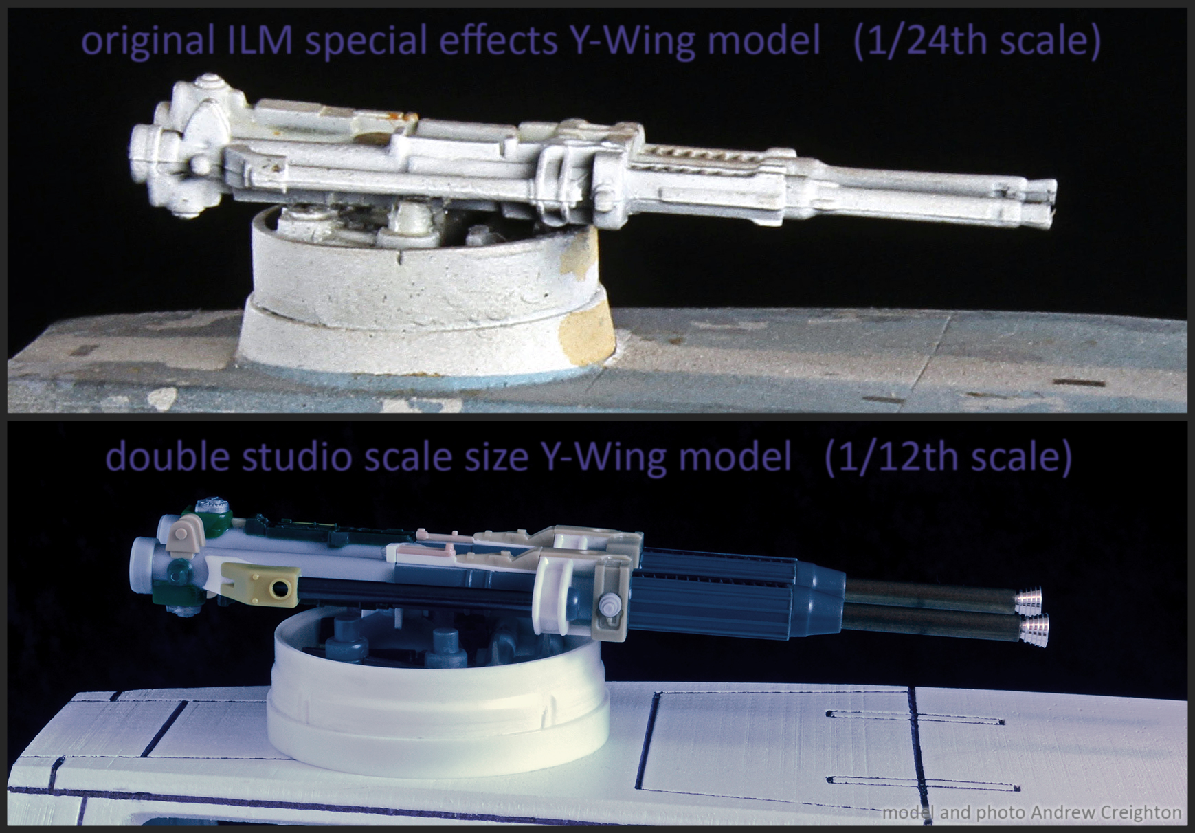

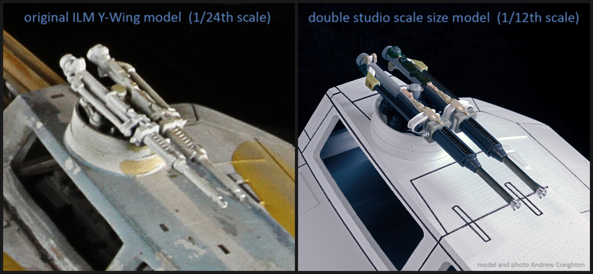

The top canopy guns for my model are built, quite a bit of work there:
Kick - Ass guns.
Thank you, Taz, coming from a fellow large Y-Wing modelbuilder that is great praise! :)
A front angle view picture of the Y-Wing's guns:
The guns were just two parts for ILM. (Two Airfix Me 109 machine guns in 1/24th scale) For me, it was 99 seperate parts. (These came from armor, model railroad, aircraft, truck, anime & ship kits, plus plastic strips, plastic tubes, brass tubes and stainless steel rods.)
93 of these parts needed to be made to fit, only six were taken directly from a sprue and left unmodified.
(All of this does not include the round base underneath the guns)
Thank you, joberg and bigpetr! :thumbsup

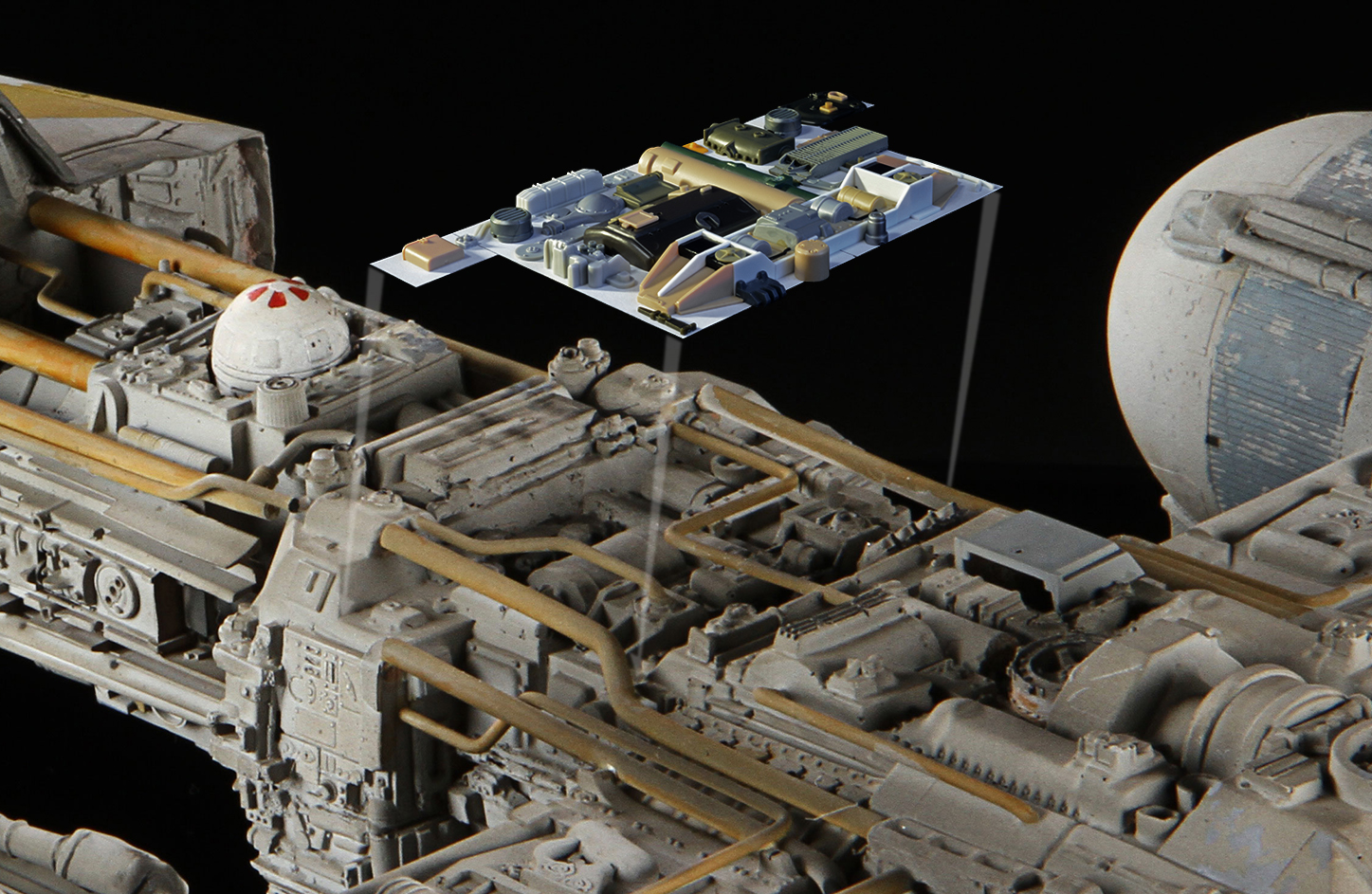

The topside details on my Y are 98% done. Here is the approximate recreation of another recognizable piece, again with a little extra detail:
It'll be on to side & bottom details soon.
It's gonna be real nice when done...every time you're showing a new "set of greeblies" I paint them in grey in my mind and it sure looks very good!

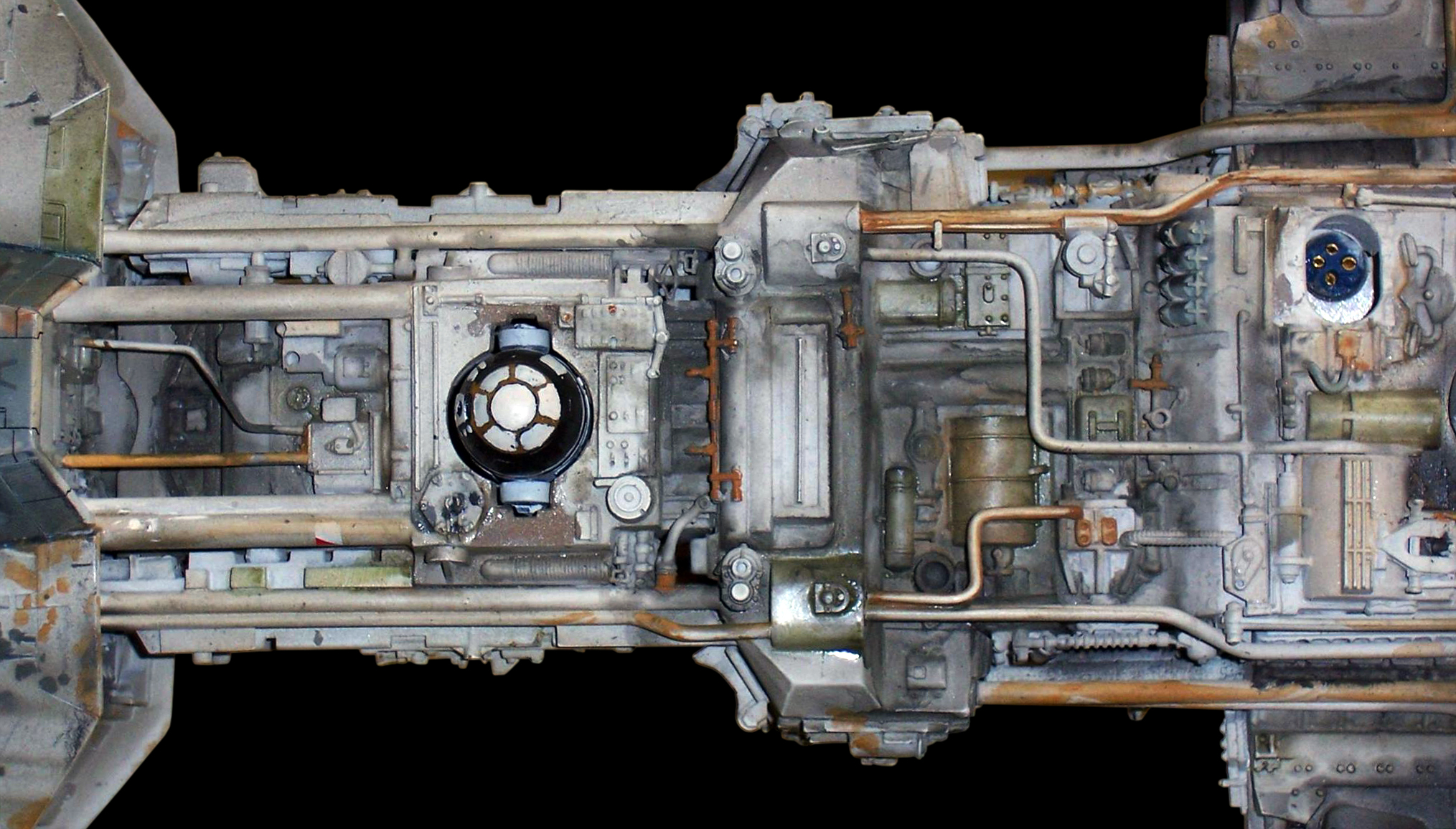

Above view of the top central area:
This is a great build! I haven’t started my 1/24 scale but now I what to do a 1/12
Thank you, wmneill! Yes, you should go for it. DaveG's generously shared 3D files make it much easier now and the detailing is a fun challenge that makes each one unique. :thumbsup

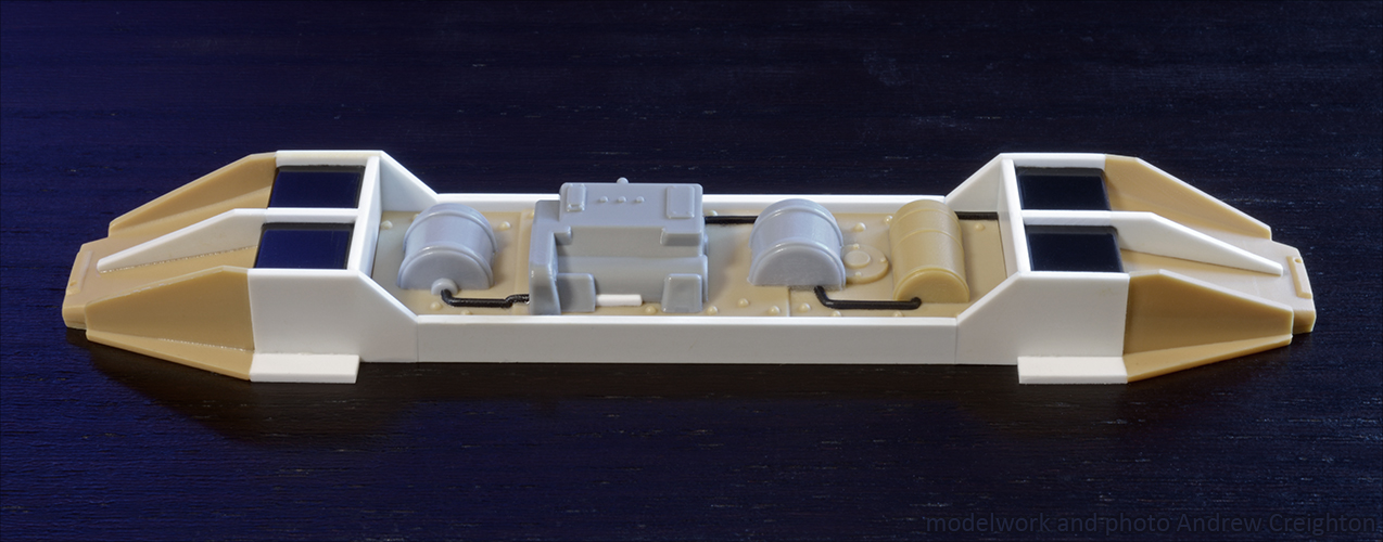

Details for the underside of the Y-Wing are comely along nicely, about two-thirds done with that, Will be posting a pic soon.
