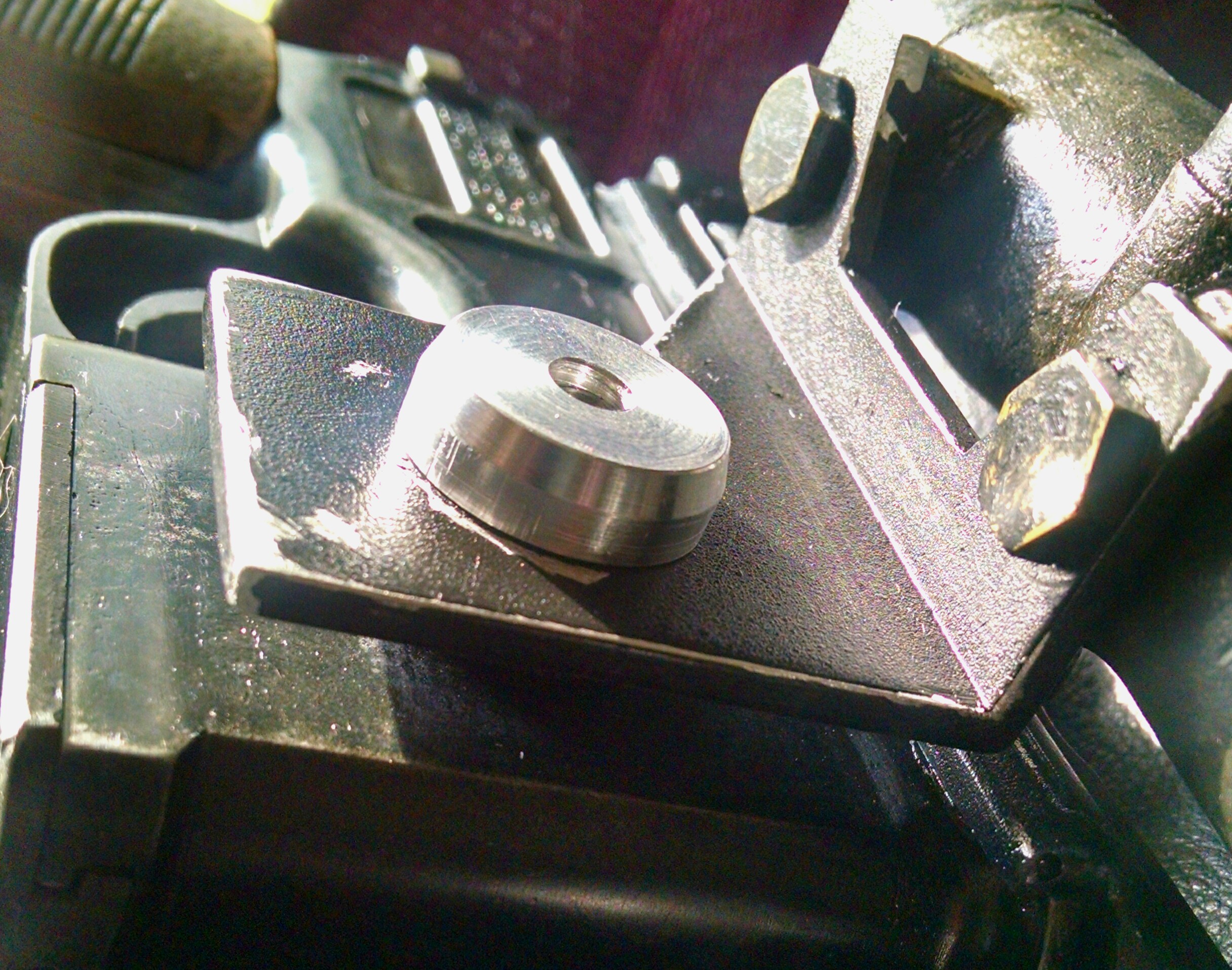

I eyeballed the whole thing. Could easily be too thick.
I think overall this mock up looks too thick BUT I do think the proportions look correct*.
Just needs to be scaled down vertically.
Thanks for all the hard work on this guys :)
*(to me).

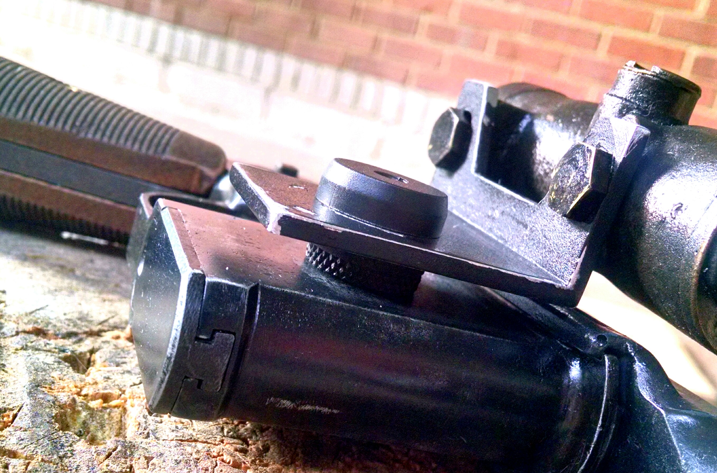

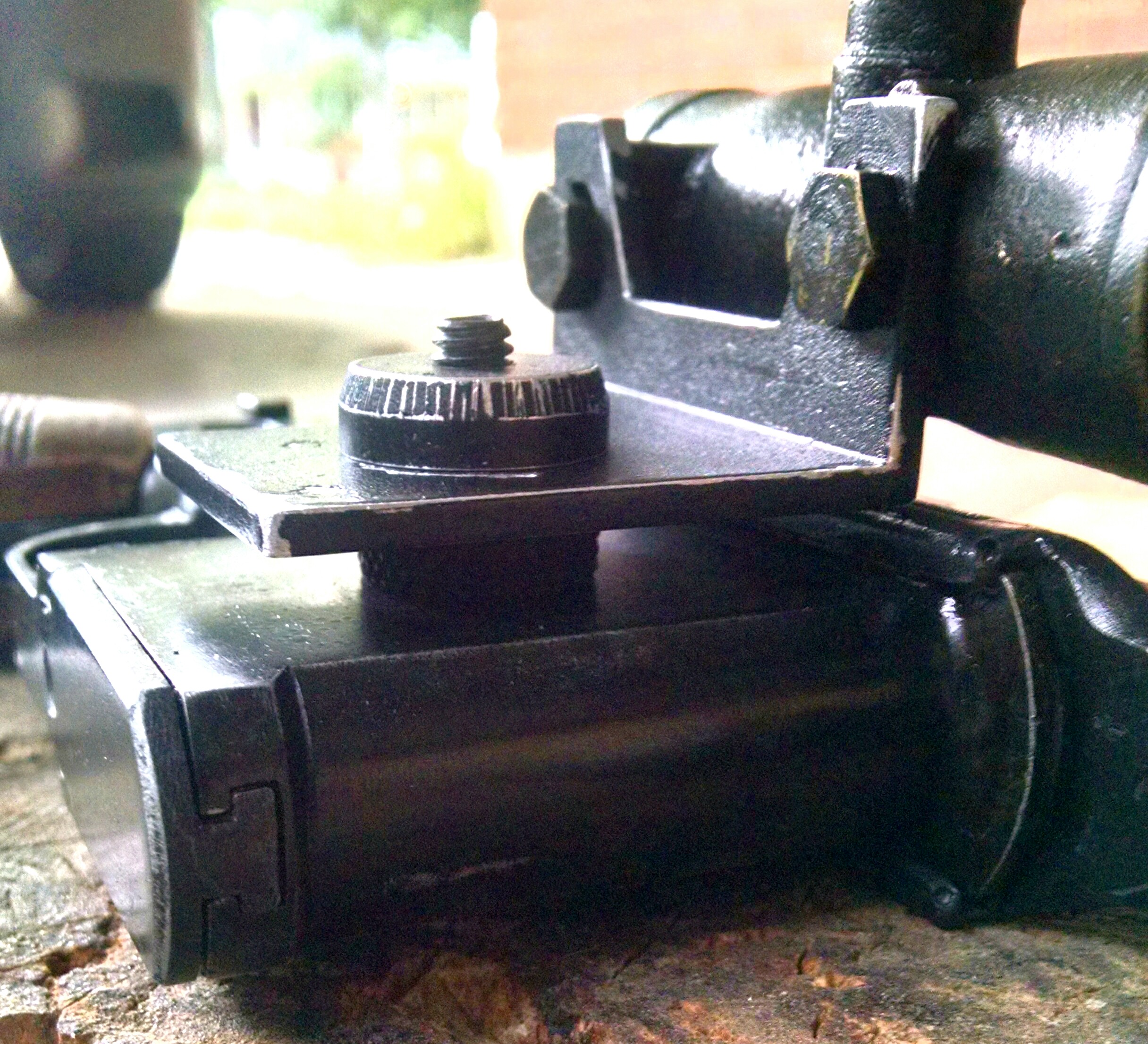

This may be a little closer.
That's .252", and the distribution is more like .150" and .102"
I agree. Looks too thick. But I do like everything else about it. Kinda hard to judge without the knurling, but better than just a diagram to visually compare!
If that is a 60 degree bevel that is only .002 off my current drawing and to me it still looks too thick so I am glad you took the time to do this.
I believe Scotts is .220 thick, and he went with a 50/50 split.
Maybe he can do one at that thickness with a .135 / .085 split

Was this post in reference to the Danns first attempt or second attempt?

Sorry about that. My comment about the thickness was in ref to the first pic.
I am torn now. It looks much better in the pic just posted above, but part of me still thinks it could be too thick. Interested to see what Scott thinks!
And thanks Dann for the update pic at the different angle! Helps give us a lot better idea to what we are comparing it to!
No problem. Happy to help!
Btw, I think my bevel is closer to 65, maybe even 70 degrees. Like I said, I really just eyeballed until I liked the look. It may not be correct, but it's looking real close.
Well, it is black in that photo, I sprayed it just before I took that. Must be the reflection of light.
But yeah, it needs some knurls. Thanks!
Looking at the photo comparison, now I feel like mine may be a hair too short!
After looking at all this - I believe that's as close as we're going to get with the ref provided. It looks A OK to me, I don't think we'll regret it.
Here it is one more time, with some pitiful scratched-on "knurls", and a little extra threaded rod protruding to better match the real thing.uploadfromtaptalk1442788109334.jpg

I'll reiterate here, what my email said. I don’t know about actual dimensions, but from the black n white still, it looks like the flat/knurled proportions are supposed to be 50/50. The middle sample from the photos you sent looks to have the best knurling as well.
