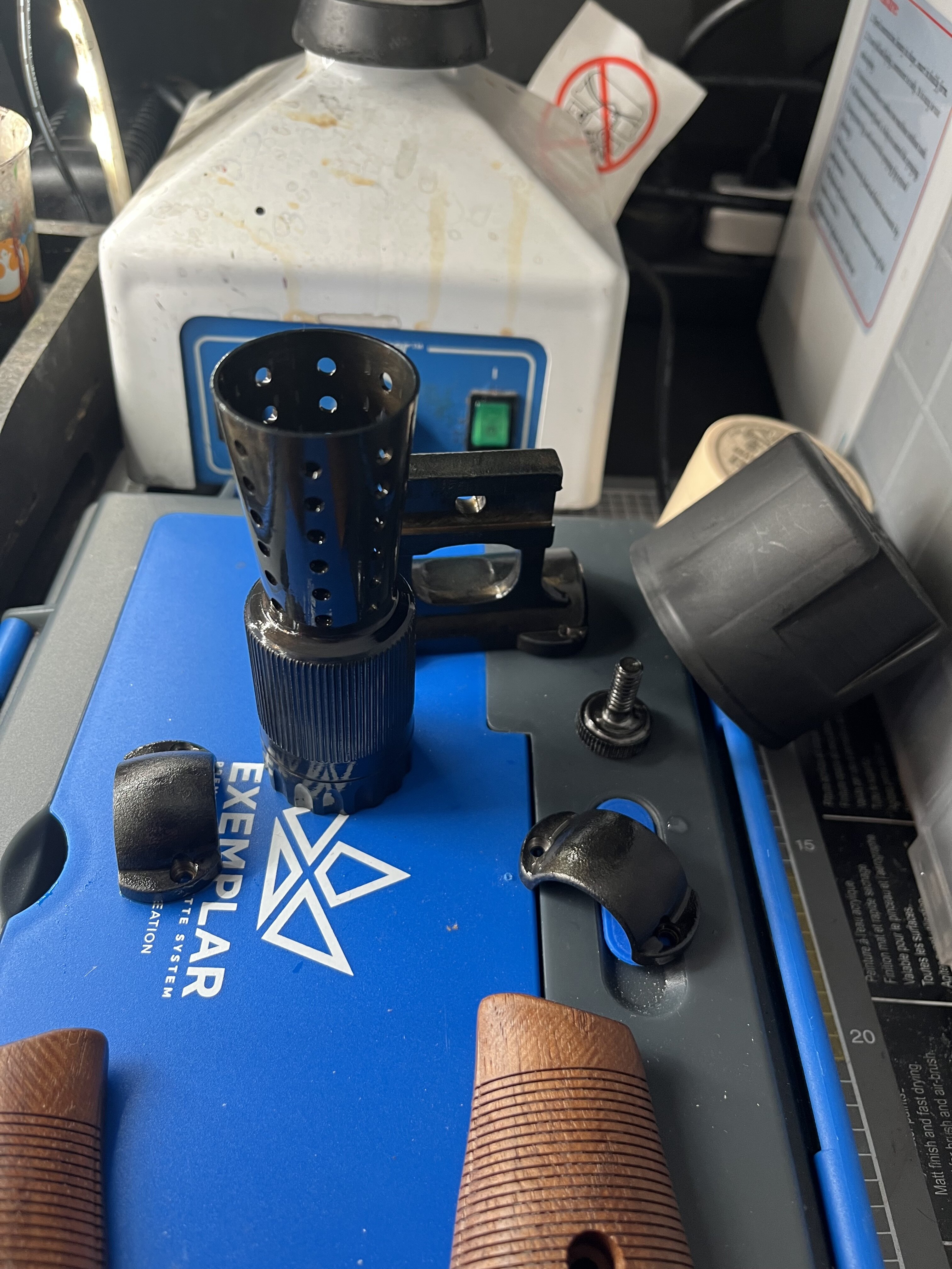

Wanted to see the affect of aluminium black on the Zamac metal Denix use, and I was quite please, looks kinda like worn steel which is nice, just a little less shiny and gives it some nice patina.

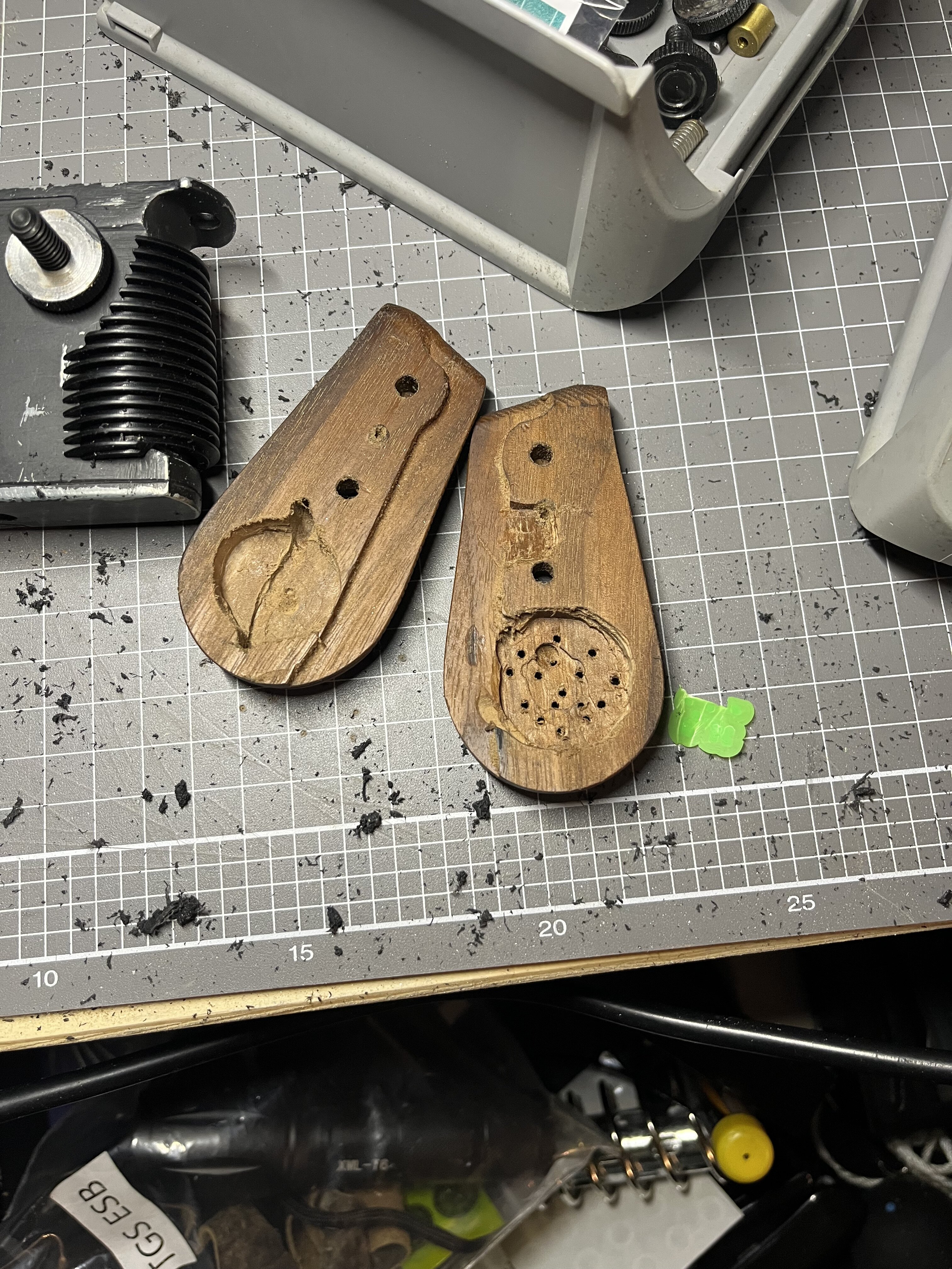

Dumb thing two was having my beautiful new walnut handles on the bench as I was grinding out the handle internal… so they got fine metal dust all over them. Not sure if I can salvage that, but we’ll see.
Dumb thing number three. Drilled holes in the handle for the speaker, and used a 1.5mm drill instead of .8, so the holes are pretty noticeable. It’s not the worst, and it’ll probably help with volume, but you know.
I forgot to take some progress photos, but otherwise I blued the steel parts (scope holder and flash hider) and painted the bull barrel and scope body mount thing, and also painted the mystery disc section. I also routed out the handles for the speaker, and drilled and tapped the charge port to be as discrete as possible. I’m fairly happy with how it’s going. I now just need to get an m5 hex head bolt for the flash hider and bull barrel which I’m waiting on, and wire all the electronics. Getting close!!

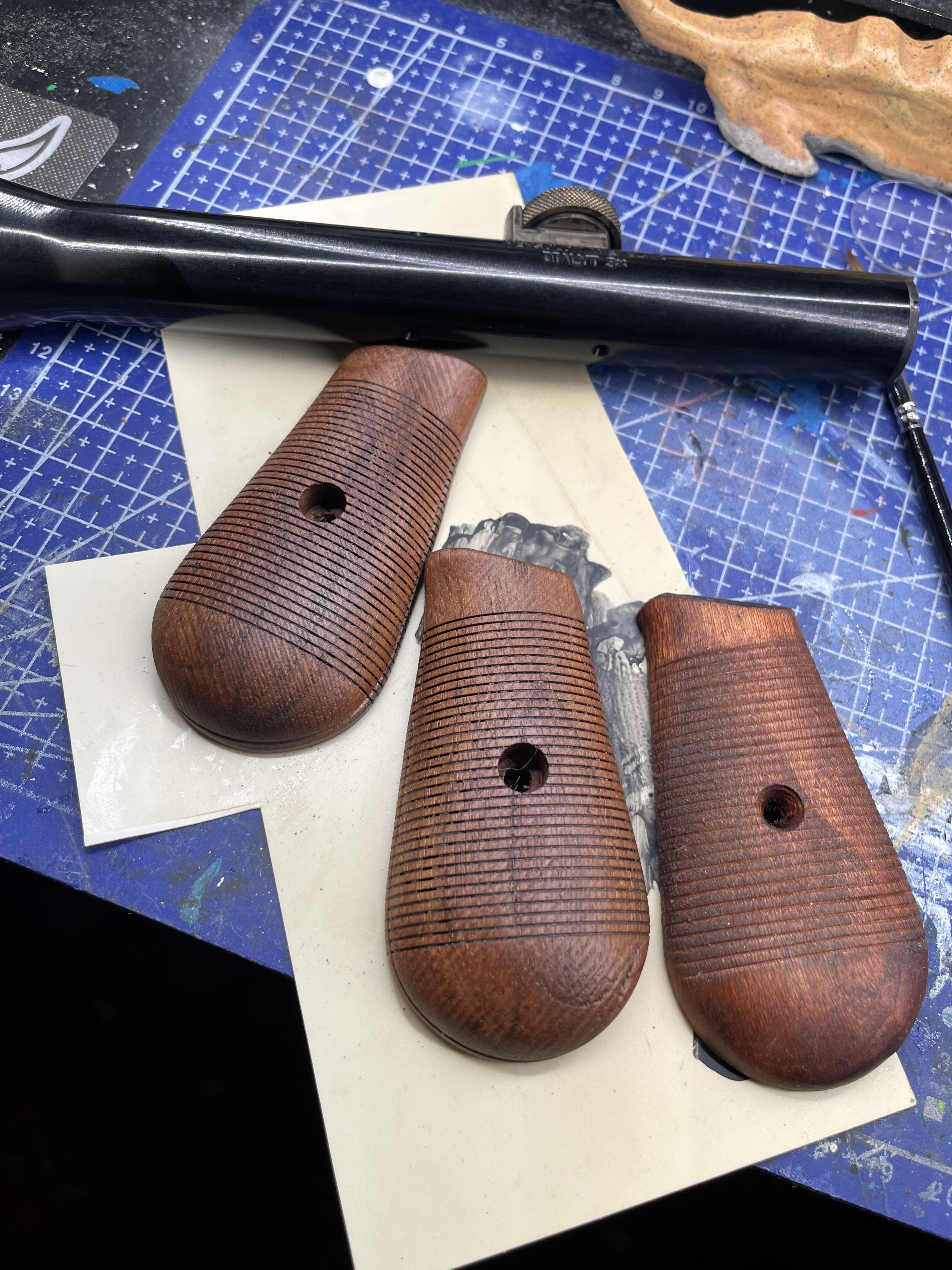

Oh, glad I got the BF grips, they feel MUCH better than the Denix. They’re much more bolbous.
