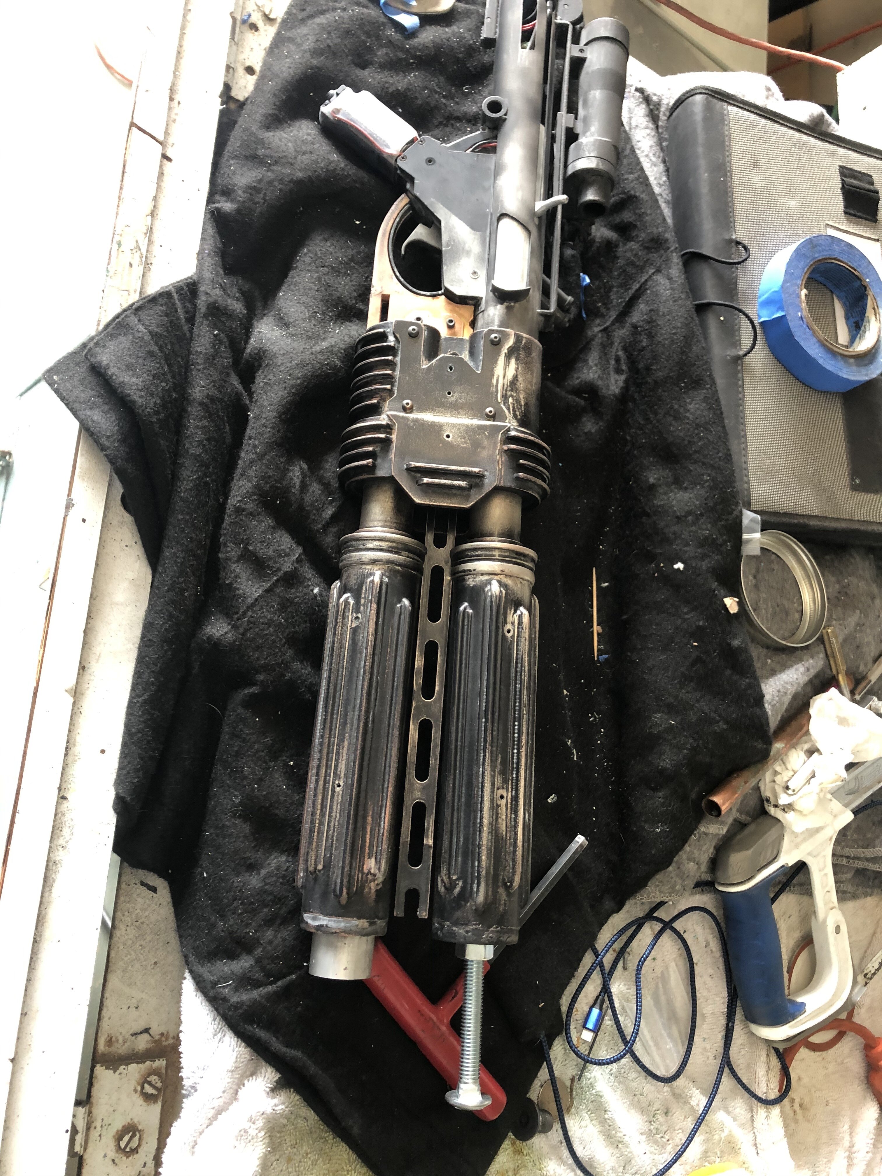

Making really good progress on my DLT20a
The front barrel assembly is pressure fitted to the stg44 denix. If you remove the top screw both barrels will detach from the main receiver with some persuasion from a rubber mallet. No cutting necessary, yet.
I then can detach the top barrel that will be reinserted and attached with the original screw. I needed to make a new offset adapter as the center point of the bottom barrel hole would not be center of the heat shield in its current position. The offset threads into the longer inner barrel which has od threads for attaching the barrel tip and locking the entire barrel assembly to the receiver.

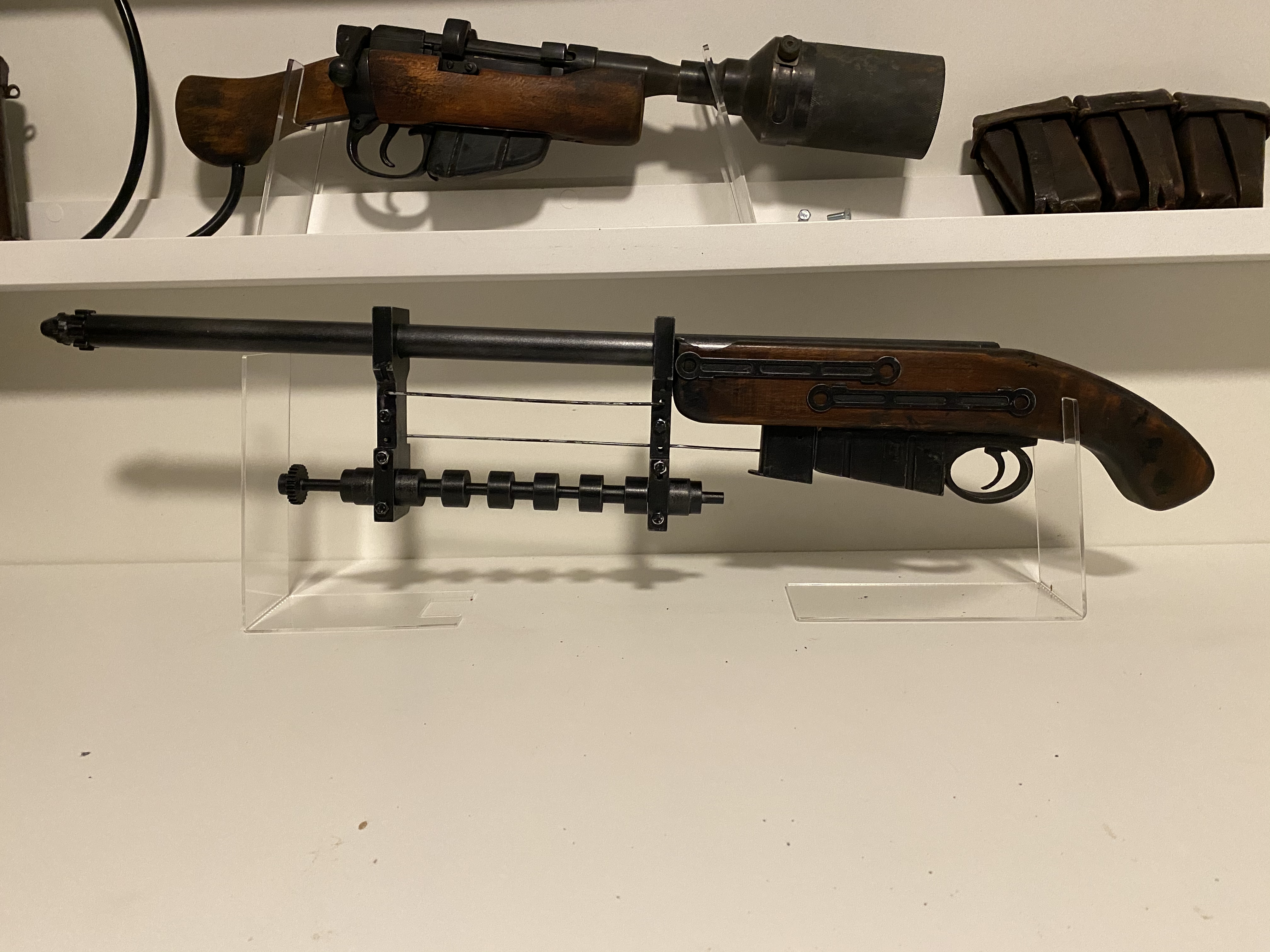

Its interesting to see how differently people see the Snare rifle from Zuckuss. My first attempt of clamps looked like yours. But I changed the design after having a closer look on some screenshots from the movie. It is so hard to tell if its right... most probably not.

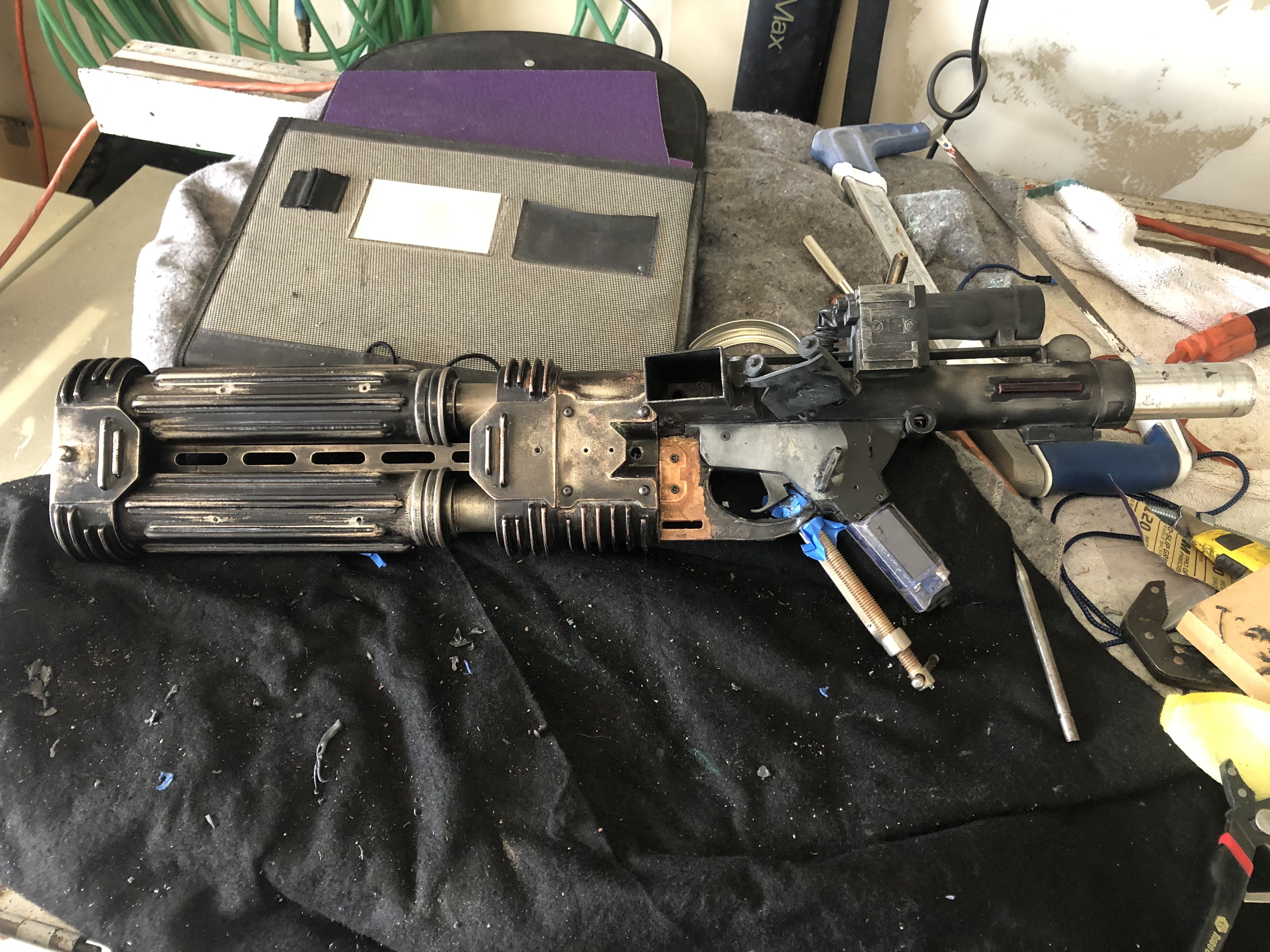

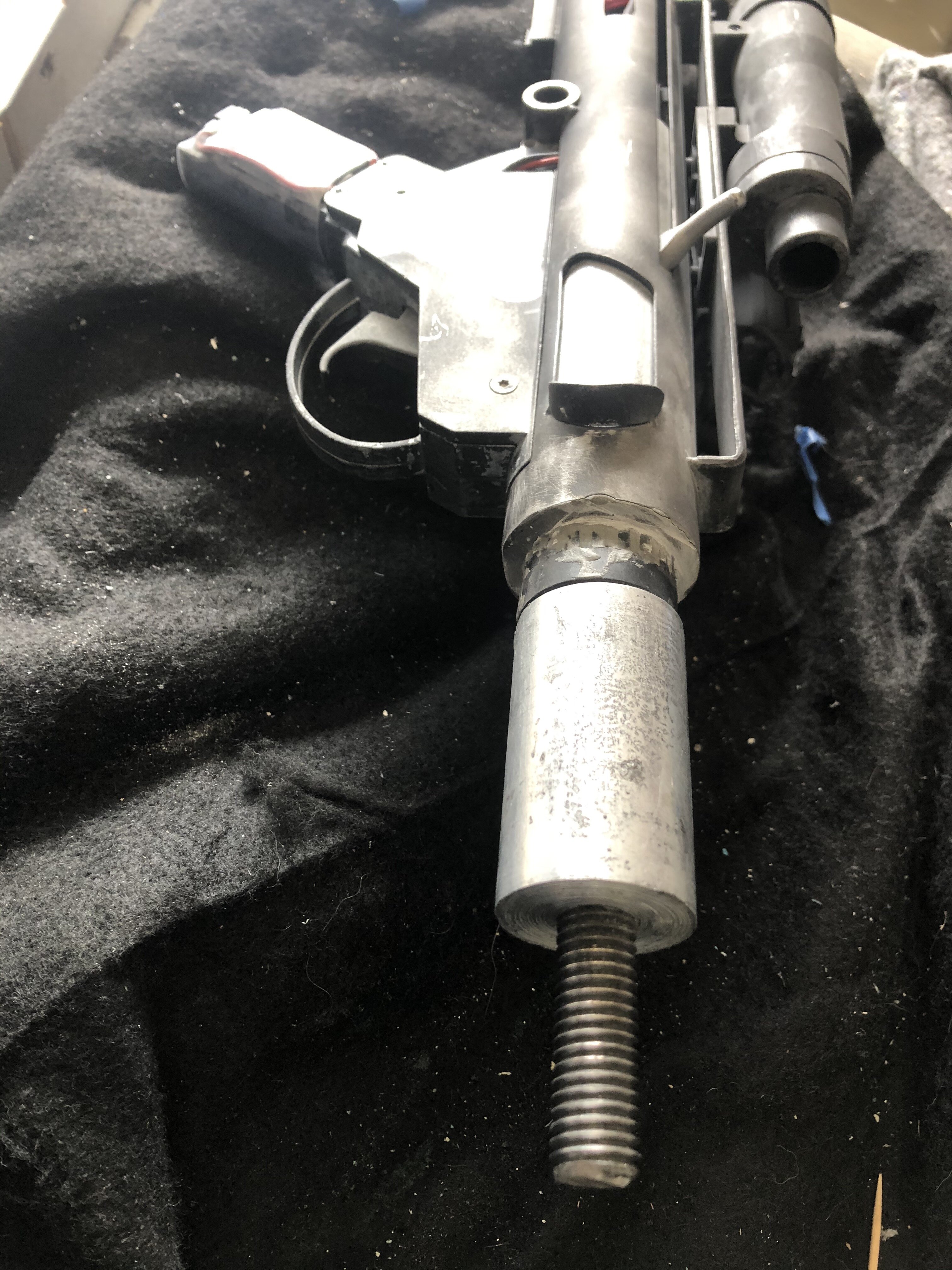

I have always wanted to tackle an E-22 Shoretrooper Rifle but as most of you know, I really want my builds to be all metal. I had to make some concessions but came up with a solution I am extremely happy with. (Electroplated / Metal Plated Parts).

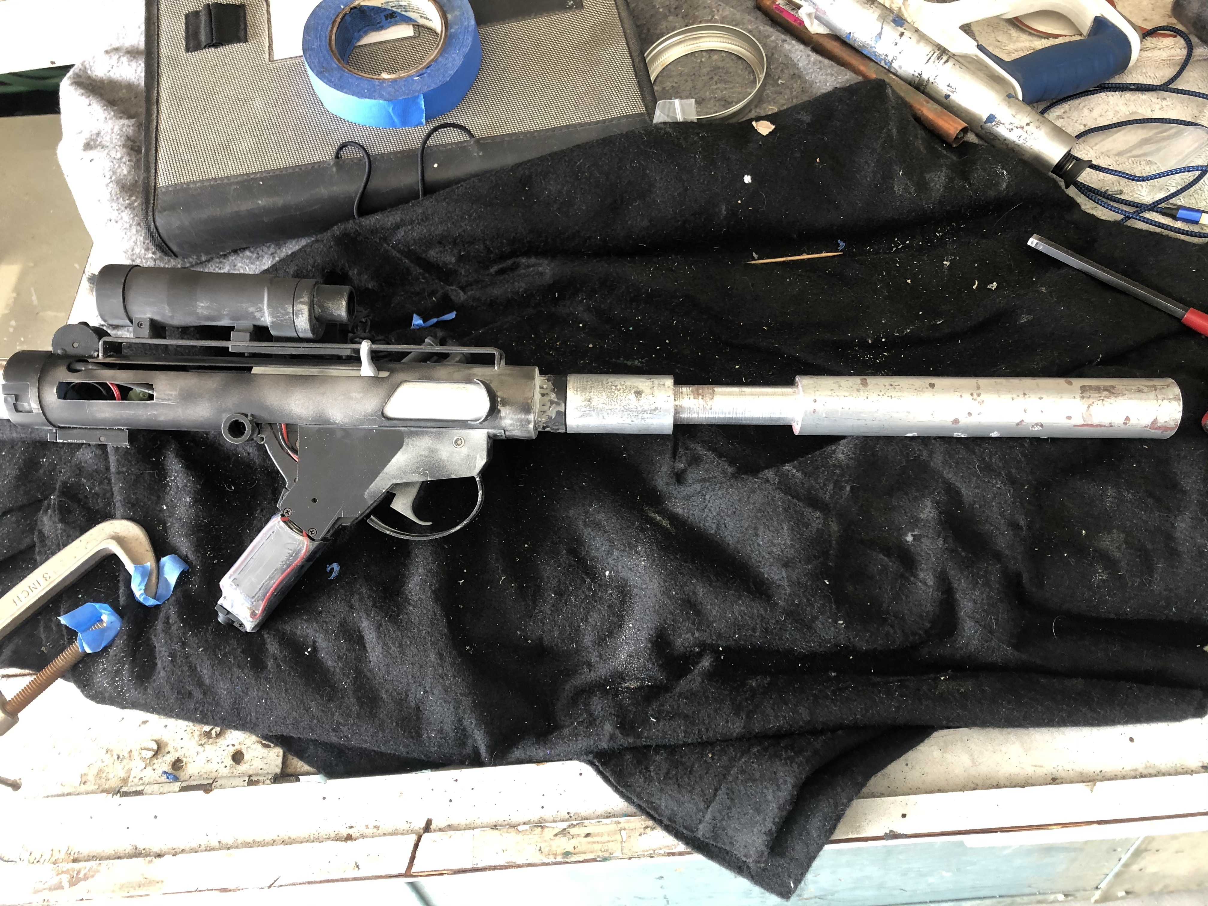

Started with an sterling airsoft to use as the main receiver. Modification needed to be done for the double barrel assembly. I cut the barrel off and tapped into the main receiver to thread a 5/8" all thread. It was a good start to the main structure of the blaster.
The frame for my E-22 was built in such a way which allowed me to slide the electroplated metal parts over the structure and secure them in place.

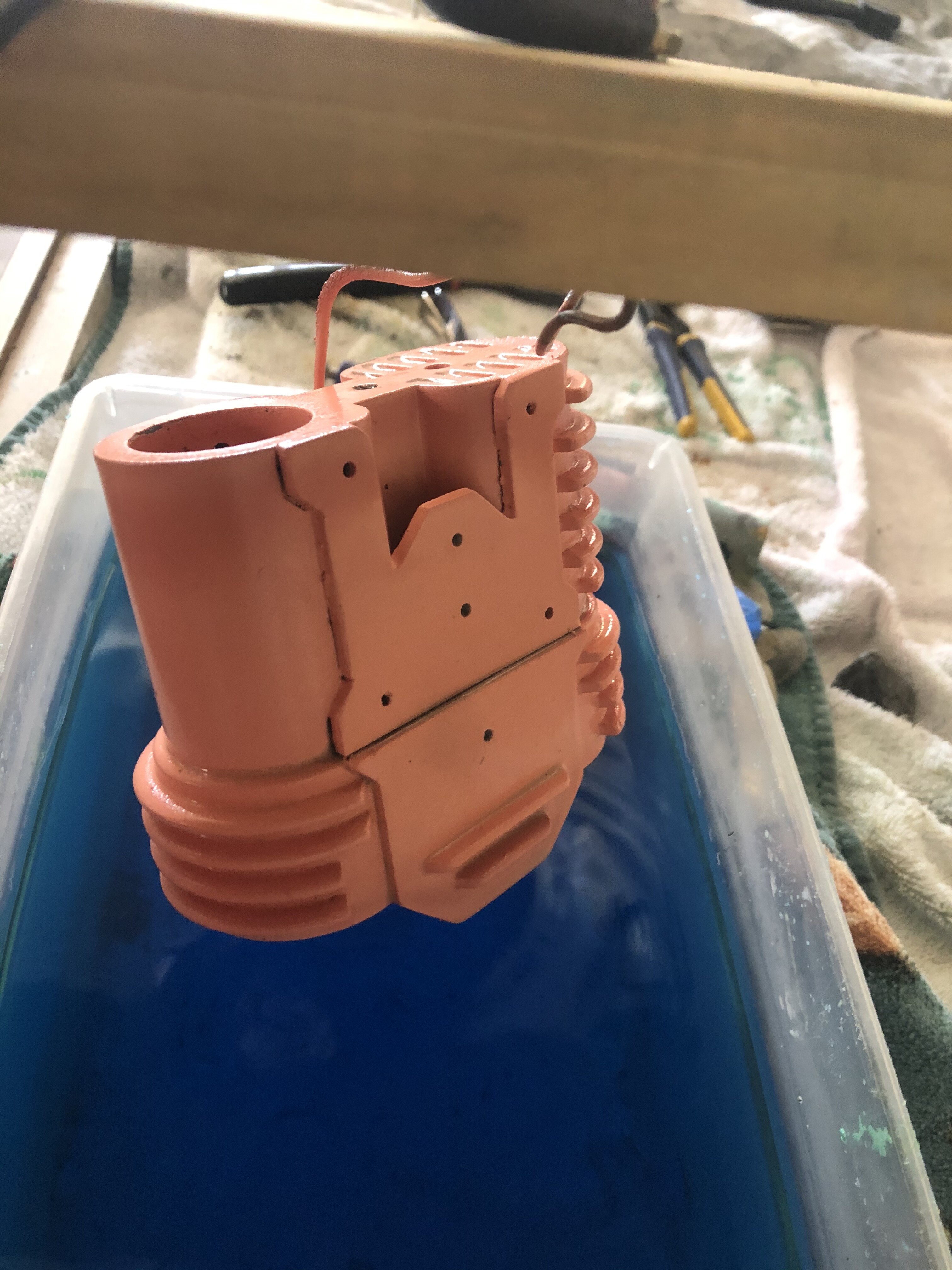

Once I had the frame, it was on to the electroplating process. I found a design of 3d printed parts that I feel scale correctly. Prepping the parts took quite a bit of sanding but was needed to ensure the copper that would plate over them plastic did not have any print lines.I also debated whether or not to use a larger diameter barrel and install my own t-tracks but decided on just electroplating the barrel with the t-tracks to coat the entire parts with metal.

Here is a video of the finished plated copper barrel. The Salman color could be buffed into a nice shiny copper color but I decided it was not necessary as I wanted to nickel plate over the copper.
Here is the butt stock after it had been copper plated and nickel plated. I learned by trial and error that the closer the part was to the conductor, the quicker the plating process occurred which resulted in some burning. I actually ended up liking the result as it gave part a realistic distress marks of heat scorching. This is noticeable on the lower rear section of the stock.

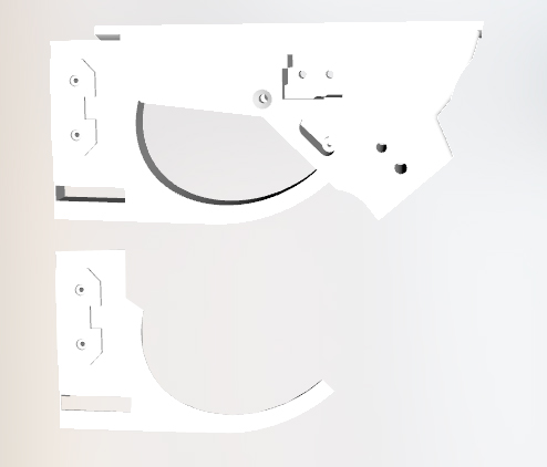

Yes, I purchased the files from ReciprocationProps. I ended up using the couplers, barrels, stock, and a modification of the main body / receiver part as I wanted to use the S&T Full Metal Sterling Arisoft as the base.
