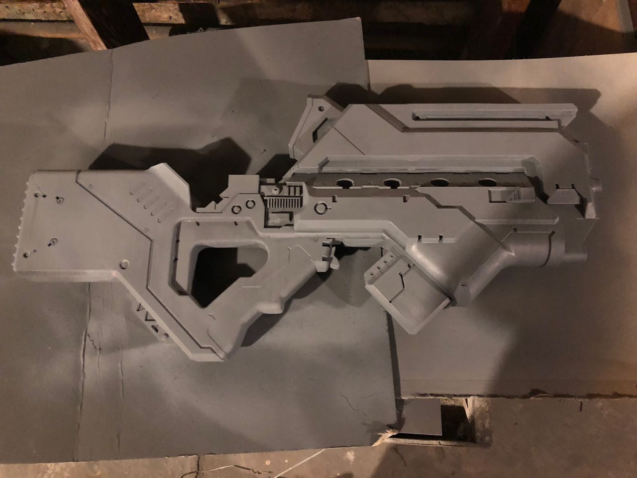

My progress so far.
Prime, sand, prime, sand, prime, sand...
