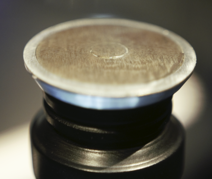

Something minor I noticed. The washer emitter is brushed in a straight line and not in a circular pattern. Not a major point, but just an observation.
Seems likely, maybe on a belt sander with how straight the markings are.
See my earlier post:
That’s a really good point, I’ve always thought they sanded the emitters down after the sabers were assembled. They would have just shoved them up against a belt sander. It didn’t occur to me that all the dust would get stuck in the crevices.
Emphasis my own. ;)
Remember, the props only need to look good on camera, and aren't made to last, or be perfectly finished and symmetrical. For the hero sabers, they probably just assembled the parts onto threaded rods, ran the emitters across a belt-sander with a few different grades of coarseness to get the rods flush (and then the emitters reasonably smooth), then called it a day.
And to be honest, it's my experience that imperfect props actually look better on screen than perfect ones. Perfect props almost read as cheap on screen, it's difficult to explain without showing, but there is a reason so many props have exaggerated textures and techniques that often appear overdone in person. They just look more authentic.
Yep. Perfectly imperfect.
