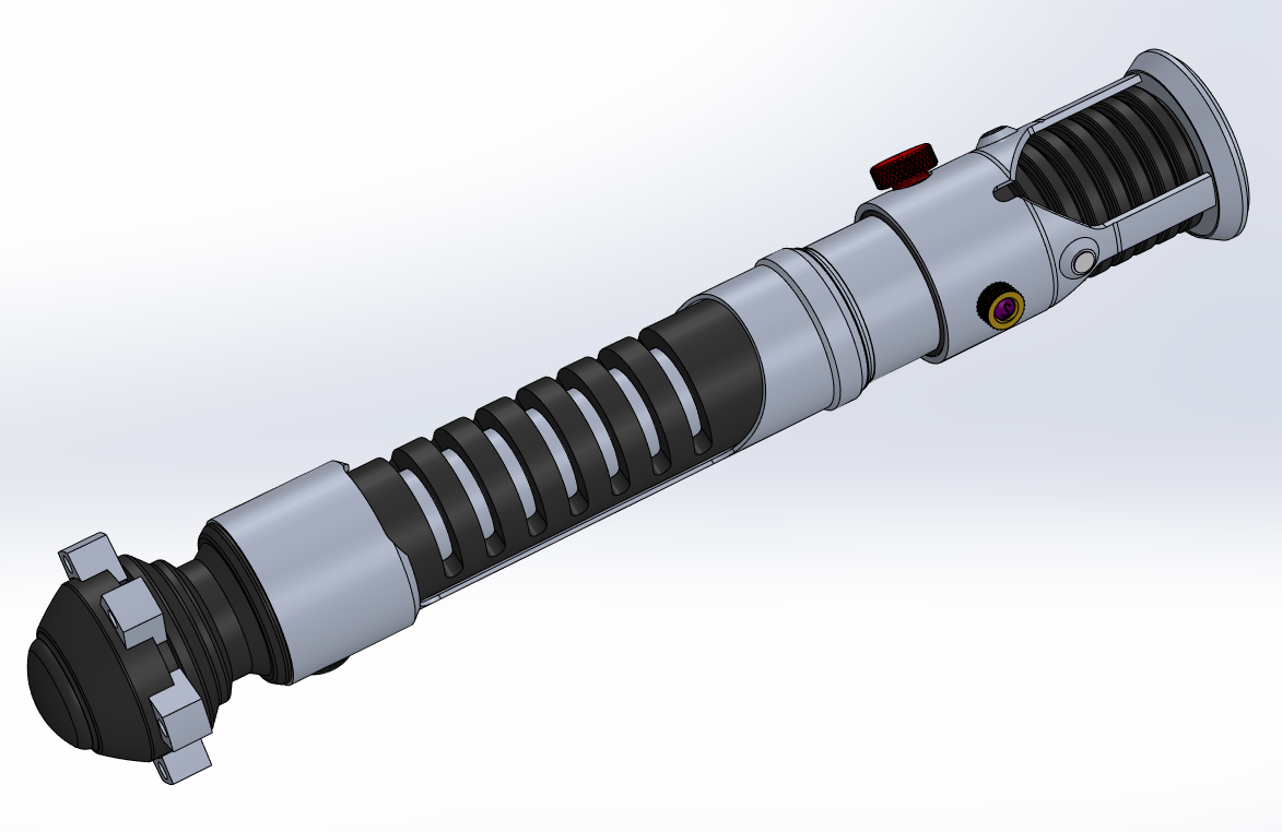

Dewy and Anakin Starkiller's Accurate Obi-Wan Kenobi Episode 1 Lightsaber Design
thd9791
you can see the underside of the emitter plate....

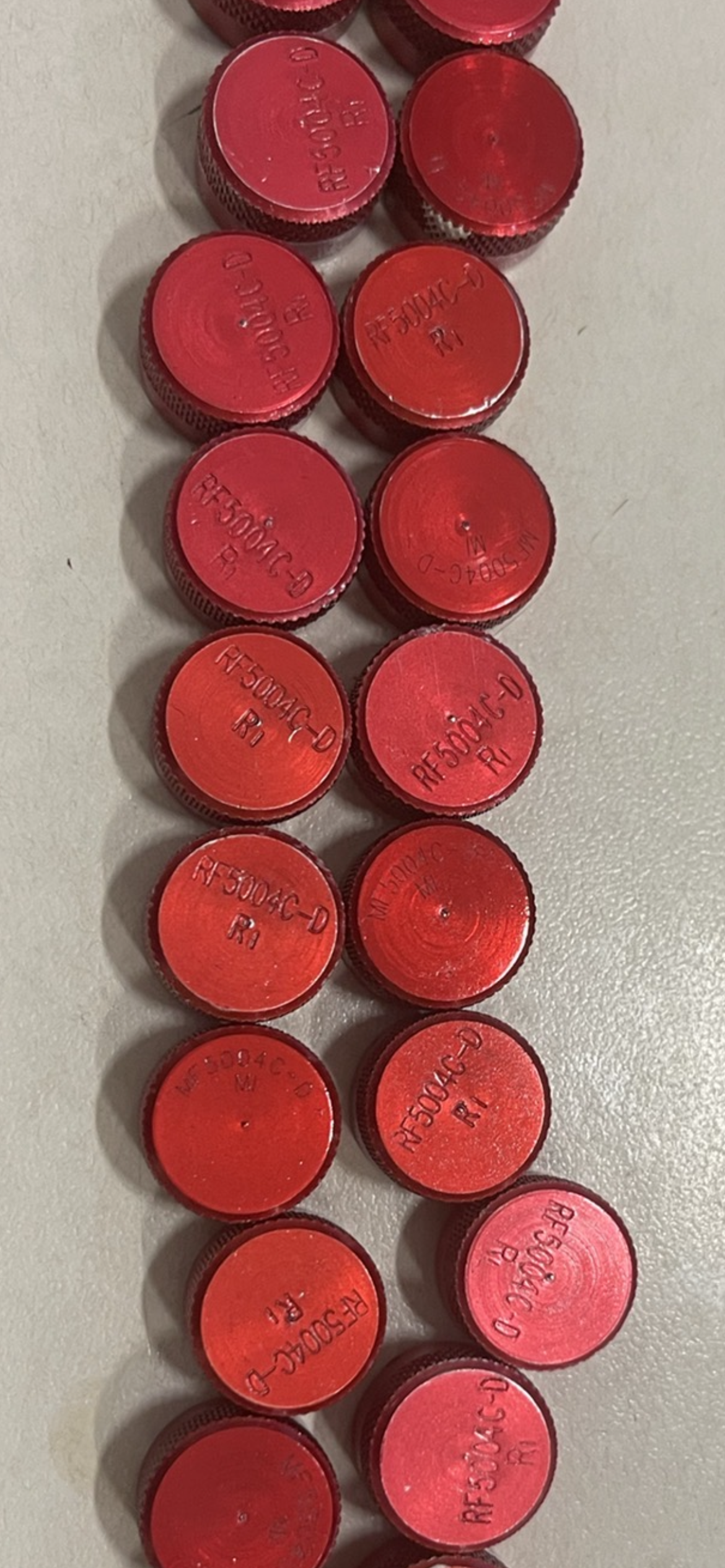

Question: what's the finish like? I'd always assumed from photos and the old Larbel replicas that they were a gloss/mirror finish. The Romans replicas give them a matte finish that's so dull they look frosted. Which end of that spectrum are they closer to?
unless I'm mistaken, they're anodized

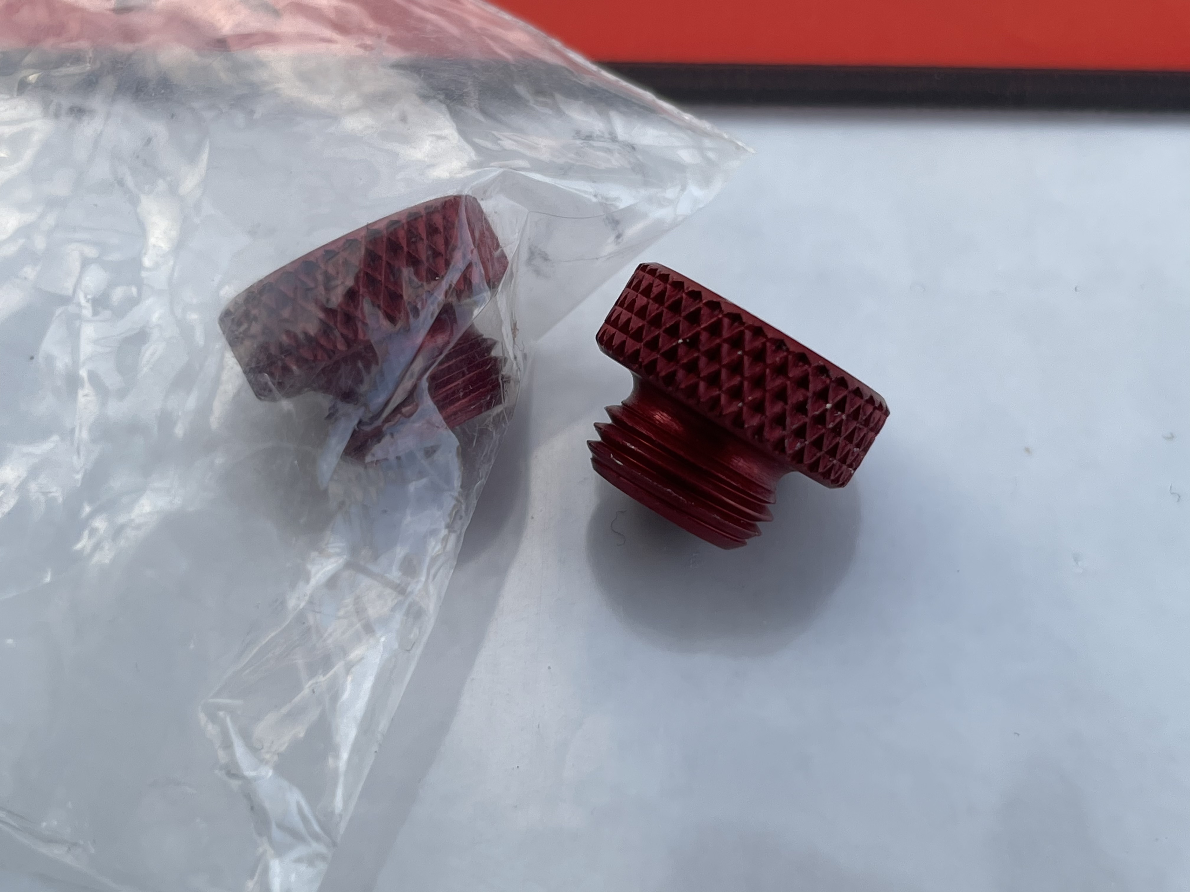

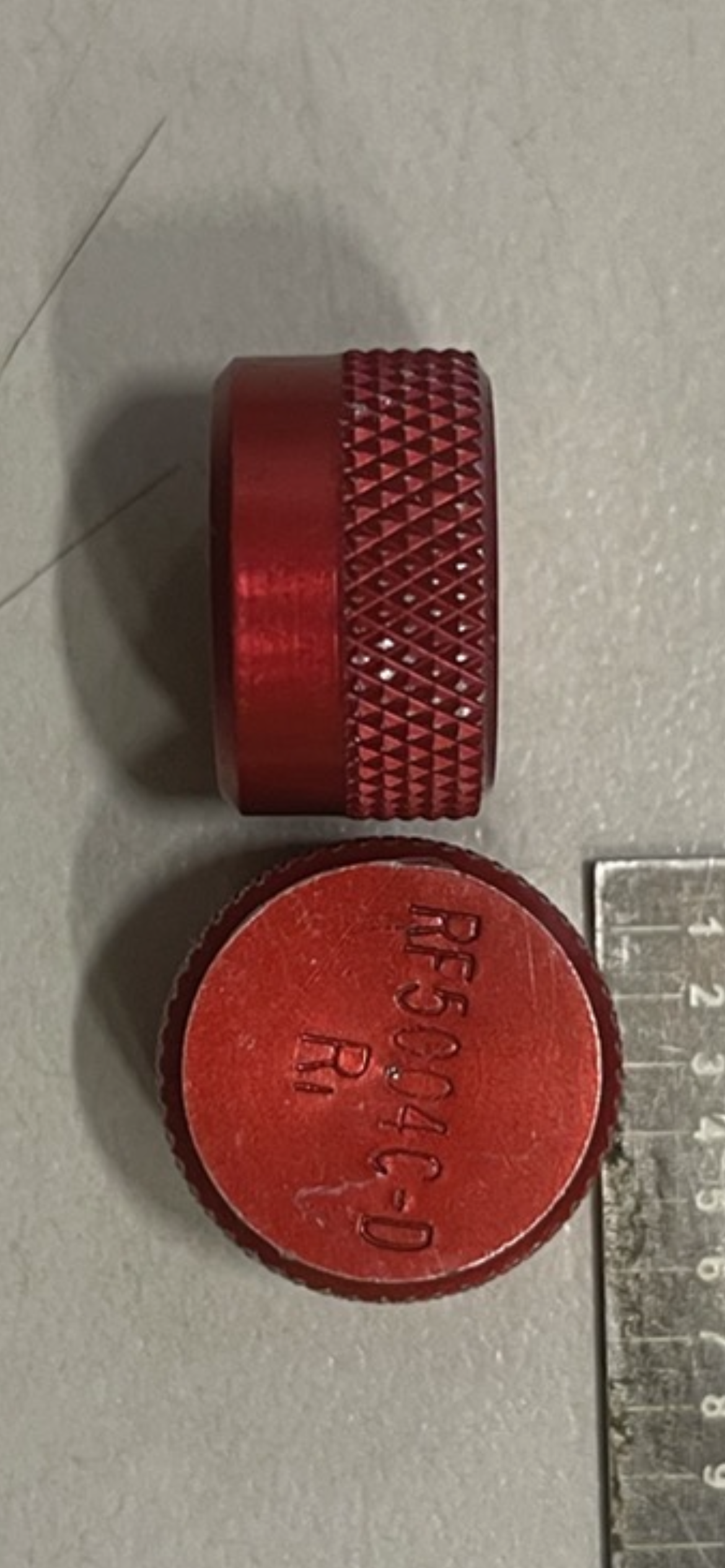

Yup, they are the typical red hard anodized finish. Here are some parts with a similar anodized finish:
Dewy
Note that these parts are not at all related to the correct “blanking caps”, they’re just similar aerospace parts with an equivalent anodize specification (MIL-A-8625 for the above).
Excelsior
Very cool.
The matte finish on Roman's replicas indicates aggressive bead blasting prior to anodizing. For a proper finish, they should go straight from machining to anodizing. The as-machined finish will give them the appropriate glossier look once they're anodized.

Looks gorgeous! Just to clarify, the objective of this run is to be geometrically accurate, but not necessarily materially accurate? I don’t remember what the final verdict was on resin grips verses other easier materials.
Dewy
Since it’s not feasible to do resin casting for the black parts, they will be machined acetal plastic (aka Delrin). The remaining parts will be aluminum, brass, steel, etc. as appropriate.
