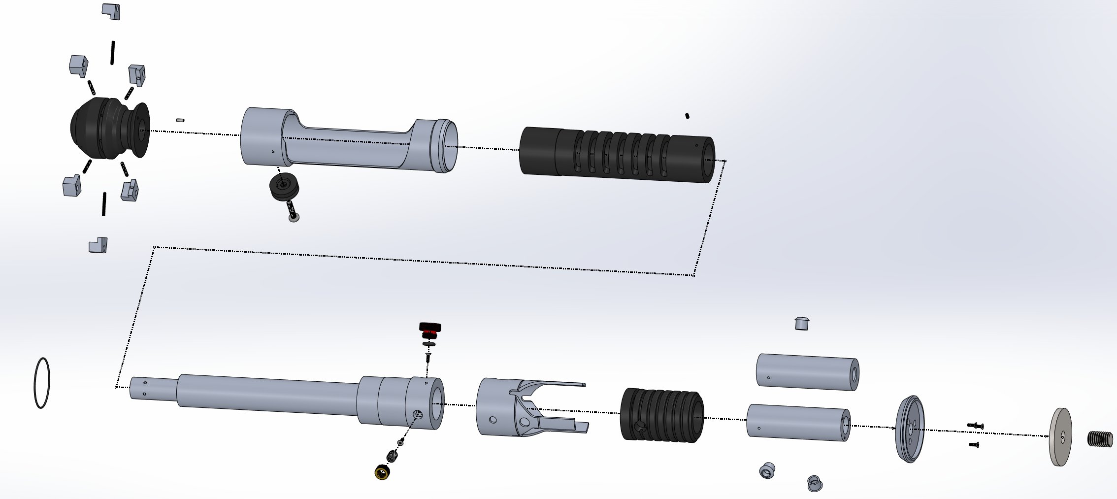

Will this design be disassemble-able, or is this more of a carefully mask type of situation?
I can’t speak to what state the saber will arrive in, but it will be fully disassemble-able. There are a few parts that will require a dab of super glue, but that will be up to the end user.

Most of the black resin portions of the hero saber (and this replica) are actually quite a bit smaller than the aluminum parts they fit within, so paint shouldn’t be a problem. There are a few hidden (not visible when fully assembled) cylindrical surfaces on this replica that may need to be masked. In other words the diameters of the non-visible sections of the black parts are intentionally larger than the visible portions so things fit together better and won’t move/rattle.
