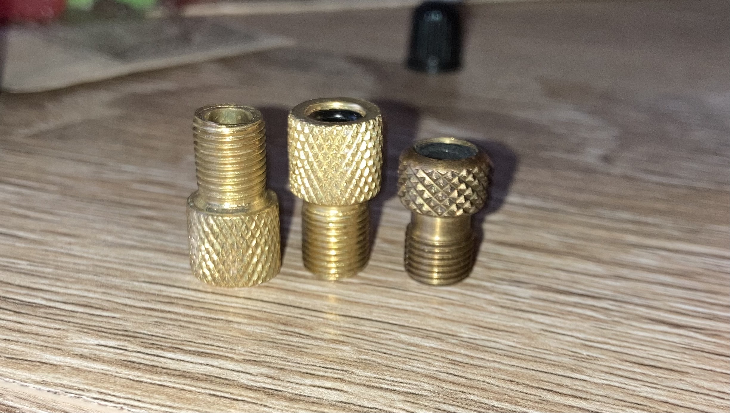

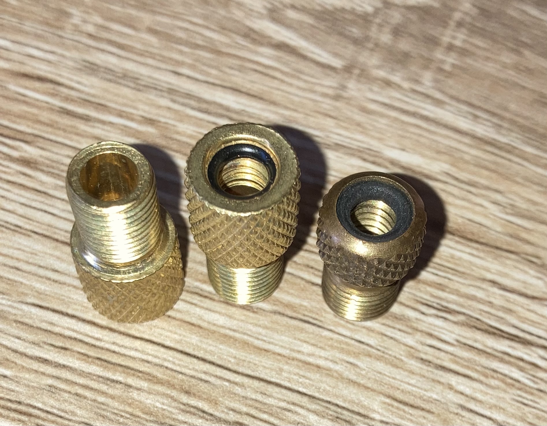

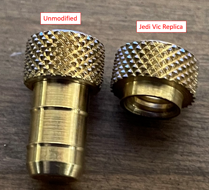

Modern versions on the left, wrong stem, too shallow knurling but a good size. On the right, correct stem, *correct angle* but big knurling on the right, may not be tall enough. I can easily see cutting the O ring section off the left one to match the prop with threading right at the surface
Dewy
Modern versions on the left, wrong stem. On the right, correct stem but too big knurling on the right. I can easily see cutting the O ring section off the left one to match the prop with threading right at the surface
The right one has the correct 45 degree knurling too. The other 2 have 30 degree knurling.

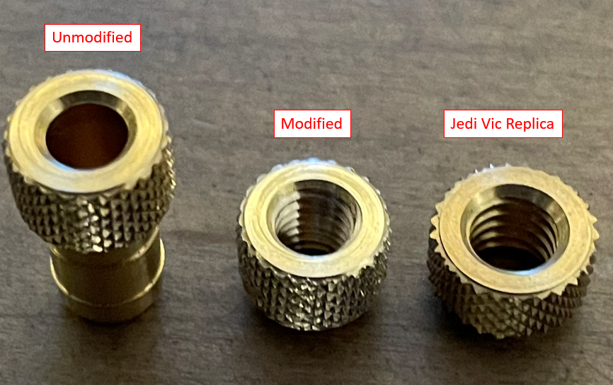

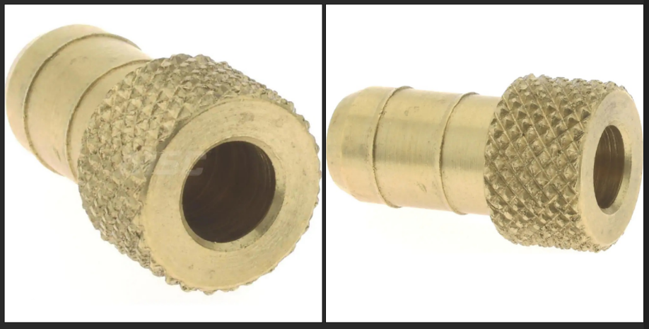

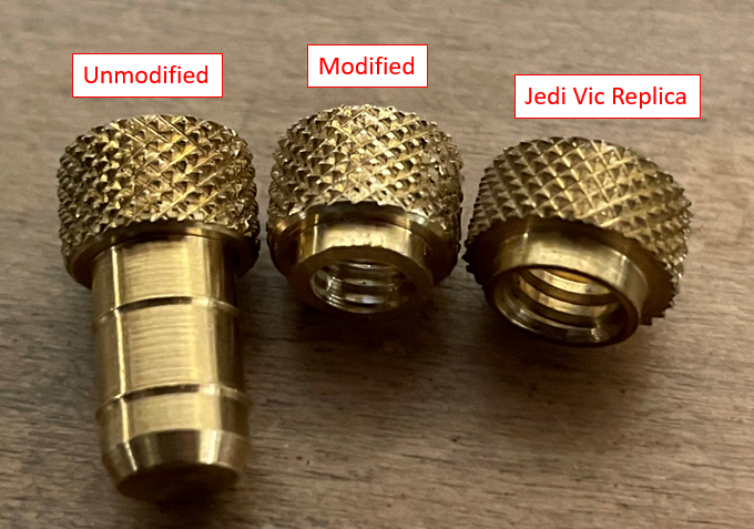

Okay, so I have an update on the "brass valve":
I had long been considering the possibility that it wasn't a Presta/Schrader Valve Adapter. It seems like too many of the prequel saber parts are aerospace related, so I thought I would look in that realm. thd9791 and I had been bouncing some ideas off each other when I stumbled upon the Parker Hannifin Model #20-6 "3/8 in. x 1/4 in. Barb Brass Plug". This is a simple plug used to plug the ends of open pneumatic flexible hoses:
The sizing looked correct, the knurling looks perfect, the only problem was the stem and the fact that the inner diameter wasn't threaded. Anyways I picked a few up, and after 10 minutes of easy modification I'm pretty happy with the results. All it took was cutting down the stem with a hack saw, and tapping the ID with (in this case) an M6 tap.
I'm not saying this is exactly what was used, but it's a possibility, and a good option readily available for cheap:

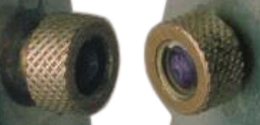

Yes! There are two versions, one with a covered front and a rear tube drilled out half the length. The other has the hole in the front, and is only half deep.
if it WAS threaded, I'd be very interested to talk about the inner greeblie when that time comes

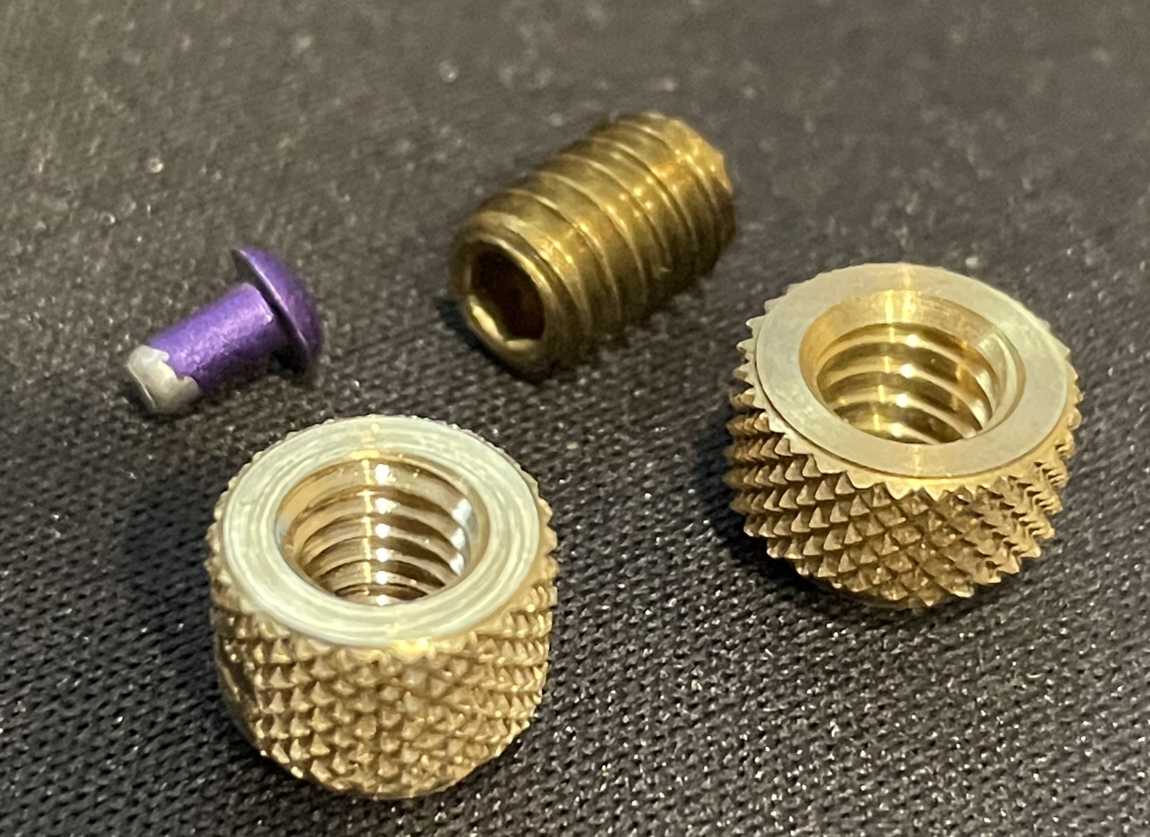

In my mind the prop makers threading something to attach the saber is just as likely as them filing down a valve adapter to be shorter.

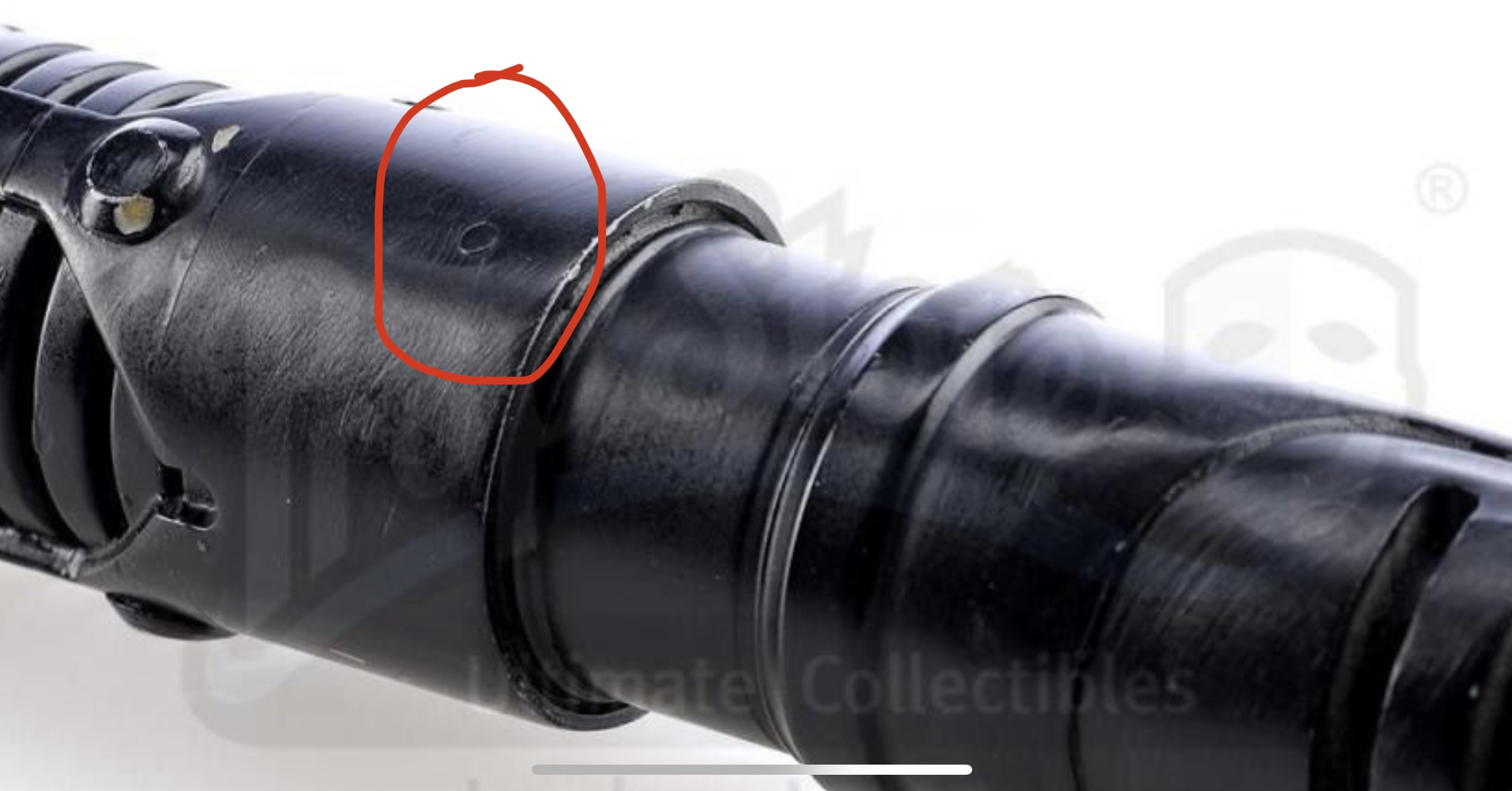

If we look at the featureless stunt sabers we can see the filled in remnants of the hole used to attach the brass knob. It is much too small for them to have used the external threads on the valve adapters.

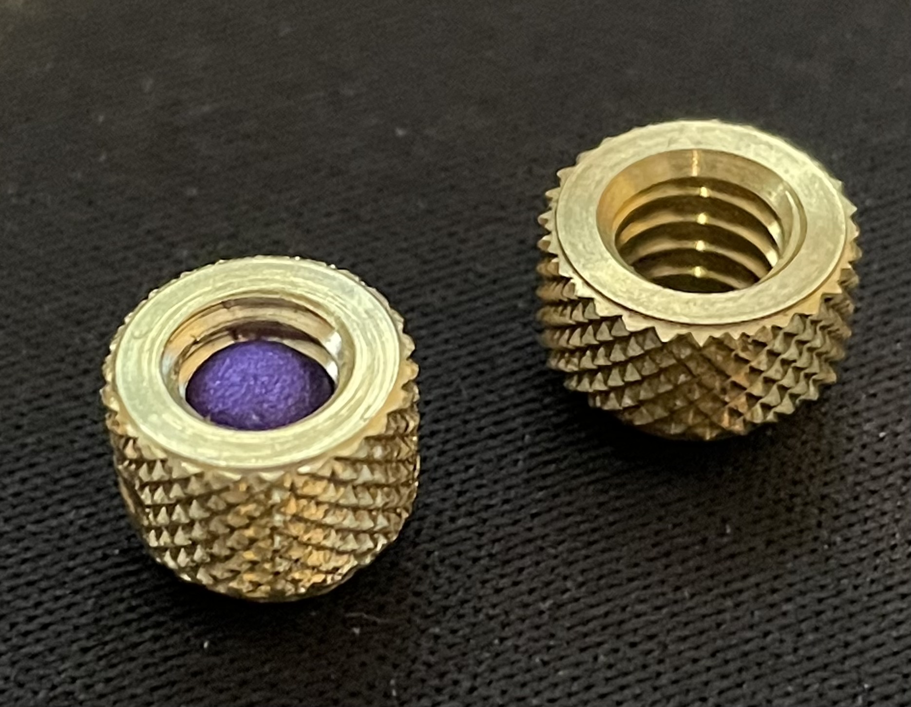

I always assumed they used a set screw or small threaded rod to attach to the internal threads of the brass knob, similar to how the Jedi Vic replica worked. The purple hemi was then either integral to this attachment method (some threaded rods have painted ends to indicate size/material/etc) or was a small greeblie to cover up the threaded rod/screw like the small painted rivet that came with the Jedi Vic replica.
Jedi Vic 3 Piece Replica with modified Parker Plug (left):
Jedi Vic Purple Rivet in Modified Parker Plug:
