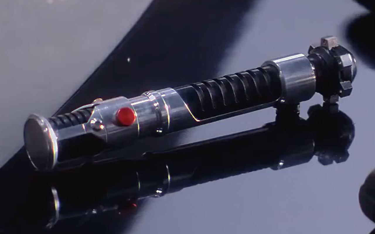

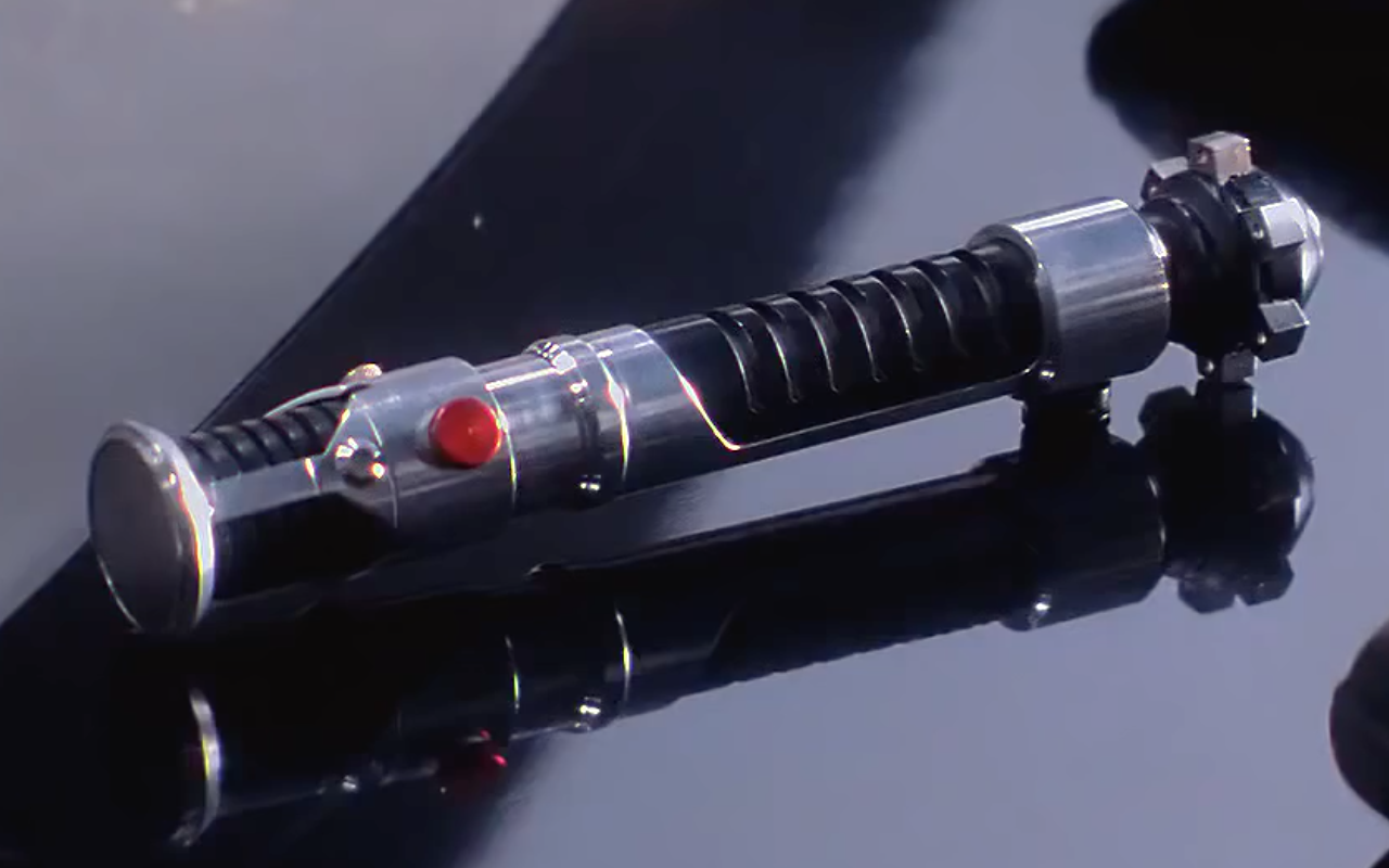

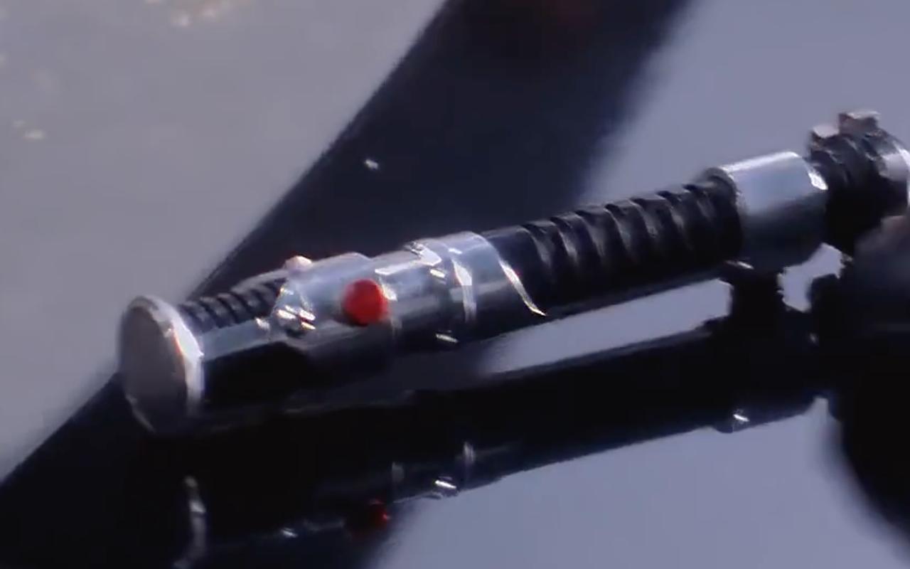

Here are some more screenshots from the same scene. It's helpful to click through and follow how the light changes and highlights different parts of the saber.

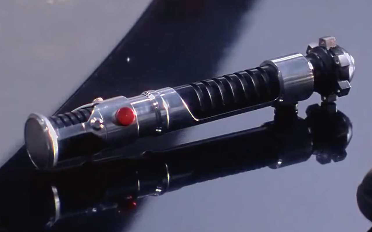

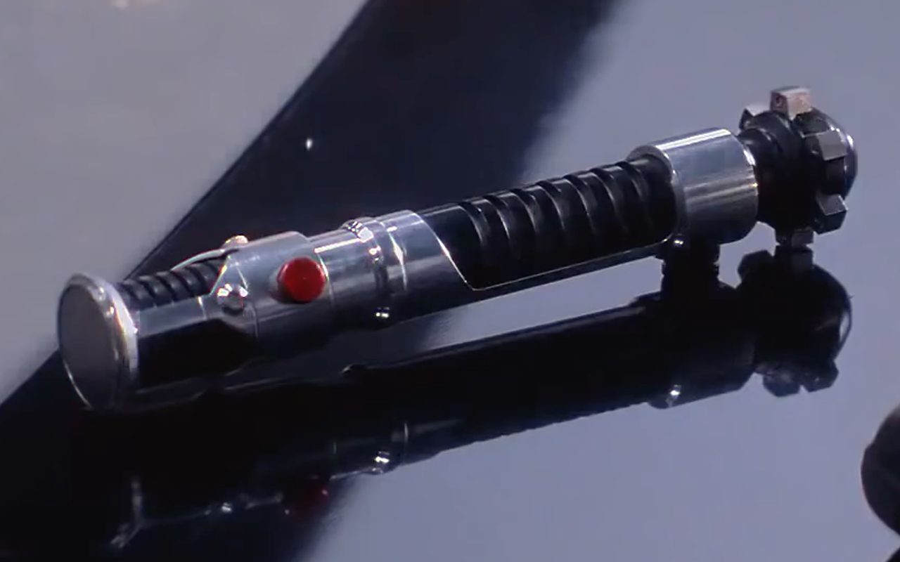

Excellent. Yes, that has to be the same. It just looks the same--the finish on the aluminum and the paint are a match. What's interesting is that you can even see where the paint has been more worn and gotten more shiny from handling in the main grip area, where the actor would have held it the most, whereas the paint up in the emitter still has a slight matte look to it. I've always taken this as evidence that the black areas are machined aluminum and were painted black. That's the simplest explanation. The black areas are not anodized, which is something most replicas of this saber have gotten wrong over the years. Some have even suggested delrin, but if you look at the top two black rings below the emitter ring, you can see where the paint has chipped off, revealing the aluminum beneath. There are pictures of the Qui-Gon hero showing paint chips also (it's even visible in screenshots), thus corroborating the existence of paint here.
FWIW, the later three-hole emitter version of this saber definitely did have the black areas anodized. But on this earlier Episode 1 prop, they just painted it.
The black portions of the Episode 1 Obi-Wan and Qui-Gon sabers are cast resin. They are warped and not perfectly circular, there are even visible cracks that just aren't possible in aluminum.
Wow ok that's a revelation to me. But it makes sense. I thought I was seeing aluminum under the paint chips--so it's actually the resin.
So they machined the inner pieces in aluminum, cast them in resin, and then used those to assemble the hero props. It makes sense because it's commonly known that that was the exact process they used to make the Maul saber, which was originally shorter and more based on Exar Kun's EU design. I don't know if anyone has ever seen the metal pieces they used to make the resin parts. Perhaps they were discarded after being used to make the molds.

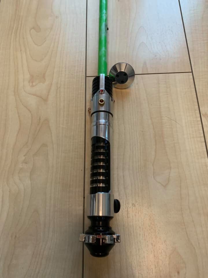

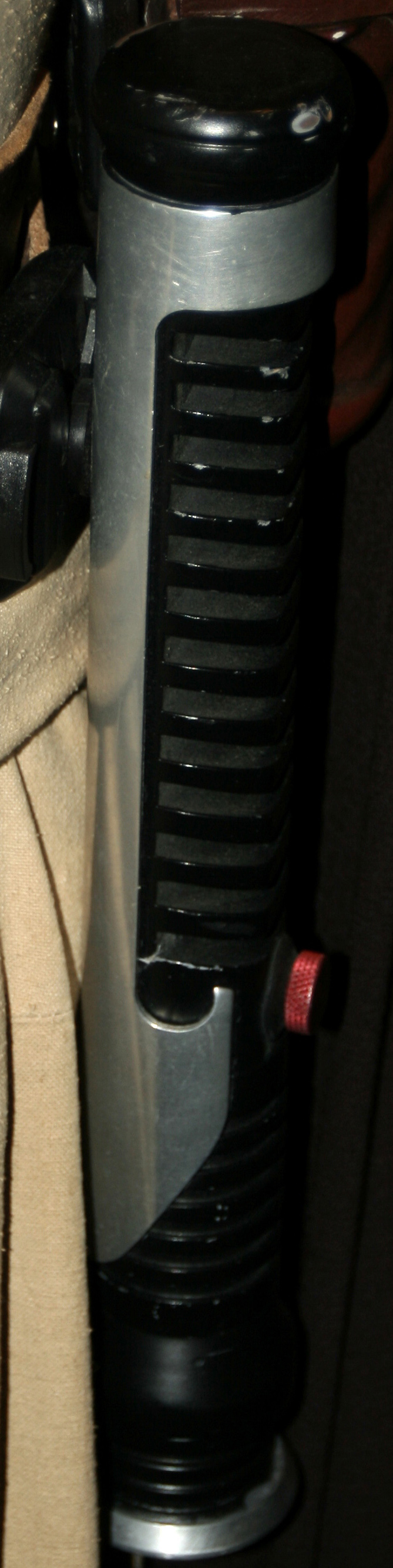

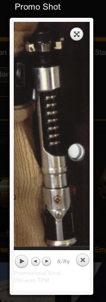

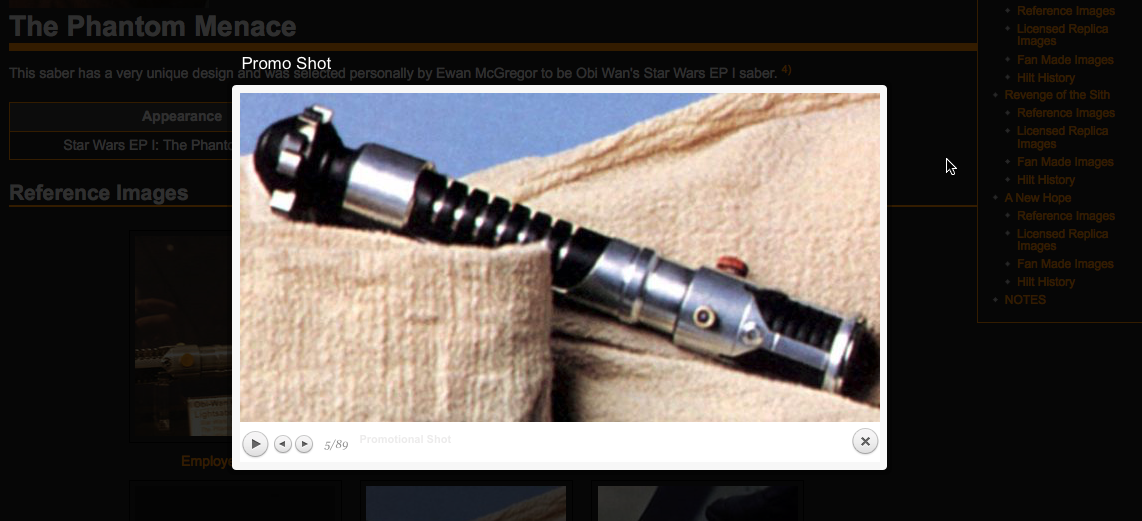

I have one more image of that Obi-Wan in question:
Anakin Starkiller and I have previously discussed this. He thinks it might be one of the salt shakers since we know there are more than one.
Two things I find interesting about that saber:
1) if you zoom in, it looks like the “emitter posts” are bent outwards under the emitter. bezel to retain it. That’s definitely not the case on the primary hero we see.
2) if you zoom in on the sides of the pommel cubes, you can see striations in the finish. This is something we DO see on the primary episode 1 hero. I haven’t seen this in any of the salt shakers we have images of.
The button does look coppery like the salt shaker. You can see it’s incredibly different from the blanking cap on the Qui-Gon.

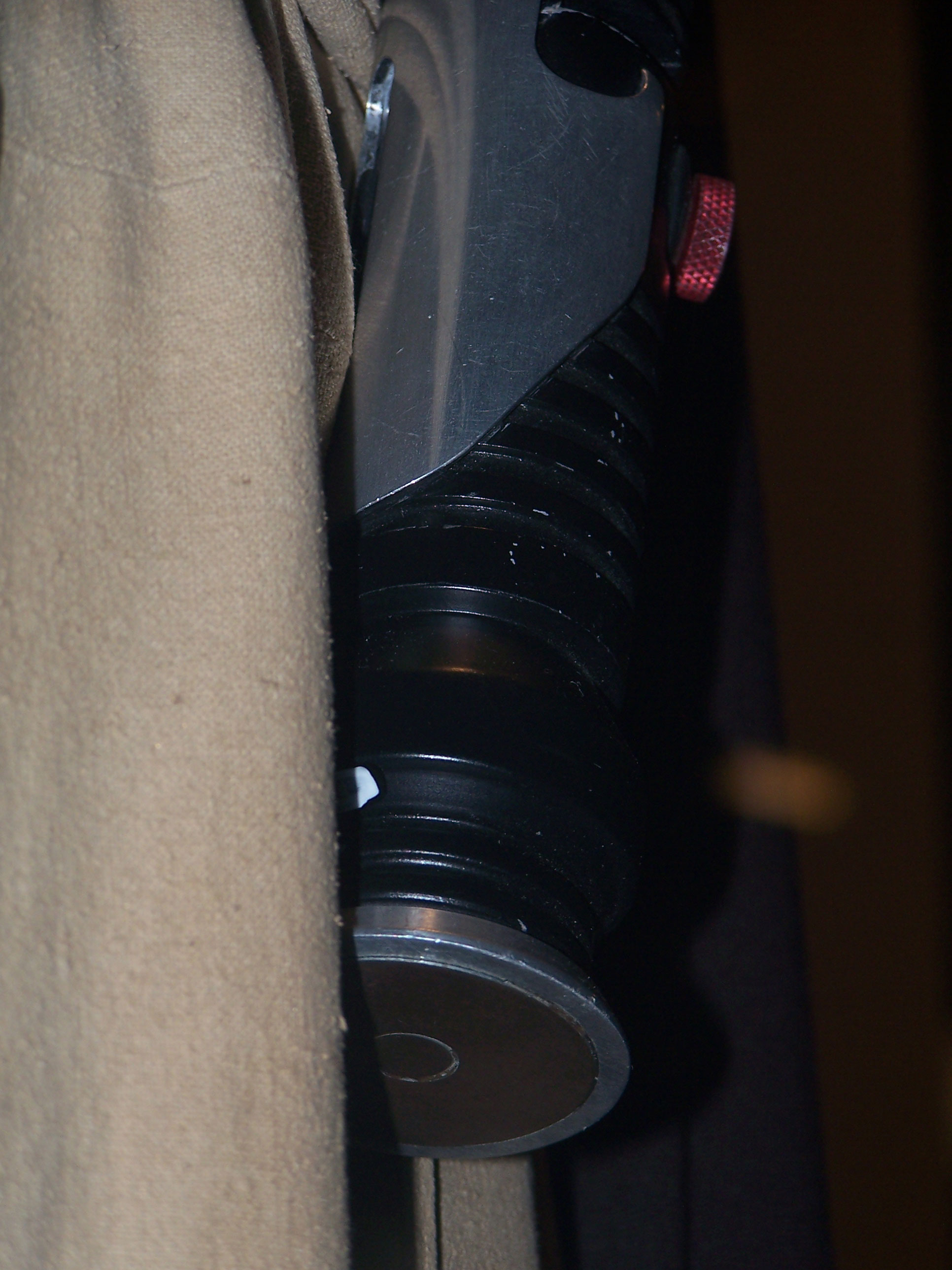

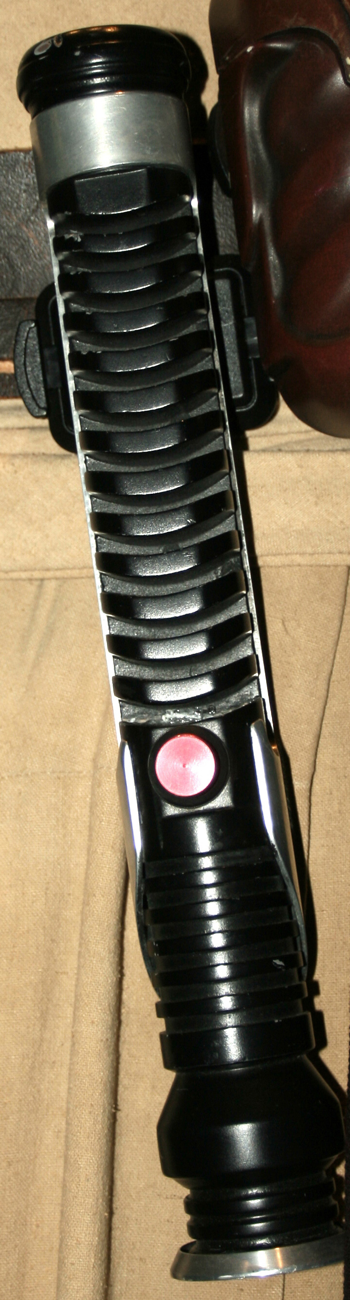

I know of two versions of the salt shaker--one with clear emitter LEDs and a stunt version with red. Both have a red insert in the bike valve. The proportions of the main grip are off compared to the TPM hero, but the "wonky emitter features"/curves around the emitter windows follow closely the lines of the TPM hero, and were thus probably machined in the same way. I am very curious about the pommel cubes. I have a picture of the salt shaker stunt that shows the pommel cubes being very shiny, and possibly warped as the left cube seems to be tilted upward. I'm curious if the propmaker machined some sets of the cubes in aluminum, and then cast and vacumetallized subsequent copies in resin.

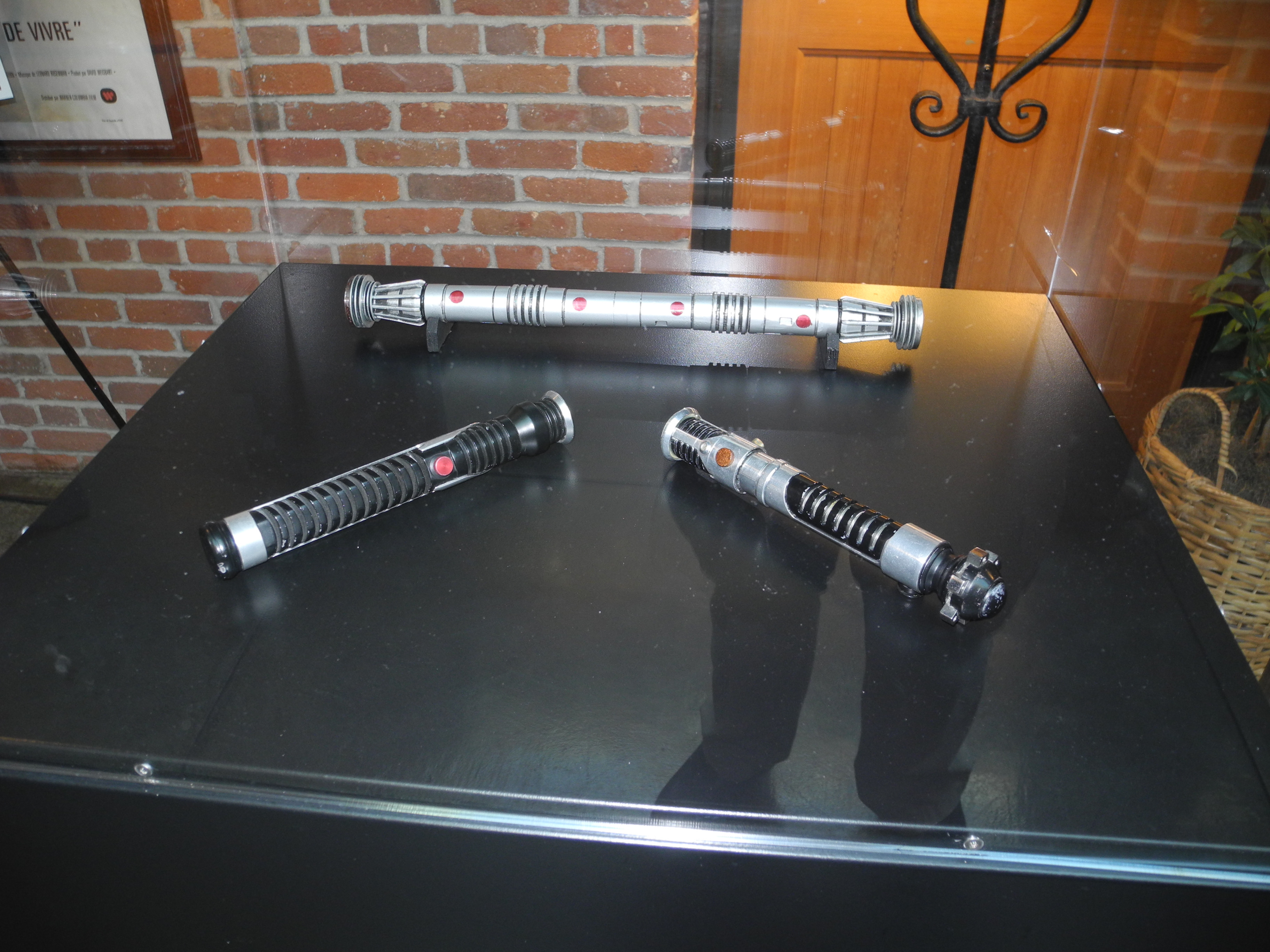

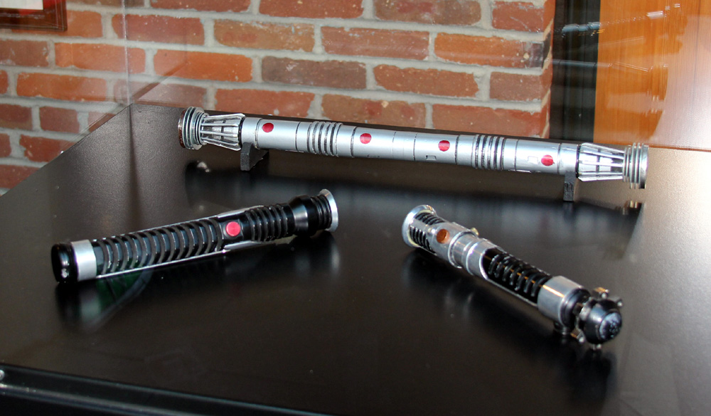

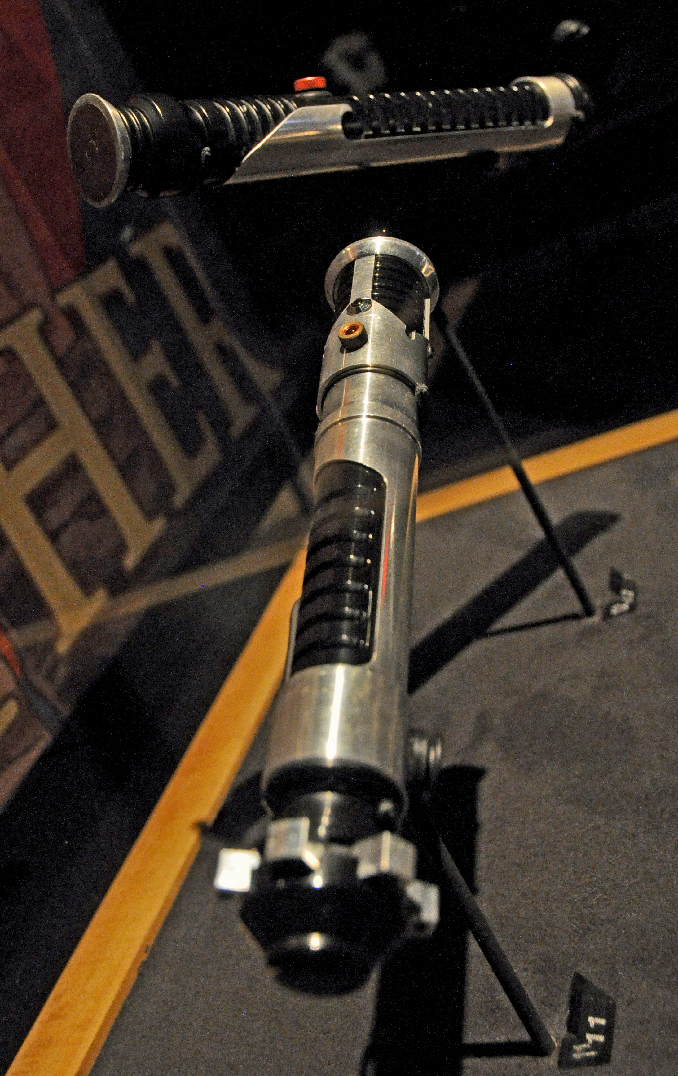

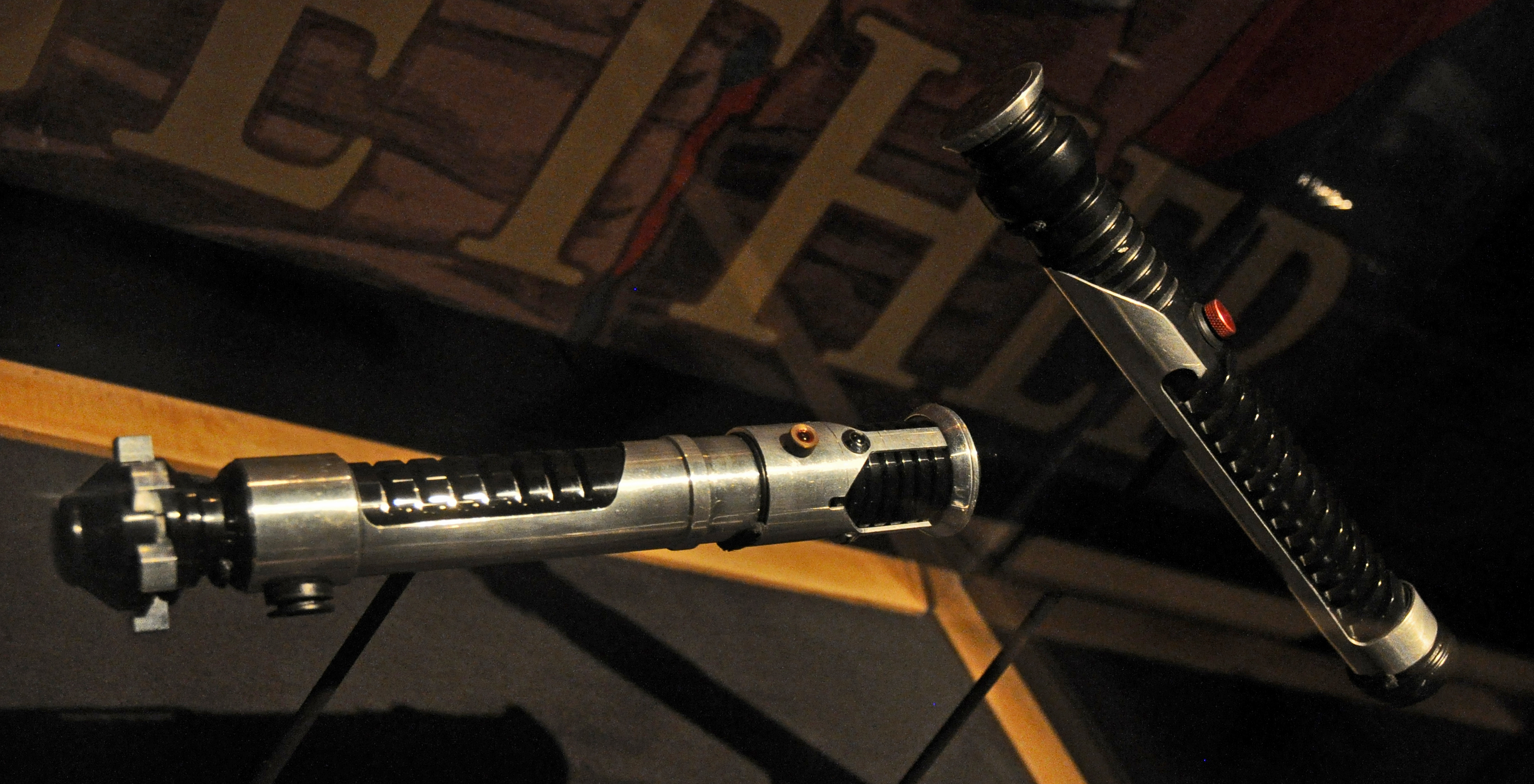

I'll attach some pics of the Qui-Gon on exhibit, which is the exact one in the Ranch photos above, next to a salt shaker that does not, however, appear to be the same Obi, as it is not nearly as beat up.
Very good eye on the bent emitter post--I see what you're saying. By extension, that means that the emitter ring is angled on the inside, and not straight-walled. That's obviously meant to be a solid hero only then because the other salt shaker has a removable emitter piece that hides a threaded rod inside for the stunt blade.
If there are striations in the finish on the cubes, that suggests they are milled aluminum.

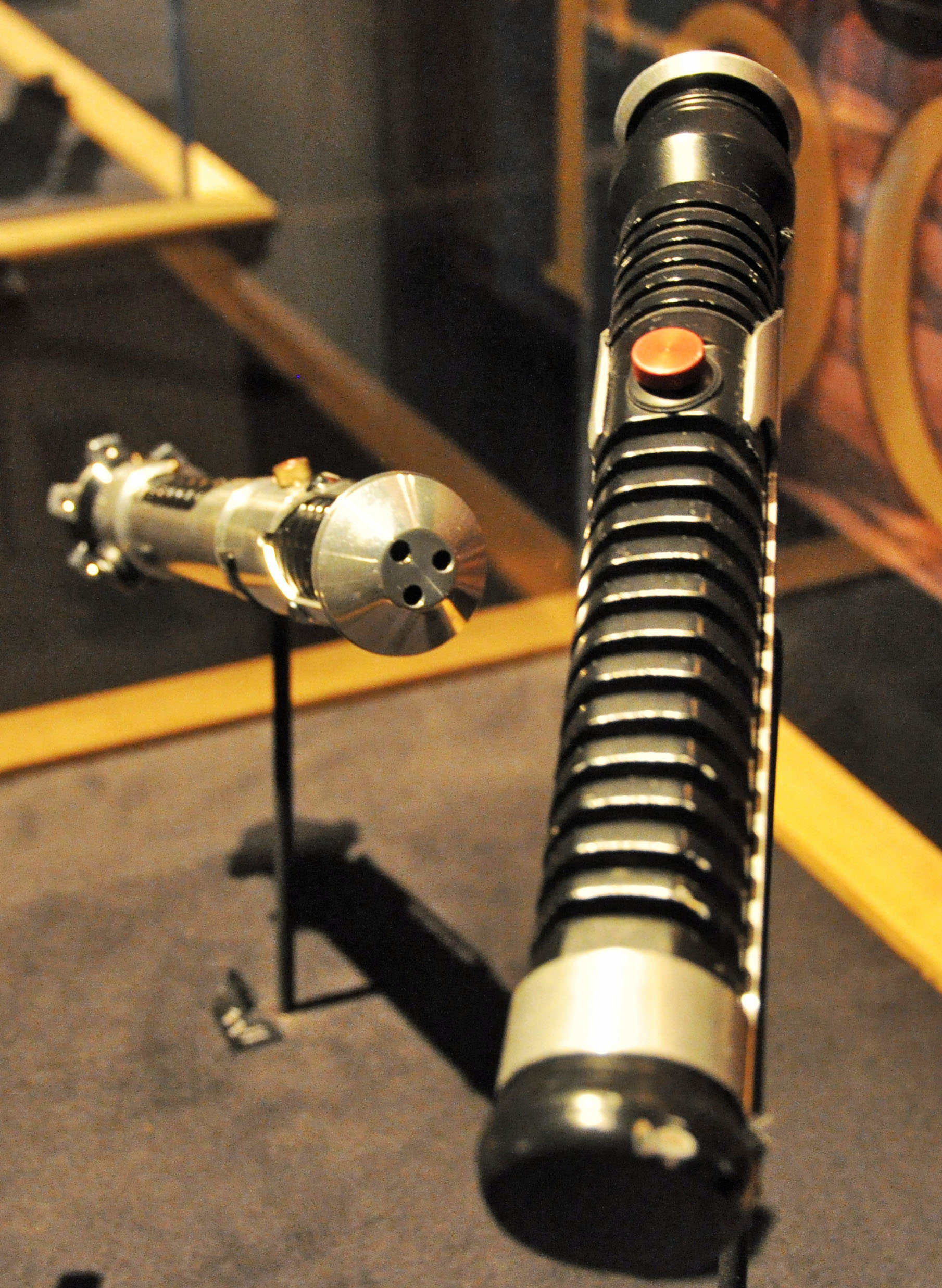

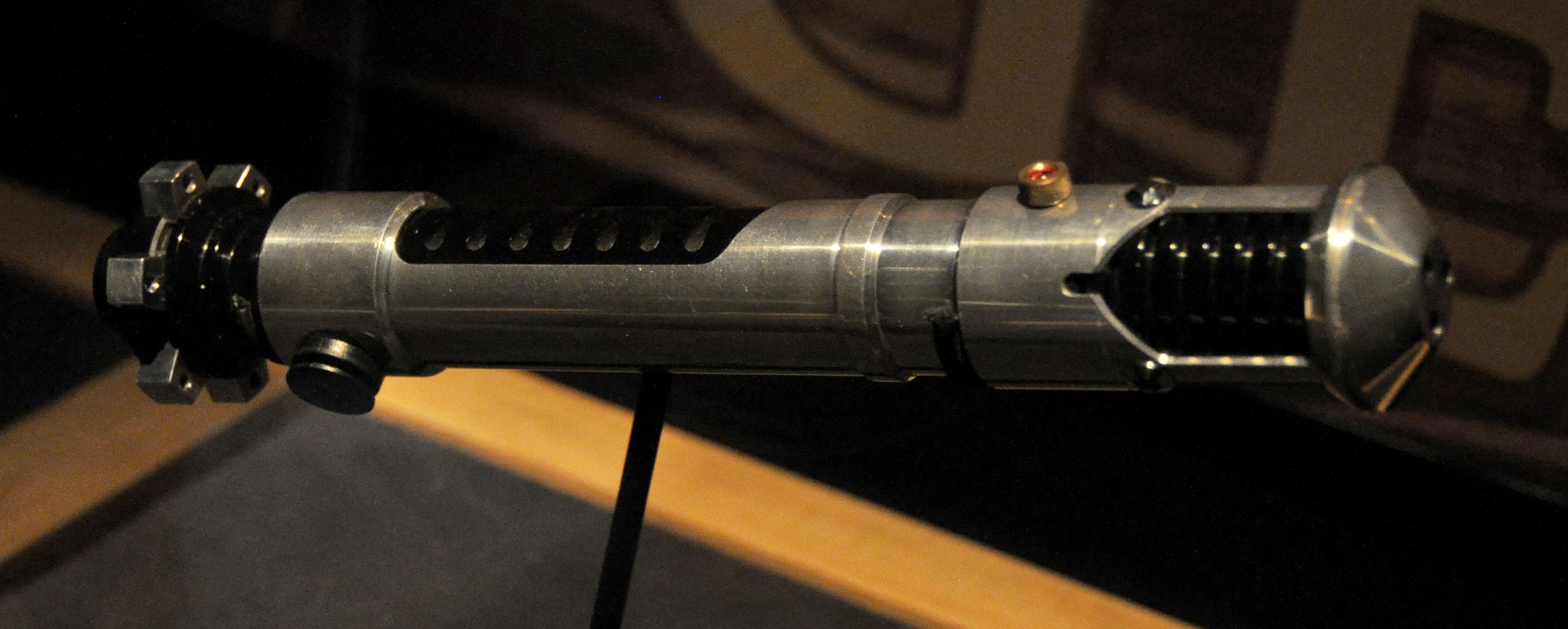

Here's another shot of the exhibit salt shaker showing milled aluminum cubes.

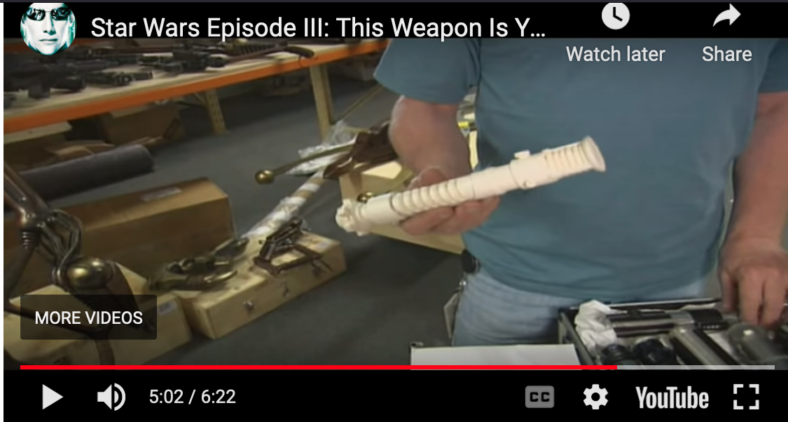

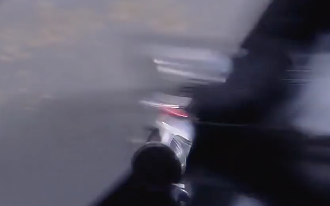

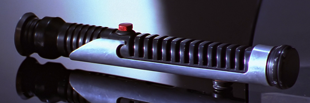

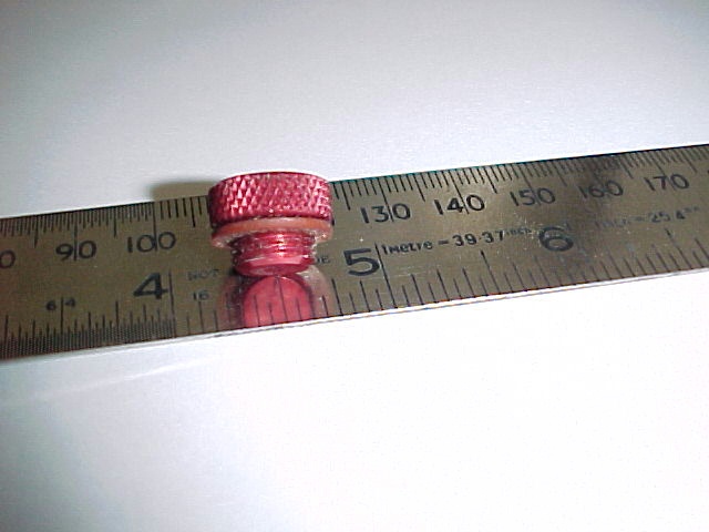

On the topic of the blanking cap again, I think I may have finally solved a detail that I've wondered about for years regarding Qui-Gon's saber...
So in the screenshot of Qui-Gon's saber when Obi-Wan uses the force to pull it to him, you can see what looks like a red o-ring or washer underneath of the covertec wheel. WELL, in the process of perusing my reference archive for pics relating to the conversation above, I found a pic someone posted some time ago of a real blanking cap, and lo and behold, there's a red washer underneath of it... I'm guessing that one of those was used on the TPM Qui-Gon hero.

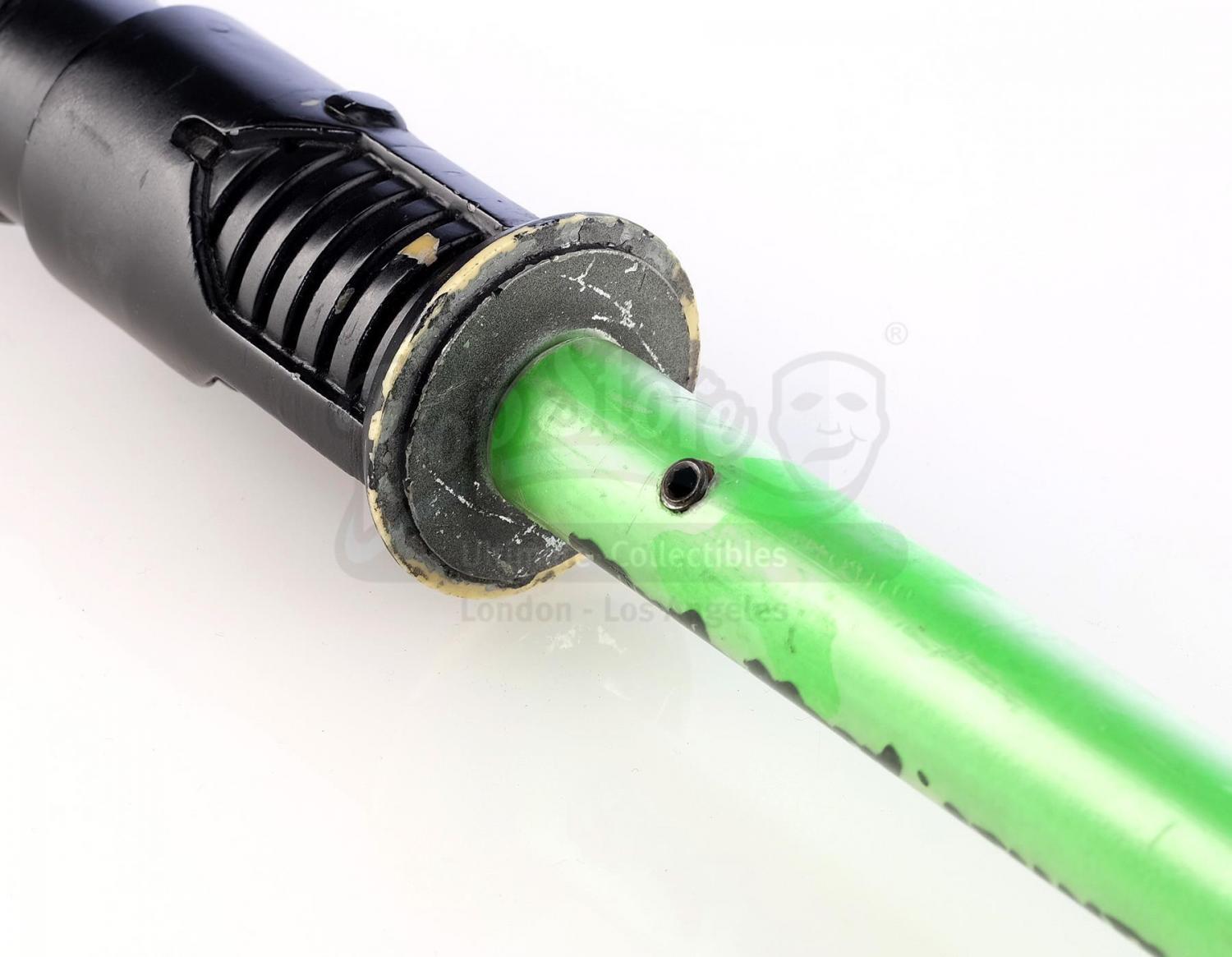

Wild that the Qui Gon (and maybe the TPM Obi) have tarnished plates. I doubt they're normal washers anymore. is this a dulled zinc coating?
Also looks like the Qui Gon emitter ring is a little hollow. It doesn't flesh perfectly underneath with the resin's bevel.

It's hard to say what's going on with the washer piece. It could be a zinc-coated steel fender washer that is ground down with the threaded rod inside, creating a flat face, and that would explain the apparent rust. If it's just a machined piece, how does one explain the asymmetries? And if they machined it, why didn't they make it from aluminum, which doesn't rust?
Yes the emitter rings appear hollow as on the Obi hero it is seen to slide up and down slightly.
Man looking back at that shot of Qui-Gon’s it looks like the aluminum shroud is kinda bent near the pommel
