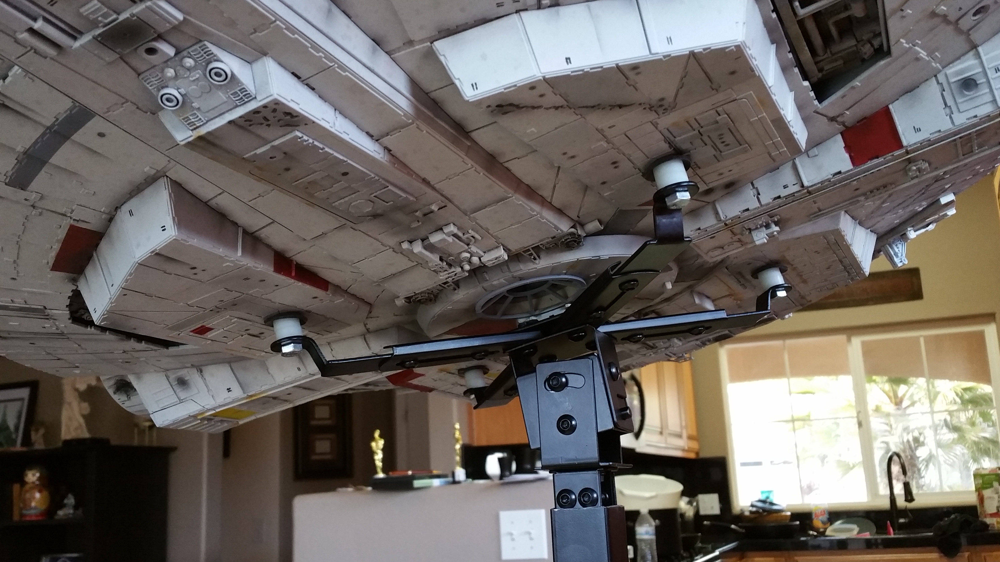

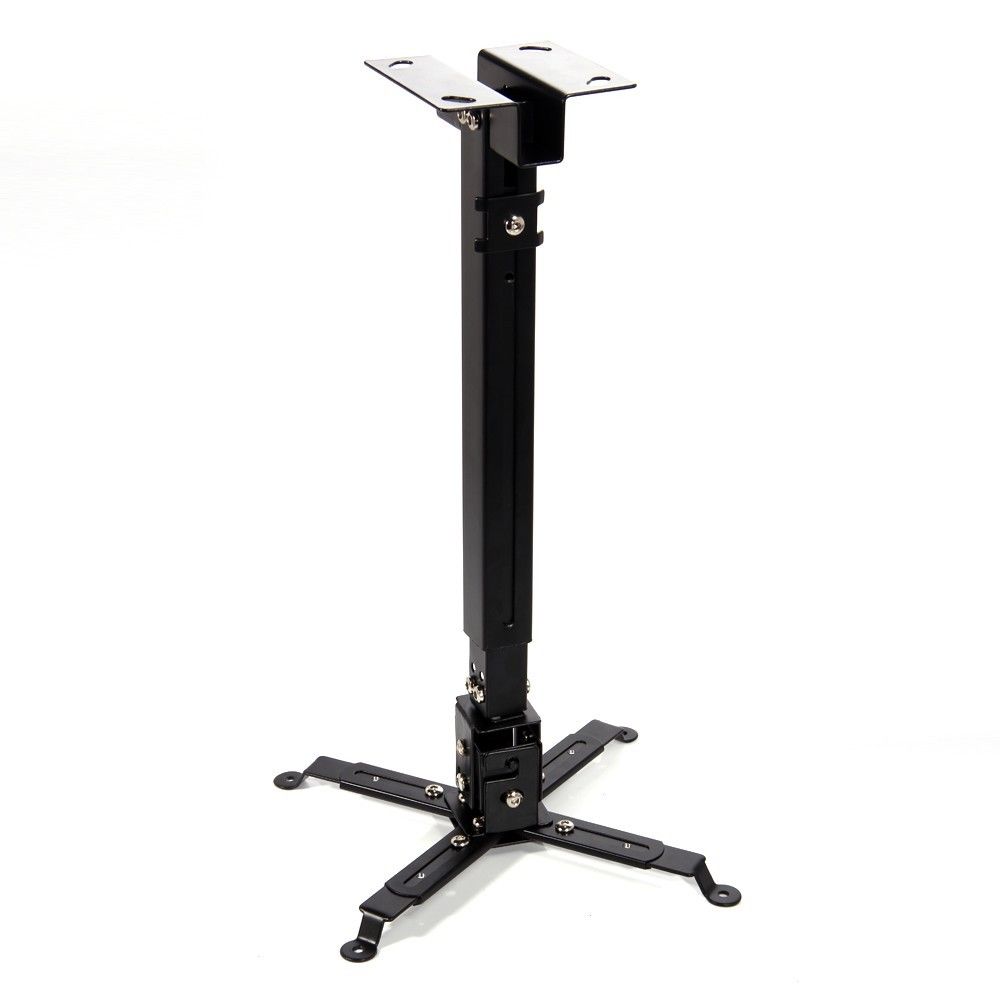

I've I been looking for other options if I want to change things up a bit. I found this projector mount on ebay for $10. It works pretty good!
All the arms are adjustable, so it works with the mounts that are already there. It also can be posed on 2 axis. I got shorter M6 screws and bought some spacers and rubber washers to protect the paint. If I wanted to have the lower gun attached I can just get some longer spacers.

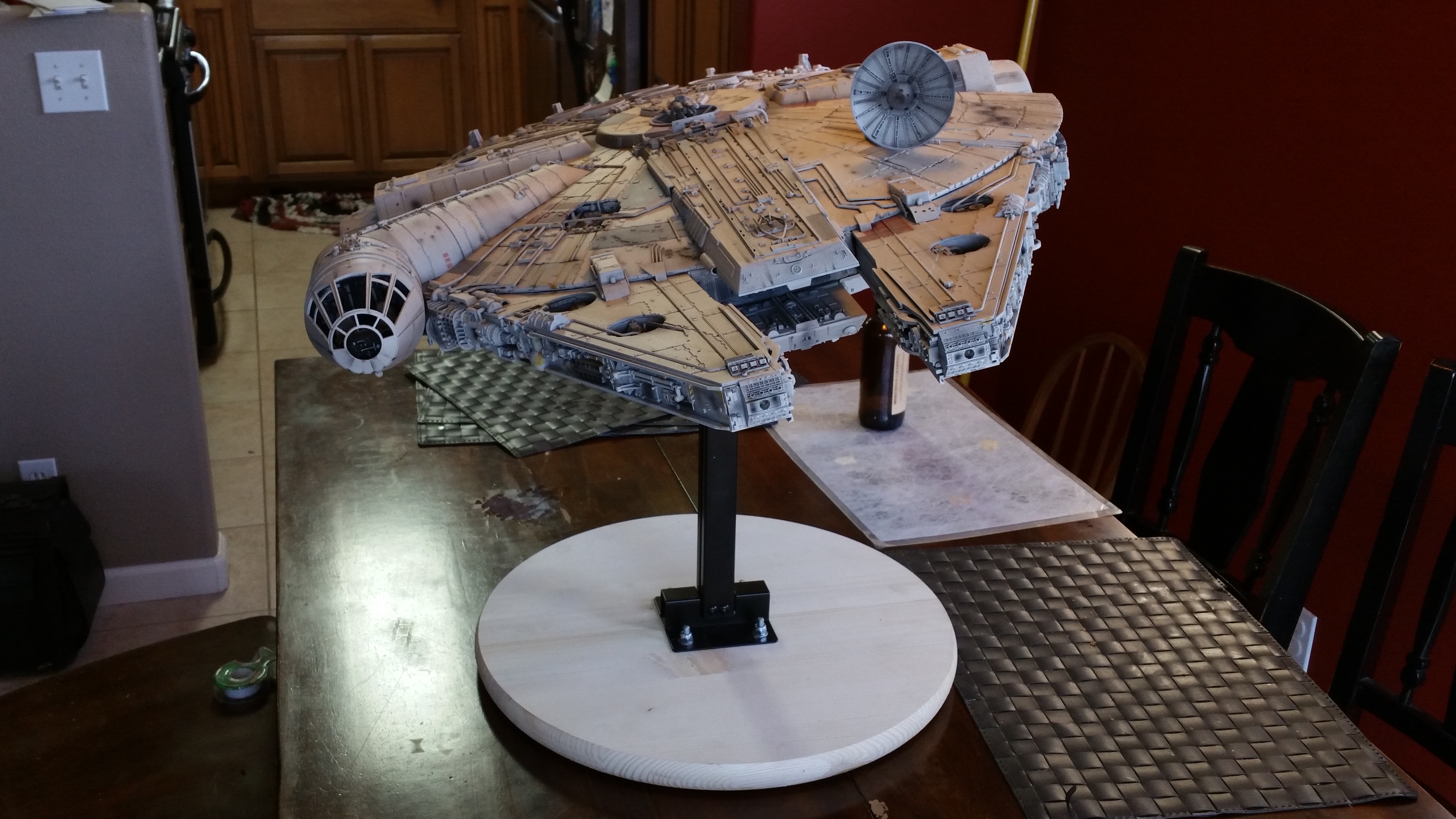

Also what size is that round base you used with the mount?
It's just an 18" diameter pine round that I found at my local hardware store. I believe it's 1.5" thick. I used bolts with washers instead of screws to mount the base to the wood because I was worried there was too much stress with screws and they would strip the soft pine. I countersunk the 4 holes from the bottom and used 3/4 inch washers to expand the surface area.
