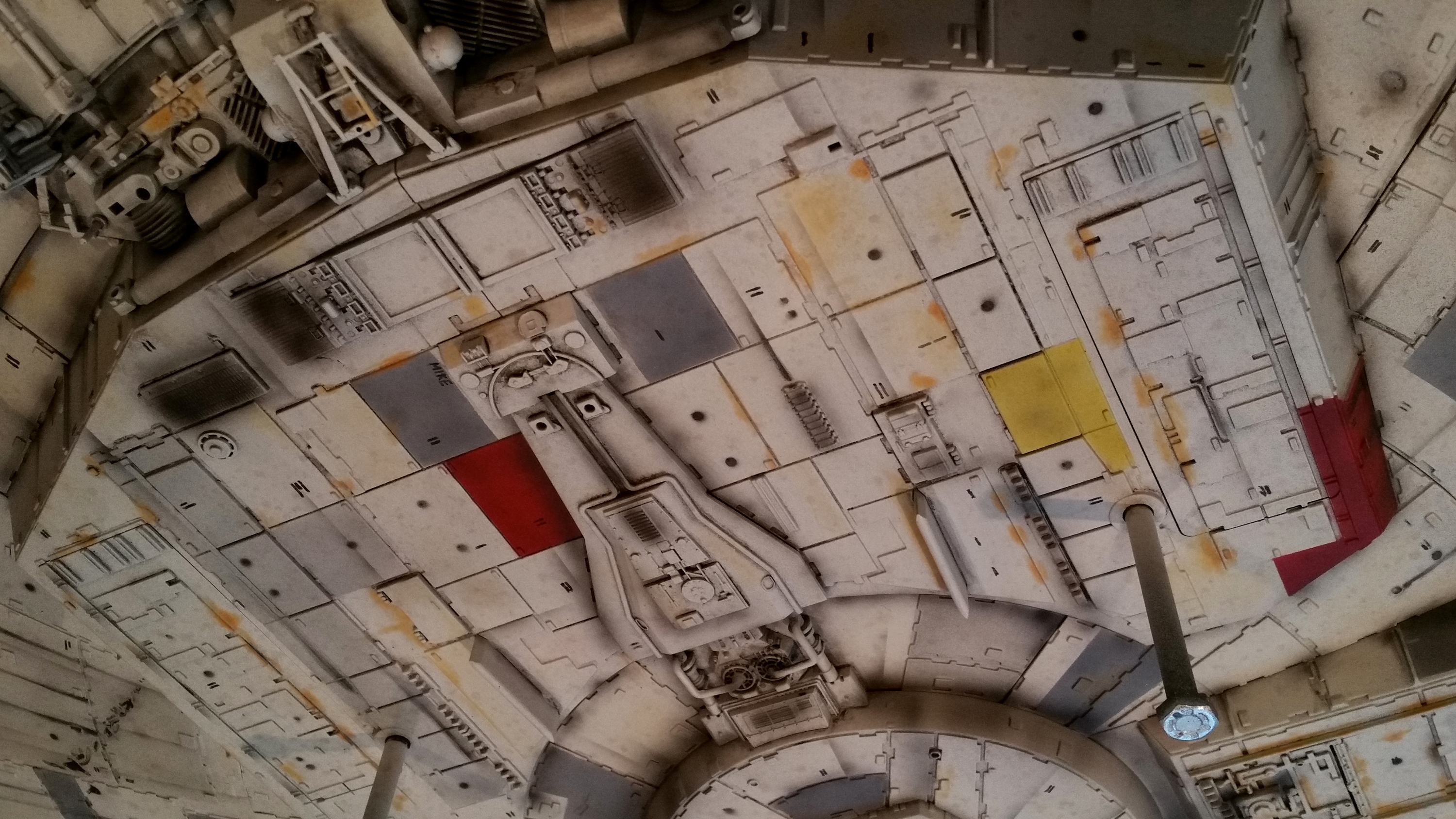

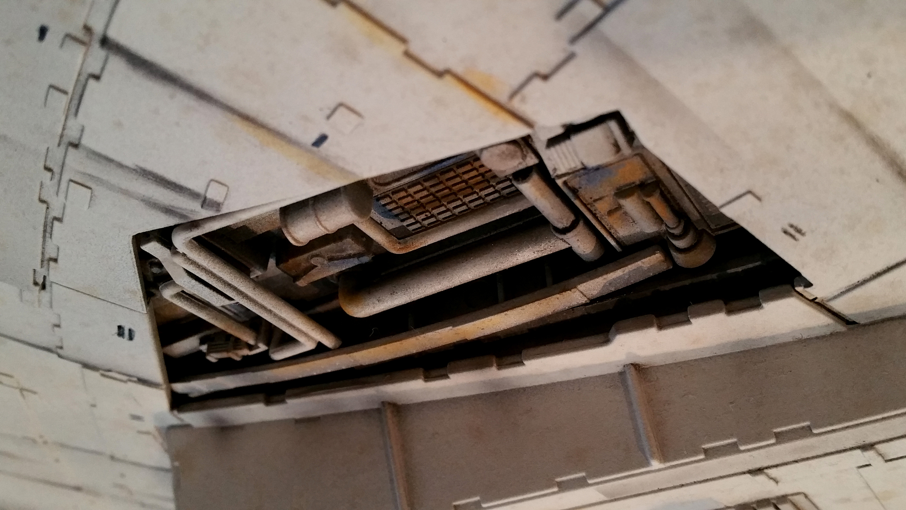

Some bottom shots.

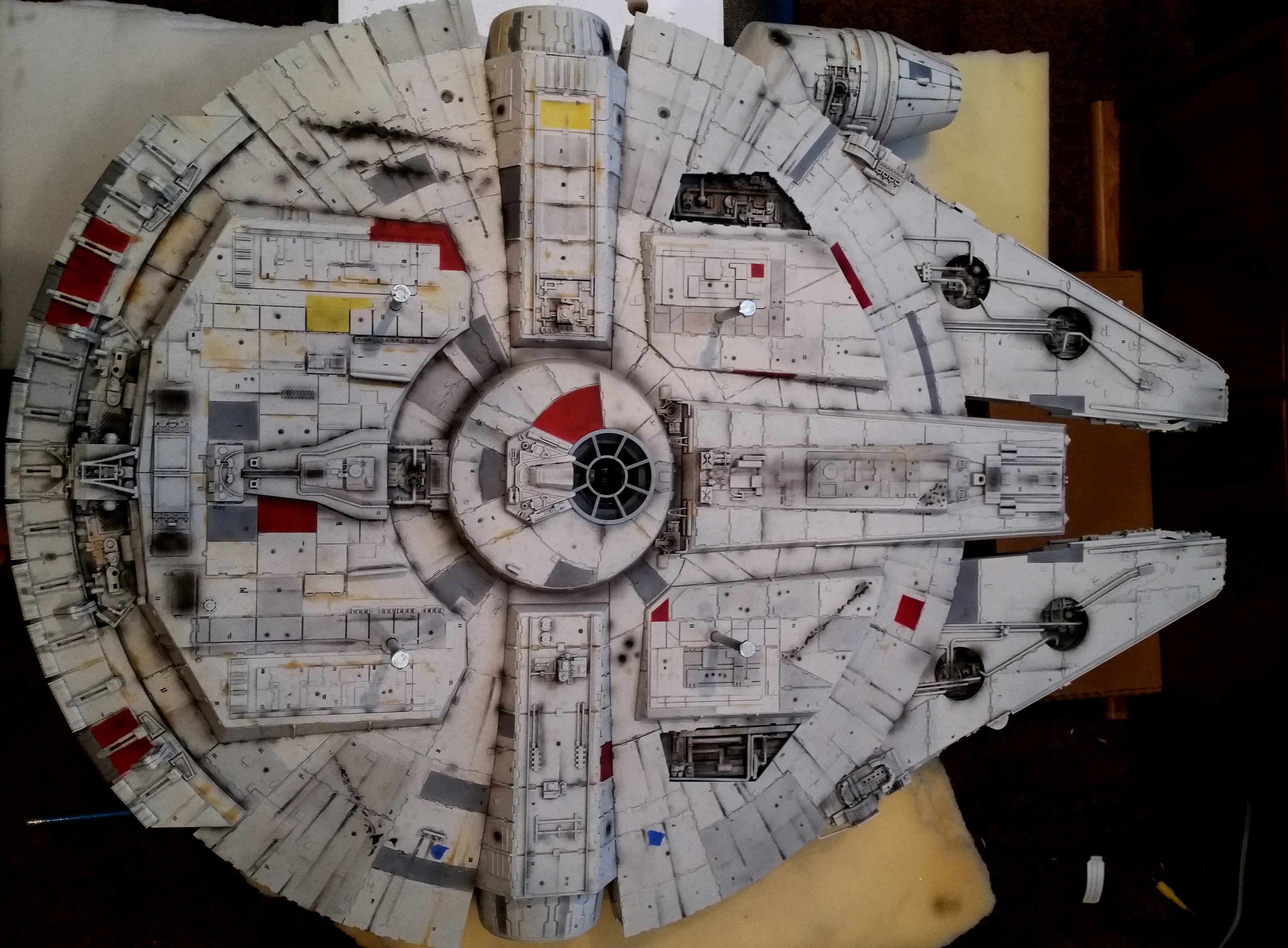

G'day Mike , before you put up your last post LOL!!! , I was gonna ask about photo #3 post #61 , with a ' similar ' name on the grey panel haha!! .Too Cool .
Cheers Ged.

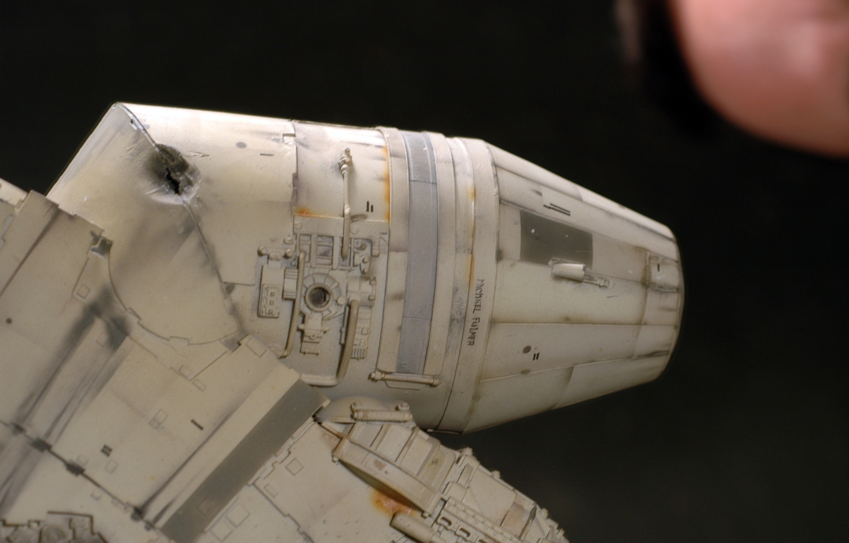

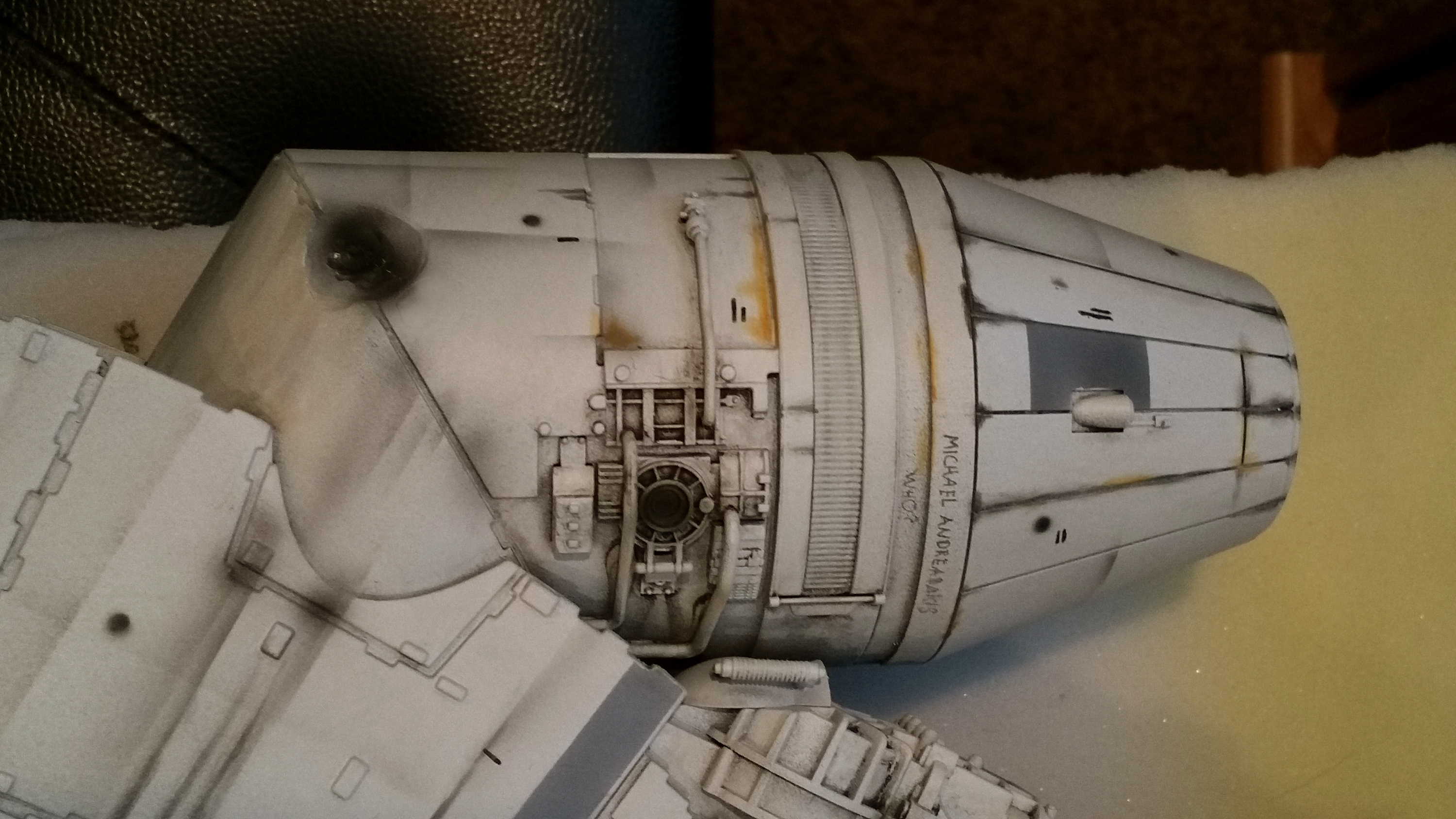

In case anyone is interested in trying to replicate the signatures around the ship there's this. If I could remember where I got it from I would give them credit.
Not sure how they deciphered Charles Bailey out that mess on the dish strut.

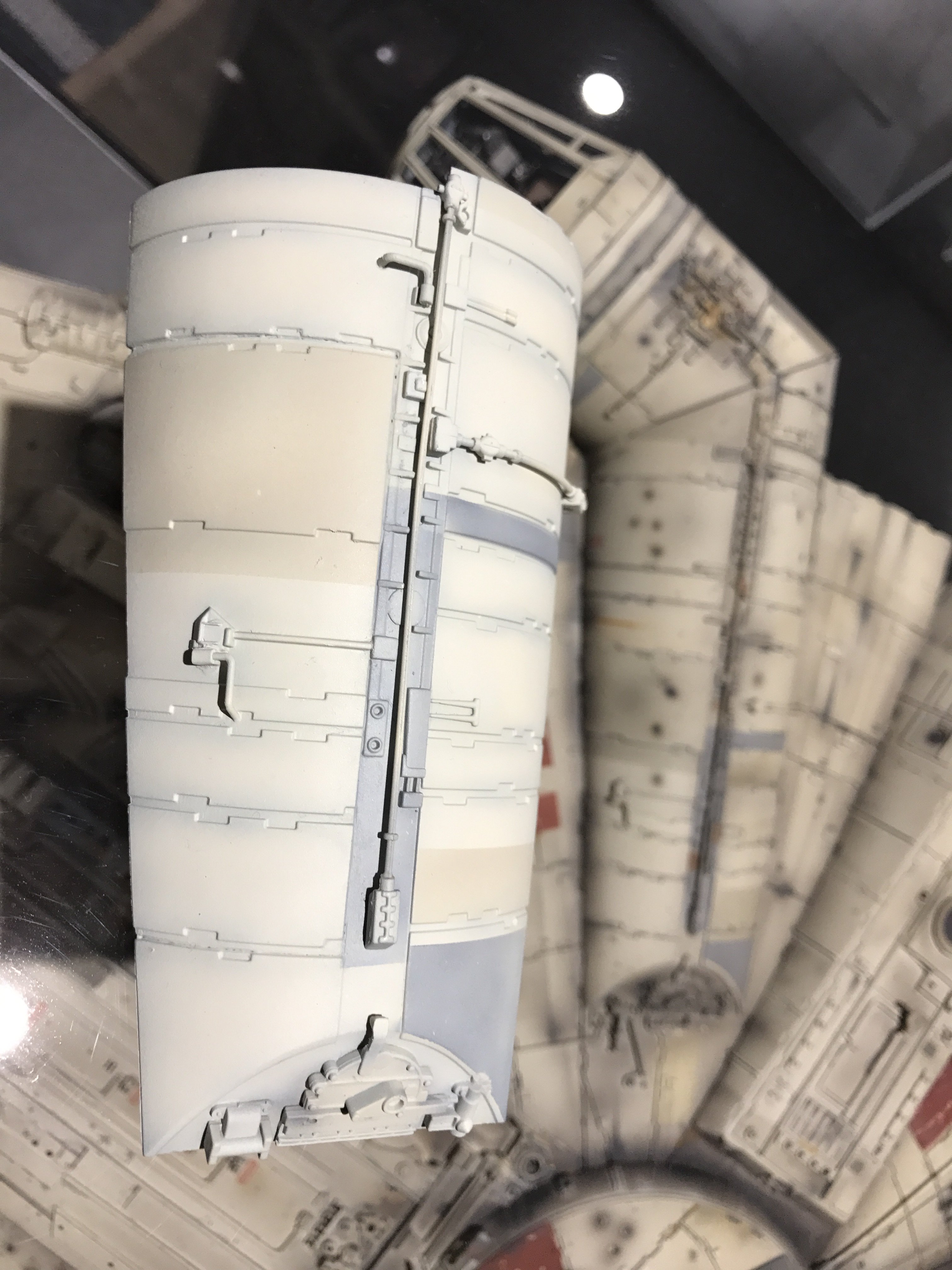

Don't know if you've decided on whether to fill in the gap around the cockpit tube?
To help you decide, here is my De Agostini part, filled and prepared for weathering, my MR Falcon below it for comparison...
I think it's a no-brainer, looks a lot better without the gap...

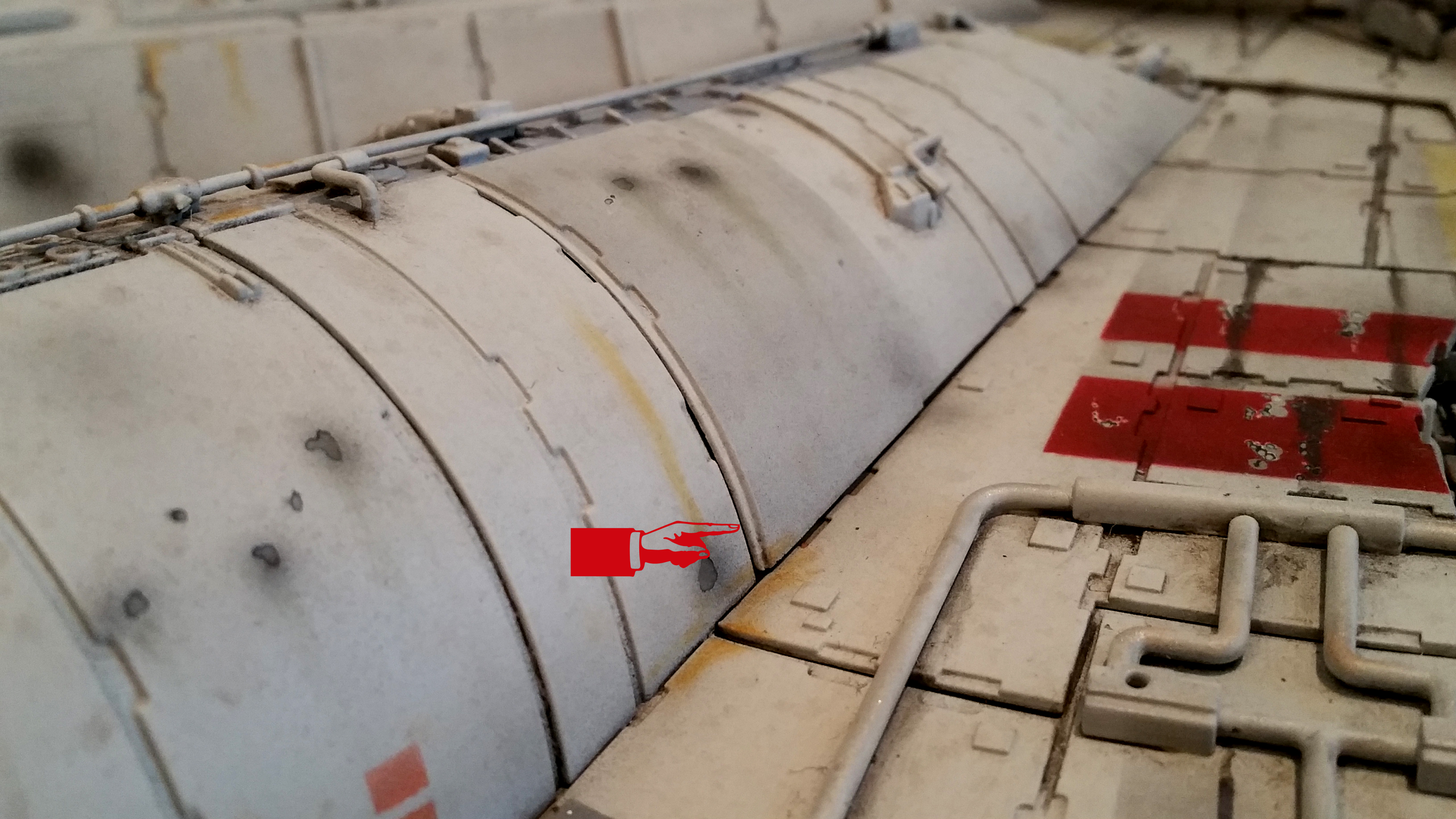

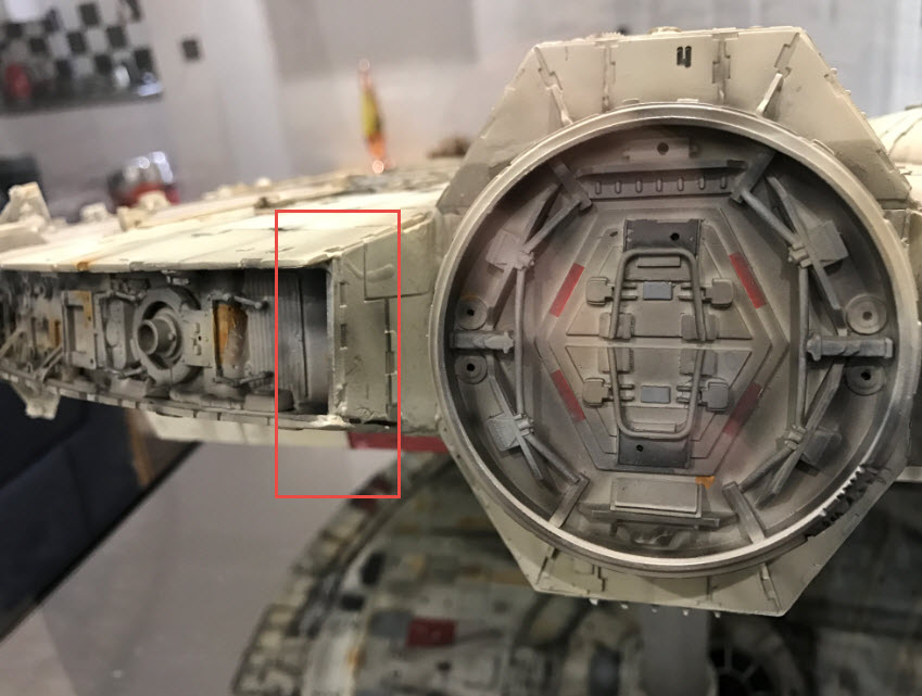

Just noticed that De Agostini missed off the notches next to the hull, at the rear of the tube piece
Yea, they missed a lot of those and the panels aren't 100% either in certain places. I trimmed off the plating in the circled area here and on the other side because that's how the studio model is. Not sure why they did it on the bottom and not the top. I also added the missing area of armor plating that was omitted by Deag.
I see you also cut back the edging by the Starboard Airlock door... nice work!
