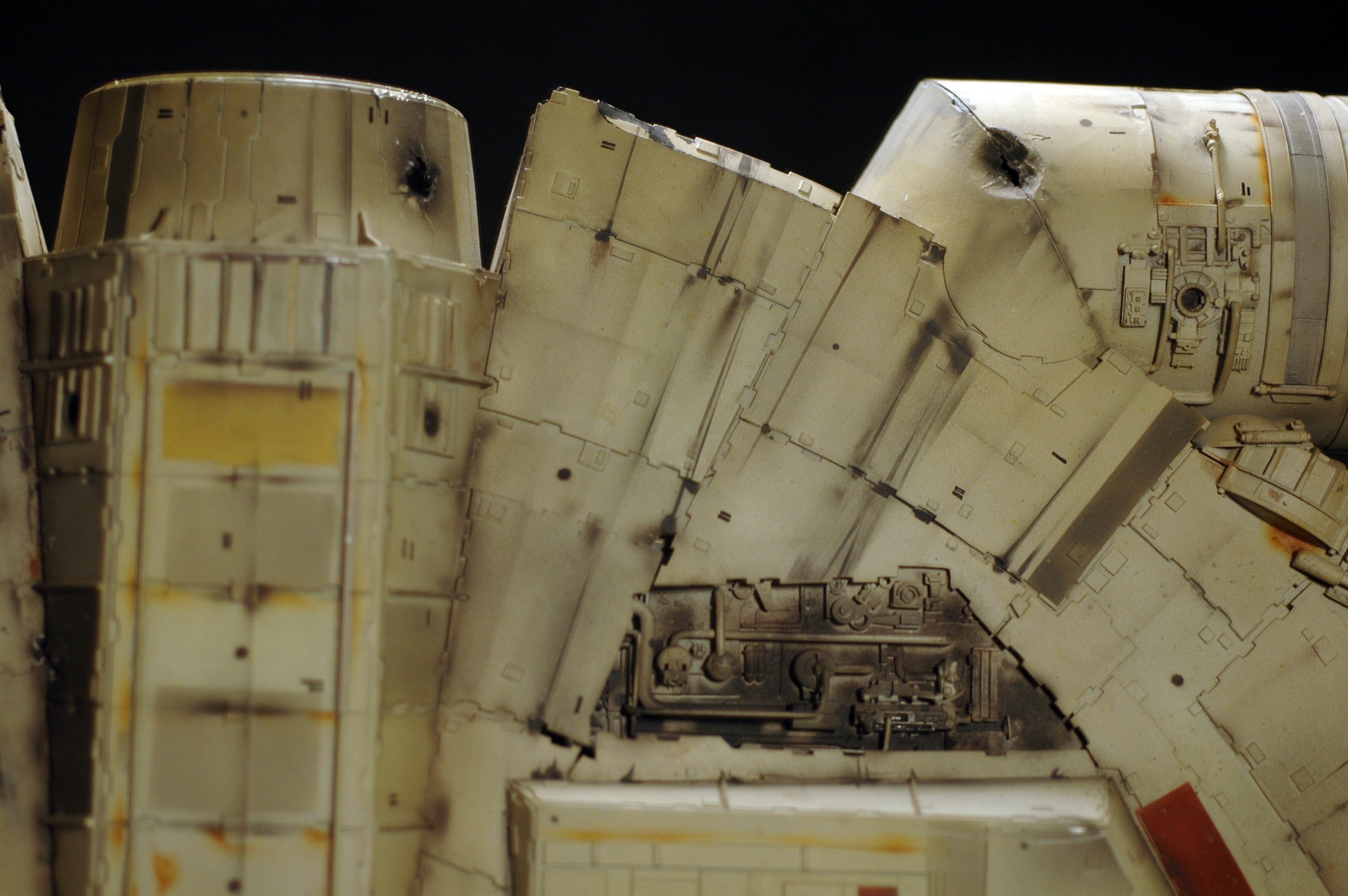

I want to reach a result which has the quality like the MR Falcon. Especially the paint. That´s why I already decided to repaint it completely after it is finished. Especially the weathering and softer colours are my plan. I already collected these cool HD images of the 5 footer and the 32” SSM to know where I have to go. I own an old MPC/ERTL 1/43 X-Wing since 25, too. This one is still boxed so I will start with this little one to train a bit… If it becomes good it will be displayed together with the falcon later on. Same scale so why not?
