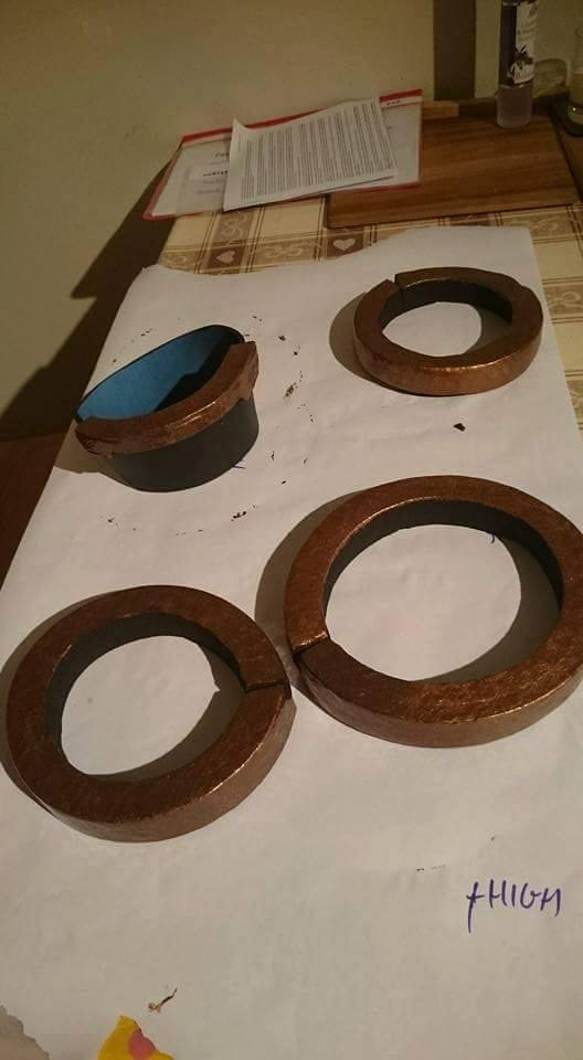

The leg test ring worked so made and painted all four. Very cool :)

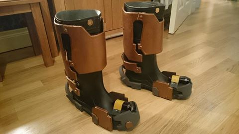

Boots. Added small parts. Undercoat added.

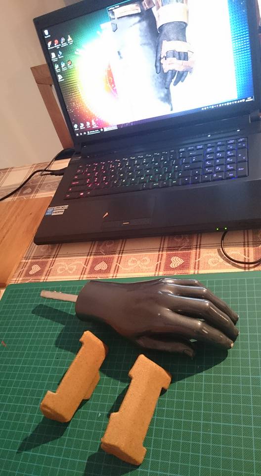

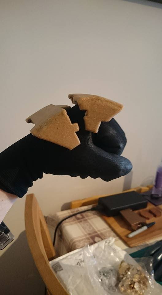

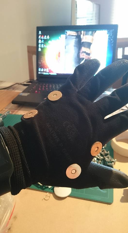

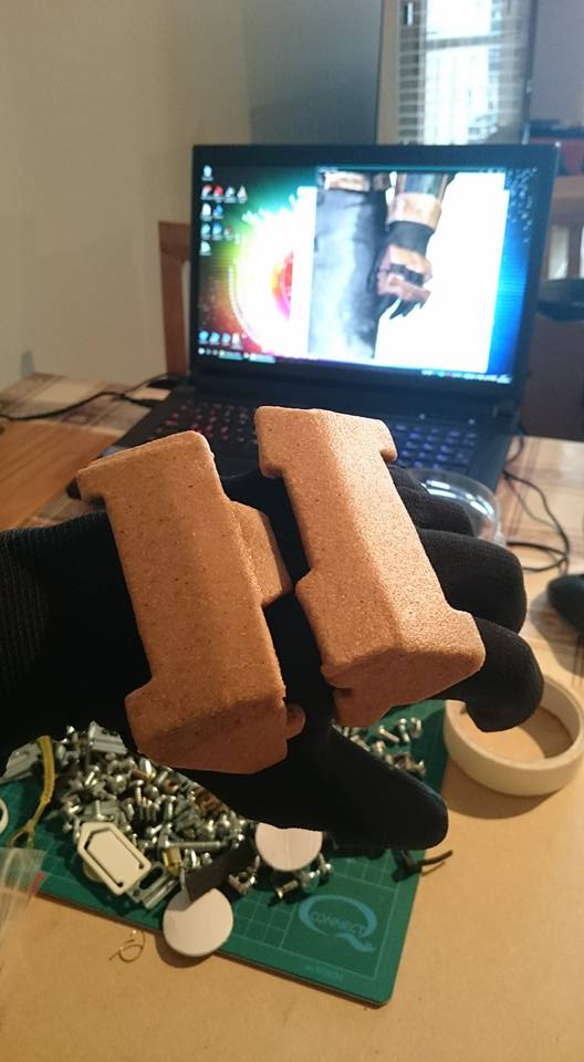

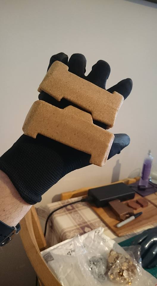

Left glove. Gard created, magnets added and undercoat and painted.

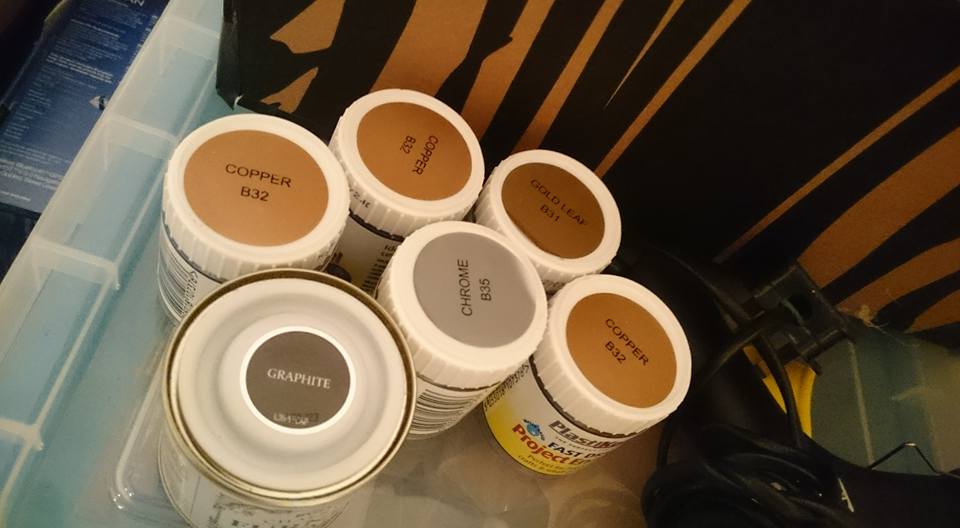

More paint bought.

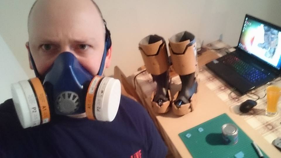

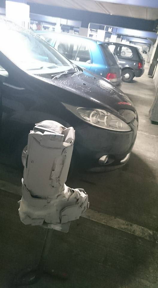

I don't have a garage and a storm is brewing. So I popped my boots in the car and found an underground car park to spray
smile emoticon
Sorry for bombarding this post this weekend but things are going well. (I have sprayed one hand black and can not remove the paint but Hay...)
Boots done! Added EVA foam rear foot clamps. Lights working and hazard yellow added. All in all HAPPY

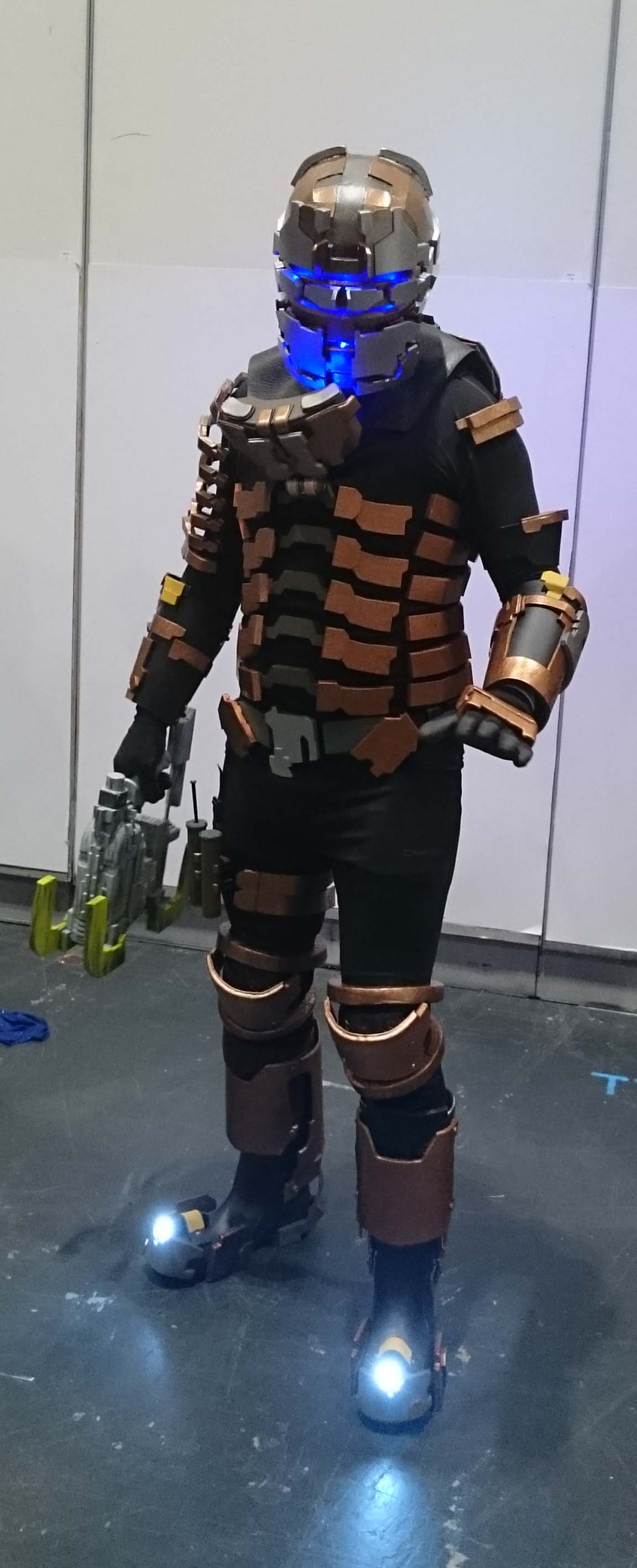

Knees done. Hold the phone... Is that the full suit built and painted?!? Time to relax. Now I must add all the details and lights. But if push comes to shove I could walkabout in it now and you would know who I am.

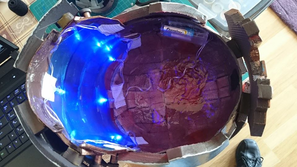

So FINALLY got my lights working along with a 95% (yes95%) visibility. The first big built where I can see! Gave up with el wire and tape went back to plan B that was plan A before plan C came along....

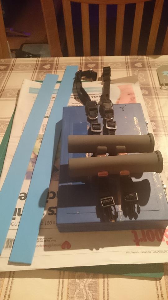

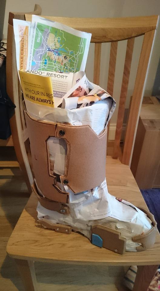

The inside is not as nice looking...

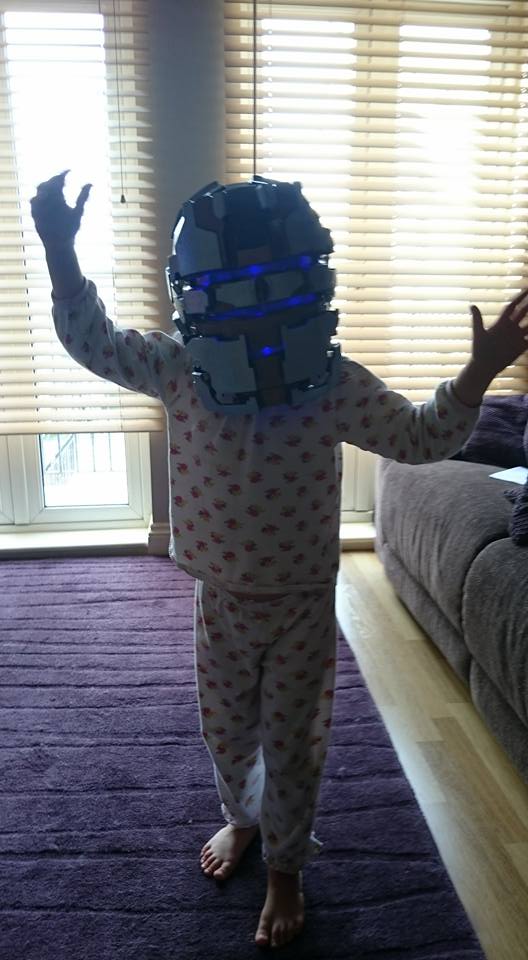

Even my 4-year-old is enjoying the possibility of heading to space!

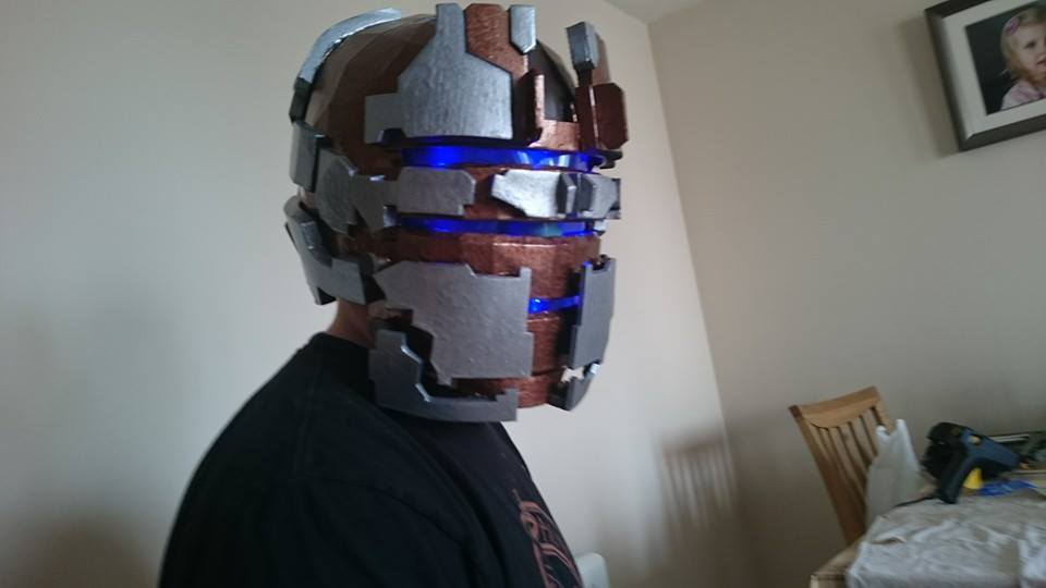

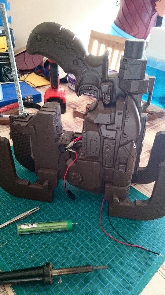

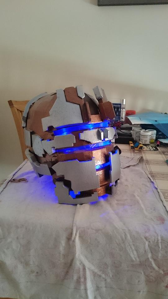

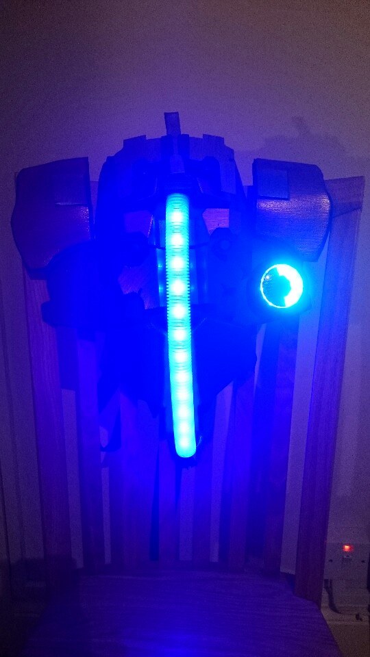

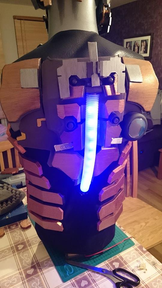

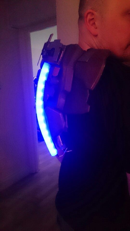

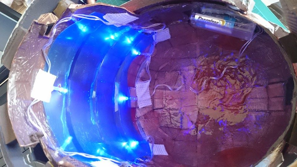

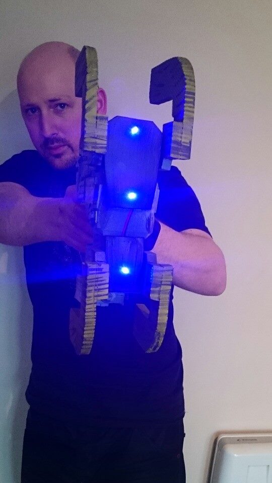

So the LED's look cool! I found a plastic pipe from a sink and hot glued some LED's into it! Nice!! also added a small round light to the side and covered half with tape. All looking good!
I have just added a small test video of the RIG to my facebook page (Dax79Cosplay)

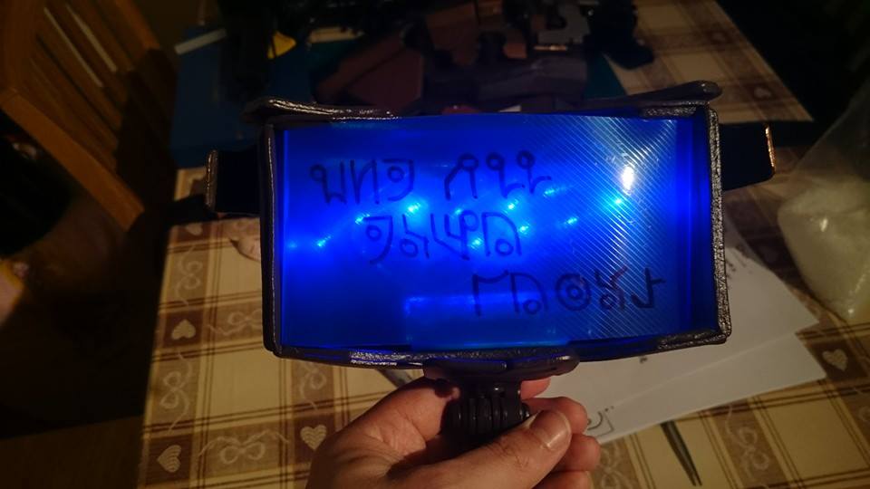

The map unit now lights up! Nice little easter egg within for you DeadSpace fans!

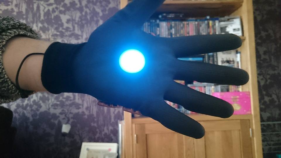

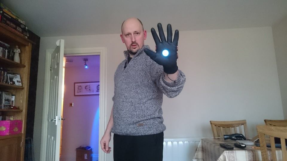

Lights added to my left hand! Soon I will try the full suit on so please continue to #watchthisdeadspace

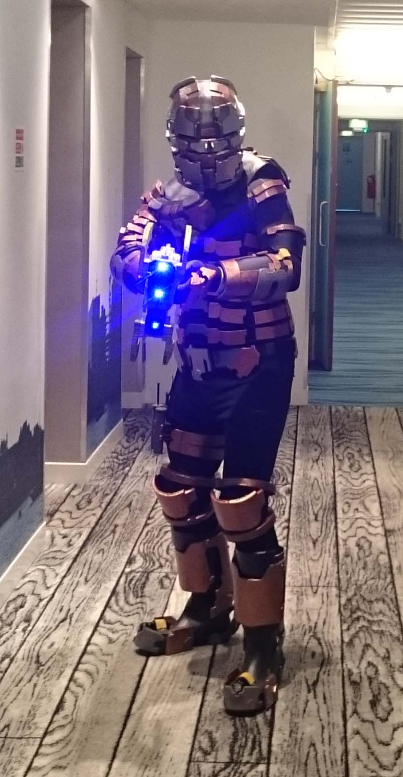

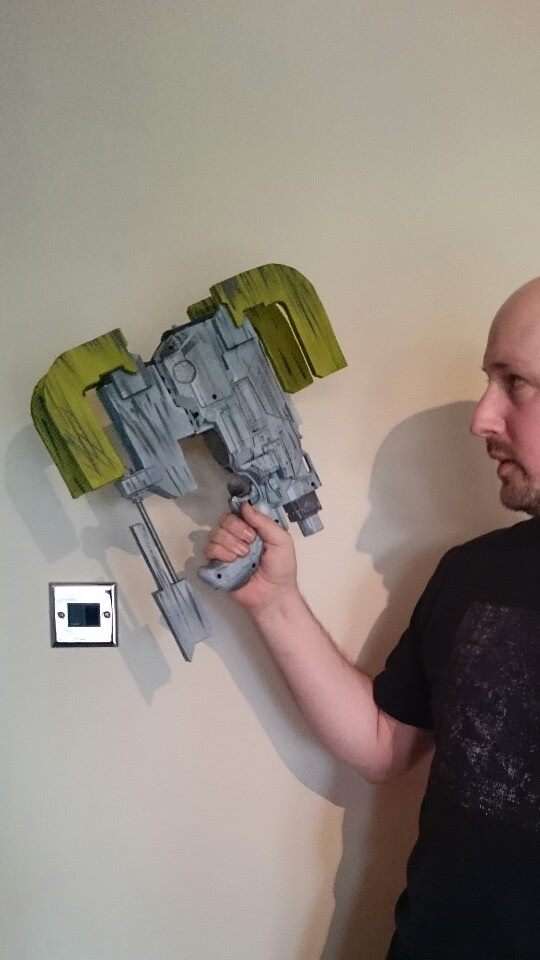

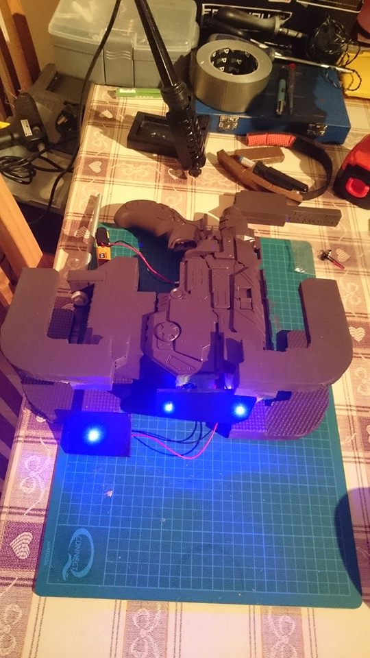

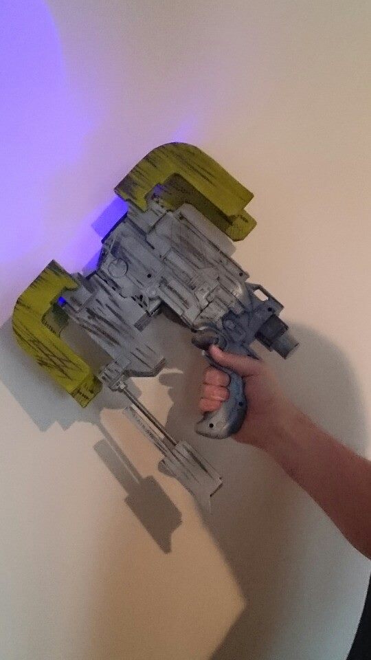

Today It was time to finish my Plasma cutter. I only have five weeks till Comic-Con (UK) so I must Busta move :)

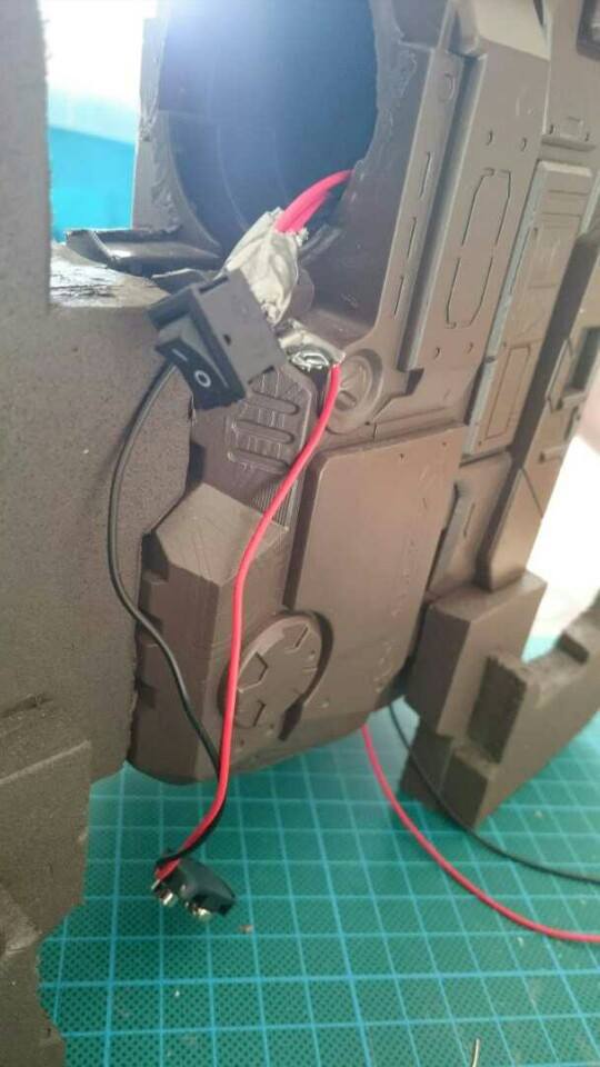

I wired up some LED's and fed them into the cutter I had made last year. I used polymorph to hold the system in the cutter. I have set a switch up on the underside of the gun so to turn the lights on I must use my other hand. It's a rocker so the lights can be left on. I pop the 9V battery into the hole underneath them use some soft gray foam to hold everything into place.
I'm very happy with this and hope it helps other cosplayers building one :)

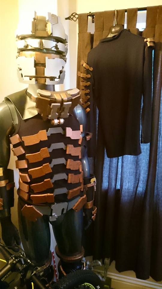

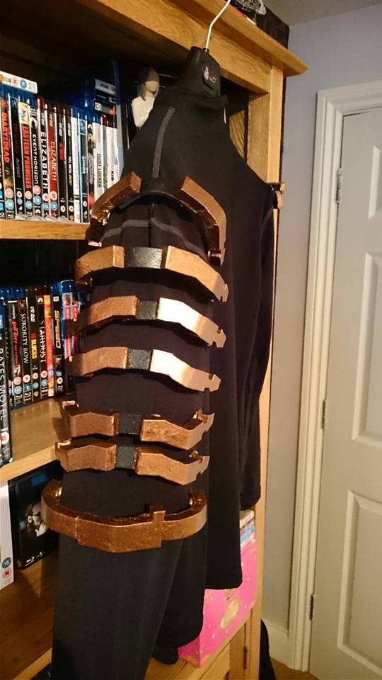

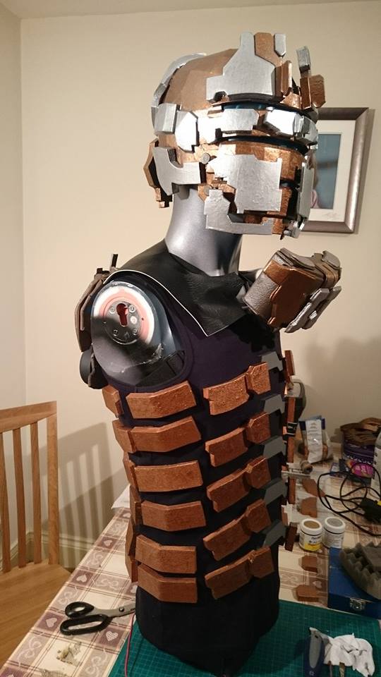

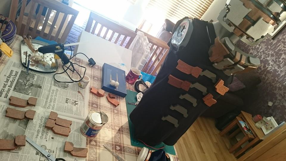

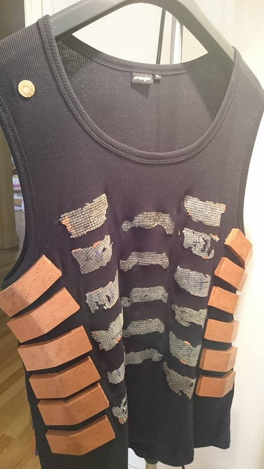

One month to go... So I was not happy with the vest as it was not fitting as well as I hoped. Also I was going to wear a boiler suite as a base layer but after studying the game I fount his under suite is much tighter and well fitting. So Ribs off the old and onto the new!
I really like how the back is looking with the tighter vest...

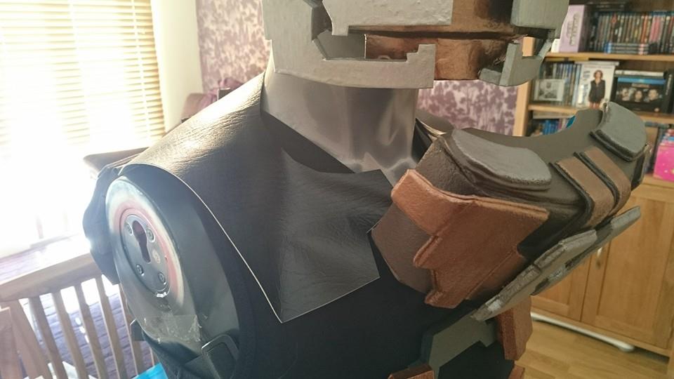

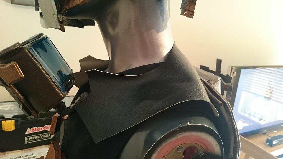

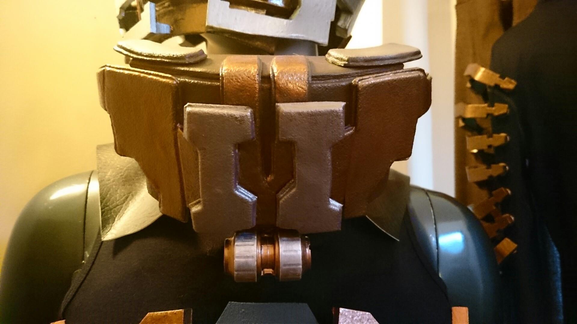

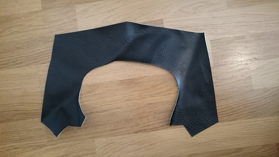

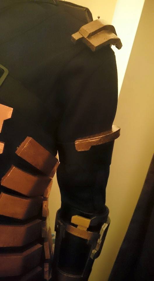

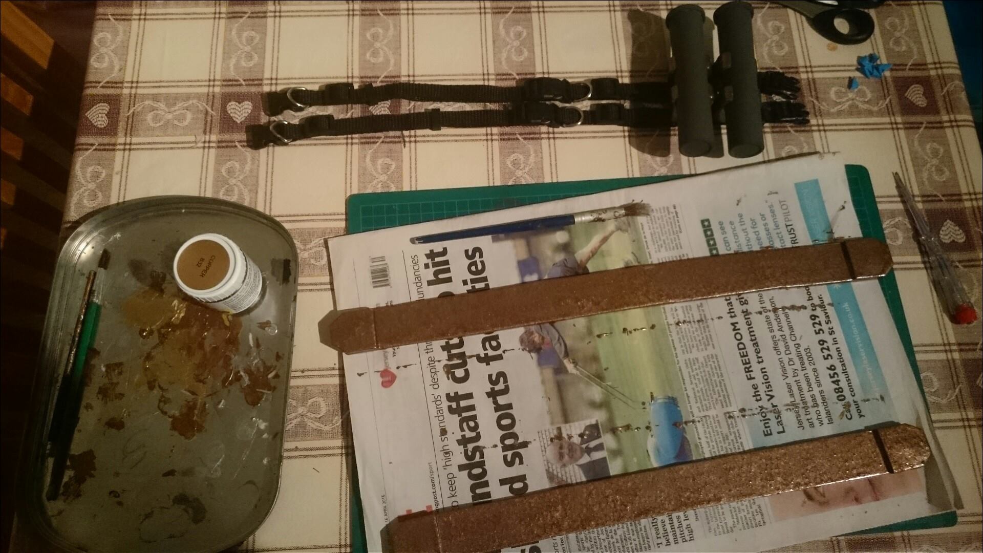

Now for my shoulders you can see a cover that goes up to his neck. For this I got some plether and cut it to shape. I will ass Velcro to hold in place. This really helps cover the harness that the RIG and Chest map unit are using.
Also added the Map unit hinge...
I used magnets to hold the 'floating' arm shield on the right arm, also magnets to hold the left shoulder plate in place.

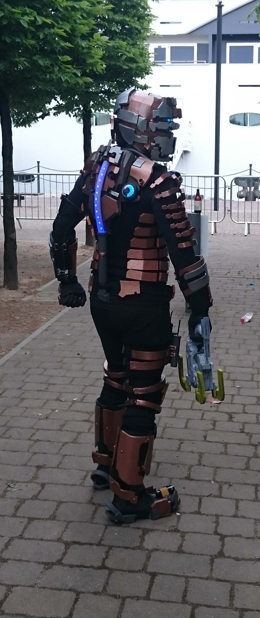

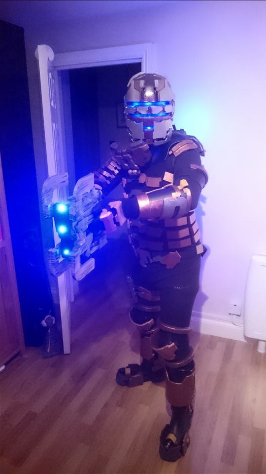

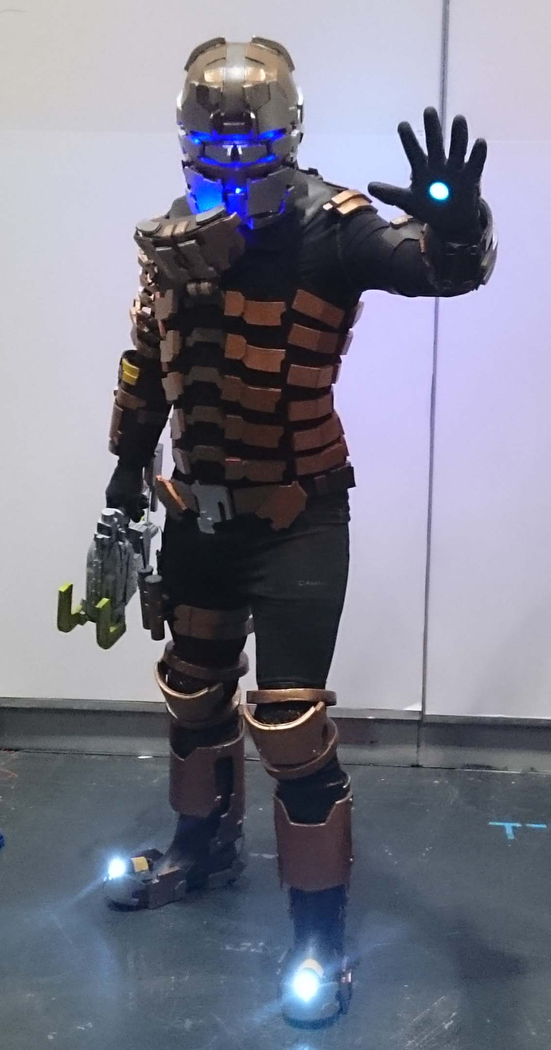

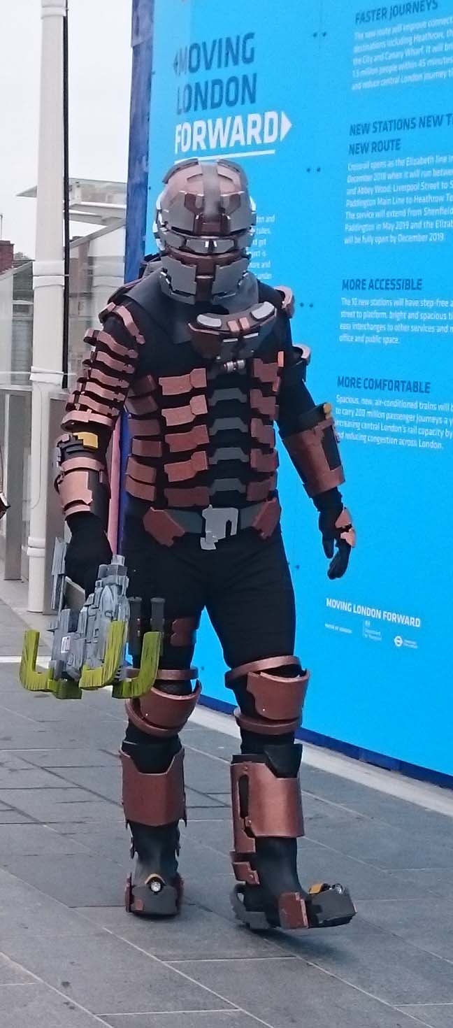

DeadSpace 2 Cosplay completed at last! Here is one photo for you all I hope you enjoyed the build. this was the first test of the full suit. Do you like? Would you like to see more? Well you have to wait until the MCM London Comic Con so #watchthisdeadspace #mcmLDN16.
I will post more after the Con!!
Updates will be put up on www.dax79.com

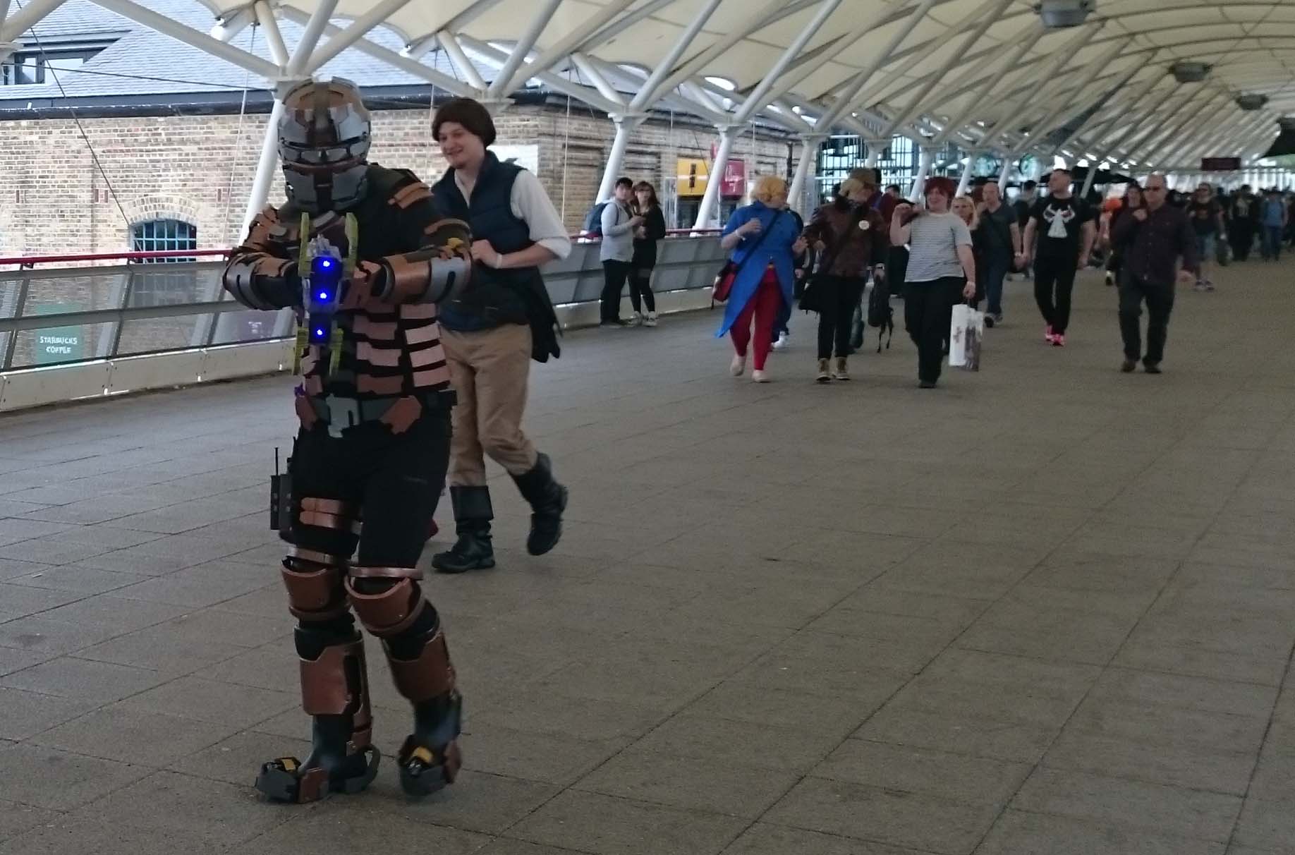

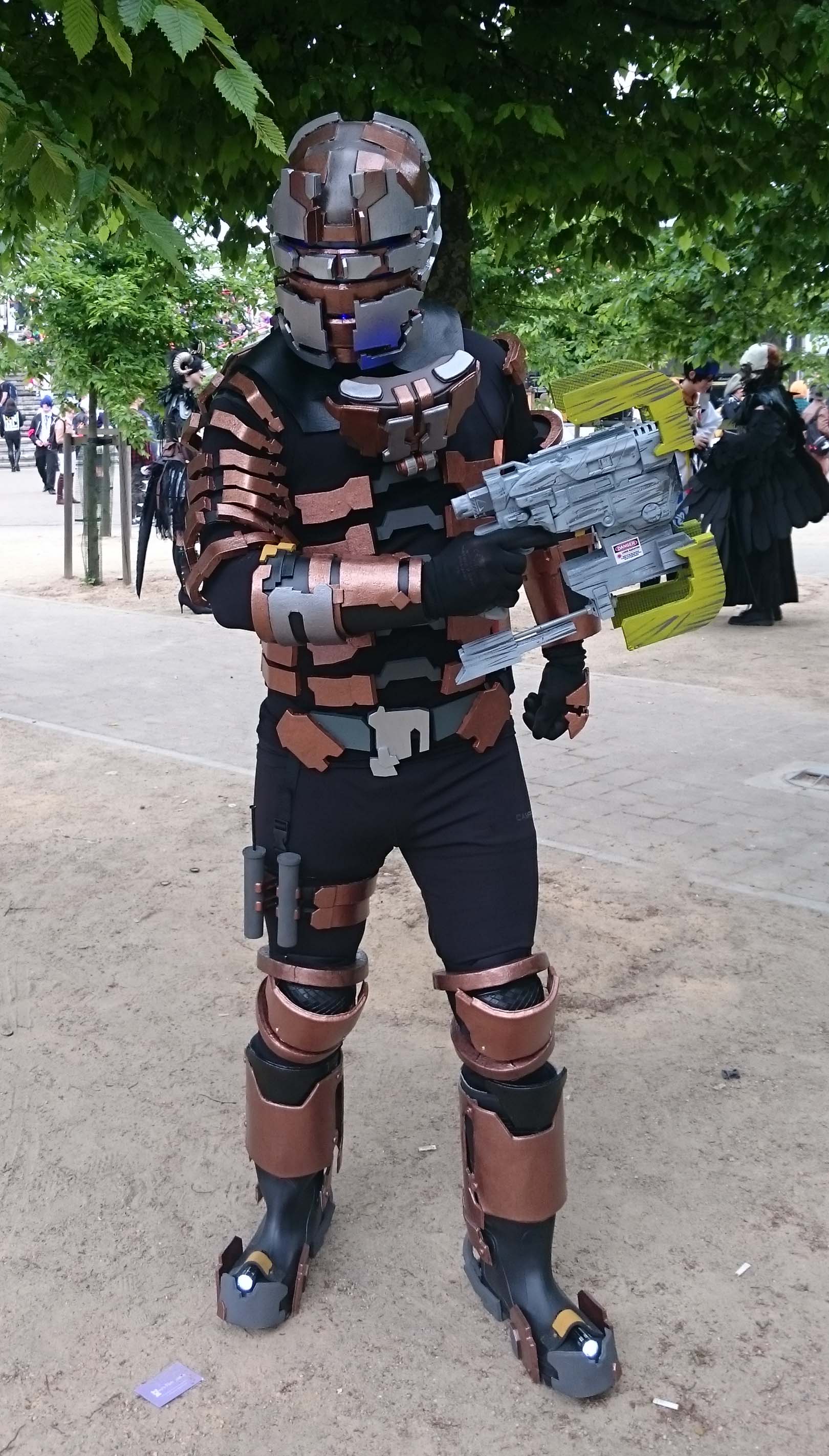

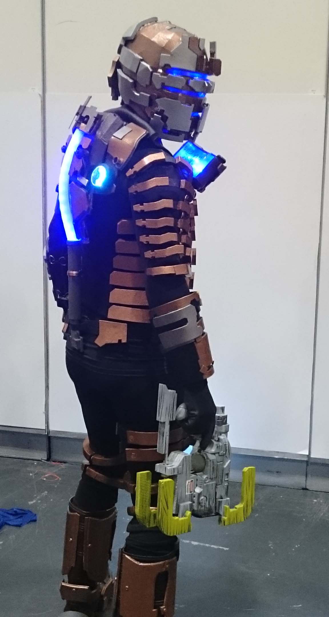

Here it is... the final post. Here are some pictures and a video from the con. I did not get the right leg cylinders to hold until the night before! But all worked out. It was comfortable to wear, my lights ran all day without dimming. Here is my masquerade performance.
The day was a blast and here are some pictures to let you want to make one too!!! I would love some feedback as you guys are the ones who keep me going!
